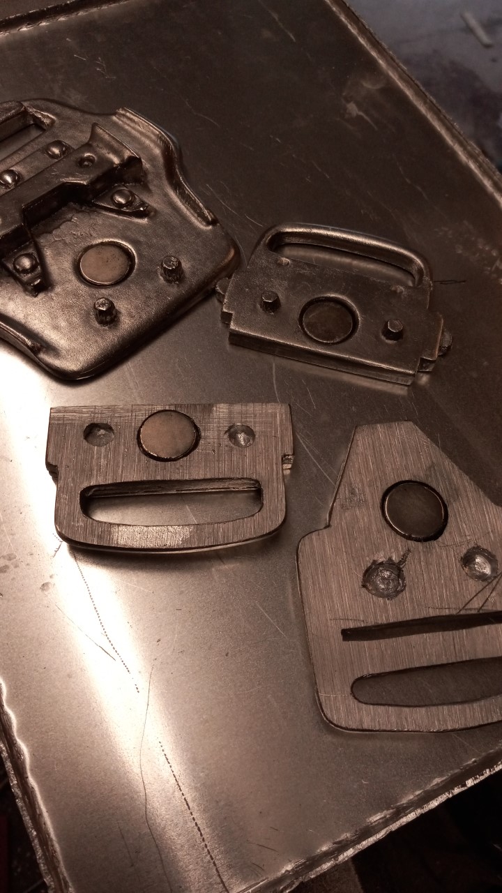

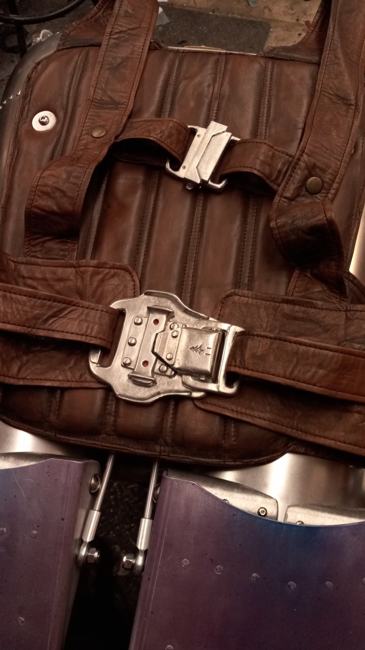

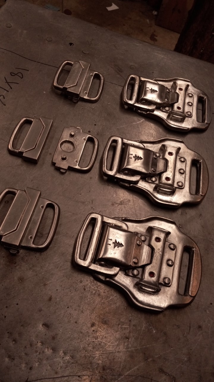

I figured out a way to cast the fabled and elusive Rocketeer buckles in real metal. As any of you die hard fans know, the original buckles are so rare that they might as well be made of pure gold. These, however, are pewter. Instead of trying to recreate the exact mechanism, I simplified it drastically. Instead of latches and springs and pivots and clasps, I made each buckle as two separate parts. On each part, there are either a set of prongs or a set of corresponding holes. There are also rare earth magnets embedded on both sides. The magnets hold the prongs in the holes, and the prongs provide the necessary strength. Since the entirety of the weight of the rocketpack (my metal ones weigh in at about 27 lbs), rests on your shoulders and not the buckles, there is almost no lateral load applied to the buckles. The magnets are plenty strong enough to do the job.

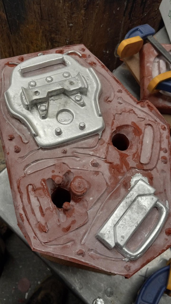

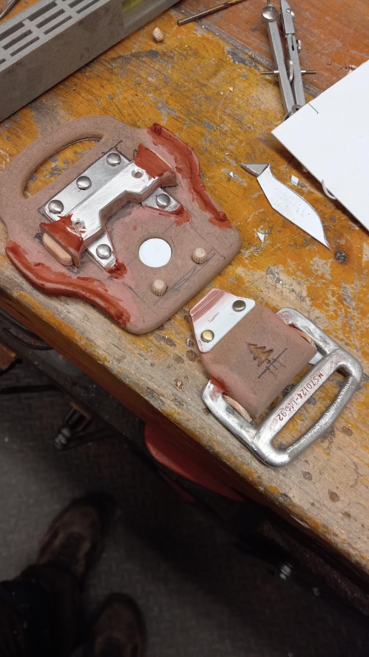

Figuring out how to cast them and make it work was a long and expensive ordeal. Each set requires a lot of cleanup, polishing and weathering to finish.
