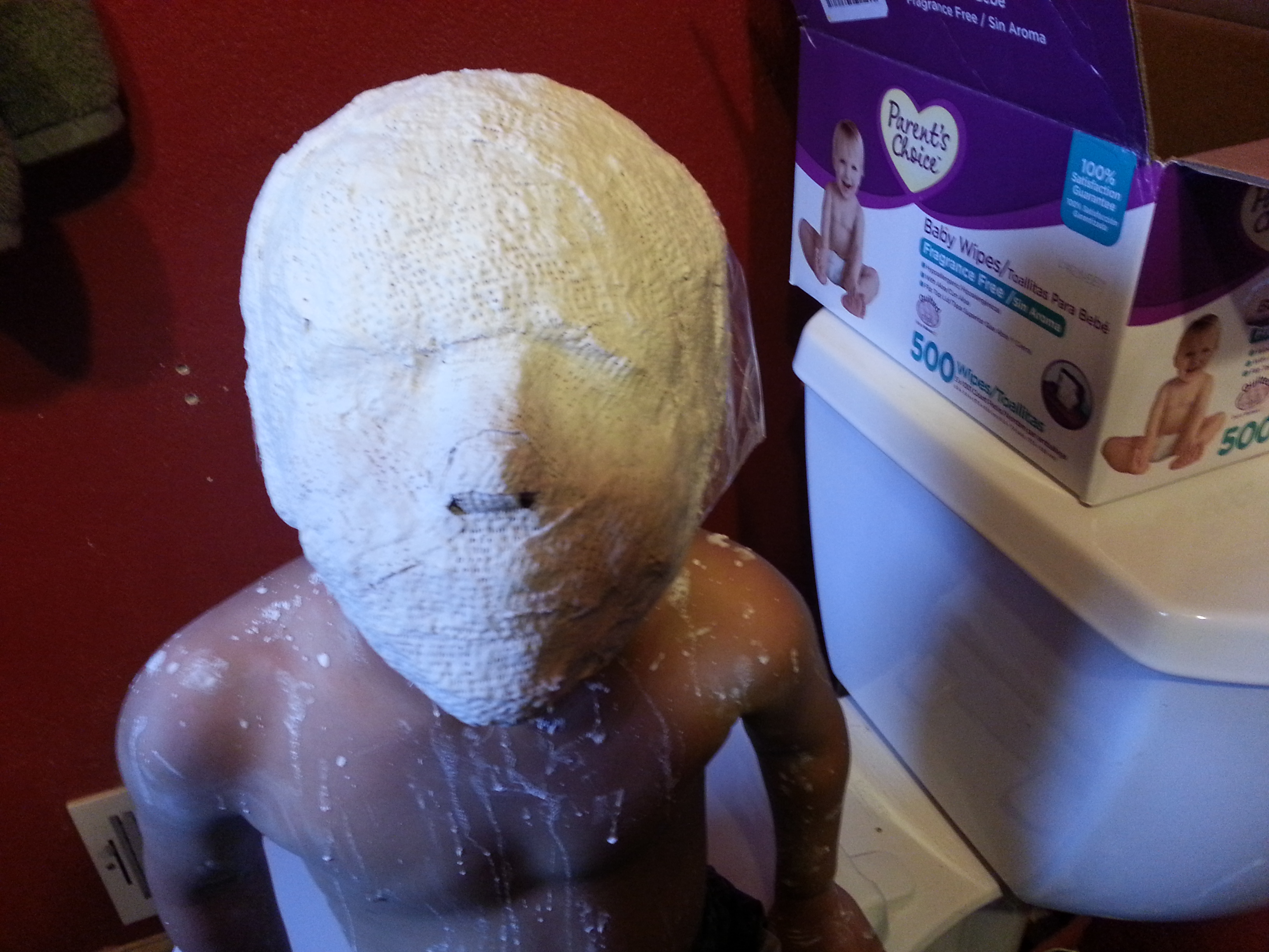

He fell in love with them when they showed up on his spiderman cartoon. I decided to start working on it ahead of time before the next conventions pop up. I made a rough face cast by coating him in vaseline, taping plastic wrap on to protect his hair, using low endothermic plaster bandages (i tested them first) and built a thin layer ( i mention how awesome my son is? Lol) Once it dried , i removed it and closed up the nose holes and made it stronger.
I lined it with vaseline, then poured in plaster (this works fine if you dont mind losing your mould) this left me with a great base to sculpt on. I sculpted out what i wanted then covered it with latex rubber ( i cant afford silicone for one mask, i spent $11 at hobby lobby and still have half a bottle left) i did 6 layers of it. I added keys and a bridge and plastered hald my mould, lined it with vaseline then did the other half to get my mother mould. Once dry i sprayed pam spray in my mould (no mould release
) and slush casted it with resin, 5 layers.

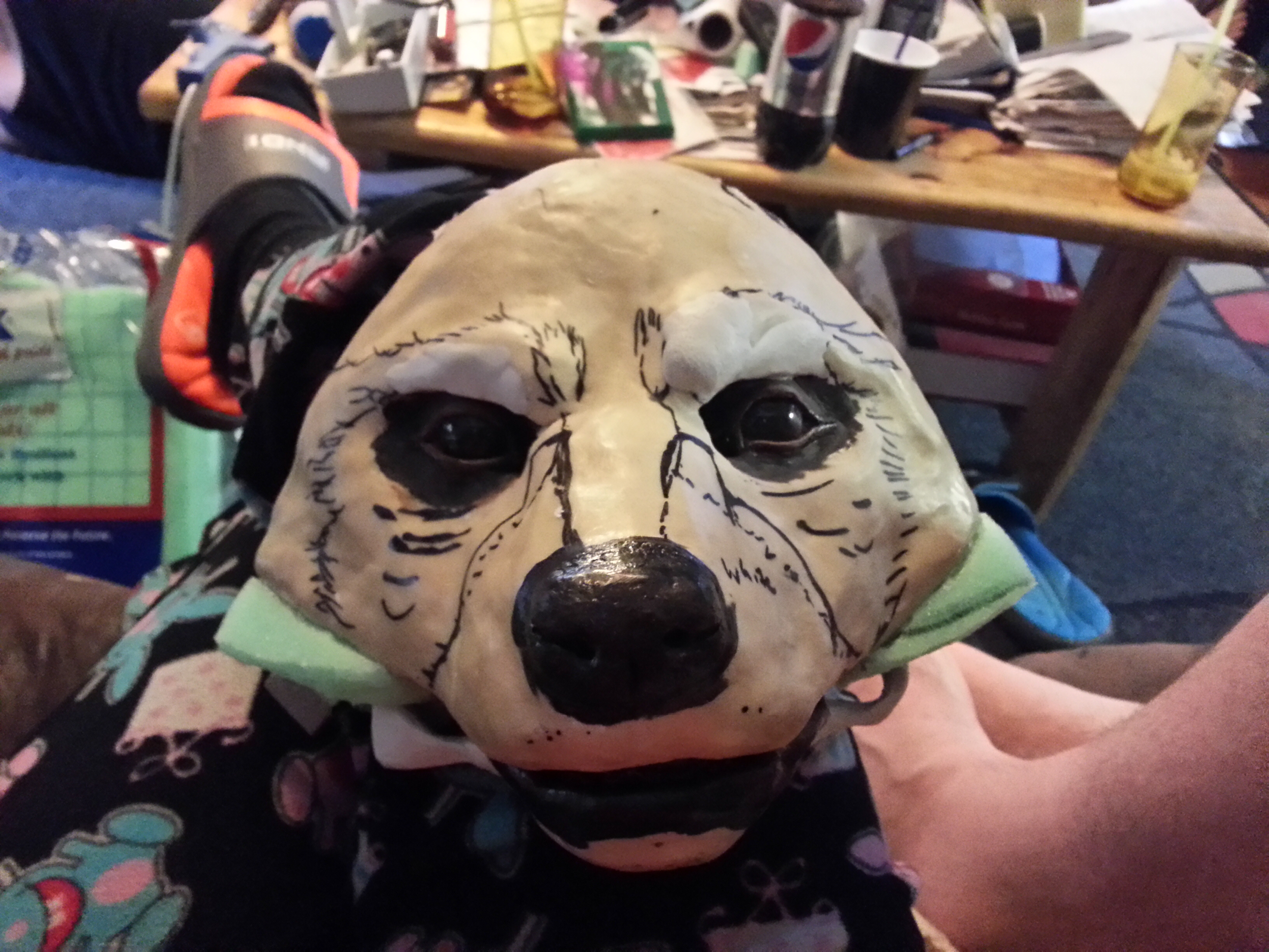

Ive since cut out eyeholes and opened the mouth with hinges so it opens and closes.
Teeth are sculpted and made. Waiting on the eyes and fur to arrive to fur it and finish making the back of the head.. More to come
