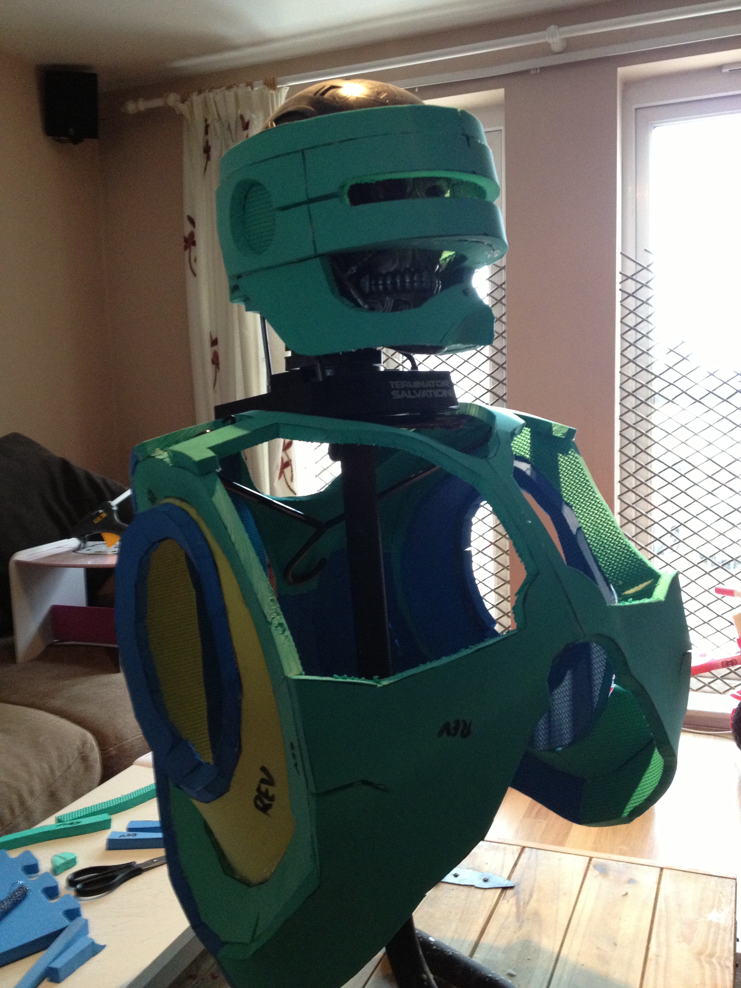

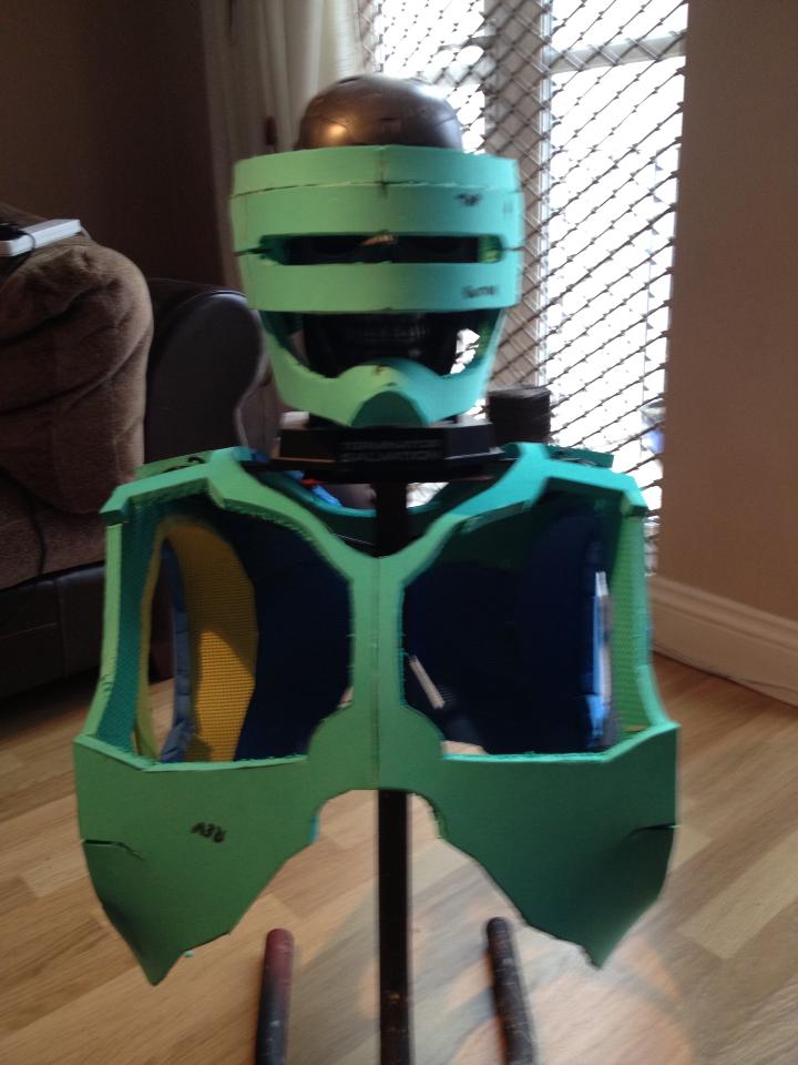

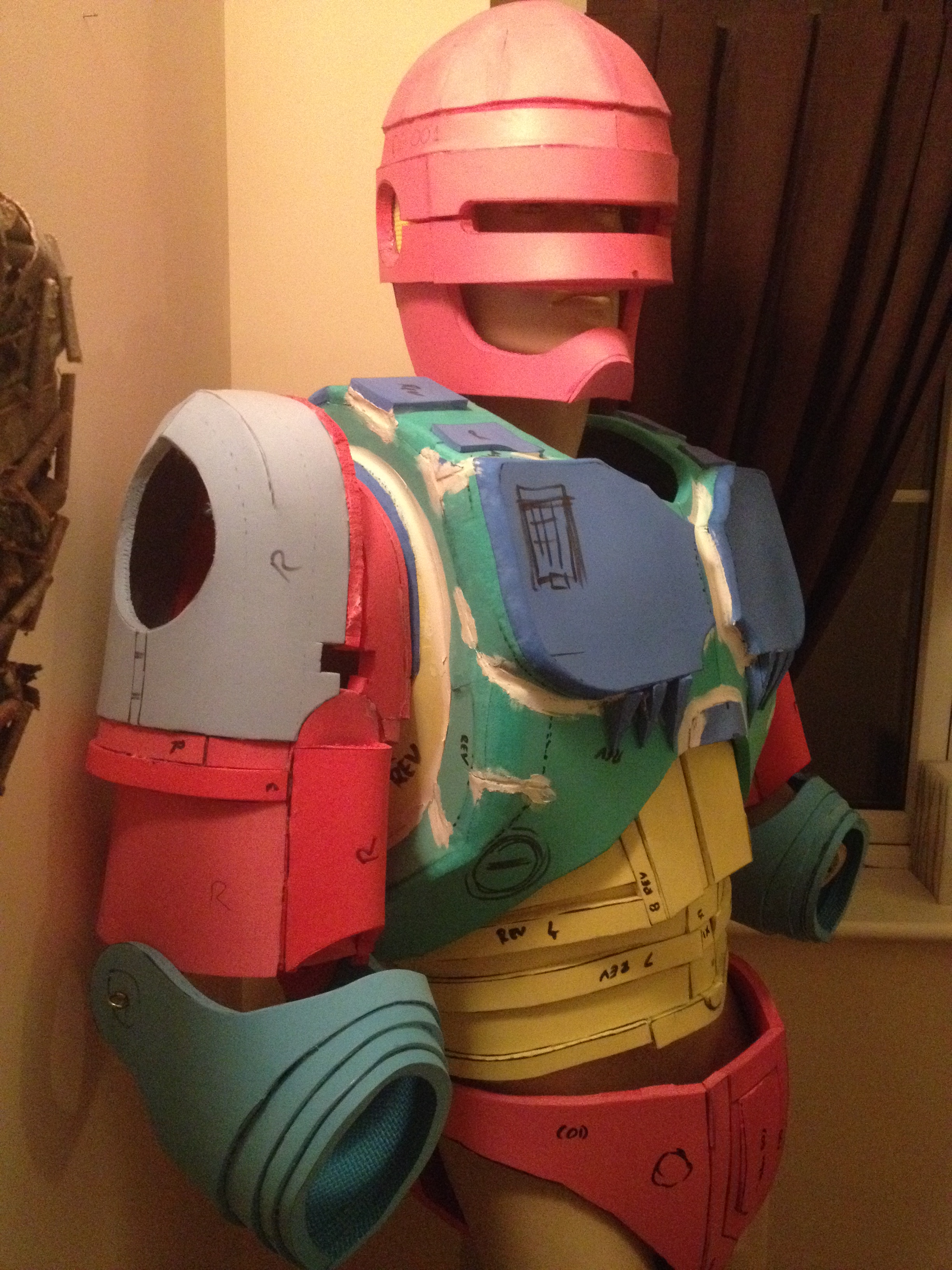

I started cutting a frame from foam.
First issue! I worked out the size of my head but forgot to take the thickness of the foam! AHHHH! I had to make a new one, but my little girl liked her new toy!
From here I spend weeks cutting and forming a basic shape to work with using a heat gun and hot knife.
Then disaster.... I live on a island and nobody will send EVA foam to me! I NEED MORE! Time to phone the family on the mainland and see if they can help!
Thanks family...
Now, back to it! Once I had a basic shape I used filler to fill in any gaps.

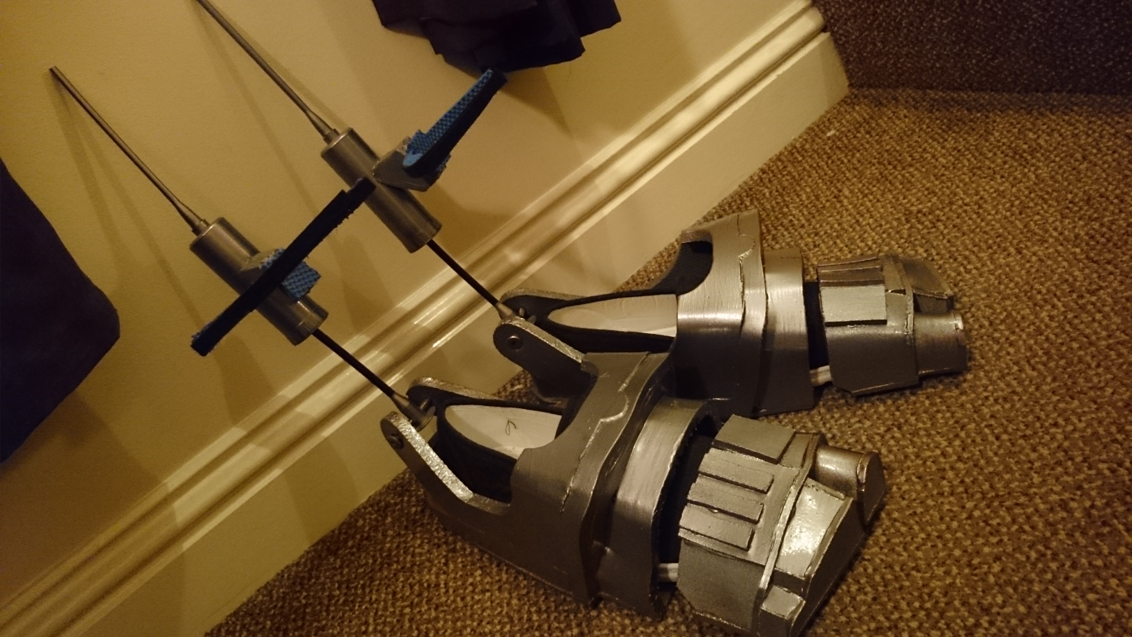

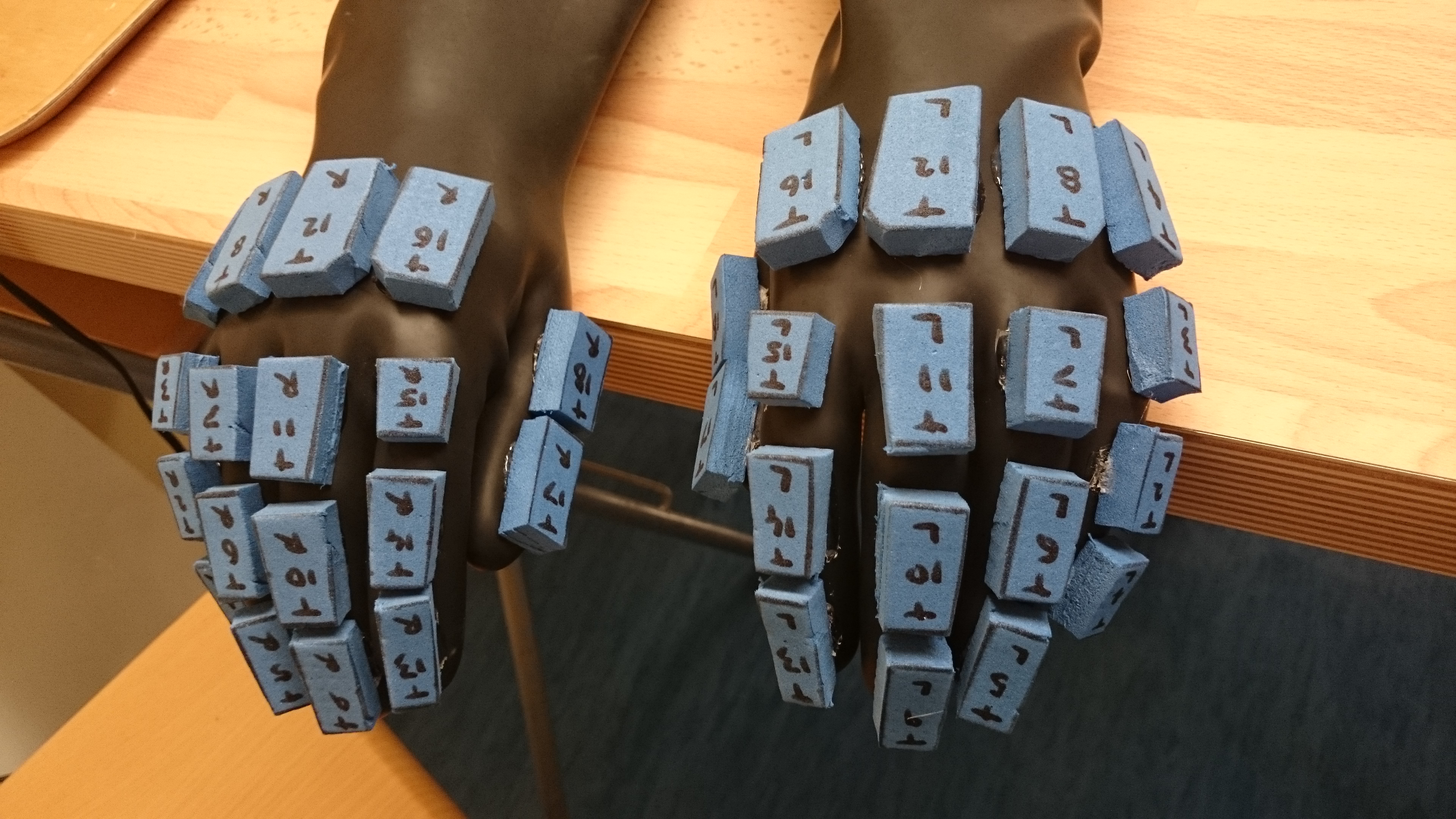

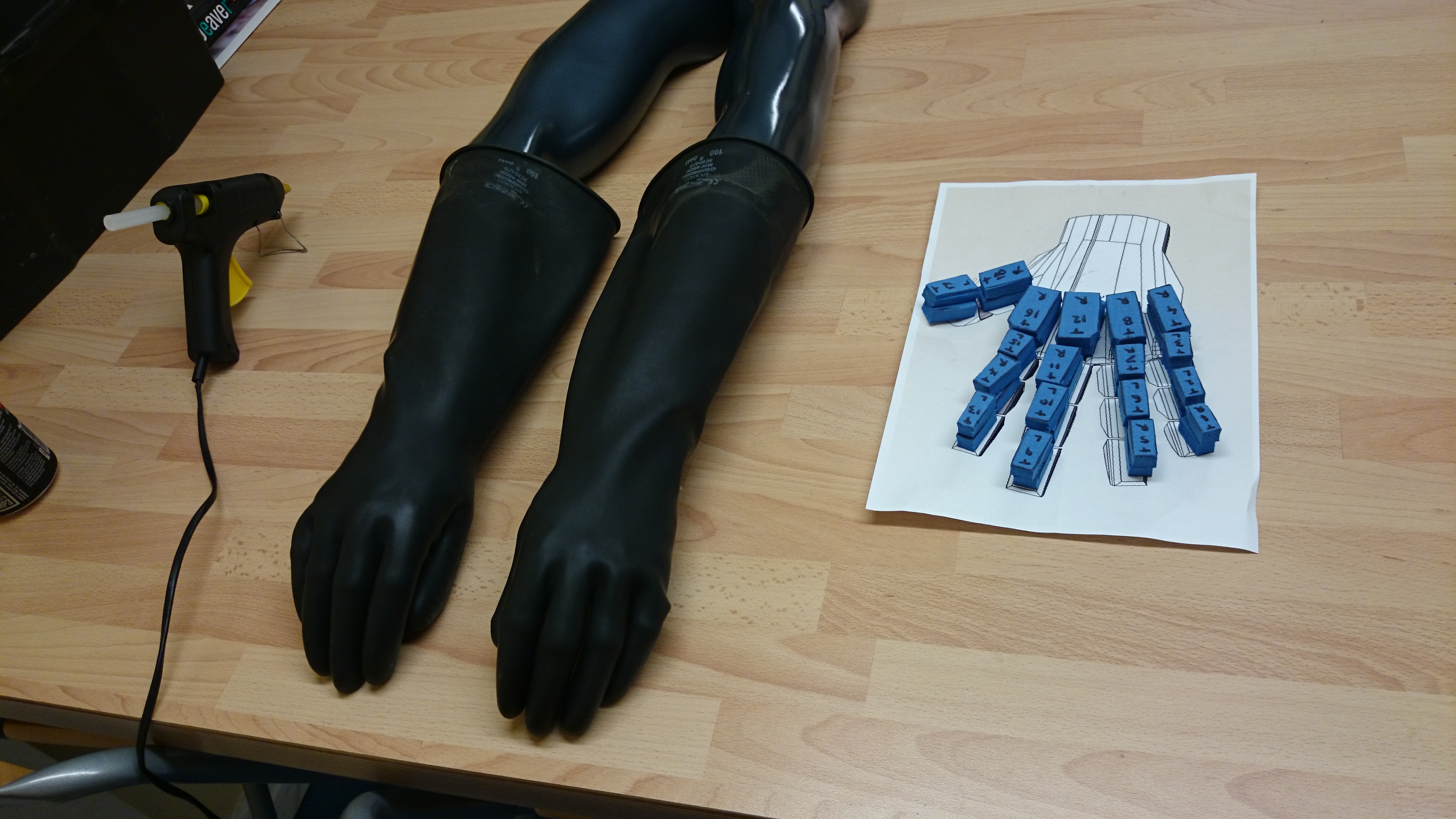

Then it was time to buy some bits. I thought the best thing to do for his hands would be to start with a pair of black gauntlets. Then add some EVA to them at bulk them out.

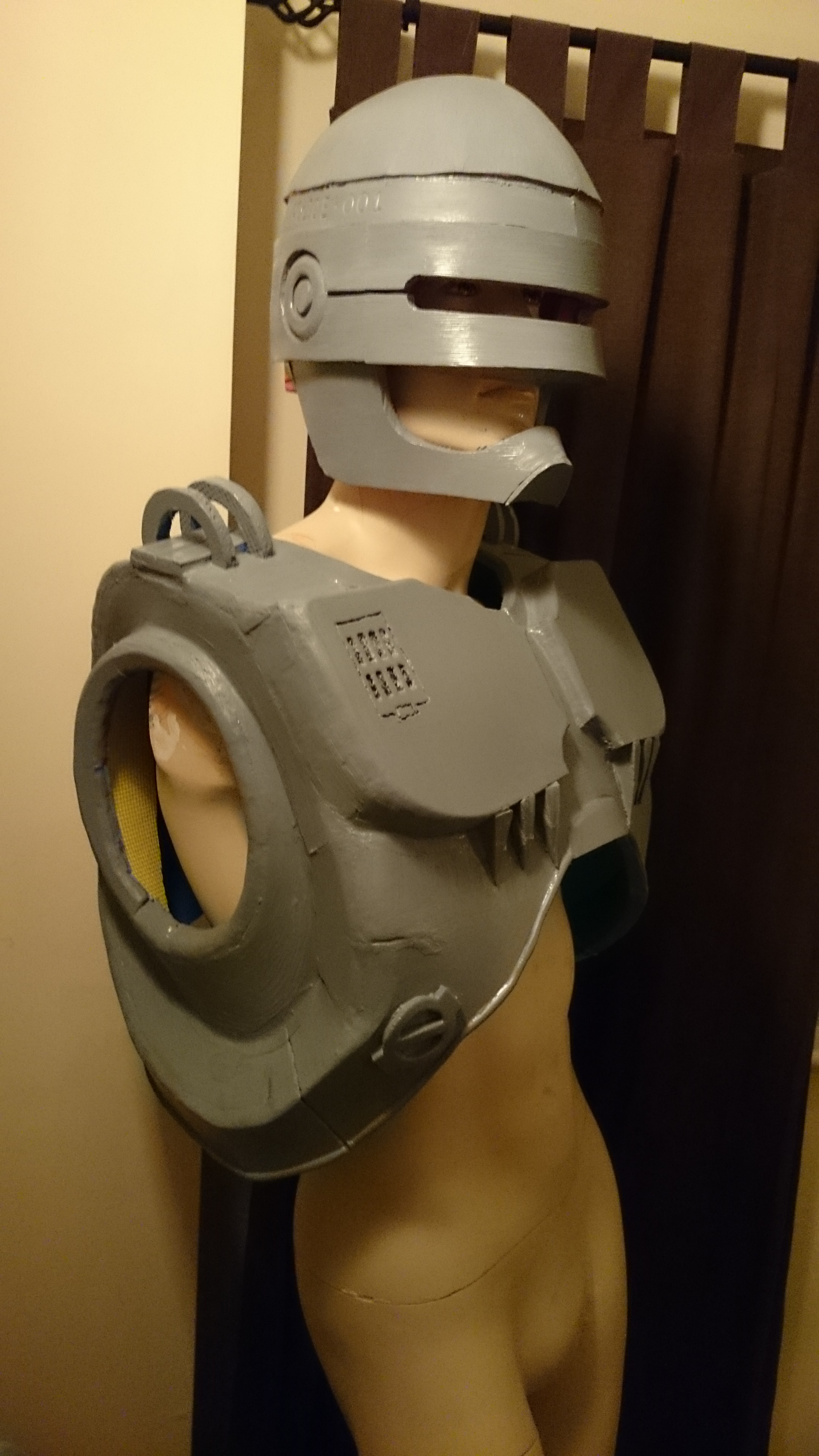

Best if I try the WIP on, don't want to waste time spraying up something that needs cutting up!
Things are looking good! I need to cover my neck and add groves. For the neck I got a scuba divers neck flange. Then I got the hot blade out.

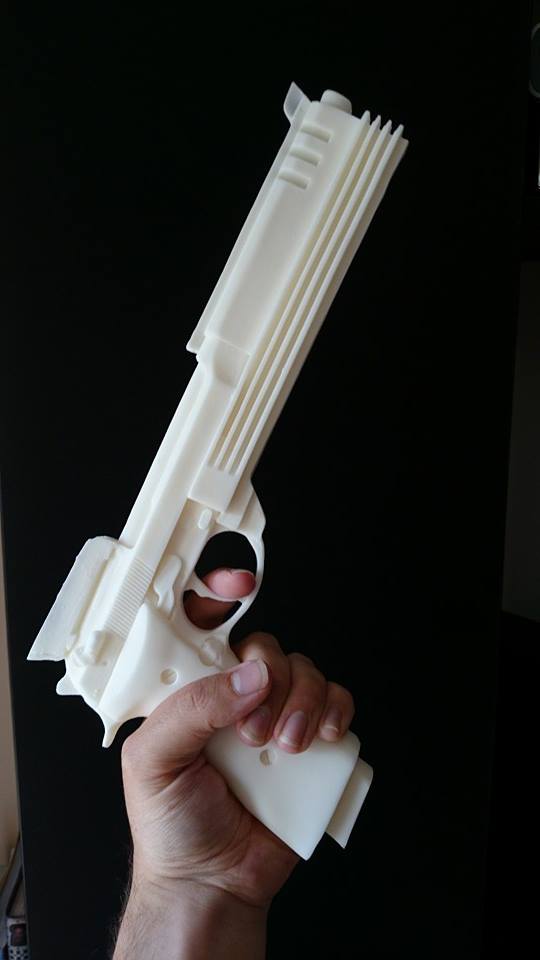

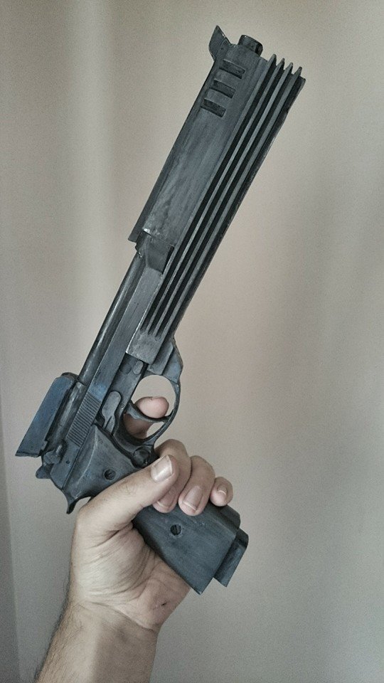

Now lets look at my AUTO 9. Its a fictional weapon that kicks ass and looks cool. Every boy from the 70's/80's knows this gun! I wanted to make every part of RoboCop but also want some great pictures, with that in mind I decided to make a EVA gun and also buy a resin film replica.

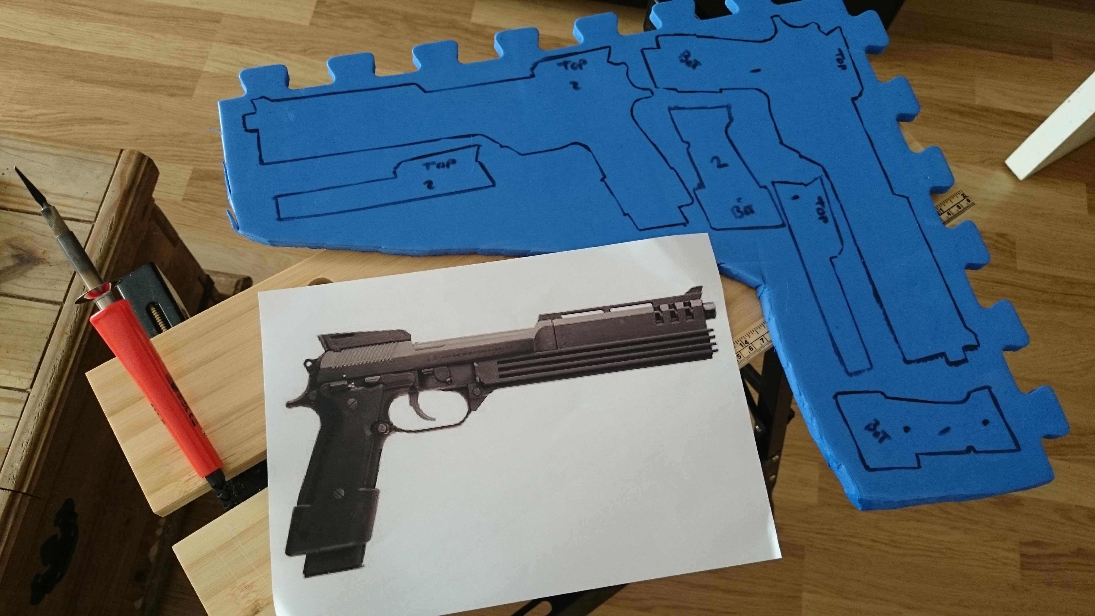

EVA -
I googled the gun, printed out the image and laminated it for both sides. Then I glued the images to the foam block. Quick easy and painless.
RESIN -
I received my prop and it needed sanding. Once smooth and all issues fixed and filled in I primed it. Once primed I painted it with Gun Colt (27003) finishing with Satin (135) Enamel.
The size is slightly off with the EVA gun but it still looks cool.
