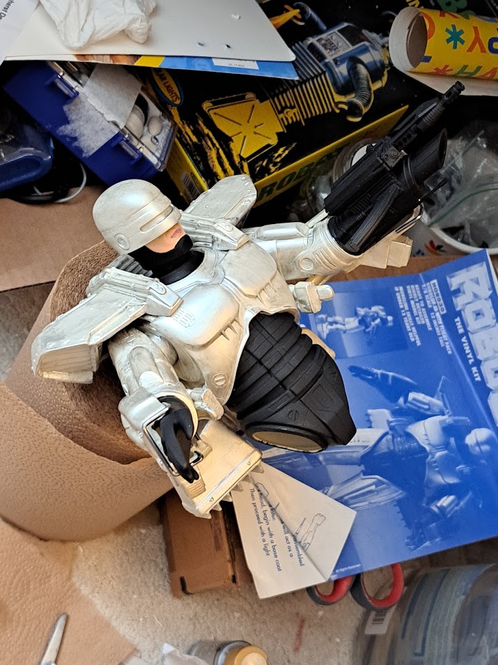

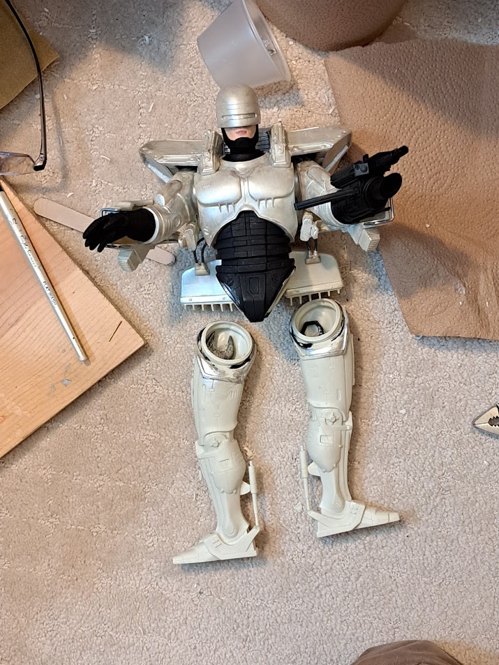

Way too far out of my comfort zone now. You can't paint a vinyl model in pieces & then assemble it later. And now I find I can't paint over mistakes with this totally useless acrylic silver paint. It's just translucent garbage (ha, and it says 'opaque' on the container).
BUT The test pieces done with paint & primer in one are now bone dry, to my utter surprise. Wow.
SO, I'm Gonna sand Robo some to get rid of some brush strokes, then blast it with Krylon gray paint & primer, let it cure for a few days until bone dry, then hit it with aluminum Krylon or Rustoleum & finish it off like a regular model with mostly enamels & stuff.
Want to see if I can salvage this mess....
Acrylics are for paintings. Grrrrrr

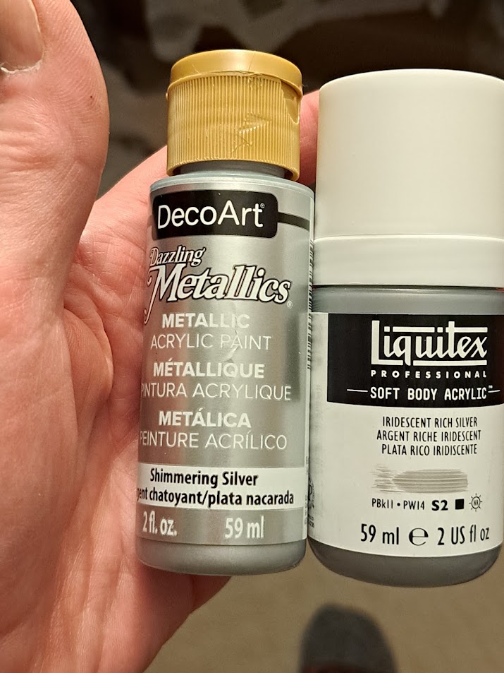

Back from the art store & bought two more acrylic silvers, the one on the left cost $3, the one on the right cost $12... guess which one looks more nicely opaque in my test just now. Yep, the cheap one. Very opaque. Nice silver too.

I've used the Decoart silver before; that should give you what you're looking for! Hope maybe you can return the other one!
On that note: Decoart, Ceramcoat, Folk Art and Apple Barrel have served me quite well over the years. I use them almost exclusively!

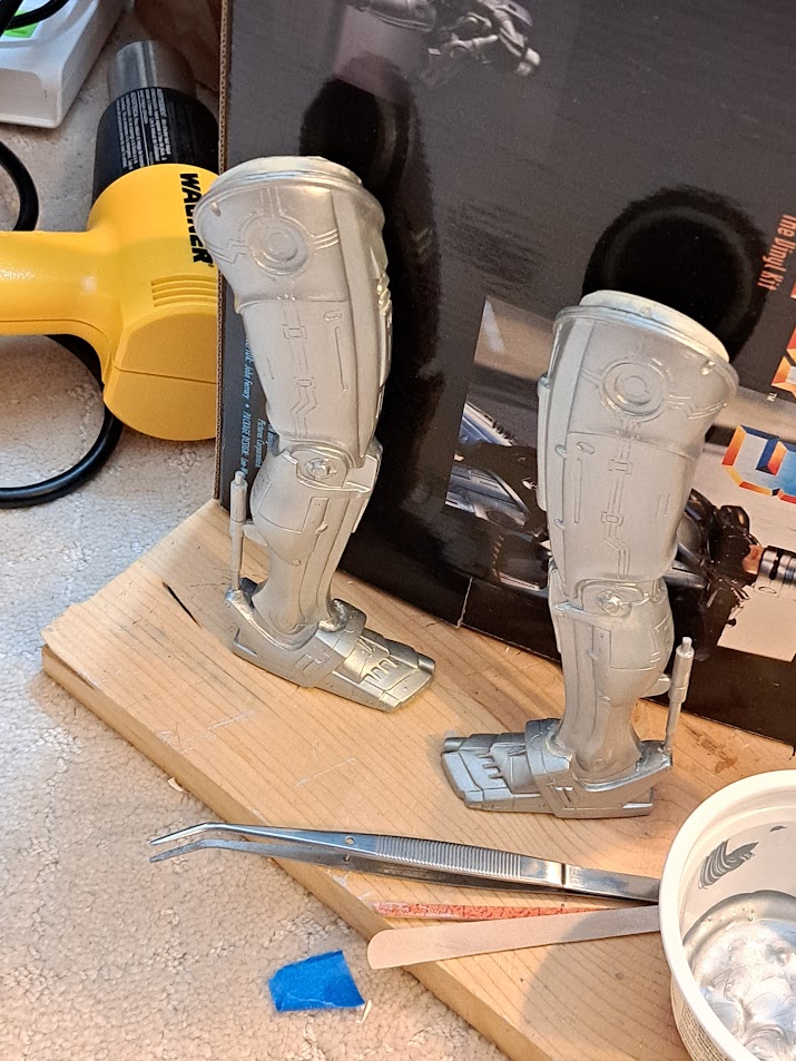

Doing more tests- the DecoArt silver is so much richer looking than the Liquitex, but painting tape tests show significant lifting whereas the Liquitex stays on perfectly. Next test was painting DecoArt silver over Liquitex (using the Liquitex as a primer, as it were) & SUCCESS! No lifting. This tells me the Liquitex has more bonding properties while the DecoArt has more silver particles. Perfect blend.

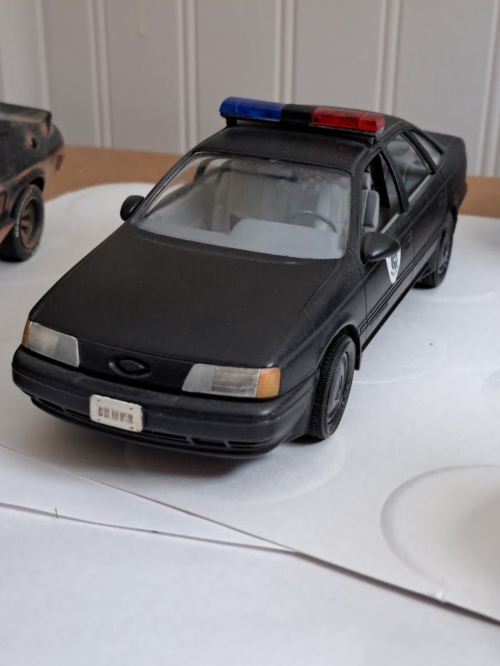

And before I get to painting, look what I found in a box- a modified AMT RoboCop 2 car kit made to look like the cars from 3 that I did a decade ago... :p Edit: I have no recollection why I left the interior white....

With the decoart: give that at least 48 hours before trying to lift tape from it. It takes twice as long as flat acrylic paint to adhere properly. You can also hit it with a hair dryer on low heat for a minute or two, but be careful of the vinyl.

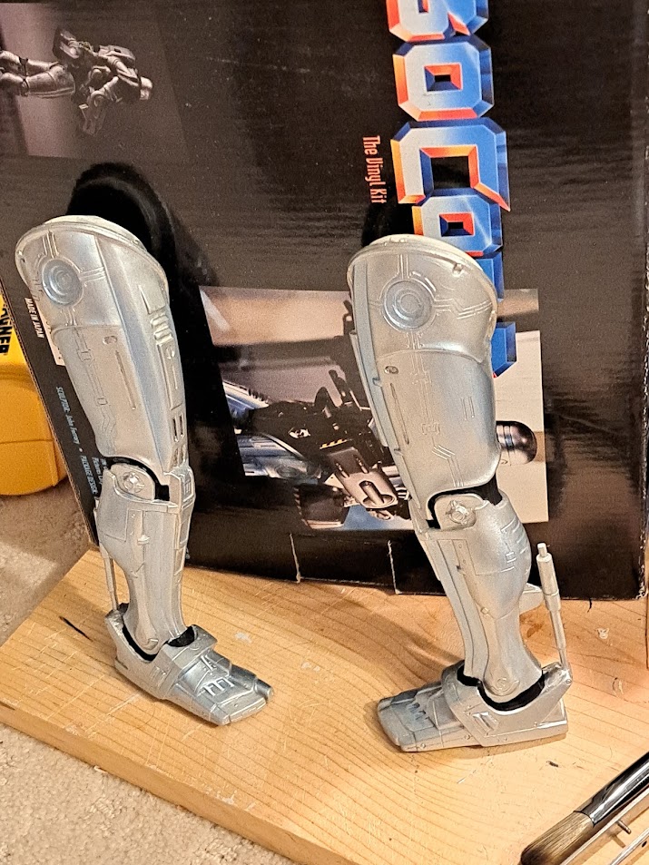

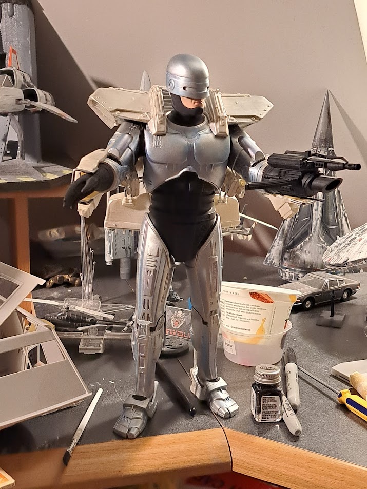

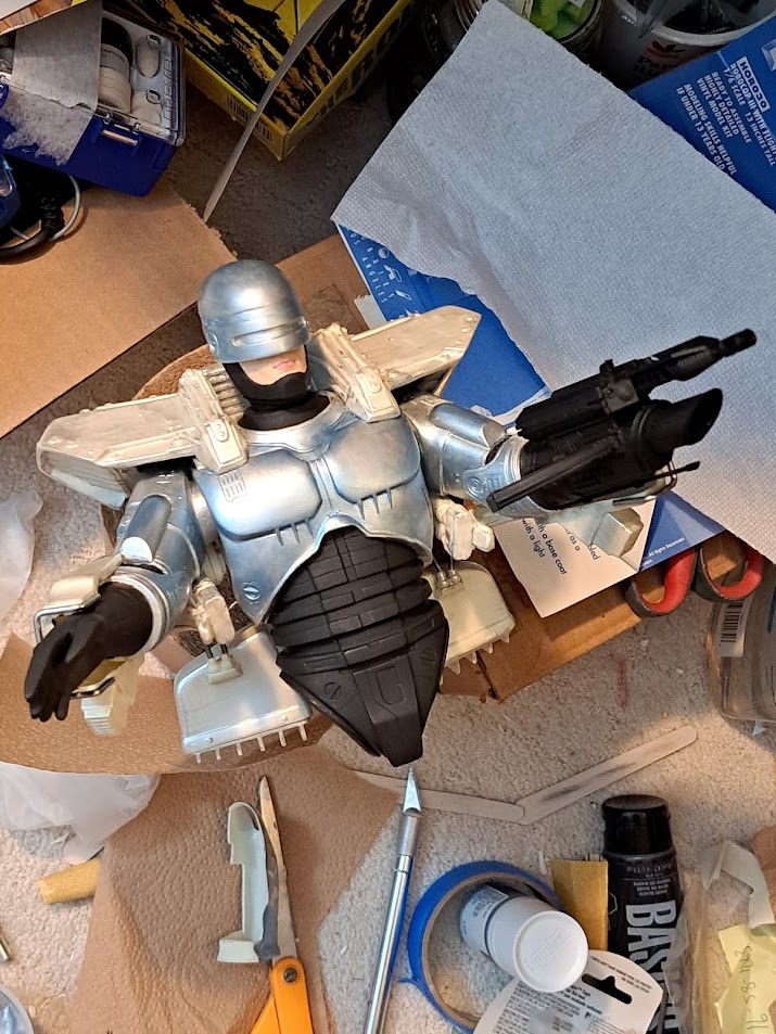

Got a proper base silver on with just a tiny bit of metallic blue added. After it dries I'll be adding light washes of blue & purple. The flight pack will be light gray. Also need to wash some dark gray into all those recesses of his...
In the pic it looks like the perfect amount of iridescence, and hitting it with subsequent layers of topcoats until you find your desired sweet spot sounds like the cherry-on-top! BTW your brush-work is coming out very clean. Man, after all of the earlier frustration I’m glad the paint is working for you! (y)

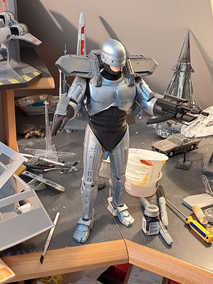

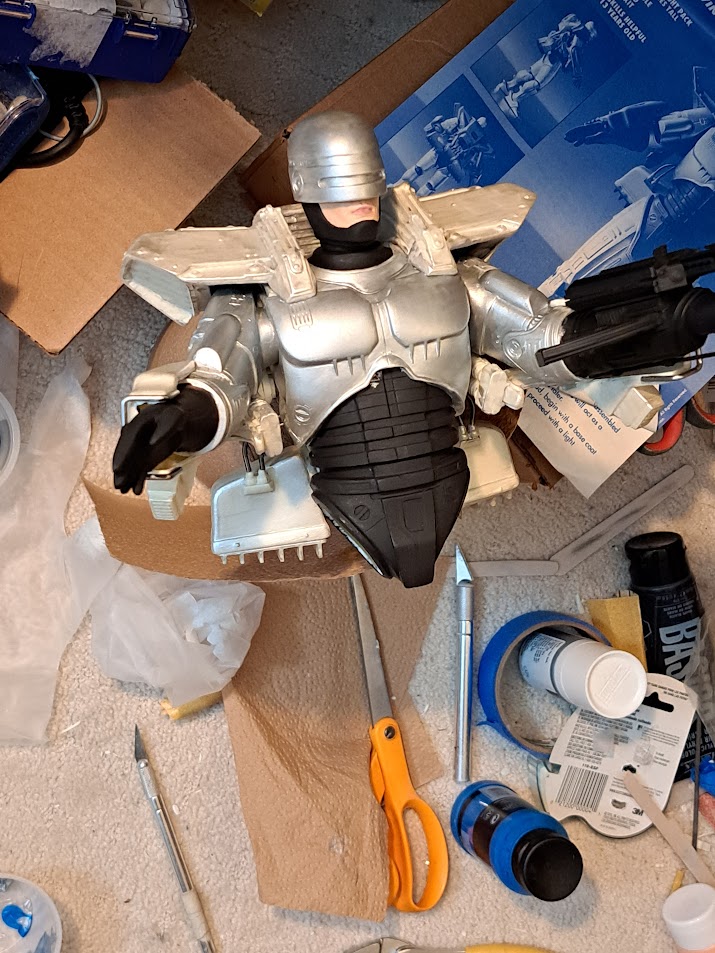

Unexpected progress: I had a thought: what if I mixed the Liquitex silver with the DecoArt metallic blue? I did a test on part of a leg, then just kept going. It was so translucent, but just a bit blu-ing.

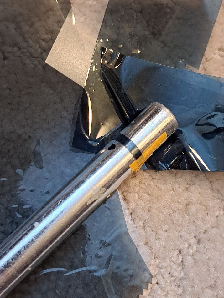

I'm basically done painting him, so I stuck window tint on the inside of clear sheet styrene cut to visor dimensions & taped around an x-acto knife handle to curve it slightly while he dries. Yeah, I coulda just painted his visor in, but I'm hoping this gives it a slight, if only subconscious, 3D appearance. Next is the Future wash. That will take a couple hours to dry, but I don't wanna handle him until tomorrow. When I get home from work I'll glue in the visor insert & post finished pictures!
