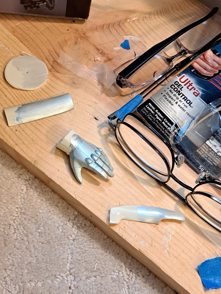

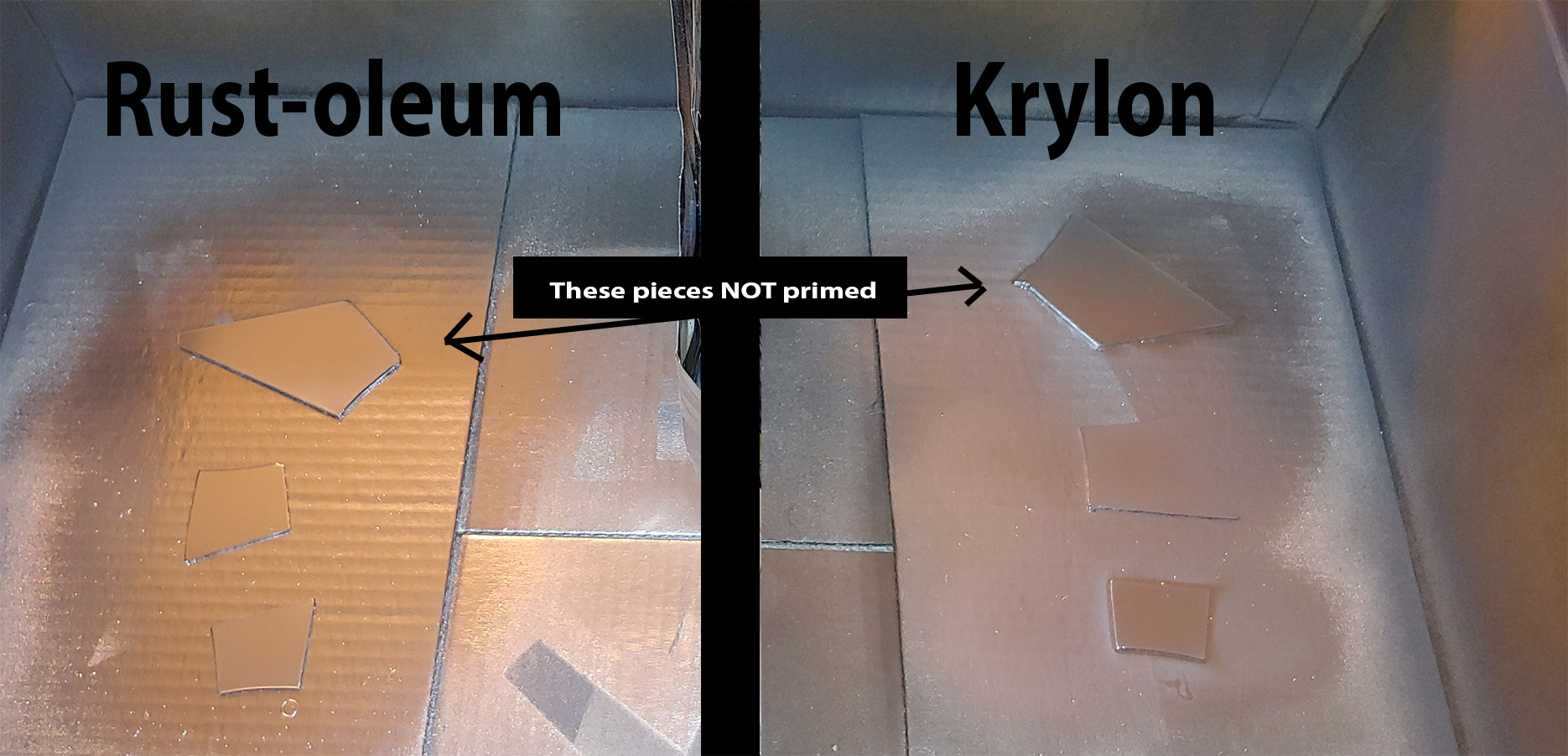

More paint tests: Yes, the paint without priming doesn't pass the light fingernail scrape test. It needs priming.
Foreground: Krylon paint & primer (you know, the all-in-one deal) on scrap vinyl flash. After 20 minutes it feels vaguely tacky, as I expected.
Background: Krylon primer only. After 20 minutes it feels bone dry. This is the way to go.
A decade or more ago I made the Horizon Robo kit (didn't wash the parts, just wiped them a bit) and simply painted it with basic tube acrylics & it came out well except that it always felt sort of tacky. I even talcum powered it, and it just never felt completely dry. I ultimately gave it away.
Today I'm more aware of what I'm doing. Always do tests first! And WASH PARTS!
My tests conclude: while the Krylon primer adheres to the vinyl very well, the acrylic actually adheres to the vinyl a little bit better than the primed vinyl(!).

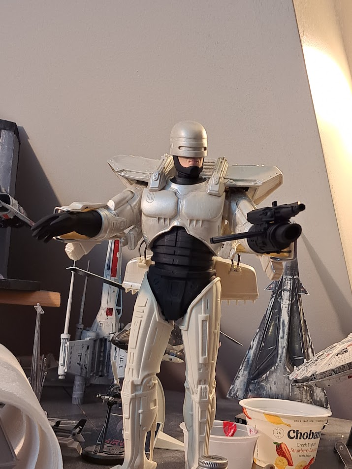

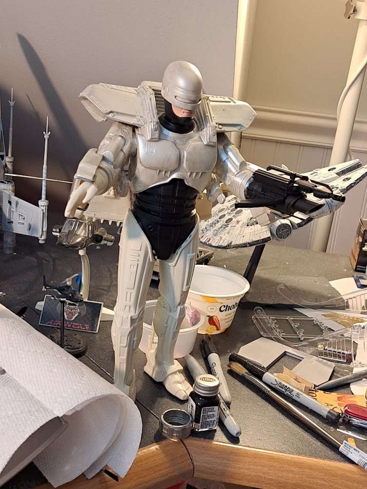

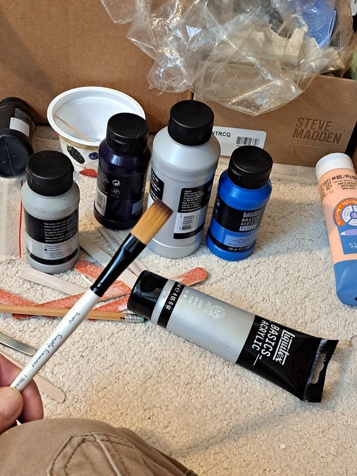

So first step, wash the entire figure as it's no doubt covered in trace finger oils after the assembly. While he's drying I'm setting up the paints. Tube silver will be the base coat after I paint the flesh colour on the face. Then liquid acrylic for the highlights. A super soft flat brush is essential, so I just rushed out to Michael's and got one. Needless to say I'll be washing my hands constantly during the different paint times. After it's done I'll coat the entire mess with Future for protection & shine (except the mouth area). This will take at least 2-3 days....

I ended up having to stop and do some tests, all with spray, between the 2 brands, and primed or not primed.
I believe, (without looking up the whole thread) I ended up not priming, but can't remember what brand I went with.
One of them actually beaded up over the primer.

Meow! It’s looking amazing btw. Some of the best work I’ve ever seen has been brush work when the time is spent doing it slowly and with the proper care, and it appears that‘s what you’re going to do with the cop’er here! Oooh… teasing such chromatic iridescence on the hand earlier! The modifications you’ve done so far really make a huge difference. The visor upgrade was spot-on but that lip! Don’t give me no lip! haha ;)
I found when doing metallics, it's actually better to "black-base" it as the black makes the metallic color pop much better. That said, yours looks good so far.
I tested that with the primer- this acrylic silver isn't opaque, so a black base would mean almost double the coats I'll be giving this guy would be necessary. In general though, it's a good rule of thumb.
True; I tend to use apple barrel acrylics "silver anniversary" and that tends to have good opacity.

Okay, as RoboCop would say, This is a bust!

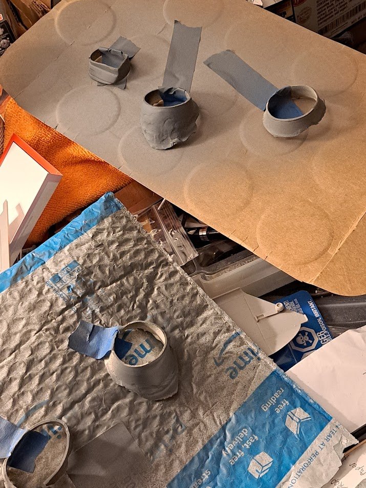

Way too far out of my comfort zone now. You can't paint a vinyl model in pieces & then assemble it later. And now I find I can't paint over mistakes with this totally useless acrylic silver paint. It's just translucent garbage (ha, and it says 'opaque' on the container).
BUT The test pieces done with paint & primer in one are now bone dry, to my utter surprise. Wow.
SO, I'm Gonna sand Robo some to get rid of some brush strokes, then blast it with Krylon gray paint & primer, let it cure for a few days until bone dry, then hit it with aluminum Krylon or Rustoleum & finish it off like a regular model with mostly enamels & stuff.
Want to see if I can salvage this mess....
