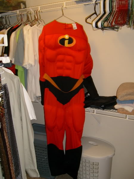

I bought a Mr. Incredible suit to form the base of my suit, but I thought I might caution anyone looking at this option:
The large standard adult Mr. I suit is for someone 5'9" to 5'11" tall. I am 6'4" barefoot and weigh 240lbs. The "belt" stitched onto the suit comes just under my ribs. This means the abdominal muscles in the suit will end a bit above the waistline. We'll see how it looks after latexing and painting it.

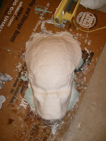

Plus, it's a little off in shape anyway. So I am going to duplicate it in pourable sculpting clay and reshape it, then recast in a lightweight resin or something.
Here is the creating of the negative from the existing bio (letting the plaster backing settle)
Here is the Mr. Incredible suit that will be latexed once I get the duct tape dummy finished (try to do that this weekend.) The latex pigments will be here Monday or Tuesday so I can tint the latex and get rolling on that part too.

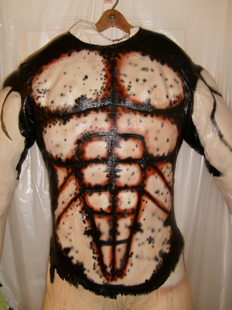

Making some progress on this suit...I haven't used an airbrush in probably 15 years so I gotta cut myself a little slack. Big difference between painting a car and airbrushing a latex suit.

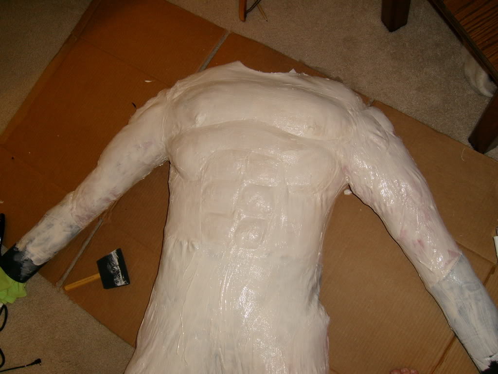

Here is the Mr. Incredible suit latexed (mostly...lower leg still to do)
Here is the paint progress so far...what do you guys think of the coloring/pattern?
It's kinda random spots and stuff, nowhere near the quality I have seen on many of the suits here but I'm also rushing to get done.
The Mr. I suit stitching is a touch off center too, so that throws me off a little. The next version will be a true sculpted suit once I get a lifecast of myself (after I drop 20-30 lbs off the middle).

I used a brush for most of it...I started off trying to spray it, but even the light overspray was getting on everything. I do not have a shop area...I'm doing all this in my apartment so I'm a bit more limited in capacity.
The brush left streaks in it and I couldn't seem to avoid it. I used a roller for some sections which gave an interesting texture, but just ended up finishing with the brush. I'm sure there is a better and easier way, but this was my first try.
One of the hardest things to deal with when doing the suit was latex sticking to itself. any areas that folded over would stick, both on the inside and outside. The mannequin I was using at first was standing with the arms down to the side and feet closer together. I ended up taking it off that and stuffing it with anything I could find to place it in a "spread eagle" form so I could get to the armpits and crotch areas without everything sticking together so bad.
The suit is baggy on me in certain areas but since I am working by myself I couldn't take up the slack. If I knew someone who could sew, I would have had them fold the areas with slack up in the back or inside of the legs and then stitch it up. Once the latex was on you wouldn't really see the work.

Thanks TMI...I've been really blown away by the quality of your paint work. Once I get this project past the Halloween stage and can slow down I really want to take some time with the airbrush and get better control.

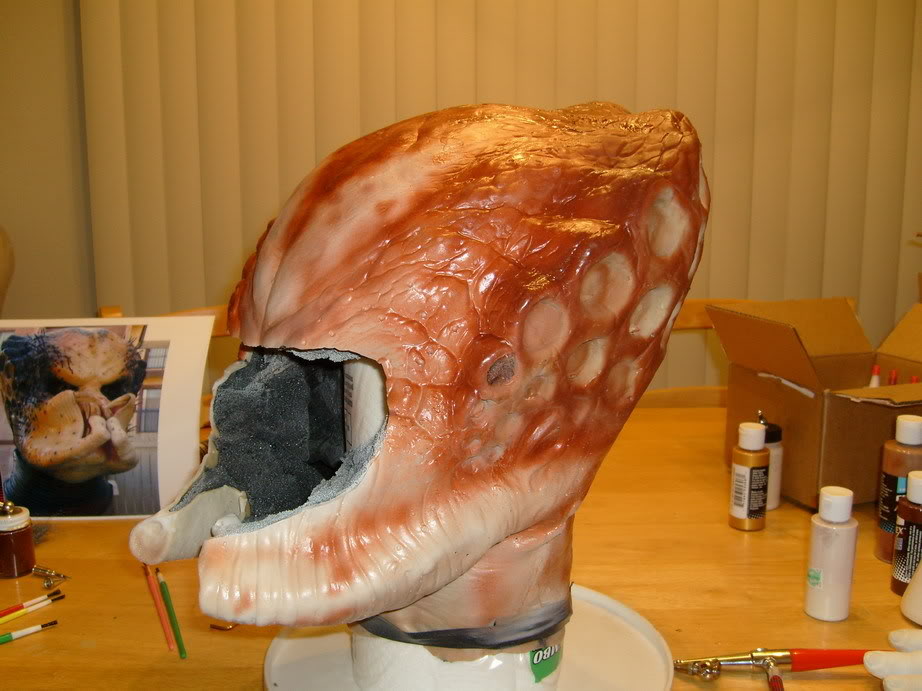

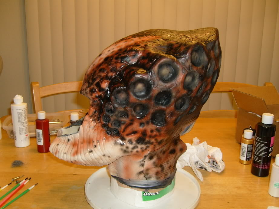

I got the undermask from Seahunterr yesterday and got a chance to paint it up with the reddish-black color scheme I'm using.
Let me know what you guys think.

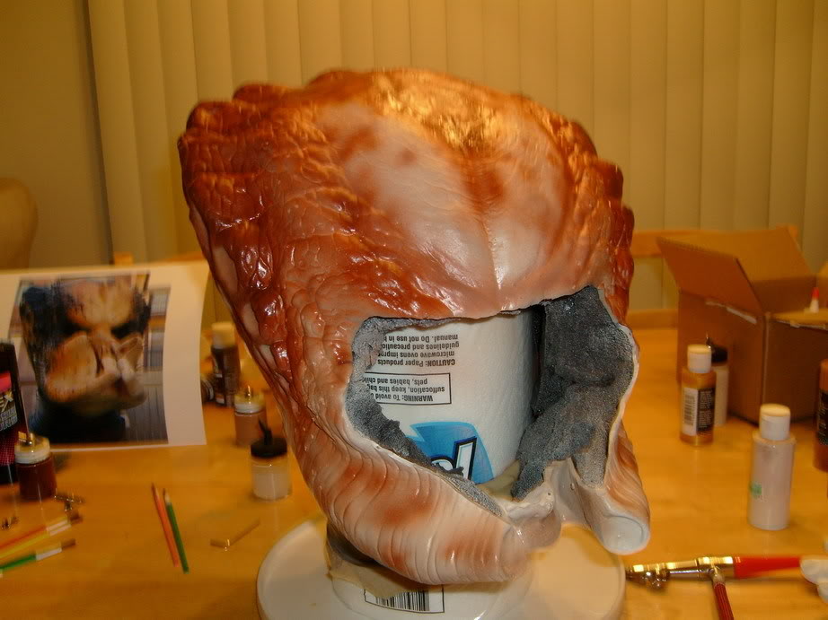

This was after the base color and the brown

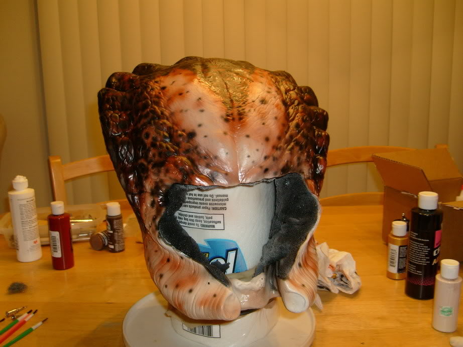

After the black spots...ready for a clear coat and then the dreads. Gotta get some magnets for the bio also.

Um wow I thought I would never see someone cut the face out of a DB P1 in my life but you took that leap, lol. But seriously everthing looks to bo going good so far, will be waiting for more.

It had some casting imperfections in that area so I got it at a really good price...
Since this is mainly for a Halloween party I can pop the bio off and talk to people (and eat/drink).
When time and $$ permit (and my painting skill is better) I'm sure I'll upgrade to a full mask.

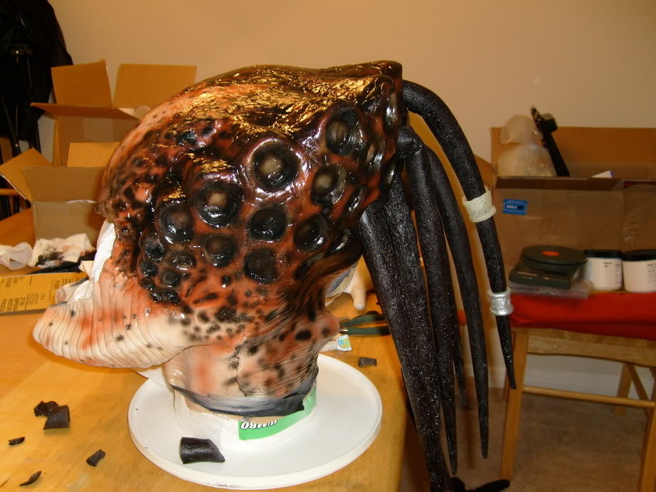

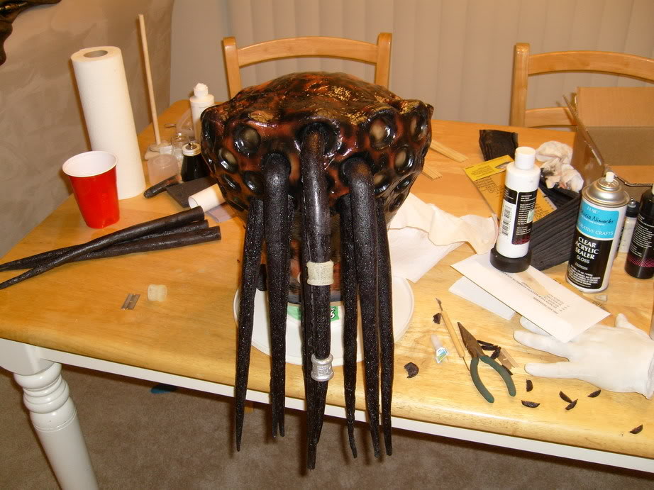

Started adding dreads after clearing the mask....till I ran out of super glue.
gonna try and finish the dreads tomorrow night. I just shaped 3 basic dread rings and cast some in resin...I think they may be a little thick. I need to mold and cast some better ones...more like the P1 rings.
I cut a series of small wedges out of the dreads near the mount point and glued them in a bit of a curve so they would turn downward easier.
Opinions and criticism welcome.
