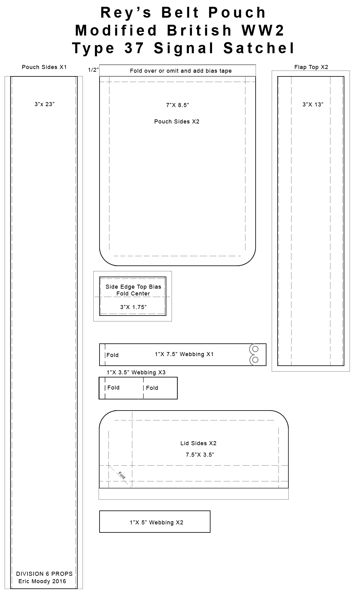

Pack size is about 14" H x 11" W x 3" D.
I just marked off on the leather and cut.
You will have to add enough to the back piece to include the flap.

Pack is same as noted above.(you might want to add 1/2" to the side to compensate for the sewn edge)
Side pockets for the 2 sticks is 5.5" H , 4 " from top edge.
Once it reaches the face it's 2" with a space of 1.5" from top of side panel pockets and 2.25" from the bottom edge. should end 4.25" from edge.
Flap (part of the back panel) goes over the top (add 3") then down the face 7".
Band on flap starts 2" down on the back side top of the pack and extends 1.5" past the bottom of flap.
The corresponding strap on the face starts 2.5" from bottom. (length 7+ inches)
Both straps start 2.75" from right edge. and are 2" wide (2 pieces for leather)
Webbing is Type 37 tan 1".
Side canister webbing is scrap from the Enfield sling.
The shoulder straps are 1.25" wide, length at least 29" (+ 3" each end) so 35"
I made mine longer then figured out how it should sit properly then cut, I would suggest doing it that way to adjust for your body type.
I made the shoulder strap loops on the back at 1.5" (3") but found pictures afterword that showed them to be longer.
These are angled at about 30 degrees
The strap on the bottom of the pack is 1" wide and 11" long +1.5" for the loop holding the rings.
Bottom cup is 2.5" x 2.5"
The band on the shoulder strap holding the chained canister 1 7/8" at center and is shaped like and S.

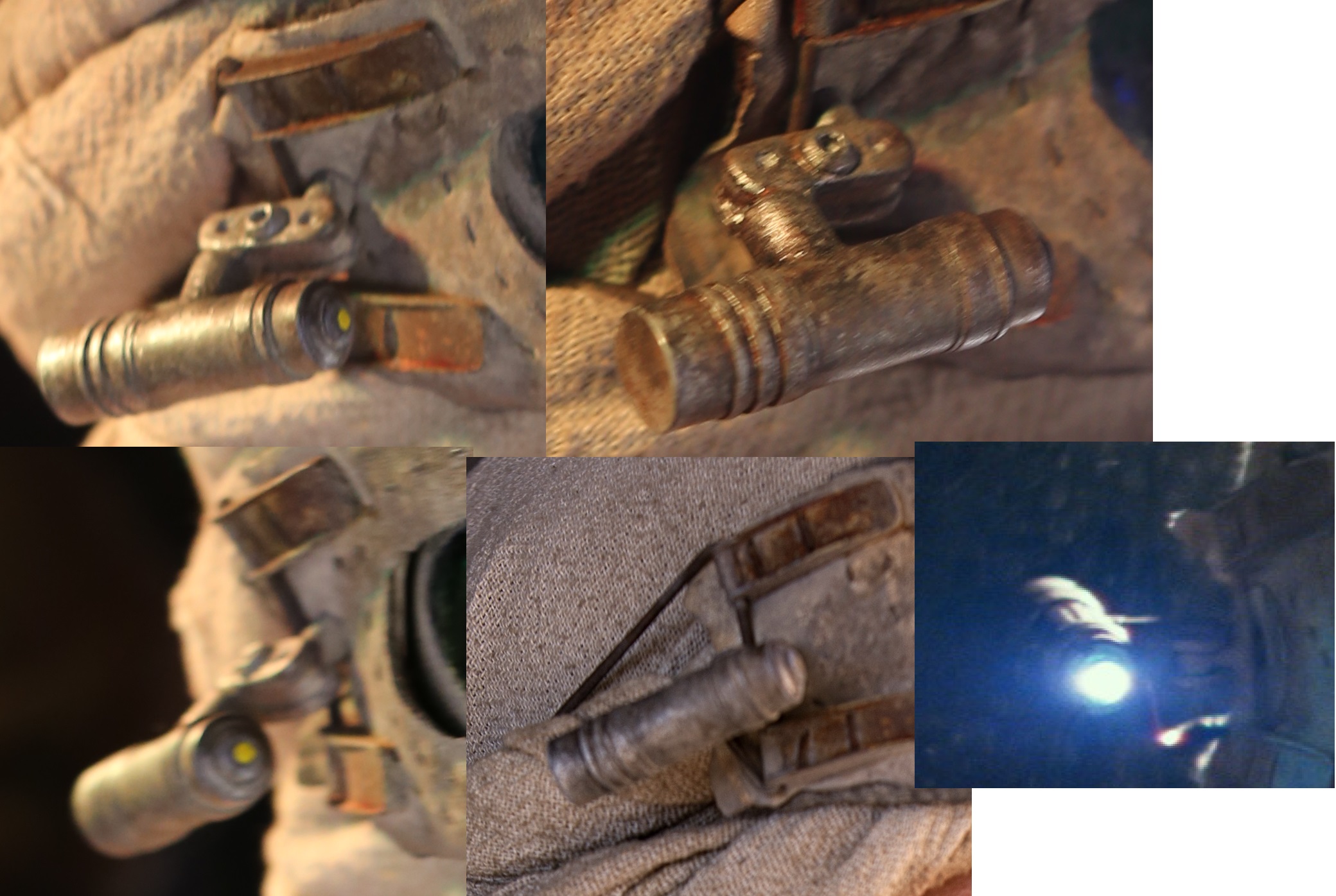

Im not convinced the Goggle Light on the traveling suit at CVII was the functioning one...perhaps the goggles werent the hero goggles?
If you look at the functioning one in the film...it has a groove lengthwise...which is not there on the CVII piece. Also the bracket made from the helping hand...looks fake on the CVII piece...possibly a cast/3D printed piece?
The D23 display had the Hero light not C7.
Notice the front lens and the metal (open armature) and the large washer to keep it from flopping around.
Thats great! All the pices i found had the light facing the other way...
More I look at it the more i think they removed the shroud from the front of a flashlight/torch...Im searching image after image...and I think thats the case....on google.com and .uk since they typically use british stuff

But unfortunately I wasn’t able to figure out, yet what the 4 side clips of the goggles are made of.
And I would like to know what kind of metal tubule is suitable to build the rangefinder.

The clips are unknown but one person used copper I think I remember and cut it out then bent it.
Don't think anyone's nailed down what to use as far as an accurate piece for the light. Or rangefinder as you called it. It's for sure an LED light but no ones figured out where to get one just like it.

I actually do have a LED light in the right shape and size. But it's black and I would like to wrap it with something more "tin like" to make it look more original.
