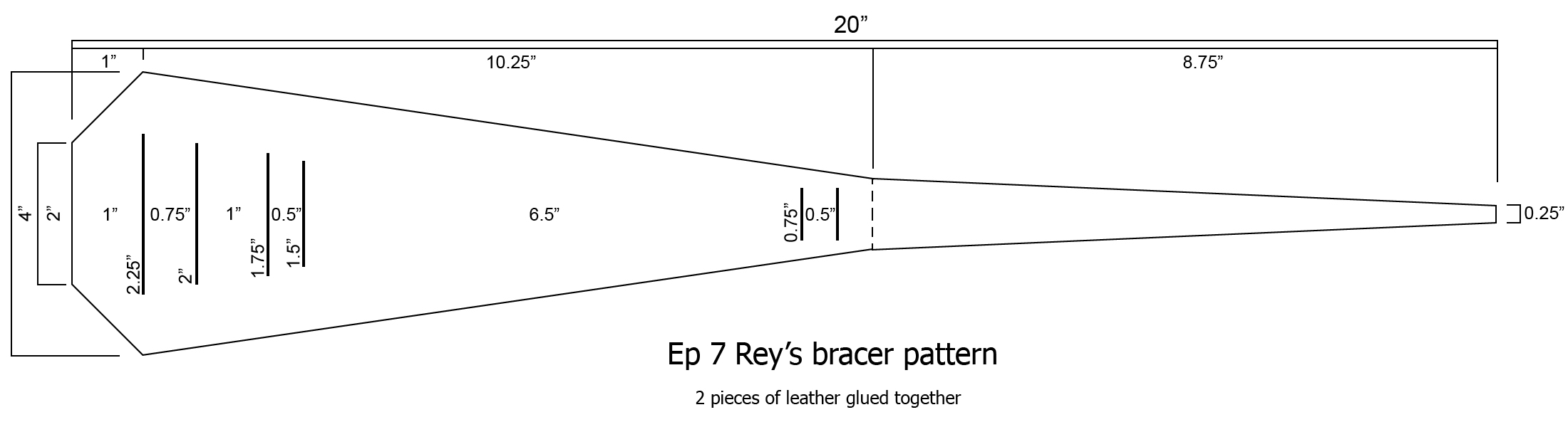

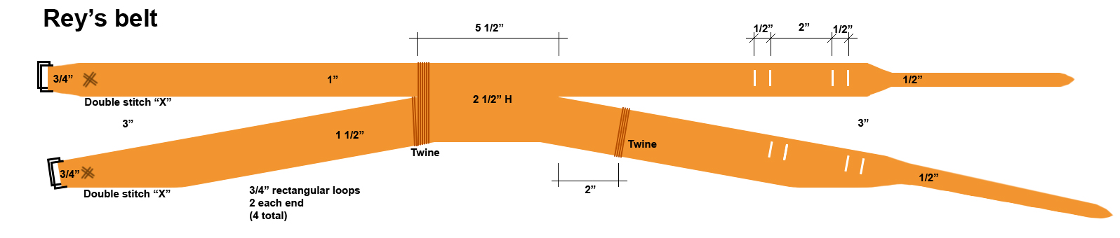

Patterns for the belt and wrist piece.
Also, anyone here in the states have some left over leather for those 2 pieces?
Ive been striking out finding any locally.
Let me know if we can make something happen.
Thanks everyone for all that's been contributed to this thread.
Im blown away by everyone's progress.
You will probably have to alter the lengths to fit your figure.

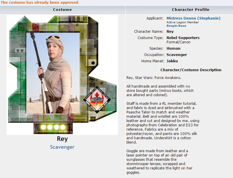

Just wanted to pop in and say thanks again to EVERYONE who has contributed to this thread over the months, because all of that research, suggestions, sourcing and details...this just in today!!! :-D (I'm not stoked, and definitely not careening around in little circles making weird noises). Nope.
You guys rock!
Very awesome, congrats!!!!
I'm also aiming for RL :) How long did it take for the approval to come back?
Overall, about a month and a half. I was asked to make a couple changes, so they'll give you great feedback, and then plenty of time to comply. It's a really smooth process, but it does take a while. My liason also mentioned that they had a LOT of Rey's on the table, so understandably, the wait time was longer. The initial estimate for first review was 10-14 days. But it's worth the wait. :)

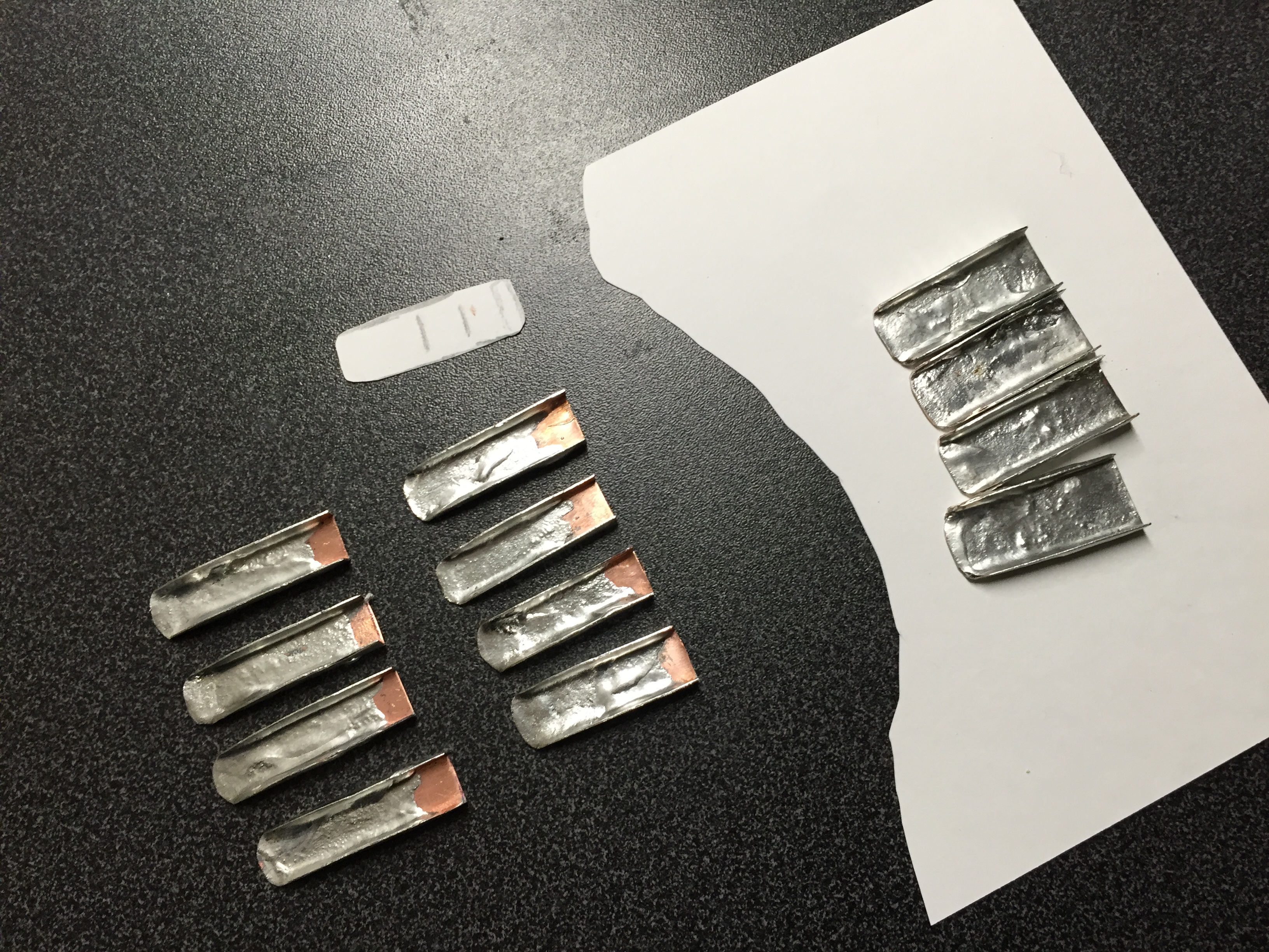

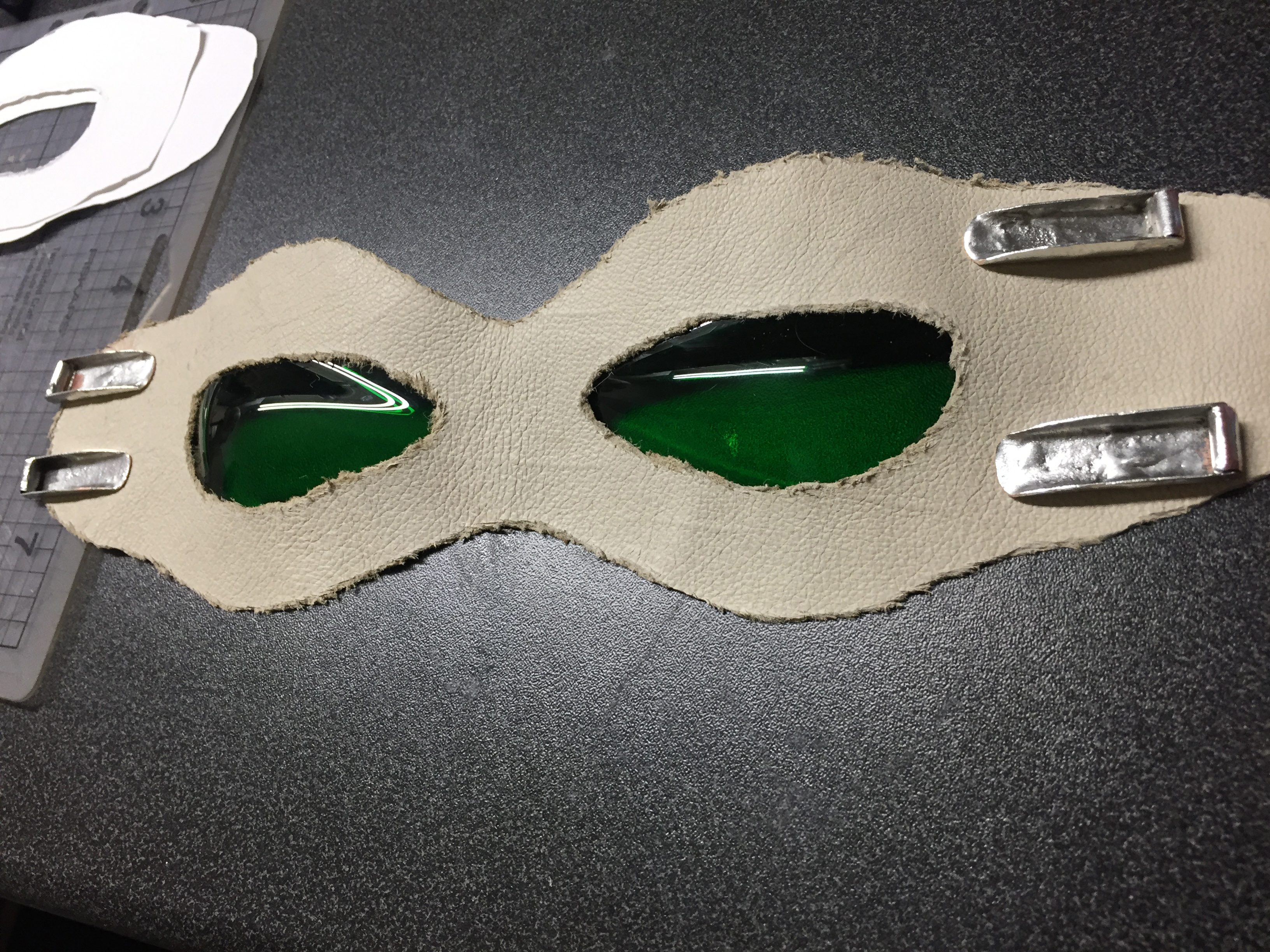

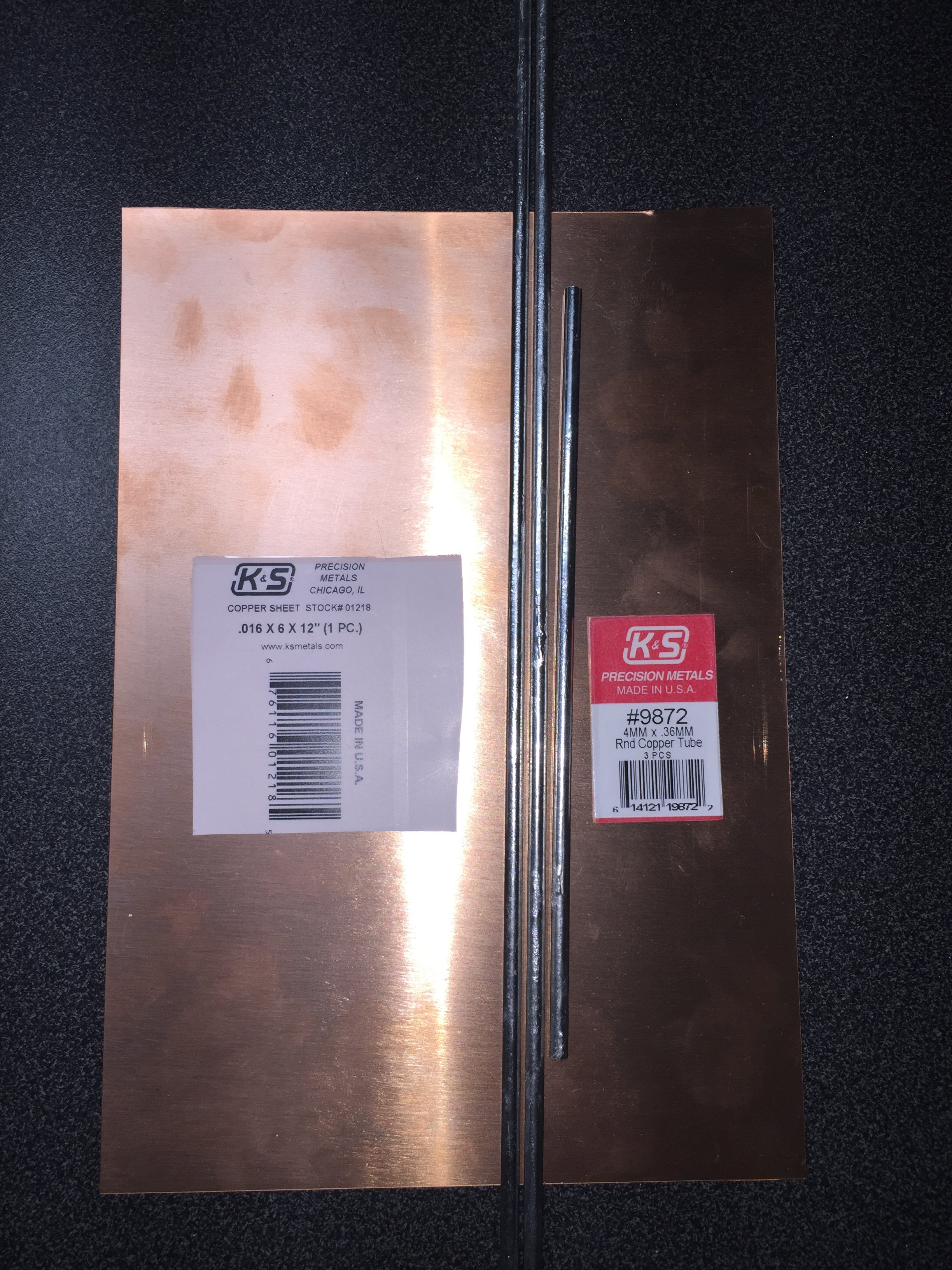

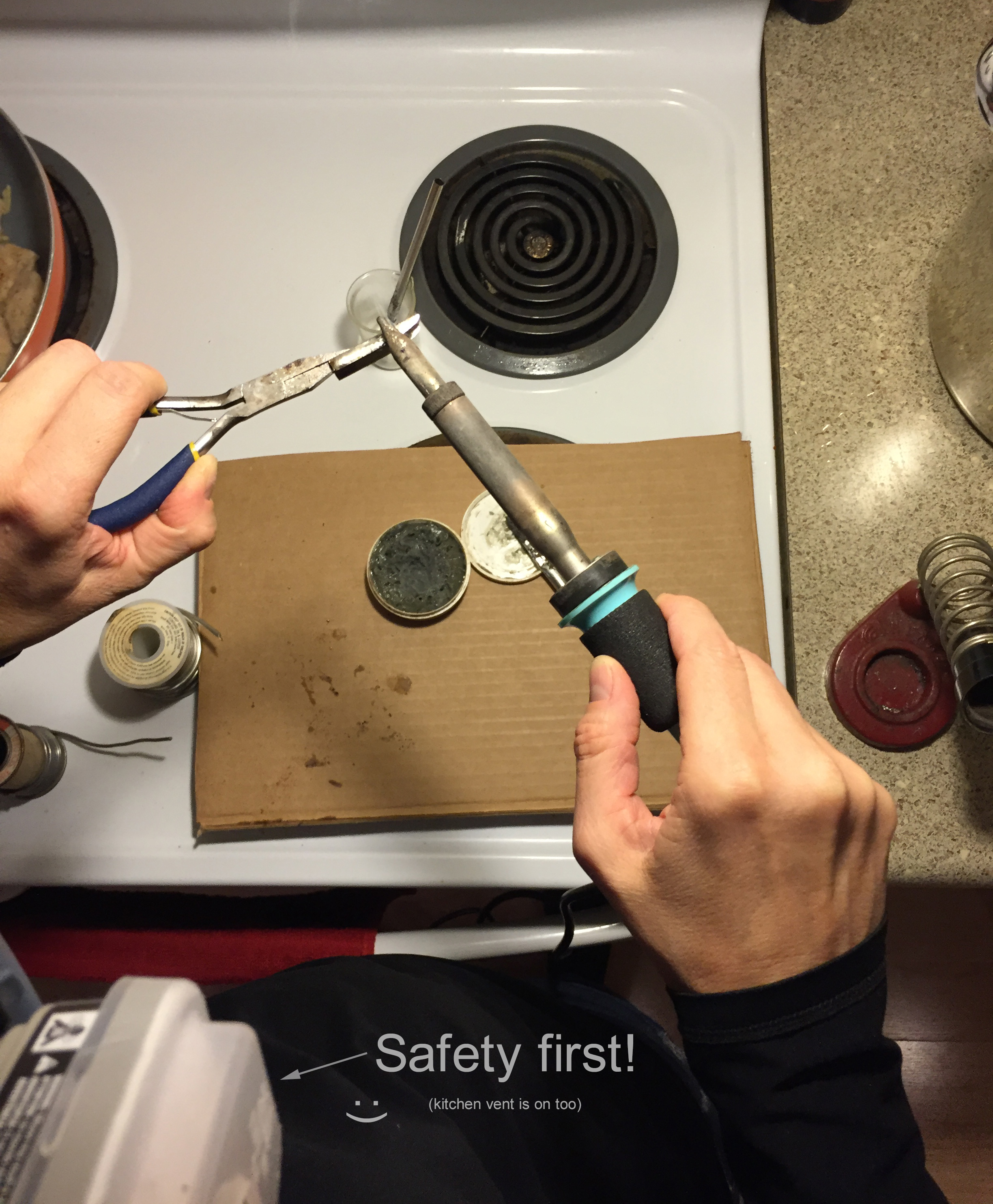

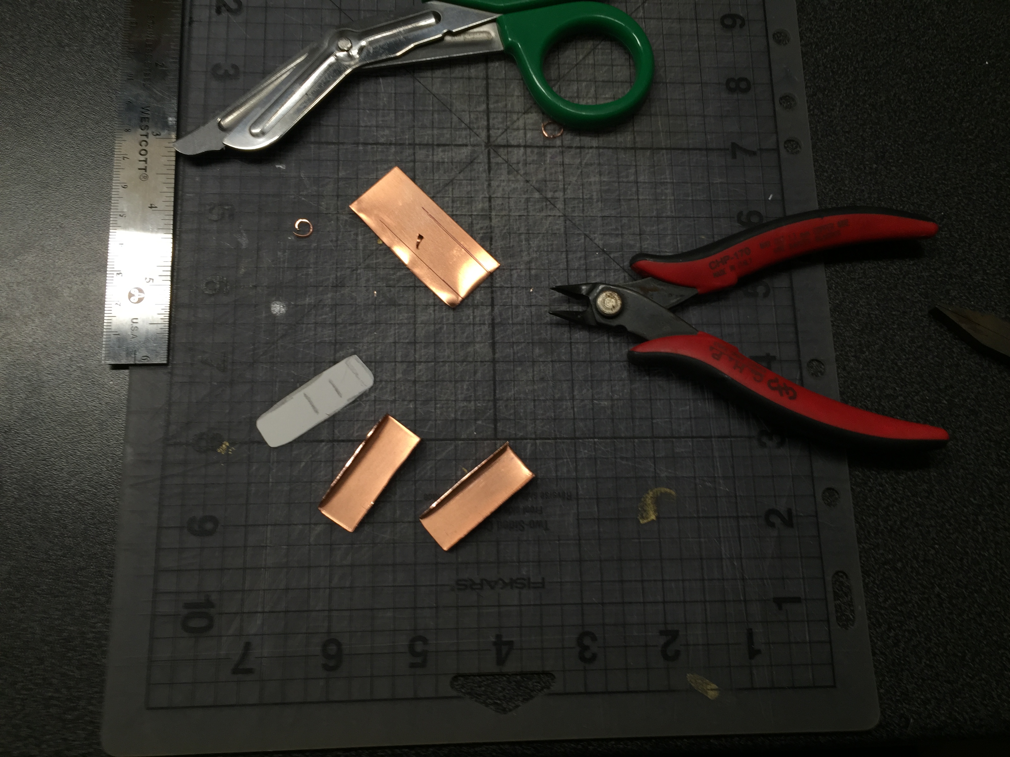

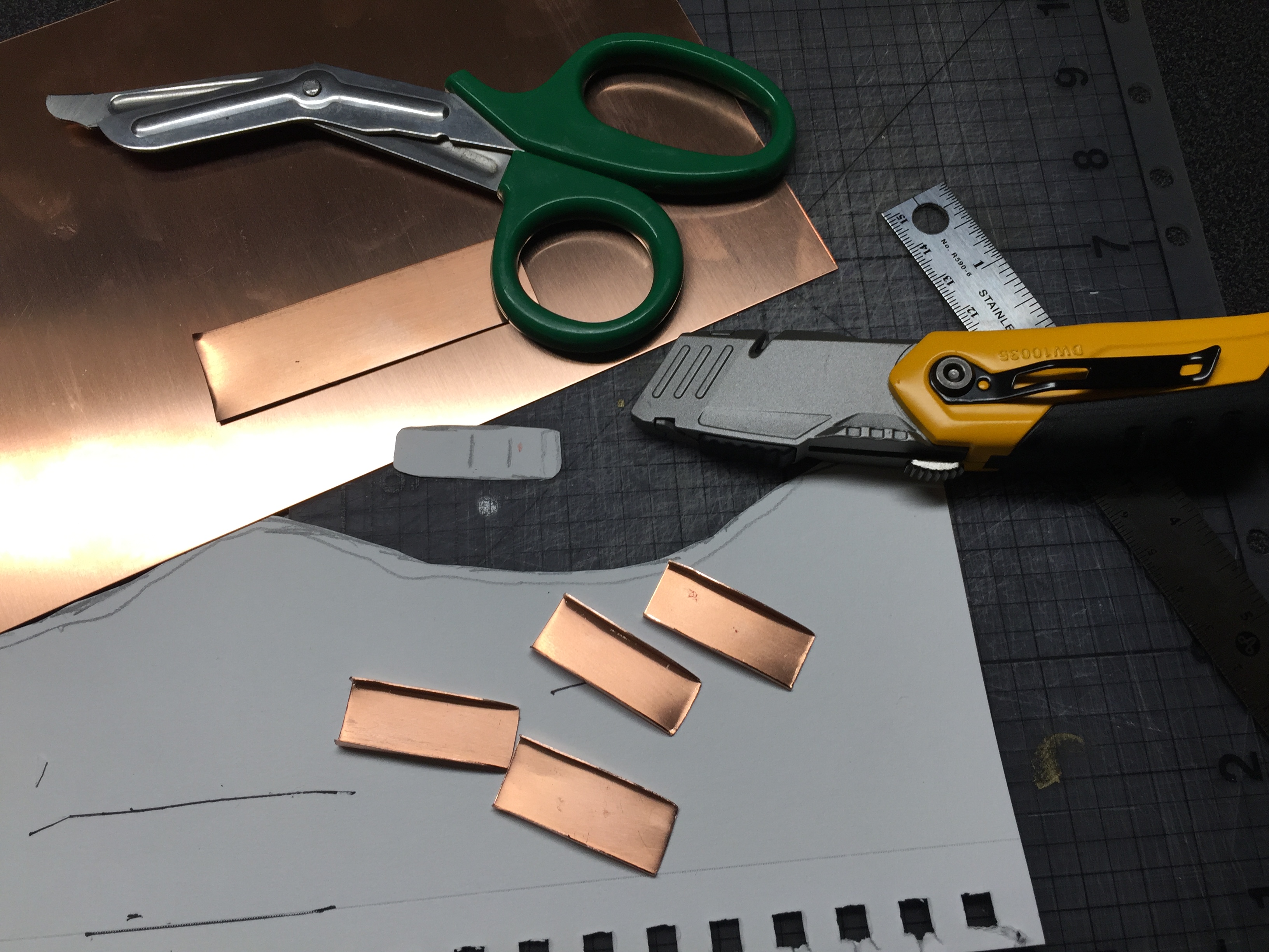

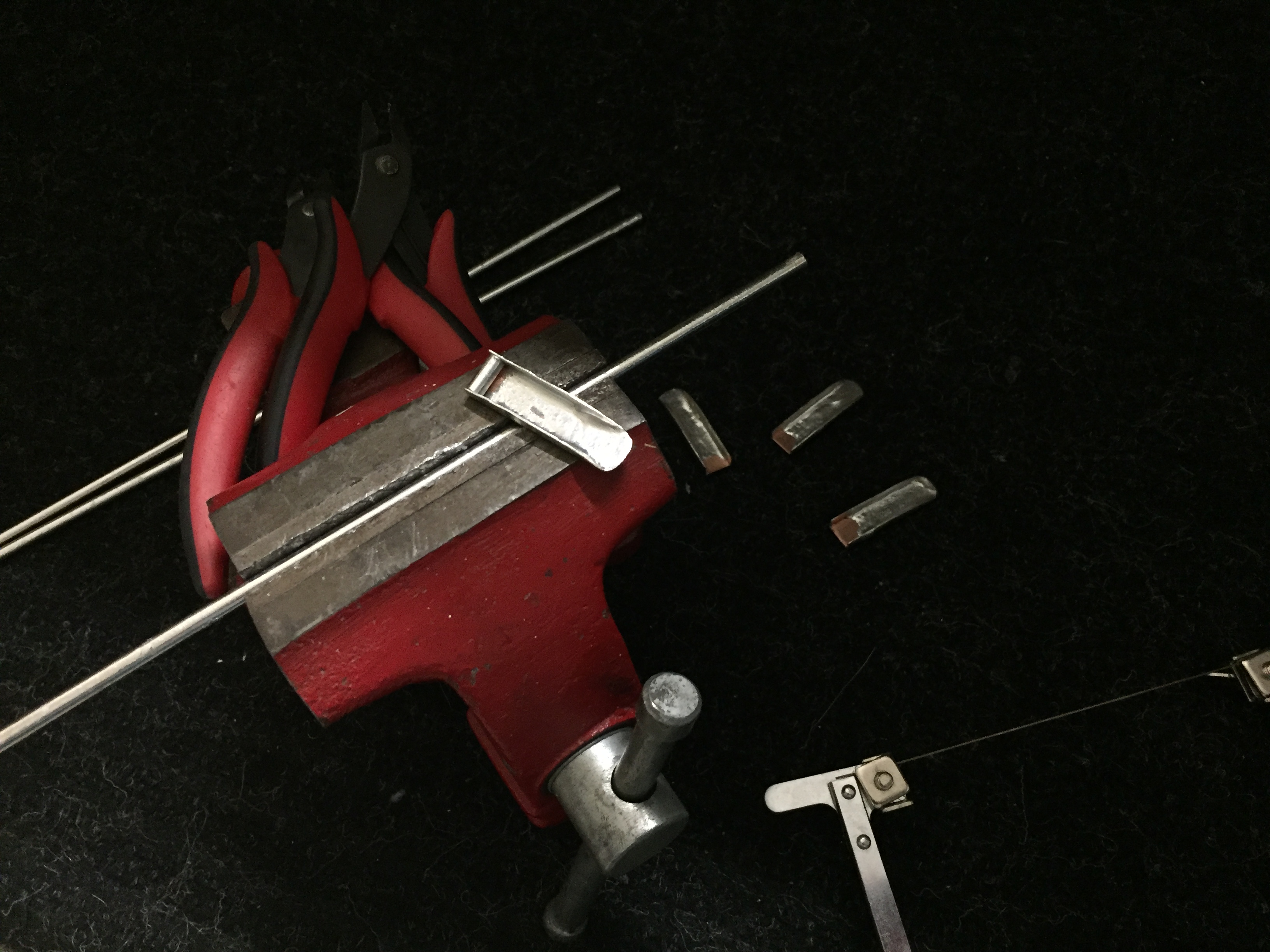

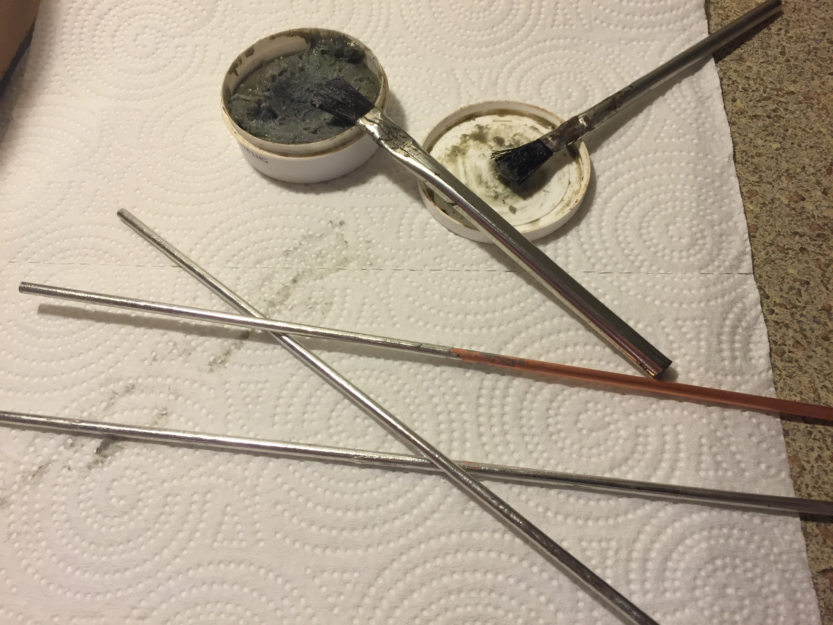

I thought I'd share my progress on making the goggles. I have a background in stained glass and soldering, so I thought it would be pretty easy to make the goggle side clips out of copper sheet and copper tubing. (Easily available at the hardware store). Copper doesn't require as much heat as other metals and is therefore easy to solder. It's also easy to bend and manipulate.

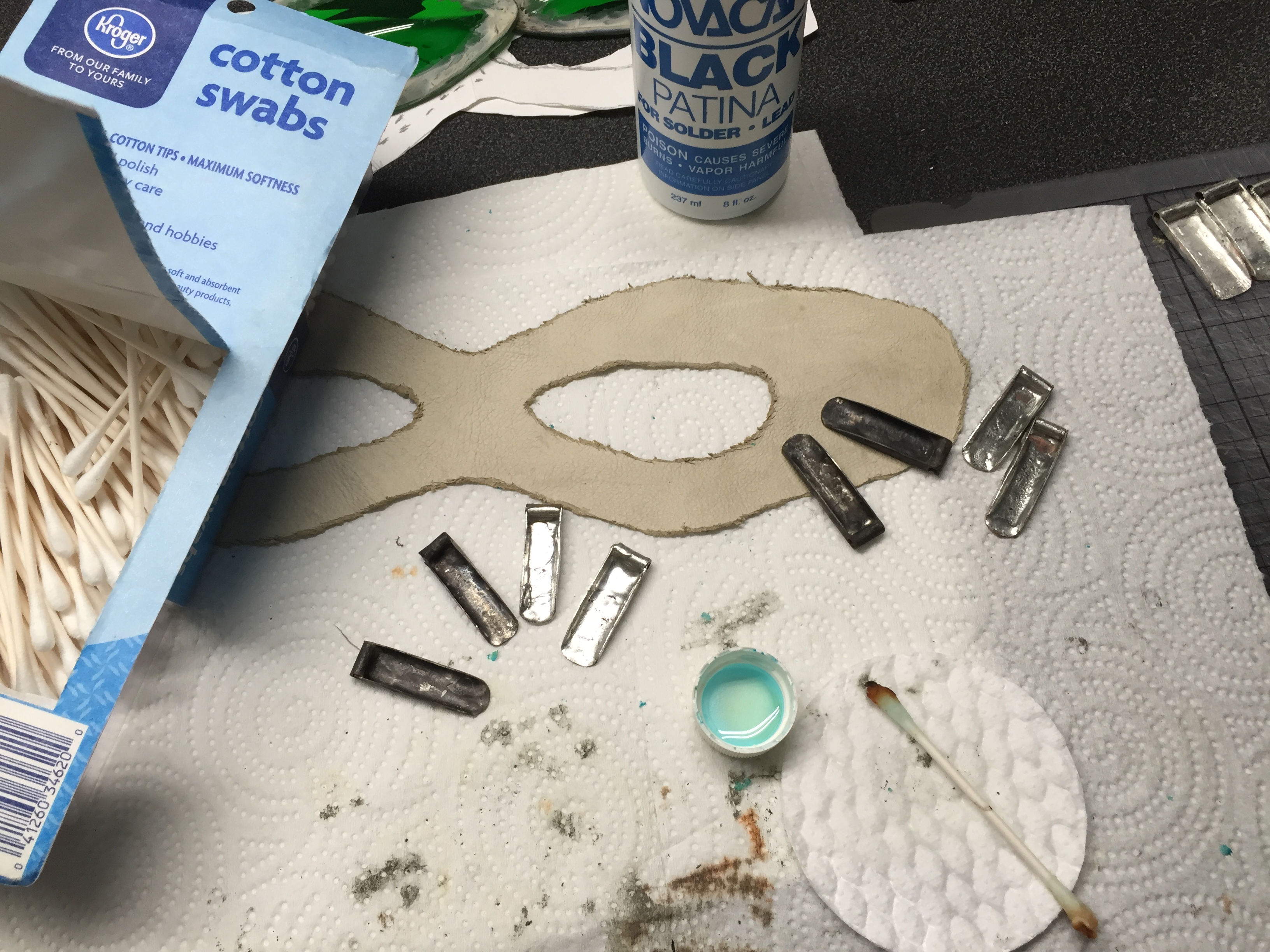

Once the copper is soldered (or tinned), you can easily apply patina's to create the desired color or effect. (In this case, darker and weathered/rough.
I still need to drill holes for the thread, and may still apply some additional weathering.
I'm not sure how many people are making the goggles and what they are using, but if there seemed to be an interest, I may make a few more with the left over copper I have.
Hope this helps spark some creative ideas. :)
