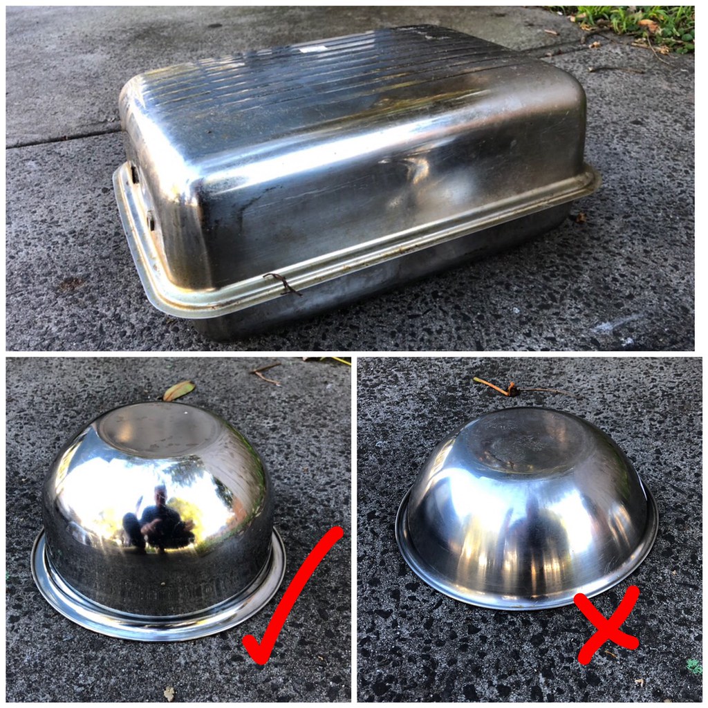

Ok, so the first Op shop i walk into has my baking pan with matching lid-for $4. Winning.
Got a couple of metal bowls for the top. One has a better shape than the other so i will be using the "longer" one and not the dome one.

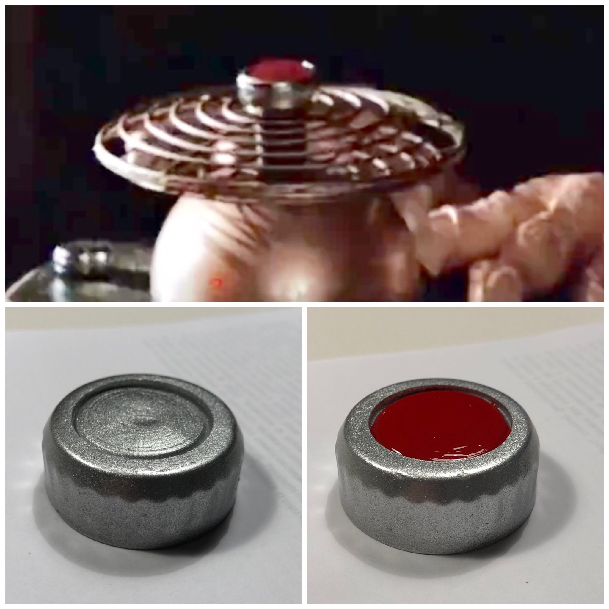

Iv been gathering bits and pieces. I bought an aluminium chair leg from the hardware store. Screw in base and the top can be cut to size also with a screw in fitting. I will sleeve the vacuum cleaner pipe over this chair leg. Deep frying ladle for the top which i will chop to size. A spring for the peddles and a couple of plastic caps for the front knobs. For the top nobs i will custom make my own as they are quite clear in screen shots and i cannot find anything off the shelf to match.

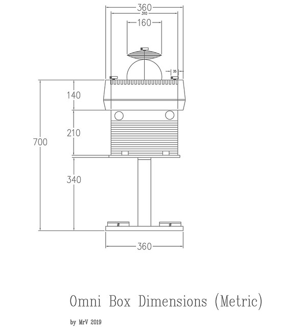

Thought i would try to scale up this thing to get some sort of accuracy. I will do a scale drawing this week.
I cast some knobs from my kids drink bottle. Basic resin mix with a bolt inserted so i can attach them through the baking tray.

Got the scale drawing completed today. I think it looks reasonably proportionate...
