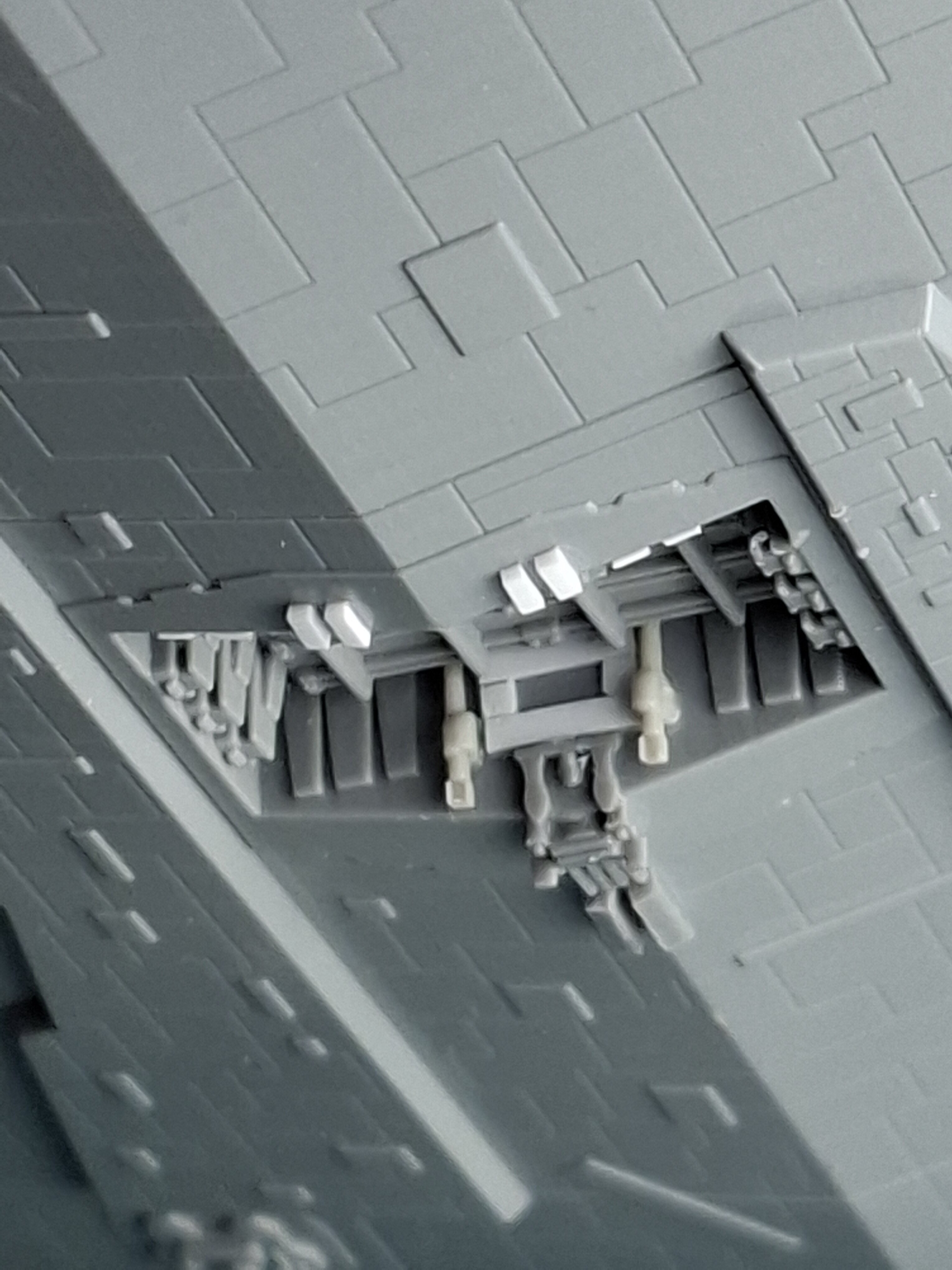

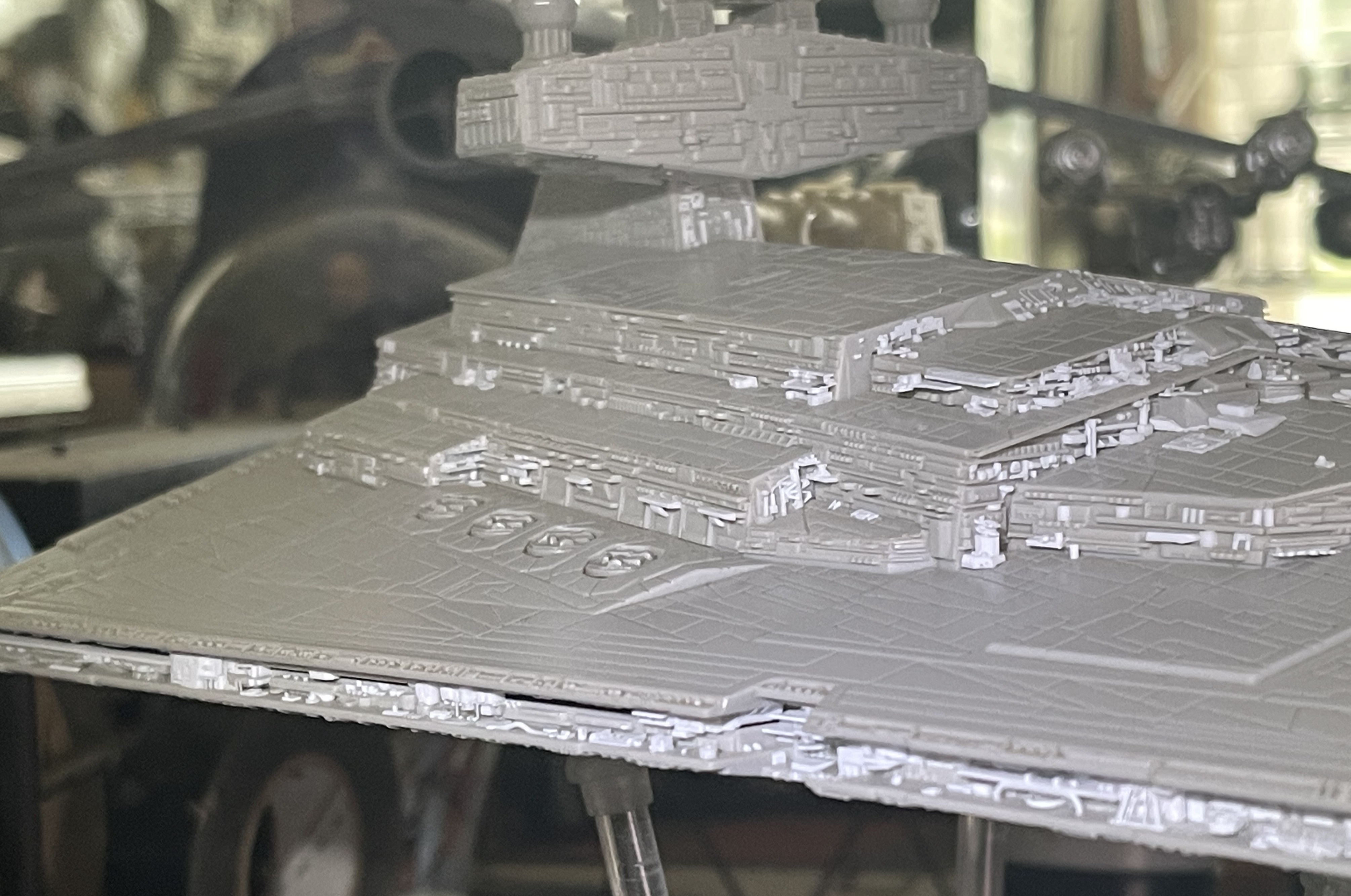

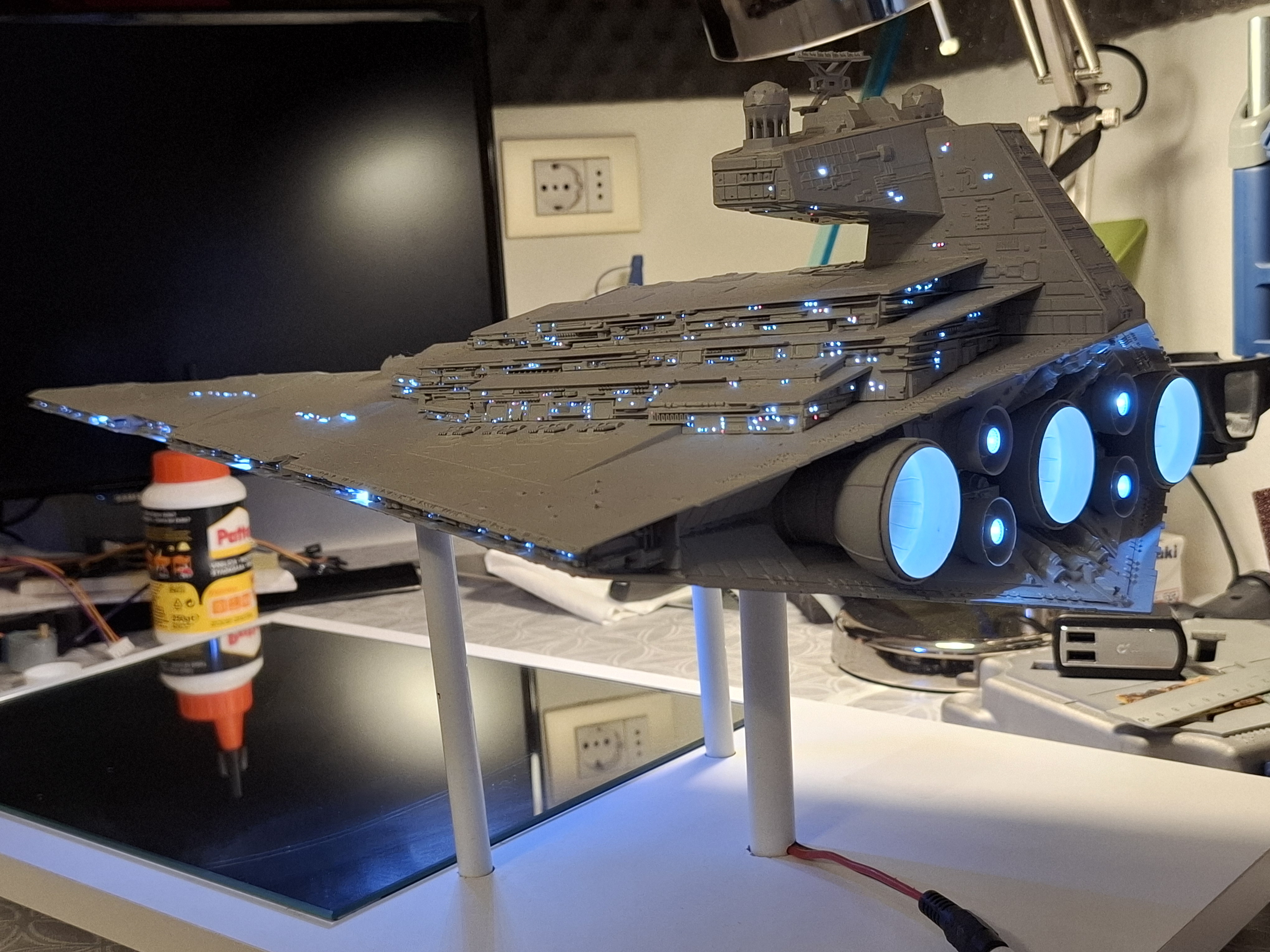

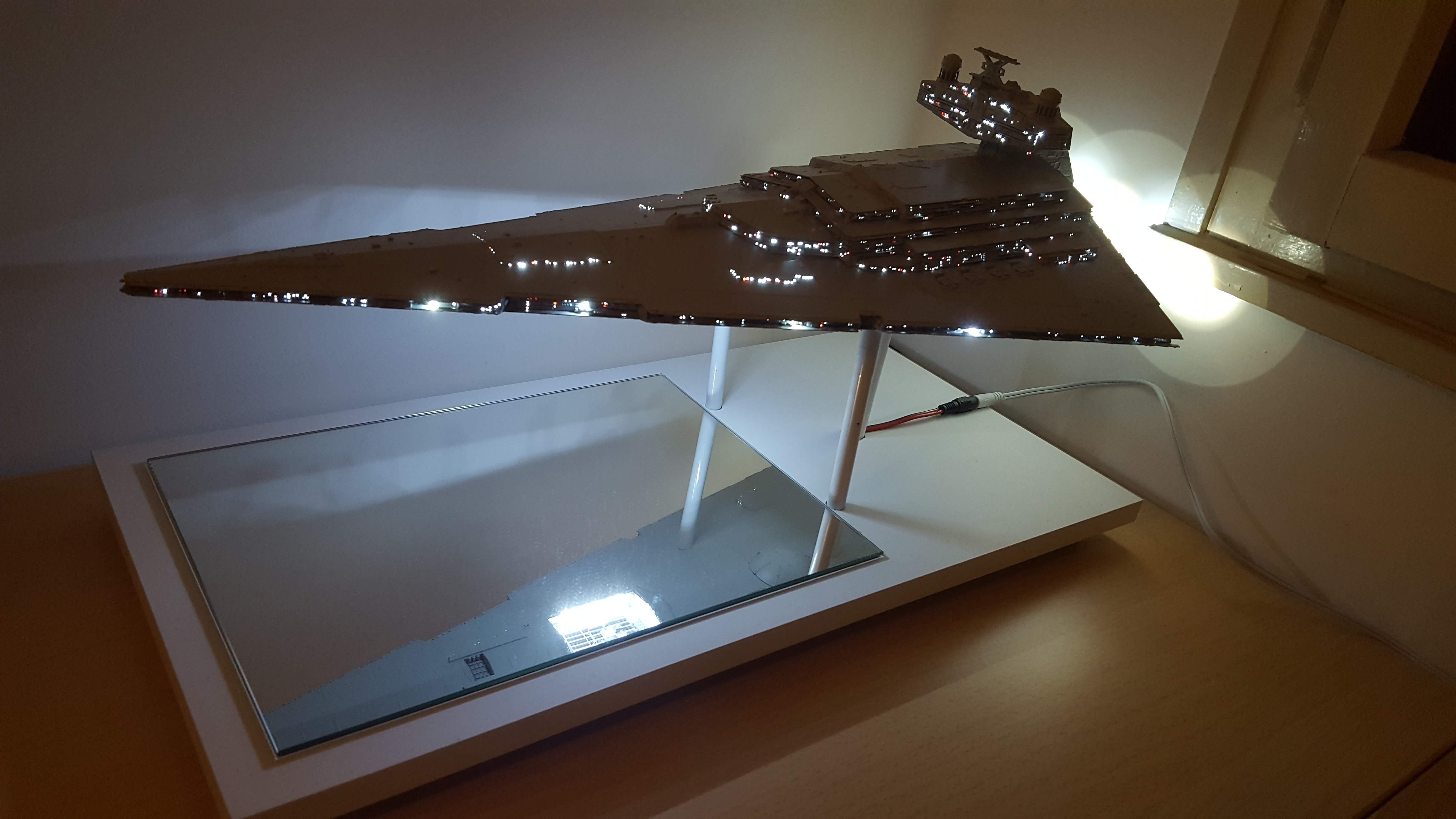

In 2019 I built the Zvezda 1:2700 ISD kit, my first kit built since my teenage years. That kit would be my first try at fiber optics lighting.
It was supposed to be a one-off endeavour to make a nice home showpiece, so no build log as well as corners cut left and right (impatient me).
This thread is about the second attempt, with a lot more attention to detail. So I'd like to start the build log by showing the previous attempt and list all the things I was going to improve on.

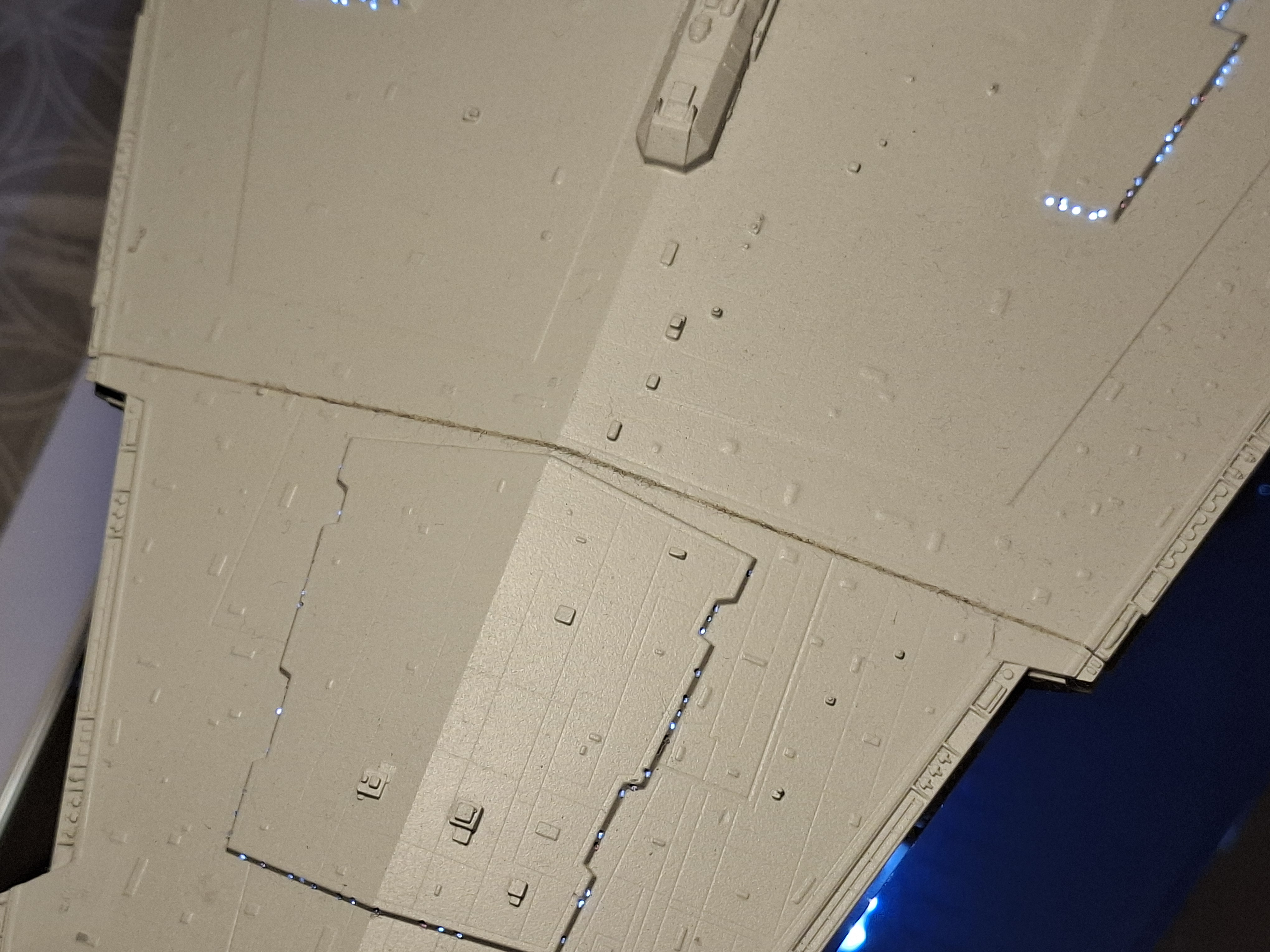

- Since the ISD is meant to be a grey triangle, I thought I could get away with coating everything with grey primer and calling it a day. No panelling, highlighting of details, weathering etc..
- I used a primer not meant for modelling and I put way too many coats to try to make everything uniform. Lots of detail lost in the process
- No kitbashing or detailing whatsoever, except a very sorry afterthought attempt in the rear trench recess

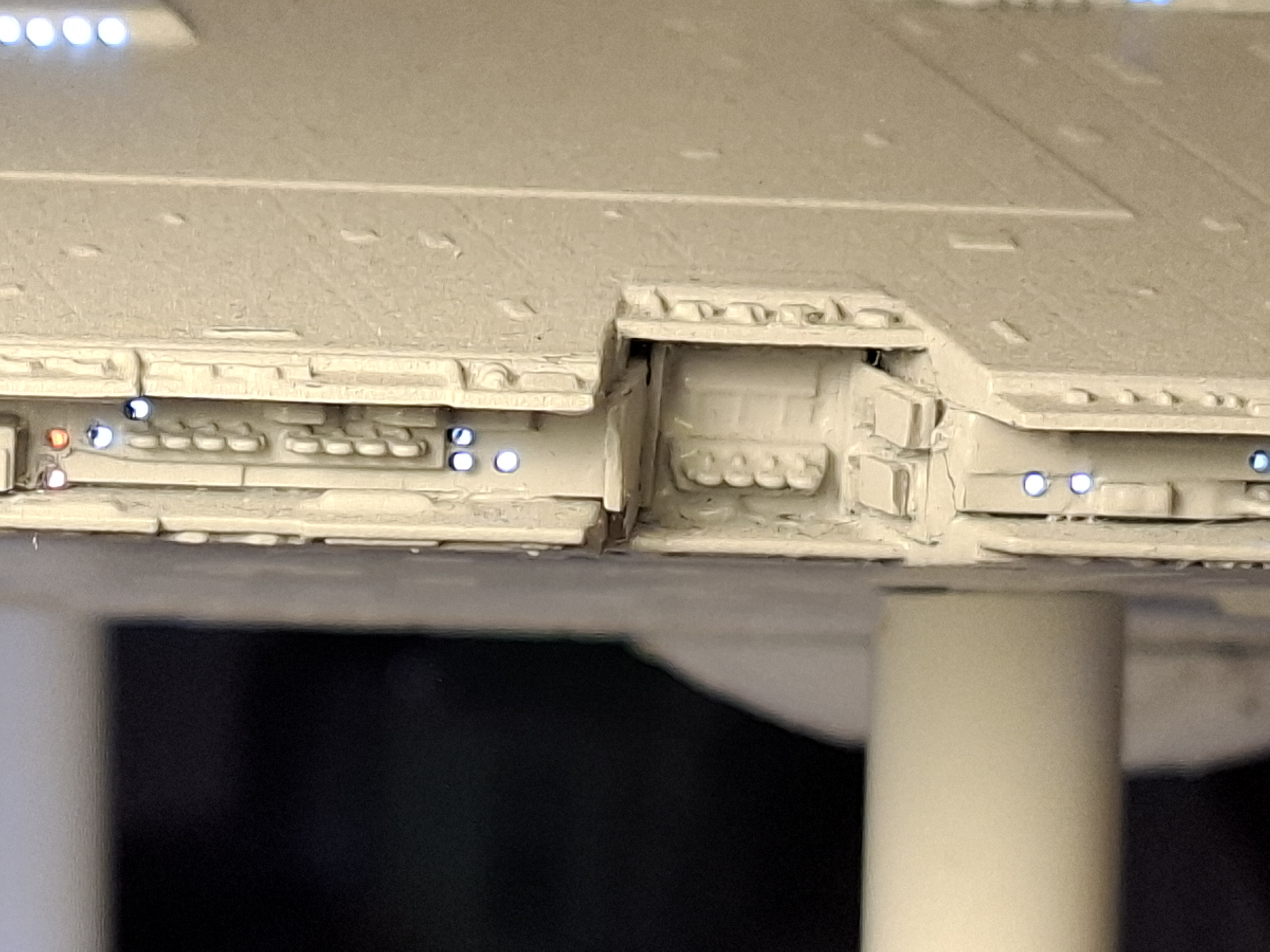

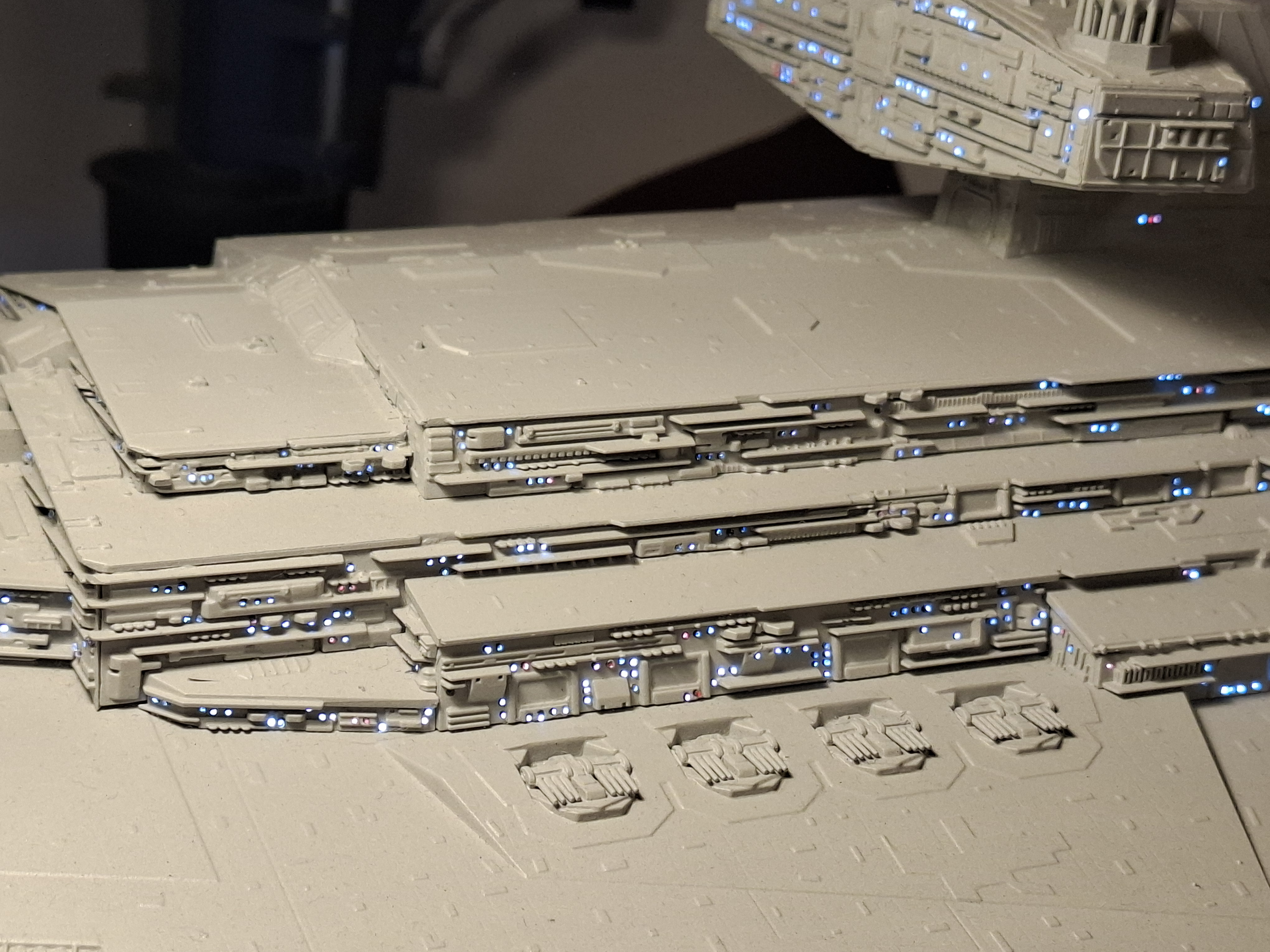

- Used 0.75mm fiber optics, too big for this scale, and in a few places they're not placed uniformly
- trench and hangar bay LEDs are too bright

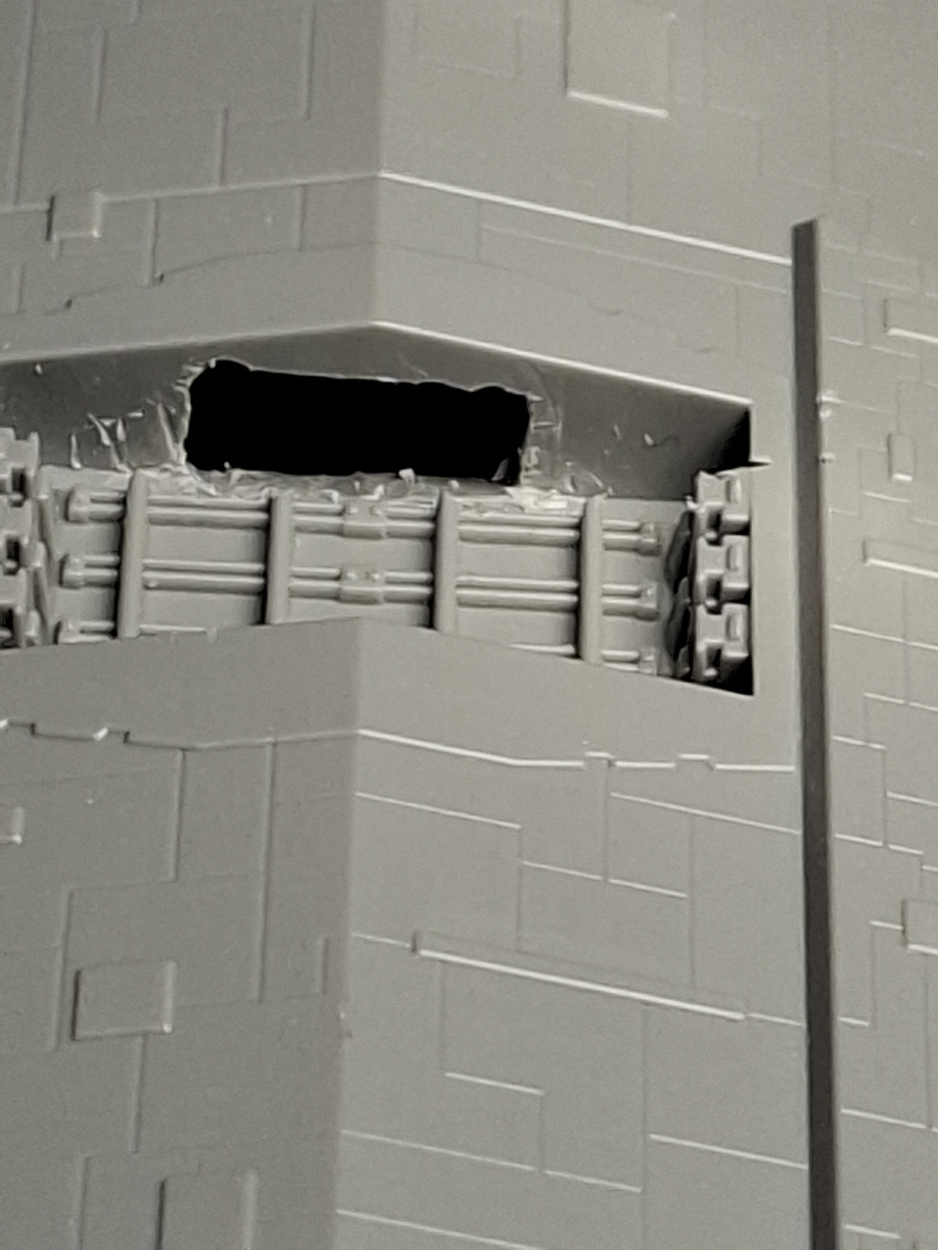

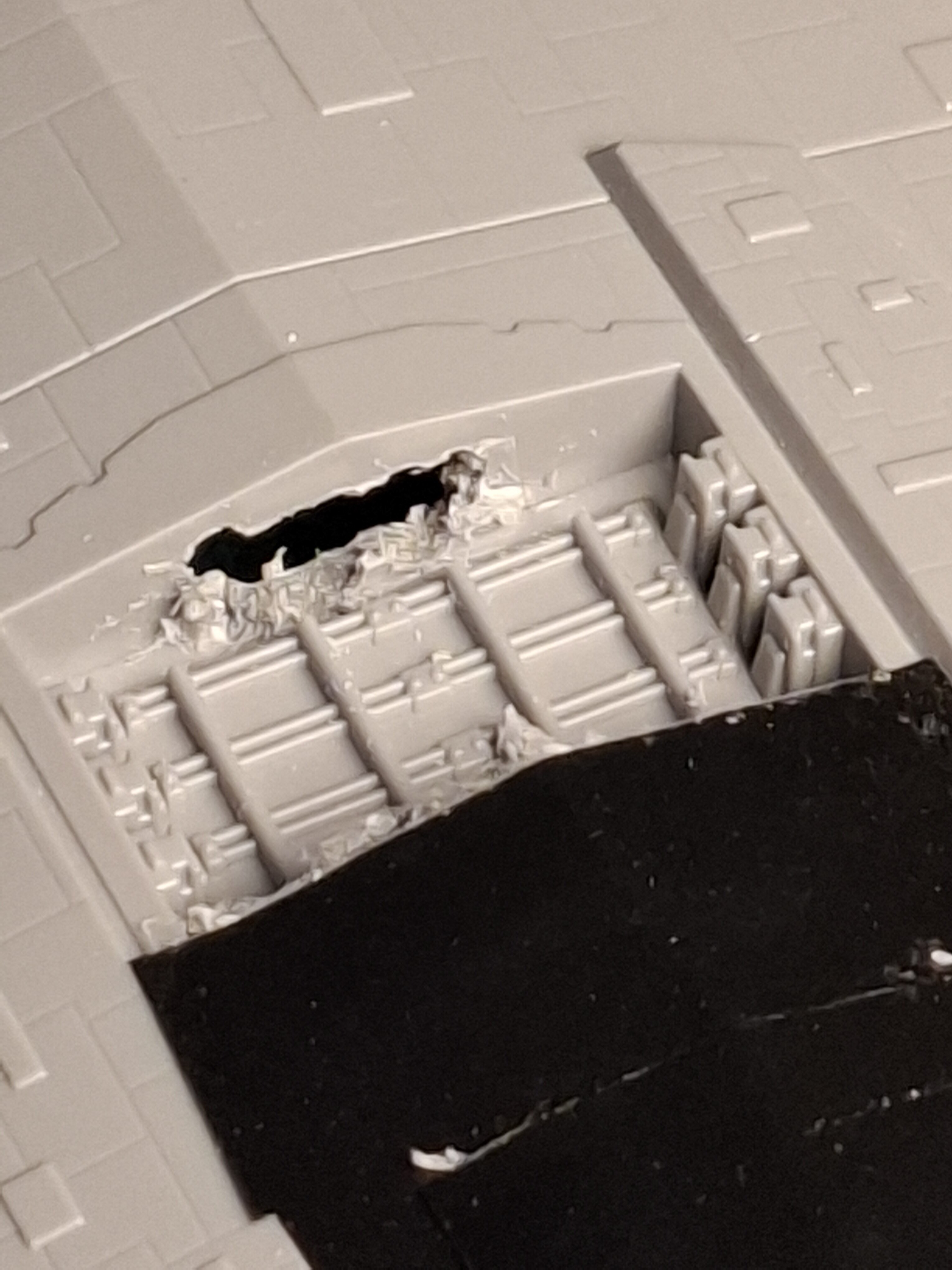

- An accident on one of the superstructure roofs badly re-touched, more lost detail
- The seam between the two hull sections was filled with thick acrylic paint and painted over, as opposed to putty and masked with greeblies. Looks poor and it also catches dust more than the surroundings

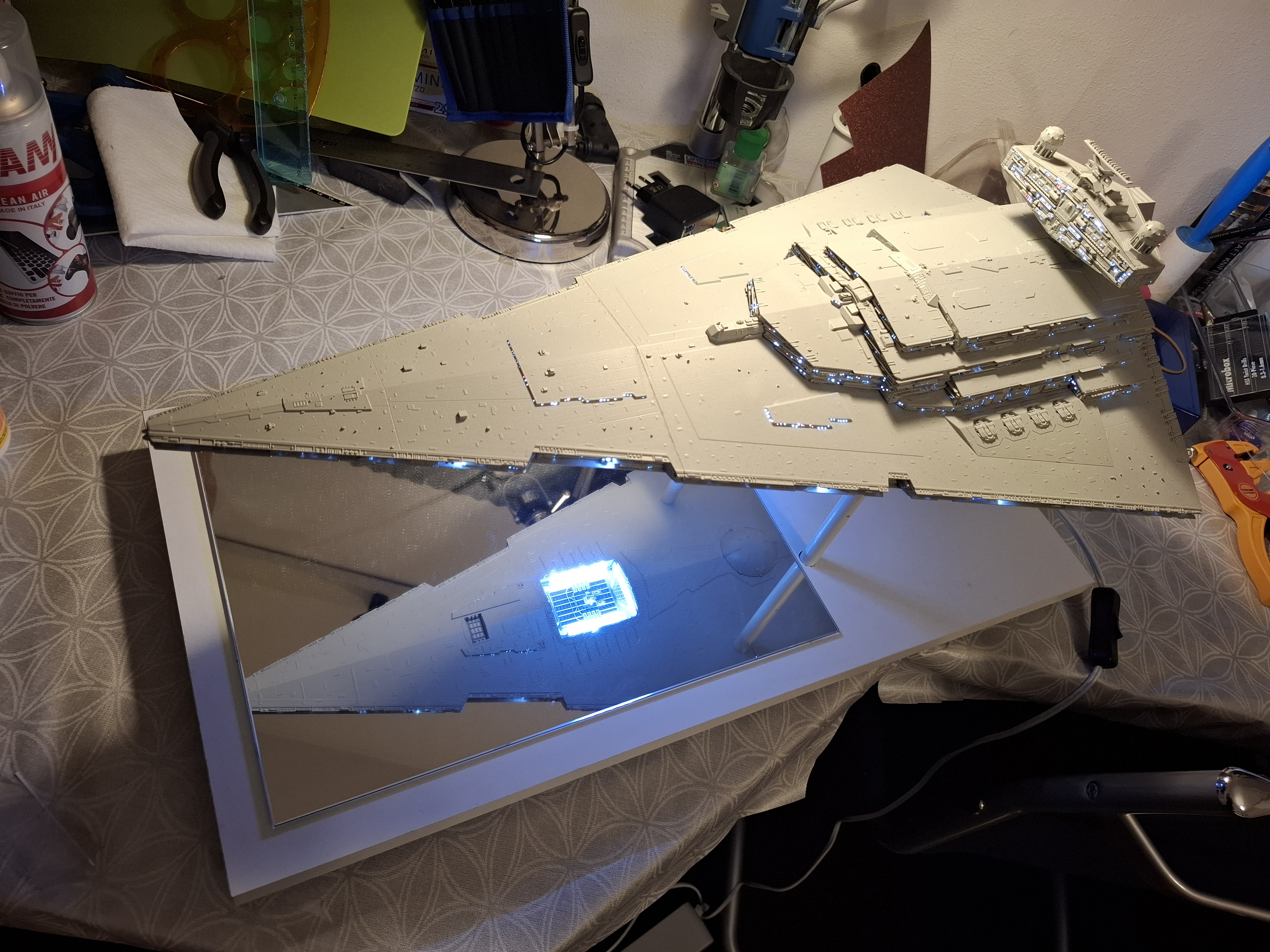

- The display can use some improvement. I like the underside mirror thing, but the triple stilts look janky

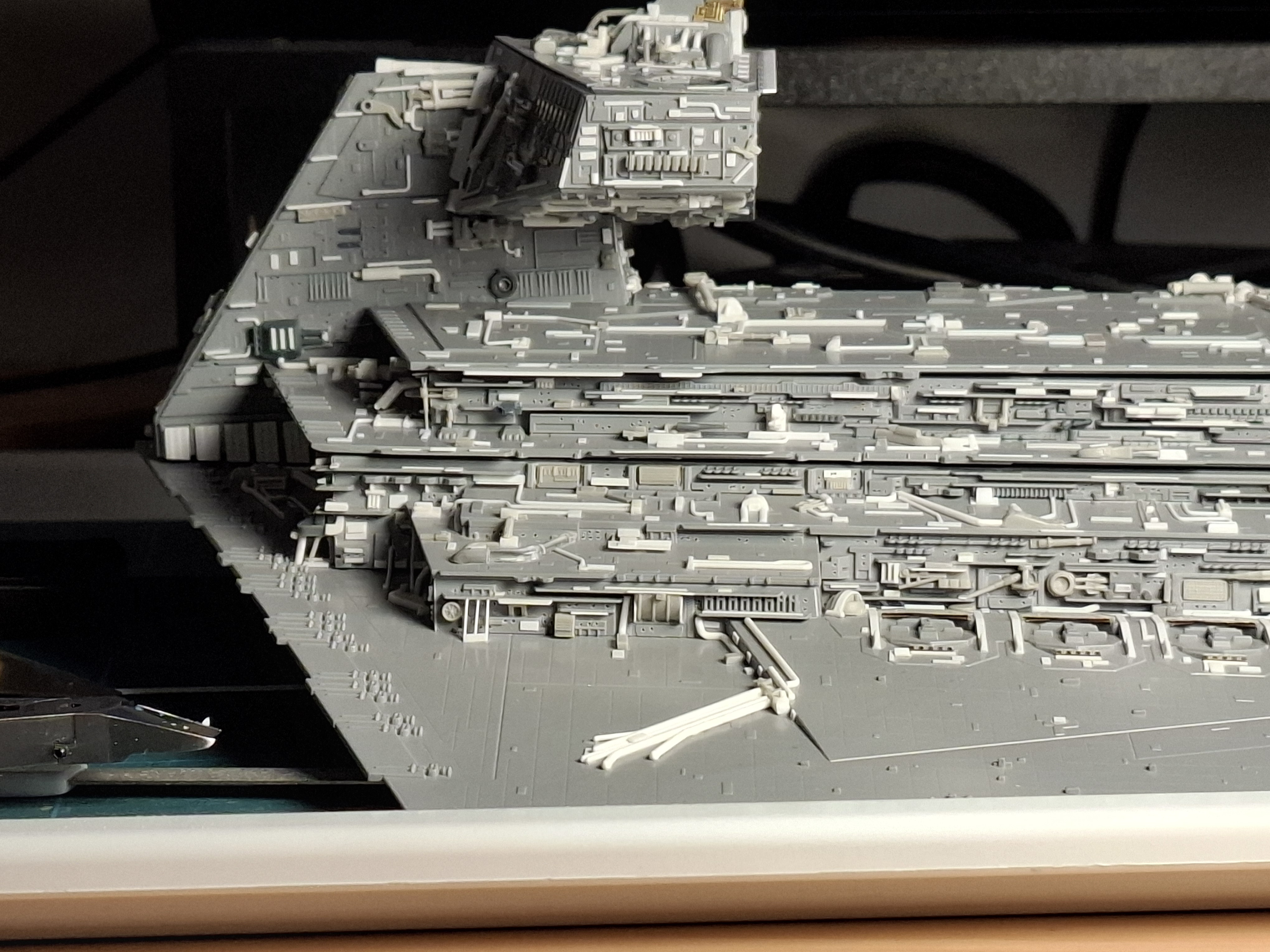

The second build began in October 2020 as a Covid lockdown project. Now, in July 2025, it's coming along nicely but nowhere near finished. In the following posts I'll showcase all the pictures I collected in the meantime

The first build was pretty impressive for a first effort since being a kid, especially with the lighting and the base
Looking forward to the second build. I think faint panel lines and odd colored panels would be an improvement over to the first build
Like on the ESB filming model you can see the subtle tone variations. A very fine point mechanical pencil would be a good way to add/darken the existing panel lines. Plus if you make a mistake, you can literally erase it. Just be careful with weathering and stay away from heavy/ drak washes or heavy handed weathering. A little misting here and there with the lighter color than the base color to fade stuff would be more appropriate

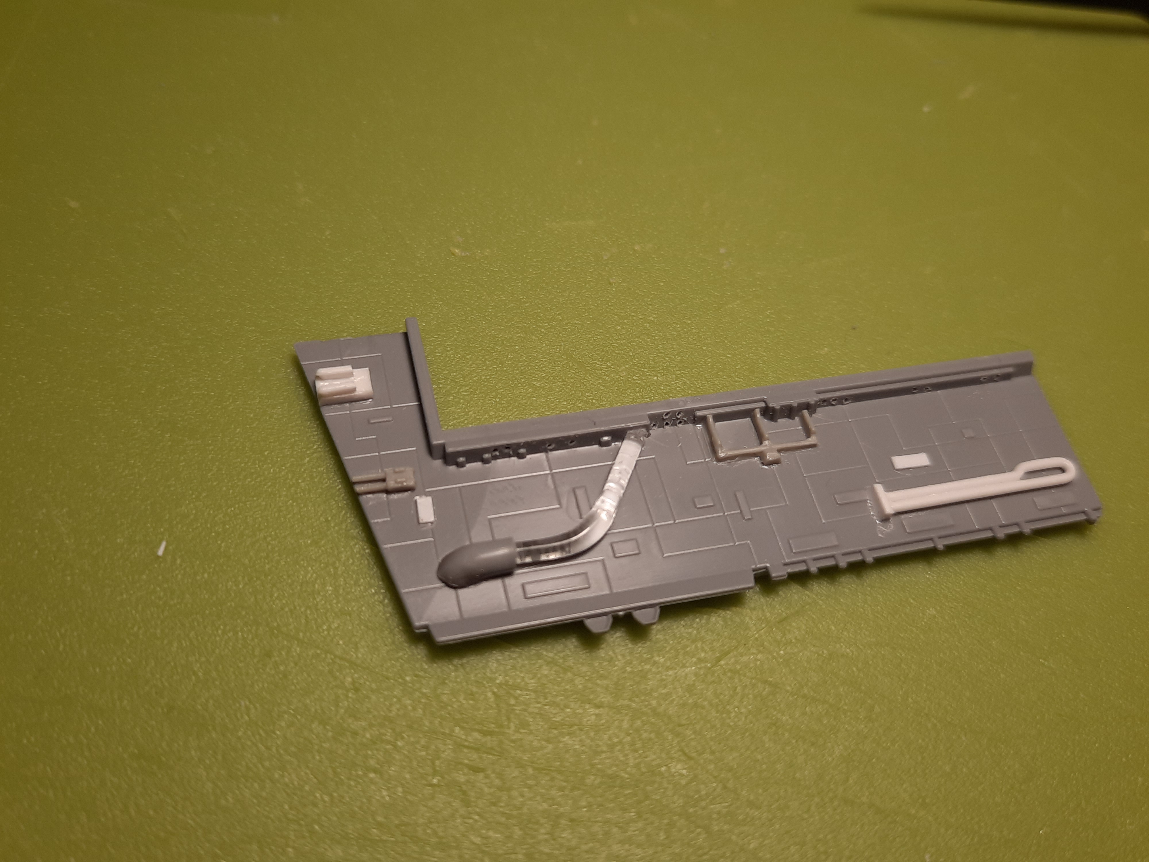

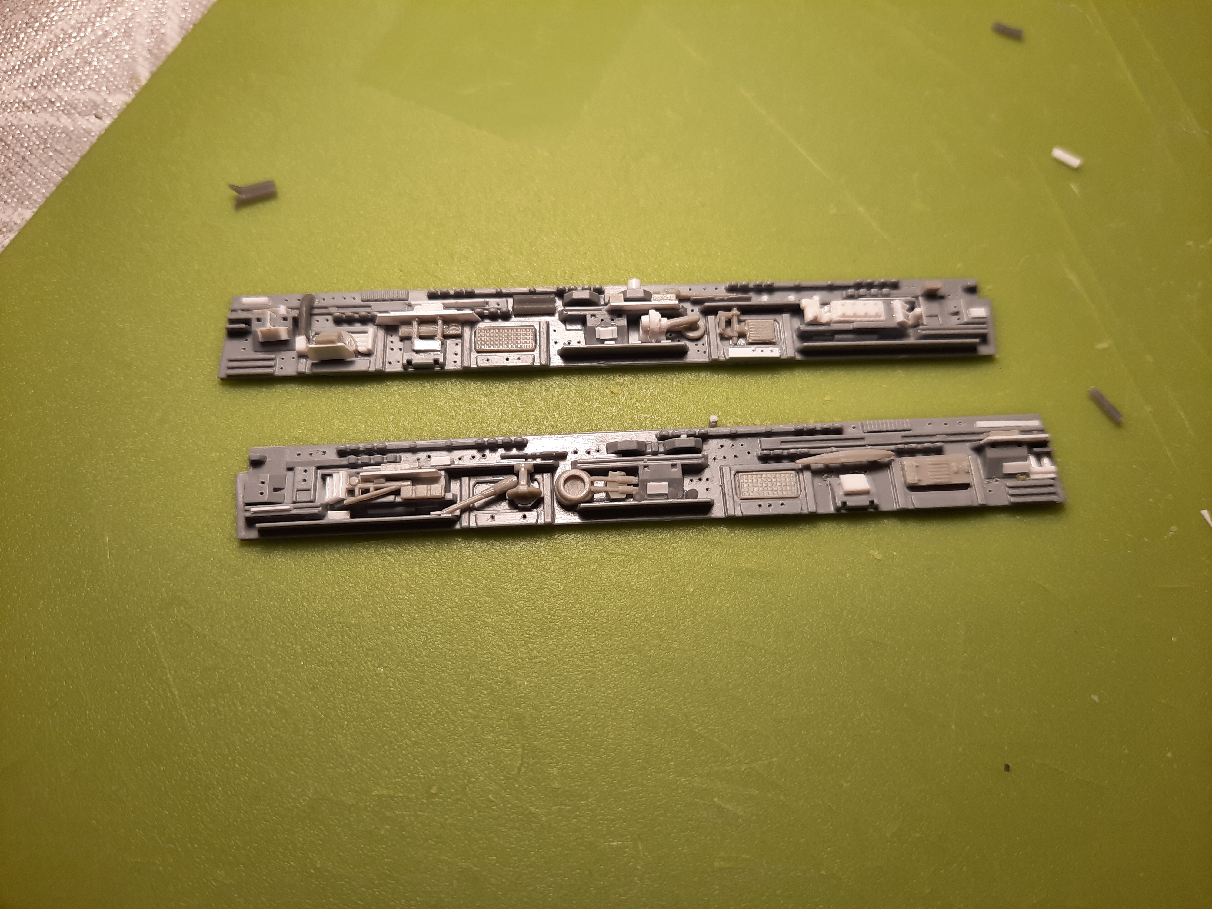

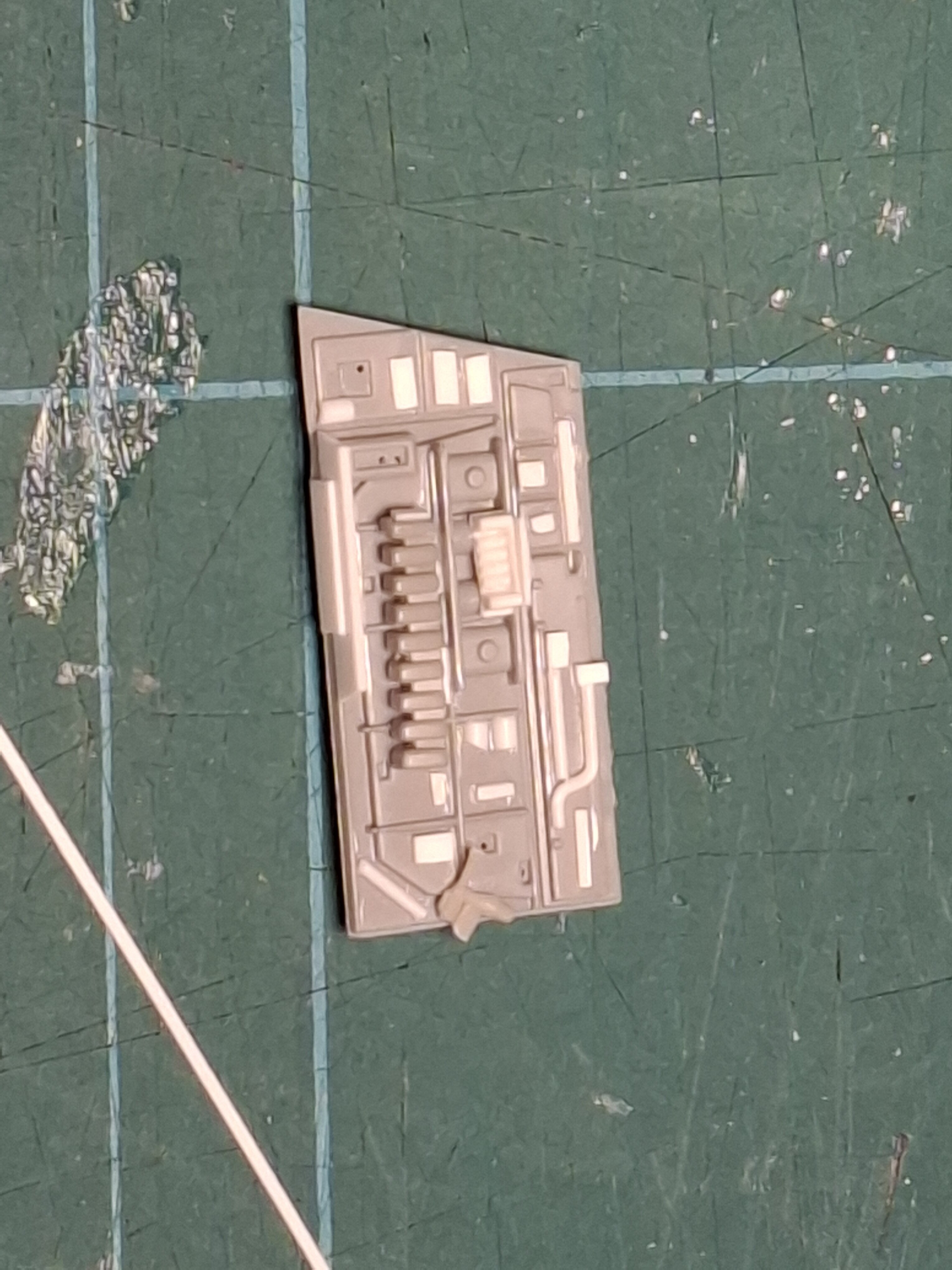

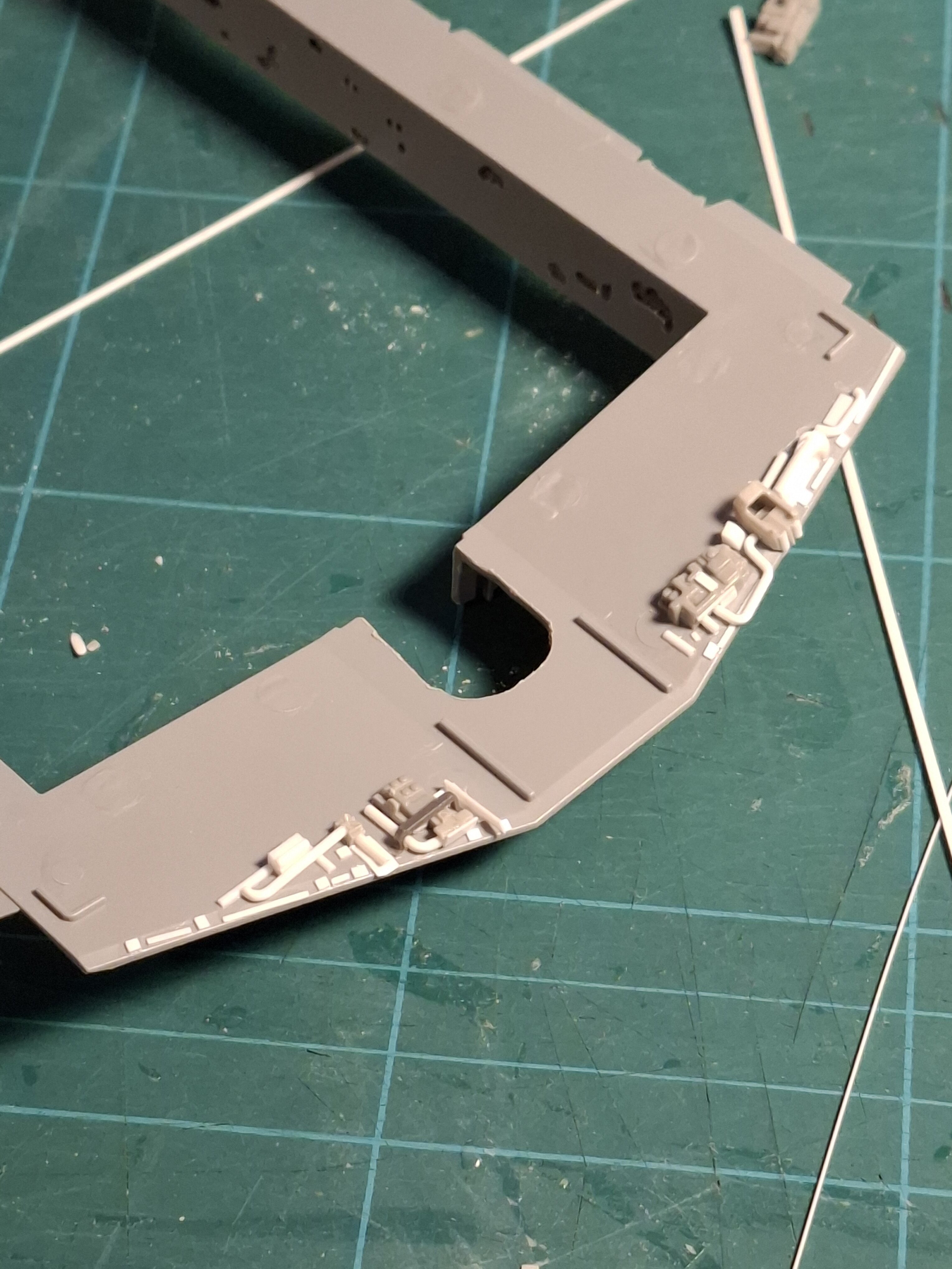

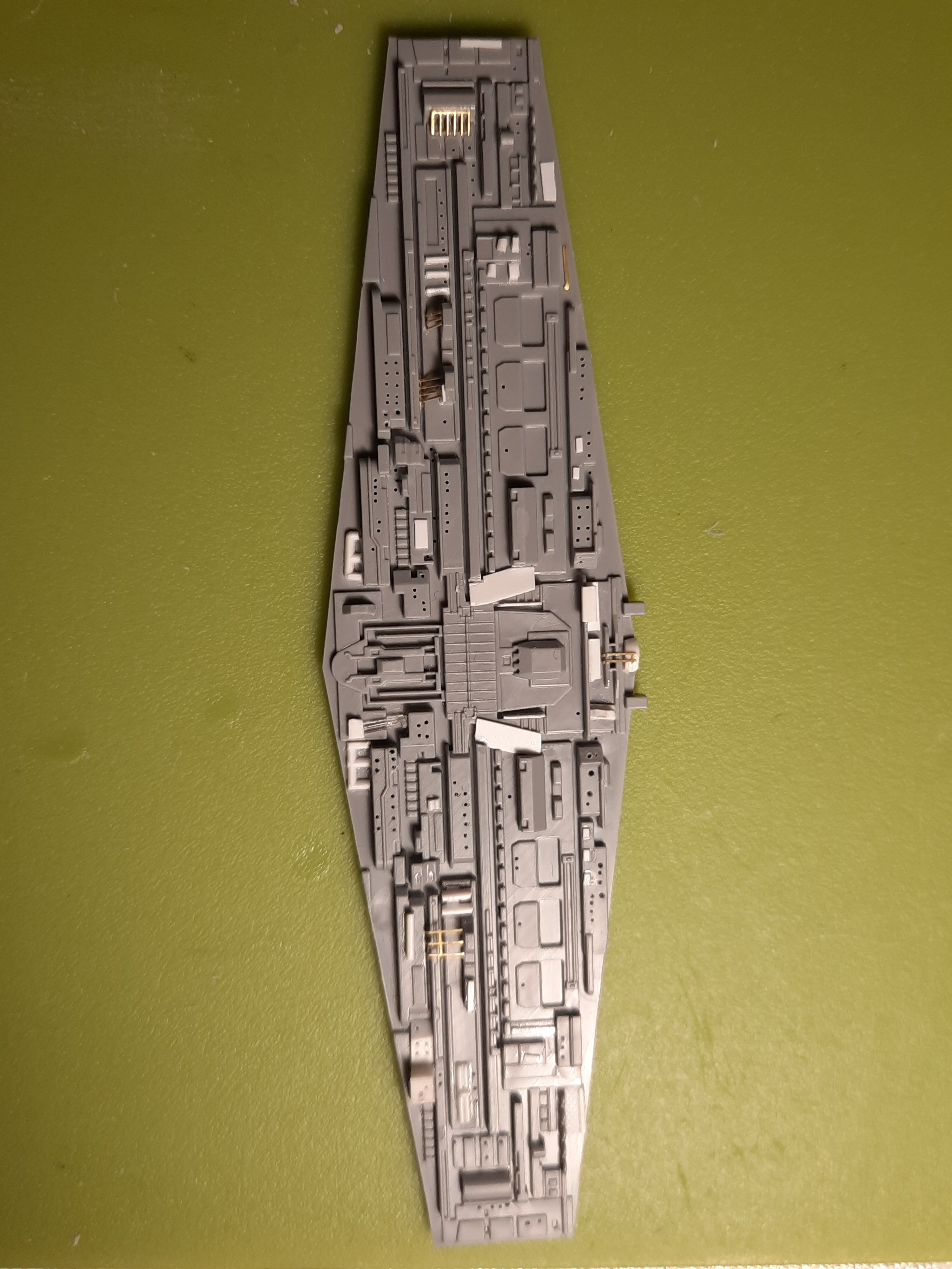

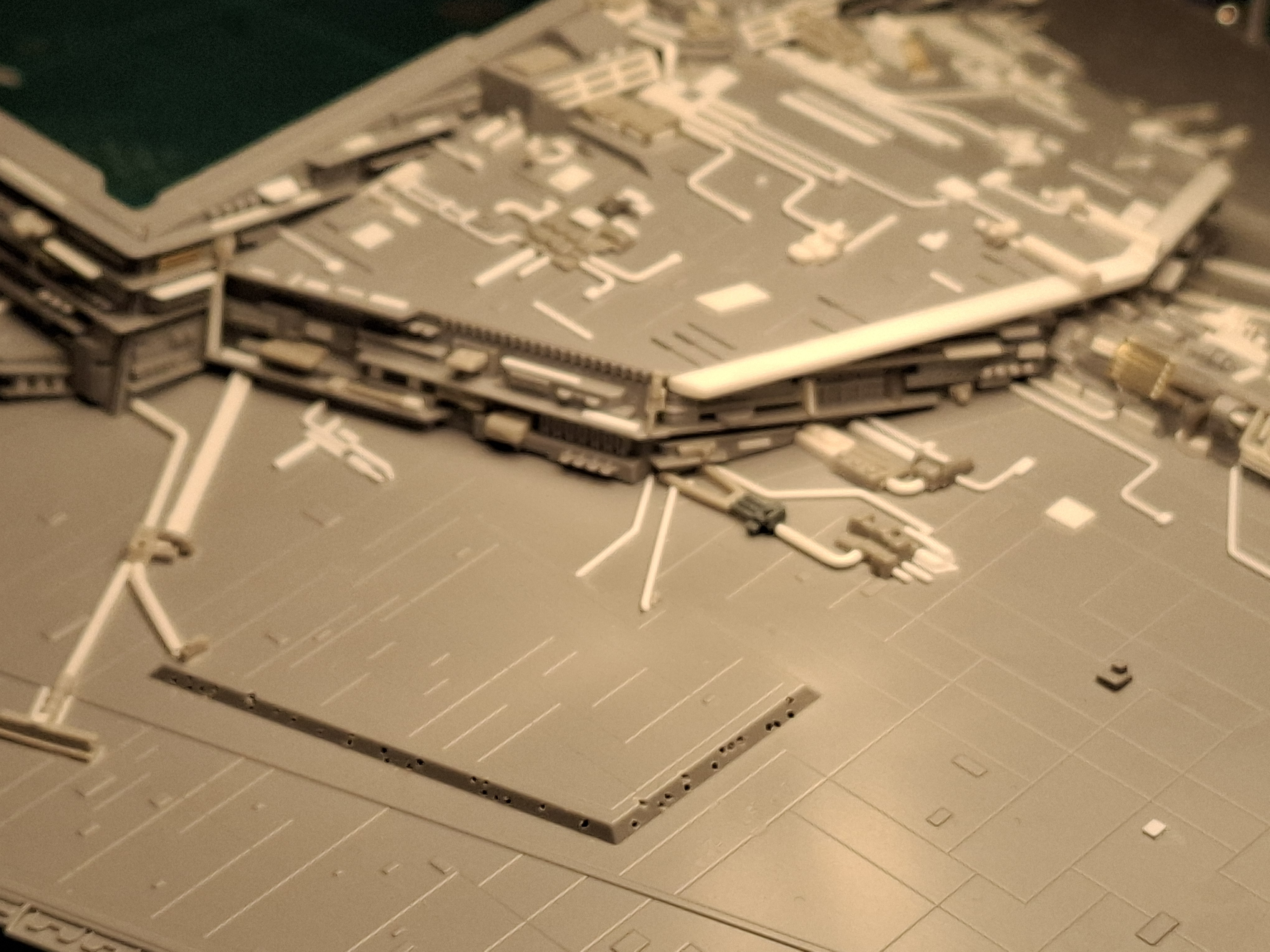

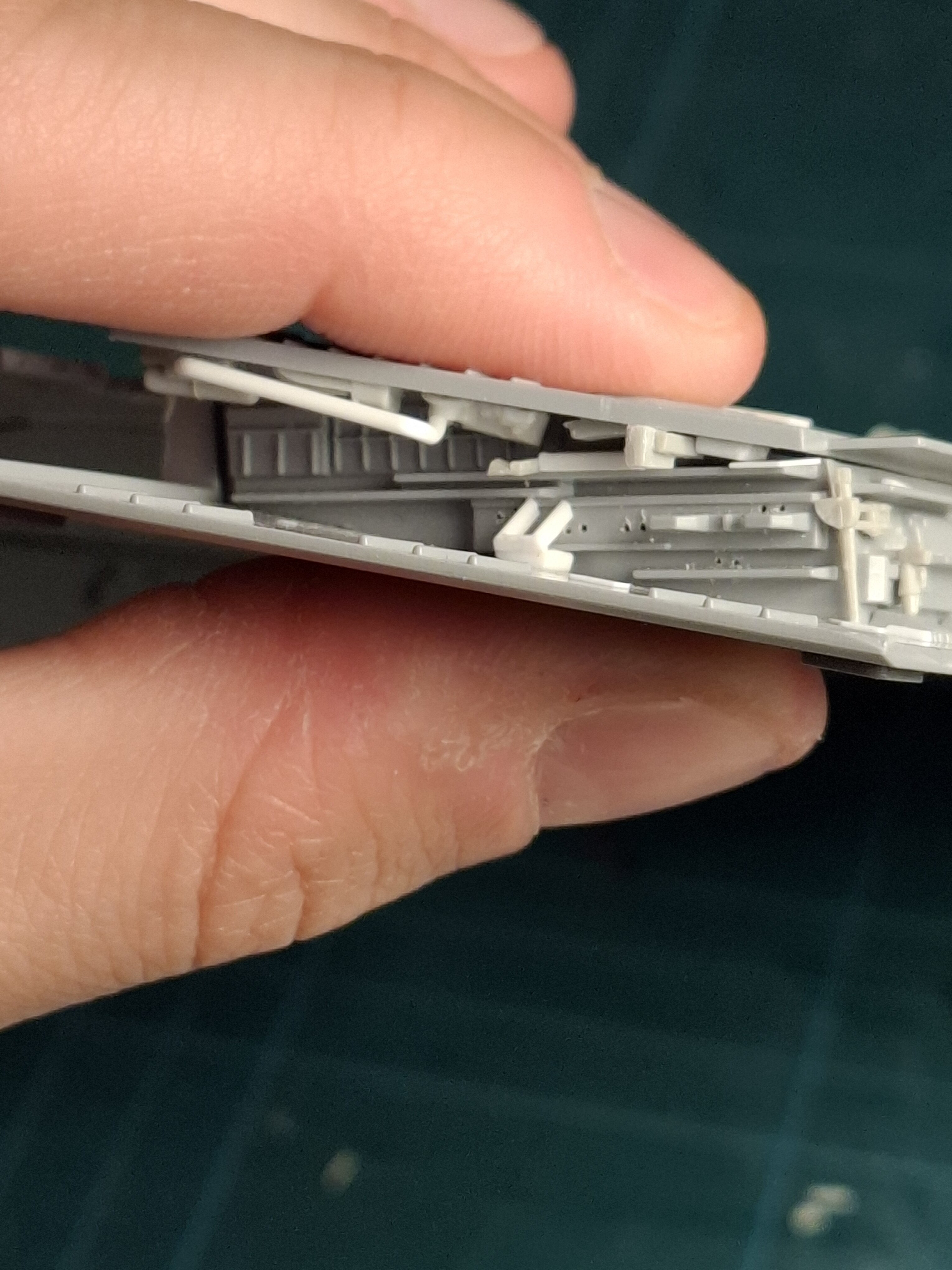

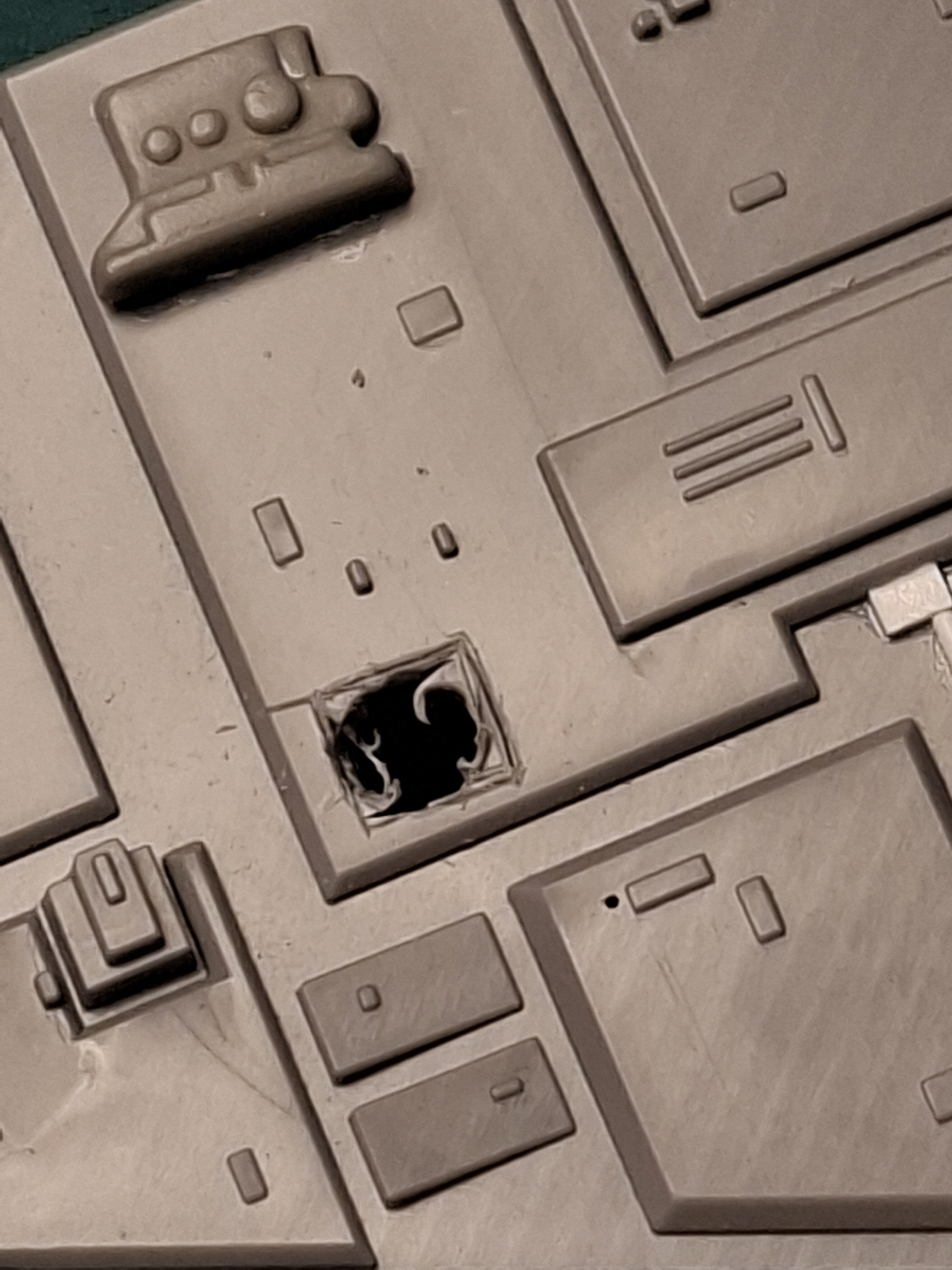

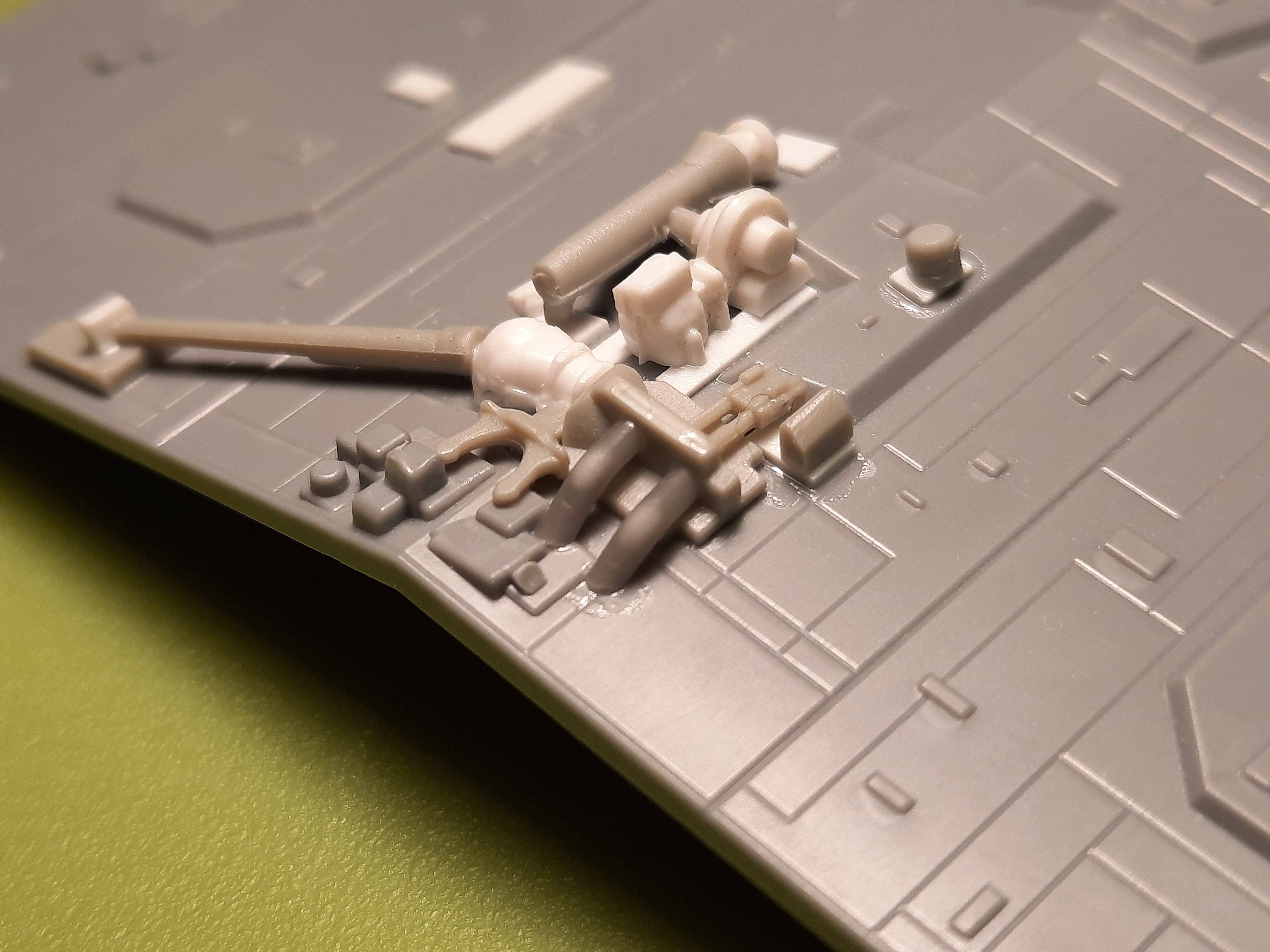

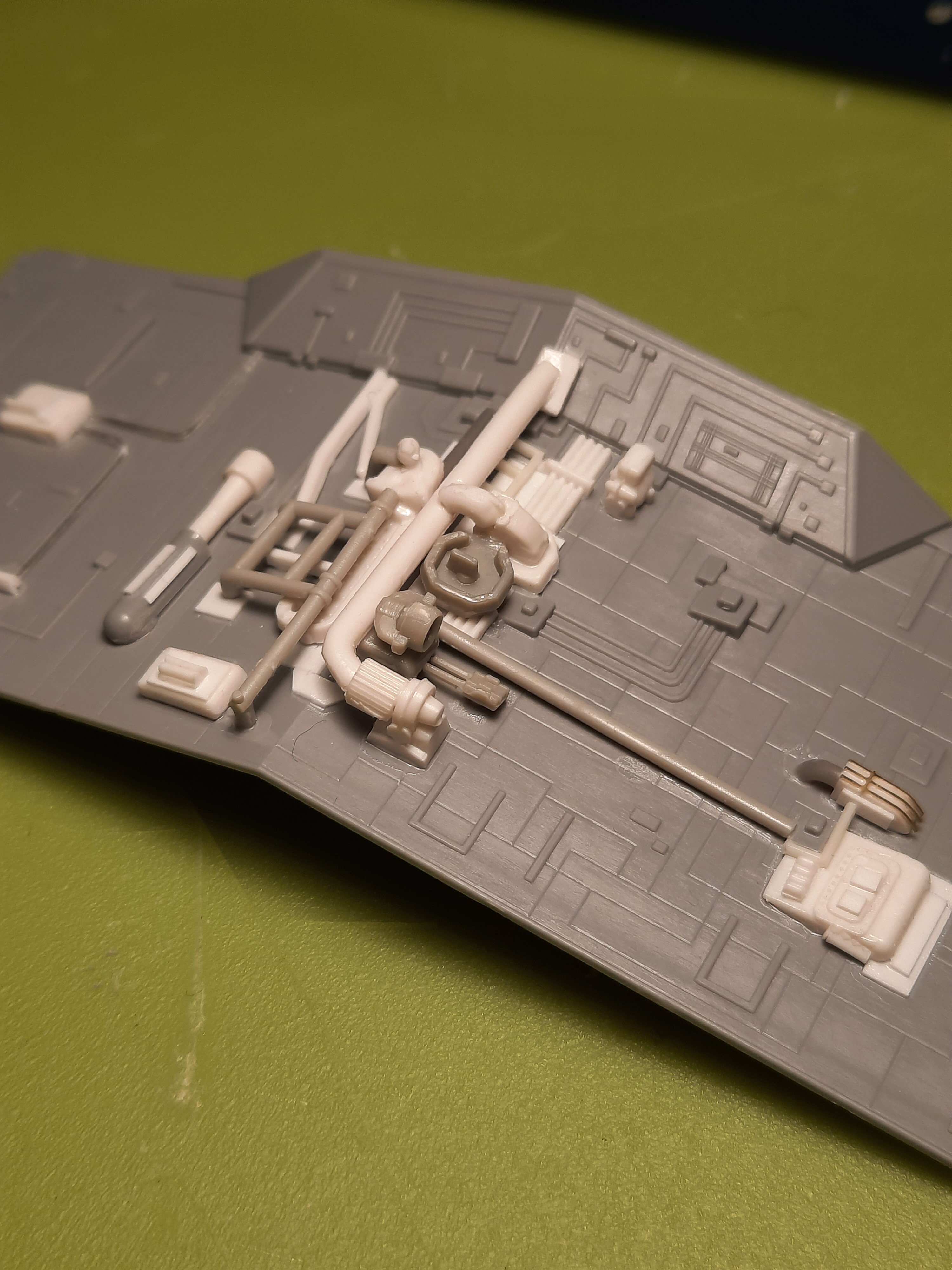

2020-2021: First attempt at greebling

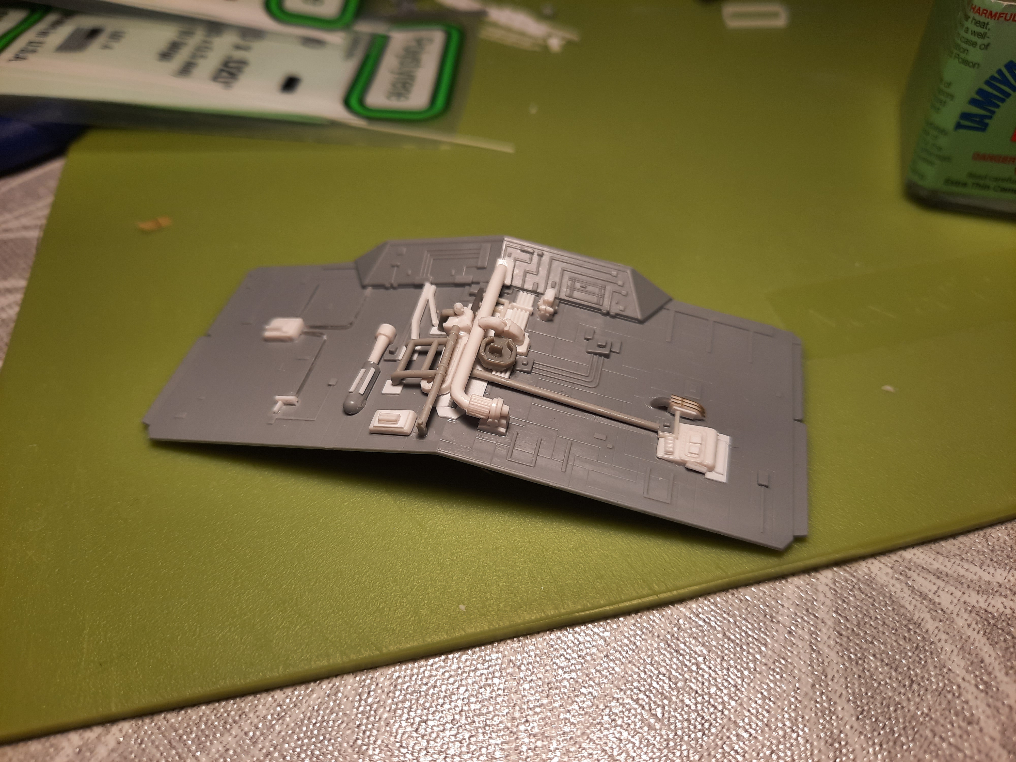

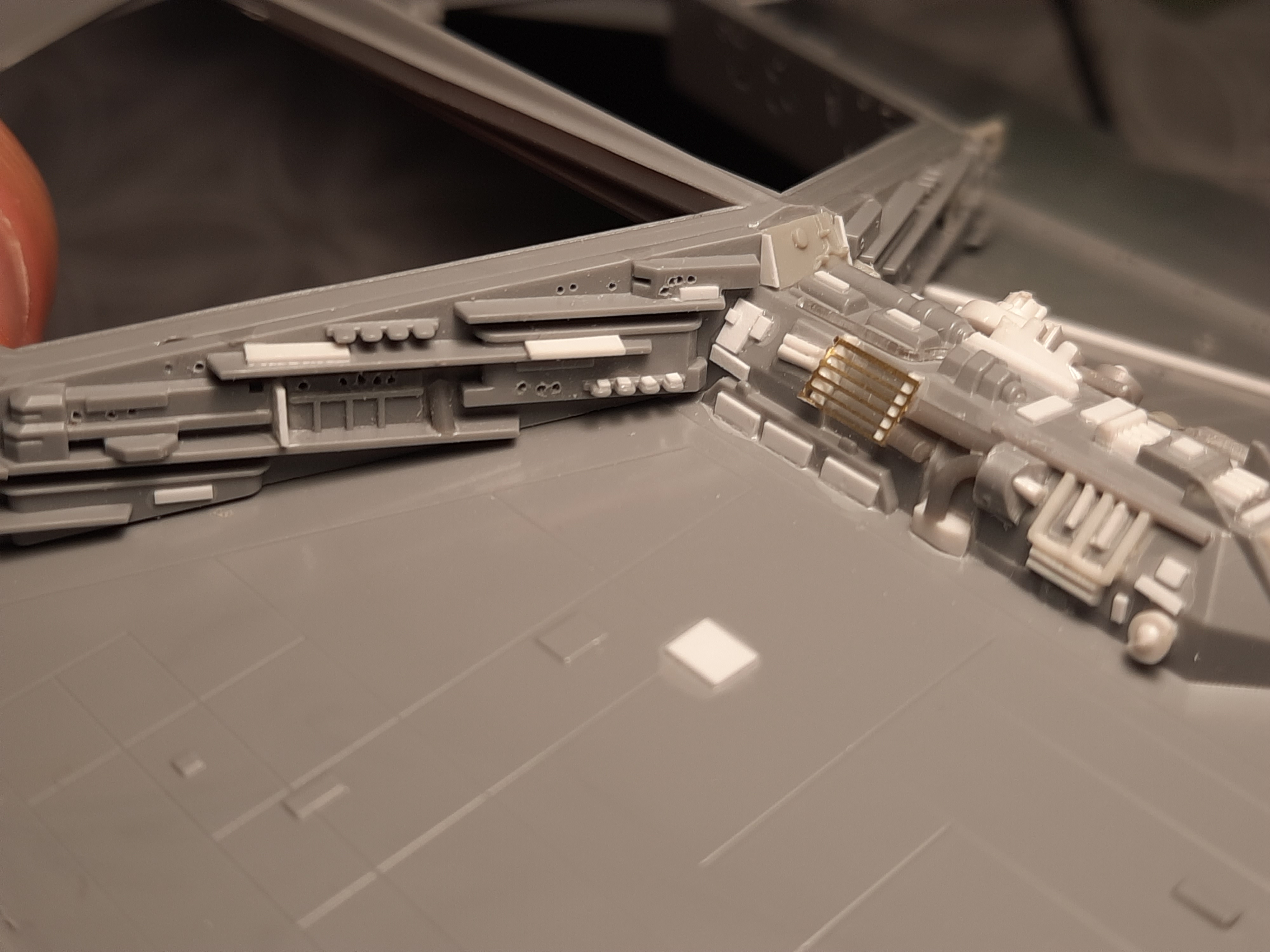

These are my first experiments with styrene stocks and harvesting parts from other kits. At first I even tried recycling old thick optic fibre that I wasn't going to use, as well as the part sprues themselves.

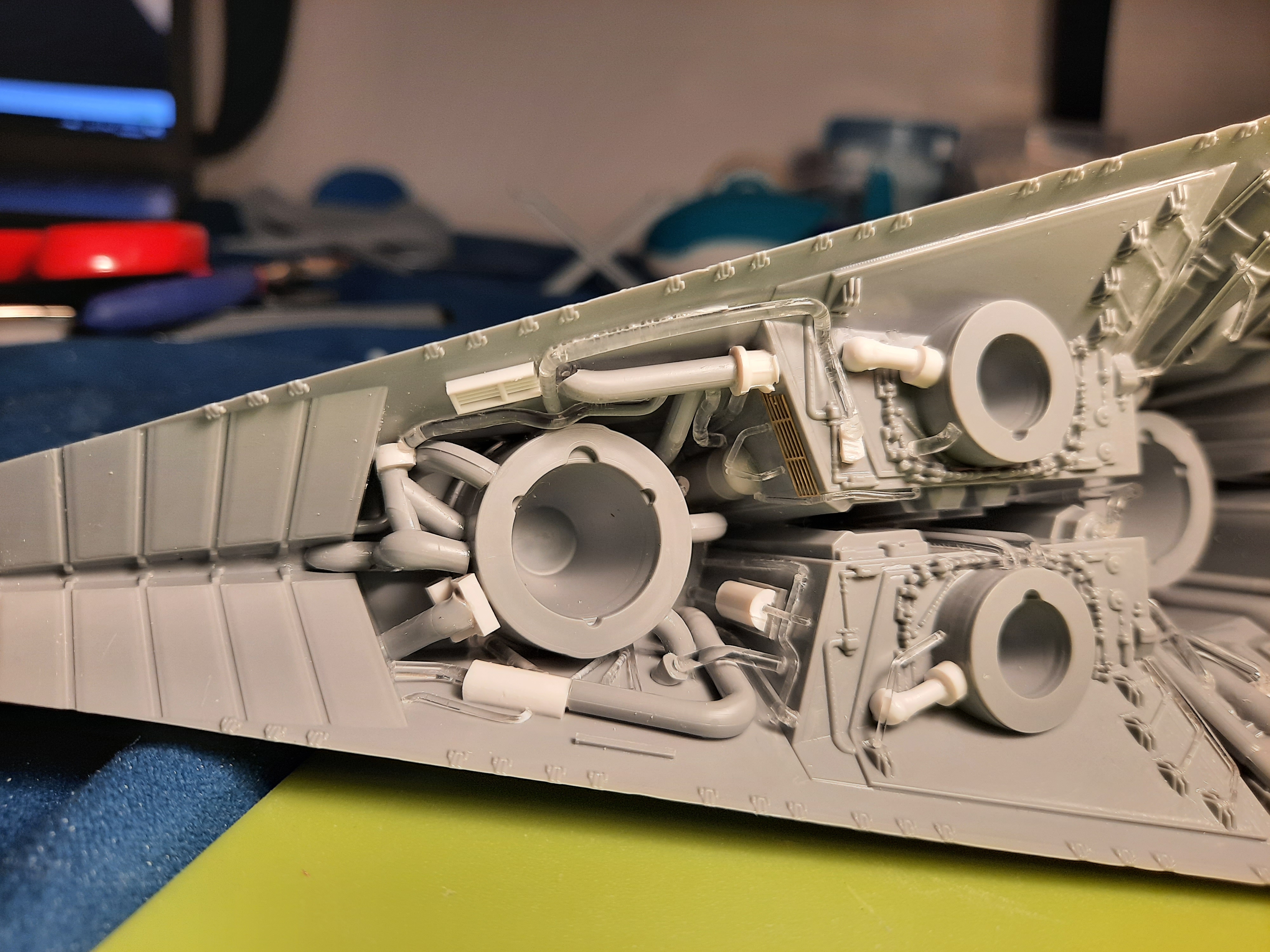

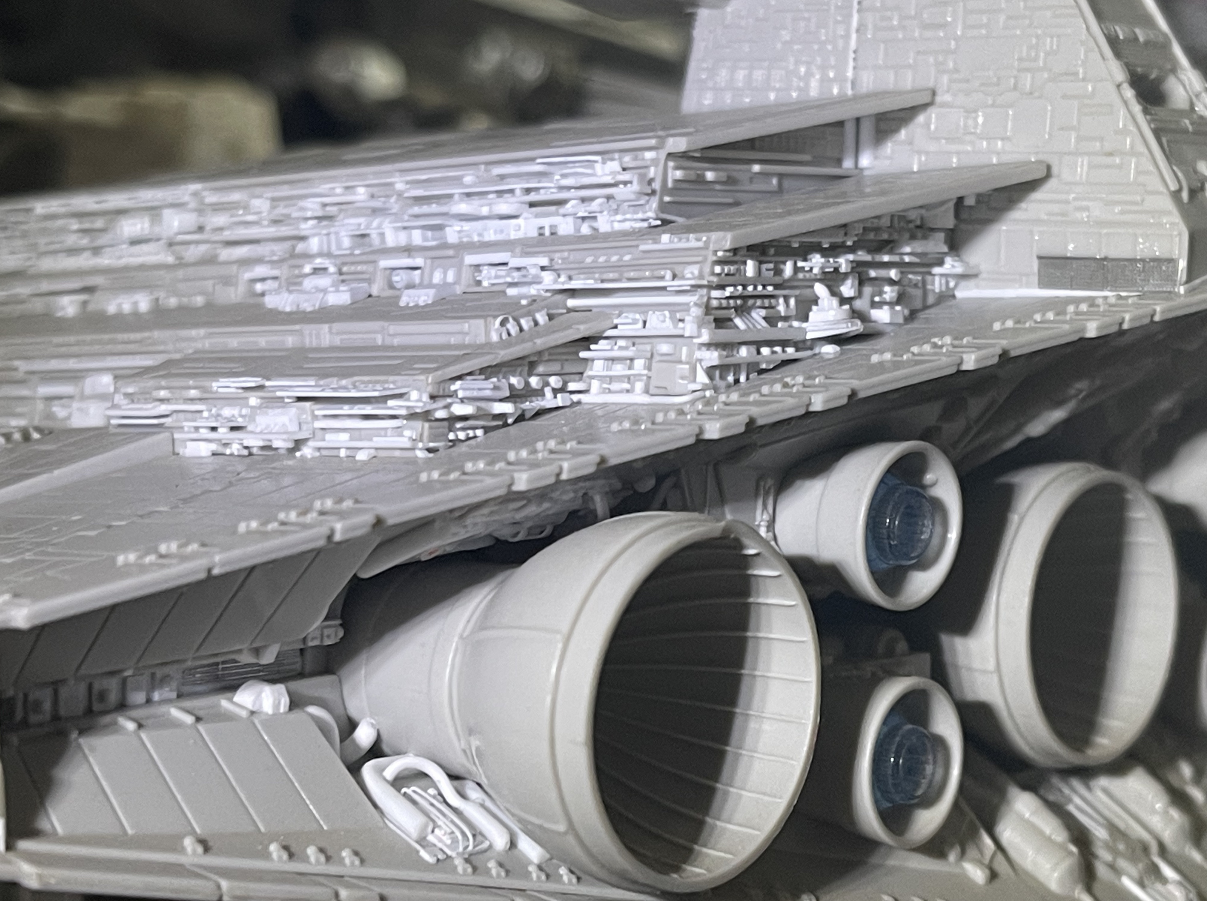

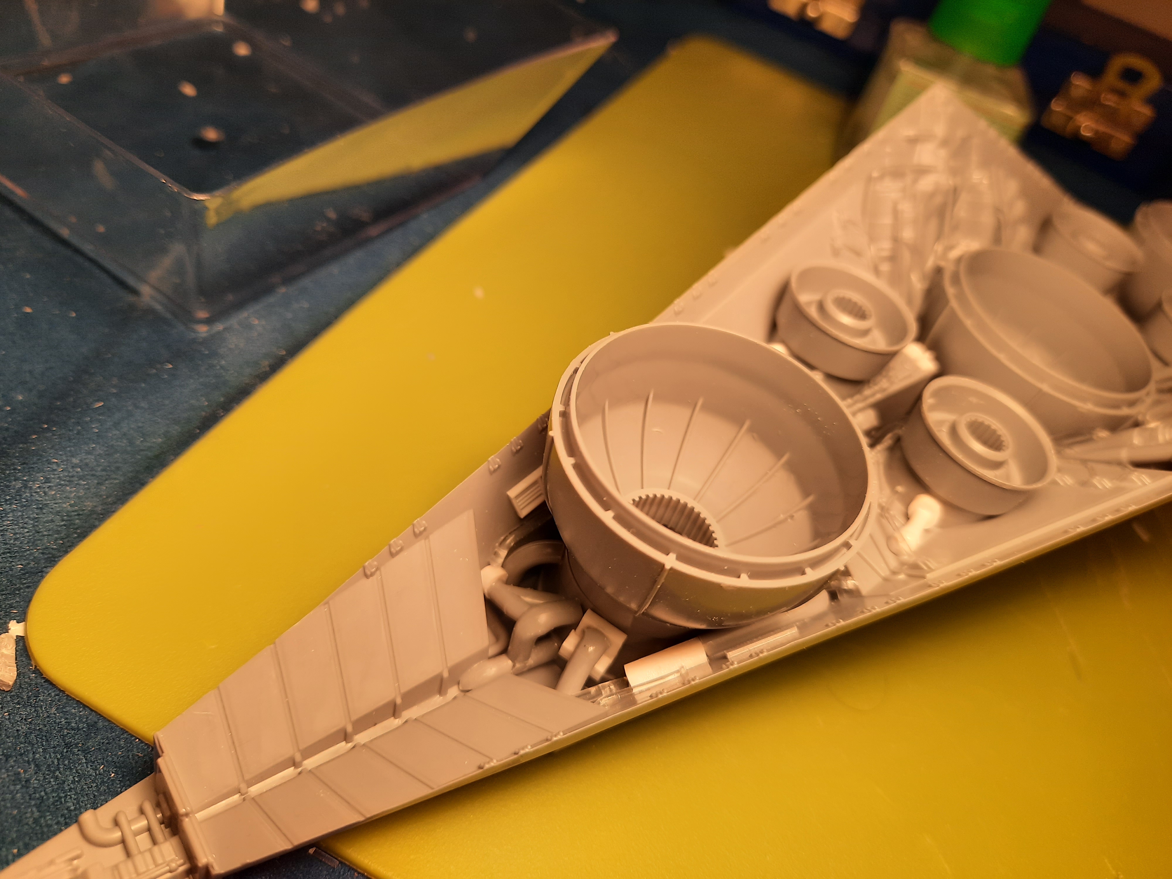

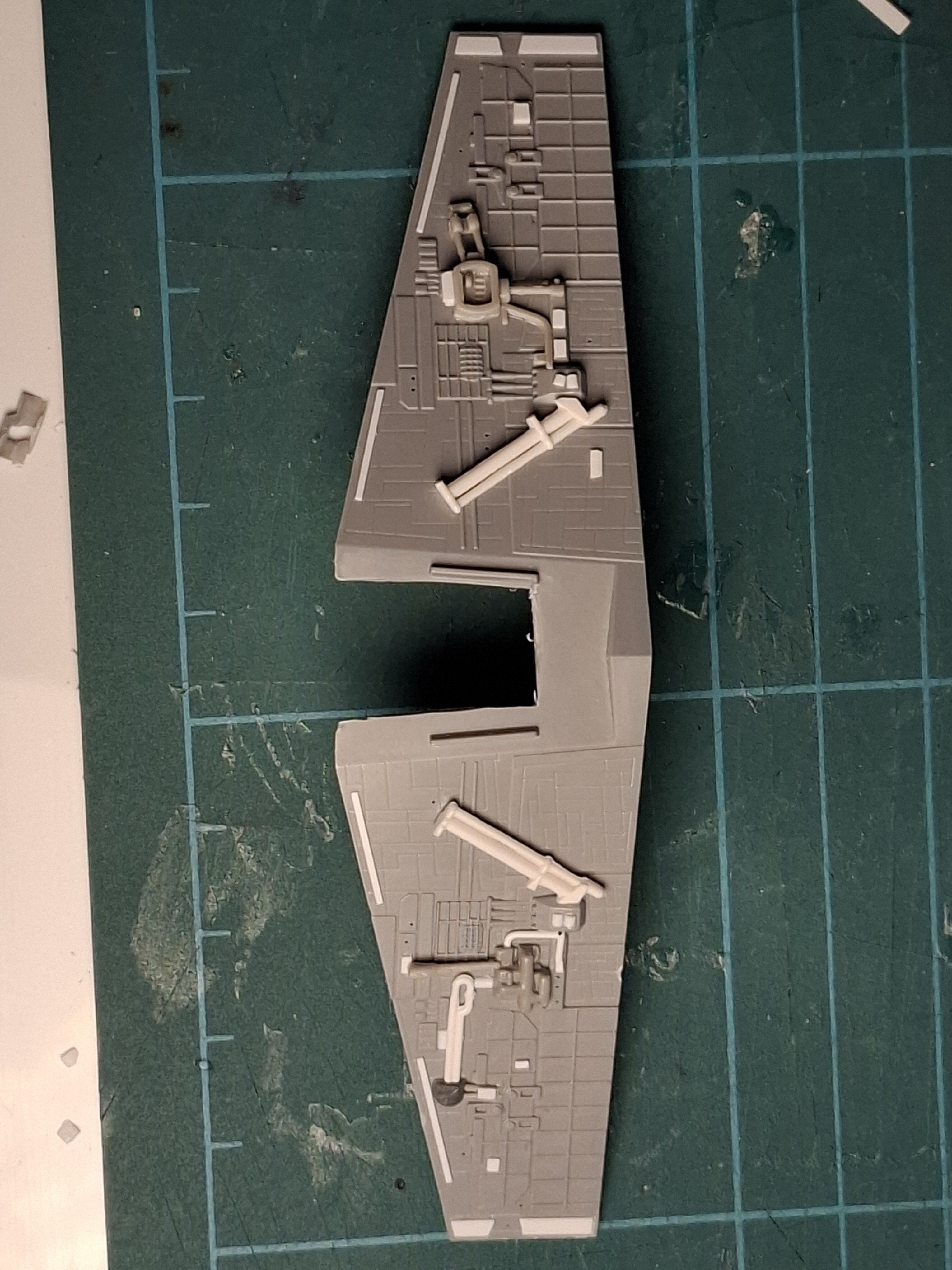

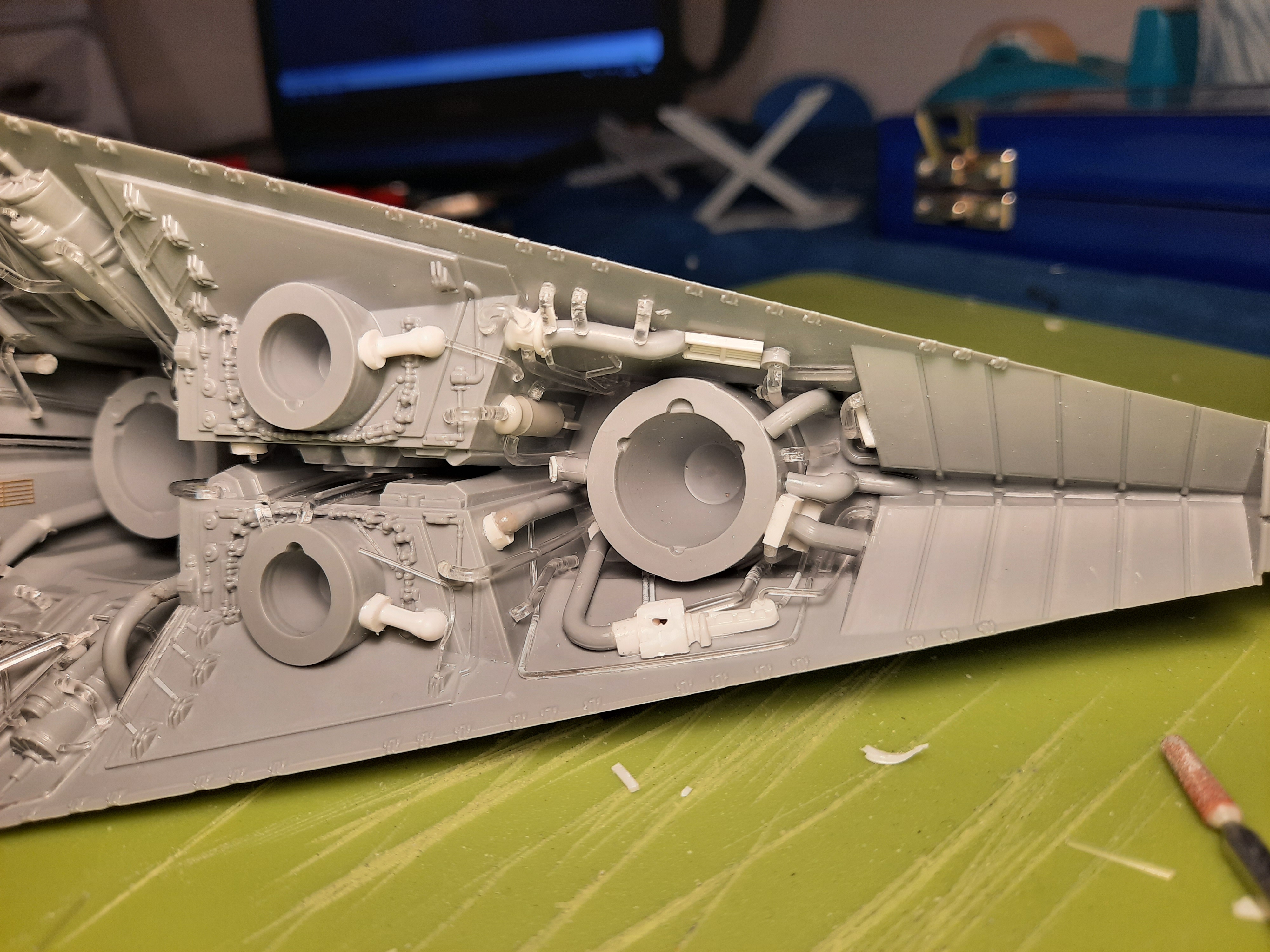

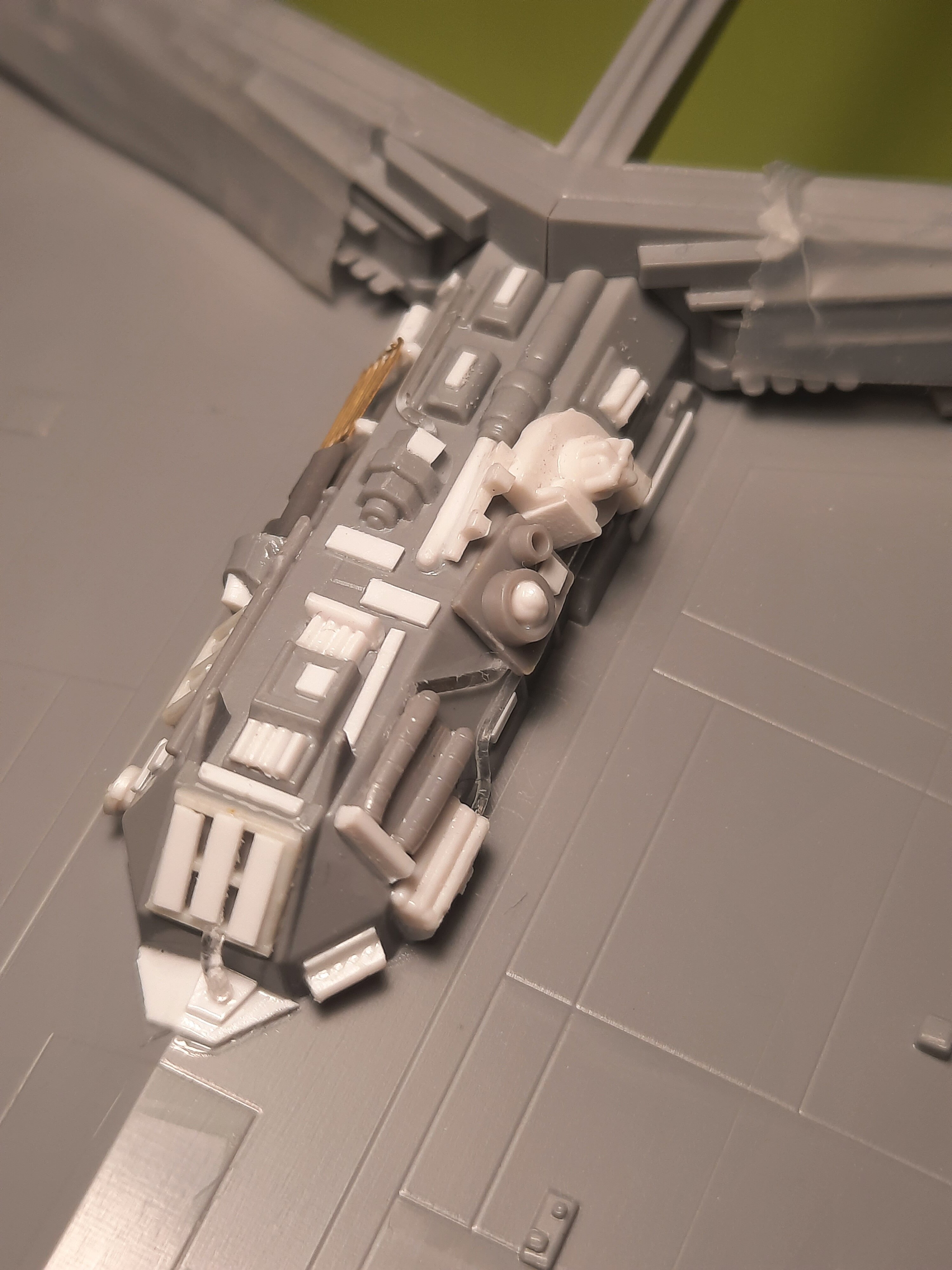

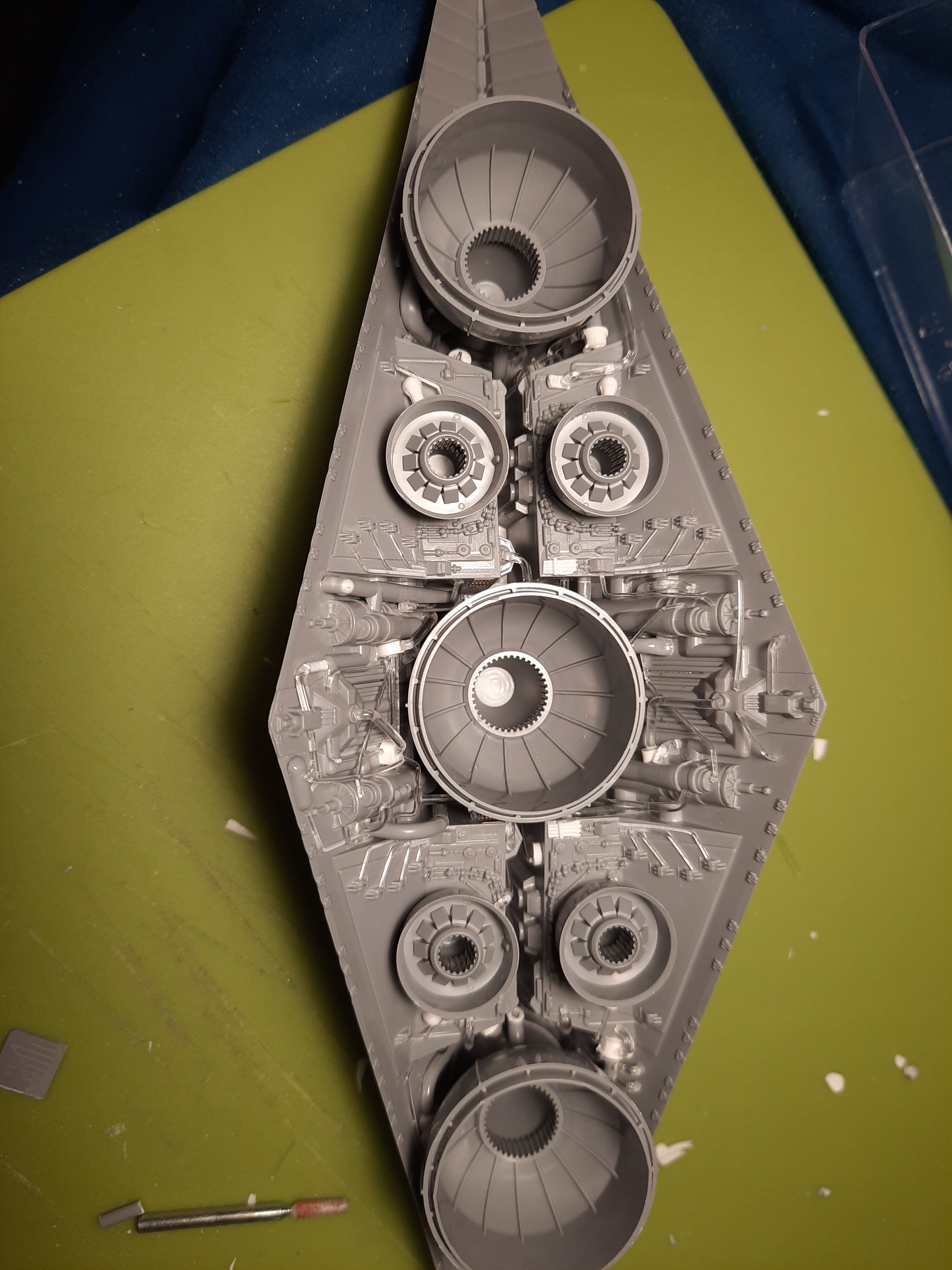

I started off from the engine section:
Several of these details will be amended much later down the line. I decided to go for thick pipeson the large engine bells.
The white kit parts as well as the brass railings are from a very old Titanic kit I never ended up building.

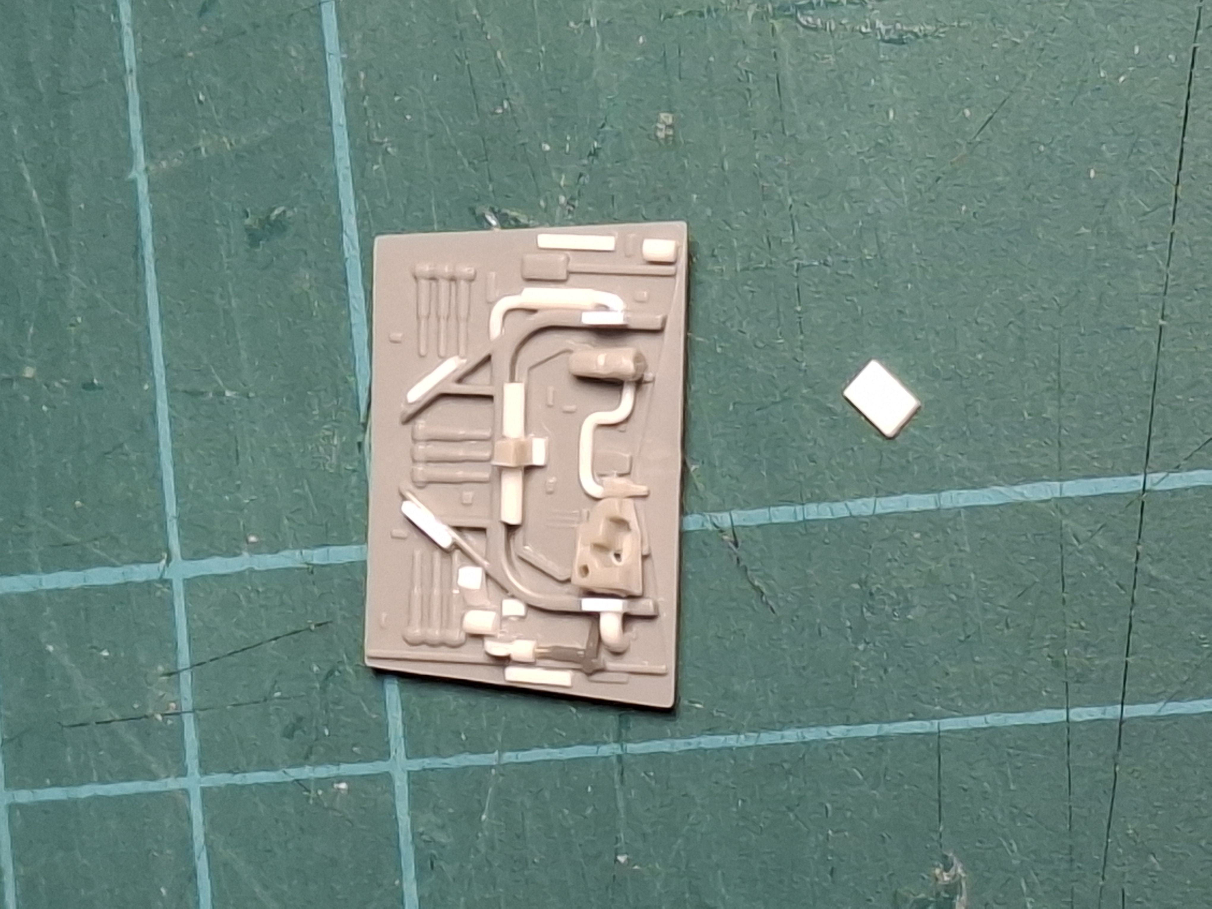

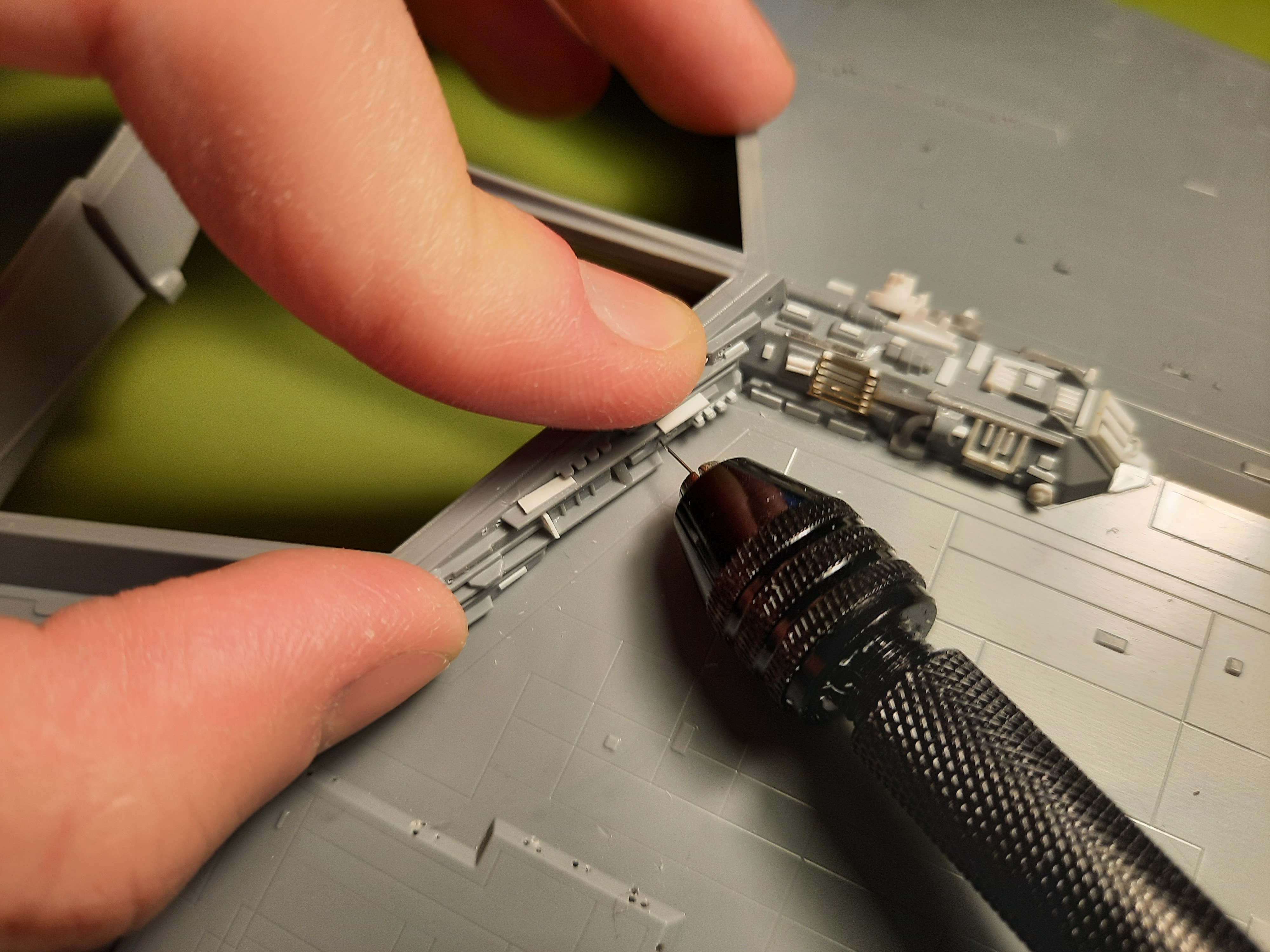

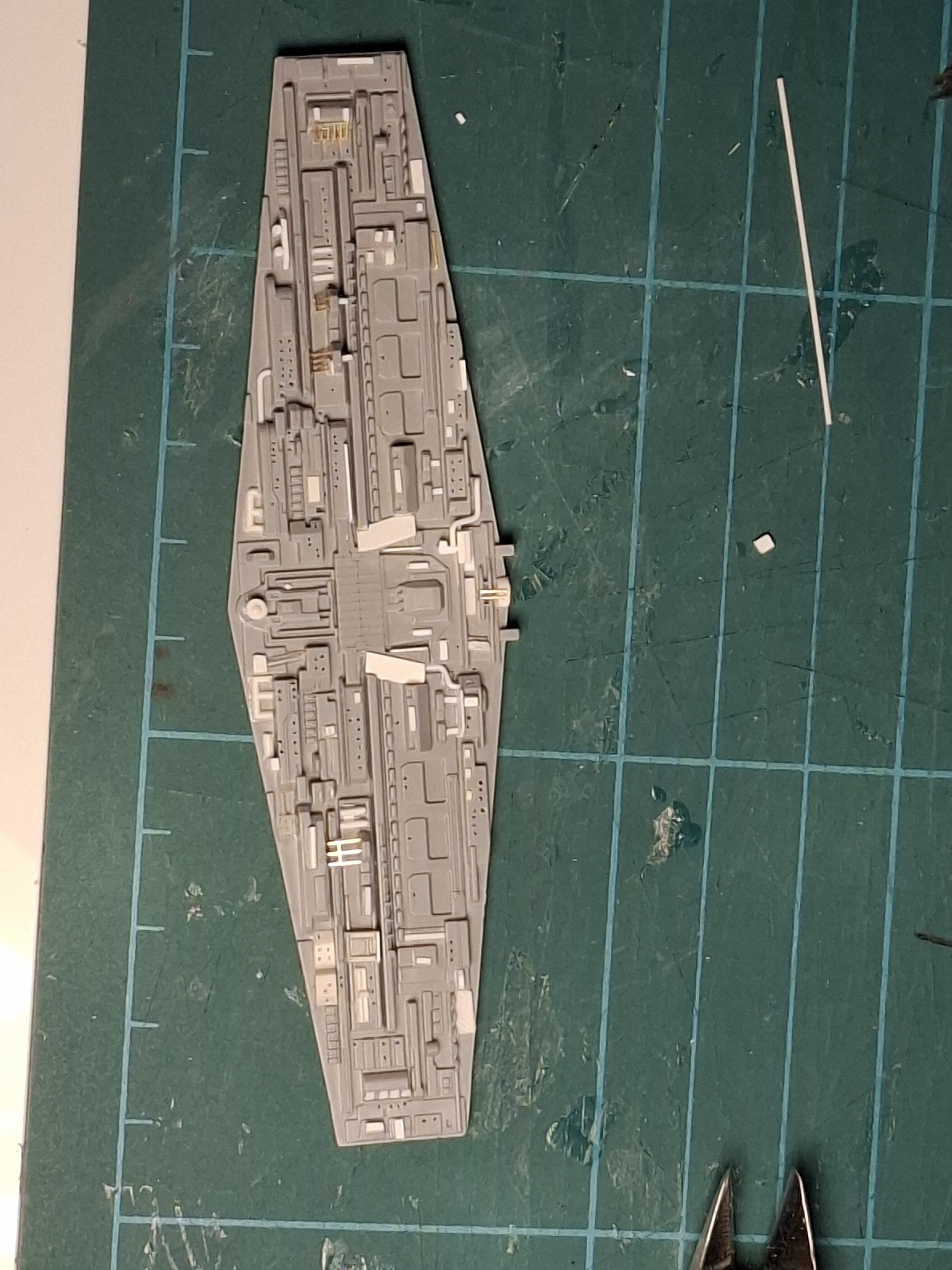

Then I invested in flat styrene strips and 0.3mm HSS micro-drill bits.
These are the olny ones that don't snap after 2 holes drilled, but they require low speed and care not to gunk up the bit with melted plastic.

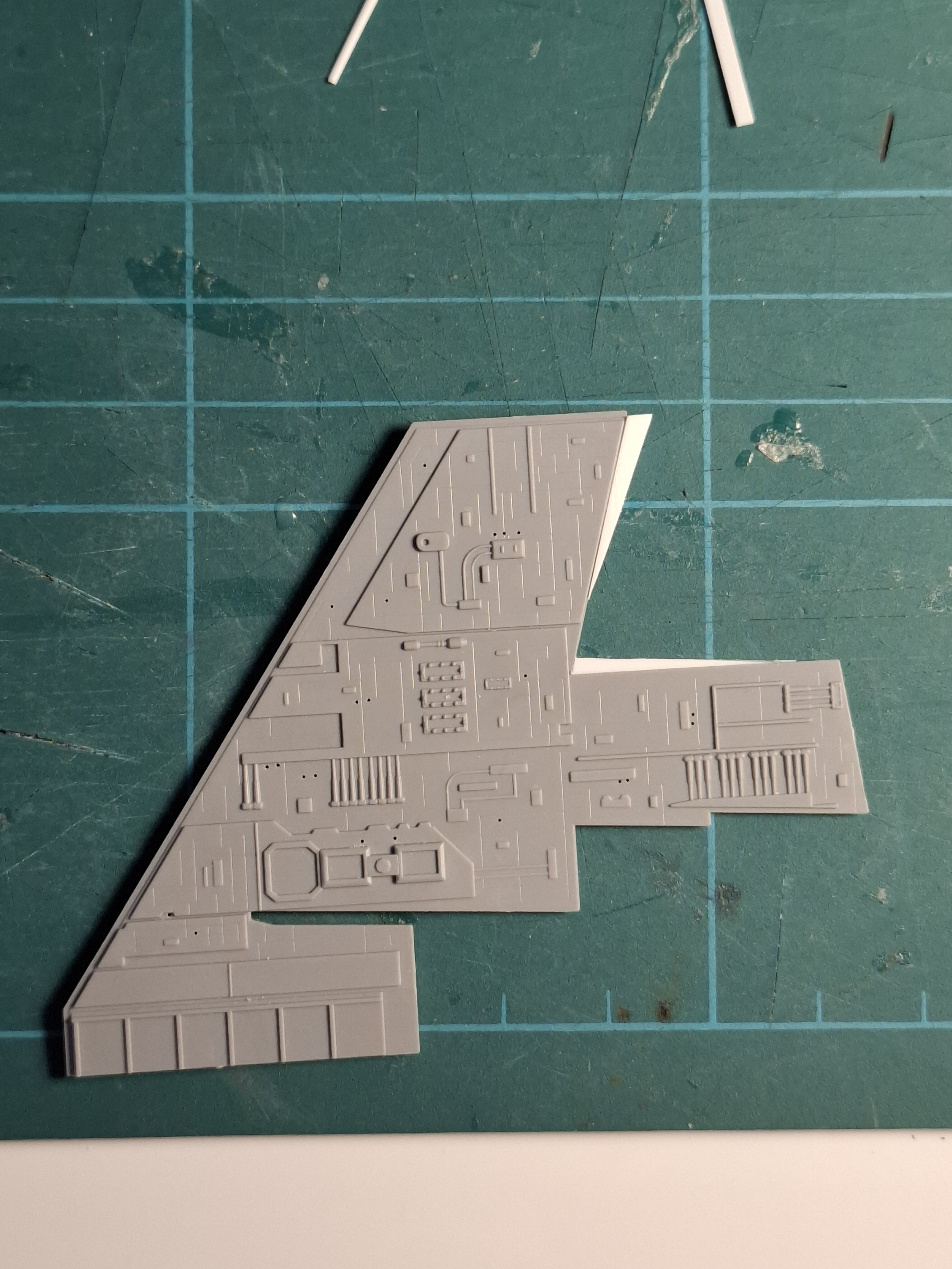

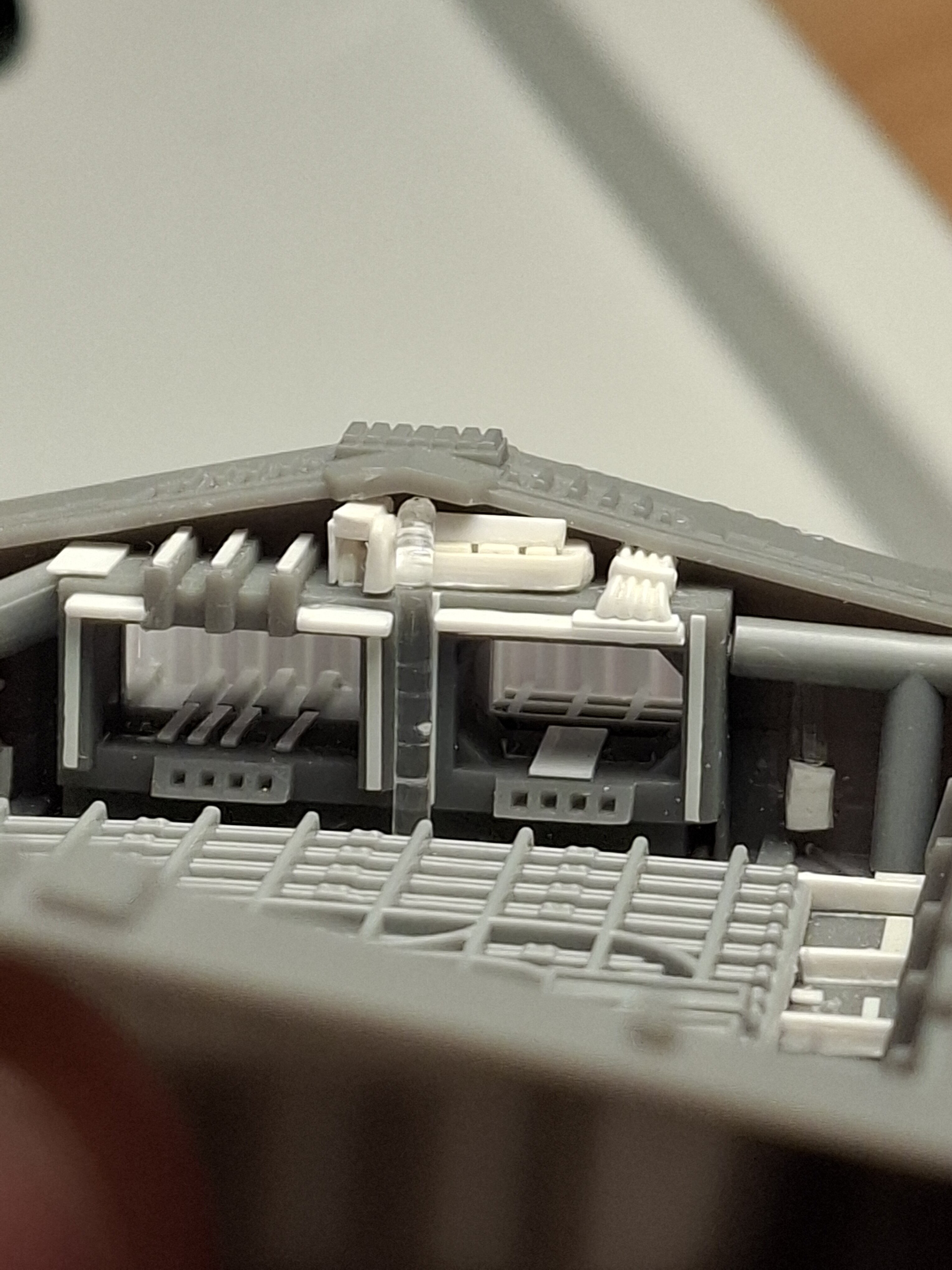

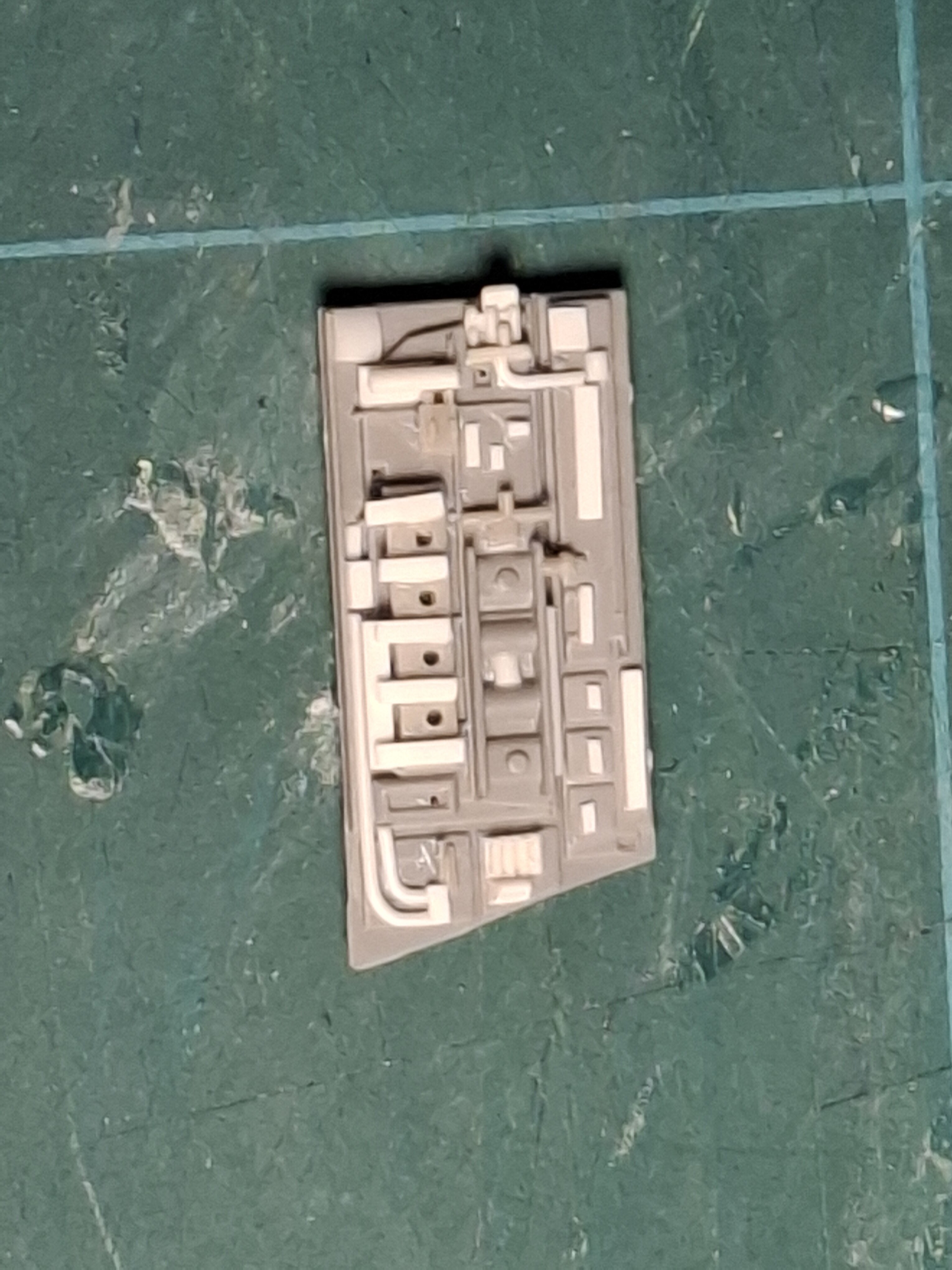

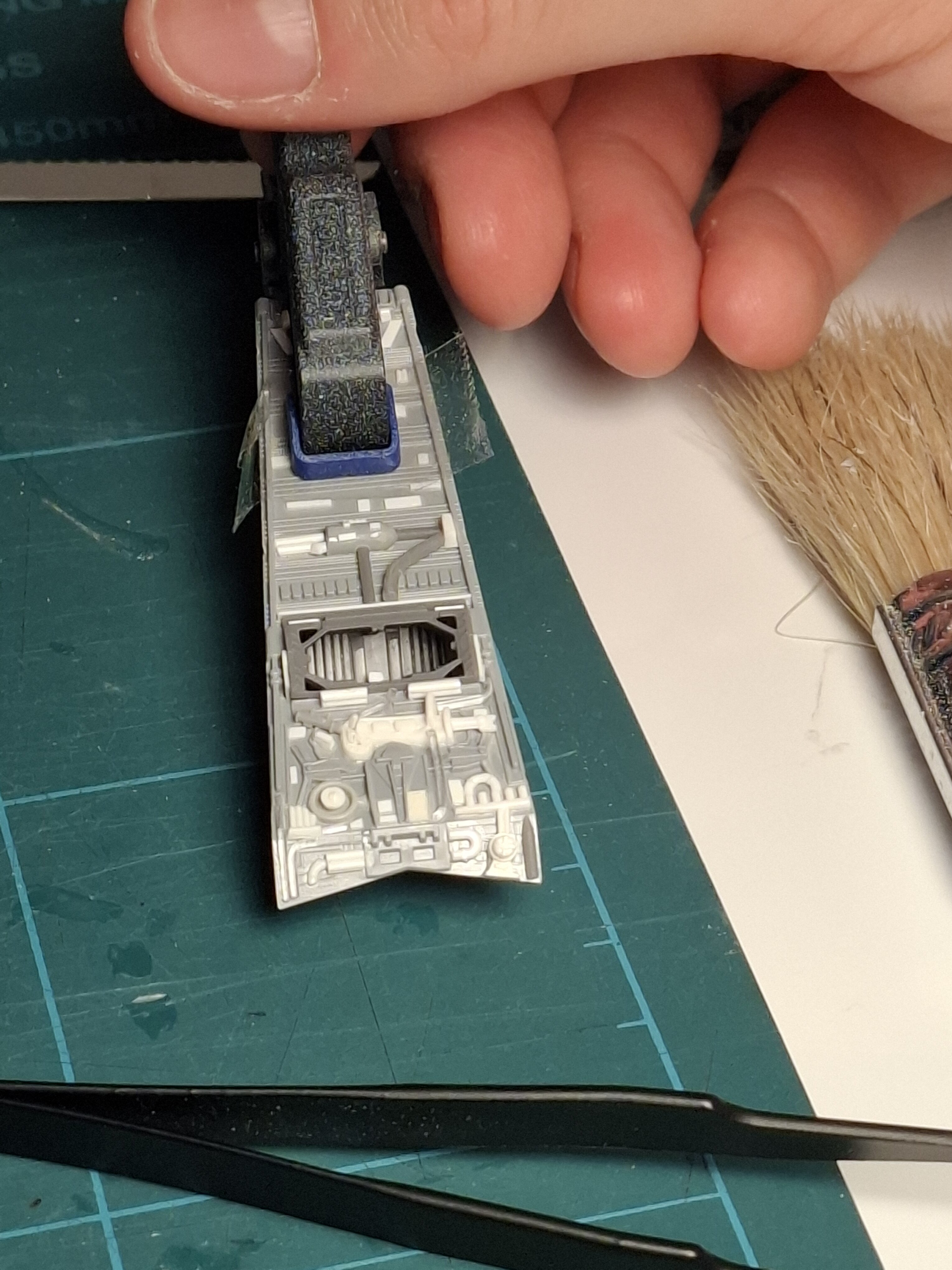

Time for the bridge faceplate (This will receive more detailing years on):

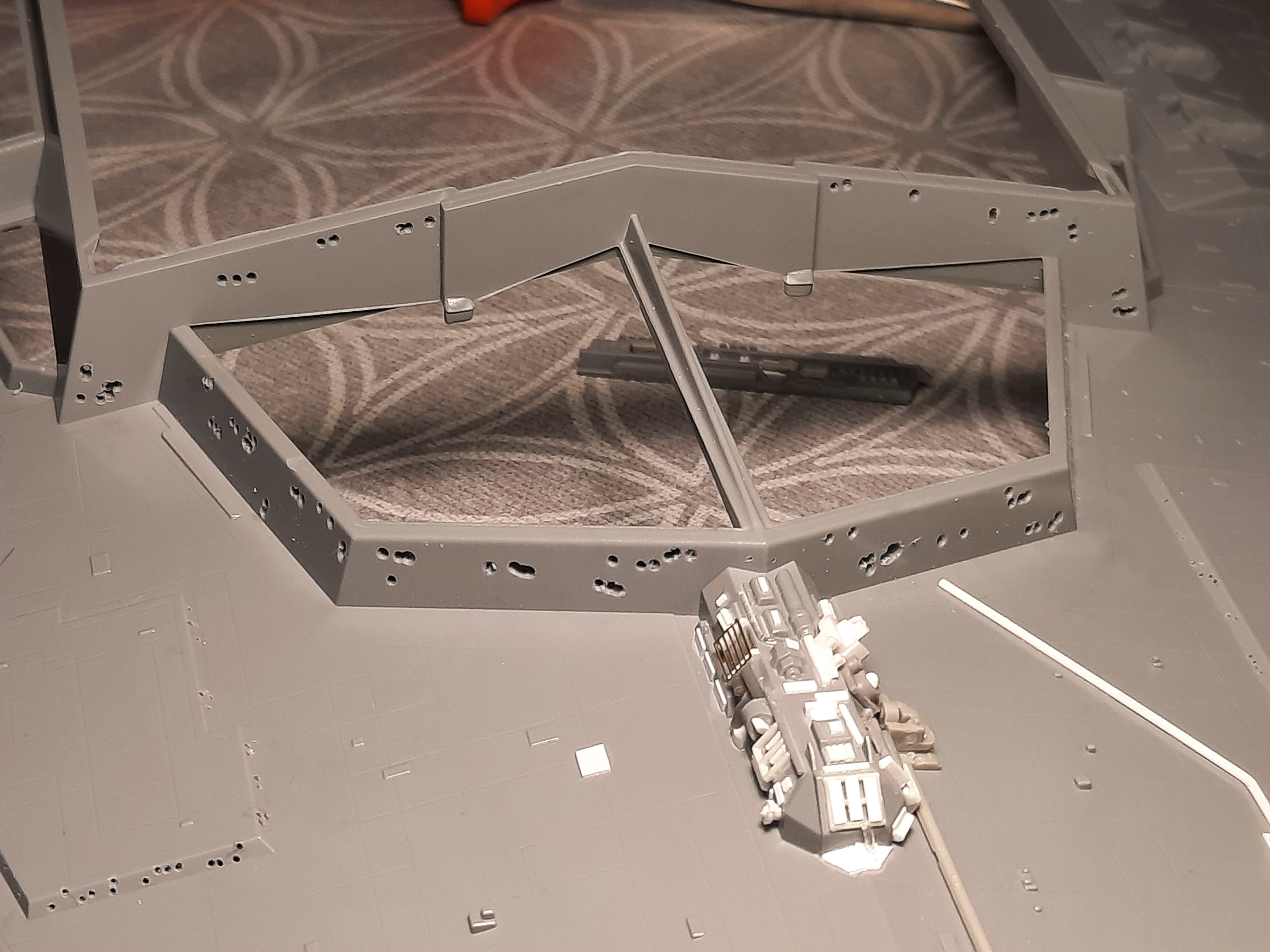

First holes drilled in the top hull islands, with qa couple accidents here and there:

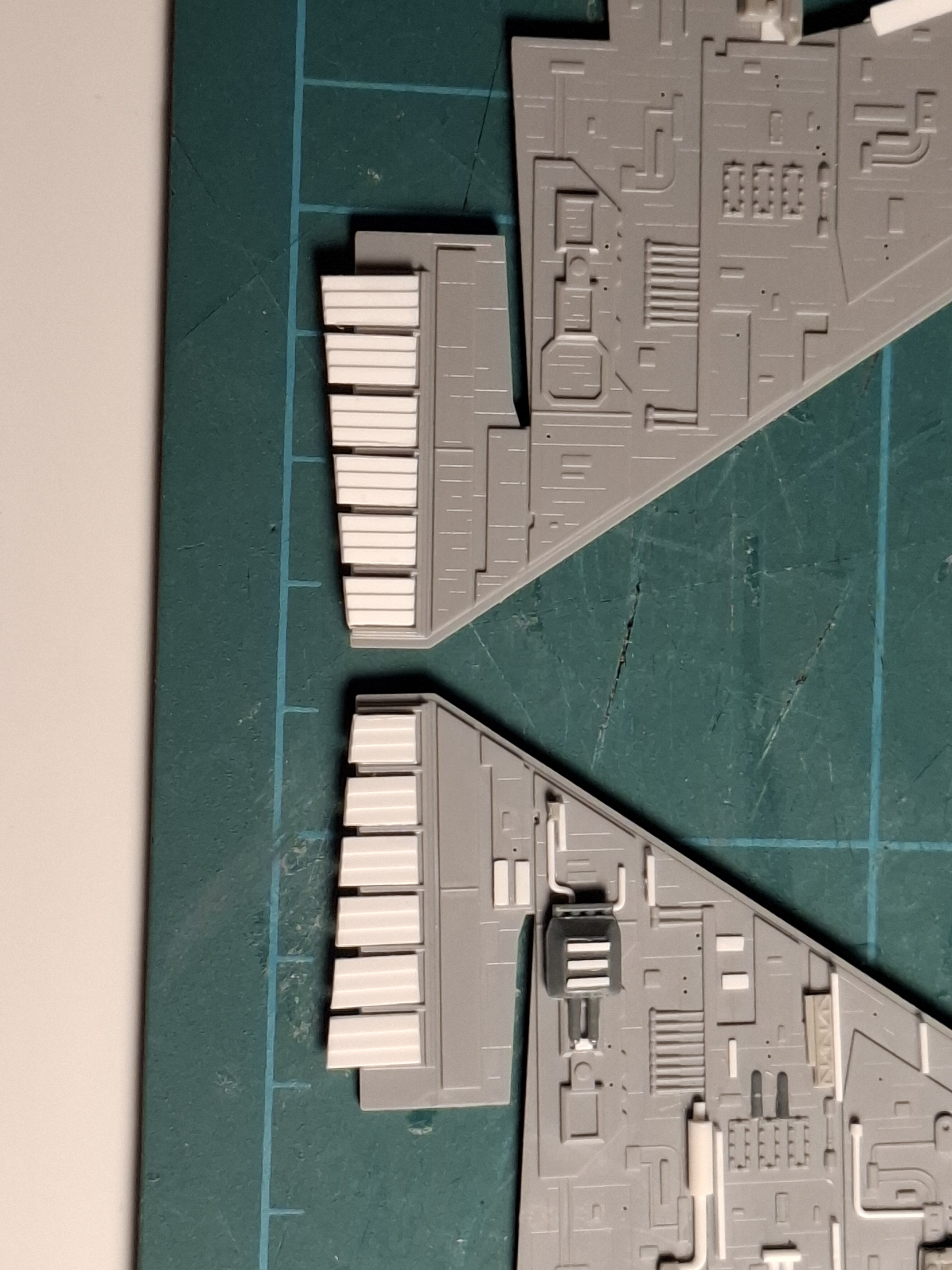

It's in the middle of this that I invested in the Falcon3D parts set.

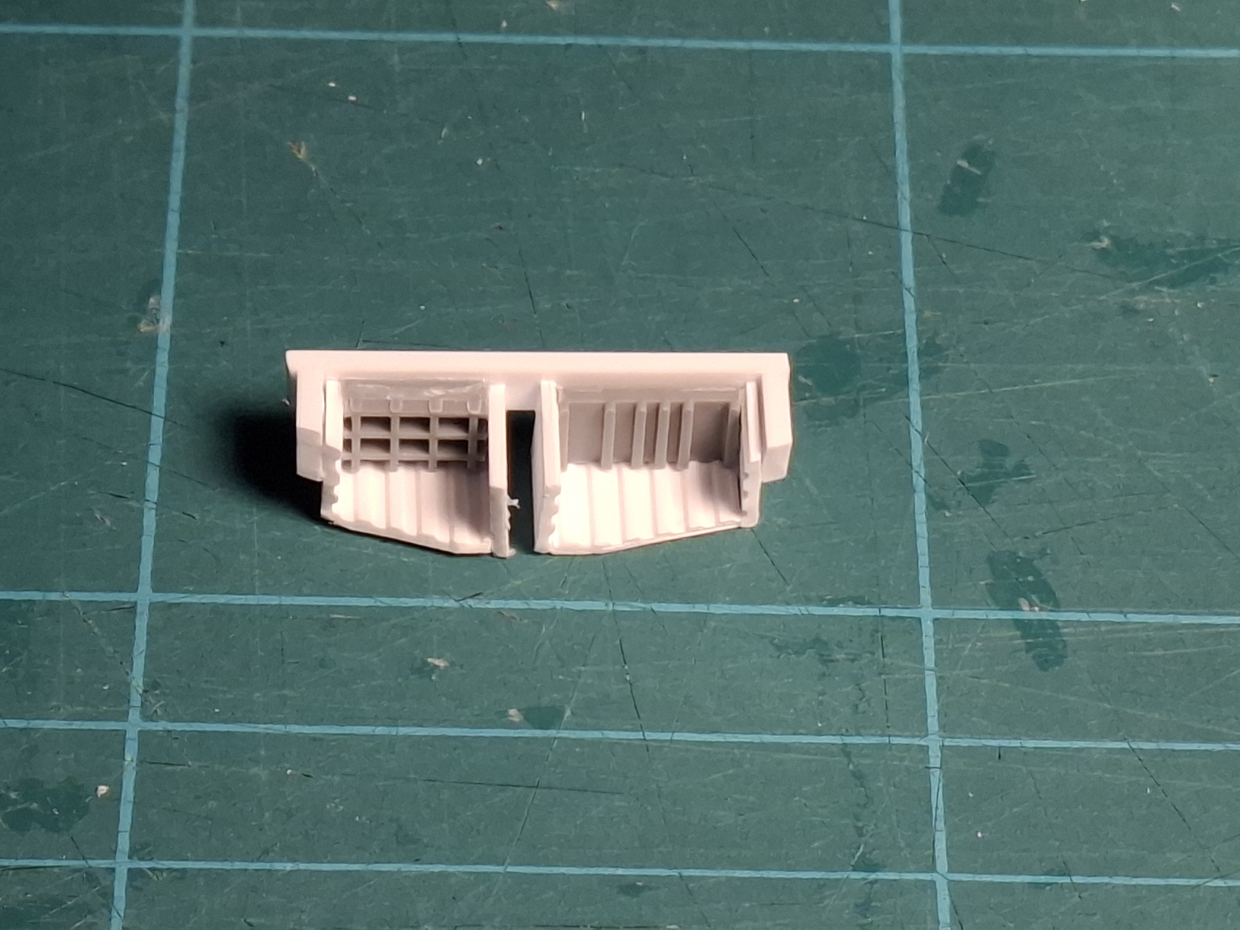

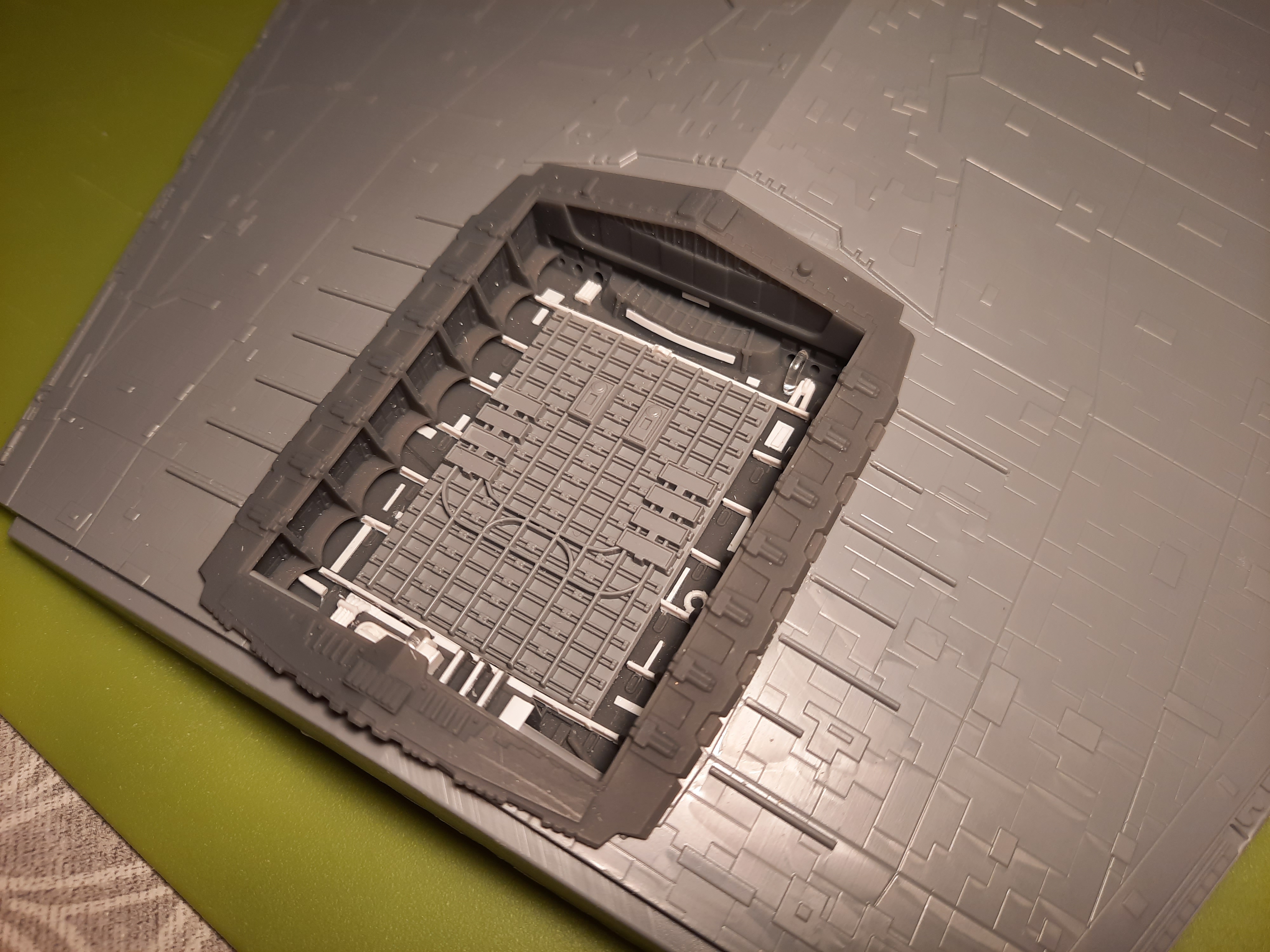

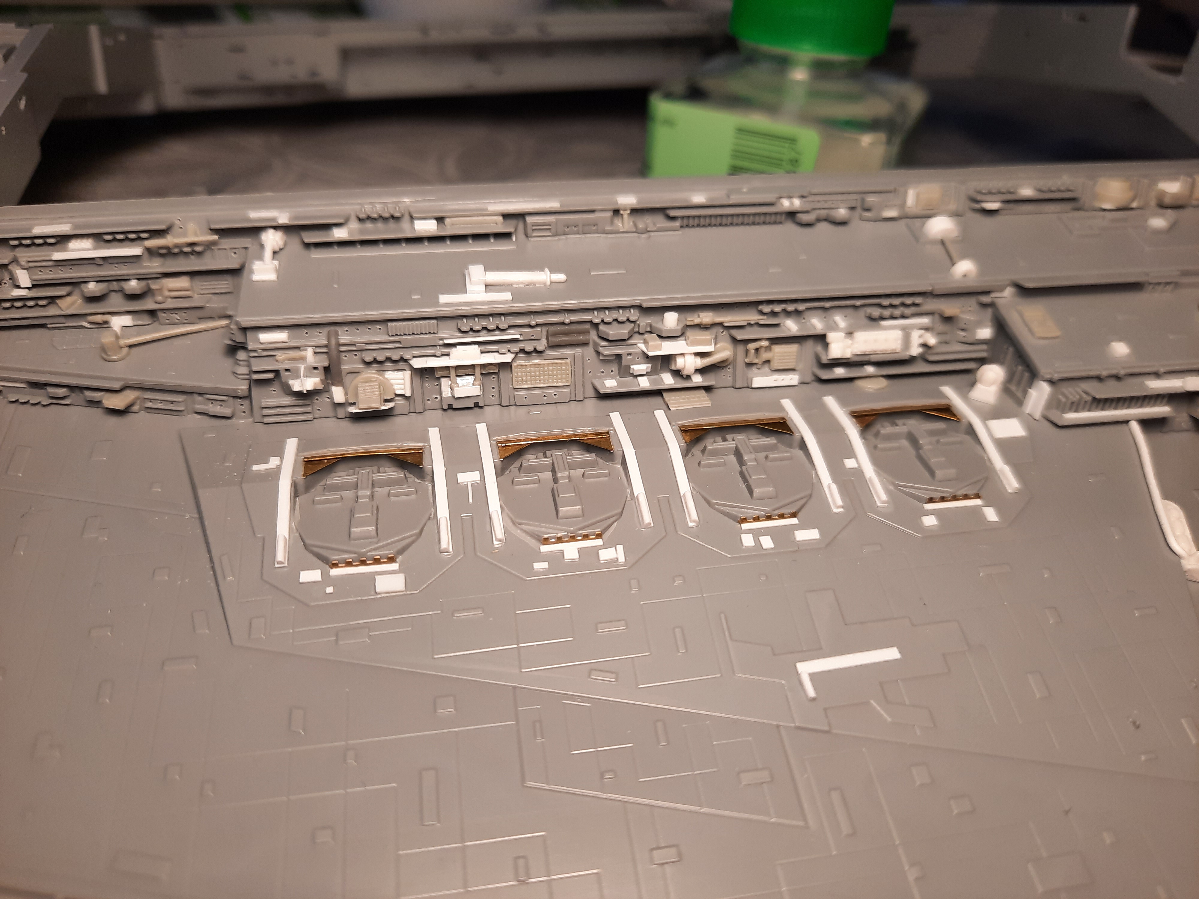

The hangar receives further details as well as the 'roofing' harvested from the original Revell hangar:

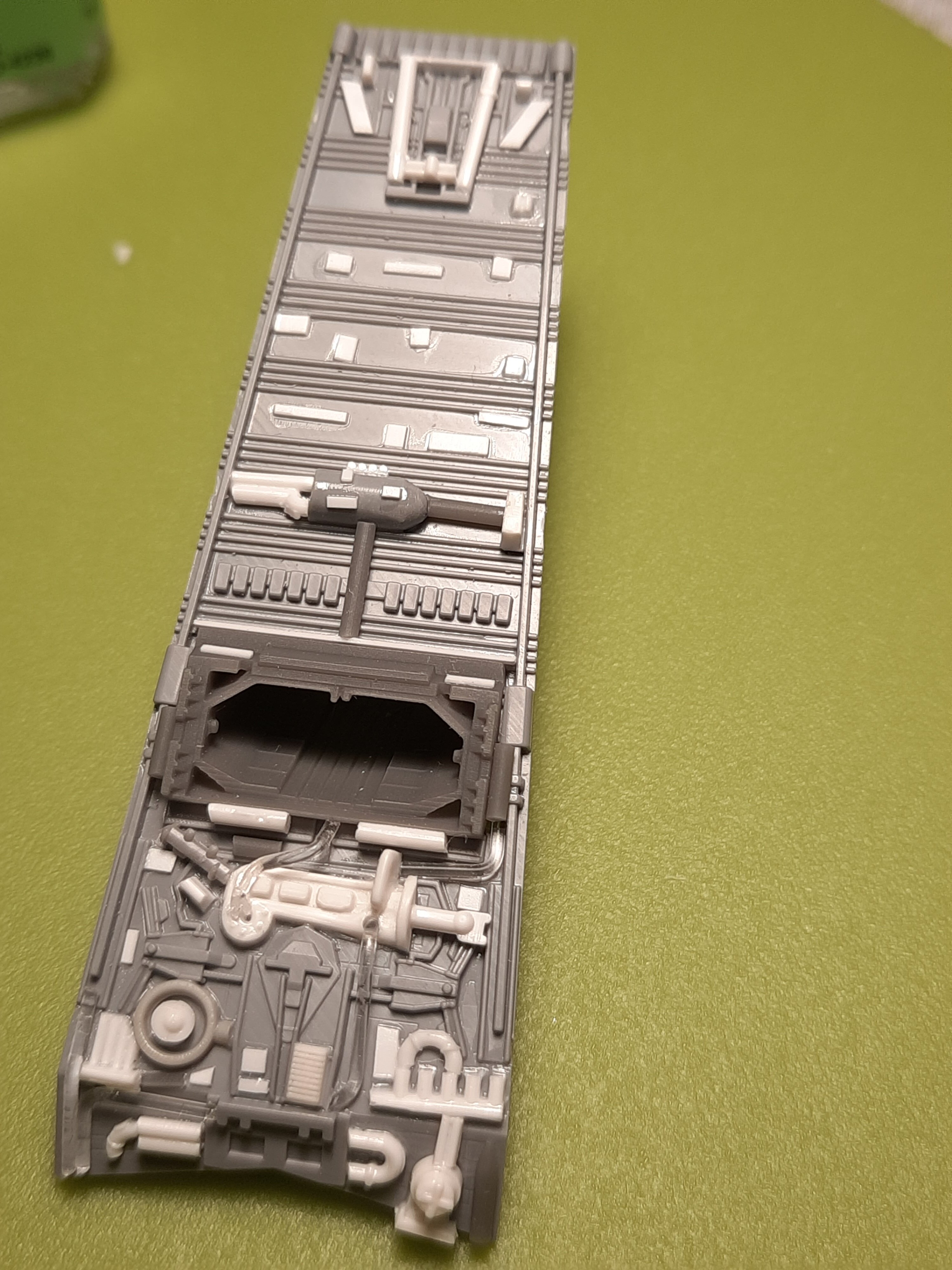

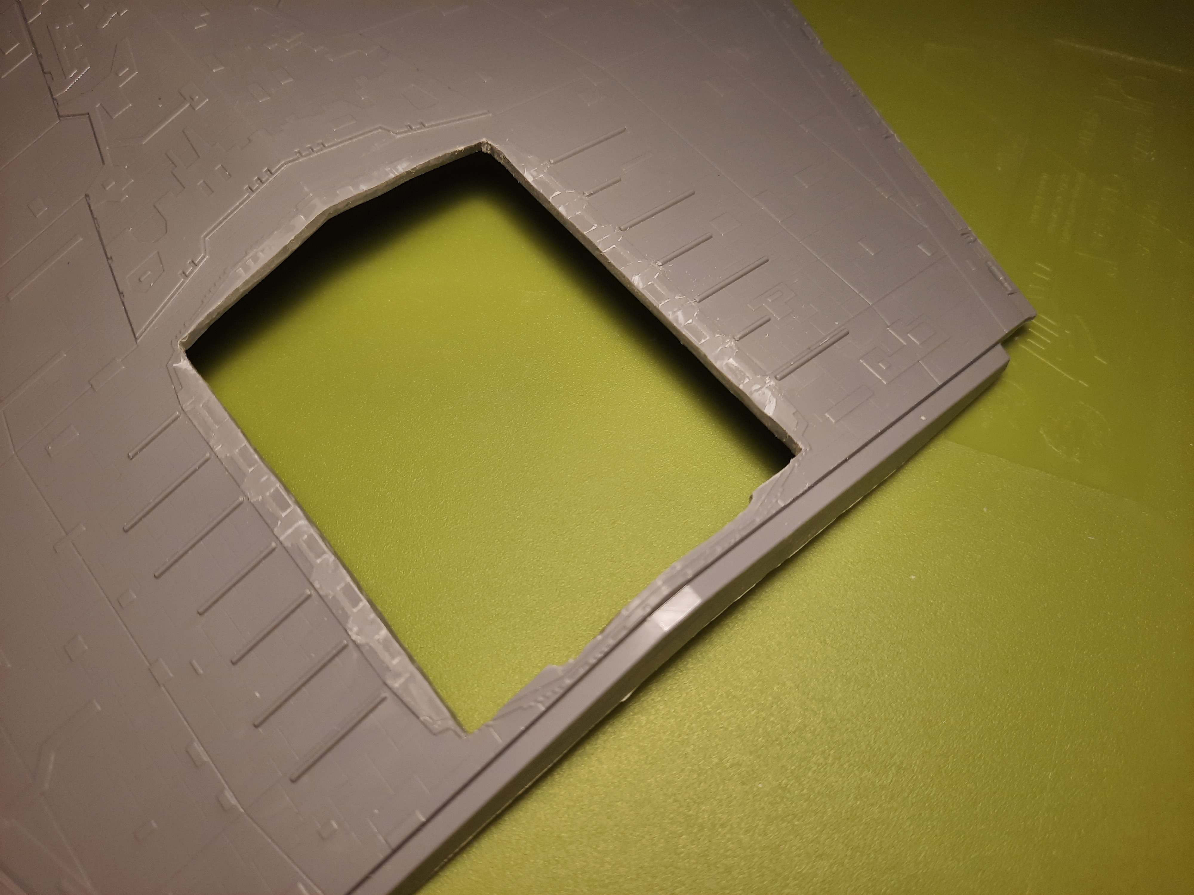

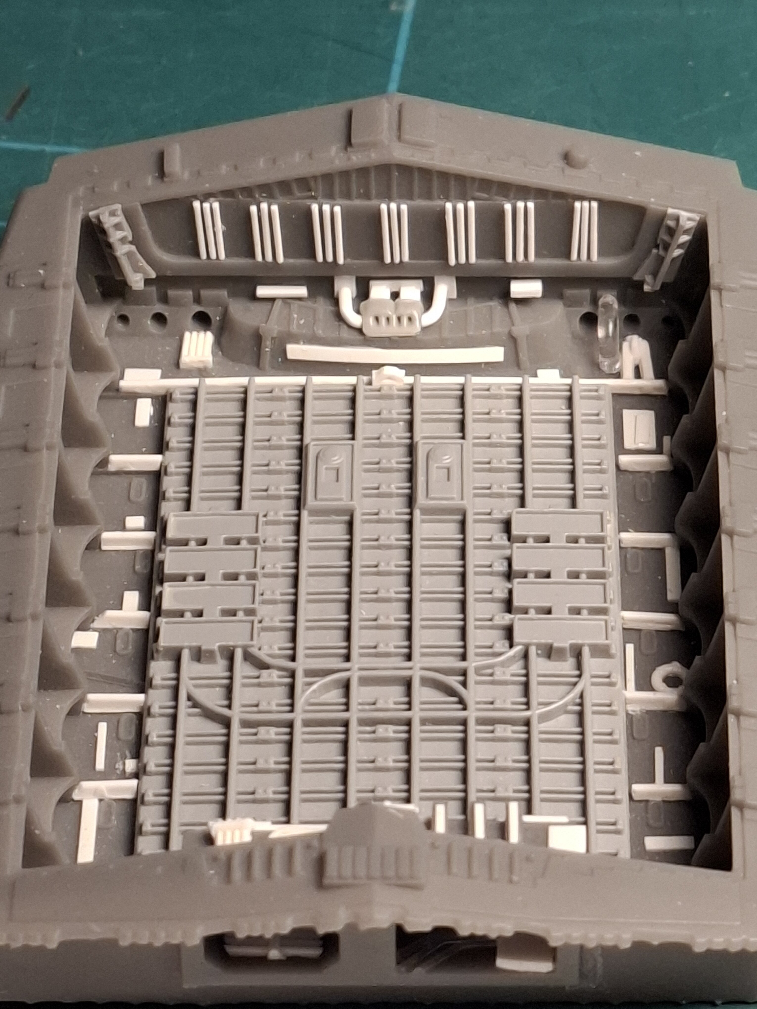

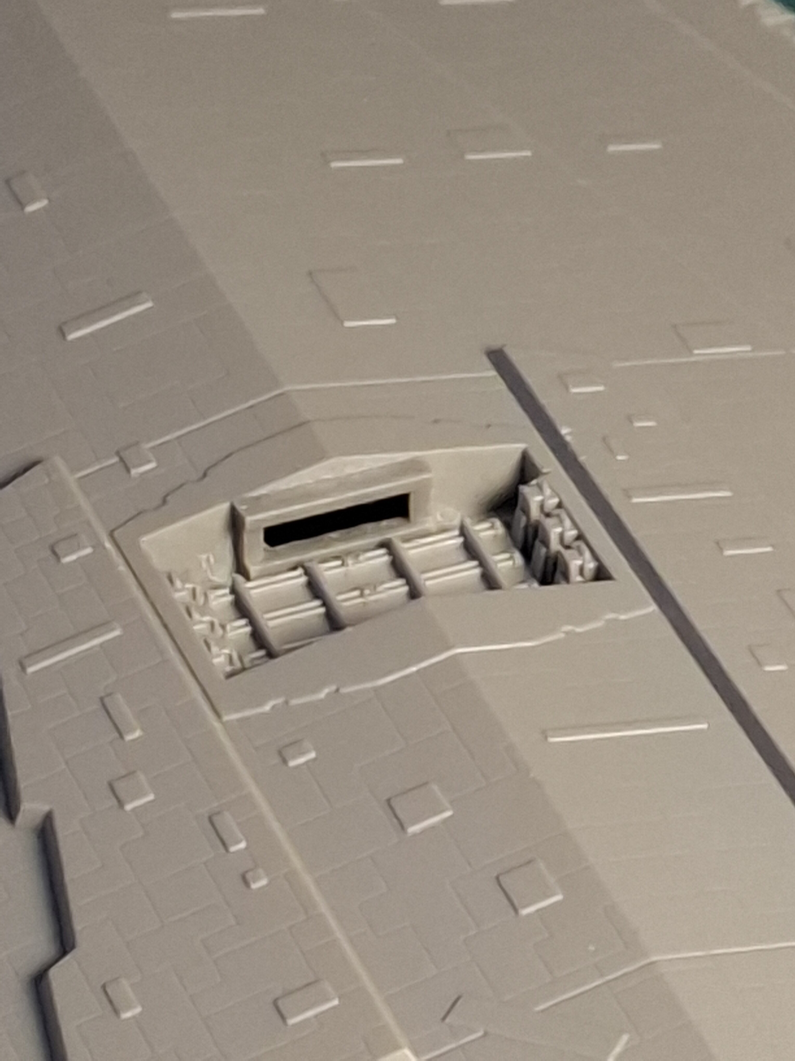

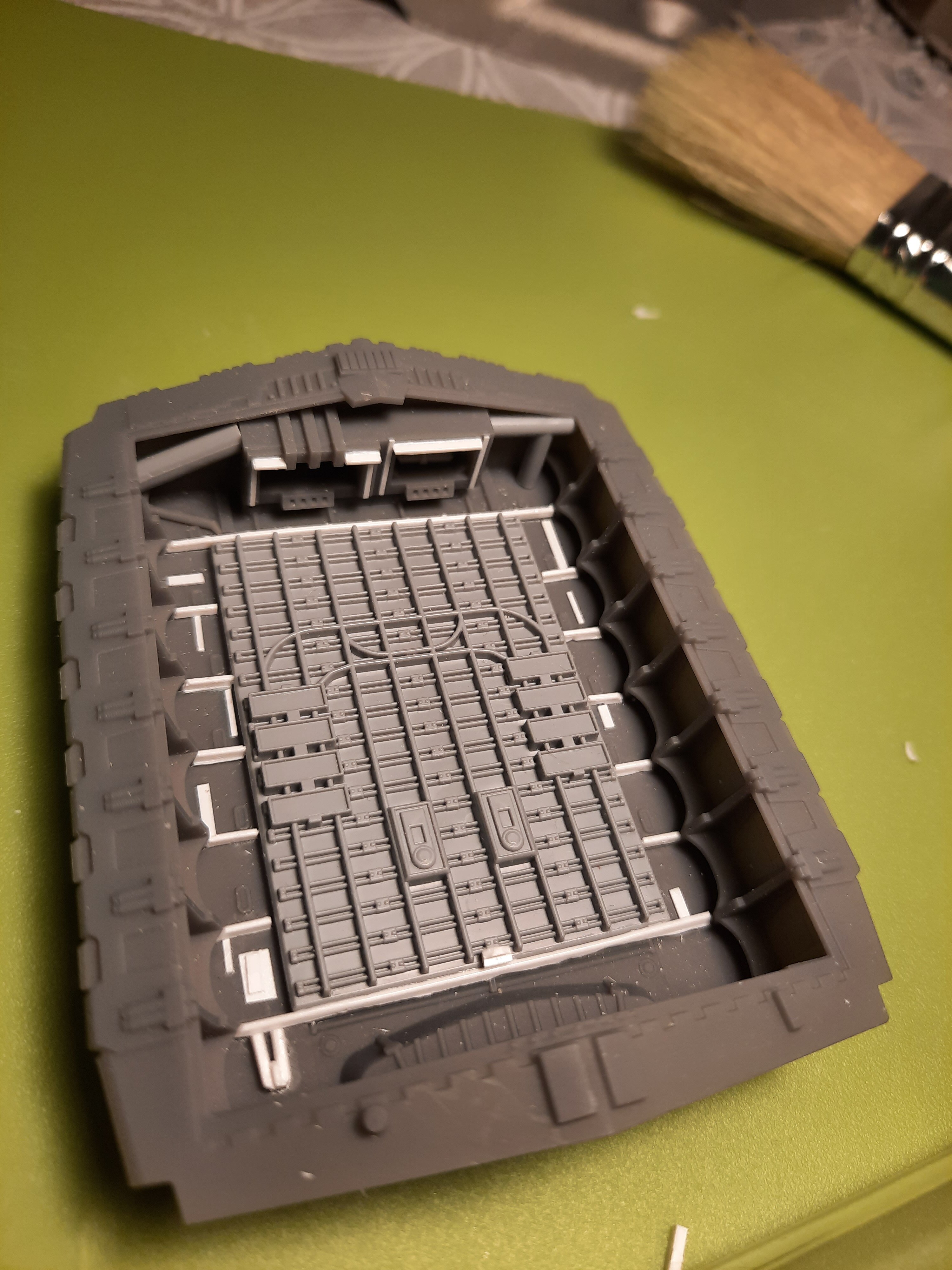

The hangar section of the lower hull is excavated and flattened, no hull details yet:

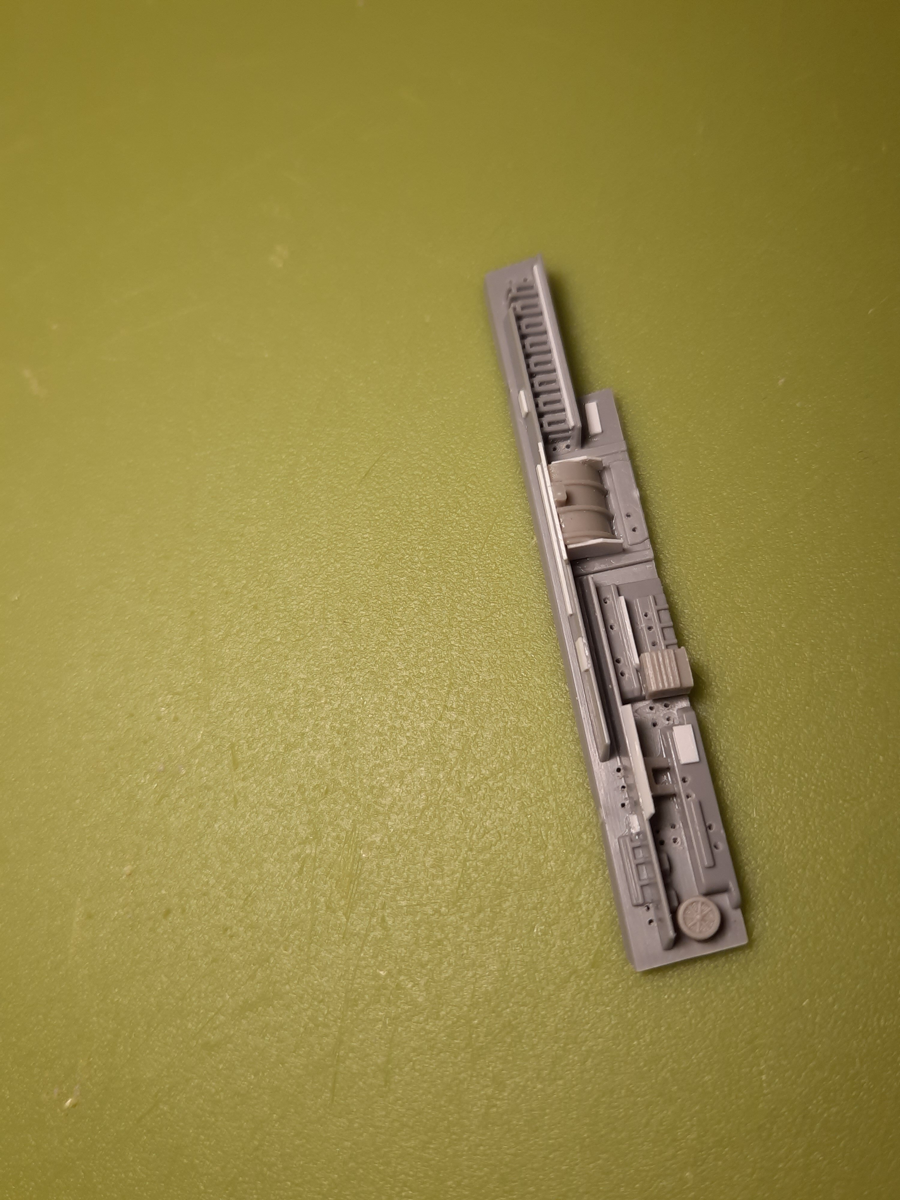

The tower spine also gets the waste chute part, still open at the far end as I hadn't worked out the LEDs yet:

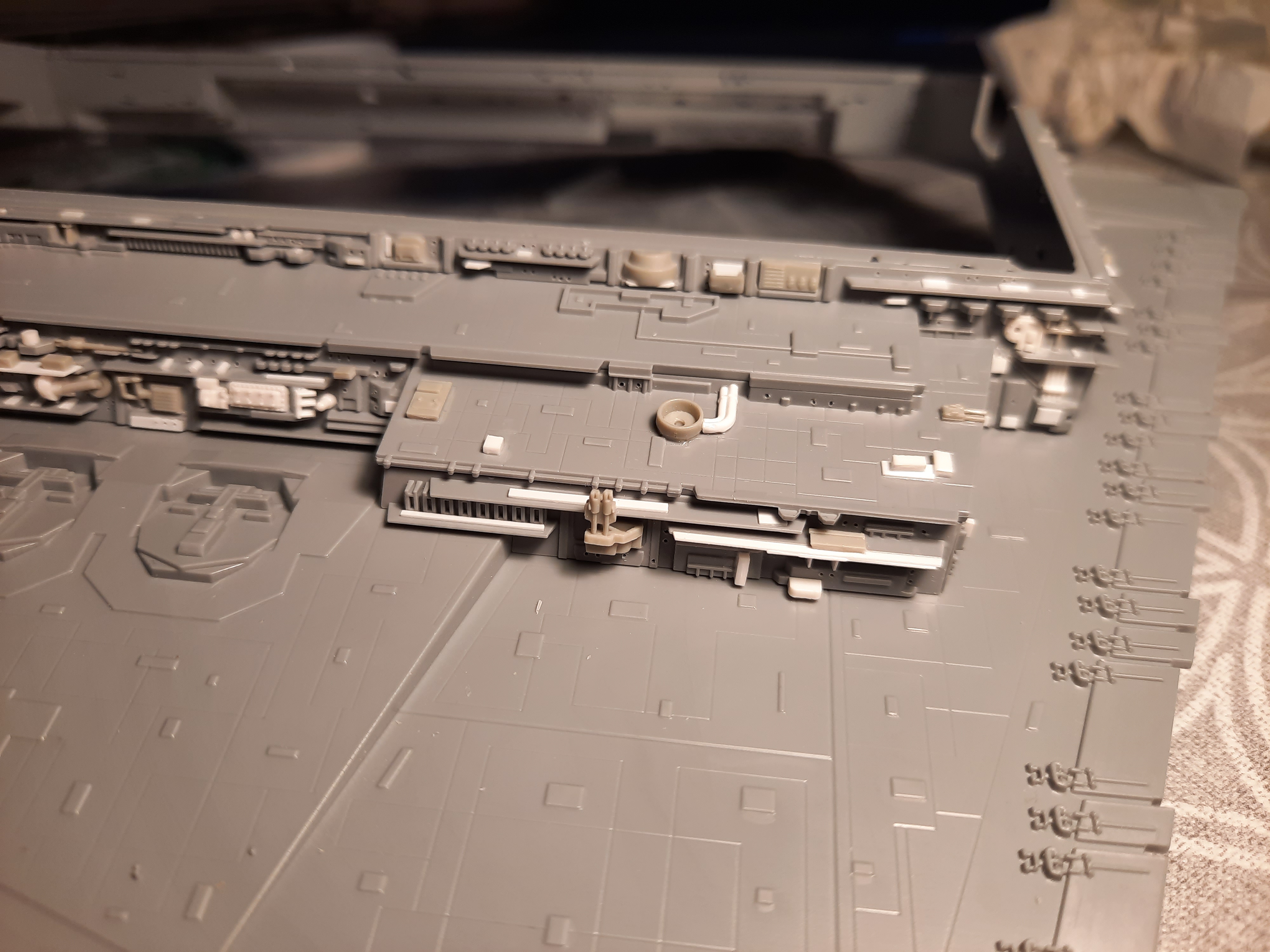

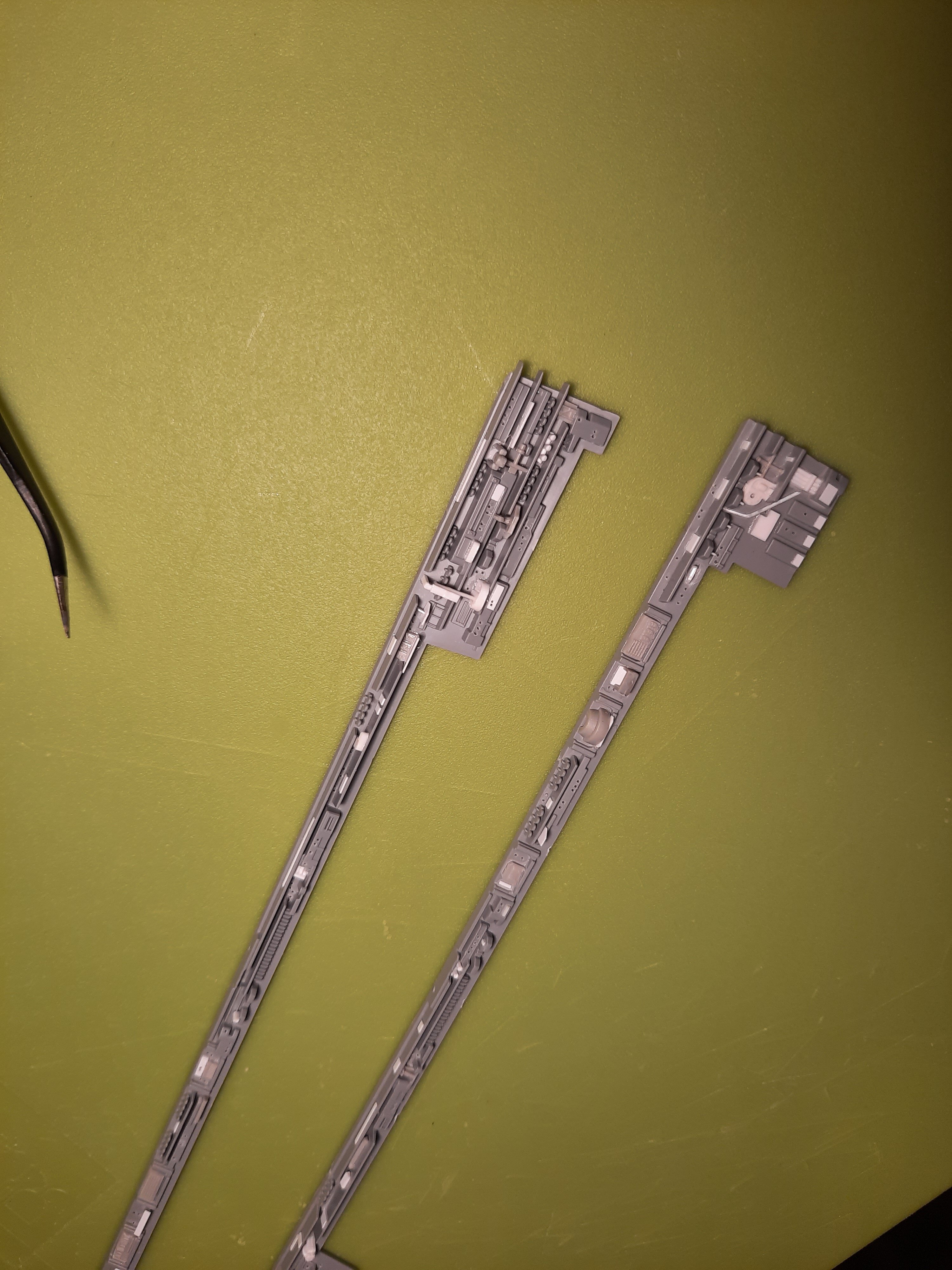

And finally the elongated pier at the front of the superstructure (This will also receive more work):

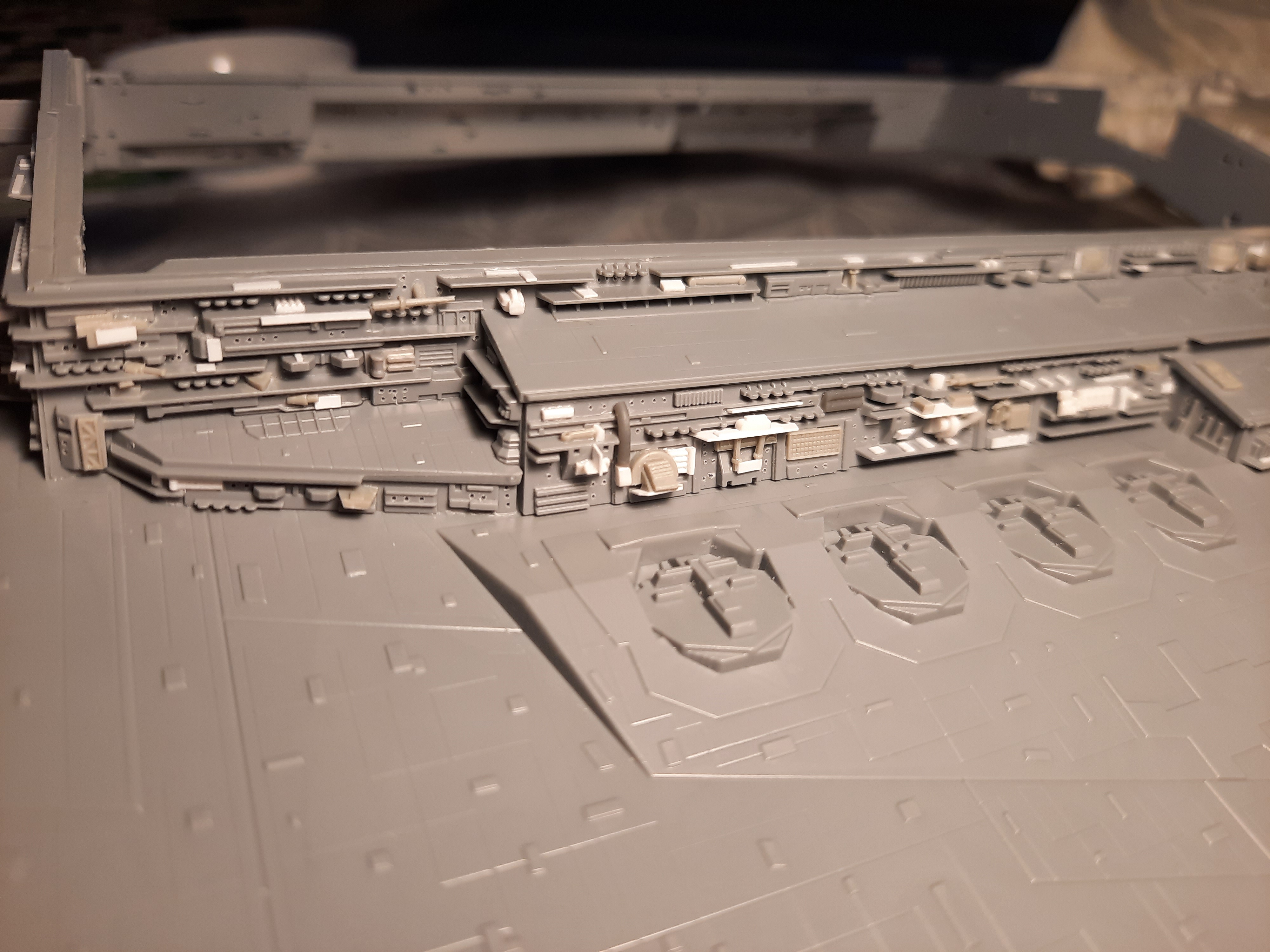

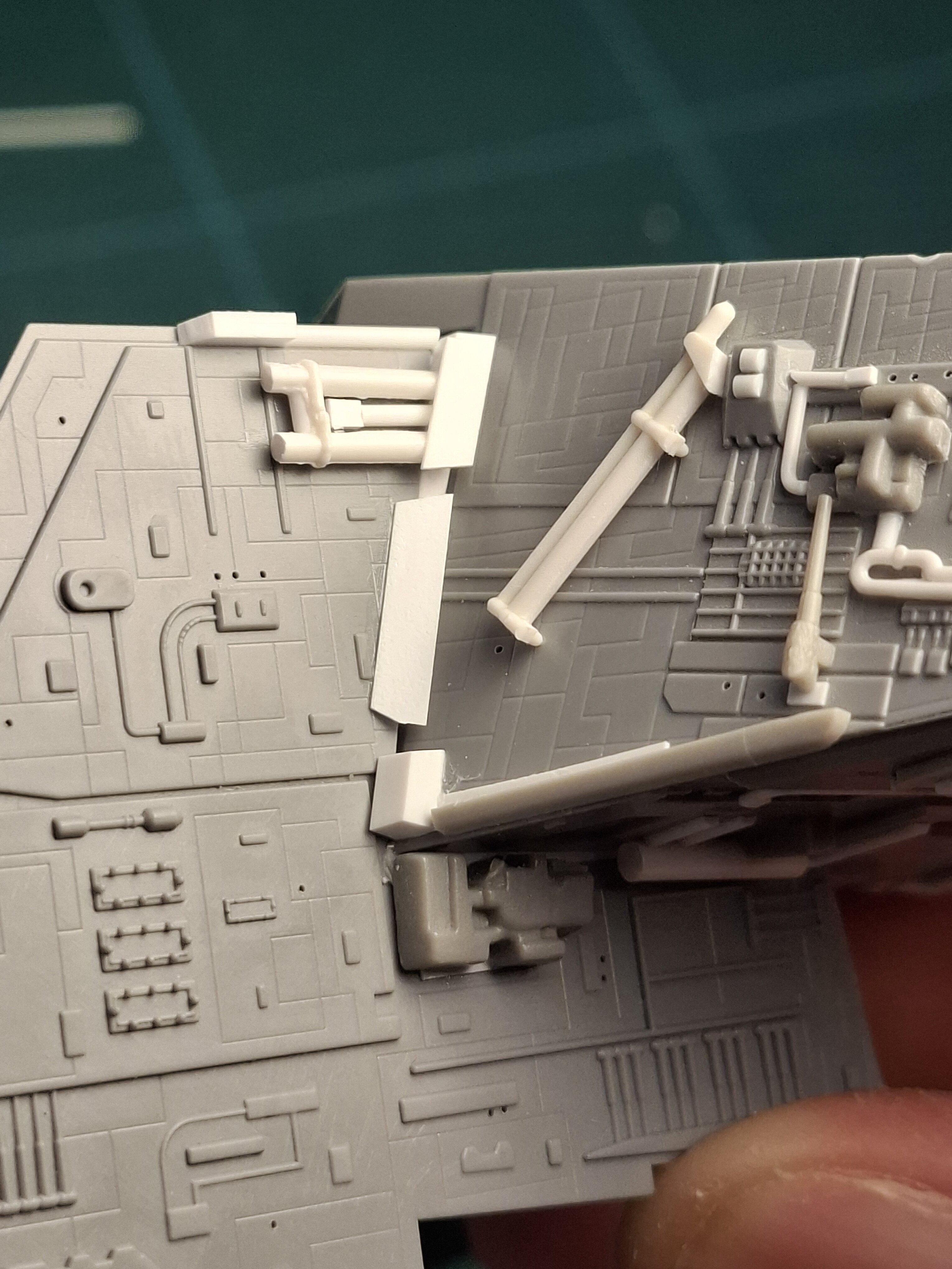

Little details on the forecastle (also not yet finished):
The bridge roof is prepared for the Falcon3D sphere arrays and detailed:

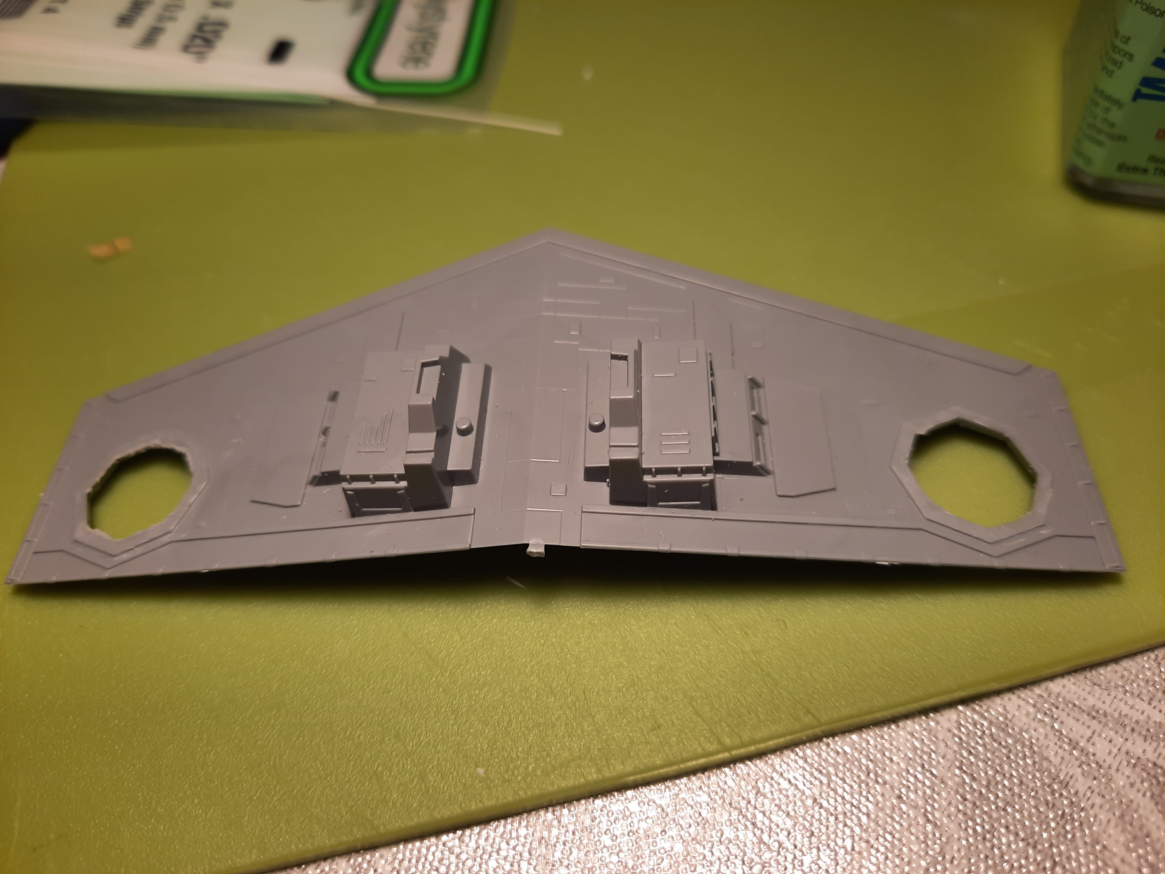

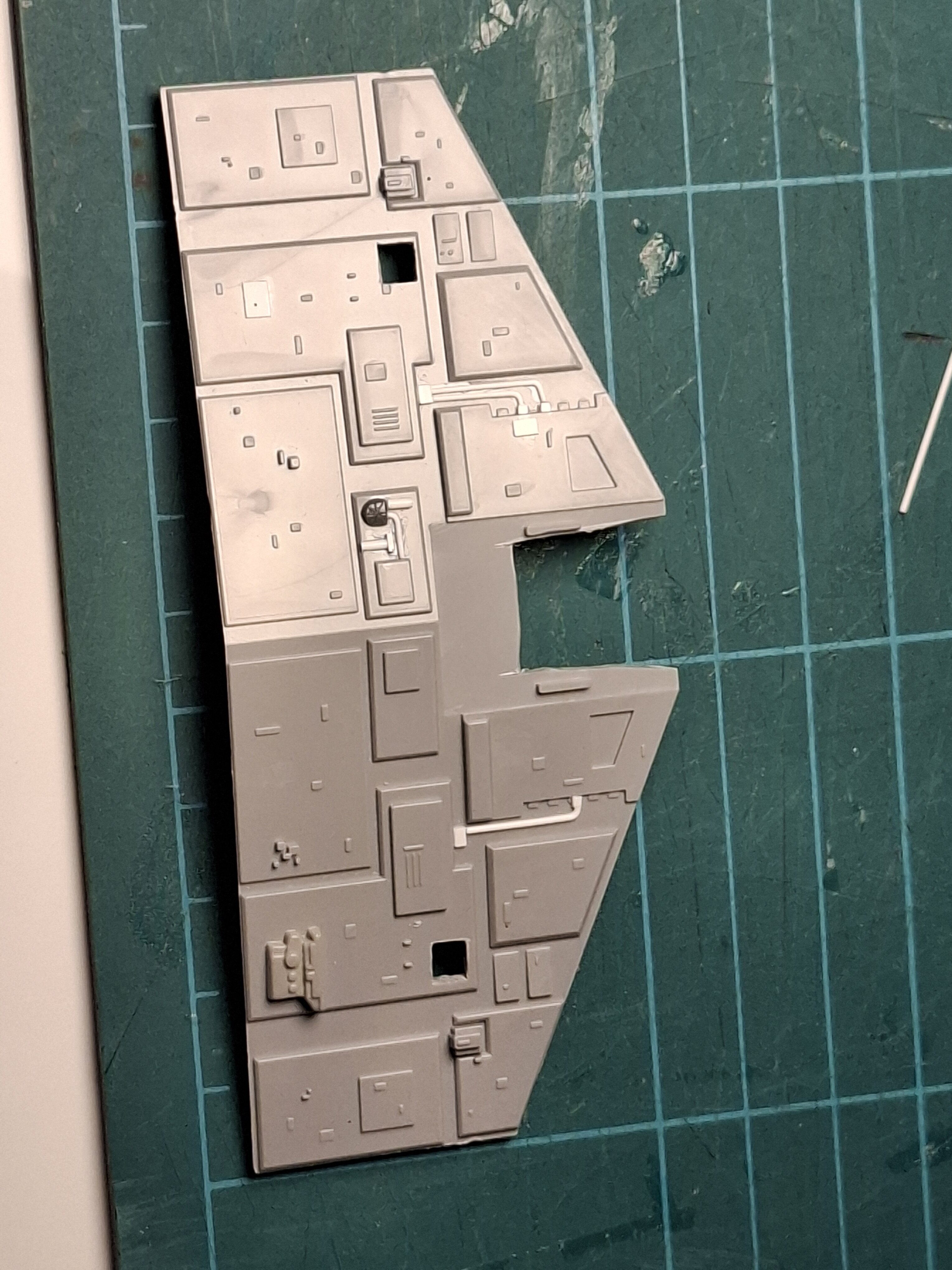

The two the superstructure roof pieces:

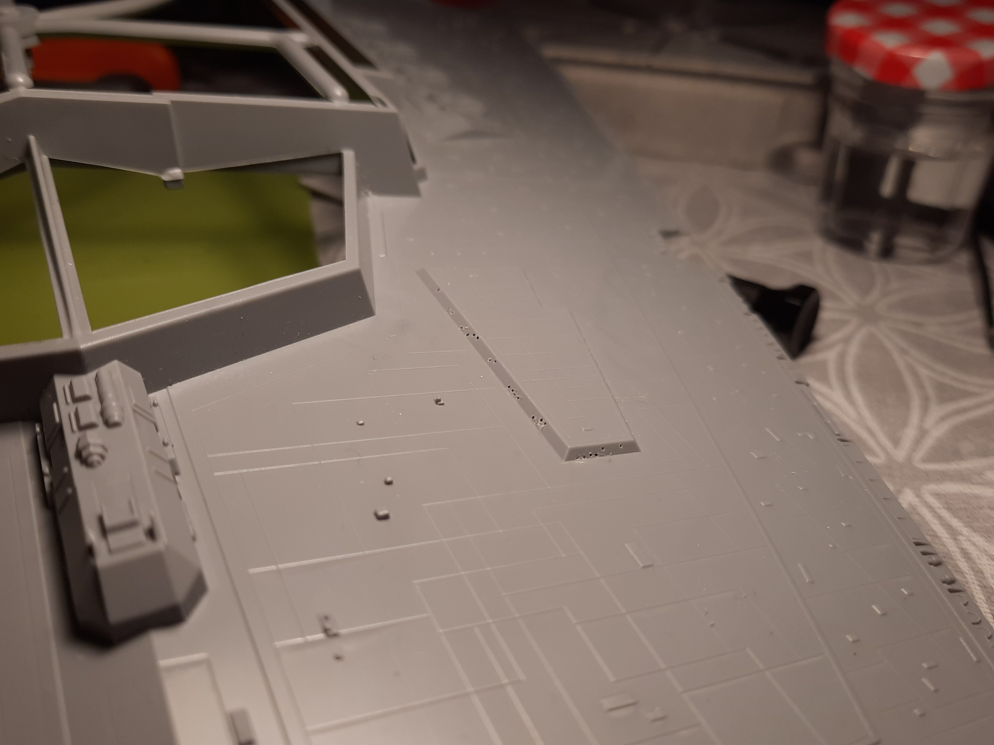

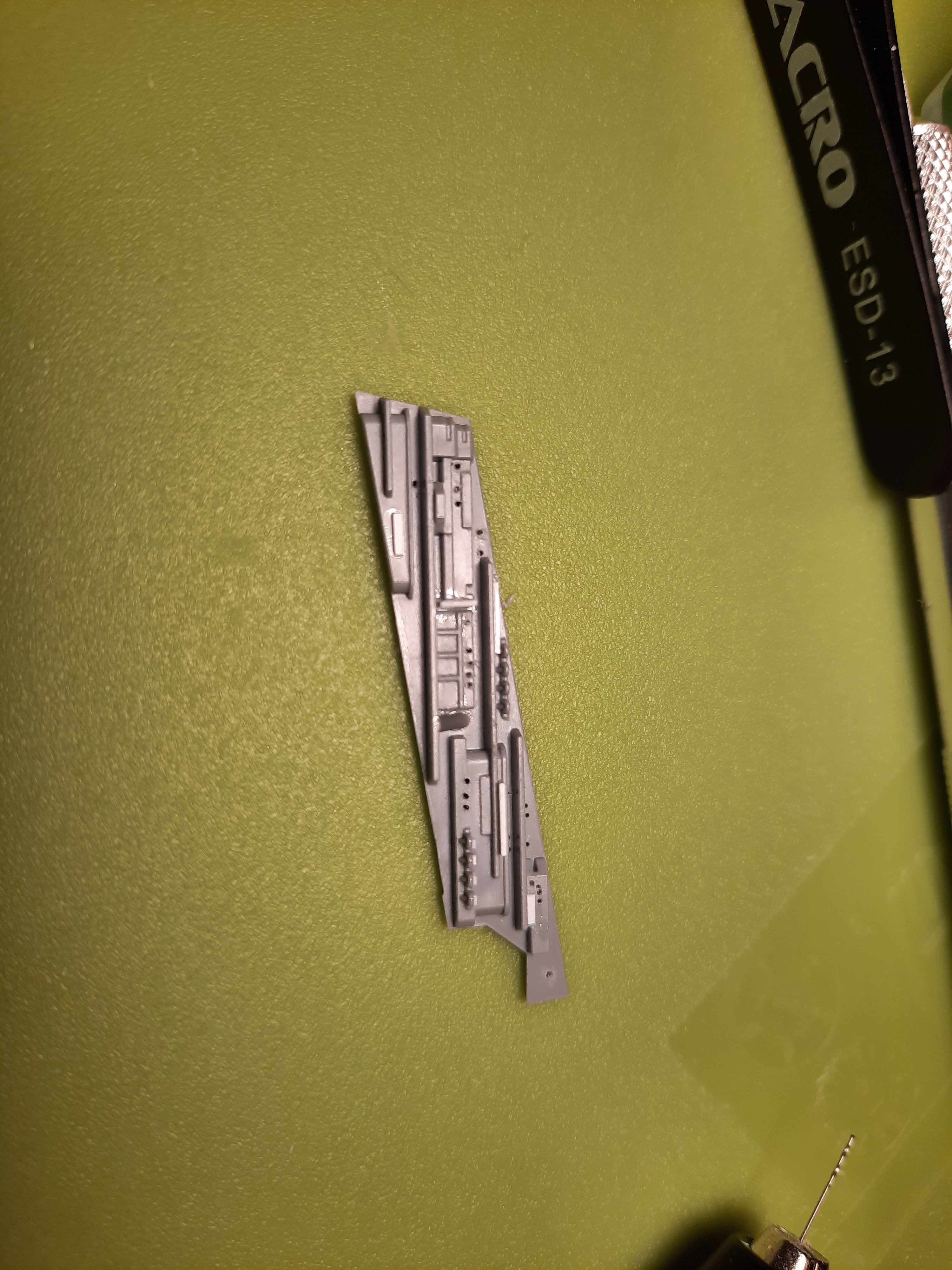

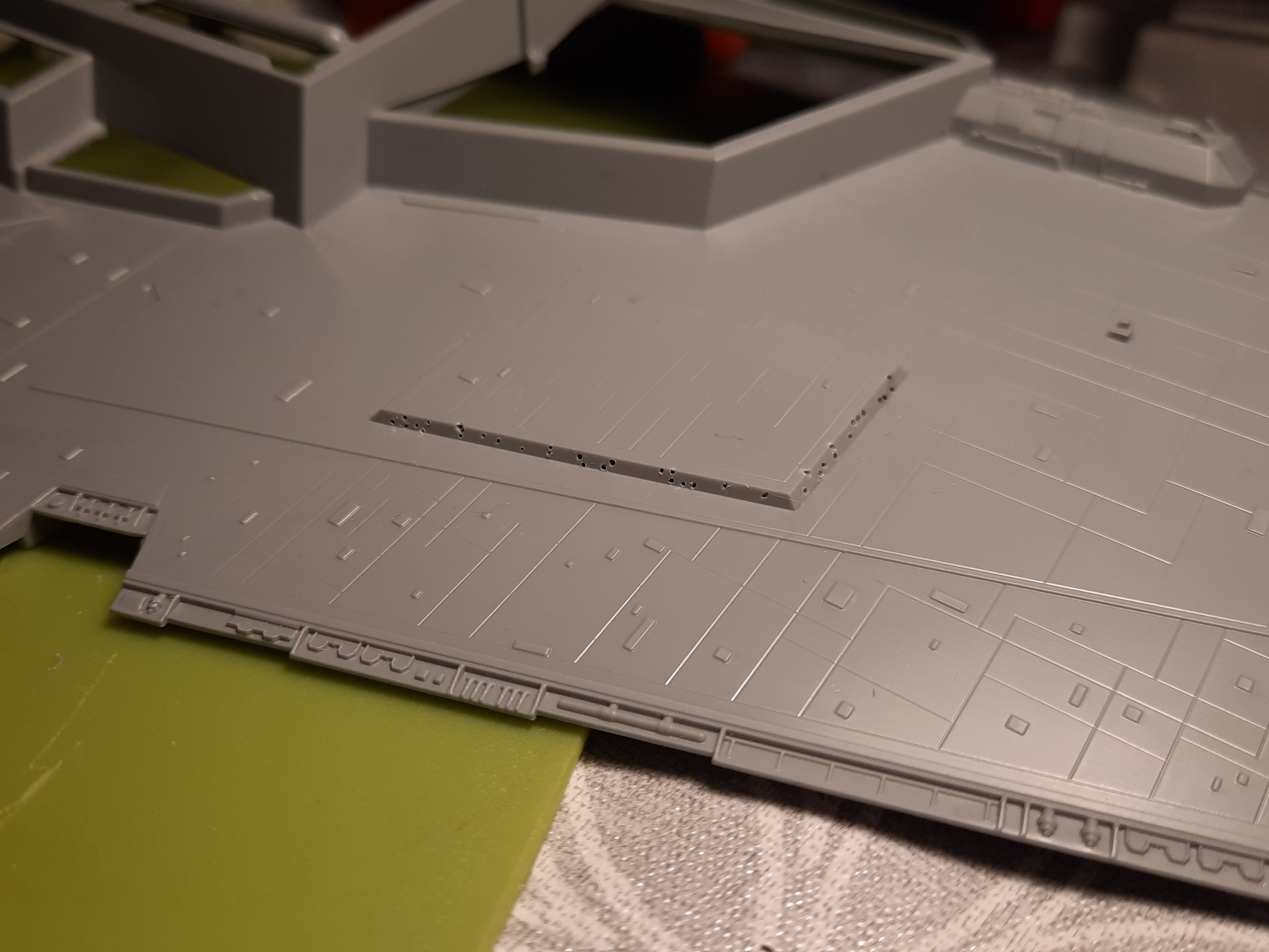

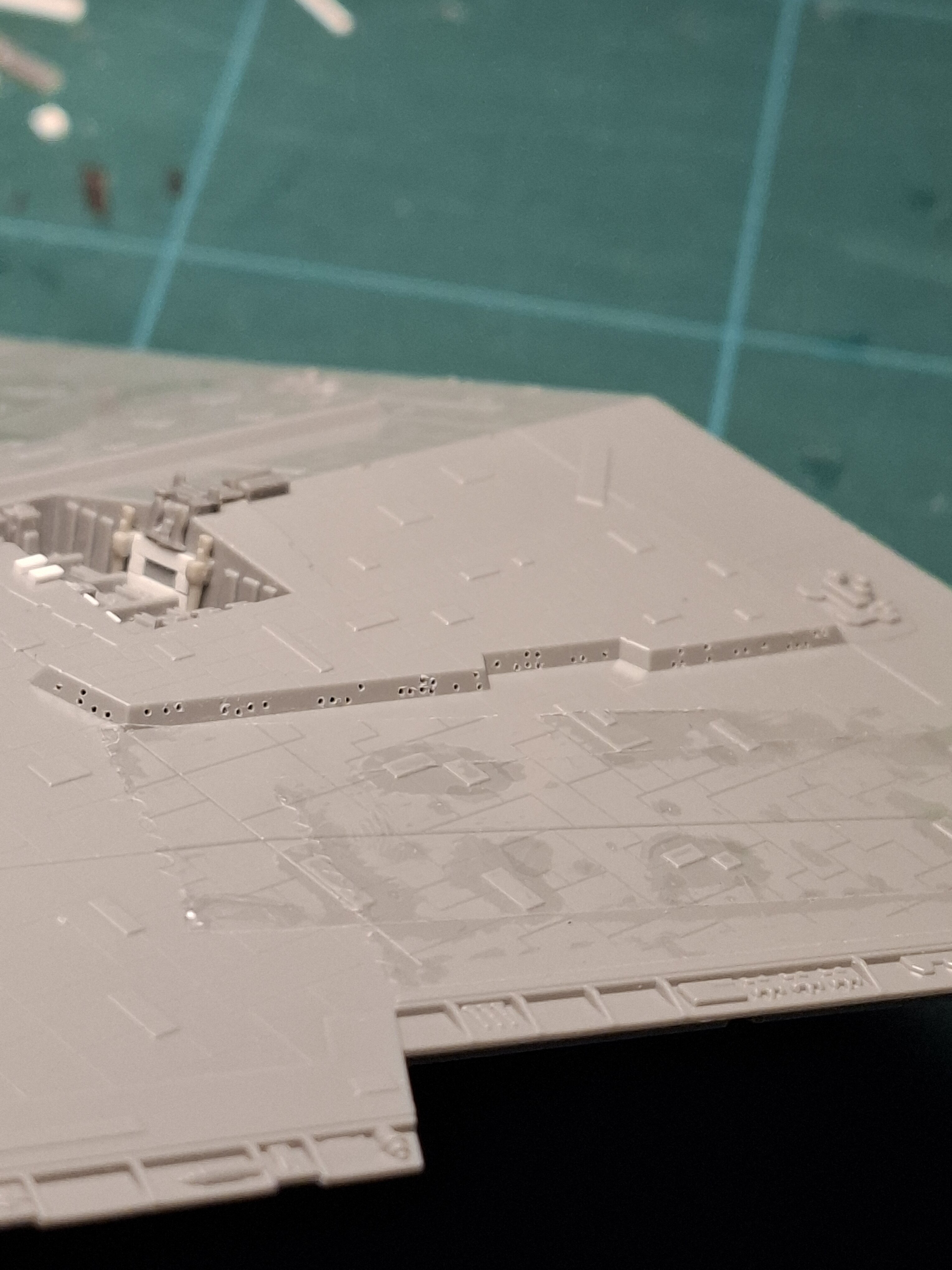

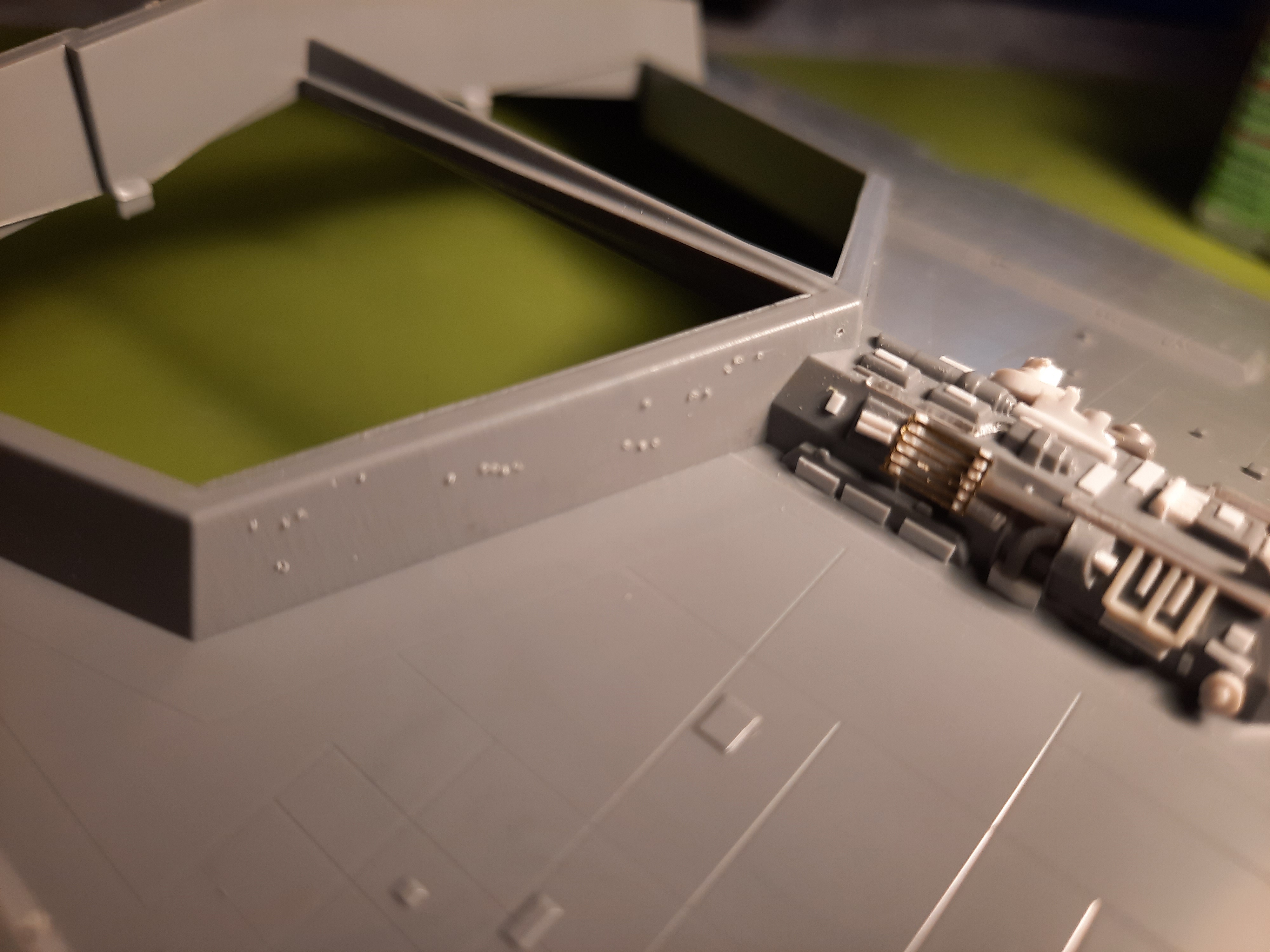

The process of drilling the fiber holes into the superstructure walls, then marking them onto the scaffolding with a hand drill:
and finally drilled through with a coarser tip:

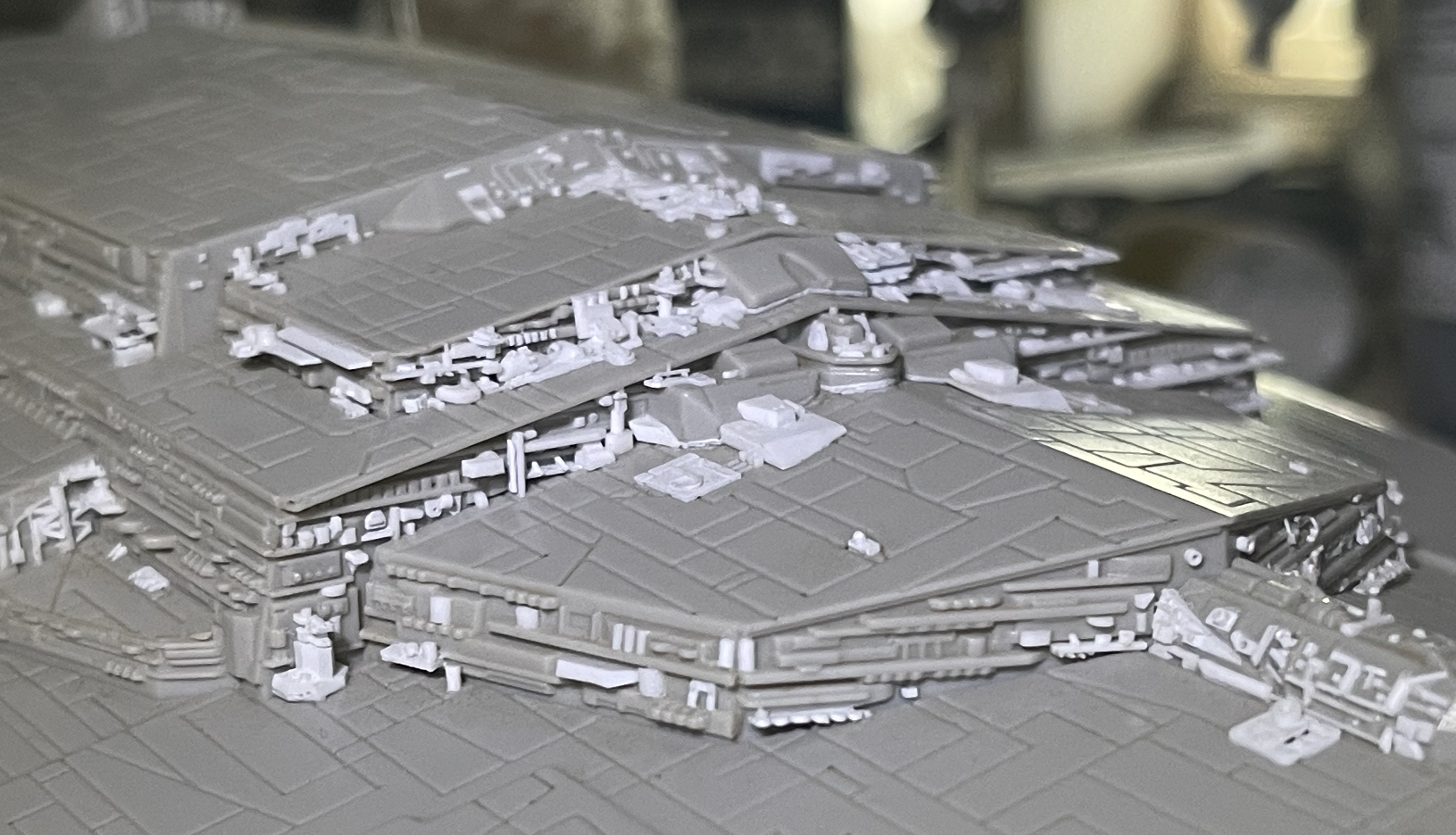

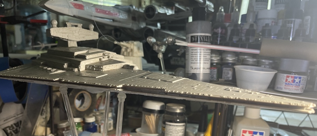

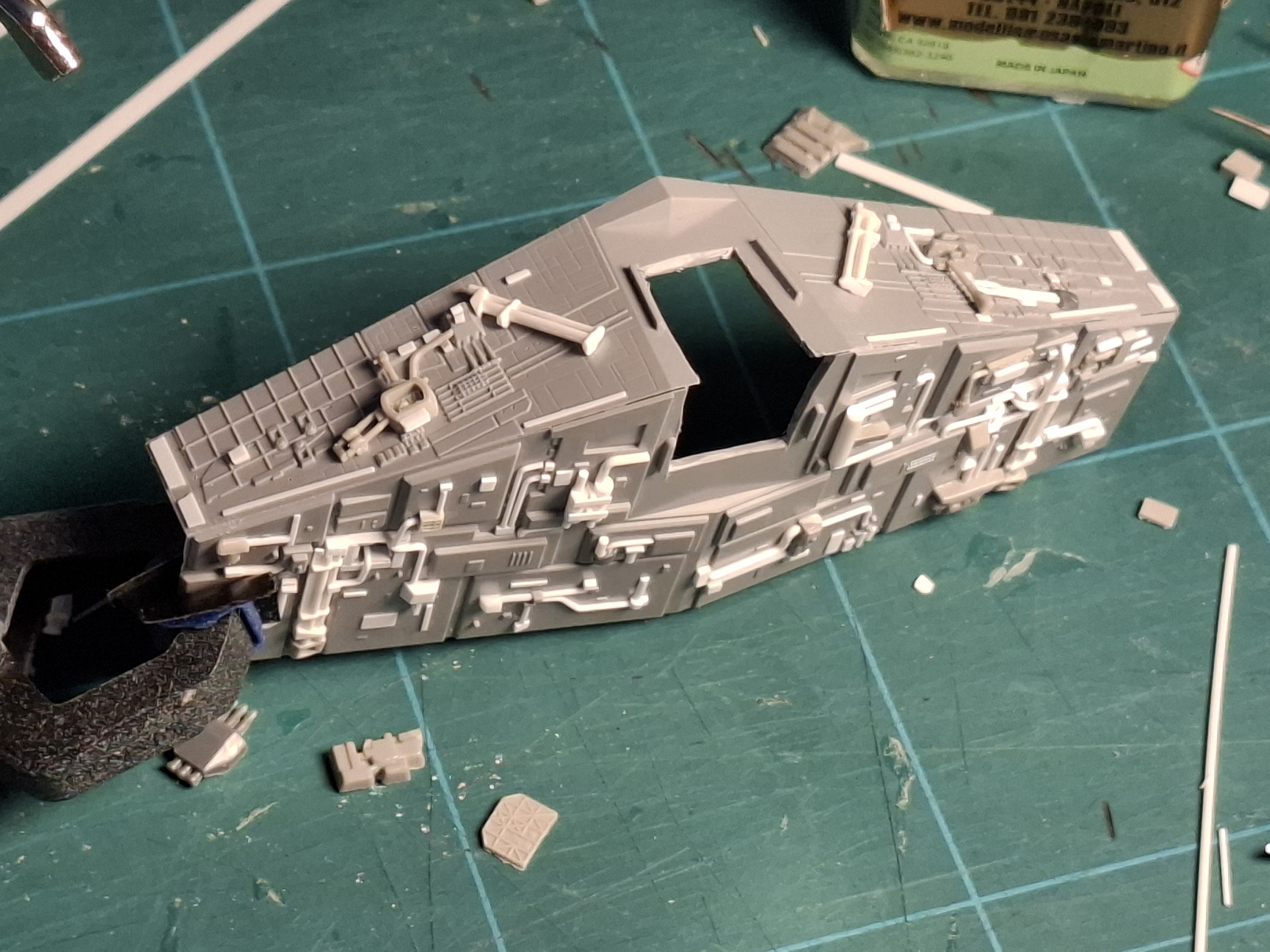

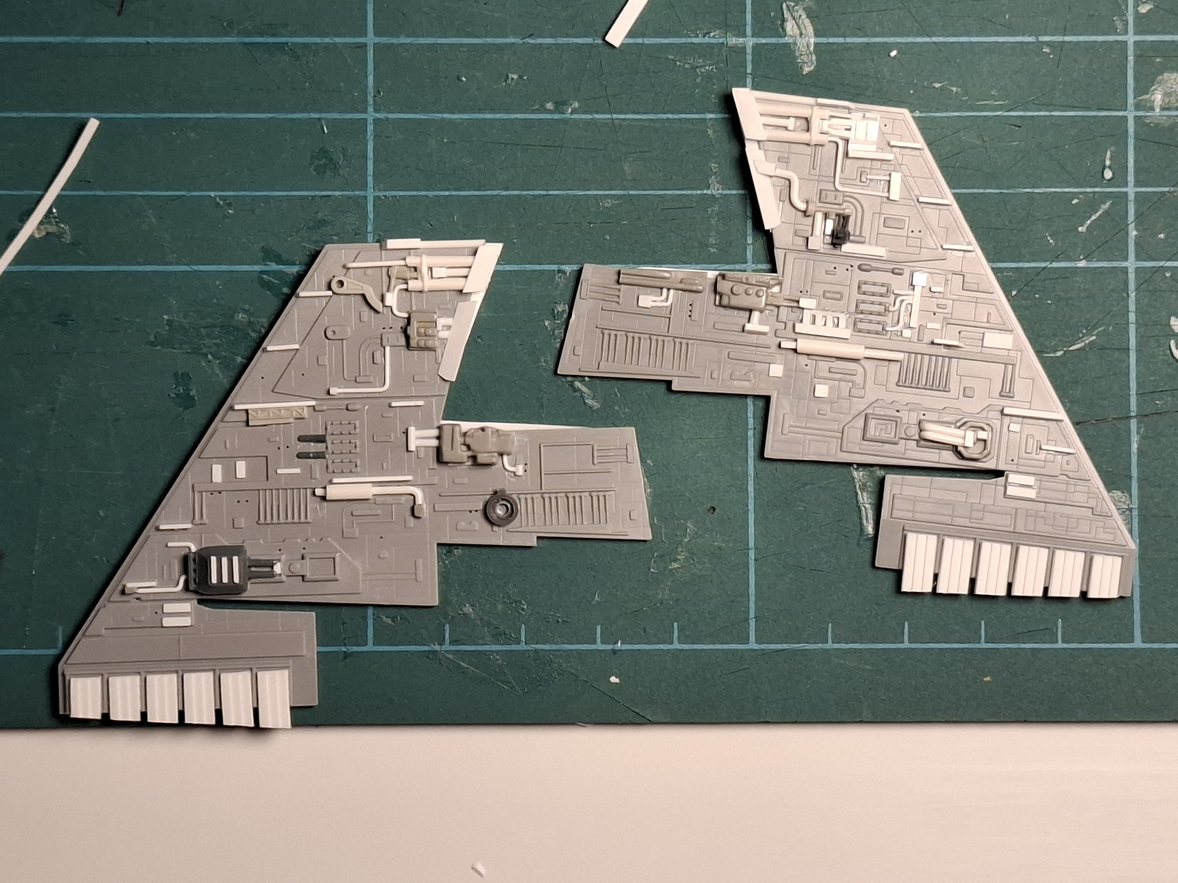

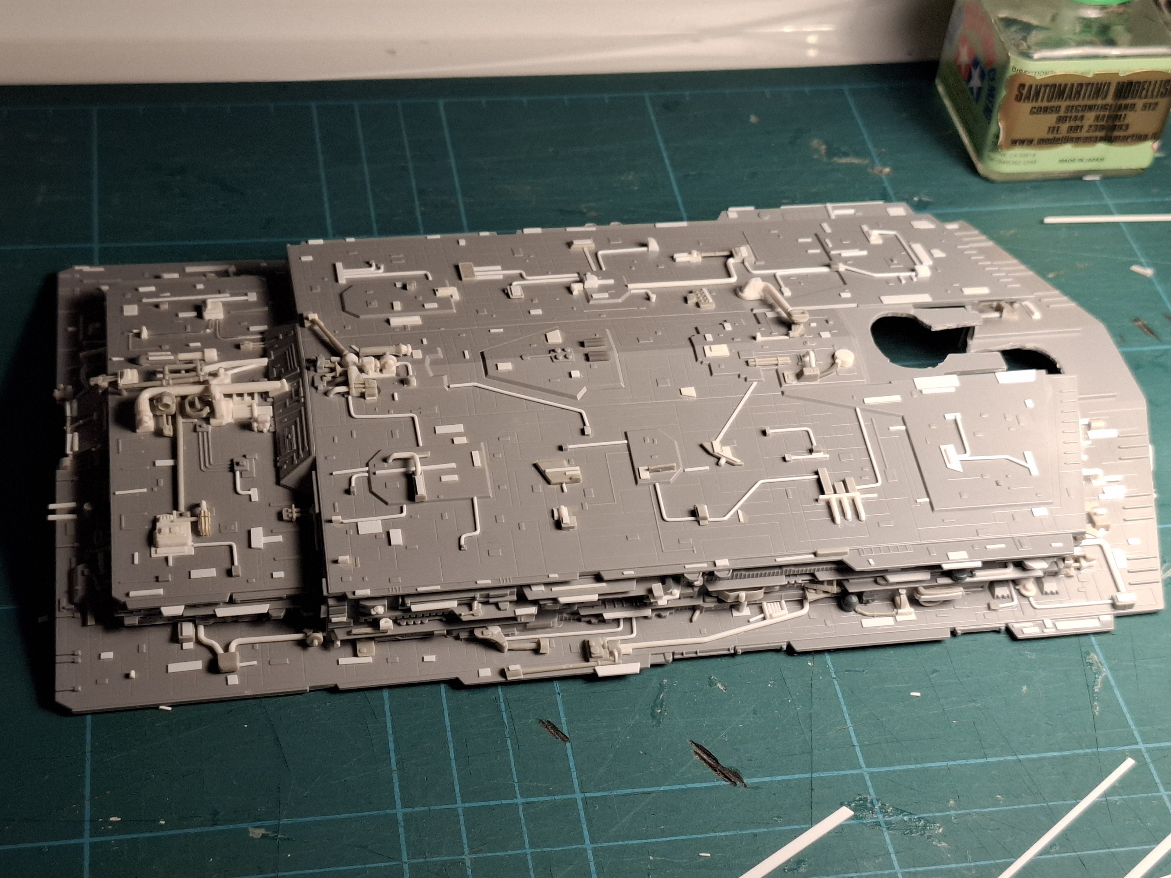

Then, long summer days workign on all the superstructure parts:
and some group pictures:

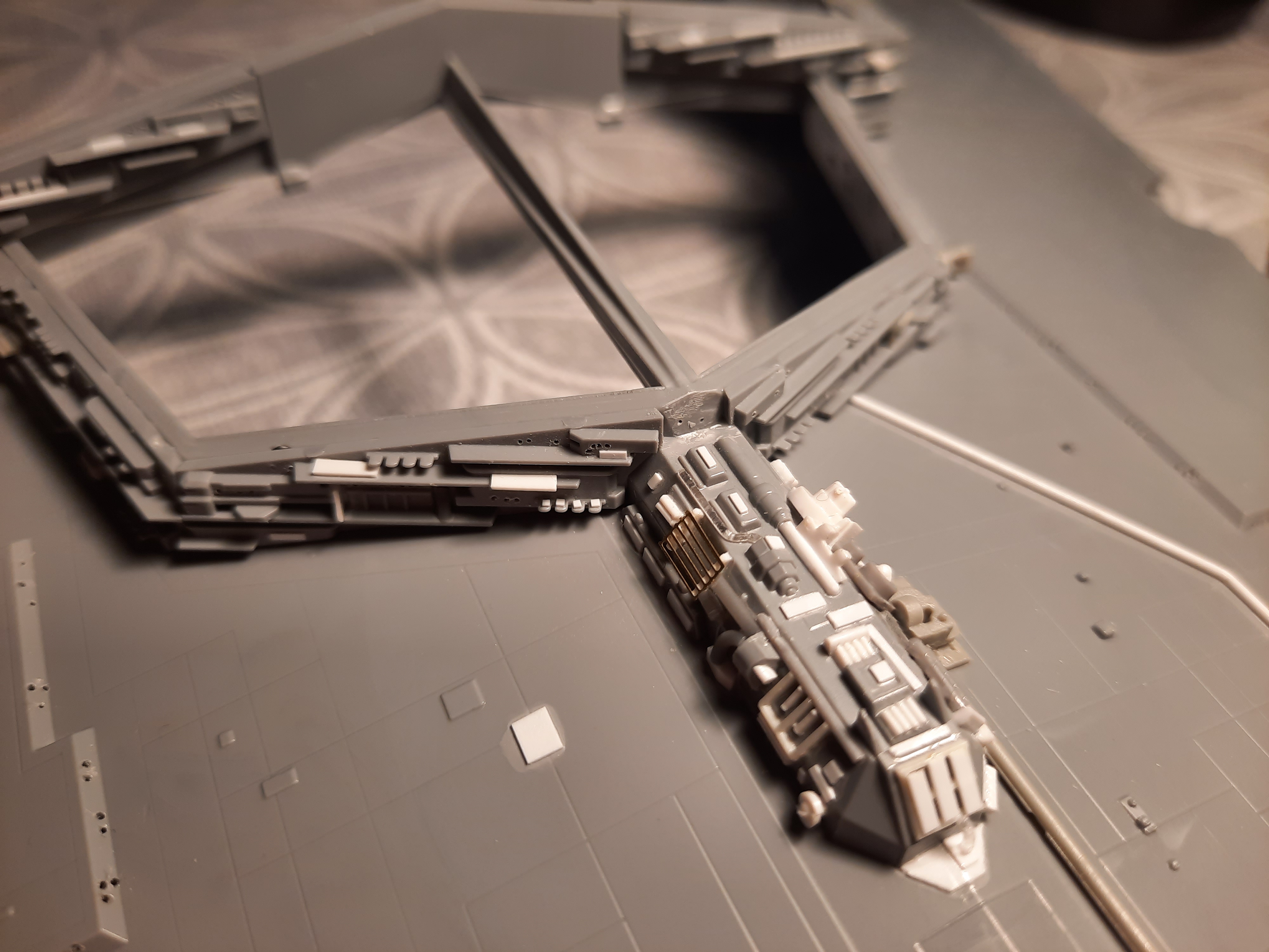

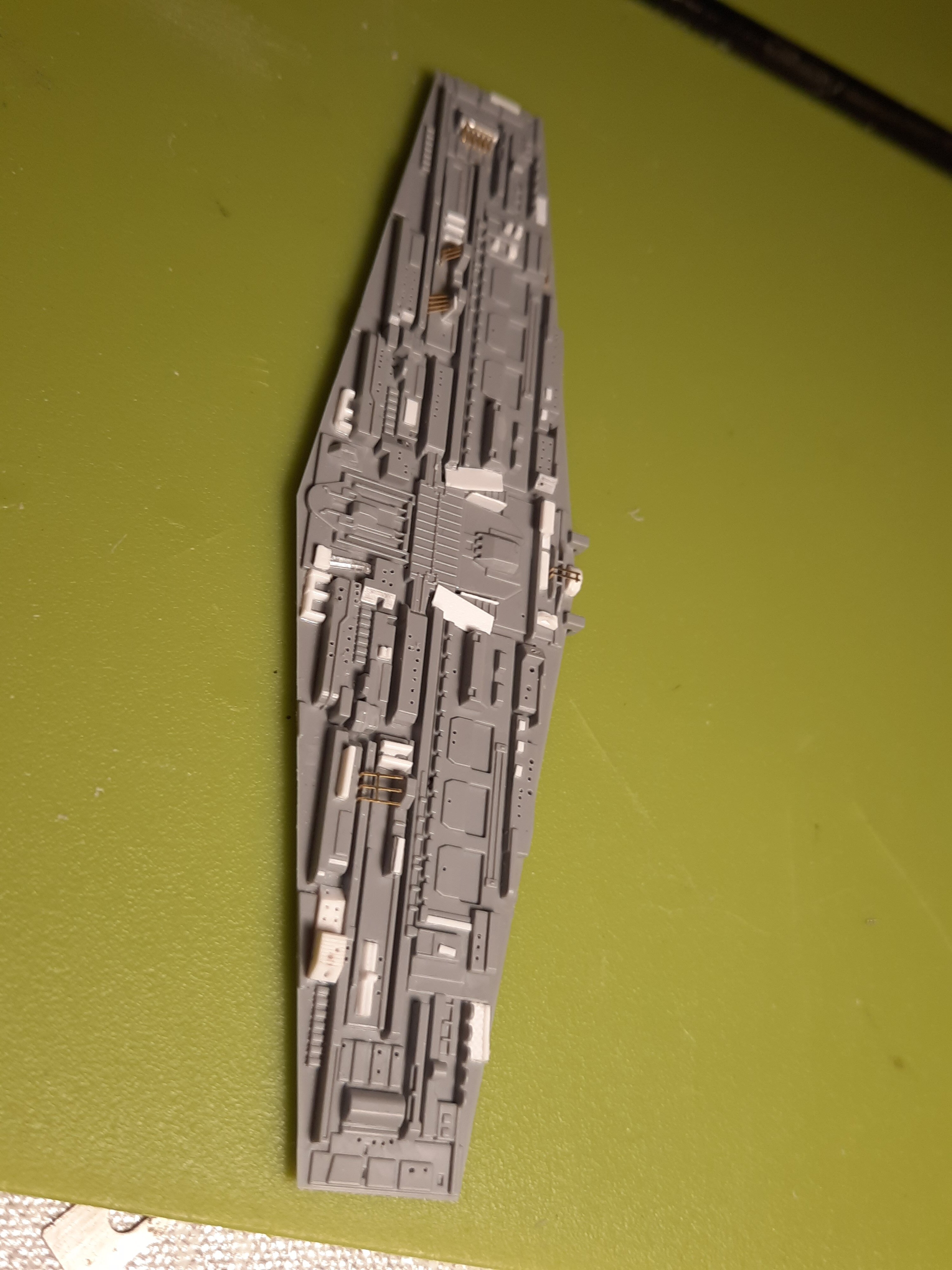

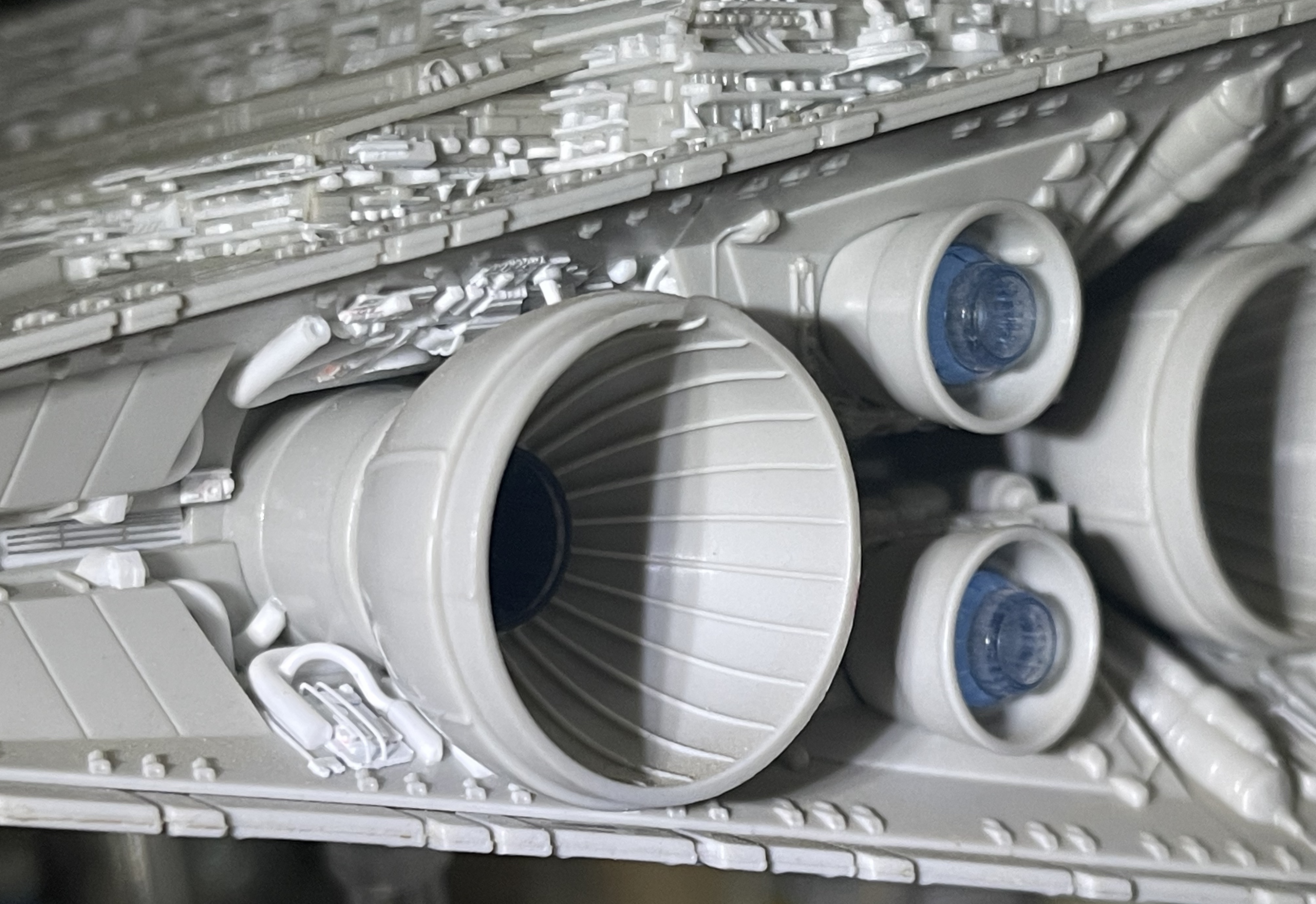

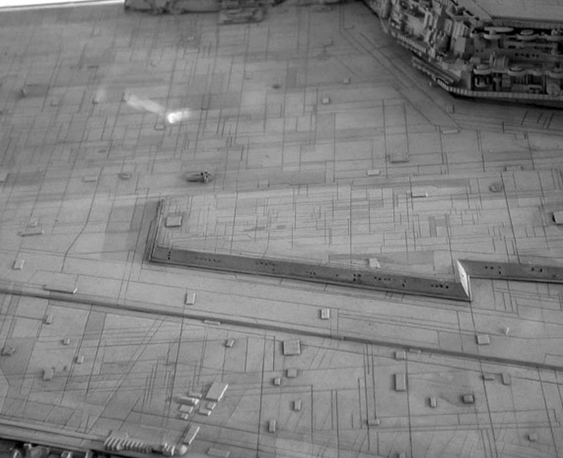

YES! Greebling! I had missed the arduous task done with my Zvezda/Revell (which I have still not finished) - and a few months ago I found myself looking at the Revell Build-And-Play Rogue One ISD TOY that they released as a model kit, and .. I was impelled to suddenly rip out all the toy electronics and accurize it better. I originally wanted to just fix the side trench height and add detail - and.... well, I got myself suckered into doing the whole thing.
This was more difficult than the 1/2700 because the scale for this is closer to something like 1/4100 so the greeblies that I had to hand carve was tiny and miniscule compared to the 1/2700. I'm not lighting this kit, I just wanted to accurize and paint it.
Original Revell kit.jpgrear port engines2.jpgrear port engines.jpgPort Cake.jpgSB trench3.jpgSB Top.jpgSB trench2.jpgSB side2.jpgSB trench1.jpgSB side1.jpg

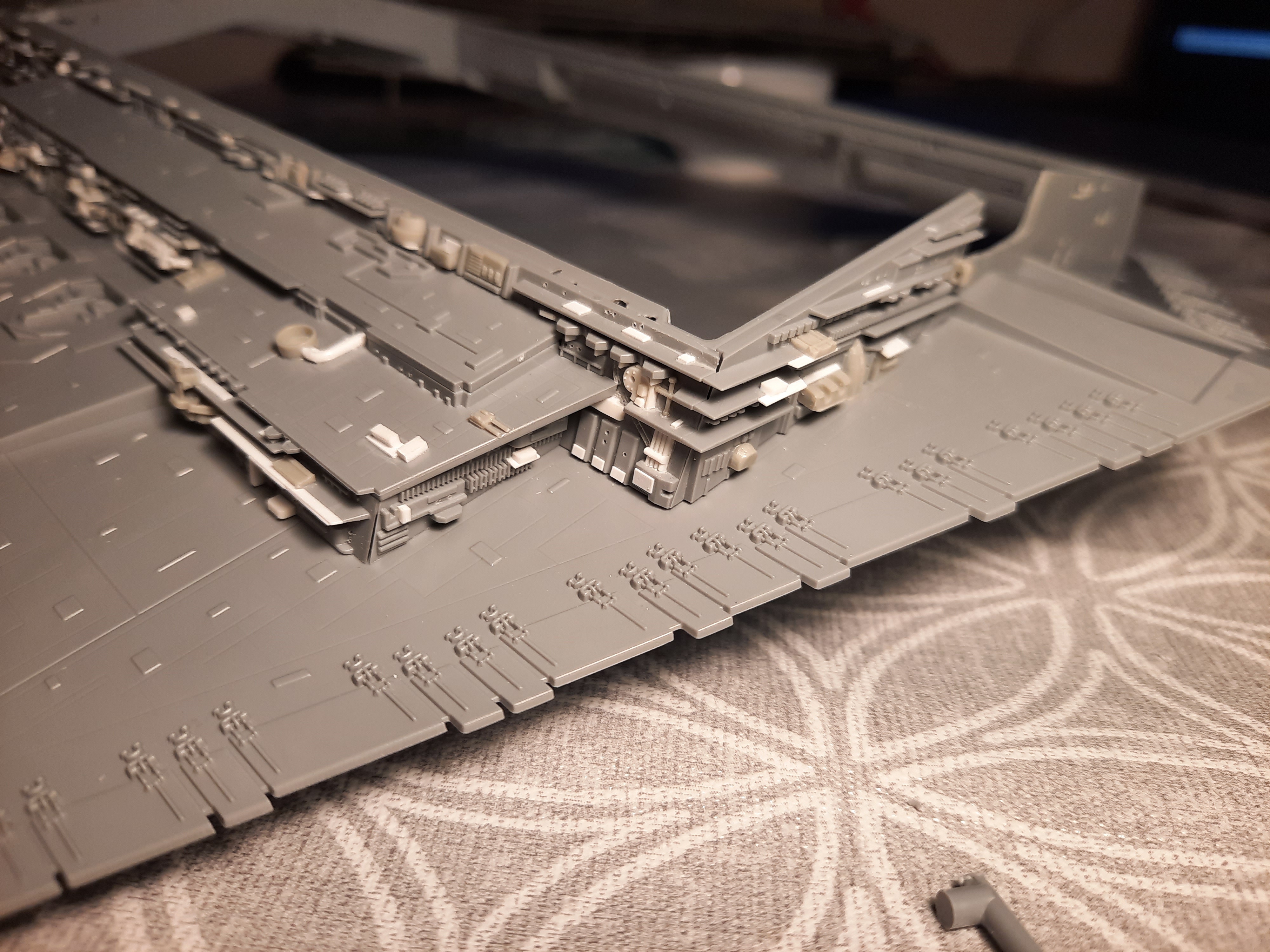

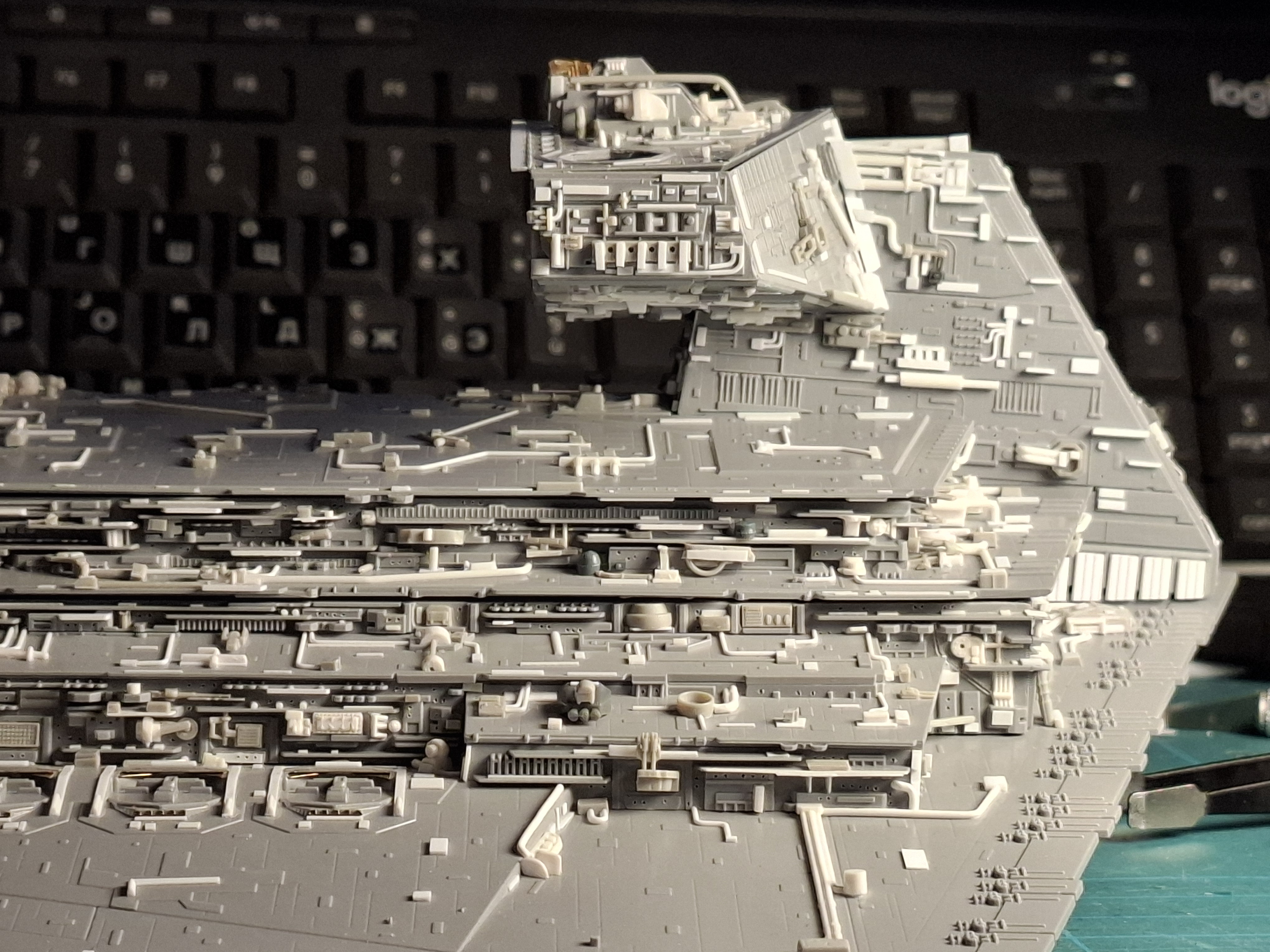

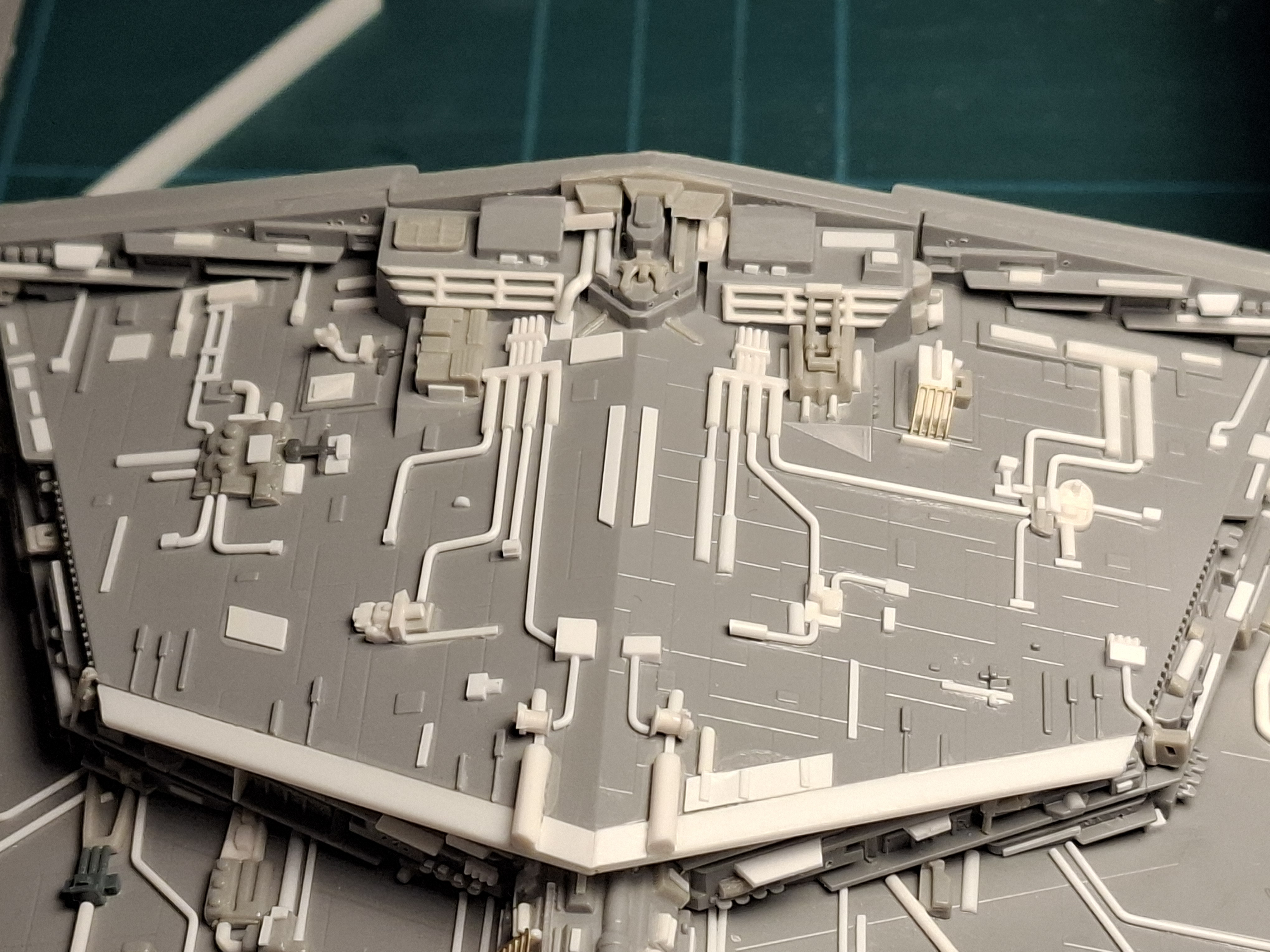

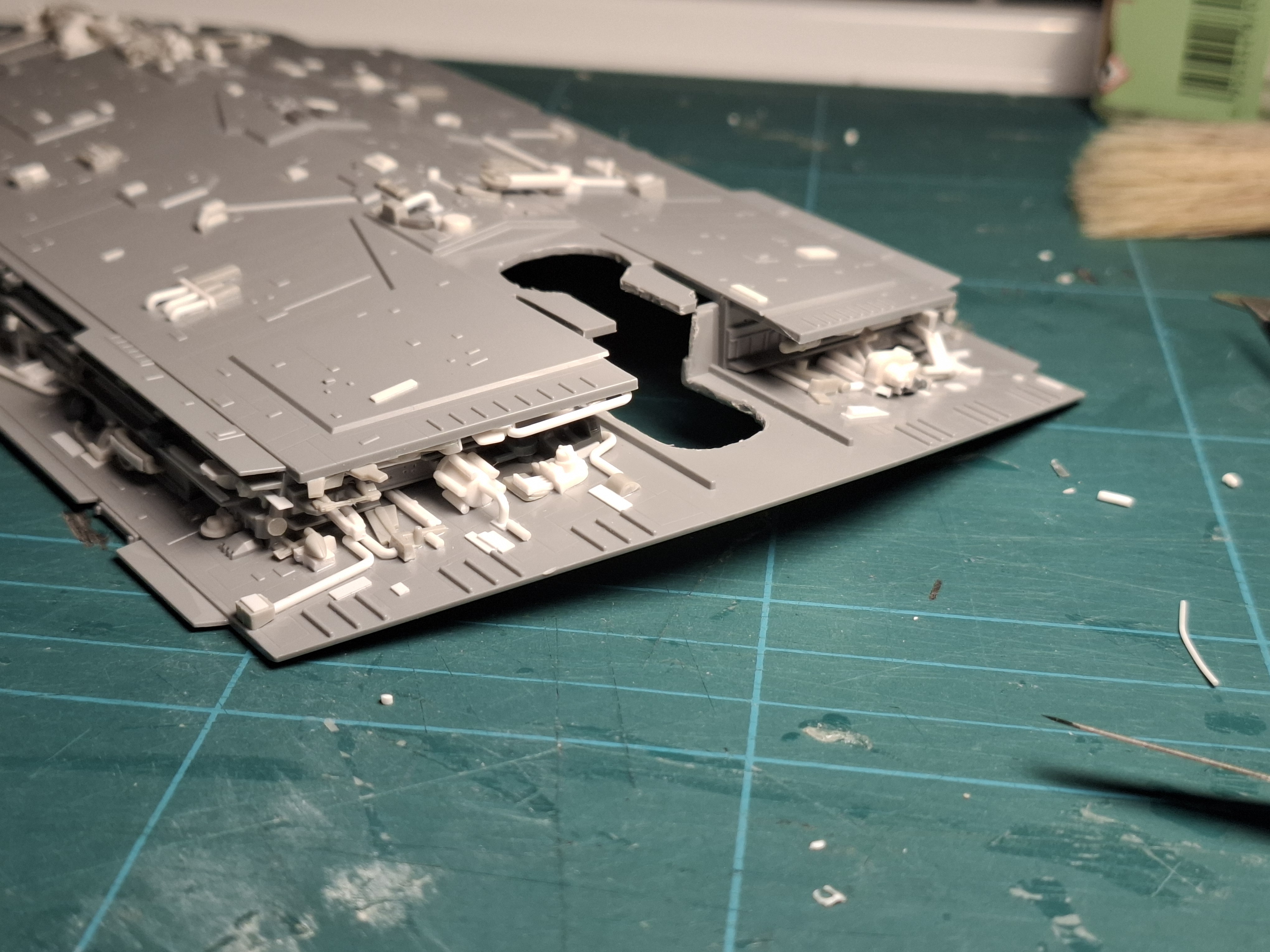

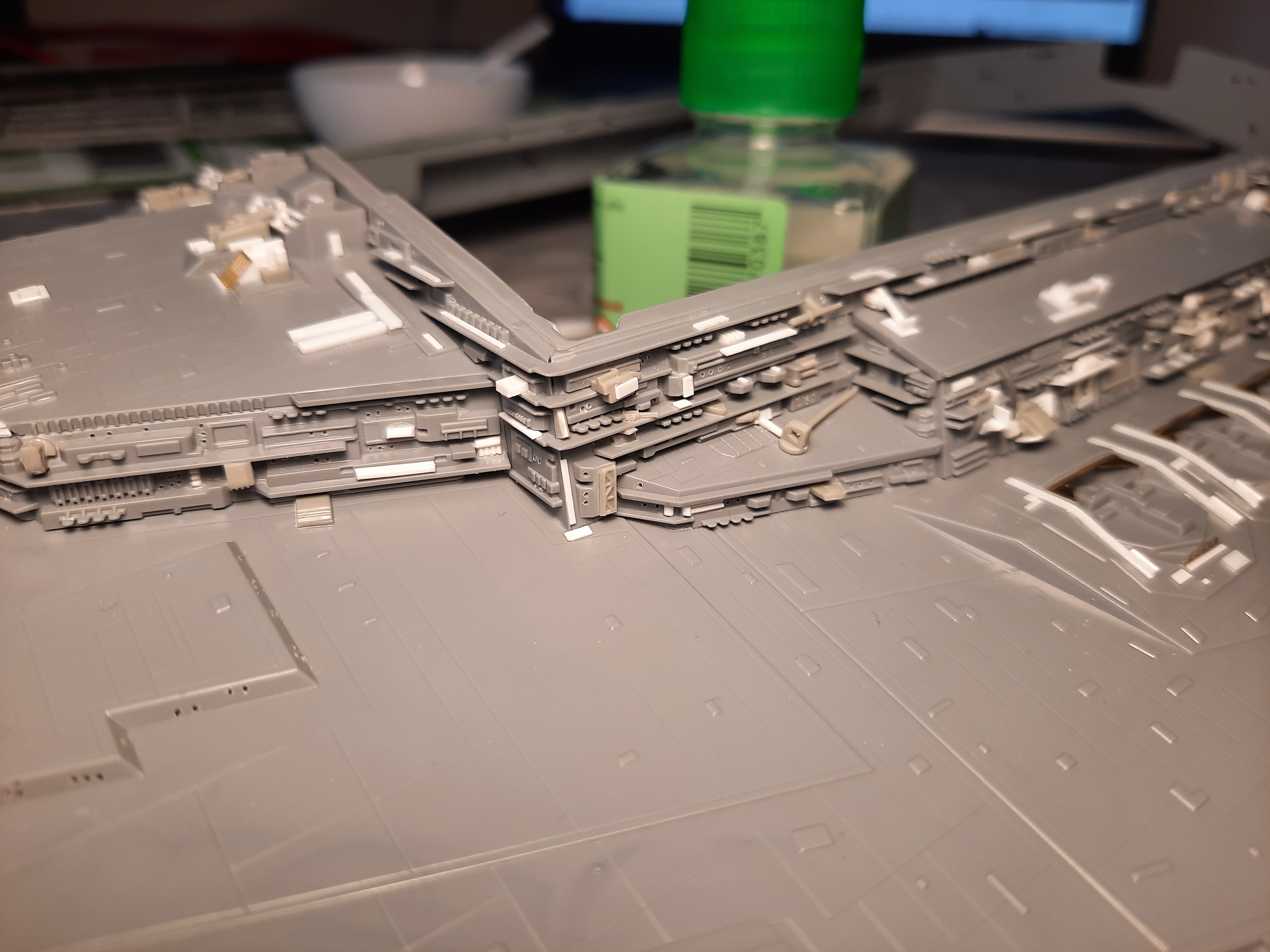

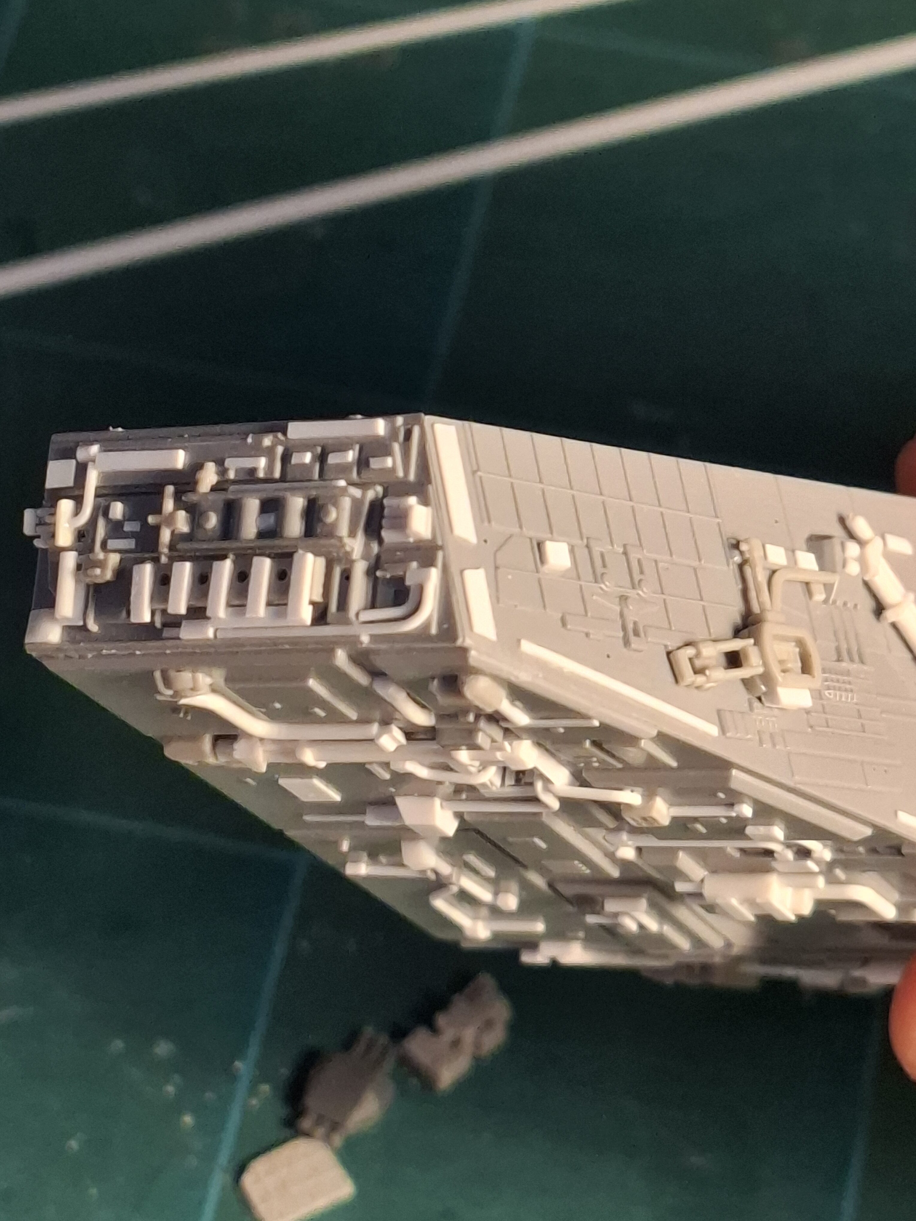

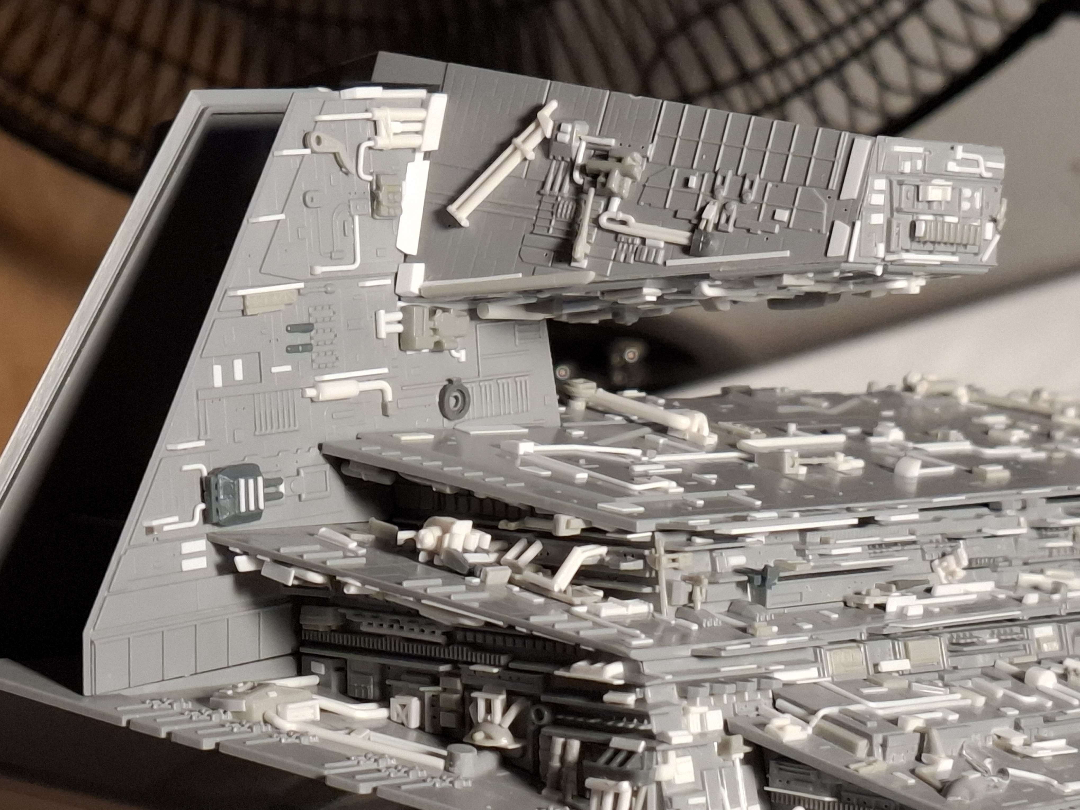

2022-2024: more hull details, then work wind-down
I kept working on this the whole summer of 22, then more an more sporadically as my actual employment work was keeping me in another city.

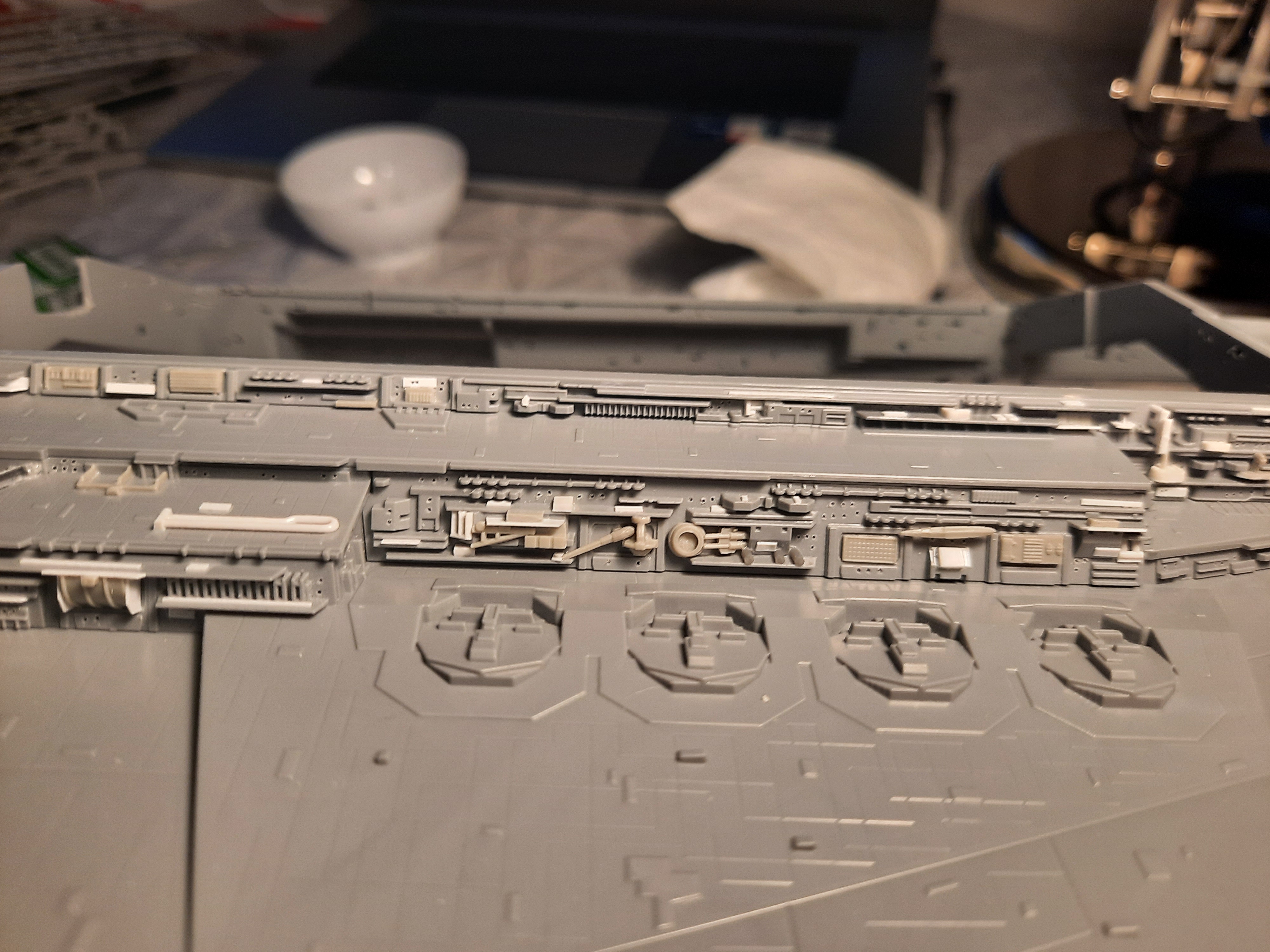

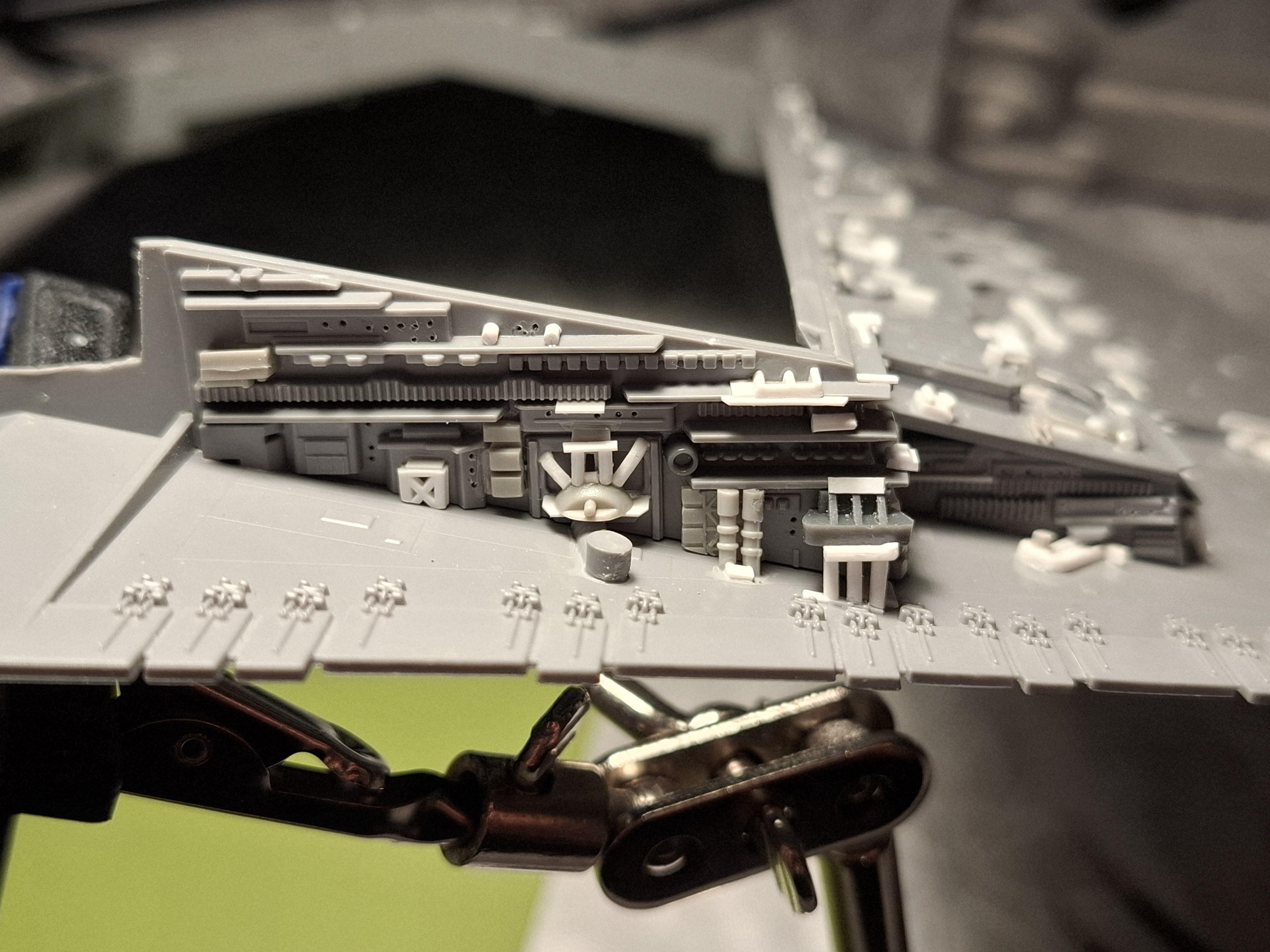

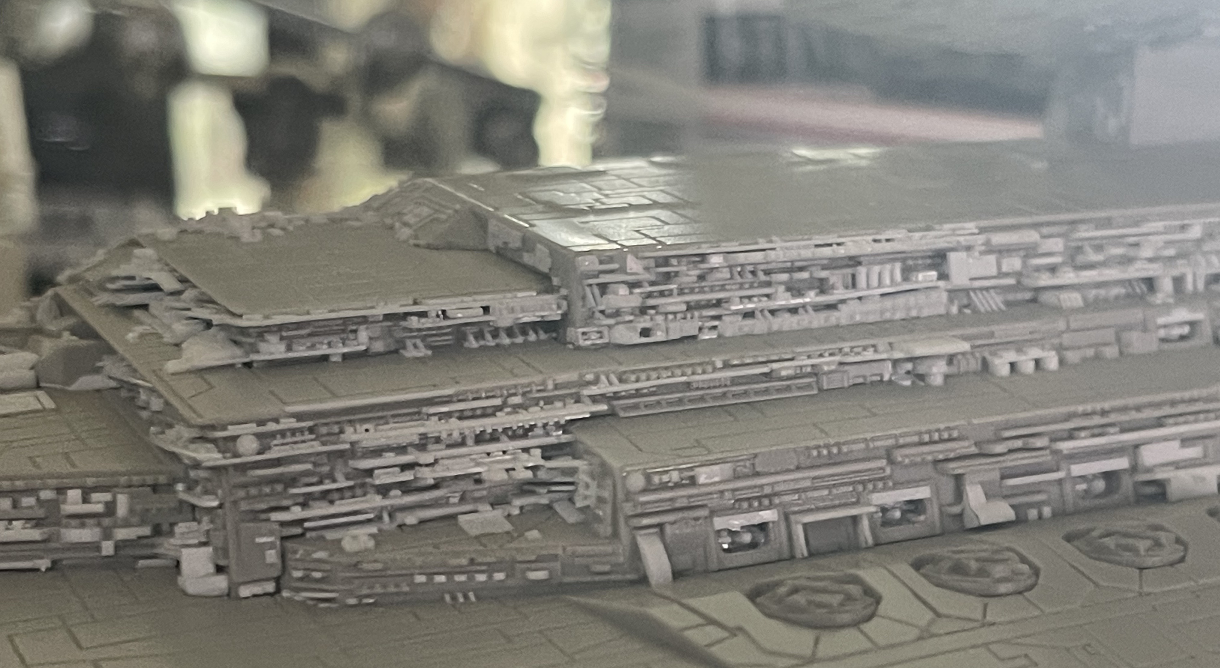

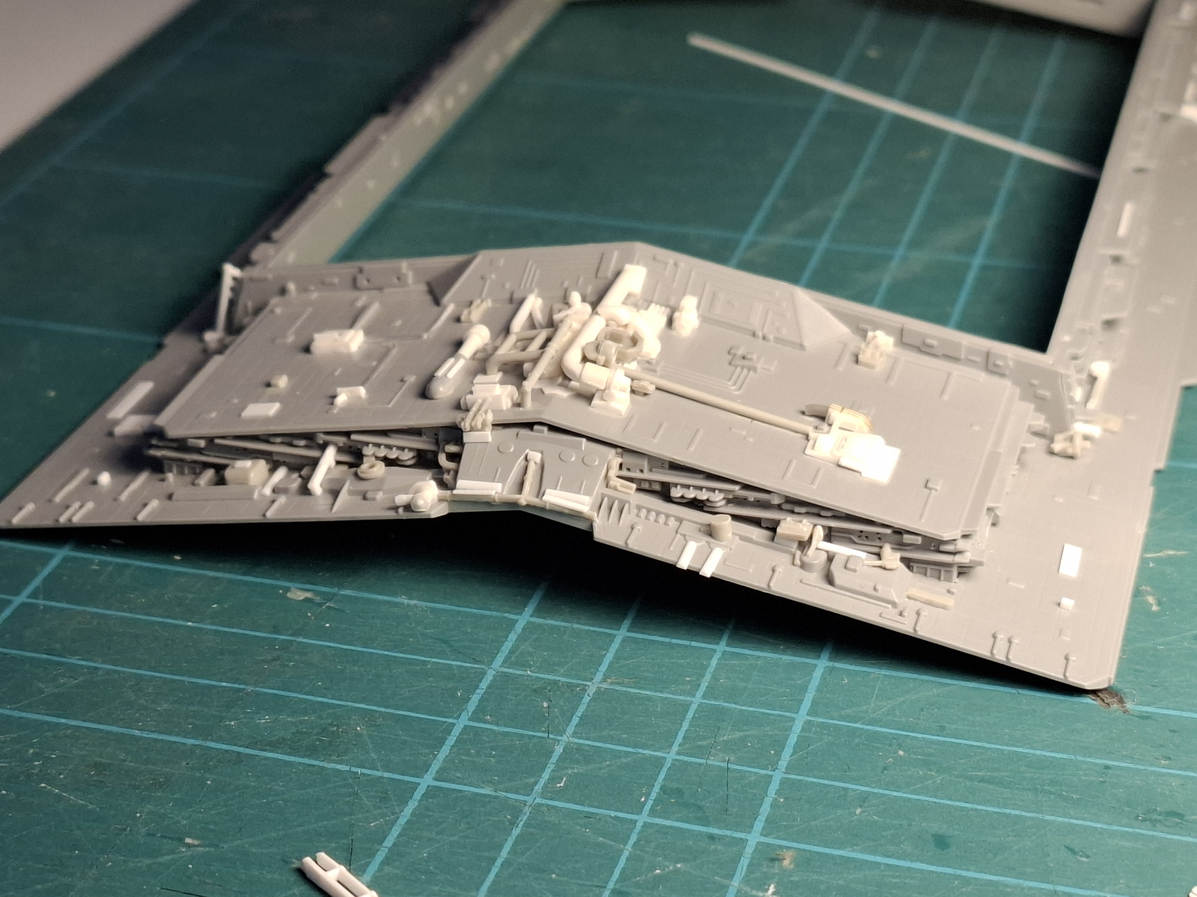

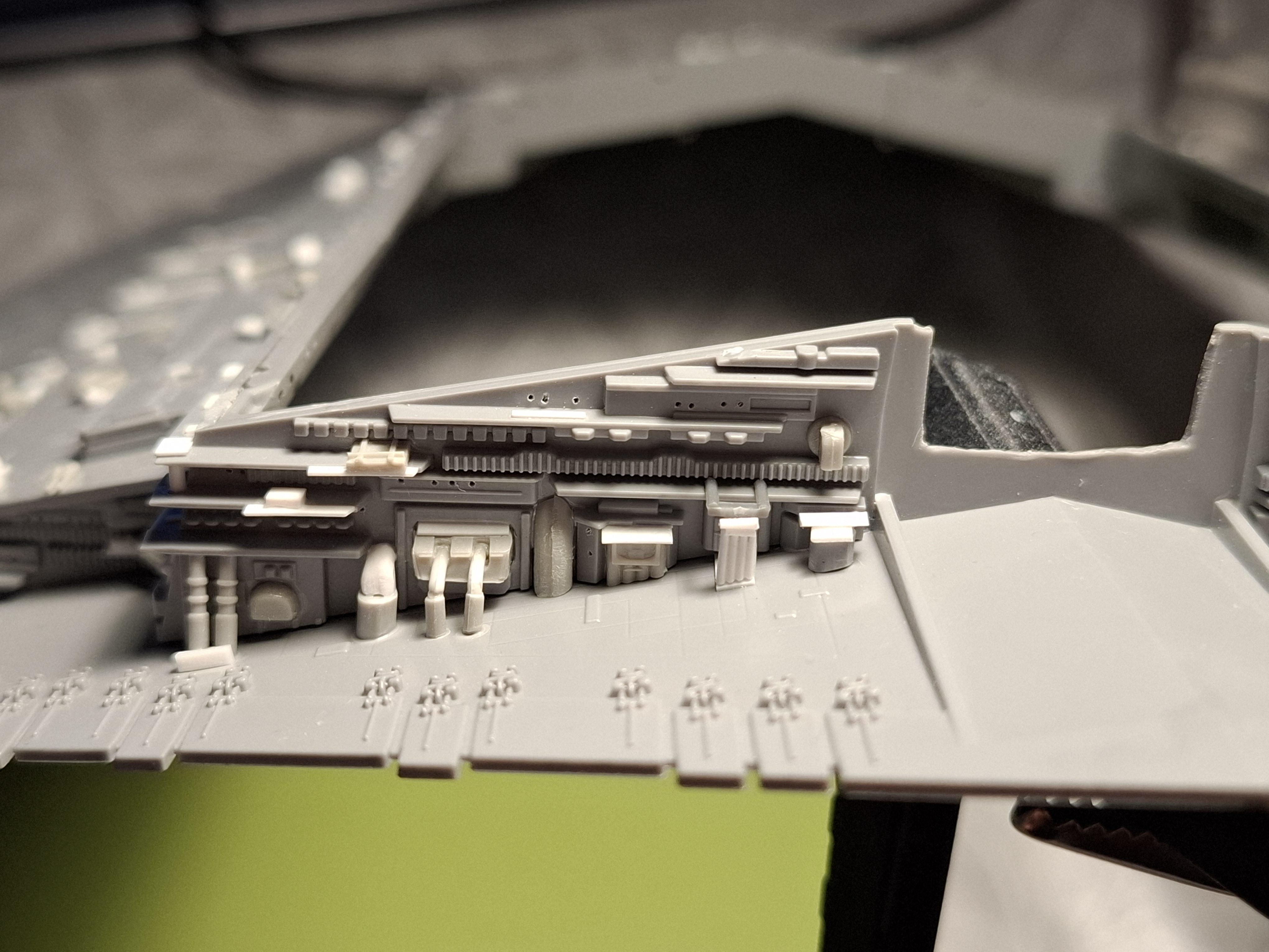

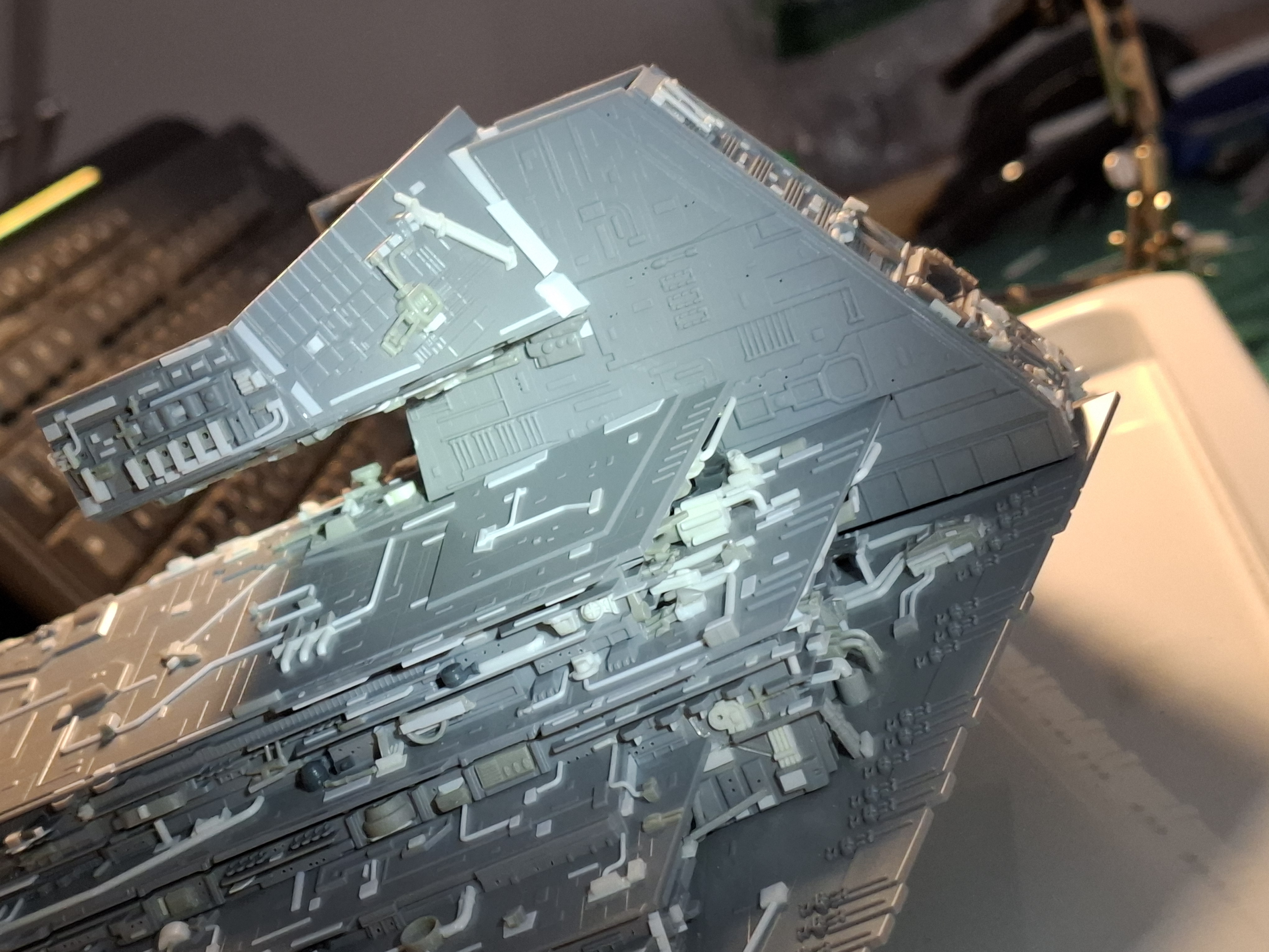

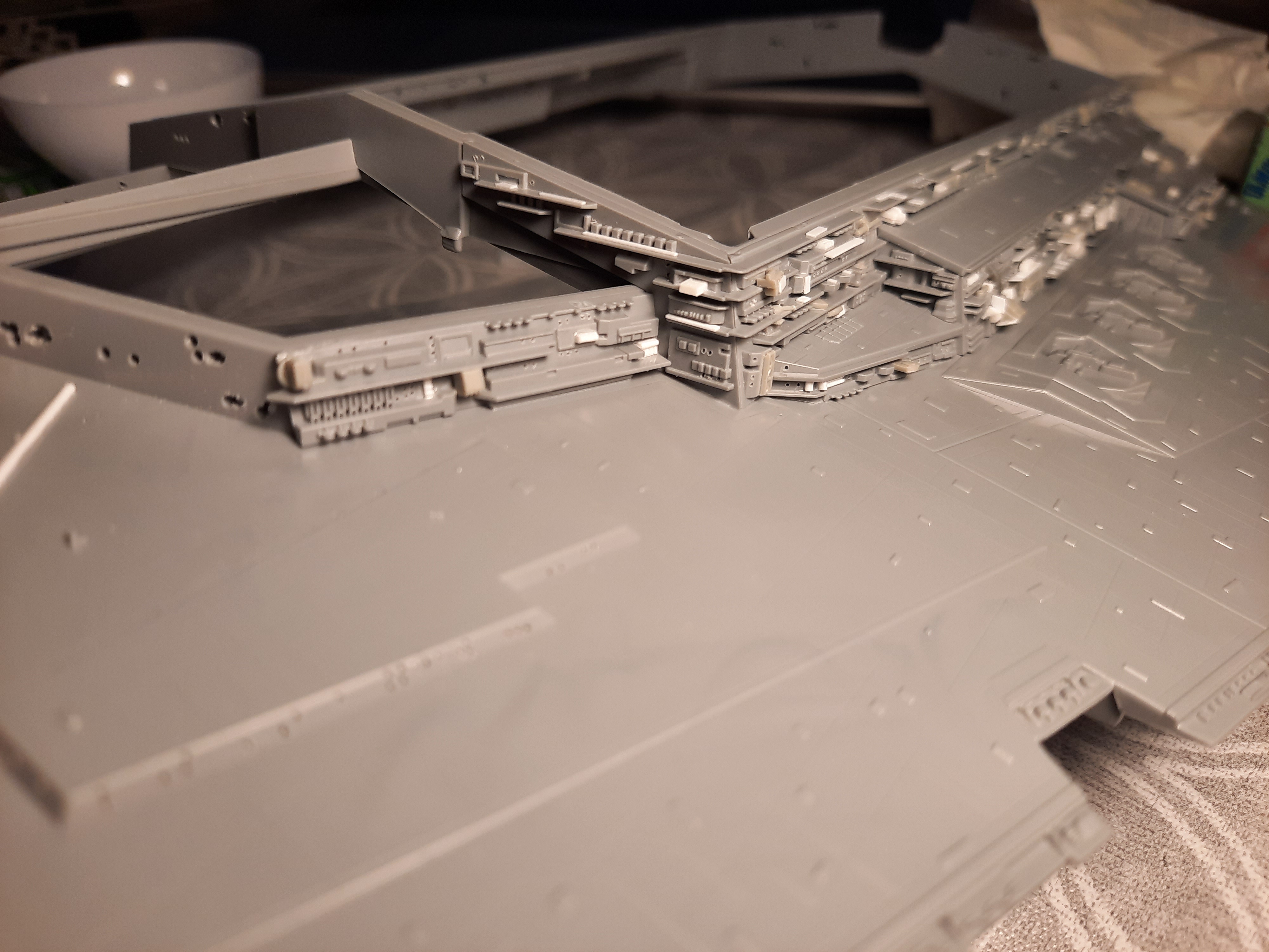

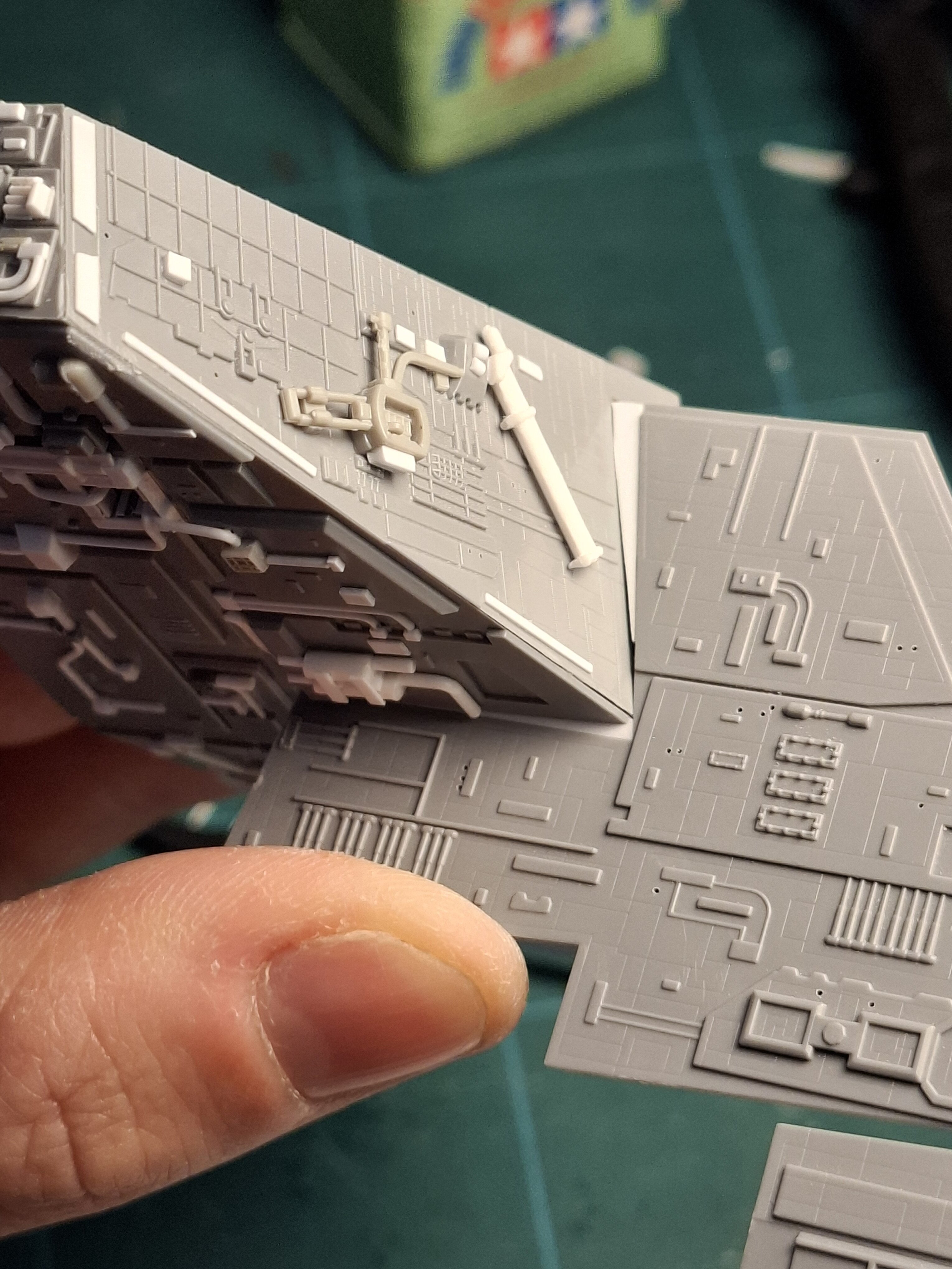

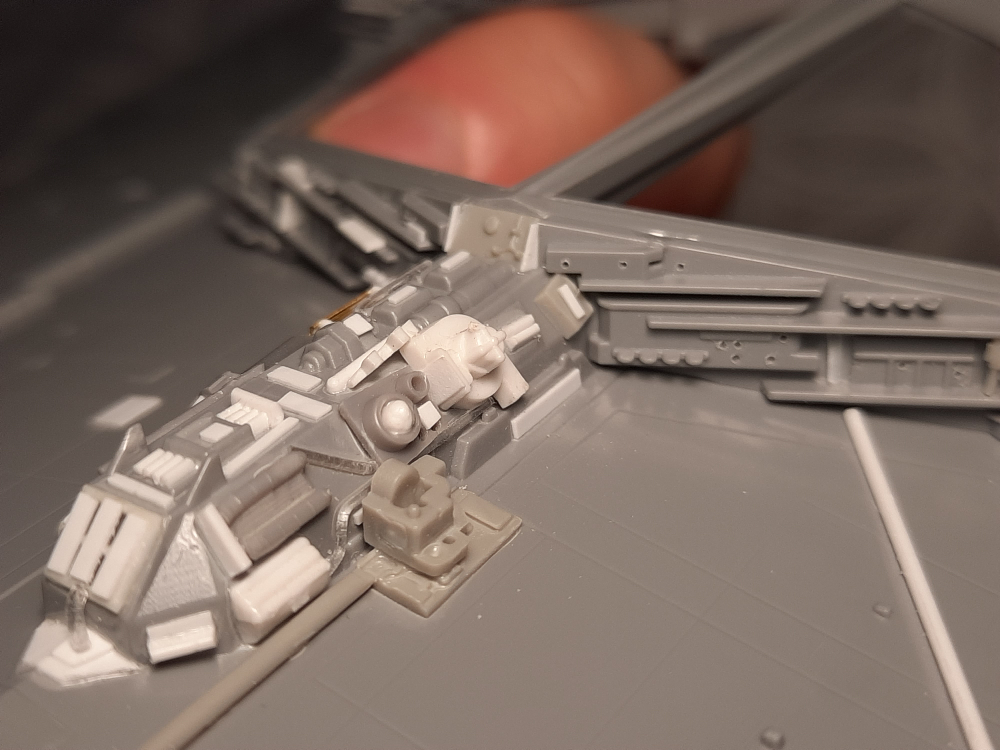

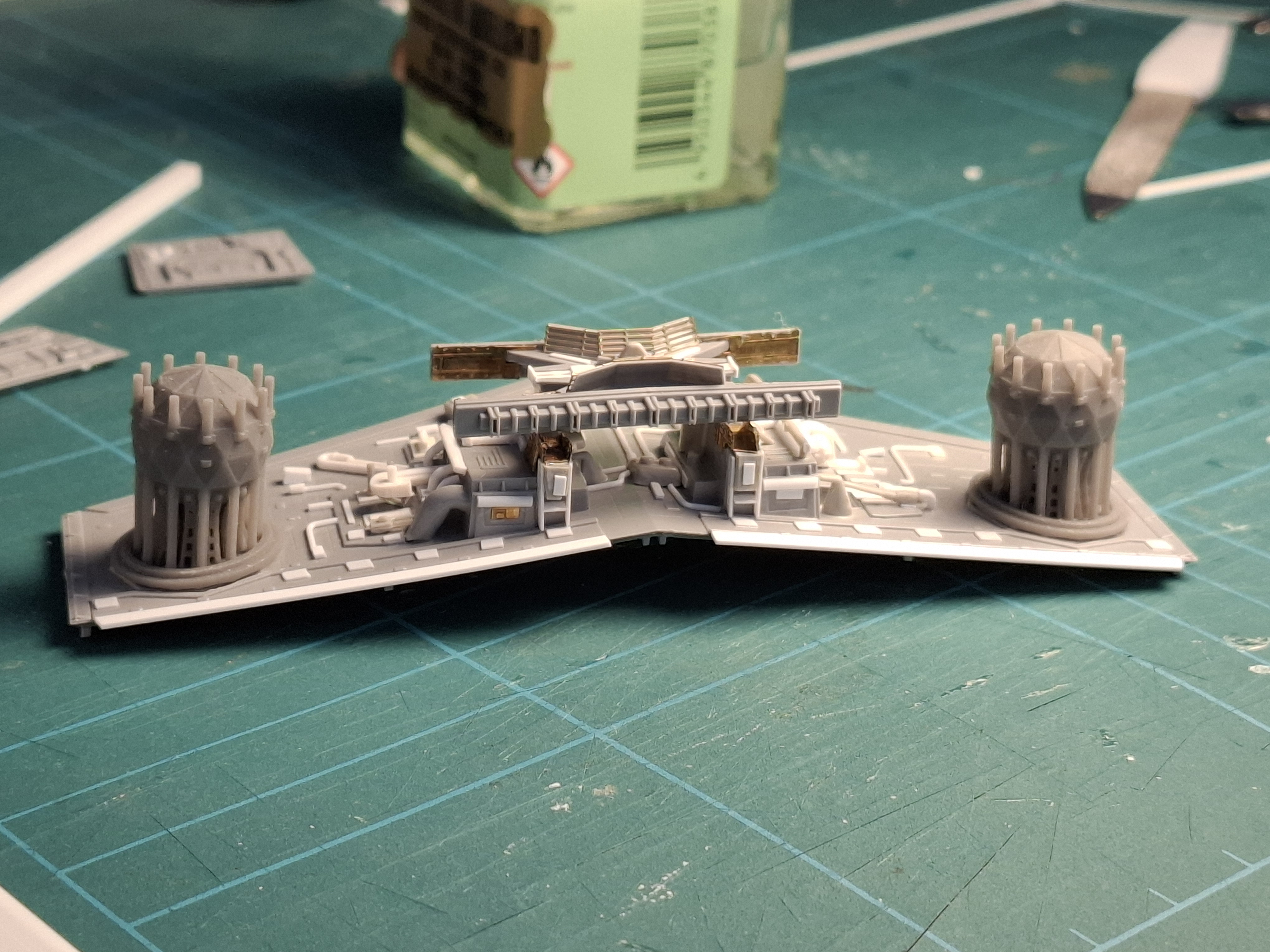

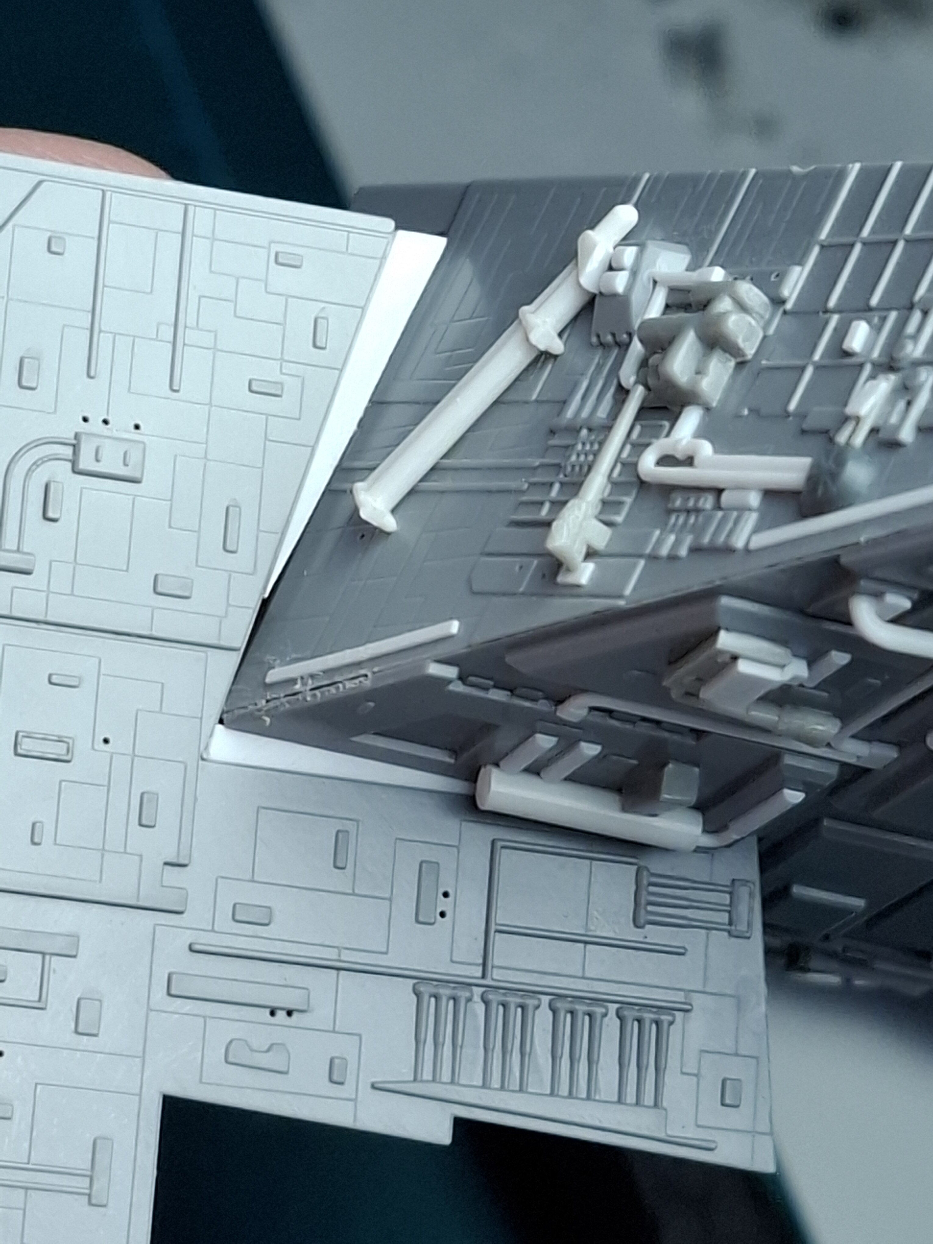

Modifications to the superstructure forward tip:
Roofing details on the pentagon structure (will receive more):

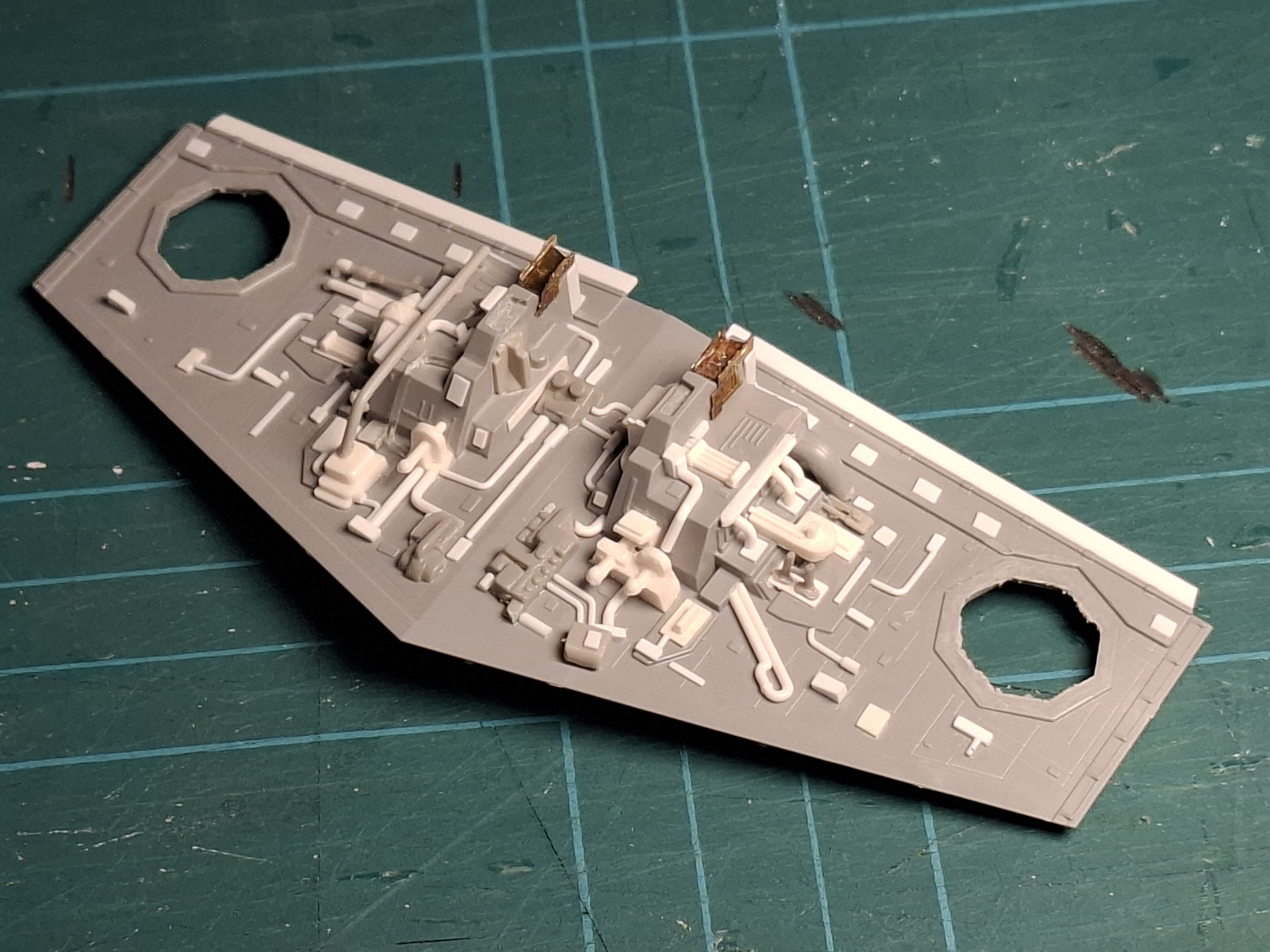

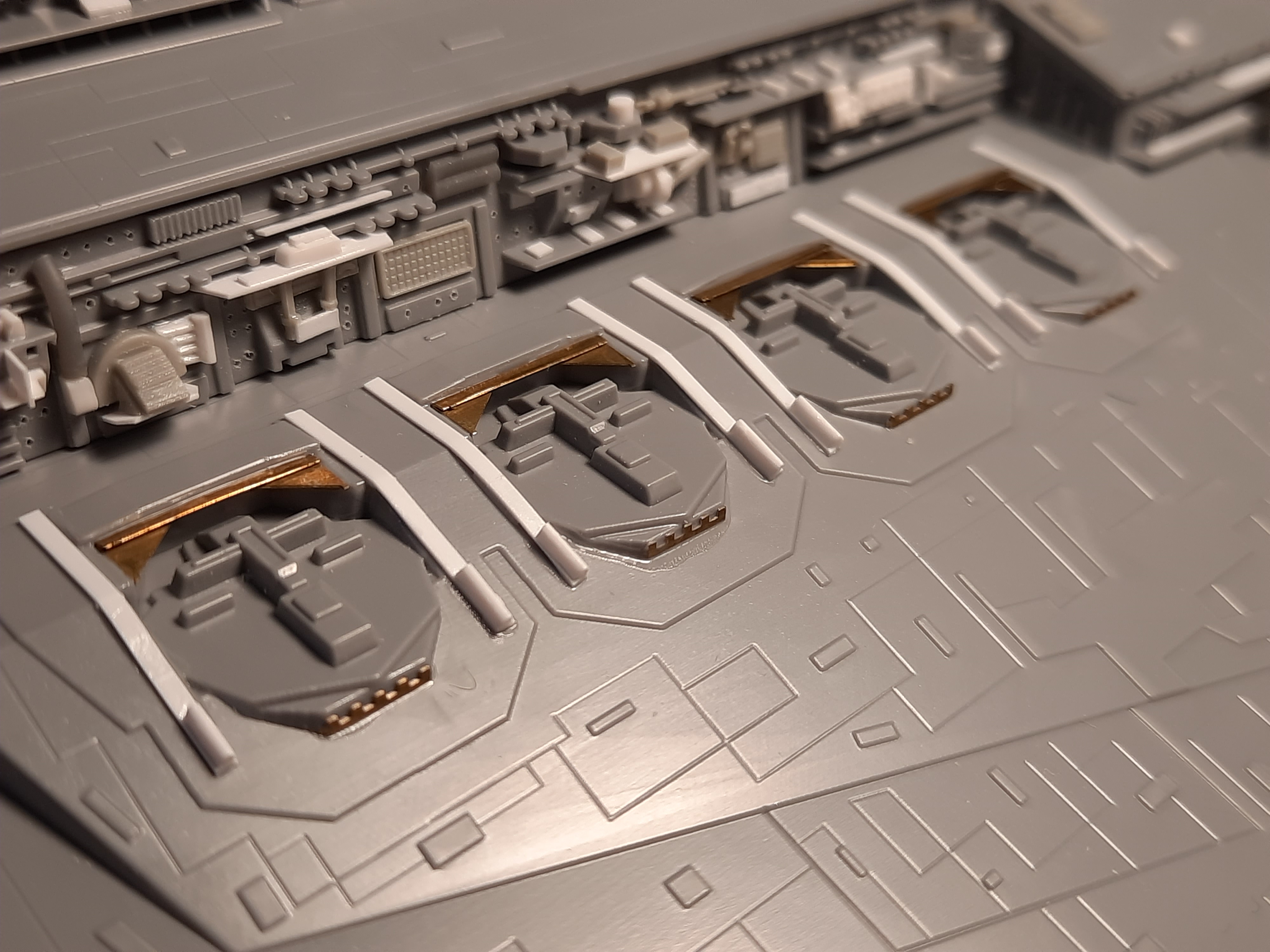

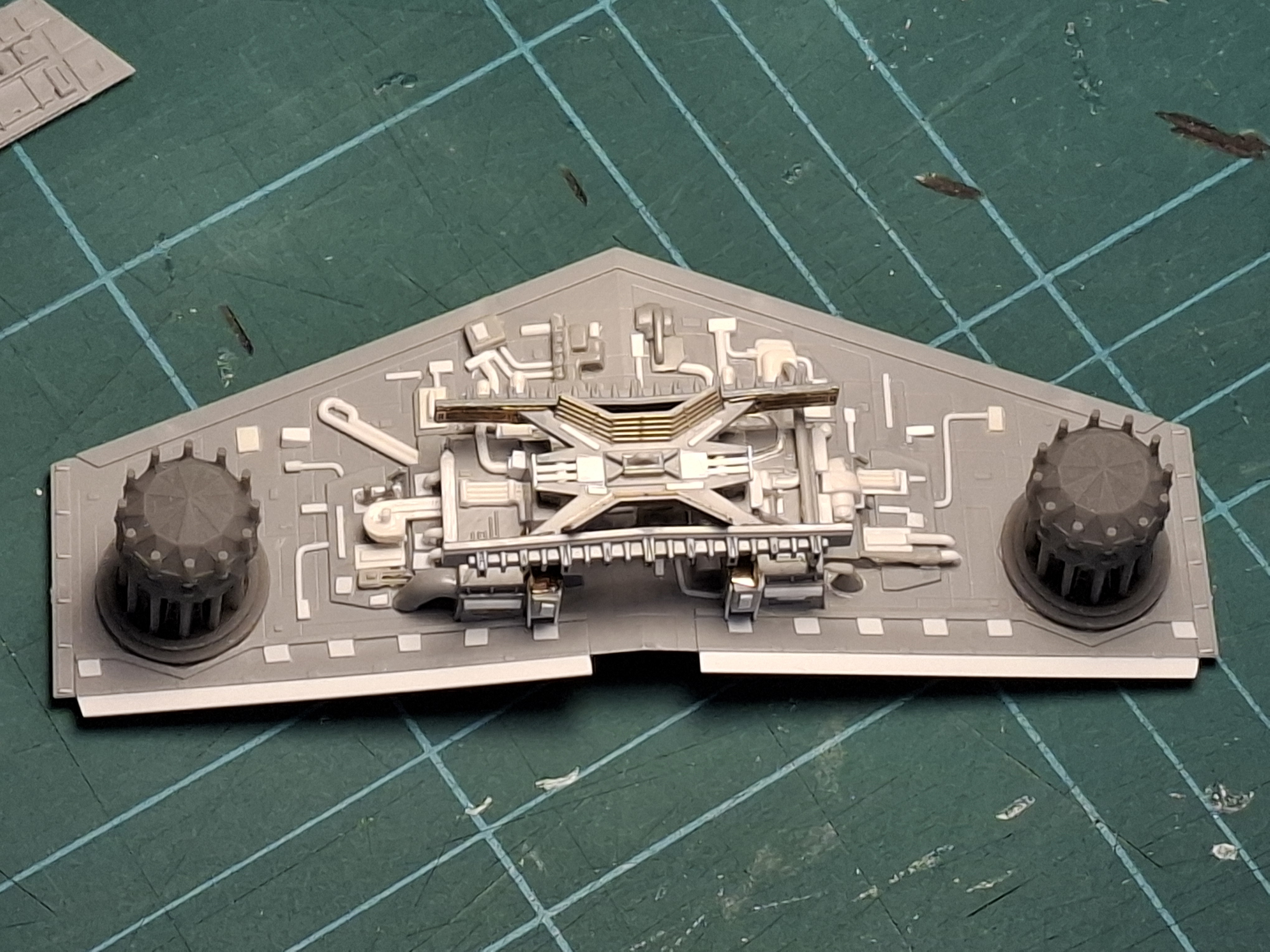

Photo-etch details around the turbo-lasers:

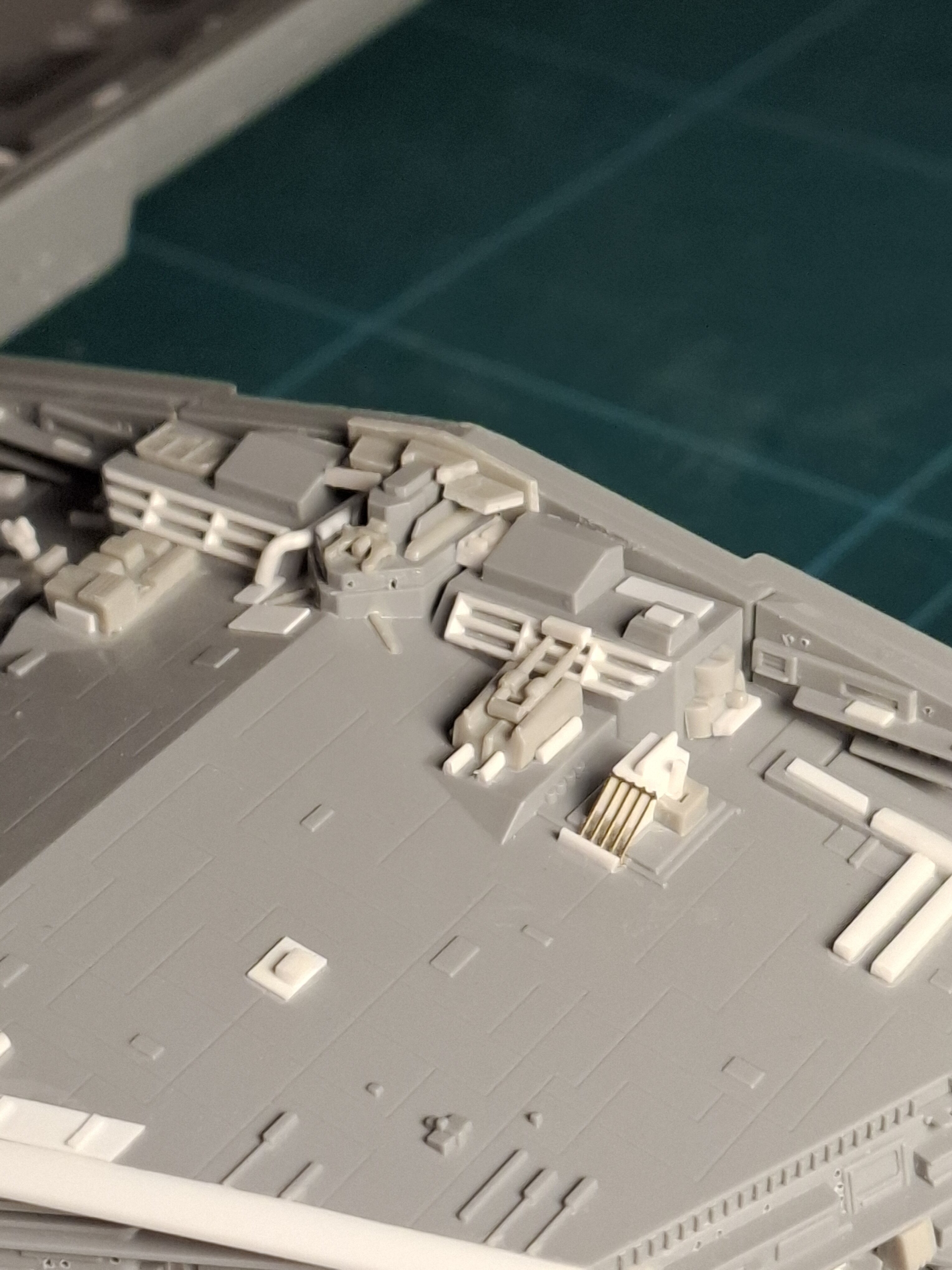

More superstructure and top hull details:

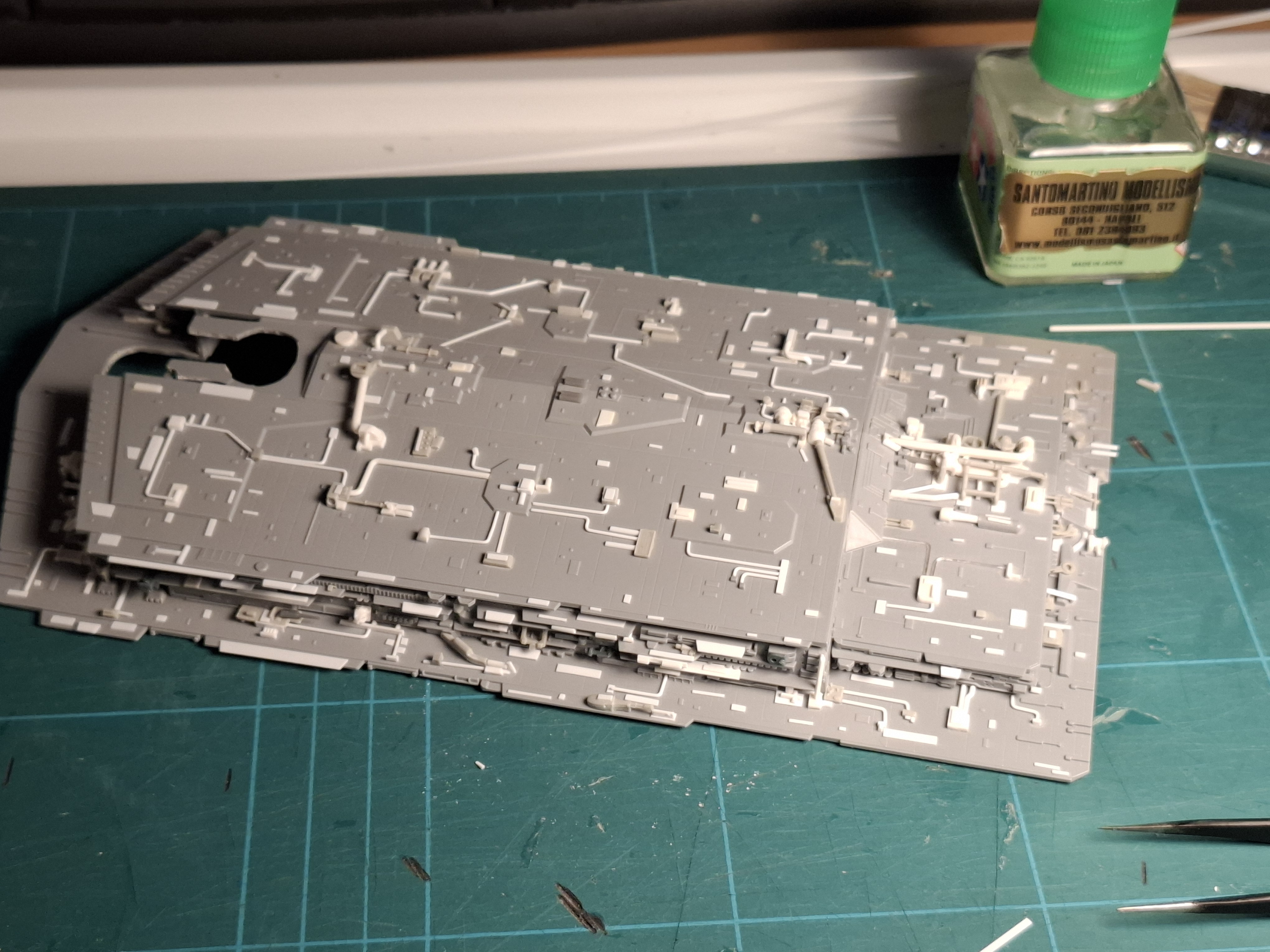

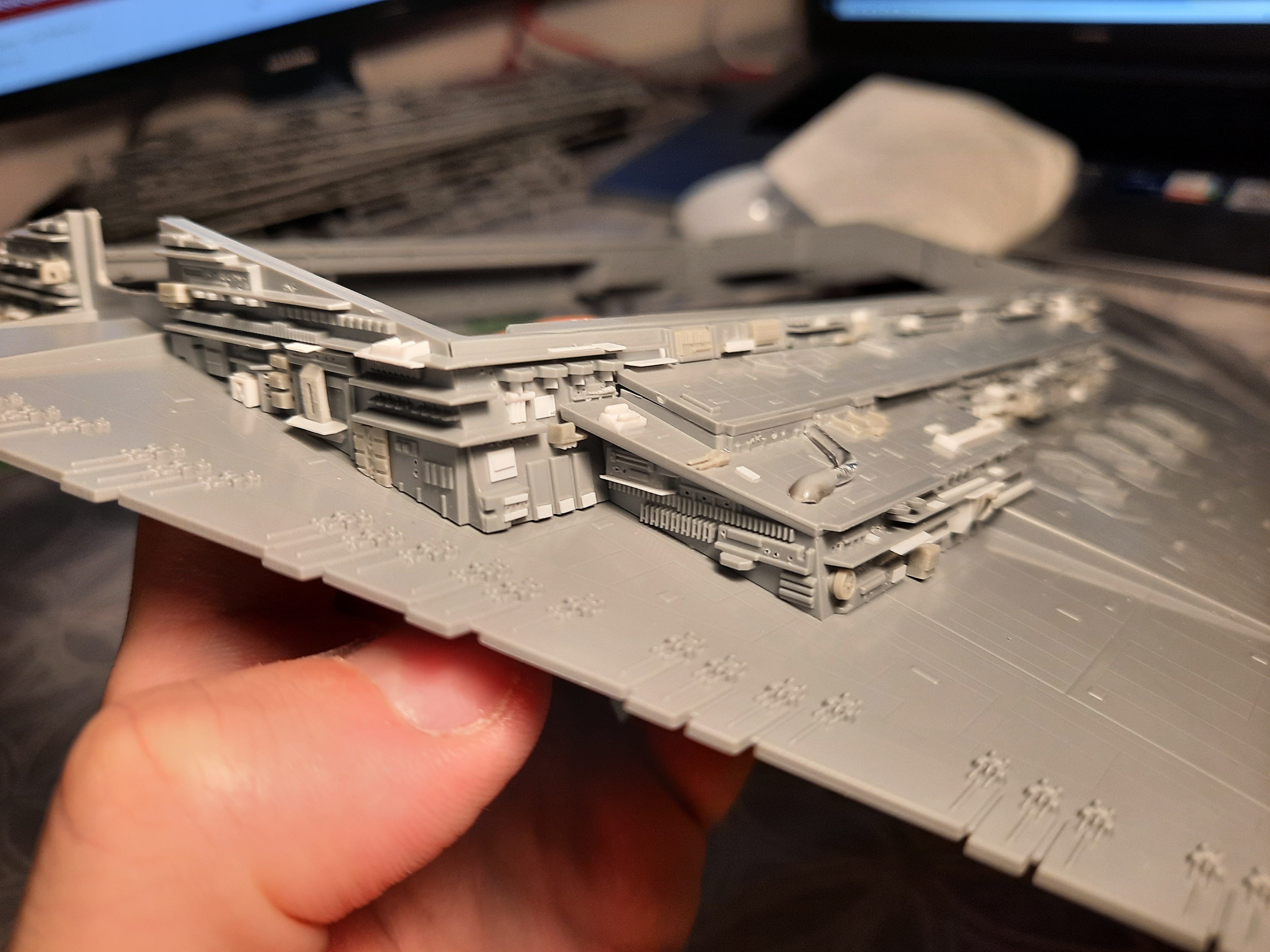

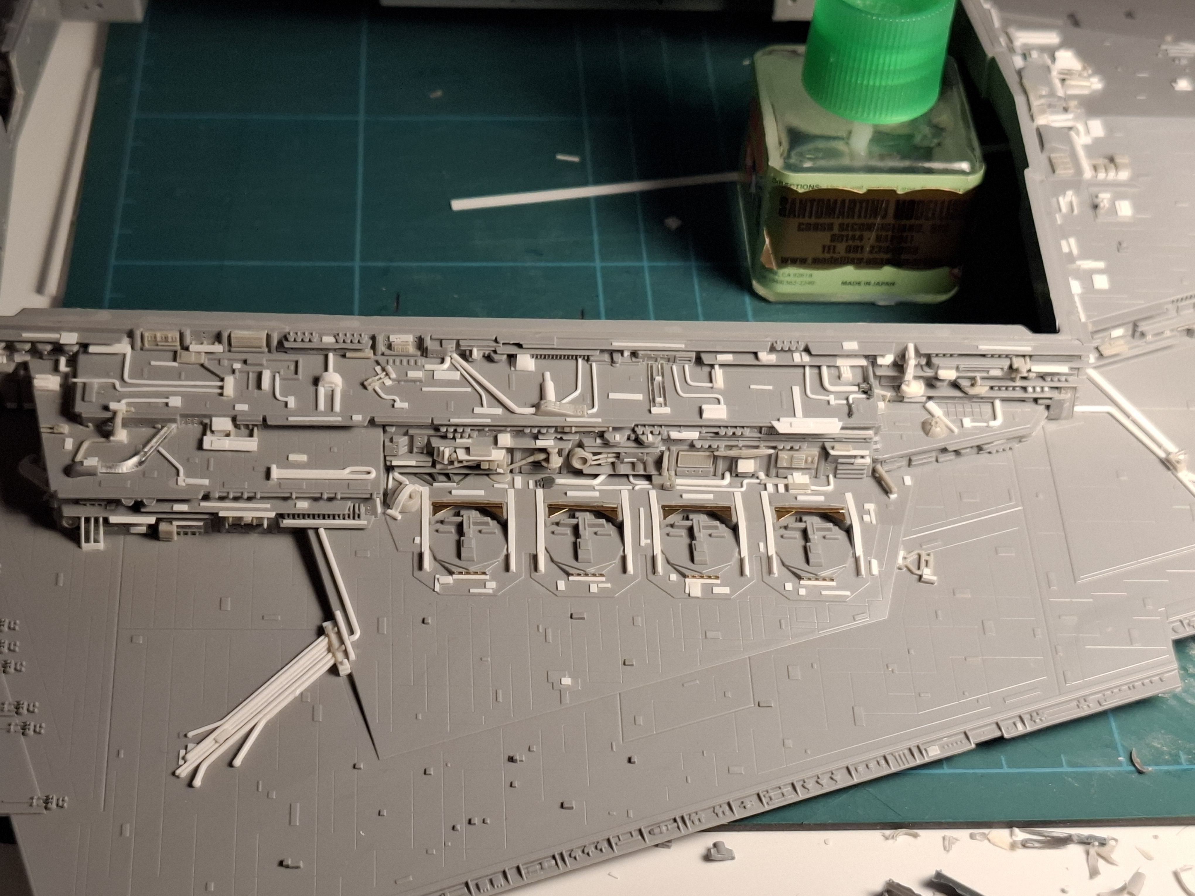

2025: superstructure work resumes
This spring I found the motivation to resume work, and setup a small work-bench space in my flat.

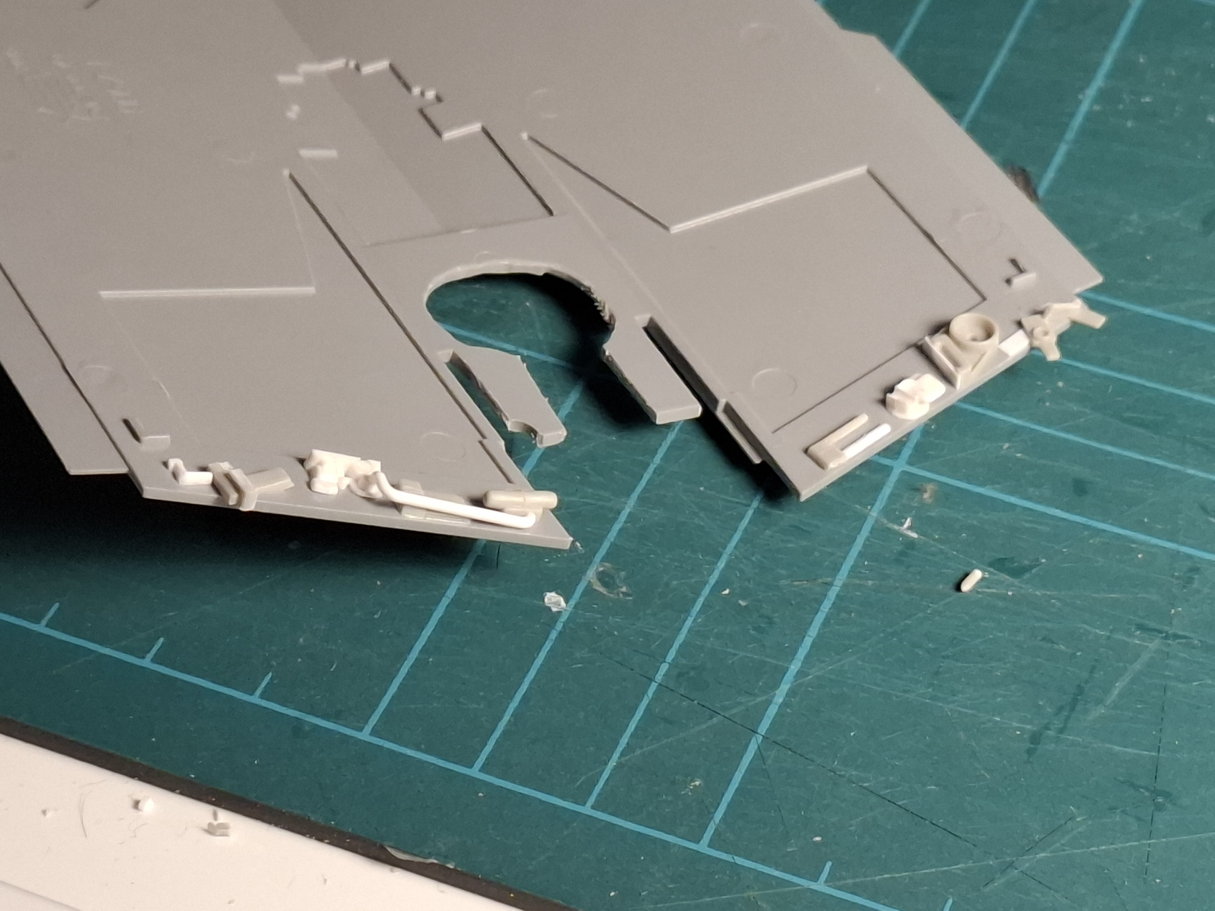

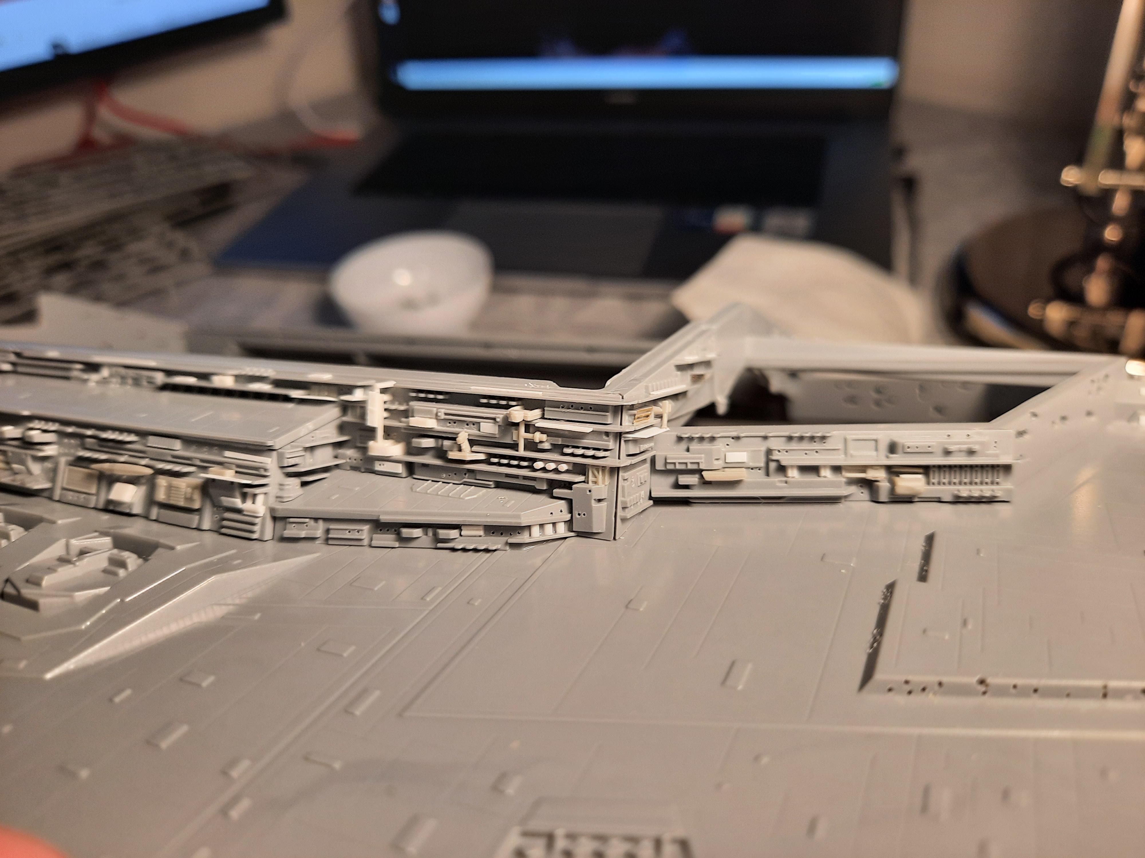

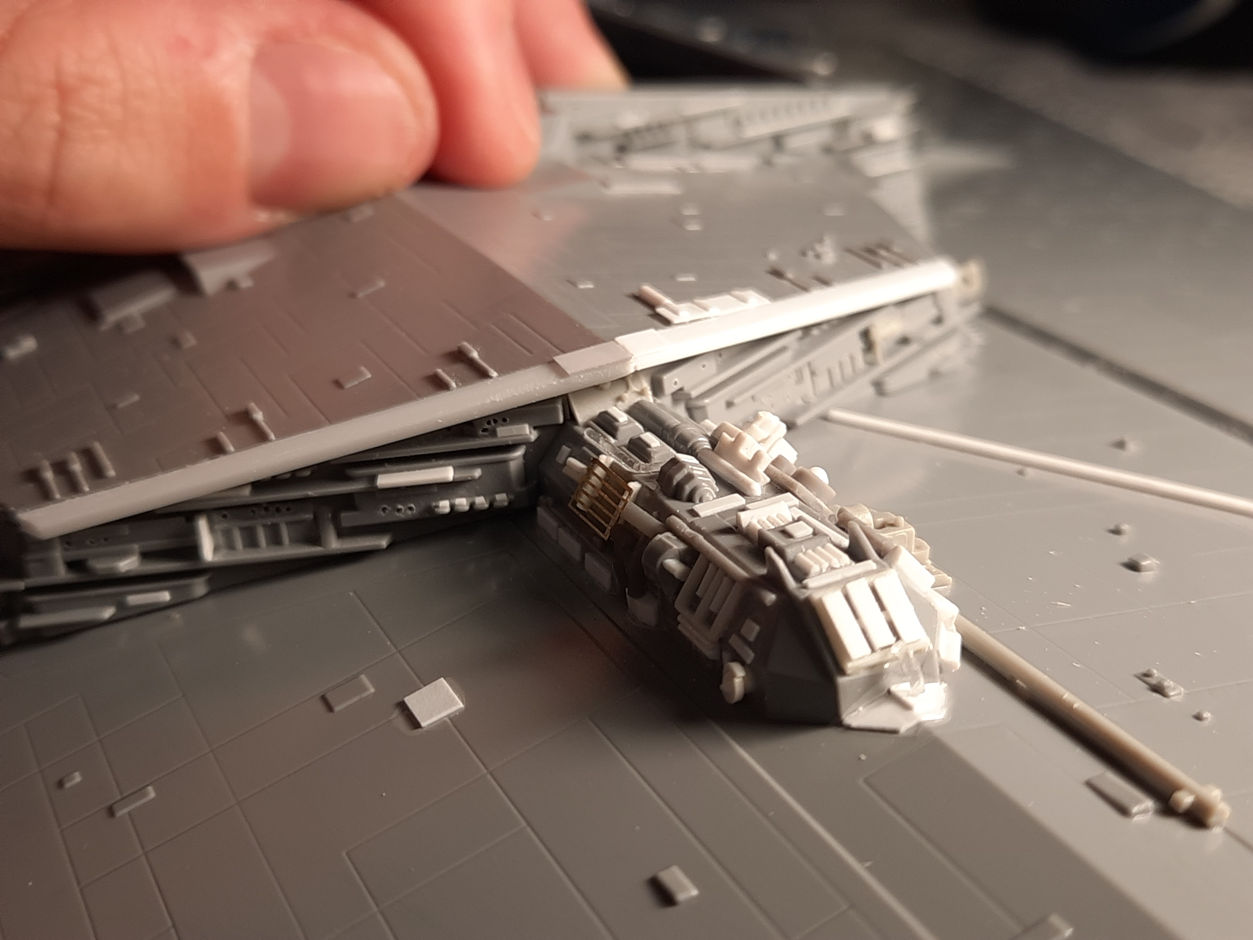

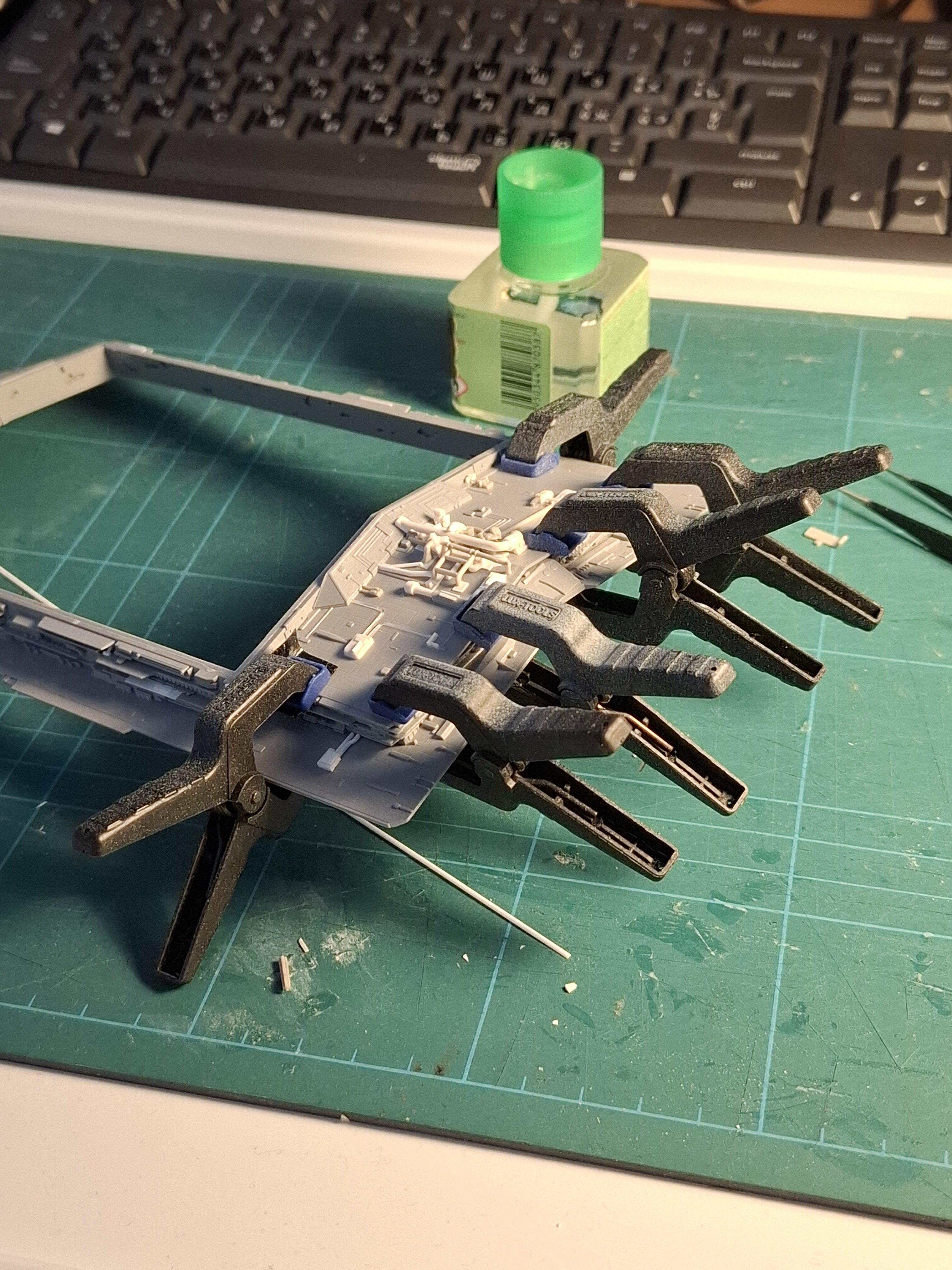

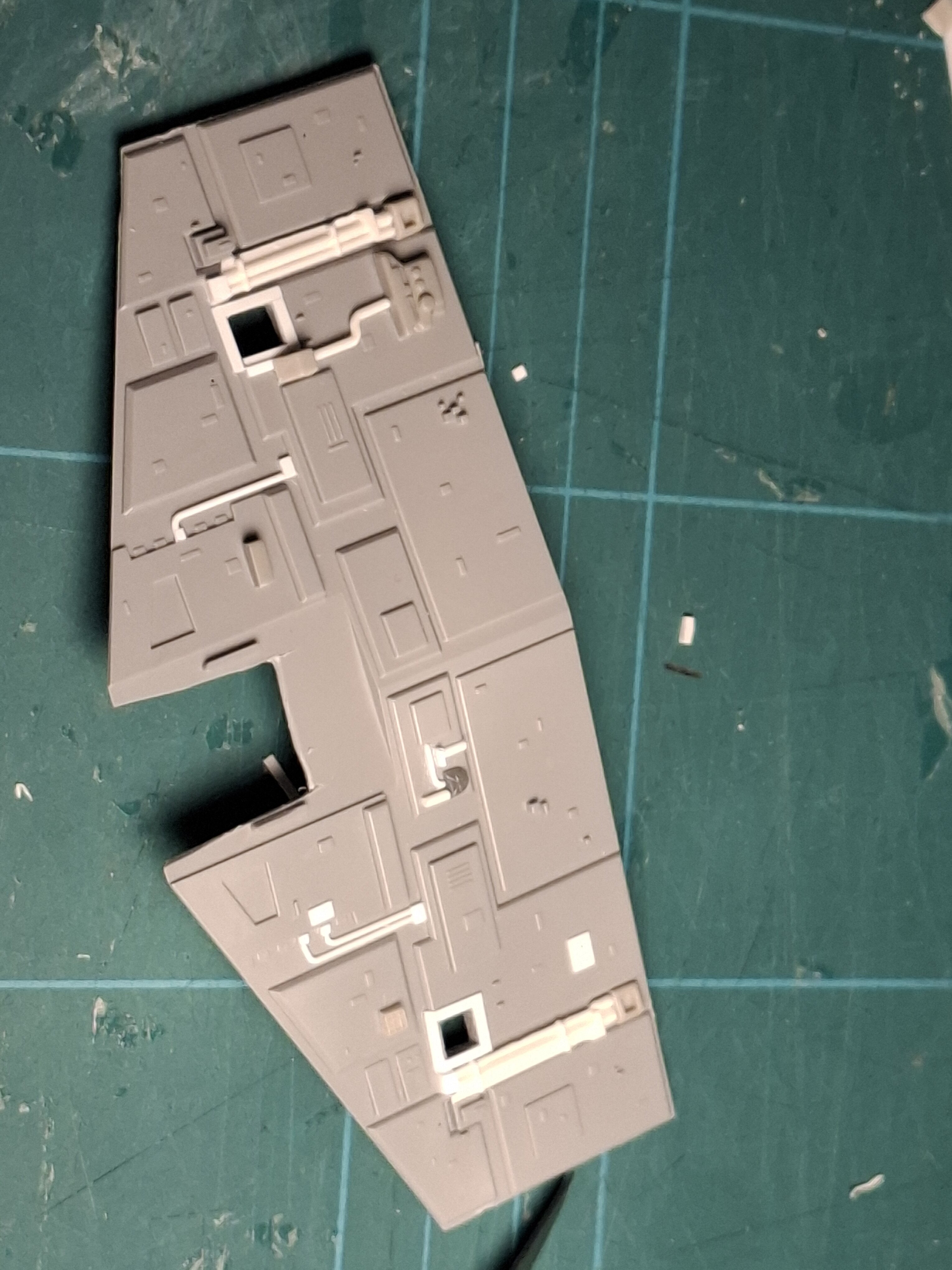

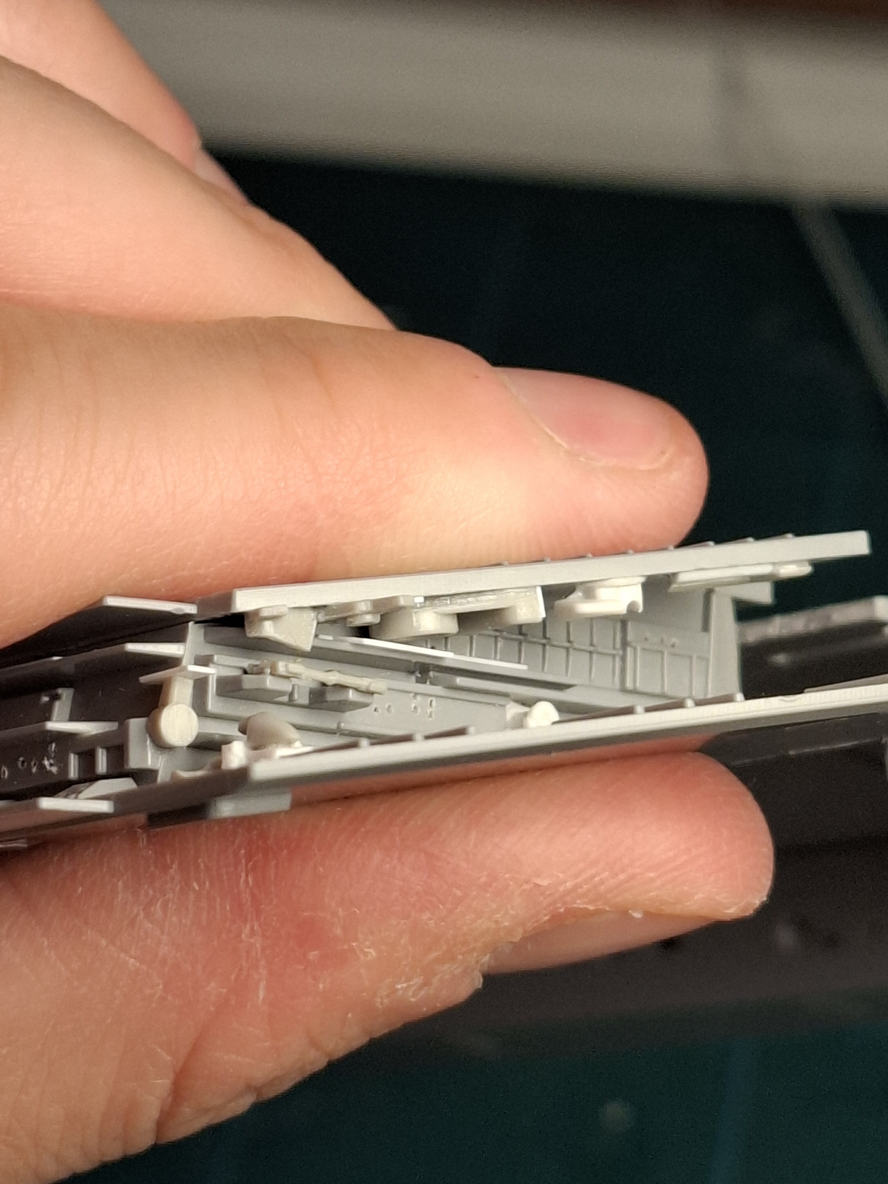

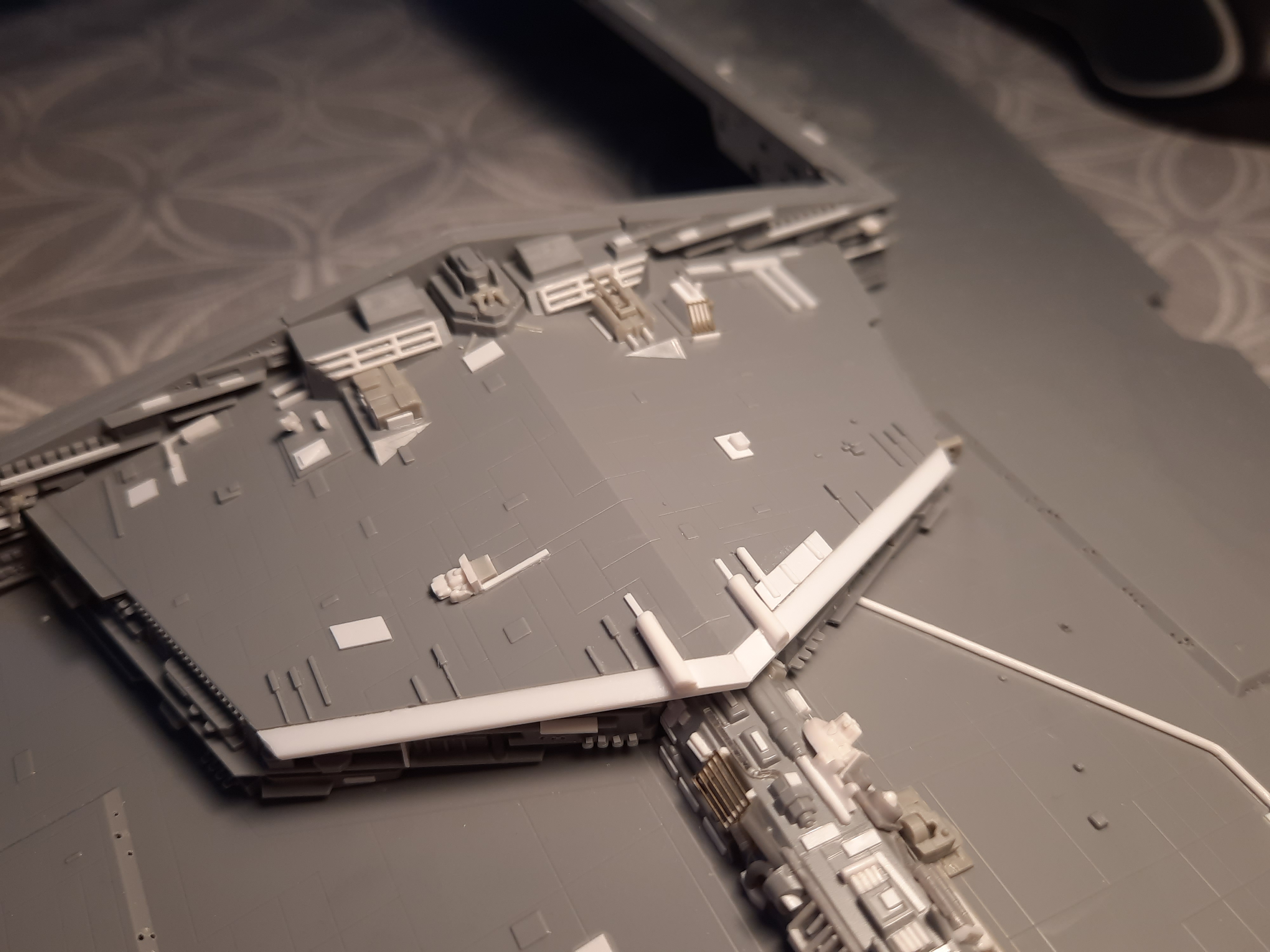

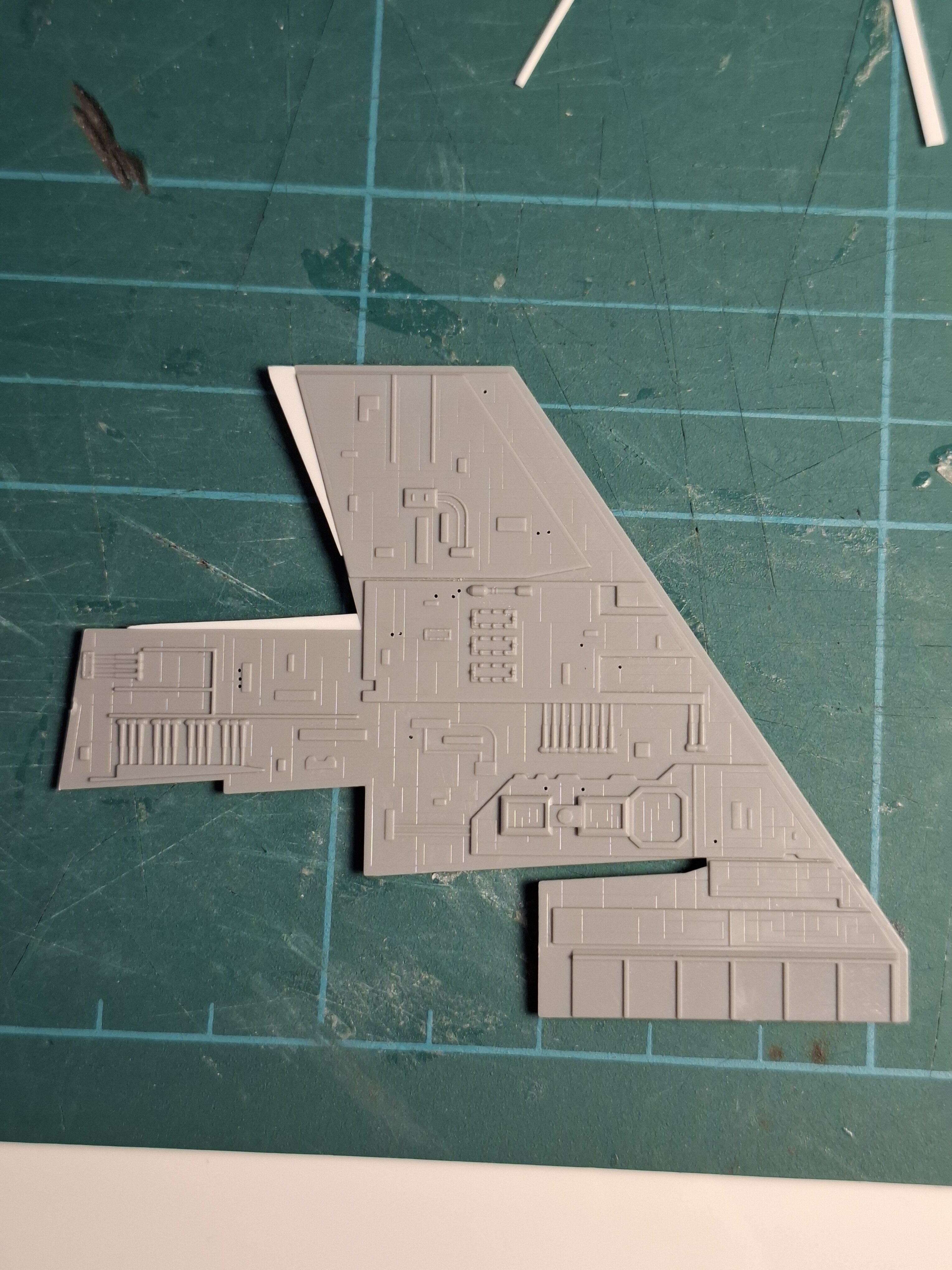

I glued the top floor superstructure parts together save for the large roof piece, might need to keep it open for wiring:

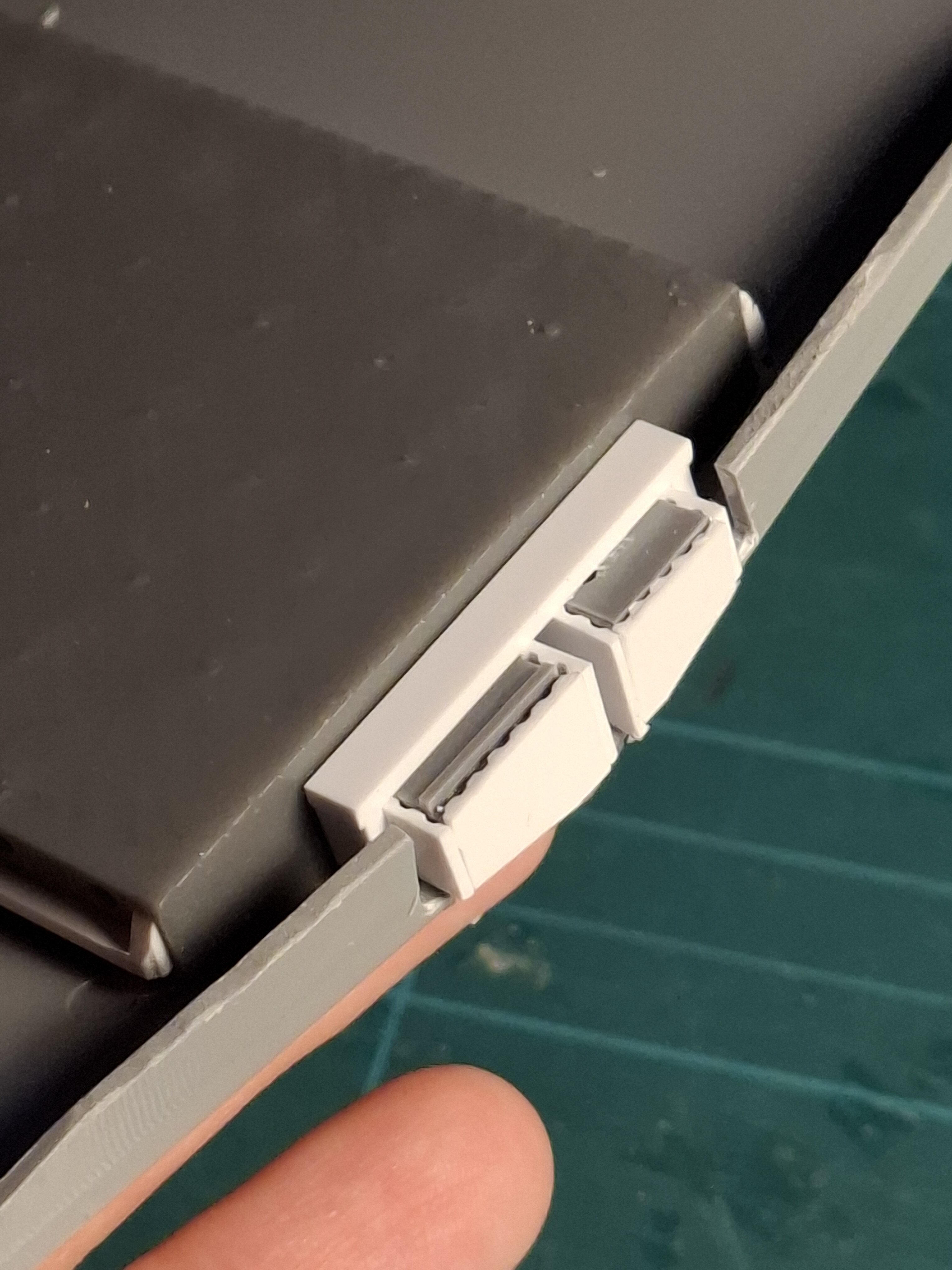

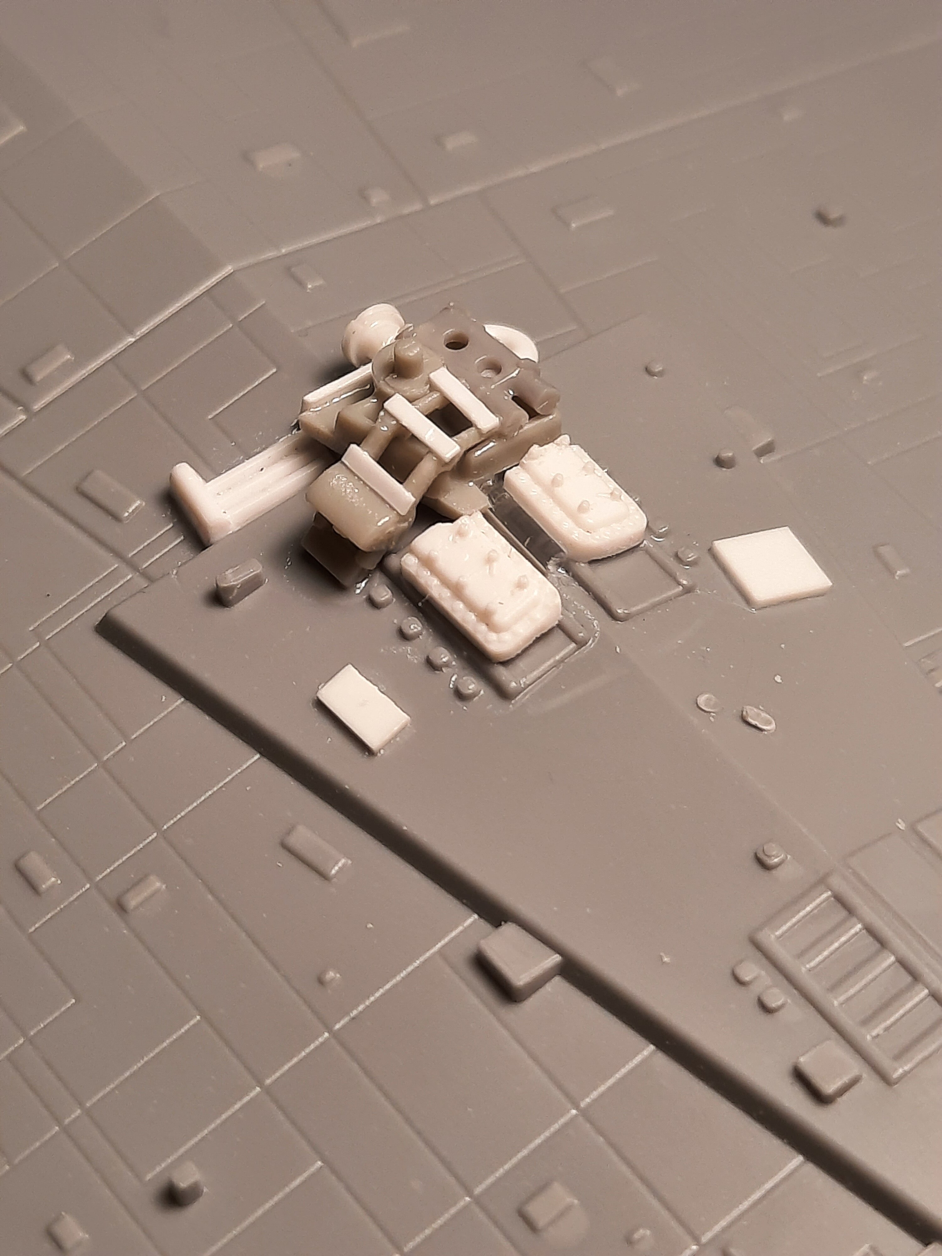

I put a couple greeblies that 'clib a step' there at the front:
I also put details on the underside of the back ledge of the roof part:
And on the ledge of the middle roof part as well:

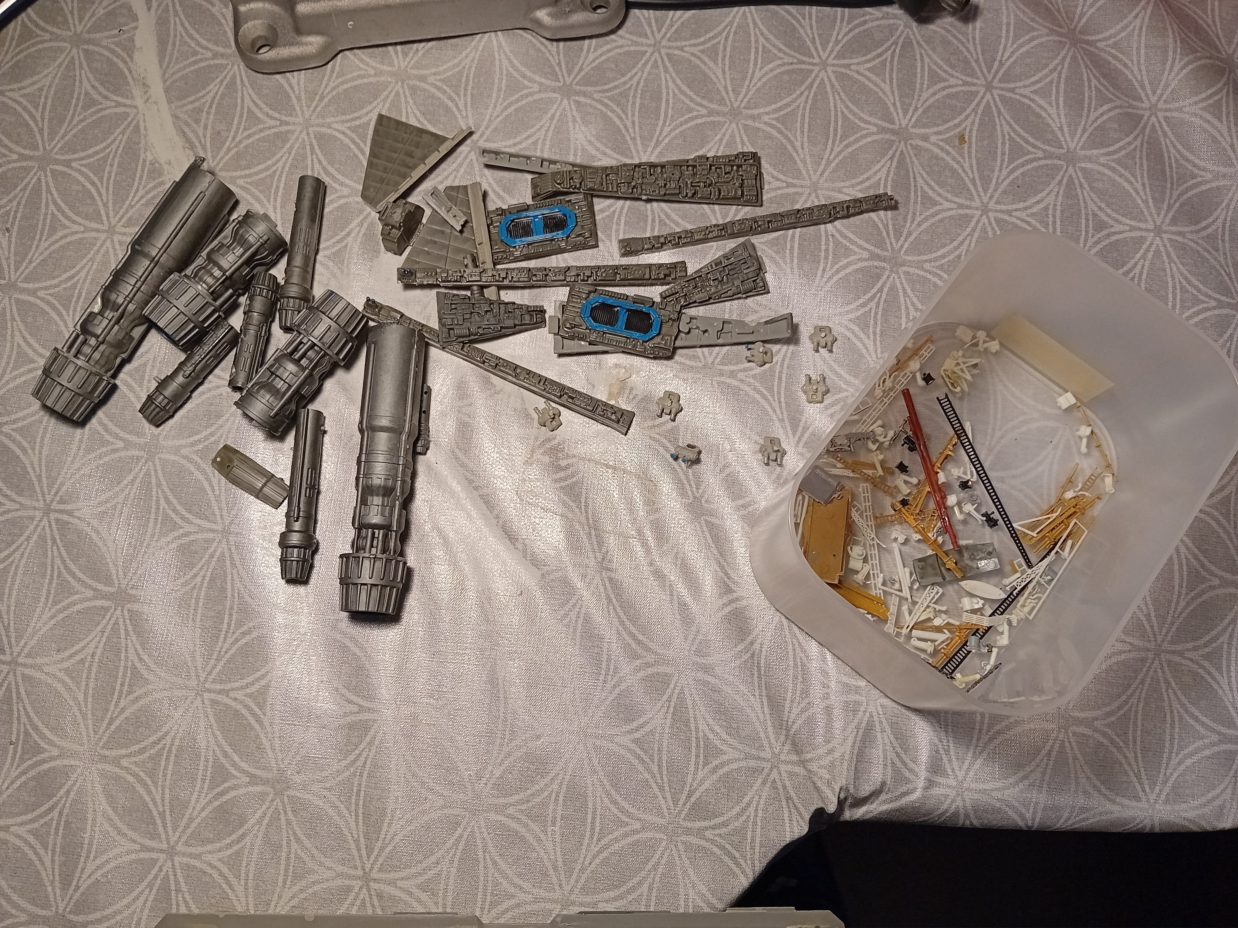

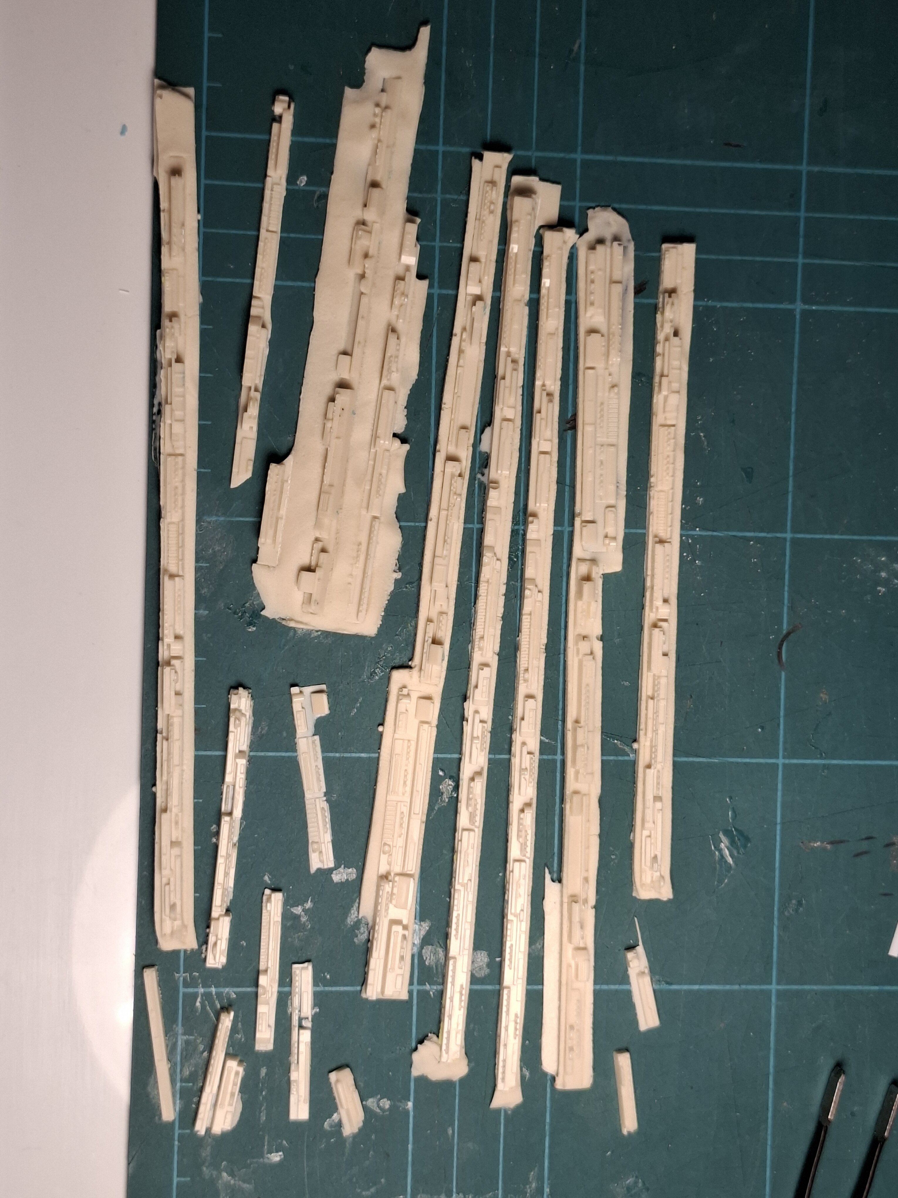

I should mention the additional greeble sources I acquired:
9 Tamiya Japanese ship kits I got for cheap:
As well as parts from two old half-broken kits I made when I was 12 or something, 1:2700 Venator kit and (i think) 1:400 Titanic, both by Revell.
This is before paint-stripping with oven cleaner:

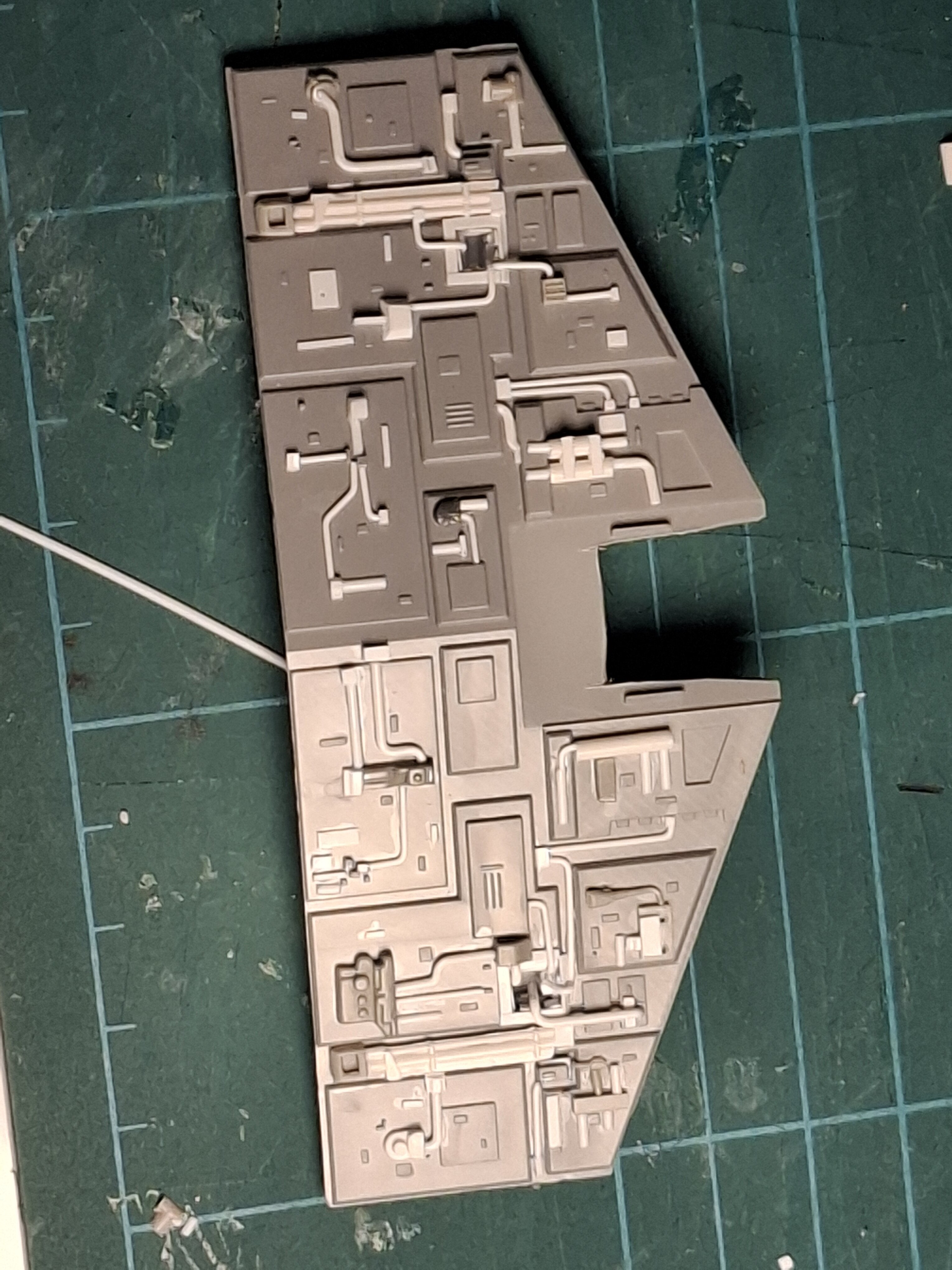

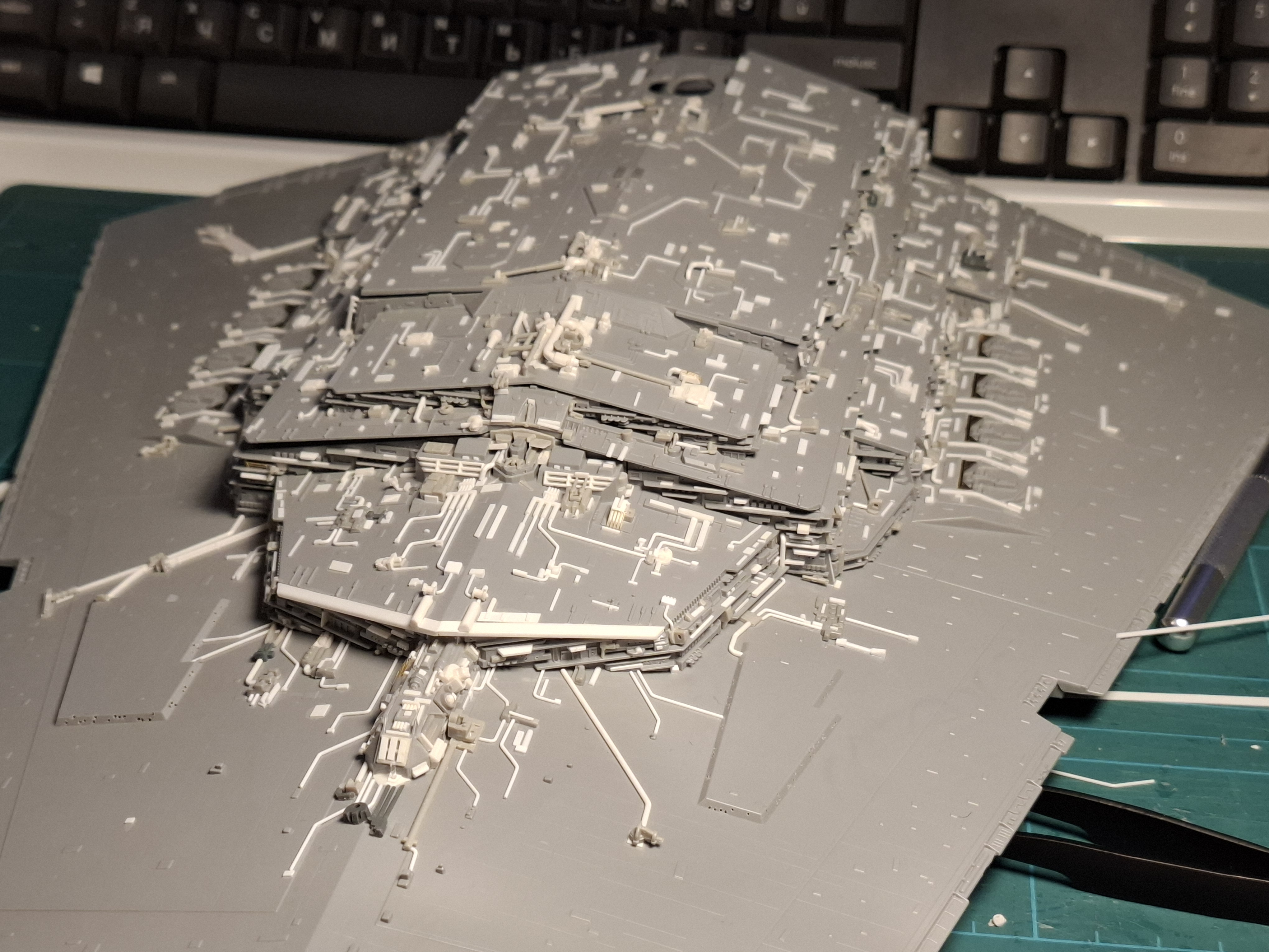

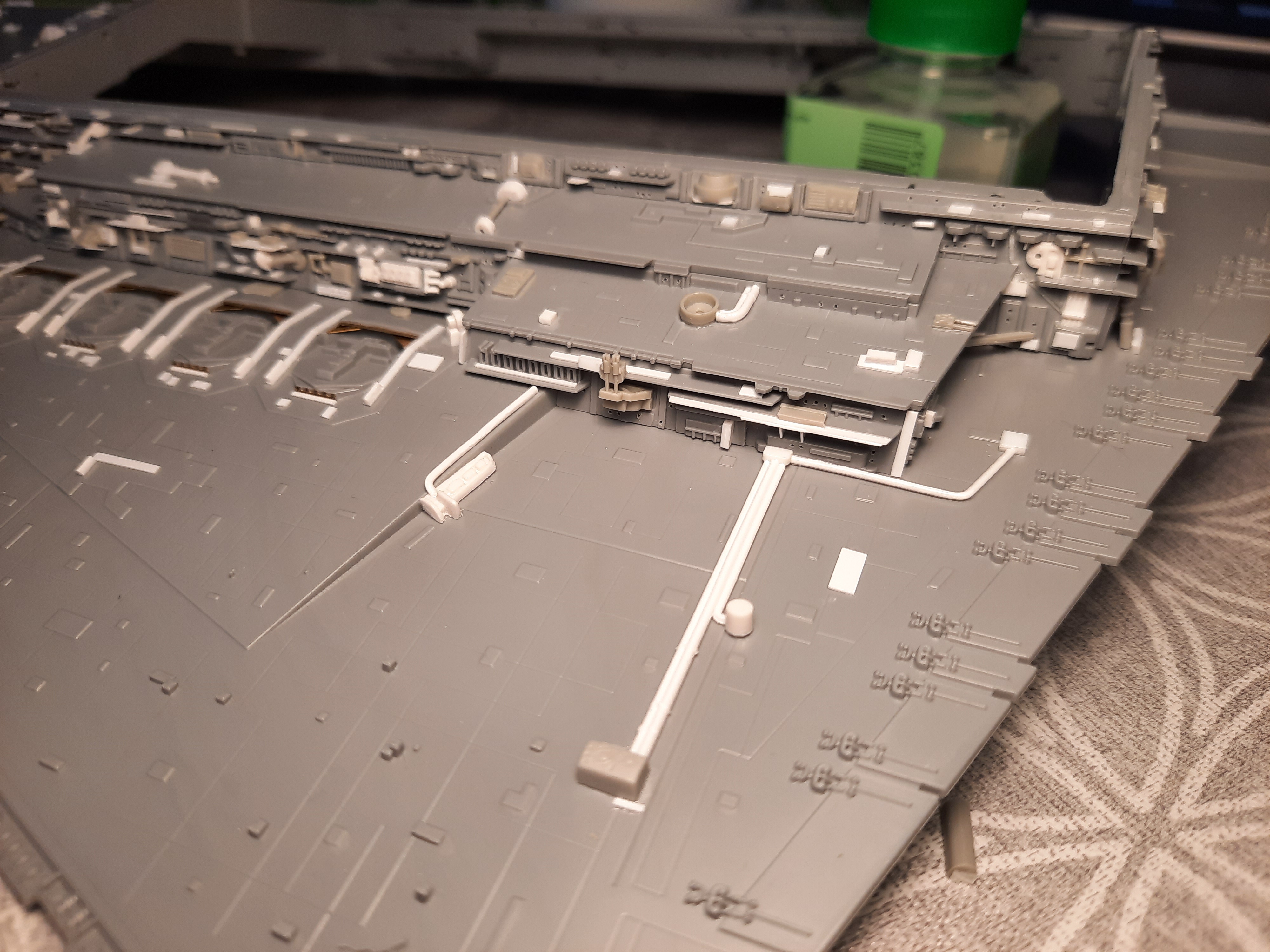

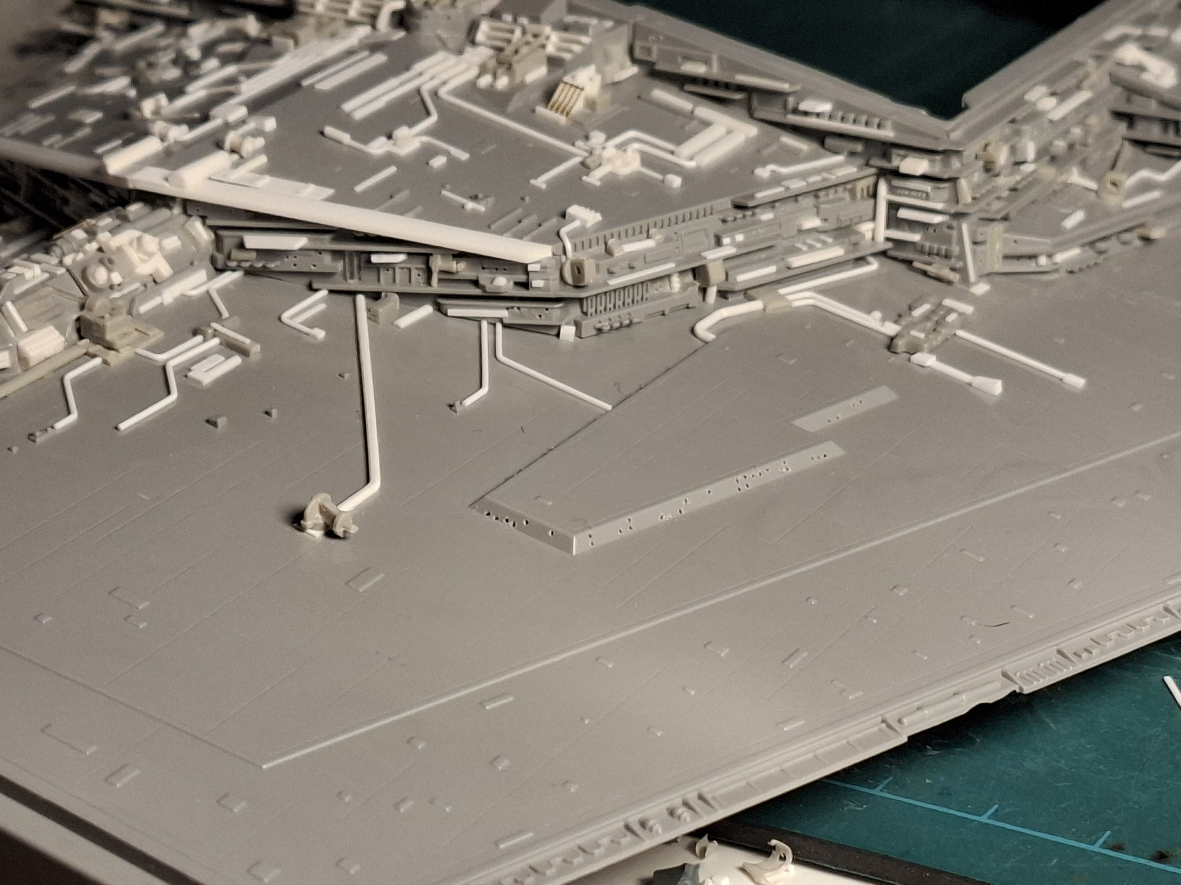

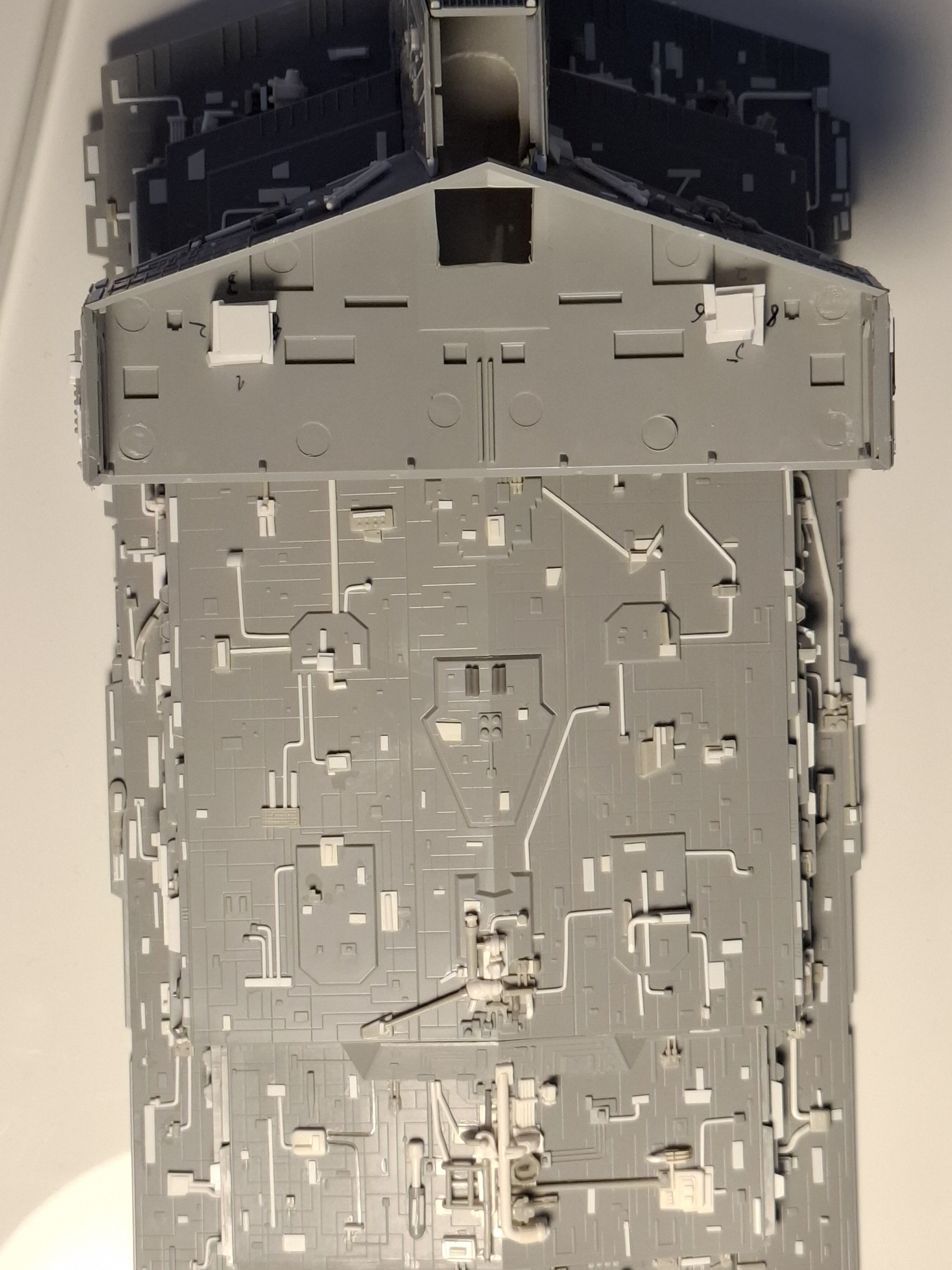

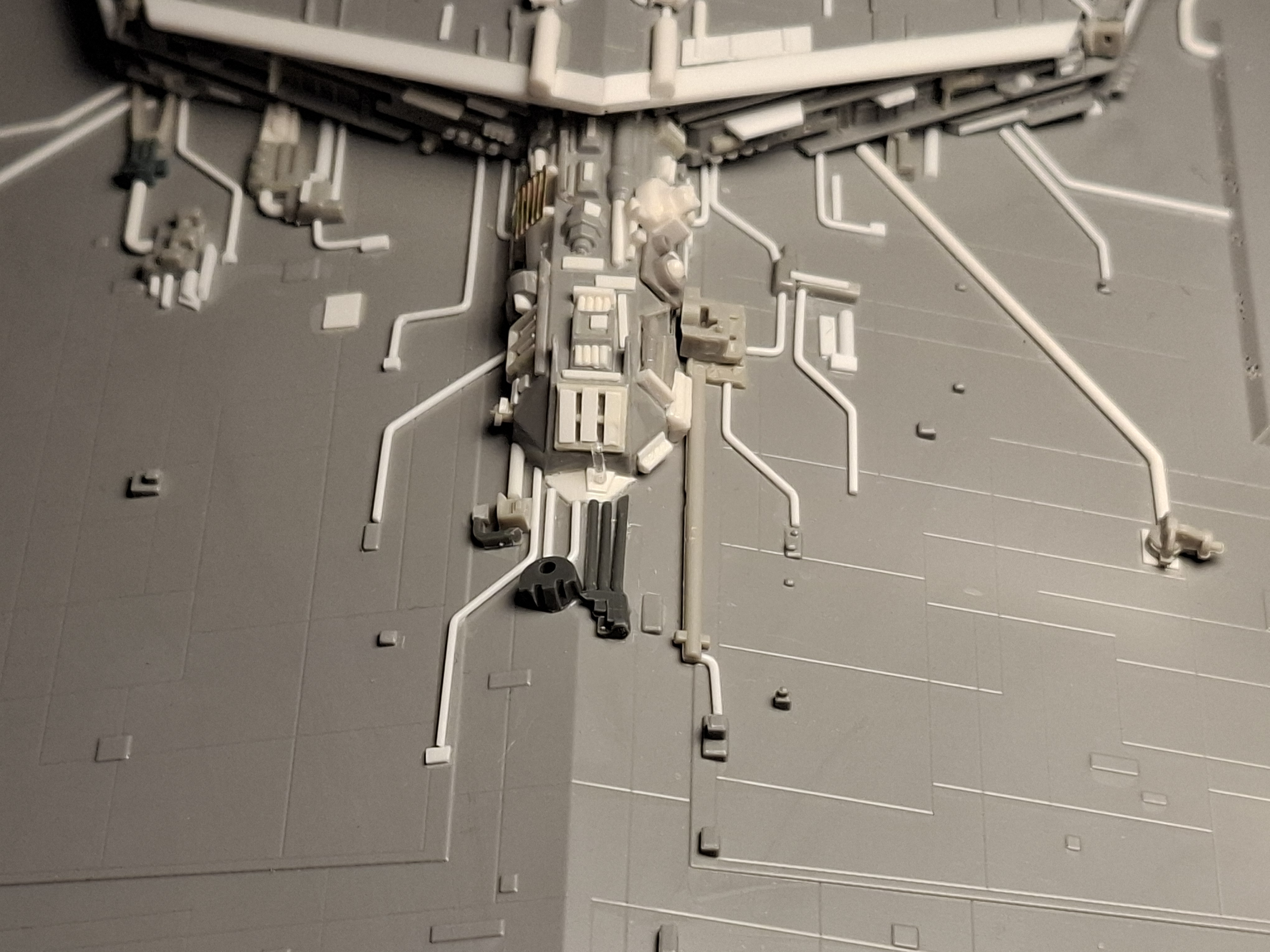

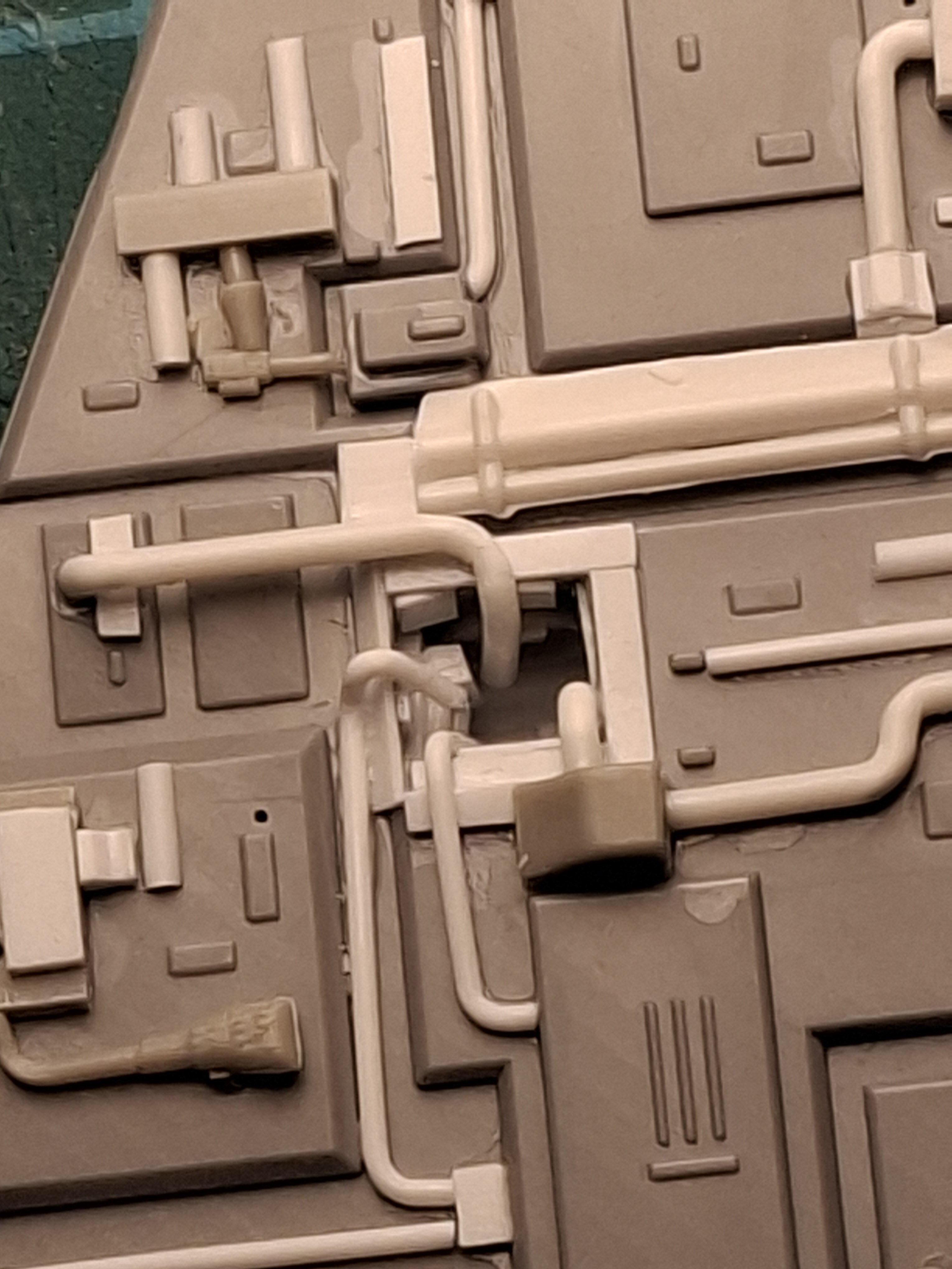

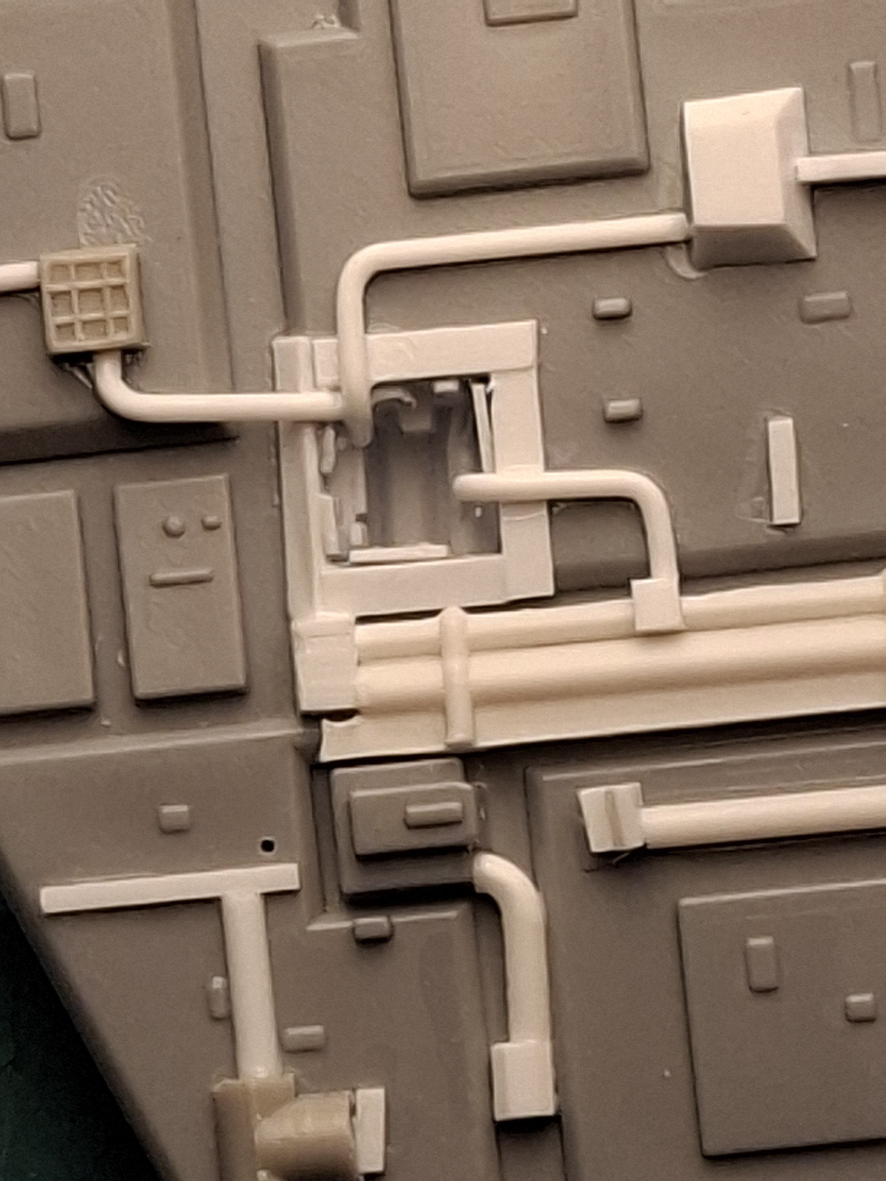

2025: revenge of the pipings

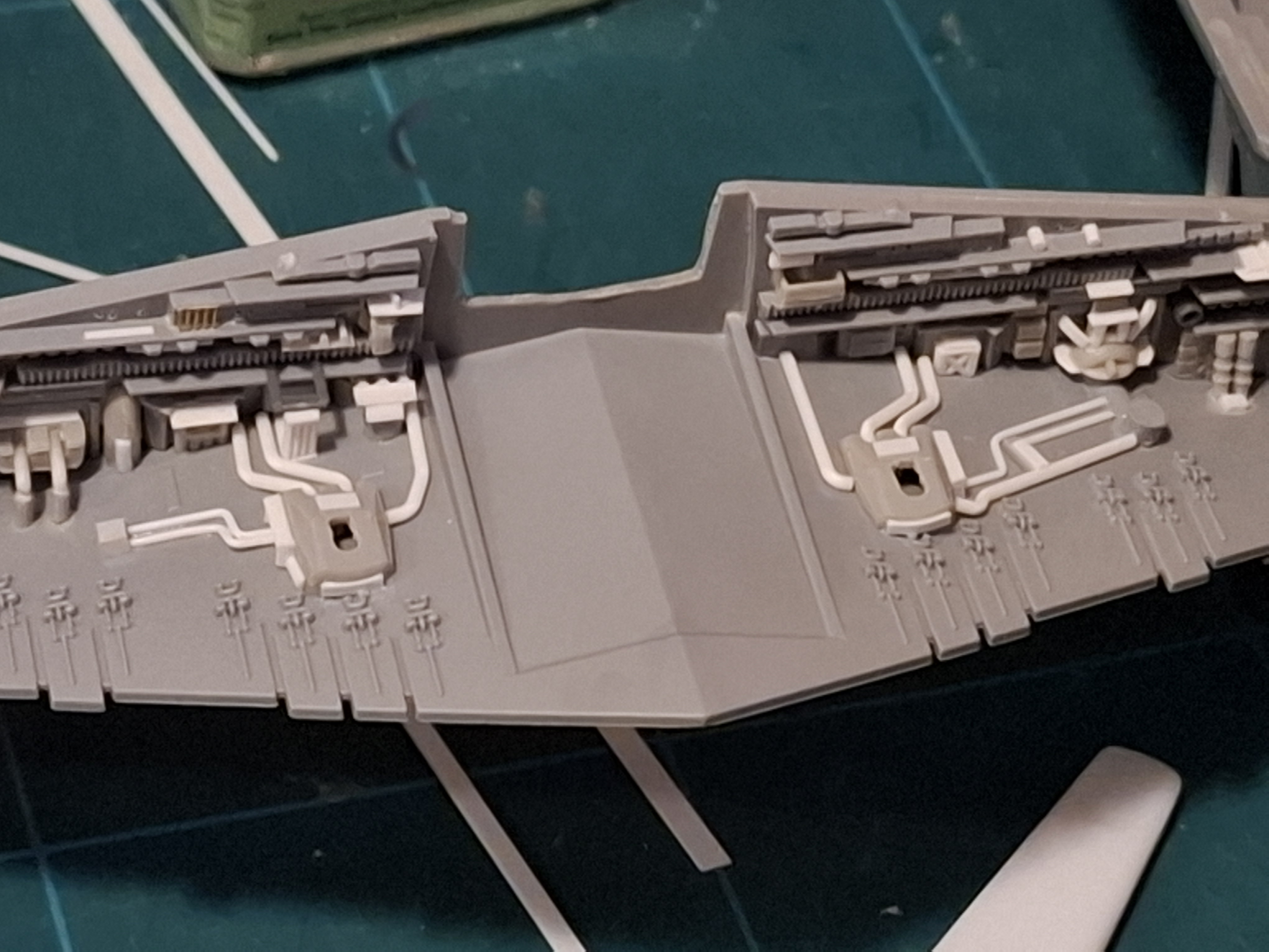

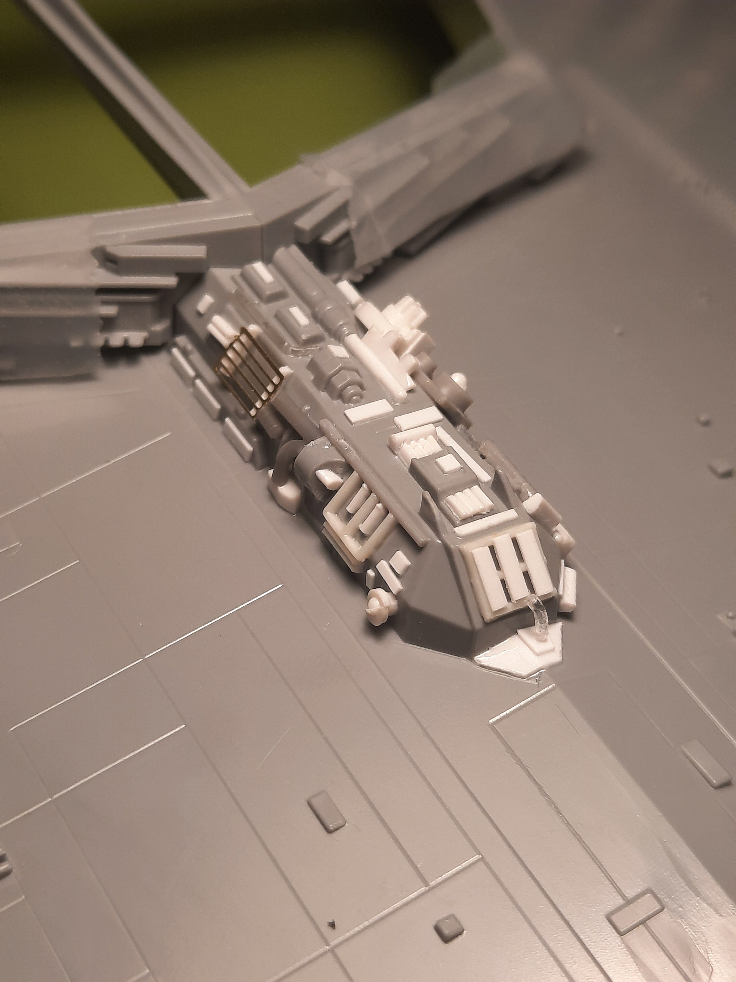

First, re-worked that empty spot above the central viewing platform (striggling to invent names for all the sections):

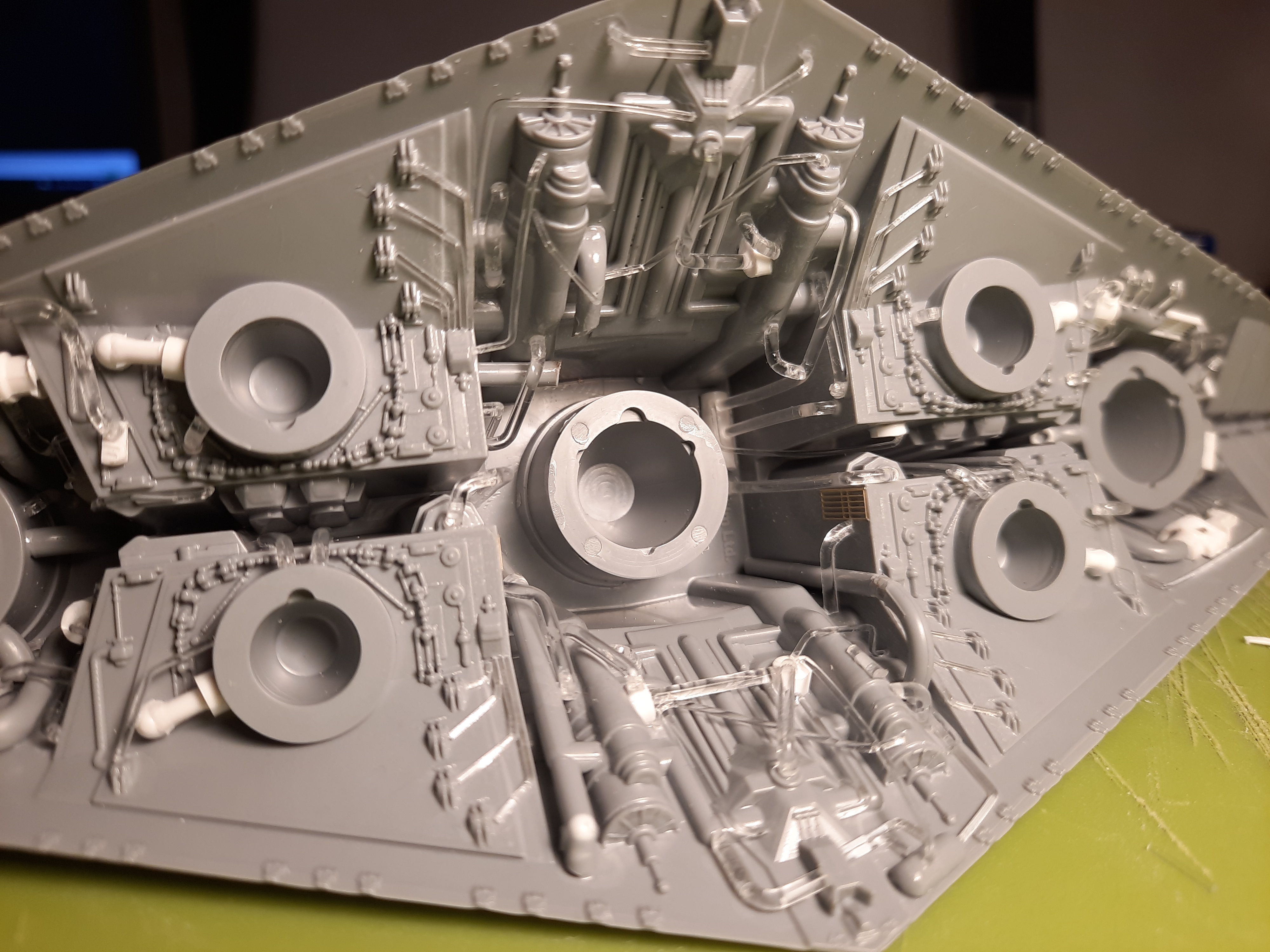

Then, I miiight have gone mad with the pipework at this stage:
One shot in the dark was to add turret barbettes at the very stern of the ship. They will receive two of the Venator dual turbolaser turrets.
In my lore, this was an afterthought modification to this ISD-II after someone pointed out the weak spot at the back of the ship:

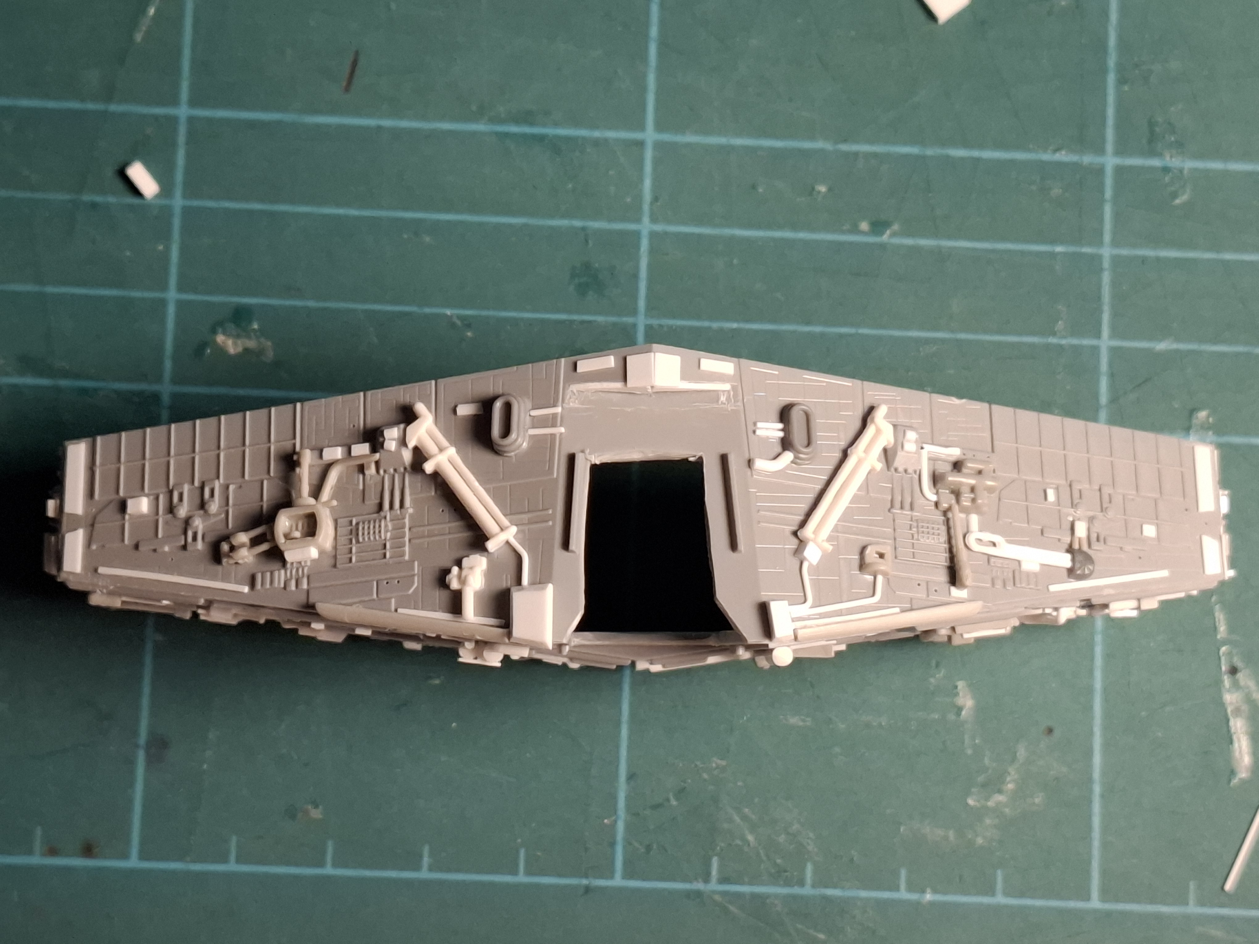

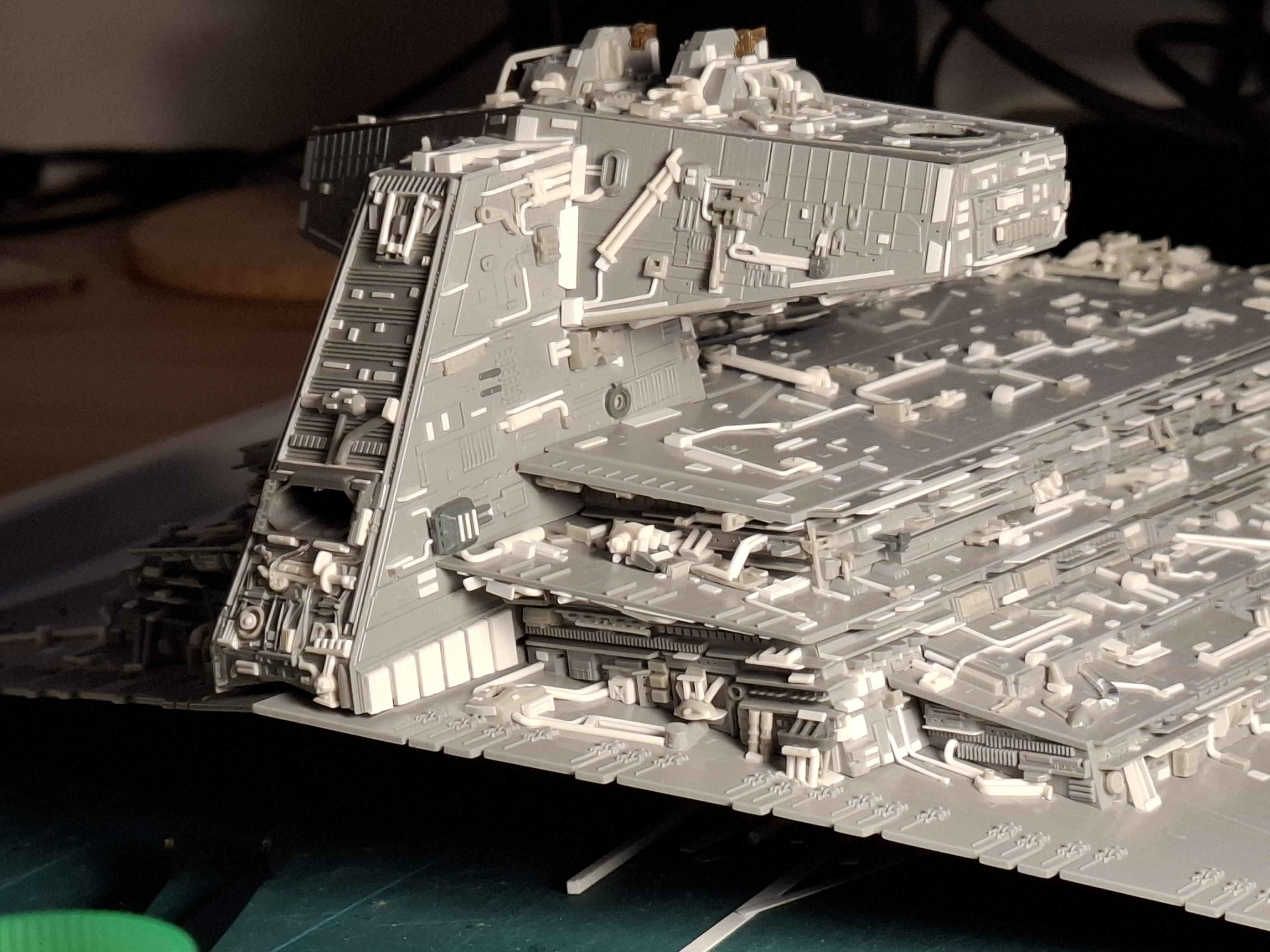

And, the superstructure as a whole:

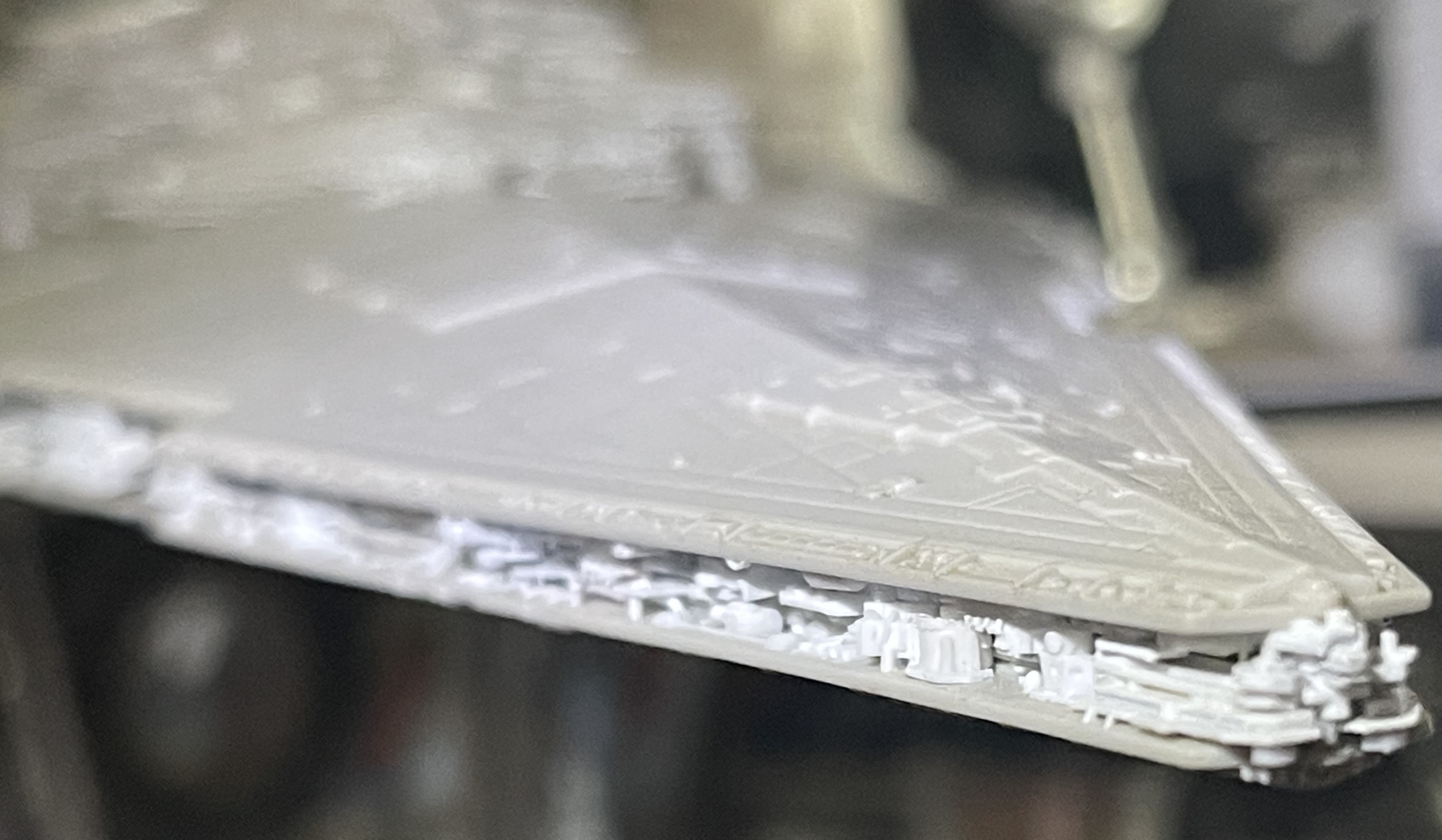

I'm calling the superstructure mostly done, barring the occasional greeble to cover a seam.
The hull will most likely receive scattered details once it's time to join the front and back segments

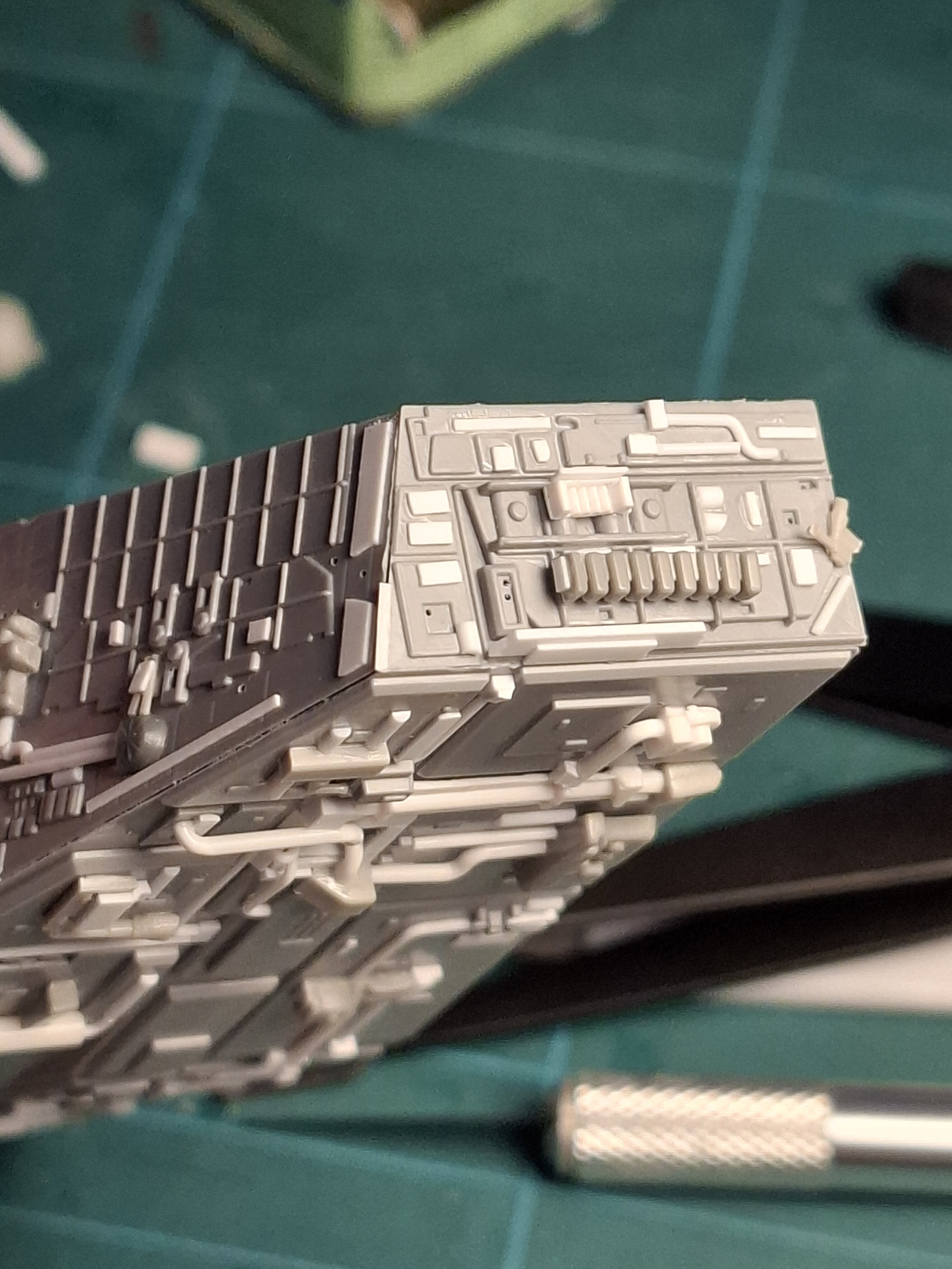

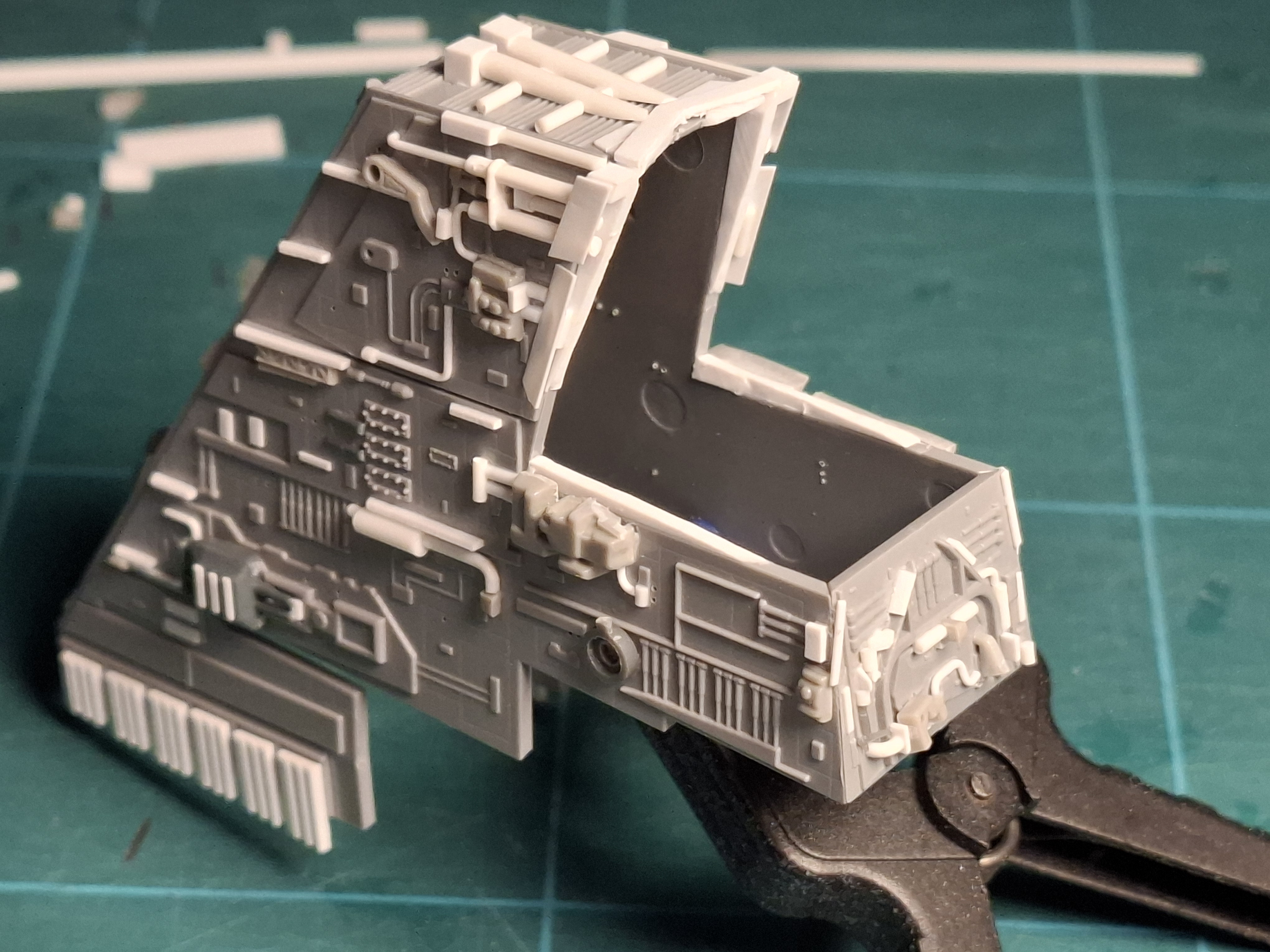

2025: Bridge detailing, part 1

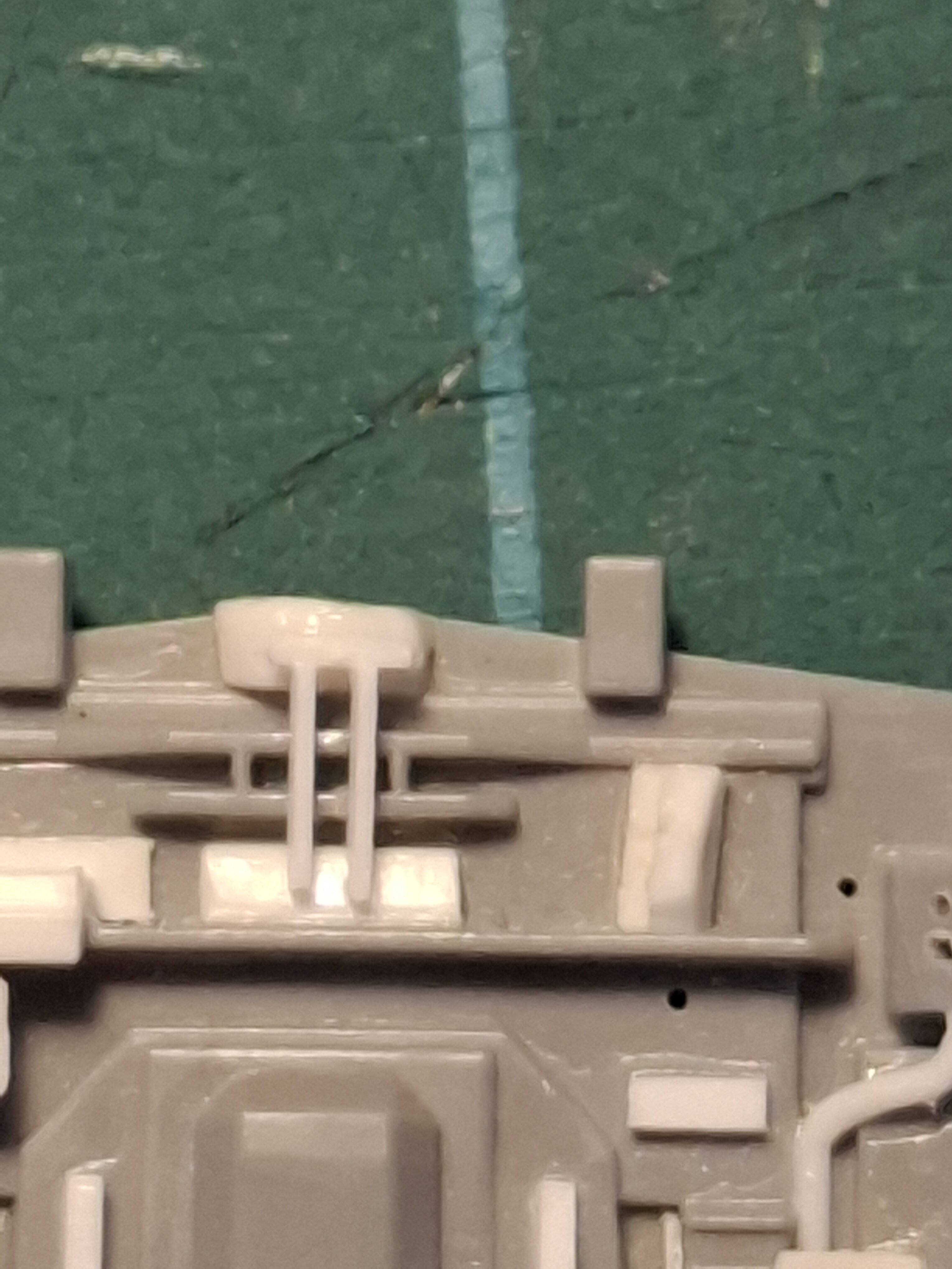

More detailing on the bridge front faceplate, including replacing two brass details with styrene strips, as they were flimsy and rattled themselves off:

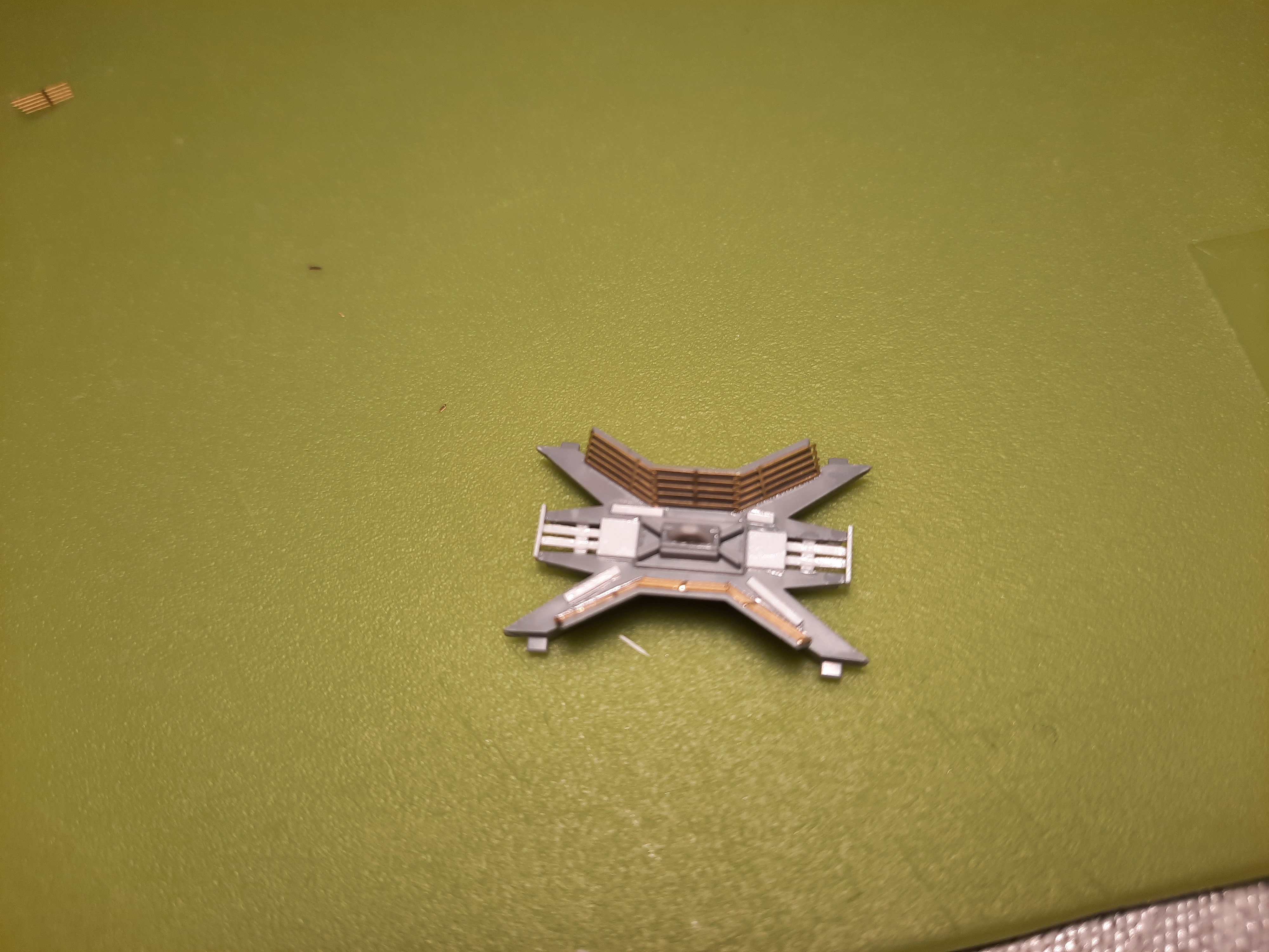

Realised I never showed the antenna cross-bracing (work was done years ago):
a ton more detailing on the bridge roof (looking at the pictures I realise there's a detailing not quite set right that I'll need to fix):
and with all the array parts:
the two sides:
And the back. This is not finished as is, I intended to add more detail when the tower neck will be sorted out:

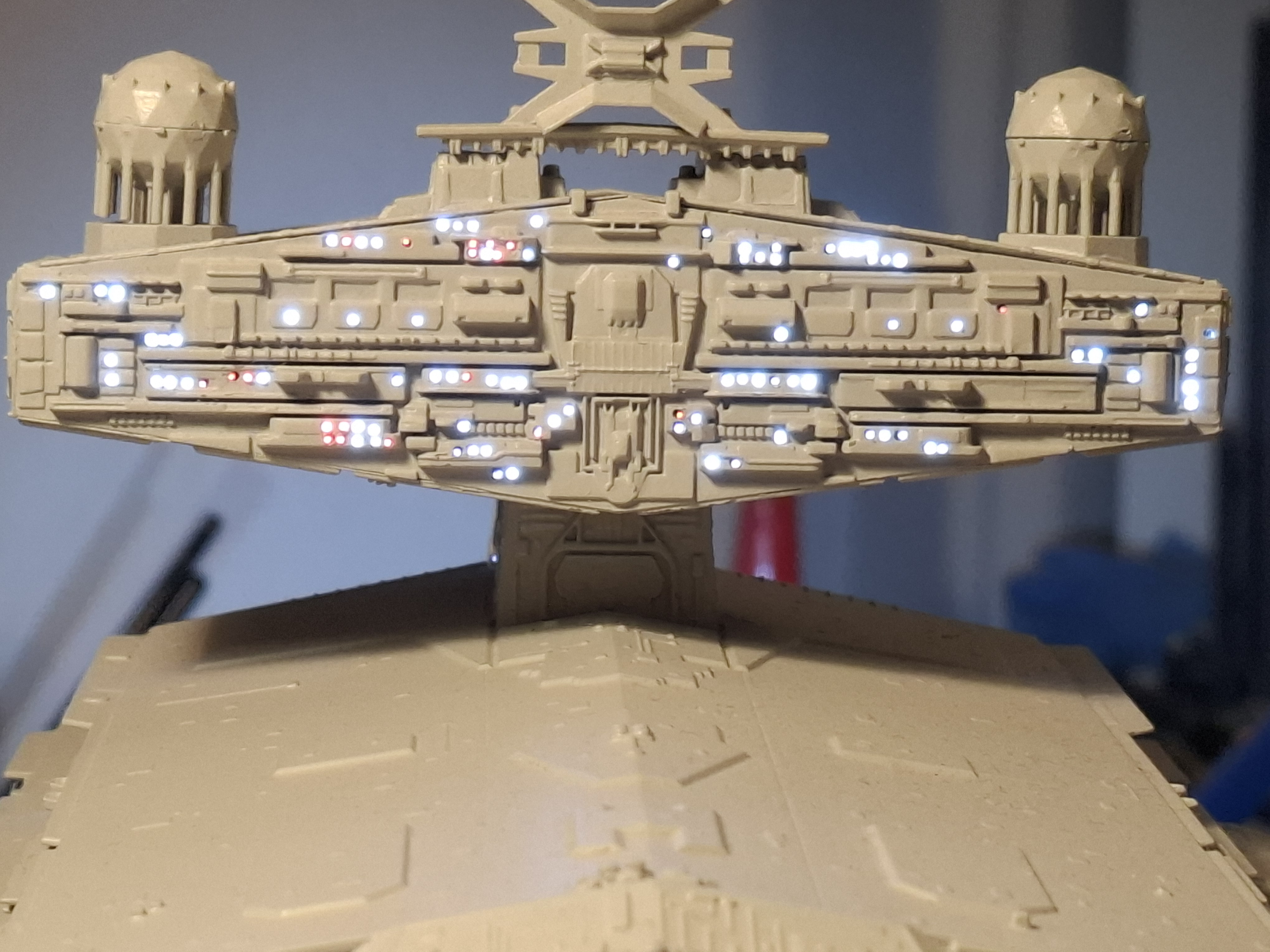

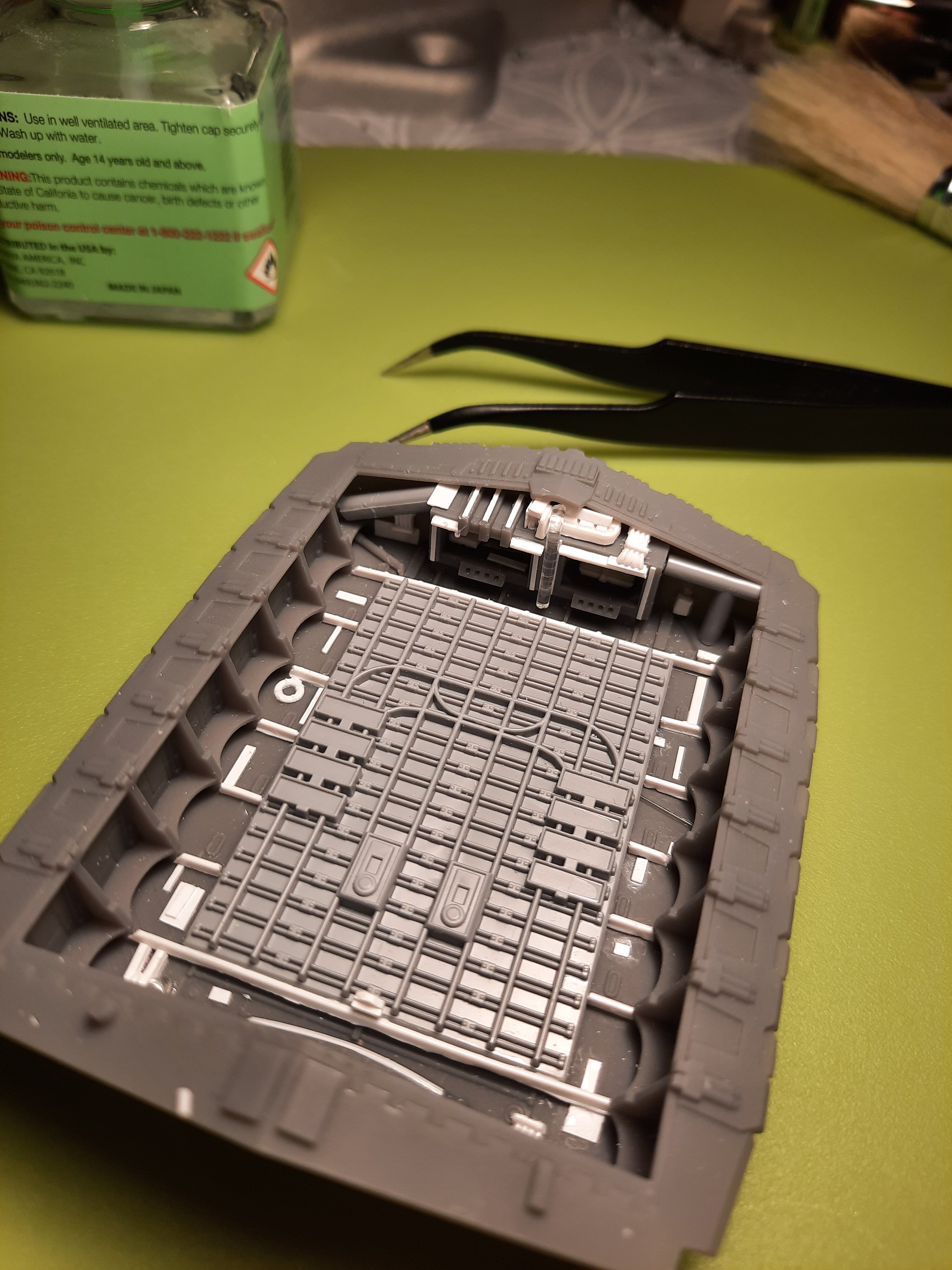

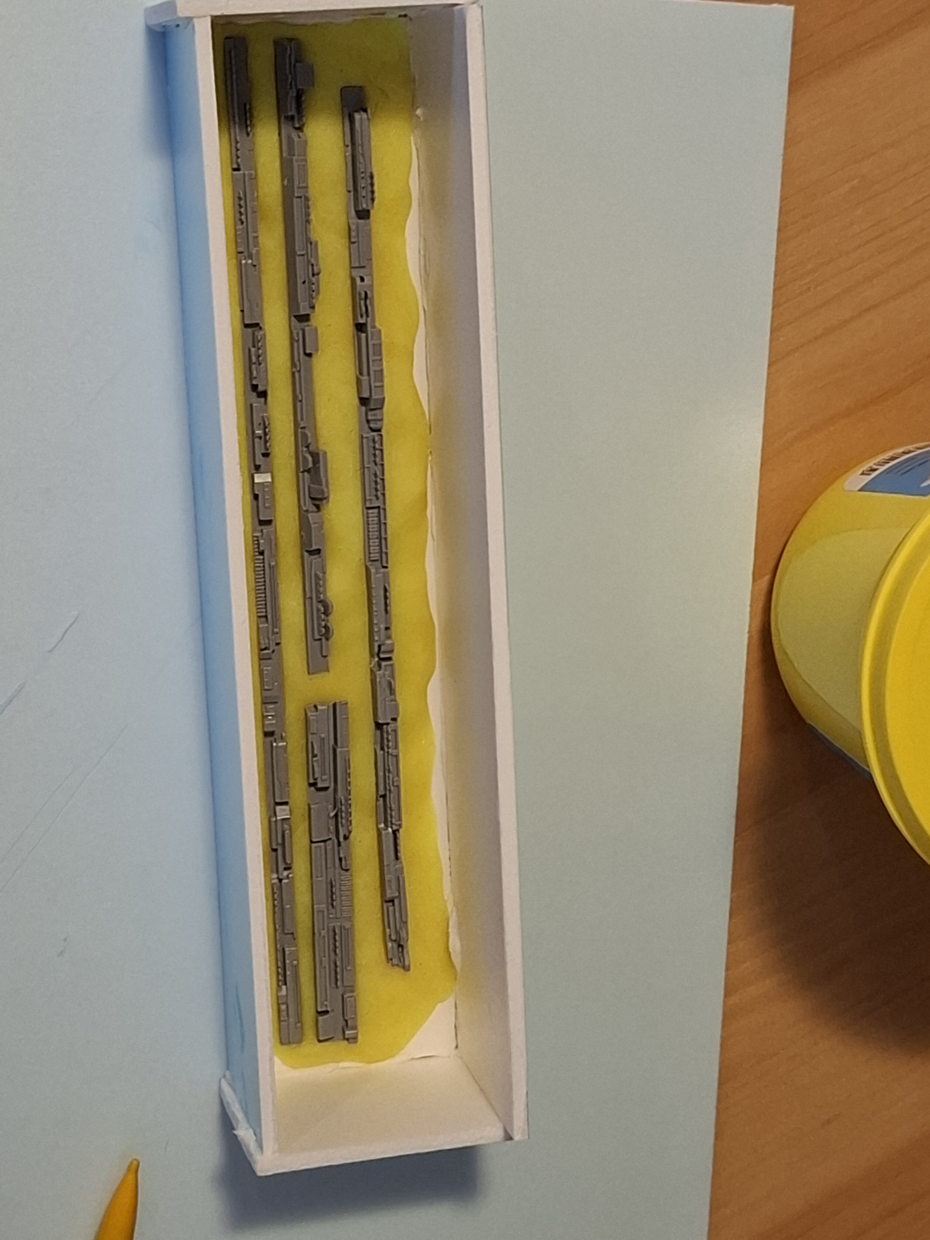

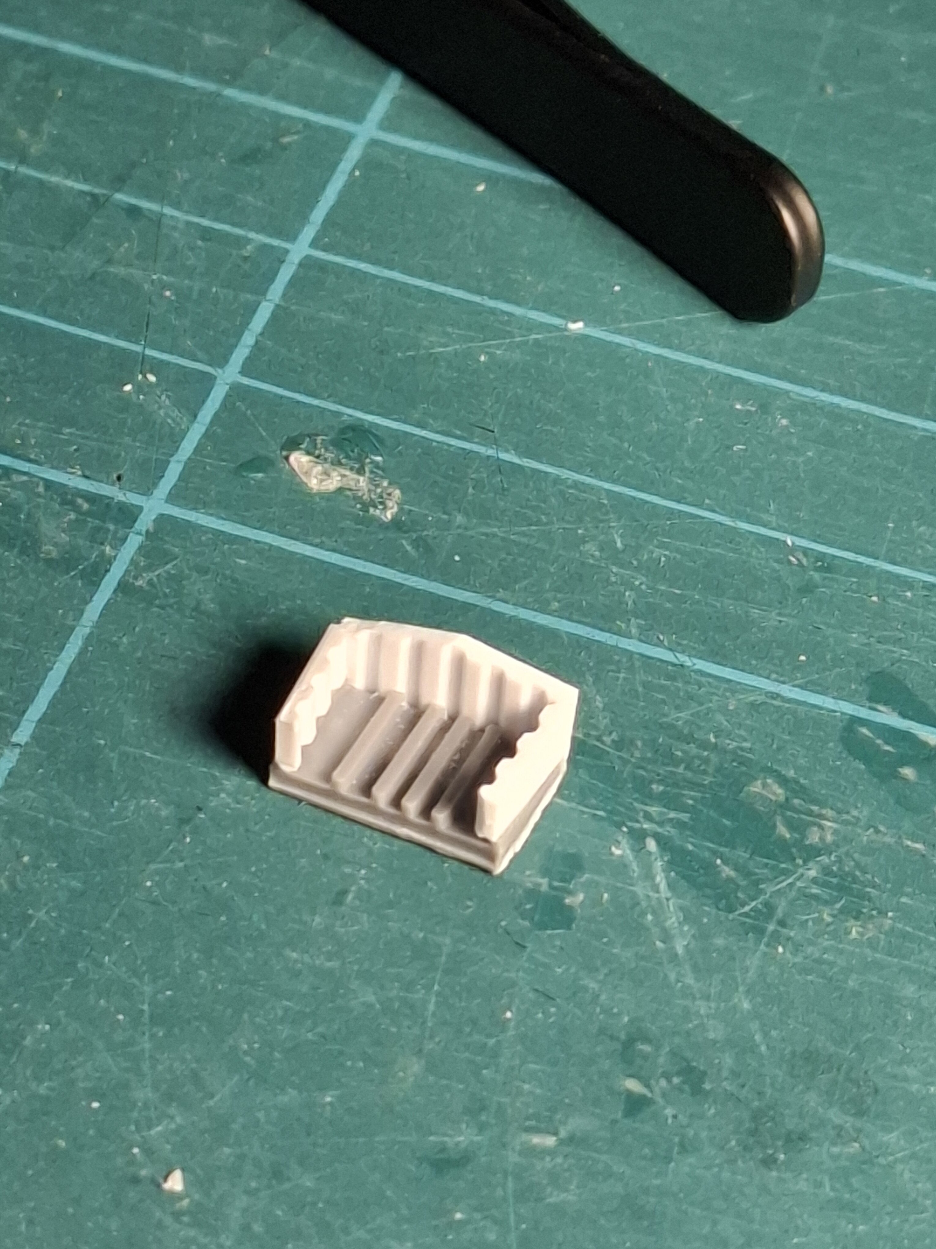

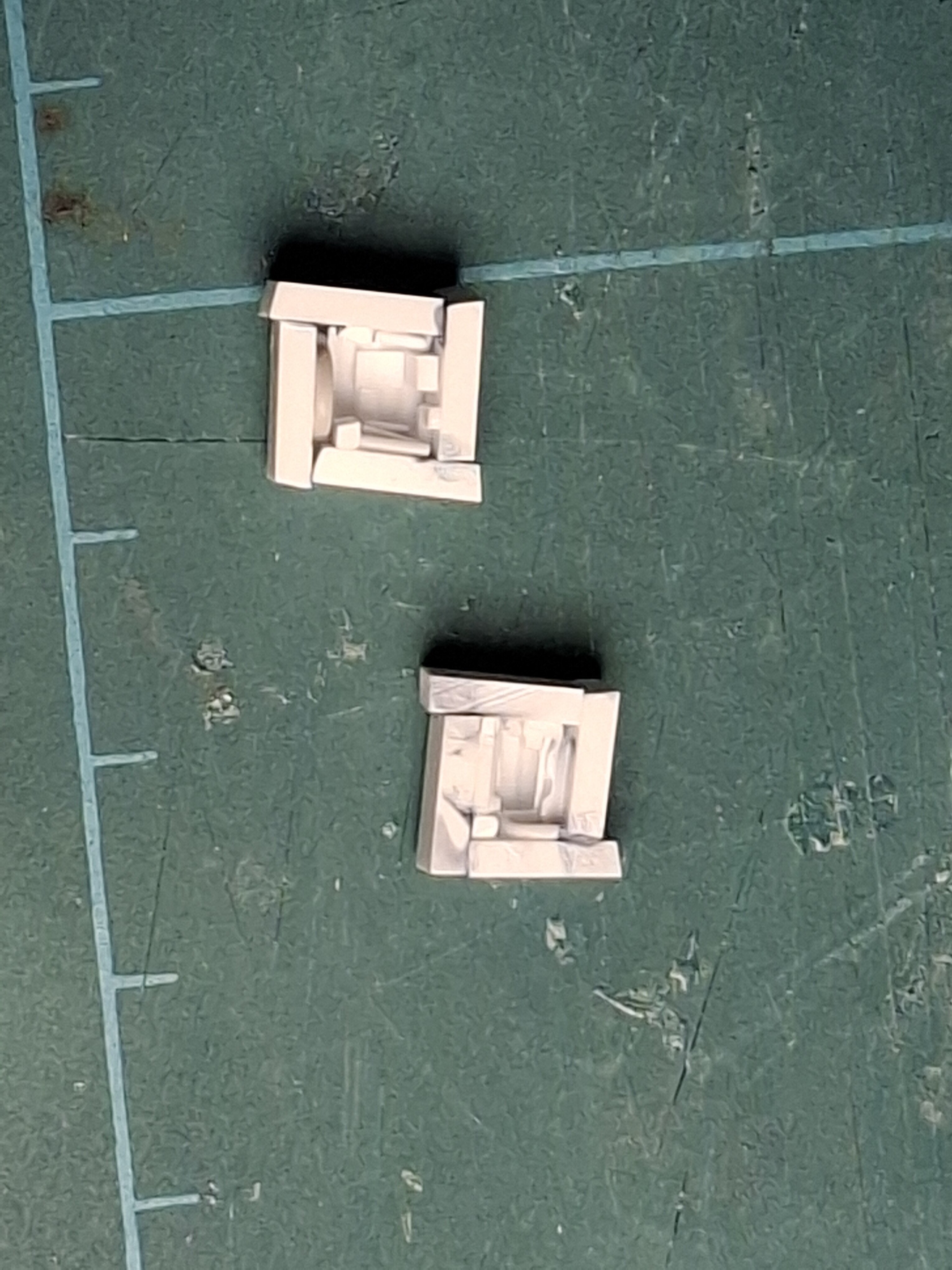

I'm particularly pleased with the underside work. Taking inspiration for other builds, I too recreated the ESB equipment pits:
Excavation starts with a drill bore and then hand-chiselled to a square:
the pits were built larger on purpose, then detailed wall by wall:

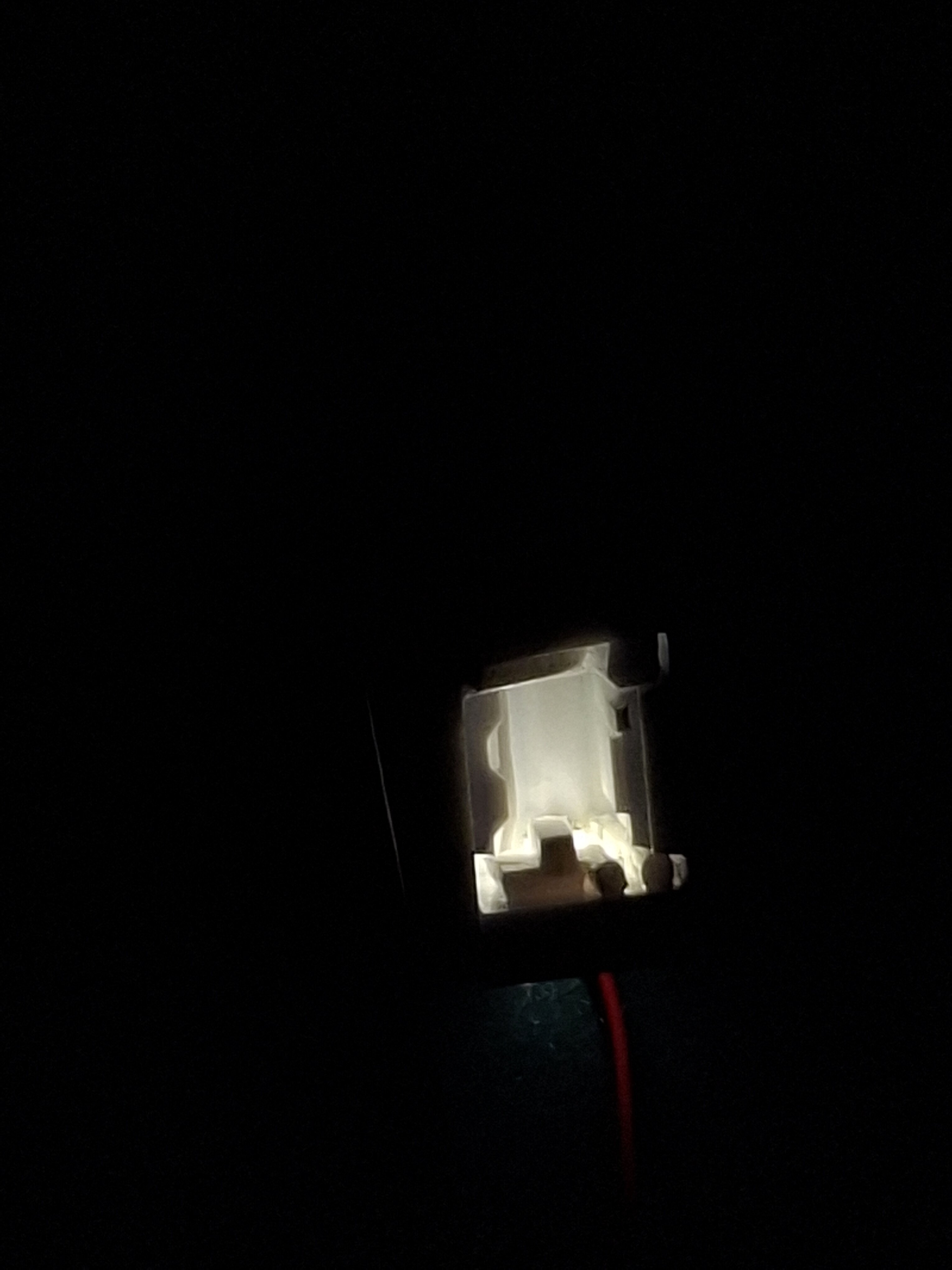

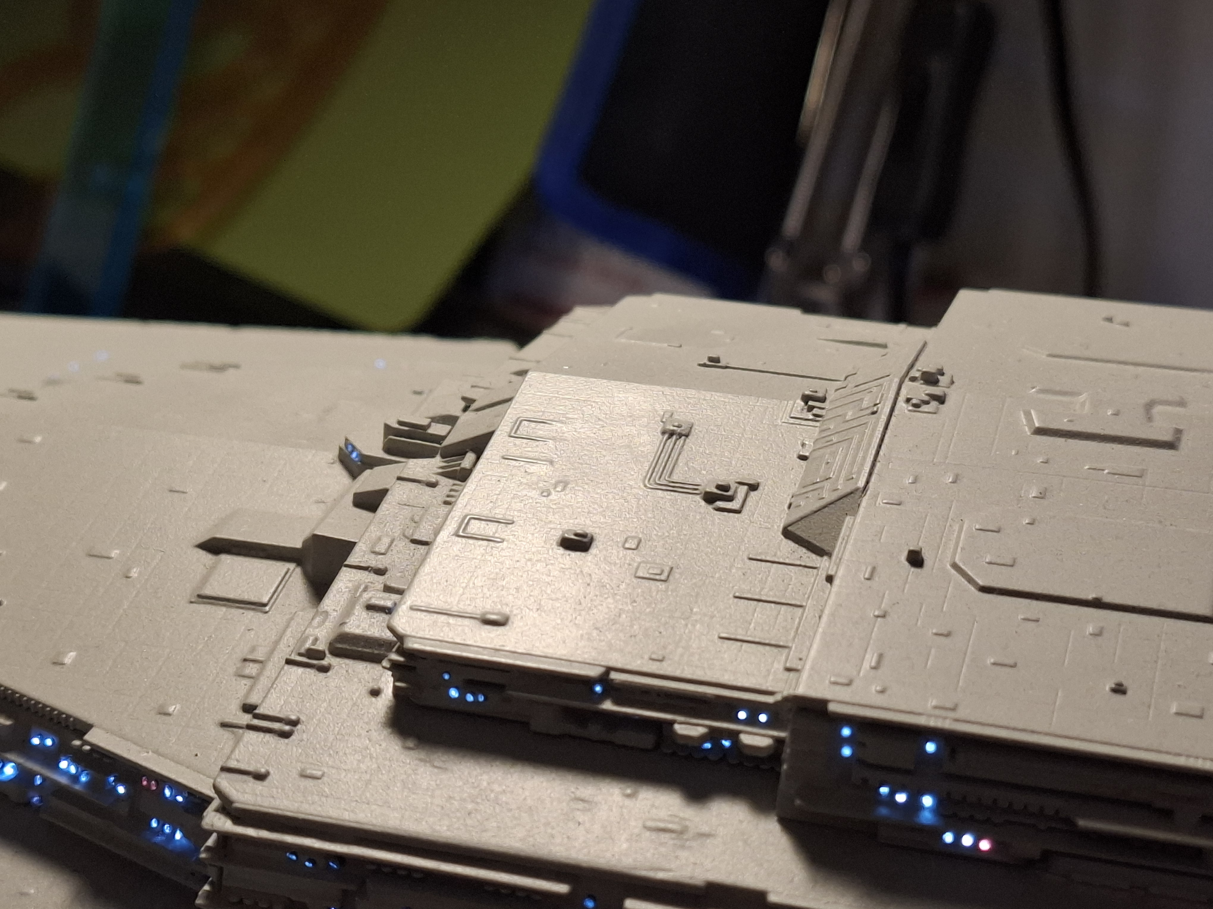

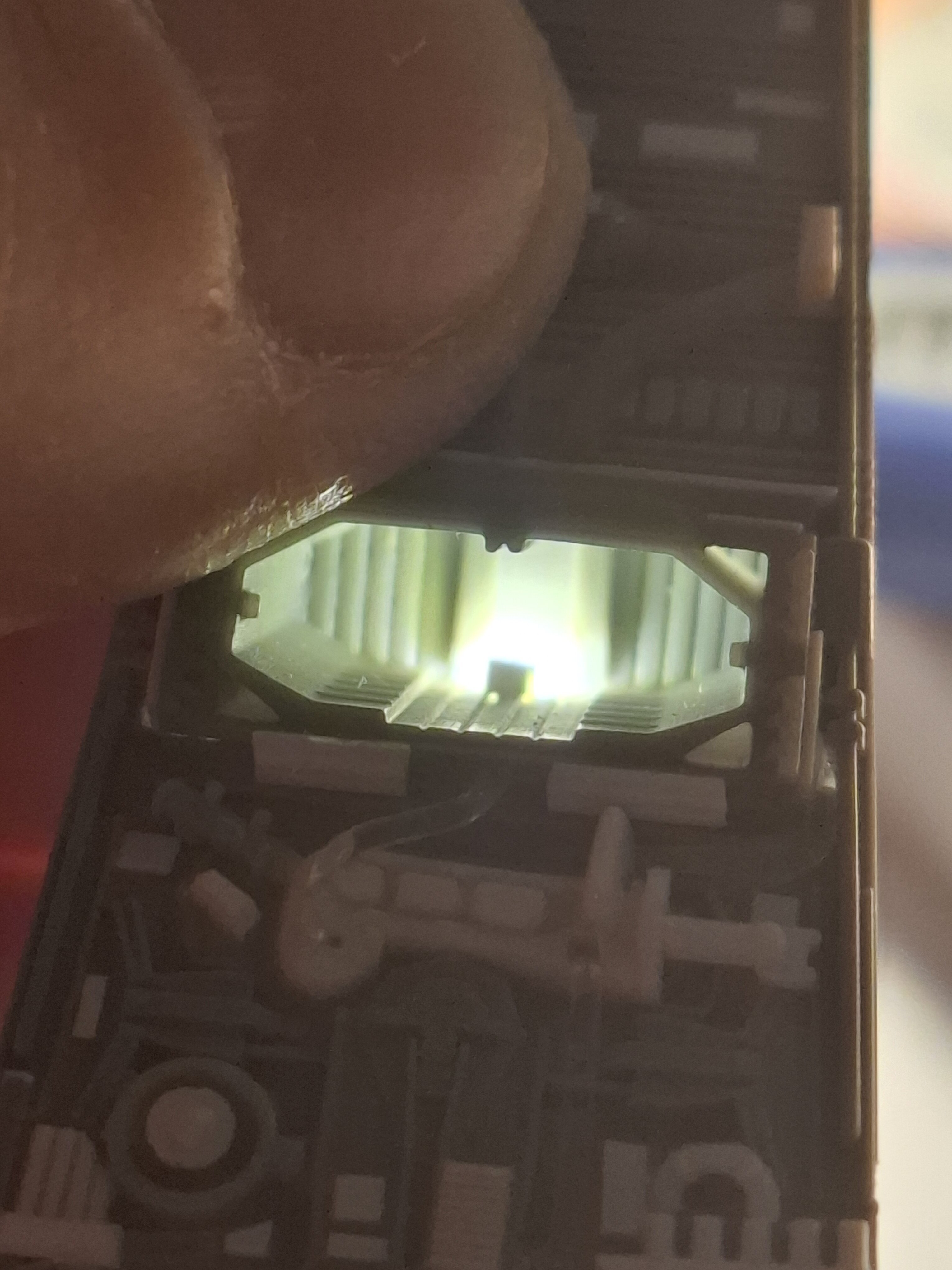

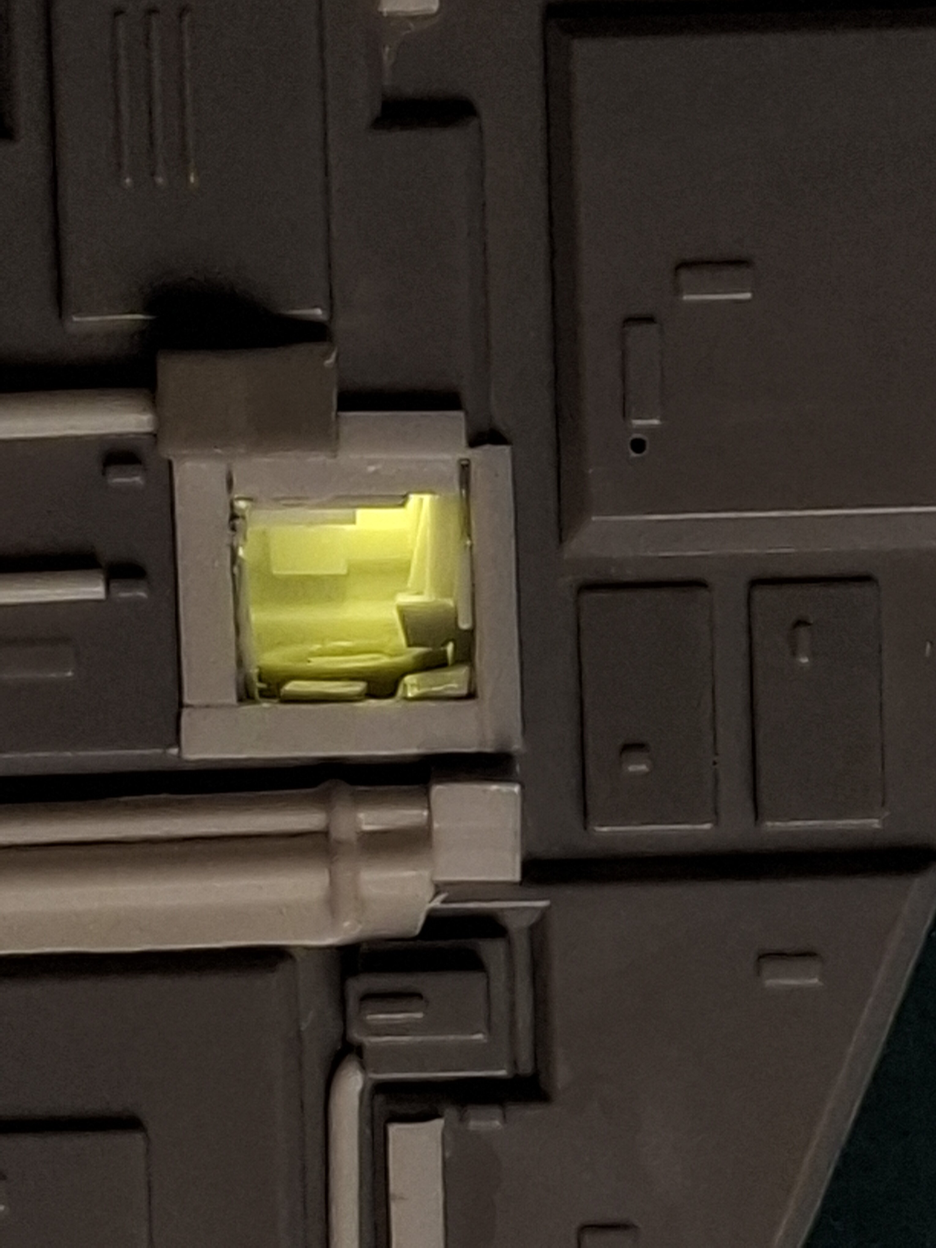

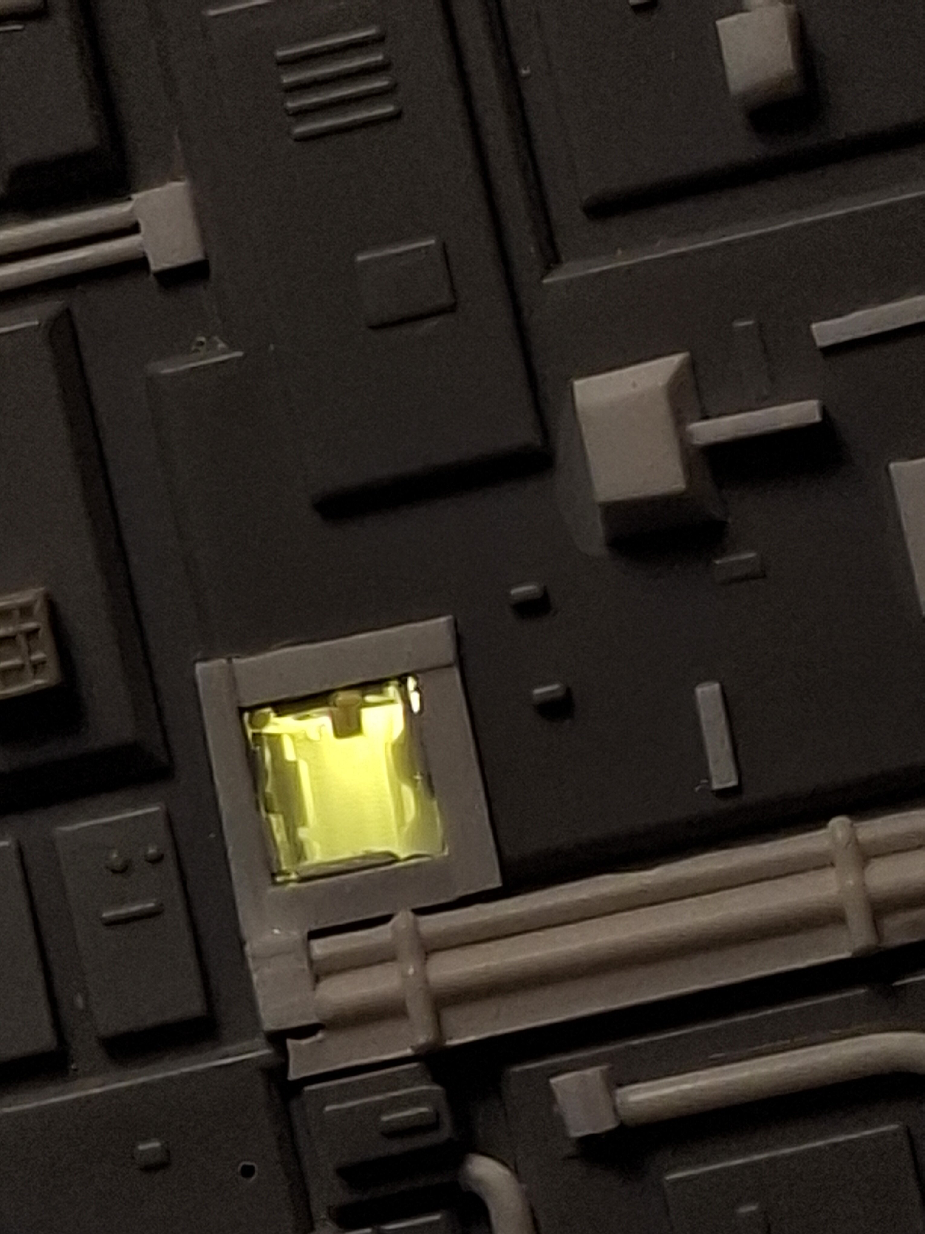

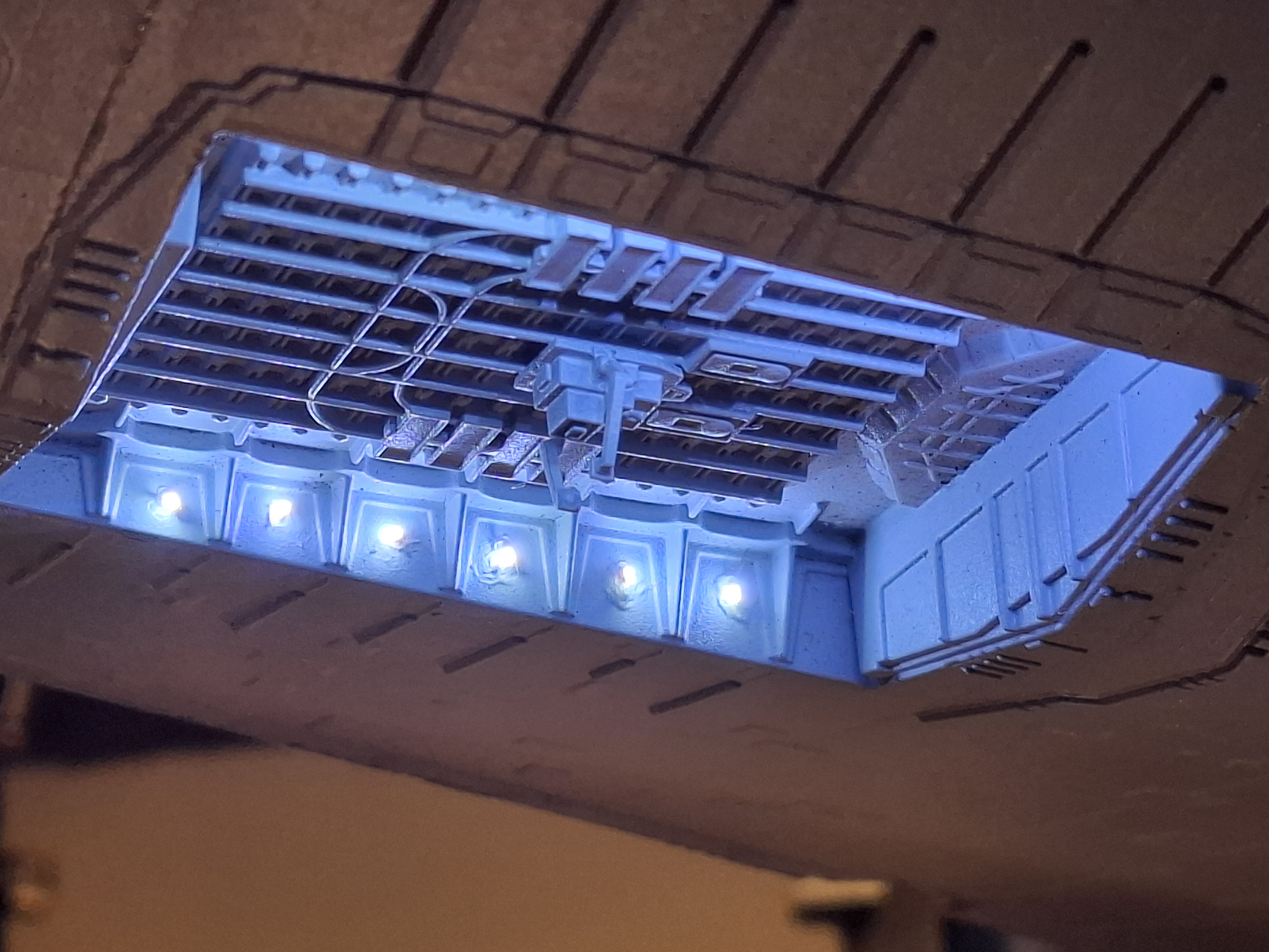

I did my first LED tests at this stage. Full-brightness 5v LEDS are too bright and will cast a light on the superstucture roof. On the latter two images I tried undervolting them to 3.3V
completed work:
Finally, the back, sides and underside of the bridge are glued together:

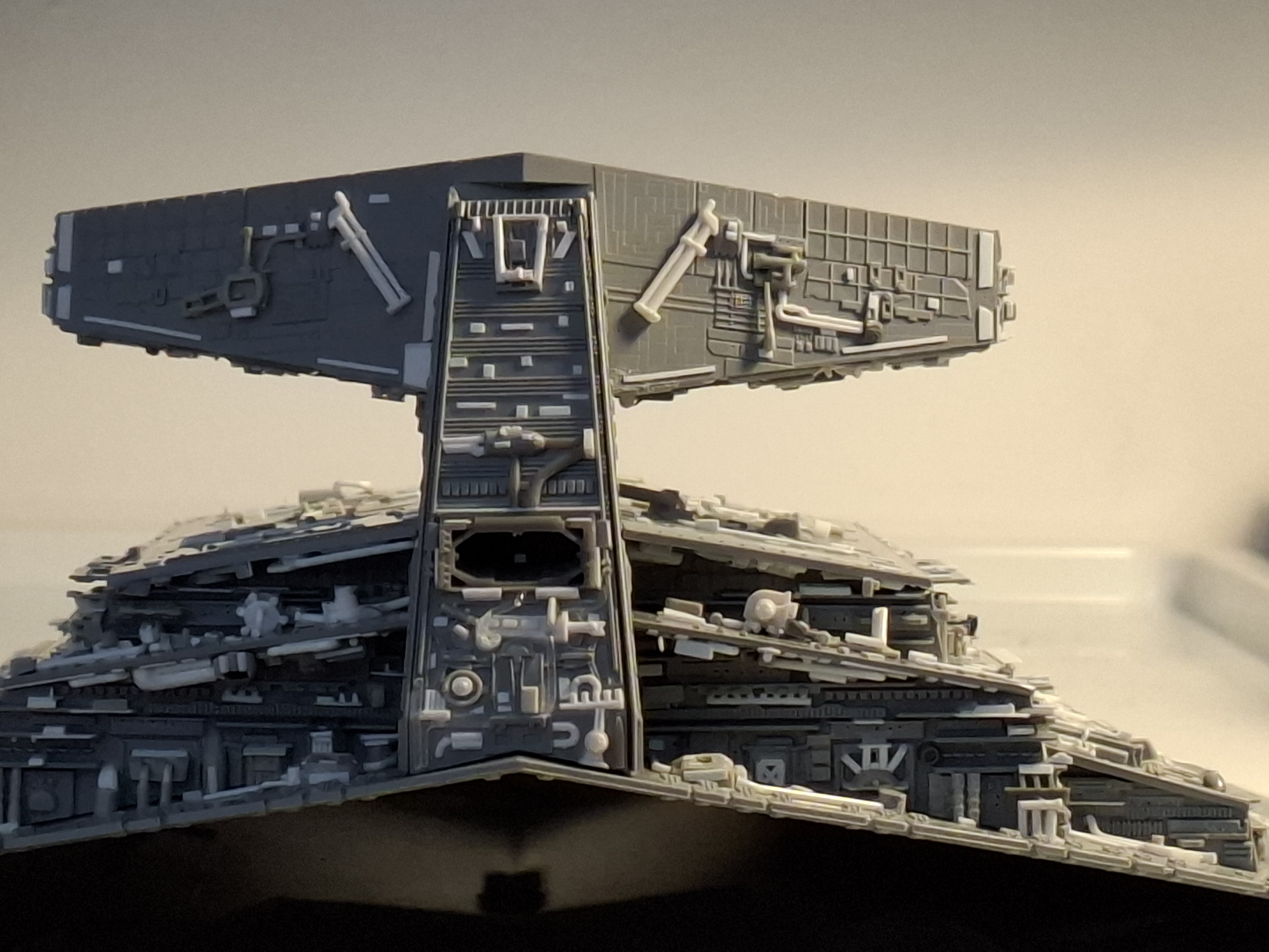

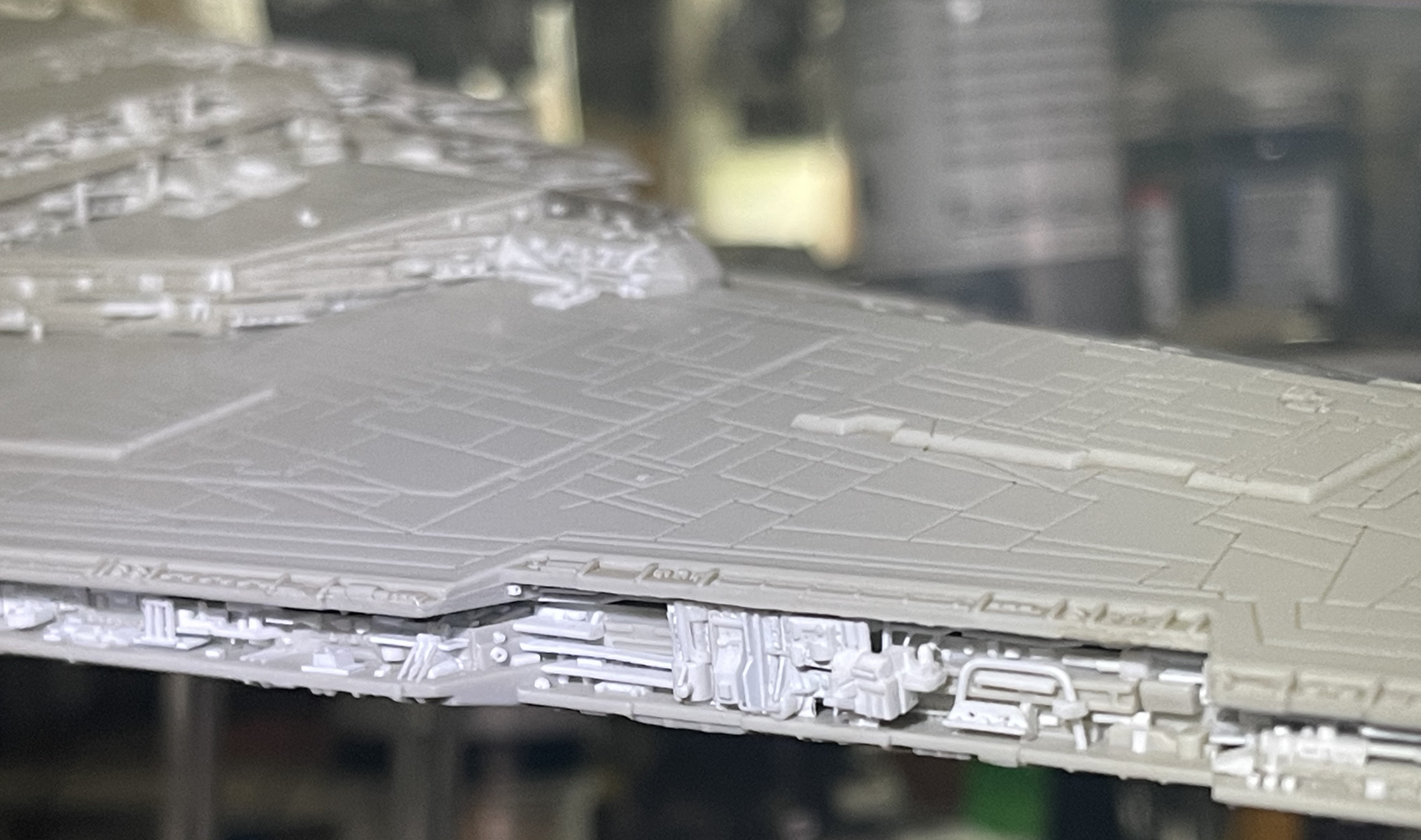

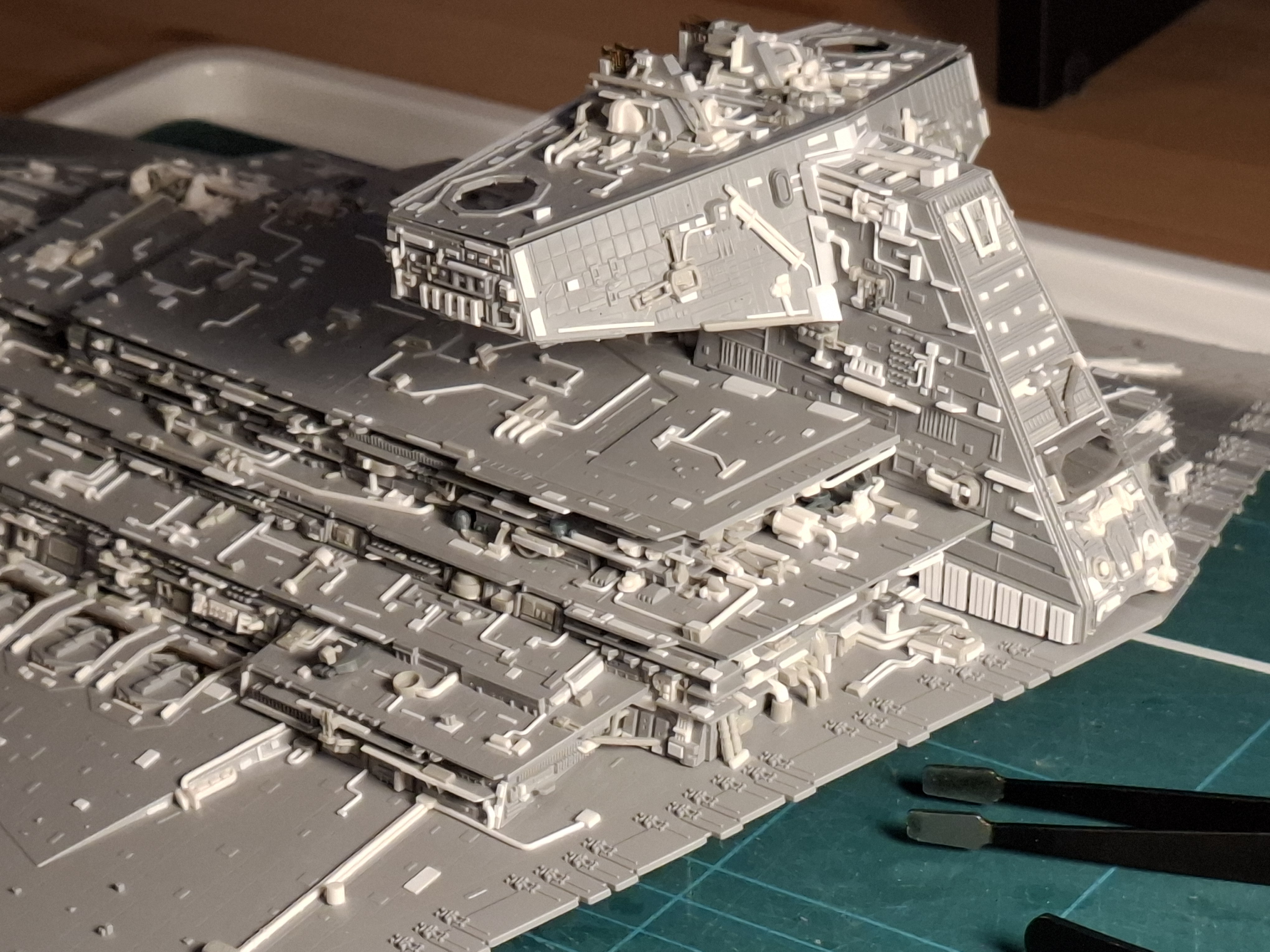

2025: Tower neck, part 1

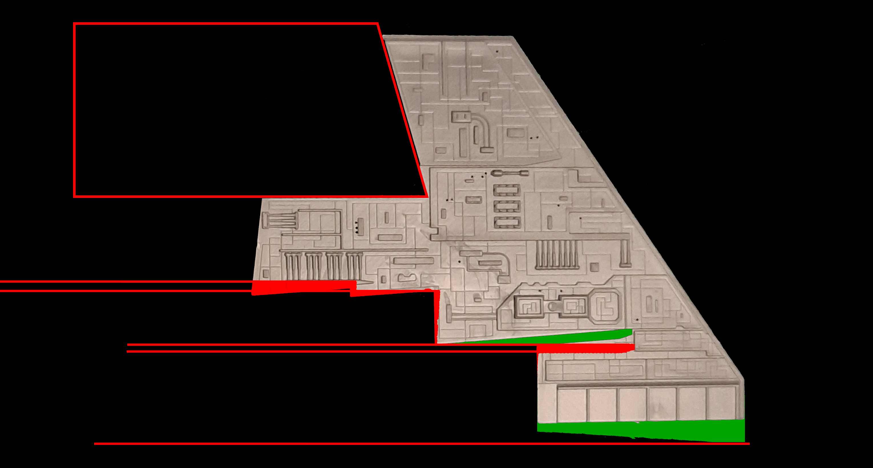

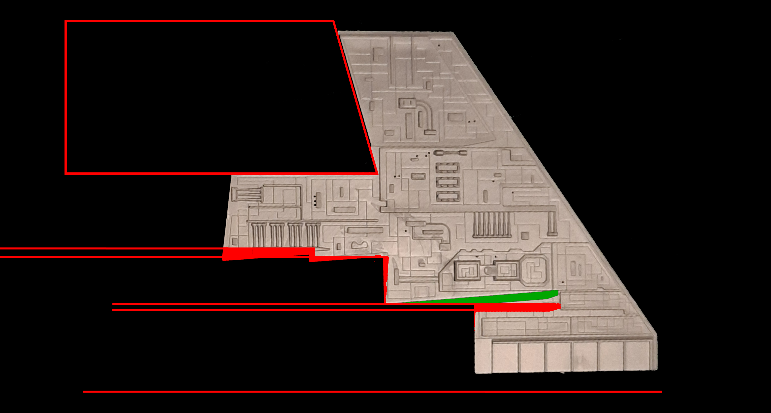

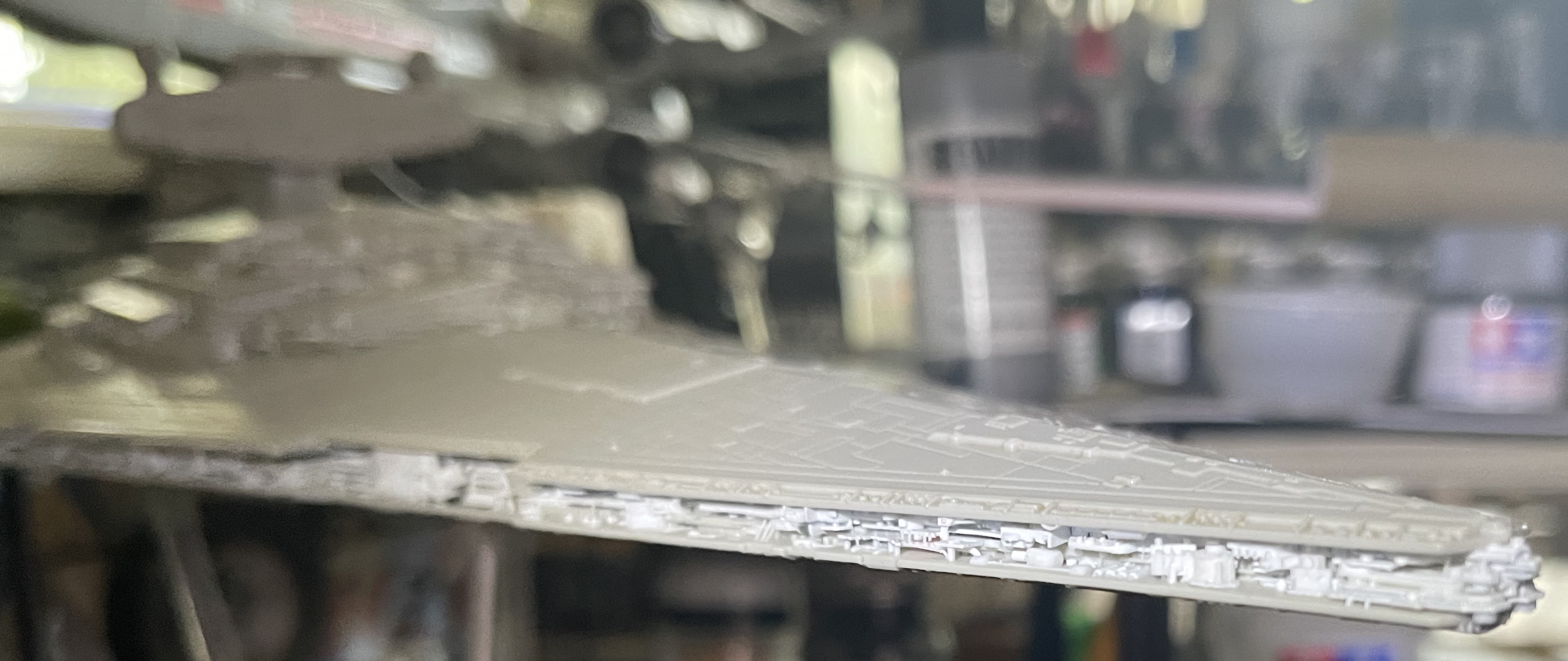

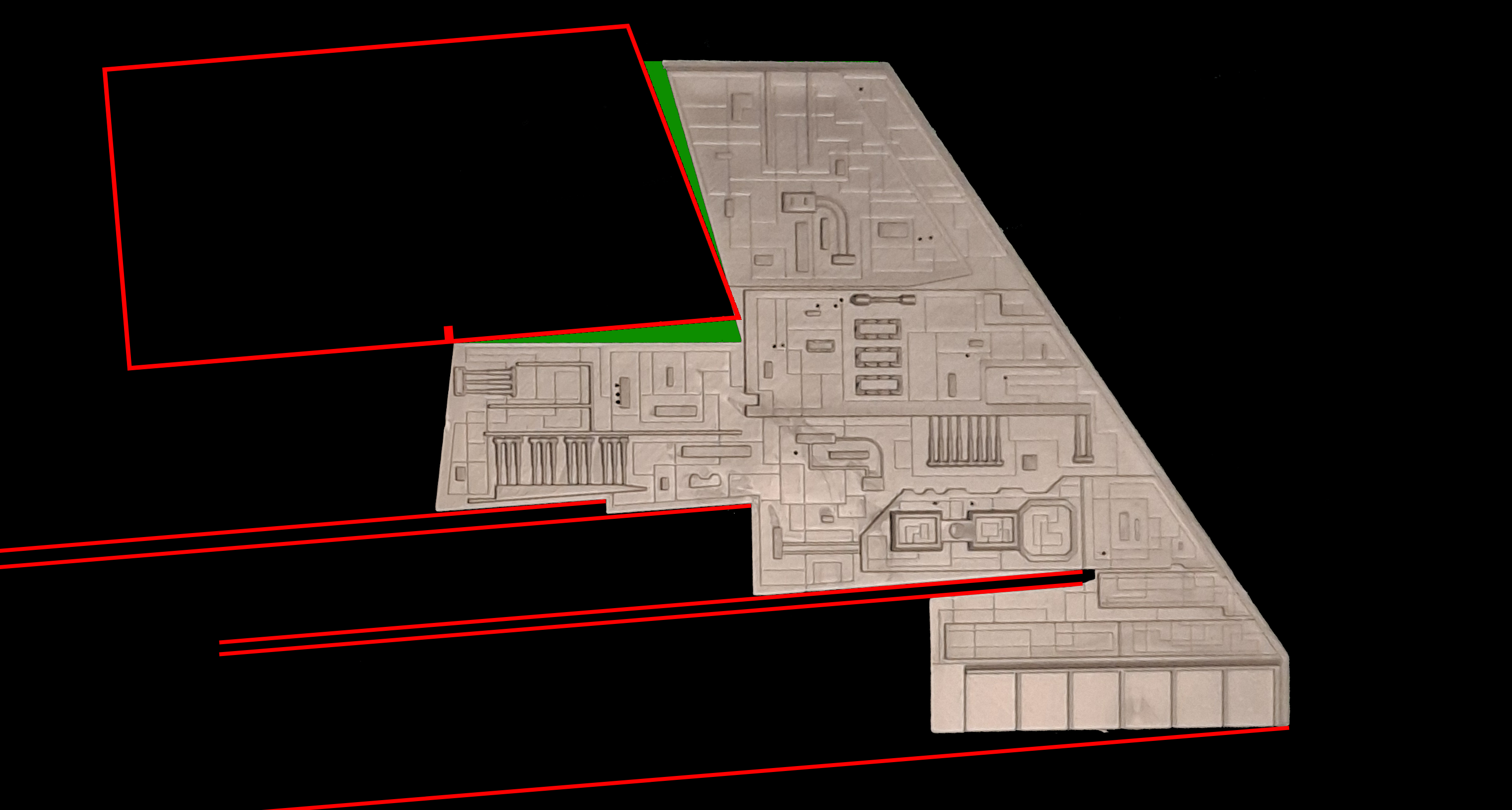

The infamous bridge tilt, one of those subtle details which you can't unsee once you're aware of it.
Didn't take long for me to decide I had to do something about it, or every time I would look at the finished model I would be reminded of it.
The issue is that the bridge and the roof of the neck come out of the box parallel to the ship centreline (the waist trench). While in the original ESB studio model, they need to run parallel to the superstructure roofs, which follow the slant of the upper hull:
I saw 2 possible solutions:
Solution 1 is the one most builds seem to go for. Tilt the entire neck-bridge assembly forwards, cut out the bottom edges and excavate a new slot for the superstructure overhang. Solution 2 is actually what came most natural to me. Leave the neck mostly as is and pivot the bridge forward at the attachment.
  • solution 1 leaves the neck details parallel to boththe bridge and the superstructure as they should.
  • solution 2 is far easier to craft. No precise chiselling that must be exact on both sides, and the extra wedges can be re-made if they're not right
  • solution 2 would have neck details that are not parallel to either the superstructure or the bridge, but by a minor angle
  • likewise with solution 2 there's a break angle between the bridge and the roof of the neck
  • solution 2 creates a sharper angle between the front of the neck and the 'chin' of the bridge, which to me looks closer to the ESB model
  • in solution 1, those square details at the base of the neck would look very tall
I didn't feel confident enough making solution 1 look right, so I went for solution 2:
and a few shots of the resulting:
around this time I also took care of the far wall of the trash chute, with a passage for a future LED:
I used one of the hangar gate parts harvested from the old Venator kit.

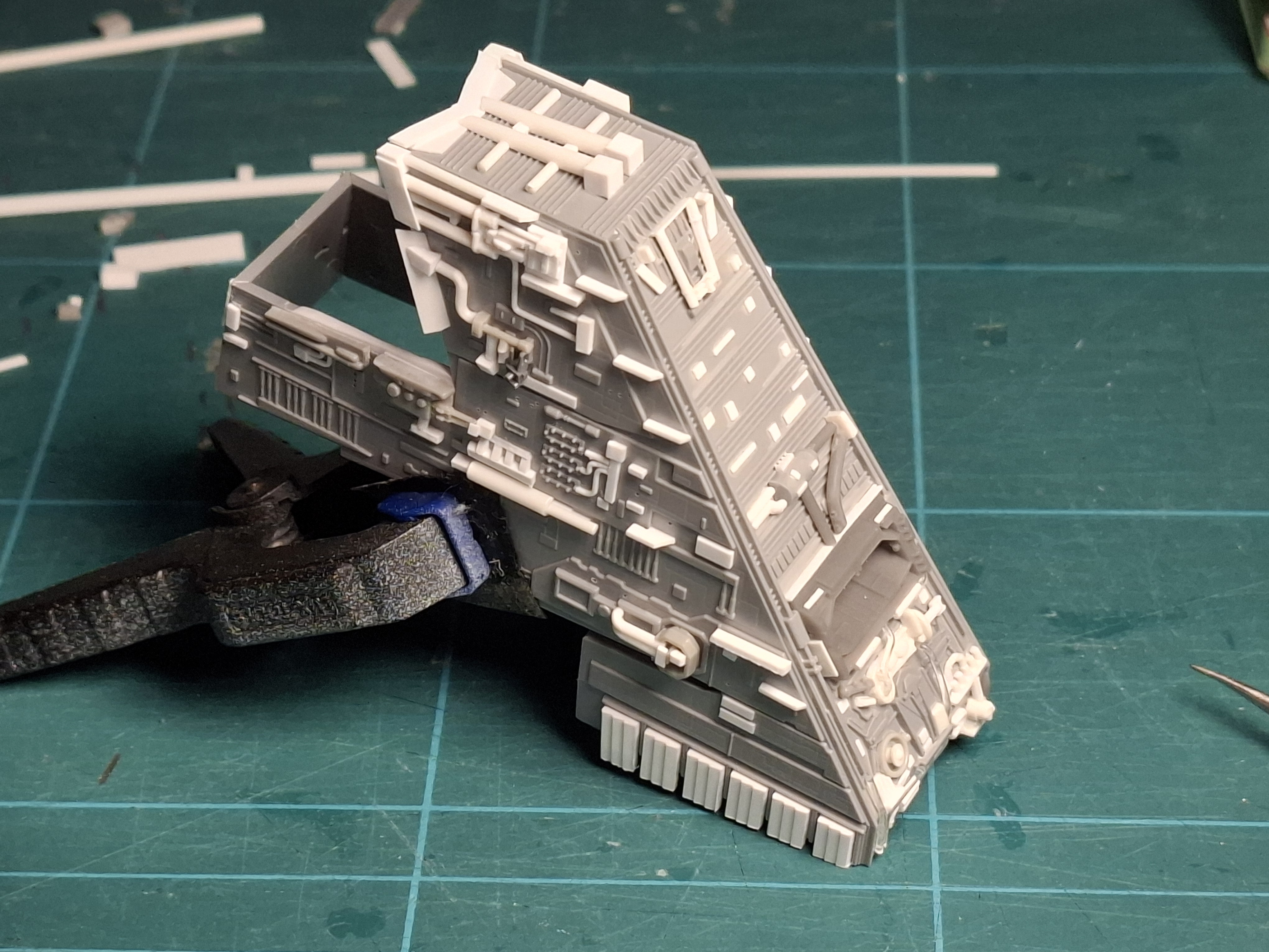

Finally, the front neck part:

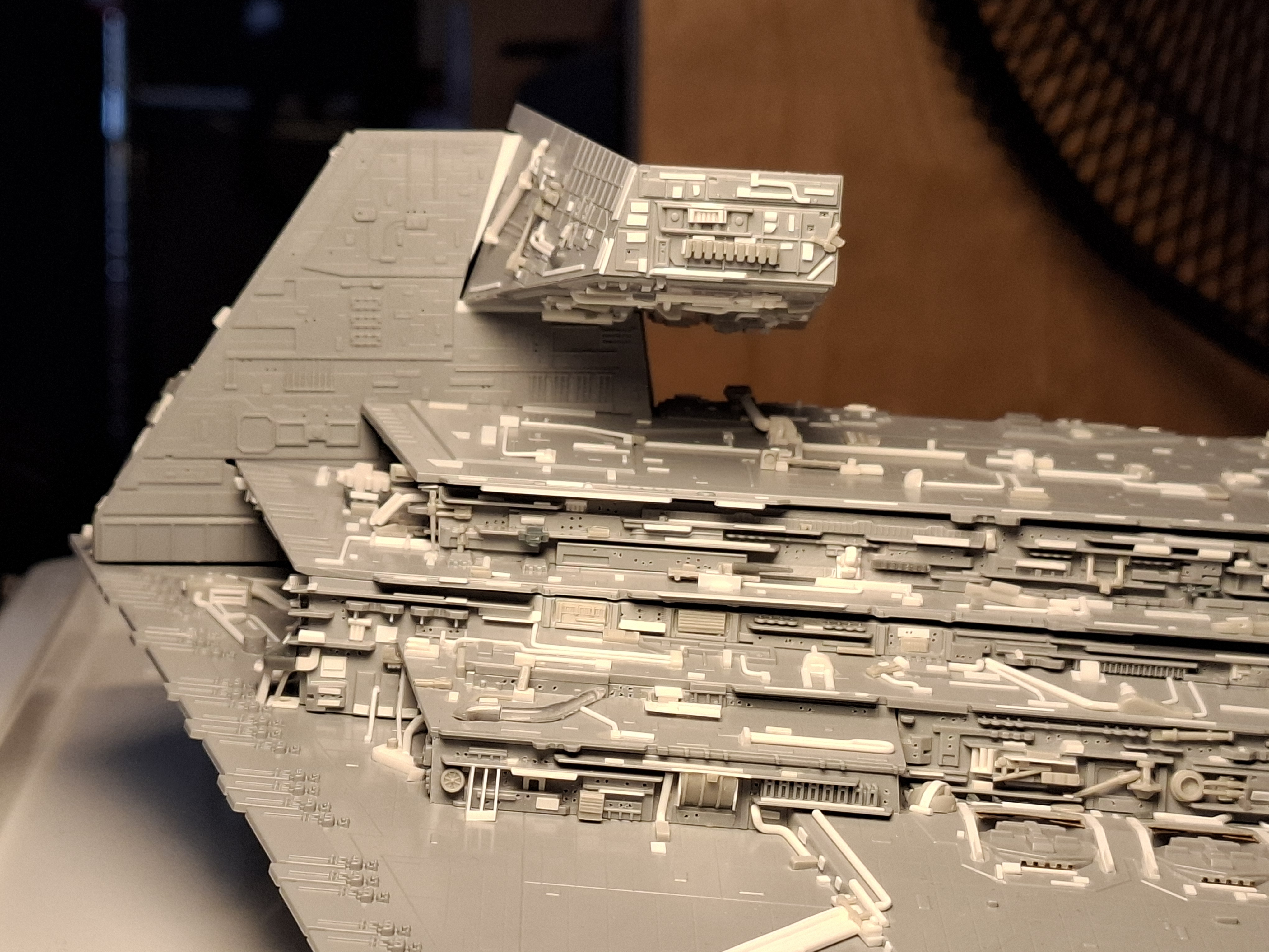

2025: Tower neck, part 2
The neck parts receive a fair dose of greeblies, especially to mask the wedges I added:
those little flaps are meant to integrate with further details on the backside of the bridge:
I used some sawtooth styrene sheeting to craft those plate parts at the base of the neck:
The completed neck is assembled for fit tests:
Note the piping at the top of the neck, slanted forward slightly to try and dampen that break angle effect.
Not perfect by any stretch, and there will be more filling in at the very bottom of the neck spine.
But still rather pleased with the result, and it's quite something to see the thing start to take the shape it should have
