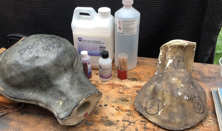

I've been given a pair of silicone moulds to make myself a set of casts of two Classic (Tom Baker) Doctor Who monsters from the 1970's, one being The Hand of Fear and the other being The Brain of Morbius.
These have been on my want list for decades, ever since I found out that the moulds still exist. This is what they looked like on screen:

Being so old, they're both starting to show their age and on the first test cast that I did, I encountered huge problems - they leaked like a sieve!

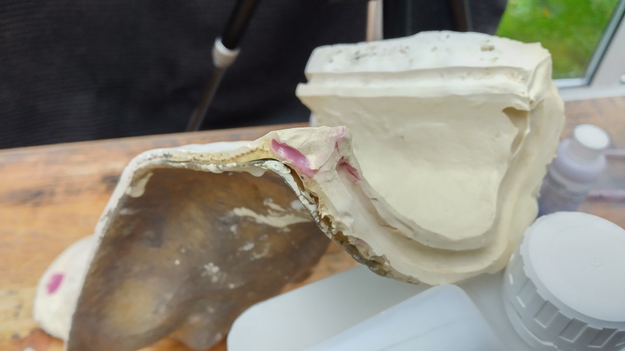

Both sets of moulds have tears, voids and missing sections that have caused all manner of issues, so to get anything decent out of these, they need repairing, so that's what I did.

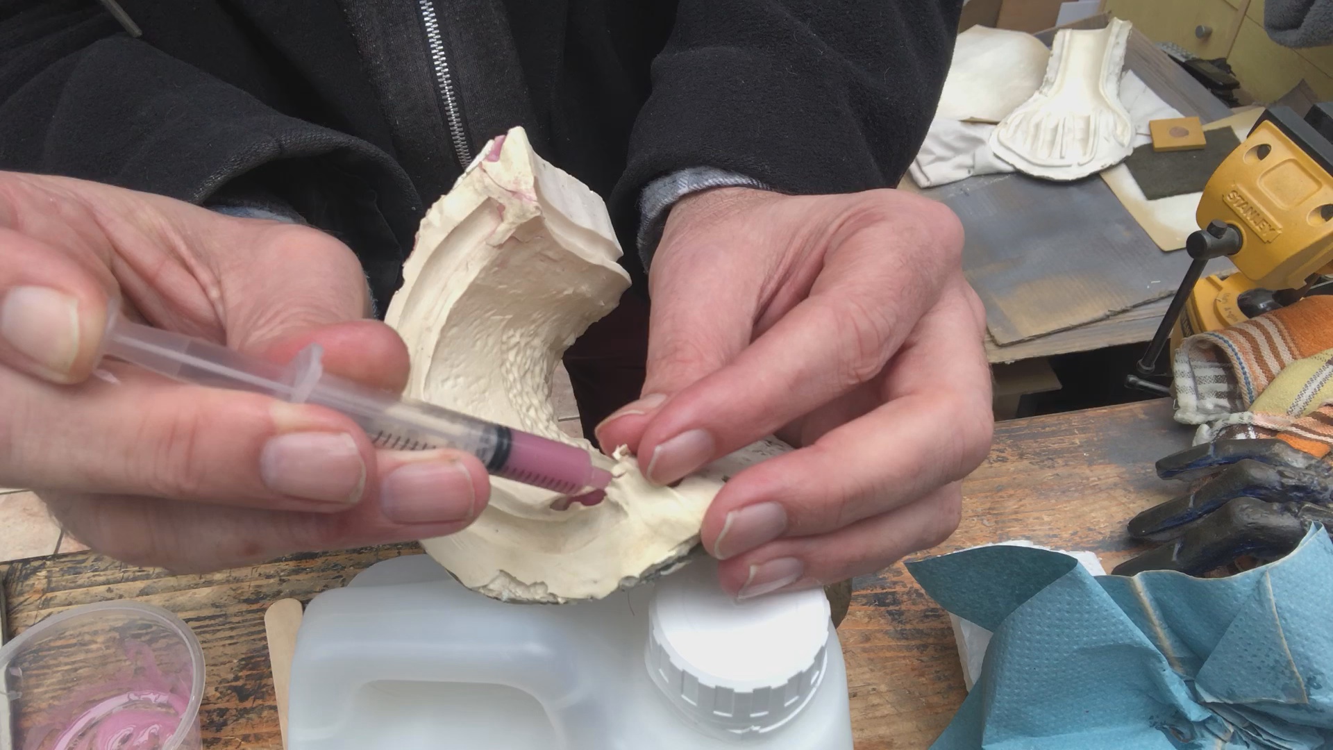

On both sets, having established that my new silicone is compatible with the ancient material, I set about patching the splits, filling the voids and bulking out the tear outs - and I have to say, it worked beautifully!
This is the first pass on the initial split repair. It's not much to look at here, but the repairs worked wonders. No more mis-registrations leading to deformed pulls, no more voids in the casts... just clean, perfectly detailed pulls - just what I wanted.

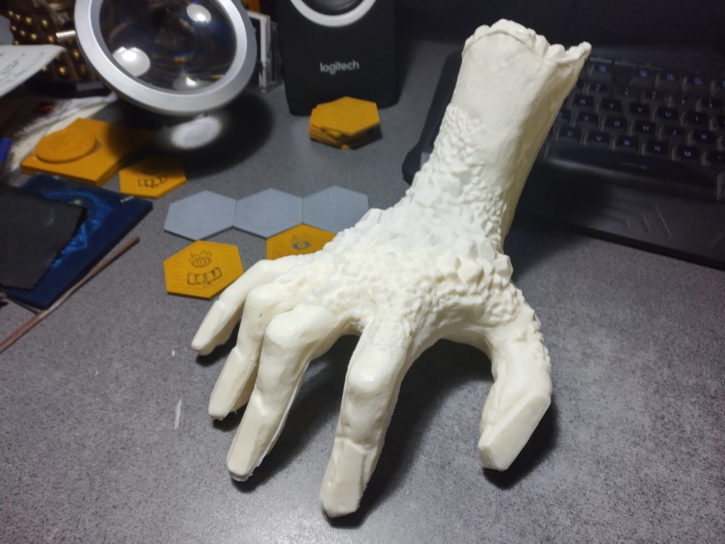

A nice, but raw pull of The Hand, with a little bit of flashing to clean up...
