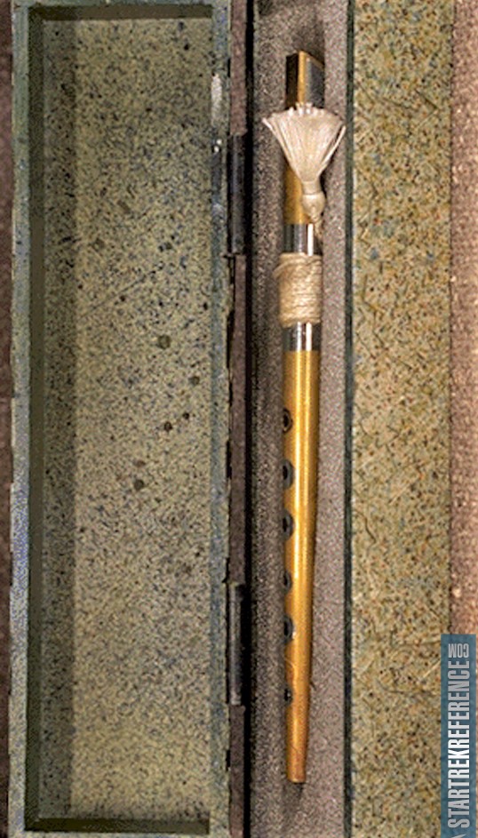

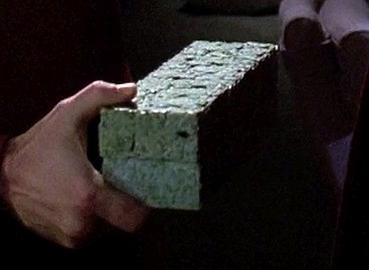

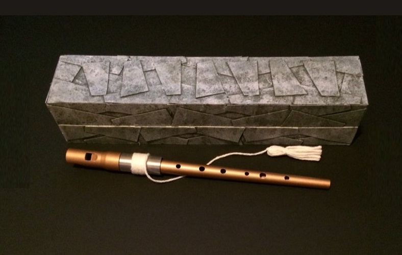

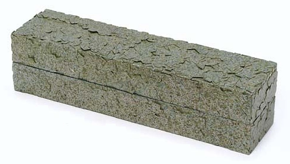

Looking for images of the detail on the box I came across this: Star Trek: The Next Generation, Picard Ressikan Flute replica movie prop
And this one on Etsy: Star Trek TNG "Inner Light" Ressikan Flute Playable Prop Replica
Of the two, the first is obviously more accurate.
I think I will try for this one:
It looks to be a pale Verdigris in color.

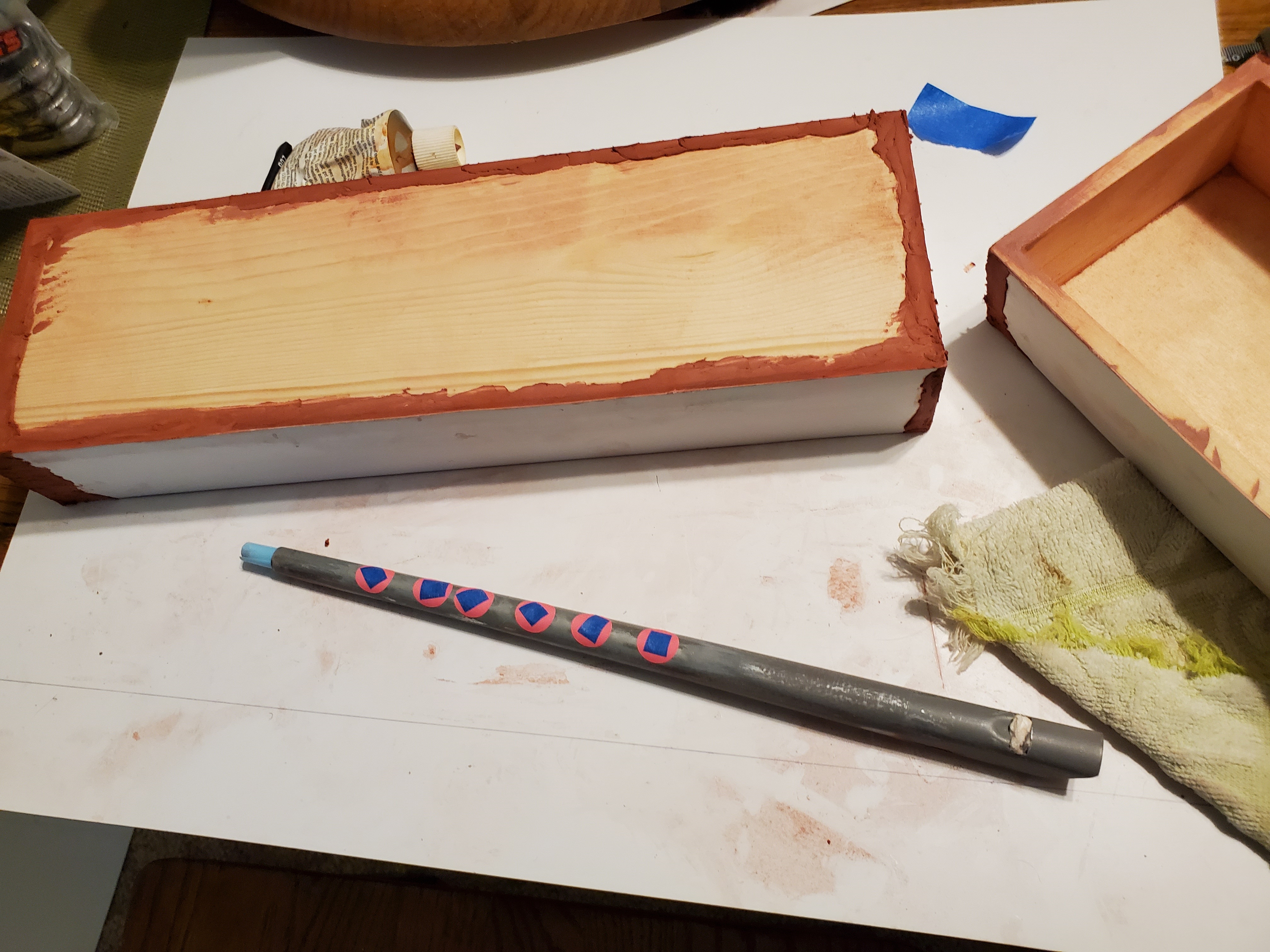

Making progress.
I made the top and bottom of the case more equal in size and squared it up. I am using notebook paper hole reinforcers as masks around the holes in the flute.
I squared the box and added lead weights so that there would be a definite bottom to it. There are magnets in four corners to hold the case shut on contact.
And I have the first layer of detail on the outside of the case. I am thinking that three layers should do it.
I hope to start painting the case tomorrow afternoon.

I found a stiff and sturdy poster board at the Dollar Tree a few days ago. I figure between the CA glue, Modge Podge, and a couple of layers of paint and sealer that it will be pretty wooden and durable by the end.
It would help if there were better pictures of the detail on the case. As it is I am having to squint and swag. (Swag - Scientific Wild Ass Guess.)

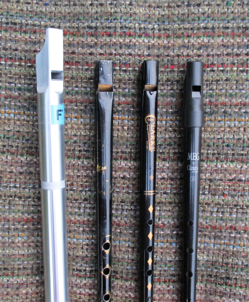

Here are two views of Overton-style heads, by Colin Goldie.
Below left to right is an Overton-style whistle made by Colin Goldie, two traditional rolled-sheet-tin Clarkes, and a newer-model Clarke with the moulded plastic top.
On the Overton-style whistle (far left) you can see the unmistakable head design with the distinctive cuts on the top and on both sides. This AFAIK is the only method of whistle-making that gives this appearance.
You can see with absolute clarity that the Picard whistle is made in the Overton style, and not either of the Clarke styles.

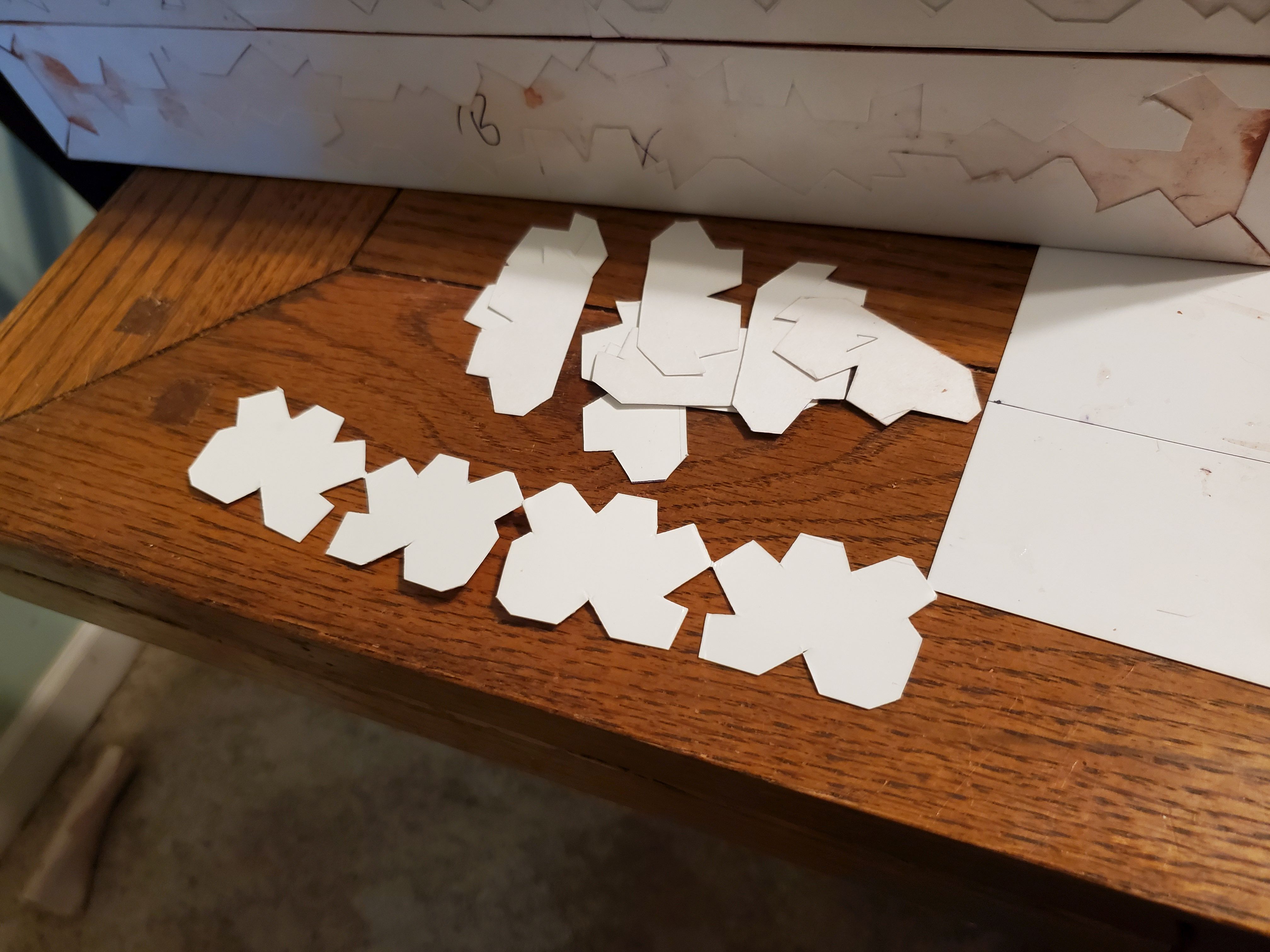

One step forward, two steps back.

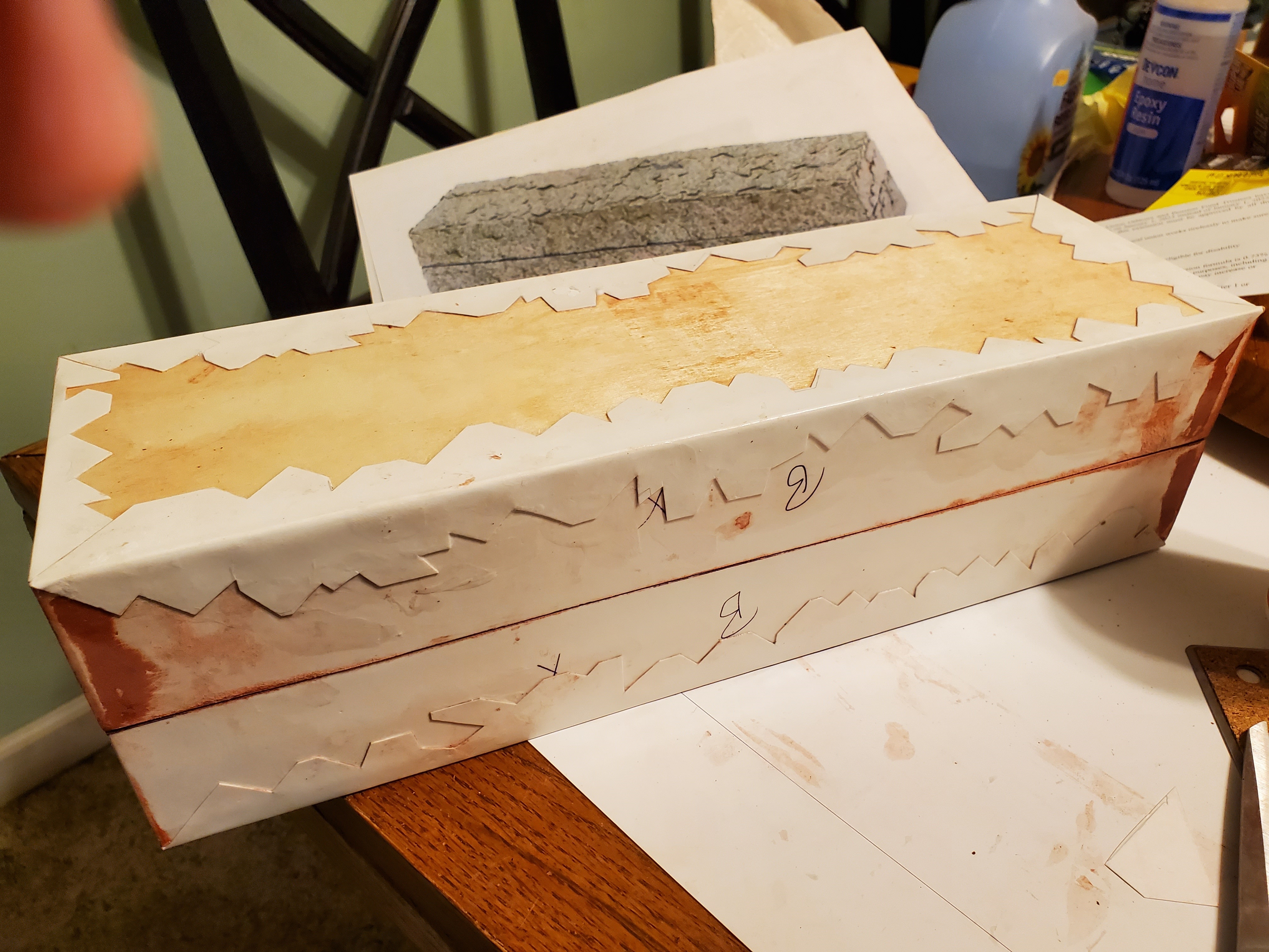

I started making paper dolls for the fallen leaf pattern on the case. I think I have five different shapes so far. Multiples of each. I will start gluing them on tomorrow or Tuesday. (First day back at work tomorrow after a week off. :mad:)
The painting didn't go so well on the flute. So I had to strip it and primer it again. My own fault. I rushed it and used rattle can spray paint even though I have better paint available. It's just that the better paint takes longer. I did a rush job and screwed it up. So I have to start over.
The first layer of detail on the box looks good though.

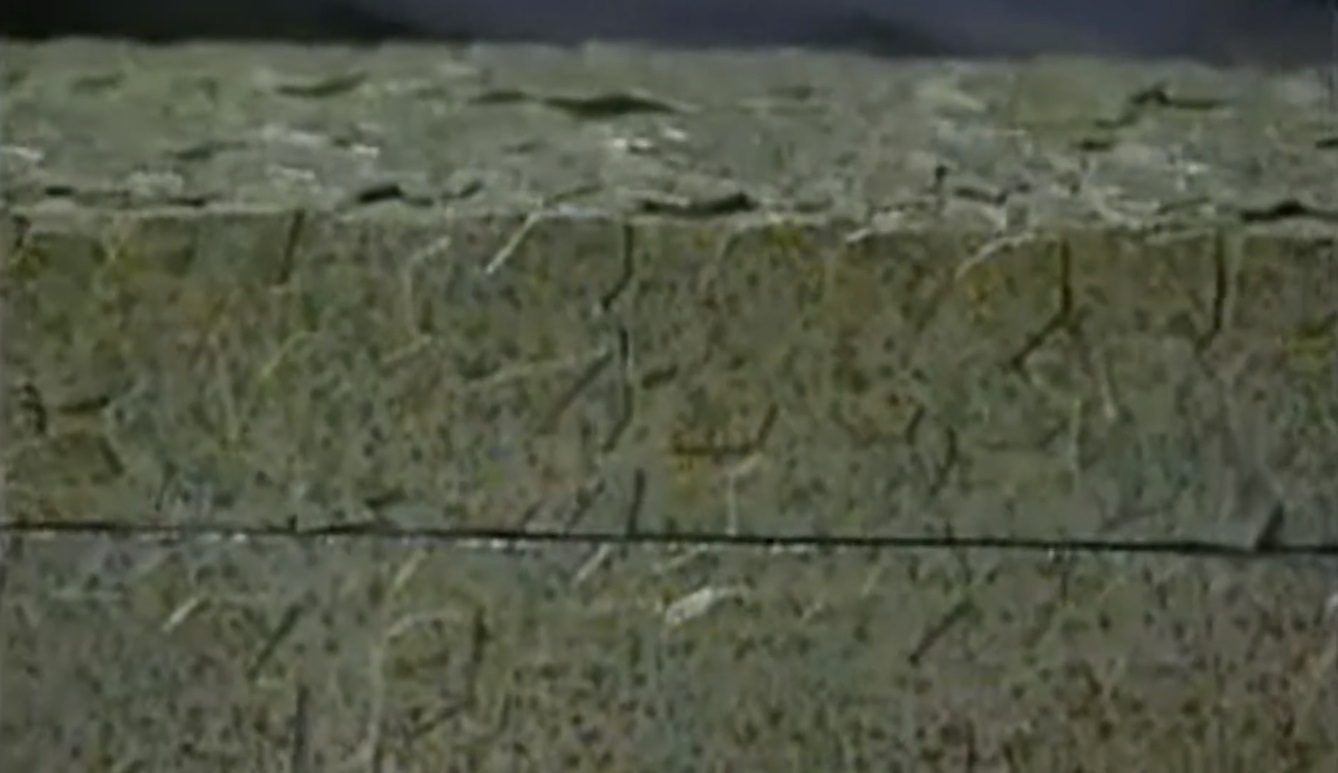

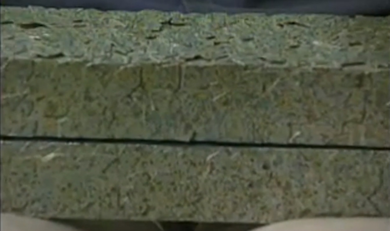

More details from that video.
Have any of you tried to replicate the case? Could you post pictures? Maybe give me a couple of tips?
- Leelan
HMS Mike
The flute was a complete custom non playing Prop. Made of brass rod and alum. turned on a lath. The box was plexiglass sheet construction with plastic hinges. The details were 3 layers of styrene sheet hand cut to those shapes and glue on top of each other. The foam was black case foam with sliver spray on it.

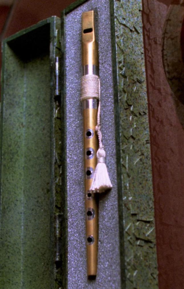

I've been looking over the photos posted above, I don't know where the different photos are from or what their provenance is, but from looking at a couple screen-shots it seems to me that the whistle he's holding seems closest (perhaps identical) to this one.
You can see that there's no metal rings around the fingerholes, rather it's clear that the body of the whistle is tin (or perhaps polished aluminium) painted gold, and that the gold paint doesn't quite come up to the edges of the holes, leaving some of the tin underneath showing. It's obviously paint over metal, and not added silver metal rings. I do see that the edges of the fingerholes have a tiny crimp or flare of metal, indicating to me that the fingerholes were punched from behind when the tin was still in sheet form, before it was rolled. I'm pretty sure that's how the old sheet-tin Clarke whistles were made, probably a stamp having all 6 holes used to punch the holes from a piece of sheet tin, then the sheet is rolled over a mandrel, then the seam at the back soldered.
You can see the bottom fingerhole here, the whistle tube is flat, just with the colours gold and silver making the contrast around the holes.
The other thing that makes me think that the whistle in these screen shots is the same as in the case, in the photos above, is that you can see file-marks on the side of the head, which have filed off some gold paint allowing the aluminium below to show.

I think the pictures you chose offer the simplest solution. The details on the case look very clear and easy to replicate.
