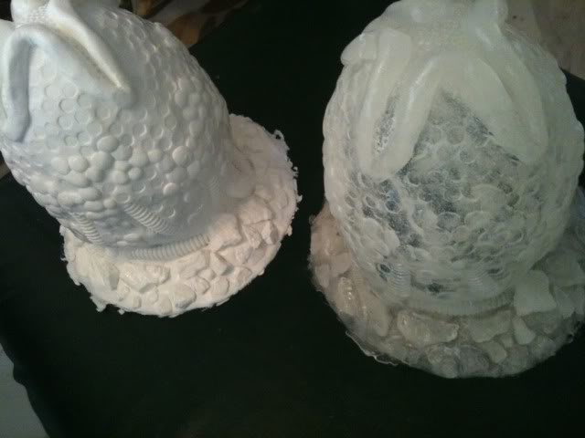

Last sunday during the storms here in TN we just stayed in and i sculpted this.Its obviously the Egg from aliens. it sits about 8 inches tall and is sculpted over the base to one of those "push lights". I made the details a tad bit over exagerated on purpose. These will be cast in clear resin and can be painted so that the light can shine out.
I sculpted it in non-drying clay, followed by acrylic spray sealer.i then had some of the latex mold maker so i used that first.i layed on coats of Latex for about 4 days.
Then to make a thicker silicon jacket i mixed silicone with acrylic paint and lathered that on.
today i pulled out the master and slush cast a couple of the eggs.thats all there was too it.
I should have some clear resin soon, Ill try that and see how it works.I believe it will light up even in white but not sure.Going to experiment.If anyone wants to add them to their collection let me know.I can throw a for-sale thread out.

this week i took the project another direction. I decided to build an Alien Egg to take to Wonderfest next year.

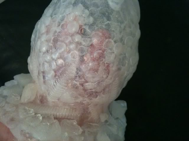

I wanted it to be see through with a chestburster inside. I ordered some clear resin and made the egg where it will be mostly opaque.

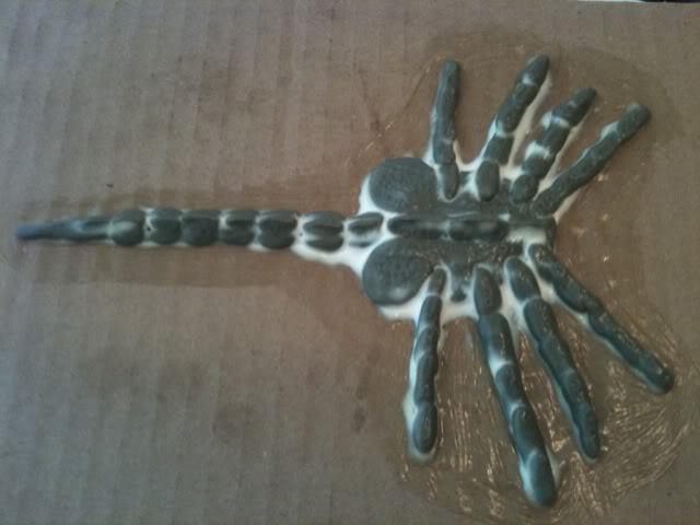

my next step was to sculpt a mini chestburster.the egg isnt completely clear,so i didnt have to go into great detail.once its painted and balled up inside the egg it should look just perfect.
The mold is starting so should be able to make some little resin chestbursters in a few days.
as of right now ill be mounting the egg on a wooden base with sand and stones and the egg all painted up and airbrushed. should make a sweet display peice!!!
