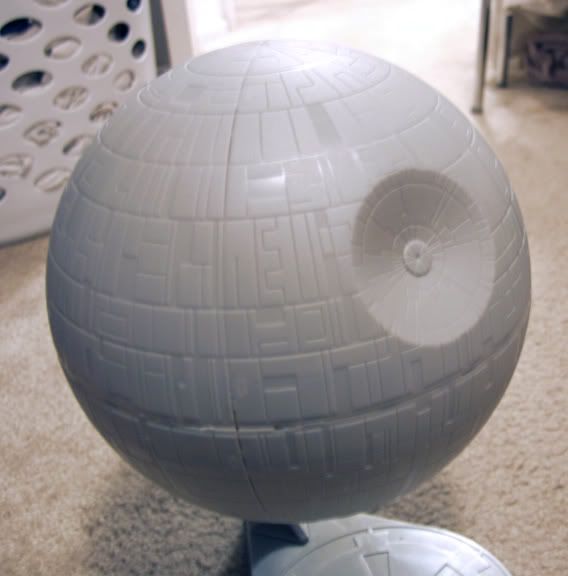

Also, going through those old pics, found my death star model kit, which is my spinning avatar, but 5 or 6 years before I fixed it up and finally painted it.

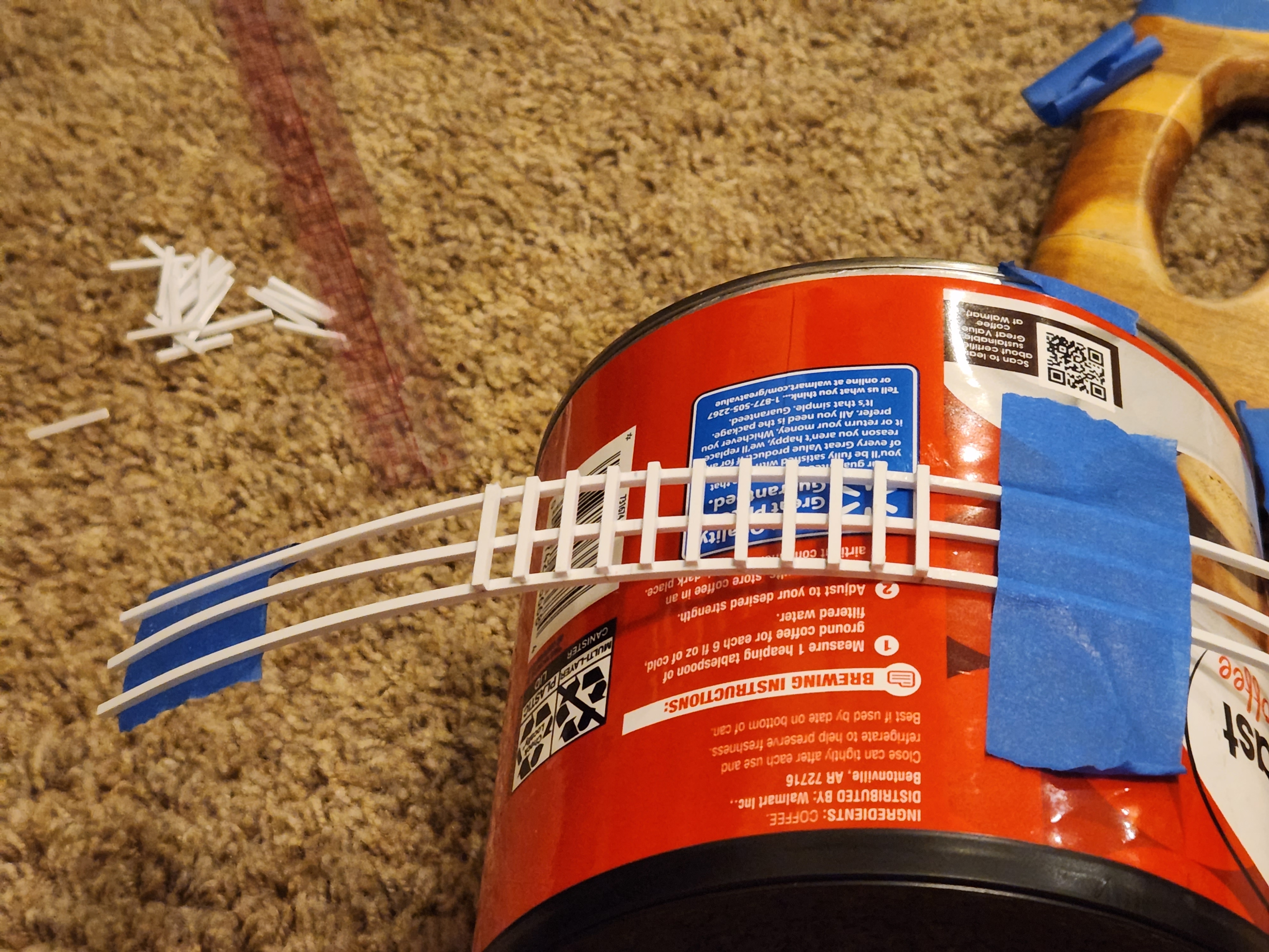

Heres another thing I wanted to fix with this kit, is the missing frame on each side.
But, this ended up being a bit more difficult than I expected.
I first tried to cut pieces that might perfectly go between the virtical frames, but in need 4 to all line up...wasn't going to happen.
Second I tried with this size. Thickness is the .75
I figured once I got it to bend a bit, I could glue it up inside...but it just didn't want to work and fought me the whole way.
It was probably still too wide anyways.
So I went even thinner, basically the stuff used on a for sale sign. It was still being tricky, but looks the best I could get it.
Before, I was also trying to already have them cut the correct size, at such a small scale, no.....this way I could trim excess off afterwards.
I'm thinking these two pieces are still not lined up exactly correct, but after all that, I think its as good as I'm getting it.

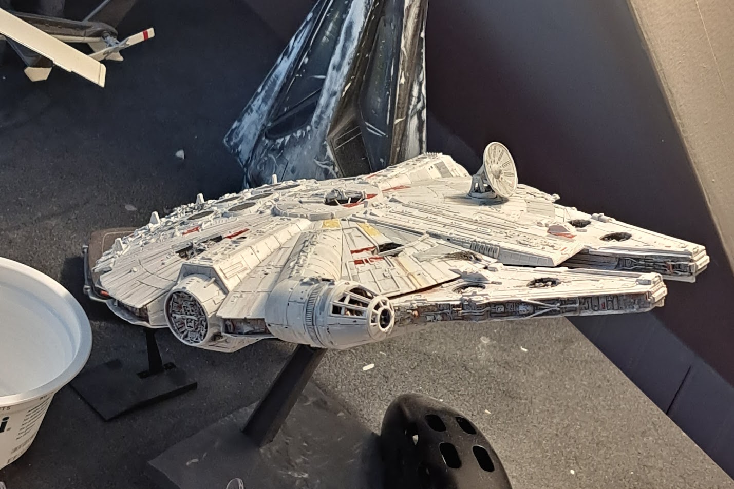

Two or 3 years ago I totally re-did my 80's MPC Falcon. It came out pretty good for the two weeks of work I put into it, but there was no getting around the side wall thickness (even though I used shading tricks & thin styrene rods to make them seem thinner).

Yeah, it came with windows. Here's mine today. It's really worth doing (revisiting the kit) because it's a nice size & holds many memories for us. No way in heck I will ever get my hands on a PG Falcon, but I *did* end up getting a smaller Bandai kit that made me completely happy (and it STILL needed modding!!!!).

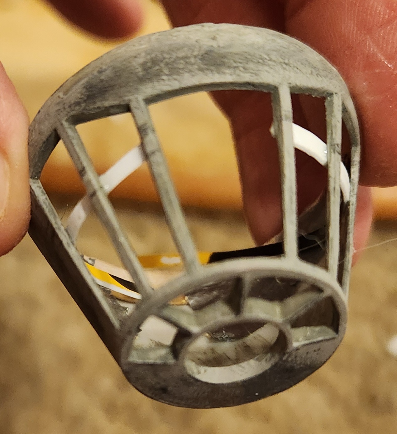

As for the back main engine, it was just that plastic piece, in fact two pieces you had to glue together, which I had done my best to paint the white faded to blue.
I thought since I'm redoing things anyways, I might as well try and work it to be more correct.
This is another one of those....try one thing, fail. Try another, fail....
Raise you hand if you've done that before.....*raises 57 hands*

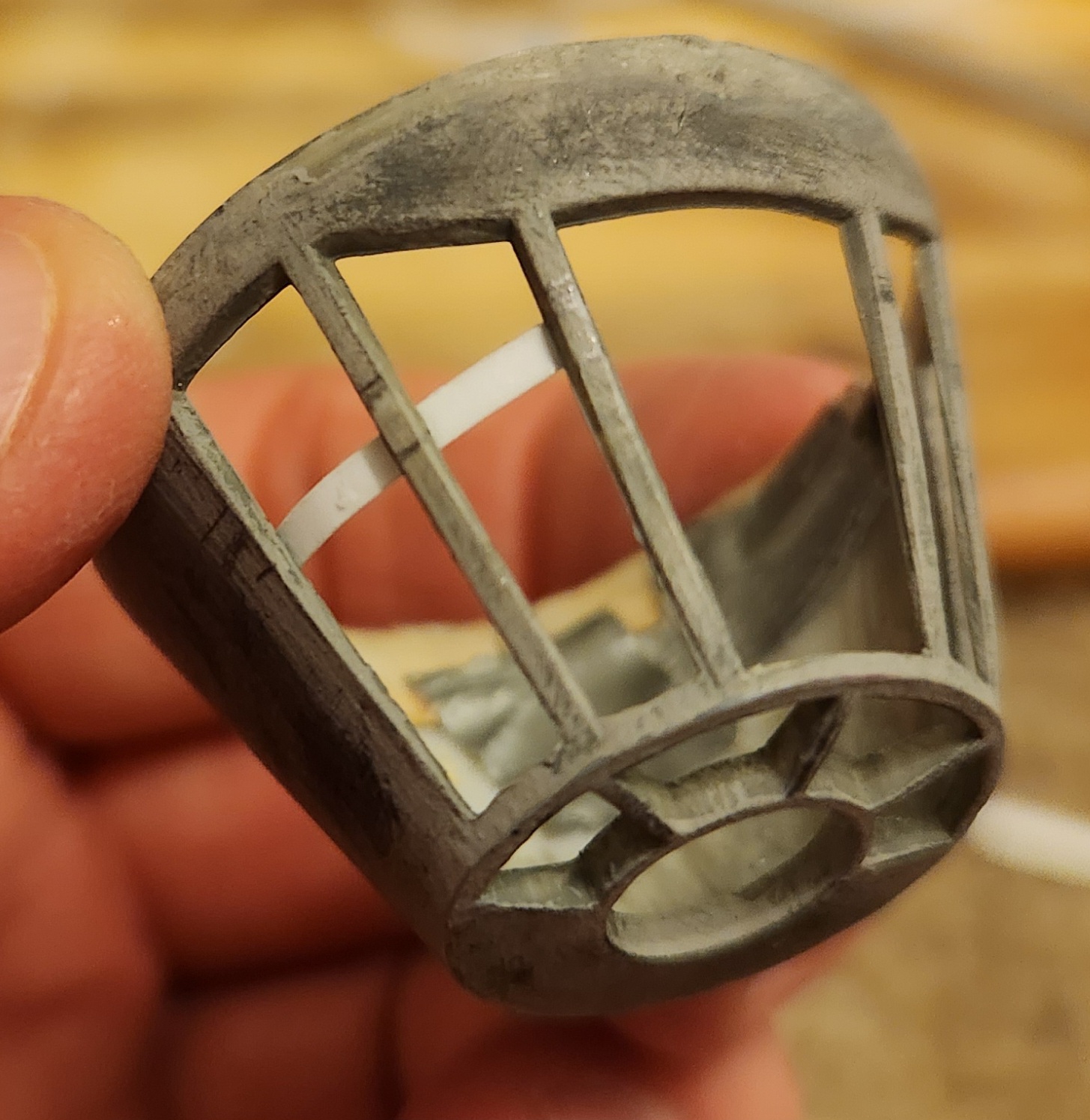

My first attempt was to take these three long 2mm rods I have and give them a bit of a bend to match the back of the Falcon. I didn't want to glue it to the long styrene strip yet, as that still needs the white fade to blue part.
I thought, if I line all three up with the correct spacing, then glue on the rods that go up and down, it should work....right? right???
nope.
I got this far, and might be hard to tell in the picture, but it was NOT lining up so well. Mainly the middle rod was fighting me the worst and kept wanting to twist. So I decided to rip it off with the help of some nail polish remover.....and broke a few pieces and snapped one of the side rods...
But I was able to fix the broken parts, got all the rods glued in and THEN just got the middle rod glued in here a big ago. Still wasn't perfect, but so much better.
Not too bad, just sitting in there for now of course.

Yeah, it came with windows. Here's mine today. It's really worth doing (revisiting the kit) because it's a nice size & holds many memories for us. No way in heck I will ever get my hands on a PG Falcon, but I *did* end up getting a smaller Bandai kit that made me completely happy (and it STILL needed modding!!!!).View attachment 1673035
At least your kit has better details. This one has such a basic mold. Probably didn't come with the plastic windows. I have some round rods I can probably add in a few places to help at least somewhat.
I slavishly created all those extra details from scratch! A new version of this kit is available with much better detailing for like $75. Might be worth lookin' at!
