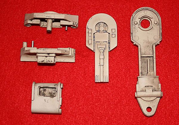

Well I got the side legs off and disassembled which will make painting them and the body easier.
If anyone is interested I can post how I did it.

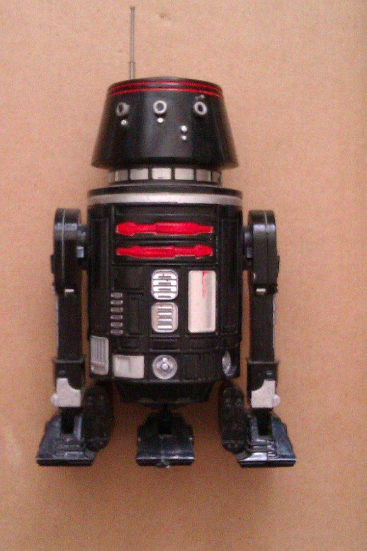

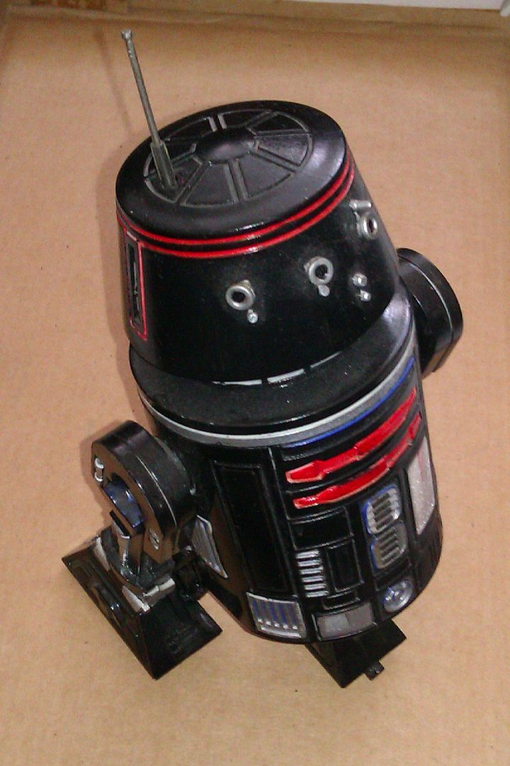

Here are pictures of a droid I saw on Ebay that inspired this project.
I like the overall look but I really hope my re-paint looks better then this

You should be able to understand how to remove the leg by looking at these parts.

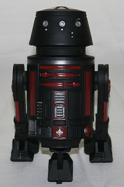

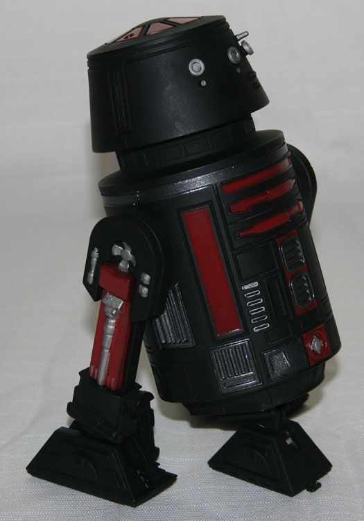

I painted all of the masked areas and I even attempted to hand paint a few of the details.
I went with flat black, dark red, gun metal for the silver panels and silver for the hand painted details
Over all I like the look but there are still a lot of hand painted details that I may just not worry about.
I think it turned out great, I love the black Imperial droids much better then the Rebel versions- except for R2-D2.
