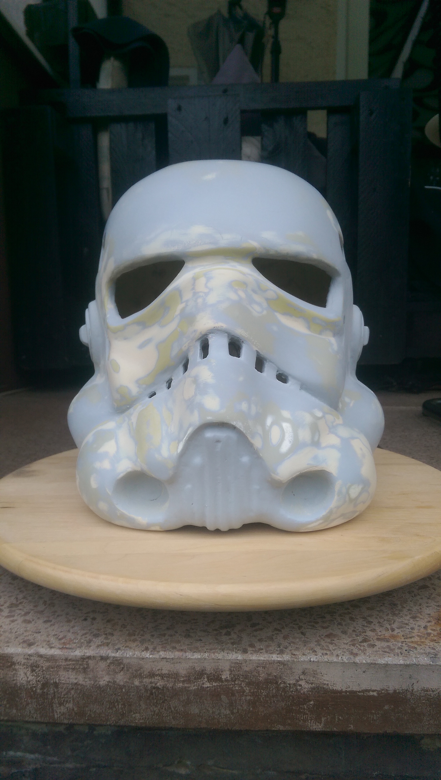

Here is what I have now. The surface is nearly perfect now, which Iam happy about. I now need a Dremel to proceed. I need to completely redo the ears, the lip, the rectangles, the vocoder, the circles for the mic tips and the eyes... Thats a bit tricky to do it by hand :)
Iam not going for the 100% exact screen accurate model. It should look and feel good.
If I really like the outcome of the helmet I may consider making a mold and cast a few more of them :D
If you have any tips or hints I appreciate them very much.
Thank you!

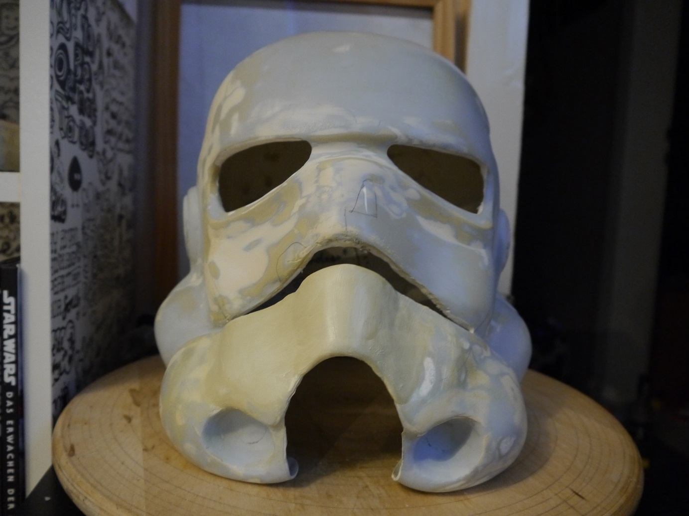

Just a quick (maybe unnecessary) little update.
My Dremel arrived, so natuarlly I had to try it.
As the mighty terra1 once said
one step backward to go two steps forward [...]
I cut out the vocoder area and the the teeth. Also I cleaned the lip and widened the eyes a little. I have a lot of work to do :/
I want the 'face' at least to be nearly symmetrical, so I have to a lot of modeling there. I think I will take milliput to do the general modeling and fine bondo to finish the surface (that was my go-to technique).
- I need to fill all the rectangles with bondo and cut them out in their right shape again.
- I will cut off the ears to remodel them again (maybe 3d print the little antenna thingies)
- Vocoder needs to be remodeled completely
Thats just the beginning :D

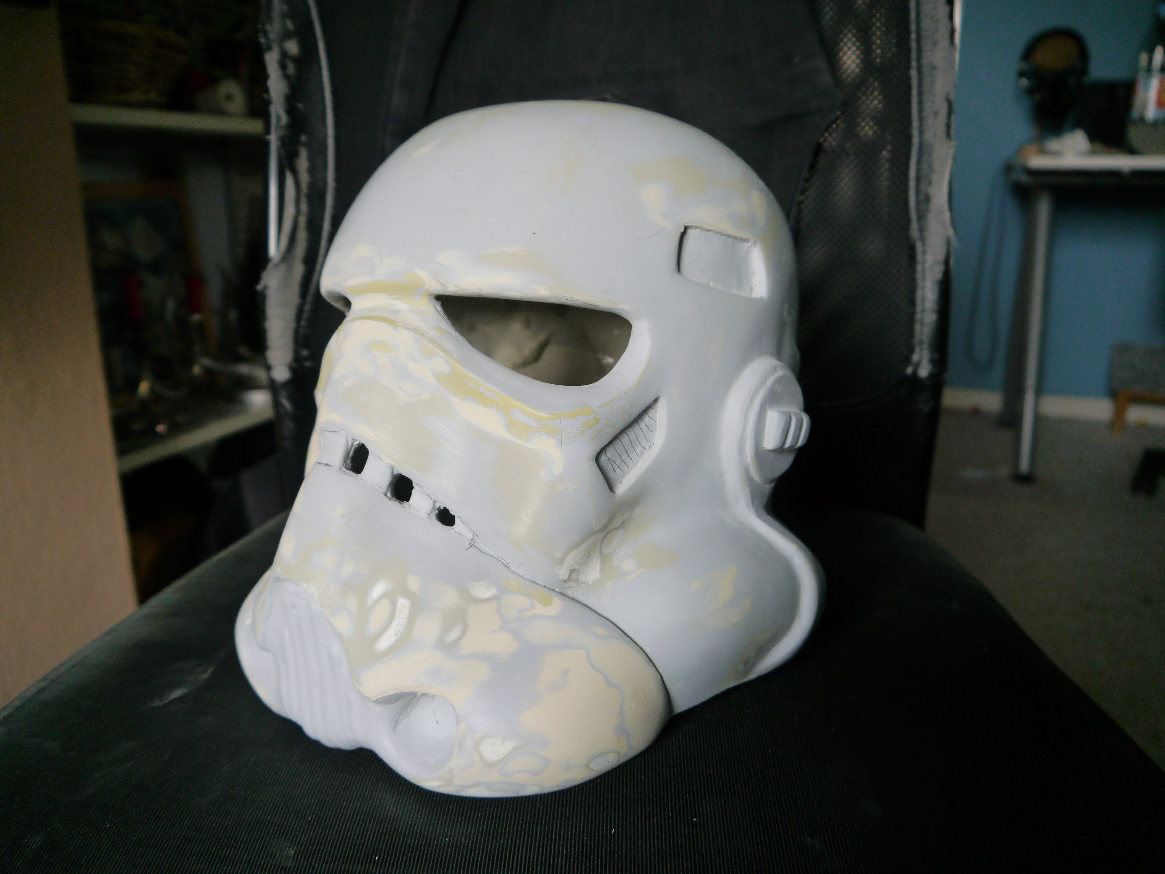

Re: Redoing my old, inaccurate Stormtrooper helmet
Slooooooow slow progress.
I'm quite busy learning for uni, so I can spend around an hour a day working on the bucket.
I managed to put some more Milliput on the lower jaw, and I think the shape is getting there. I will sand it in the next few days, apply some more fine putty and call it a day (hopefully).
Also filled the tears roughly with Milliput (had some excess).
I plan on removing the ears completely, filling the other rectangles with bondo and sand them flush, get the shapes of the eyes correct and working on the vocoder (to be precise, by working I mean thinking about a method to build it...)
