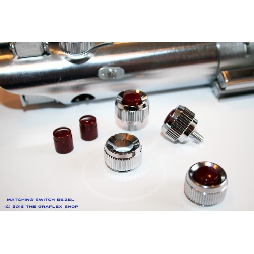

Hey H0llyw00d ! Is your TGS Red Button a thumbscrew or a button? If it's a thumbscrew, does it have a spring under the red cap to simulate it being a button, or is it immobile?
Hey @H0llyw00d ! Is your TGS Red Button a thumbscrew or a button? If it's a thumbscrew, does it have a spring under the red cap to simulate it being a button, or is it immobile?
If it has a threaded rod on the back then no, but it can be used for blade retention. The only replica with a spring is the “working” red button replica.

TGS red buttons:

They have the same size but depending on if you are going to use them as blade retention screws you may have to cut them down.
