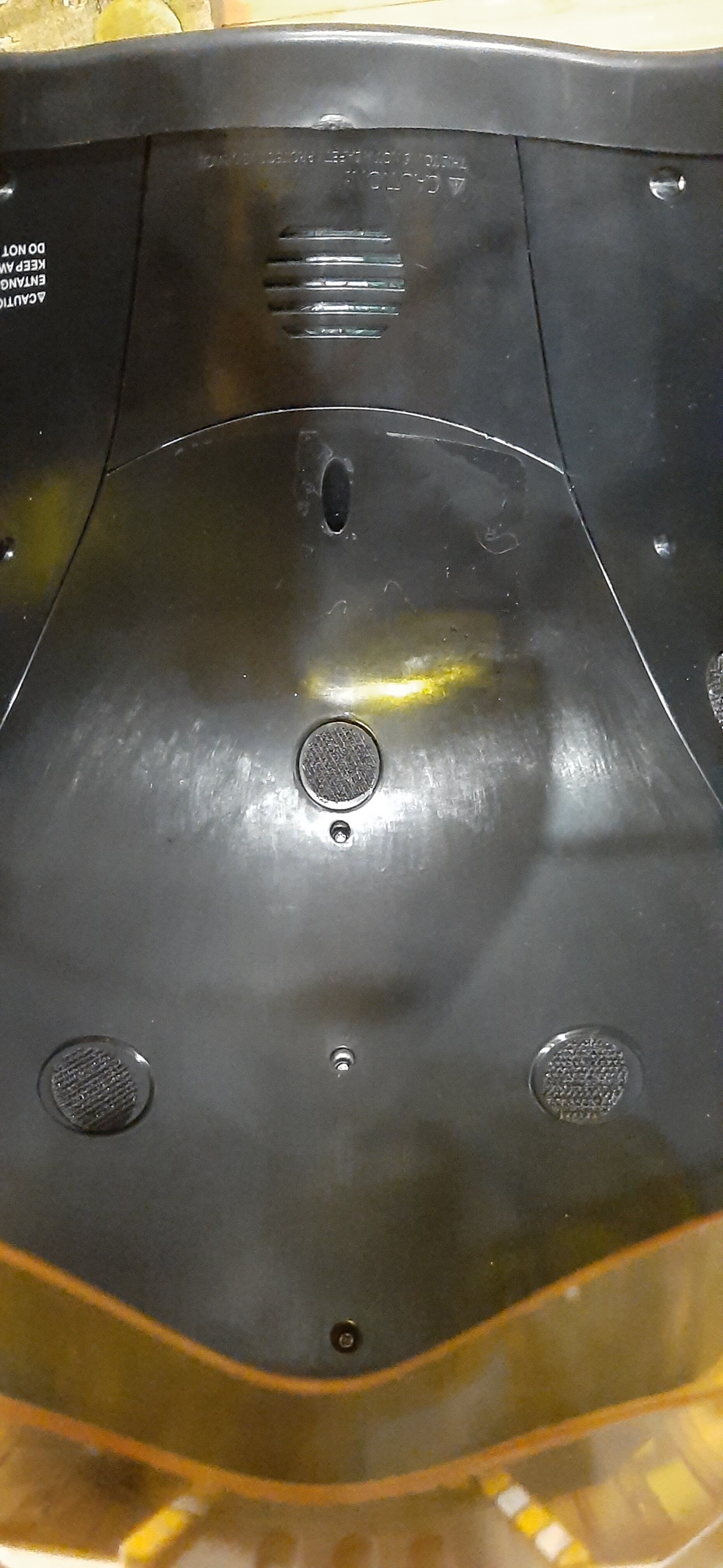

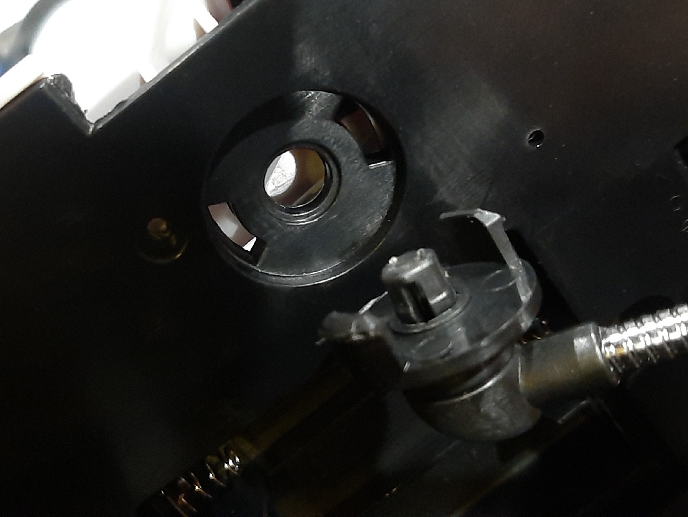

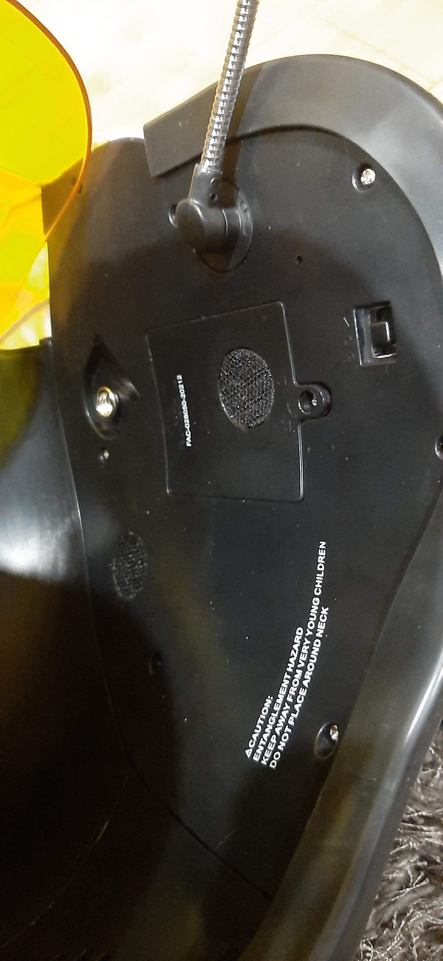

I did a disassemble and repaint of the Black Series Luke helmet and I'll show some photos here.
Any questions please ask. I'll do my best to explain how it works. you will have to forgive the mess this was. and I didn't take photos in the first part of disassembly of the interior of the shell and electronics. I'll be doing another repaint of another helmet here soon and will post a more detailed step by step.

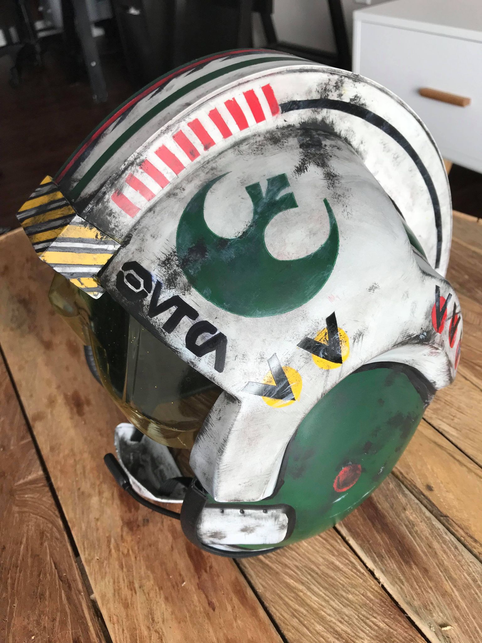

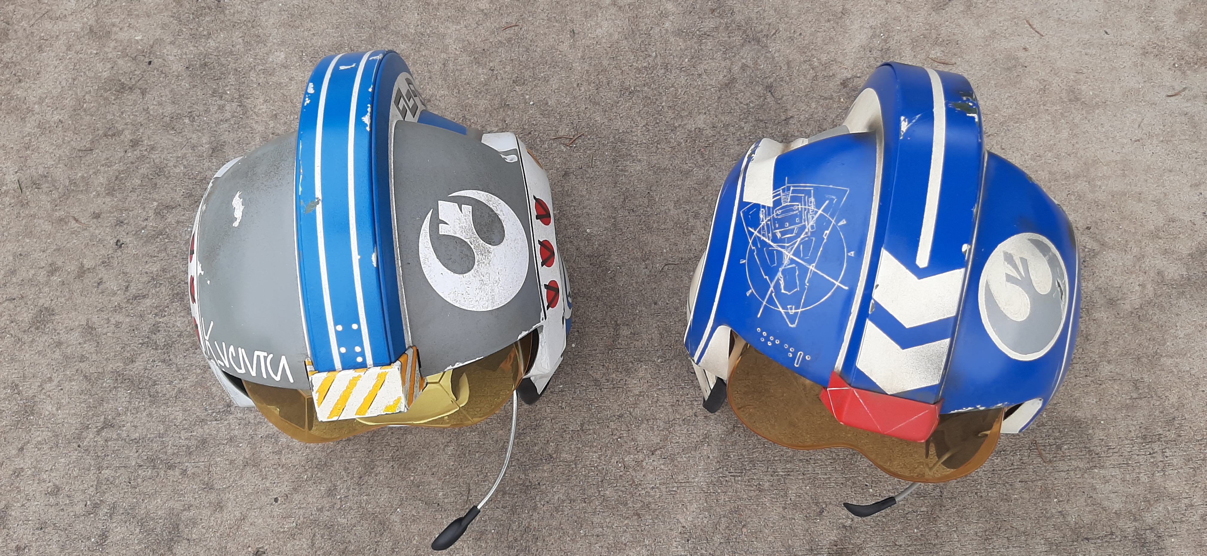

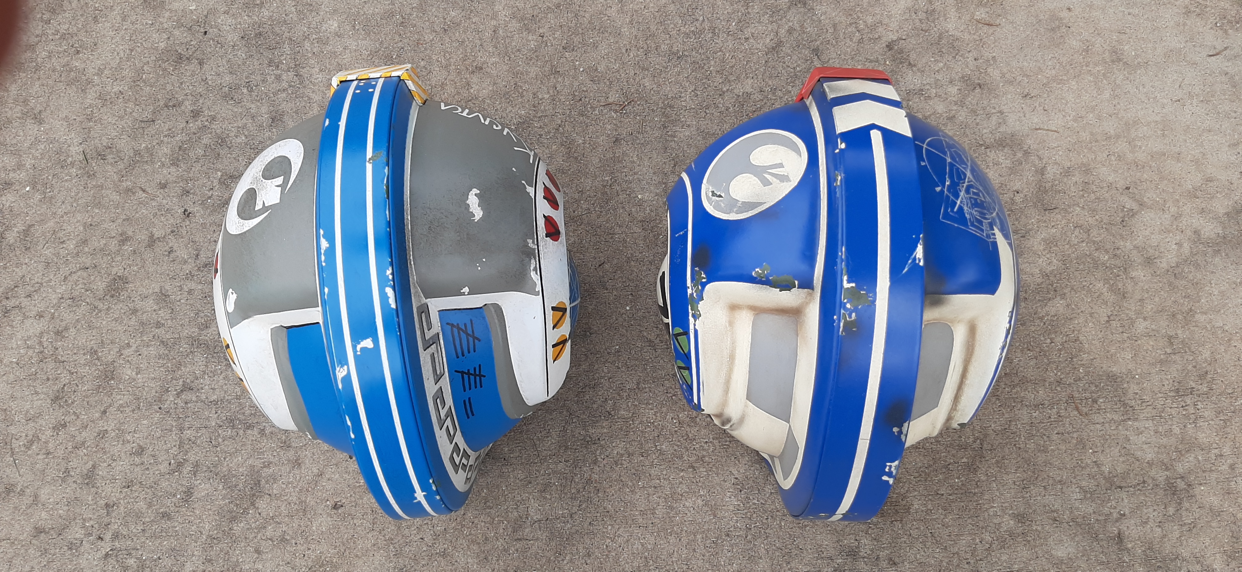

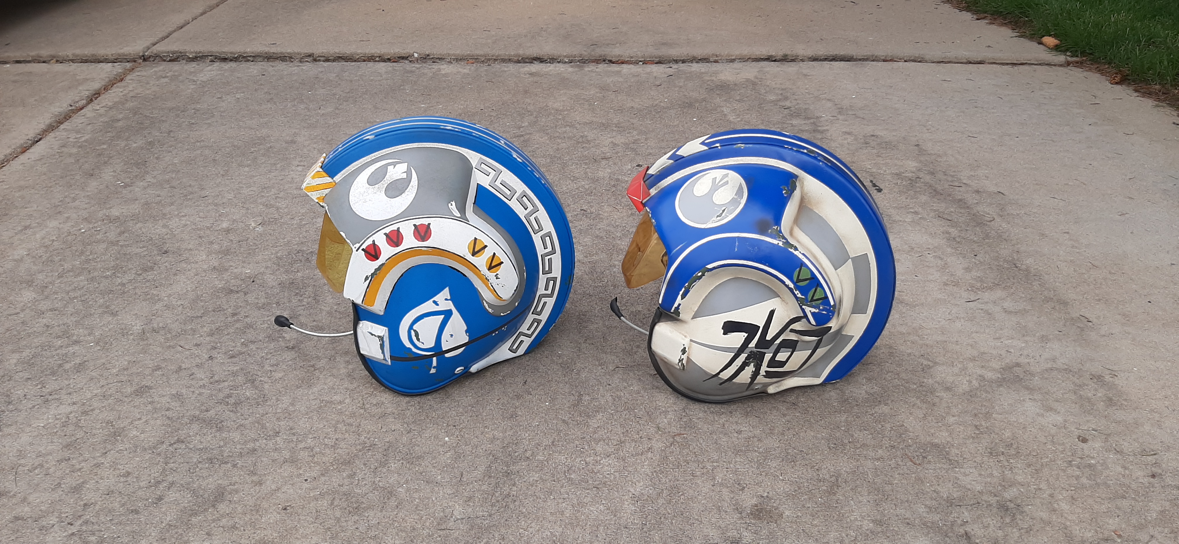

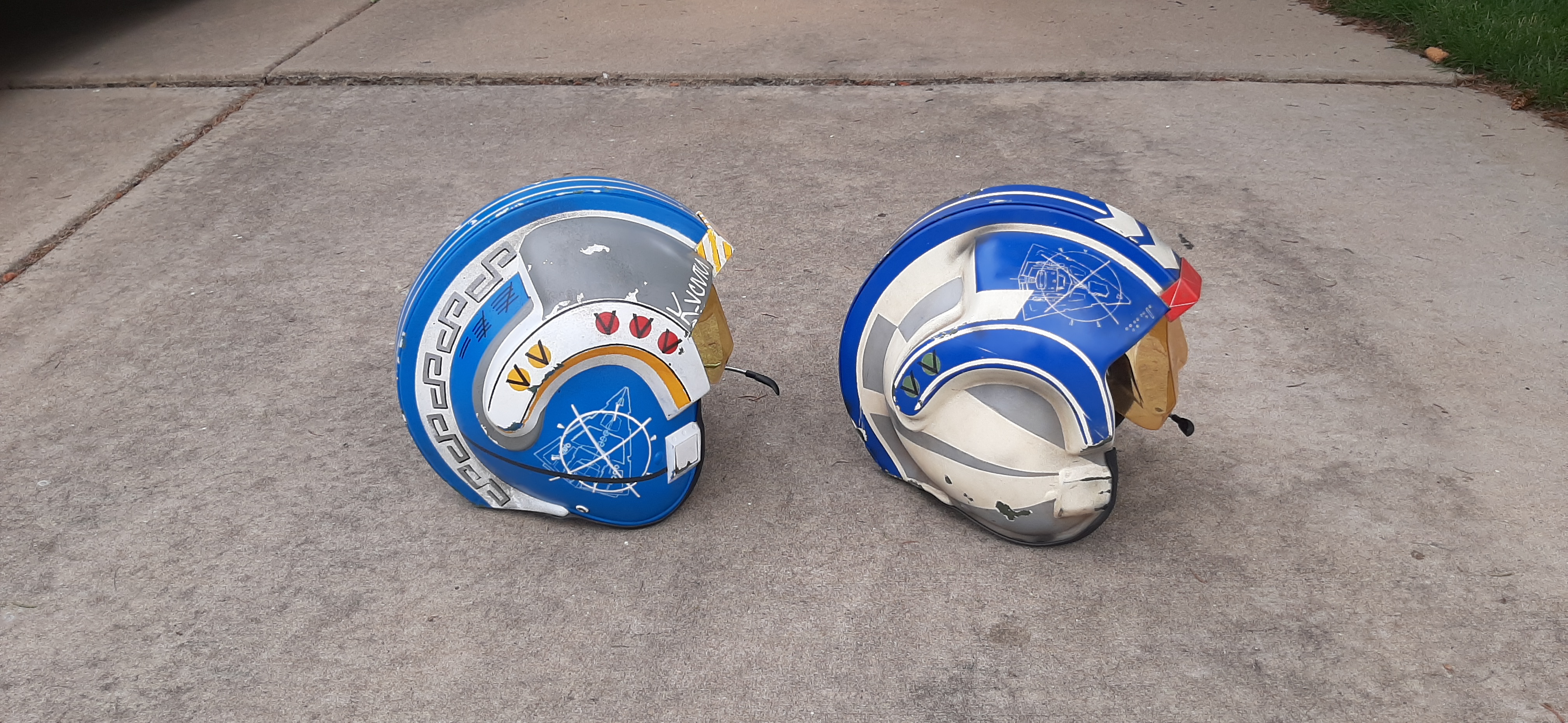

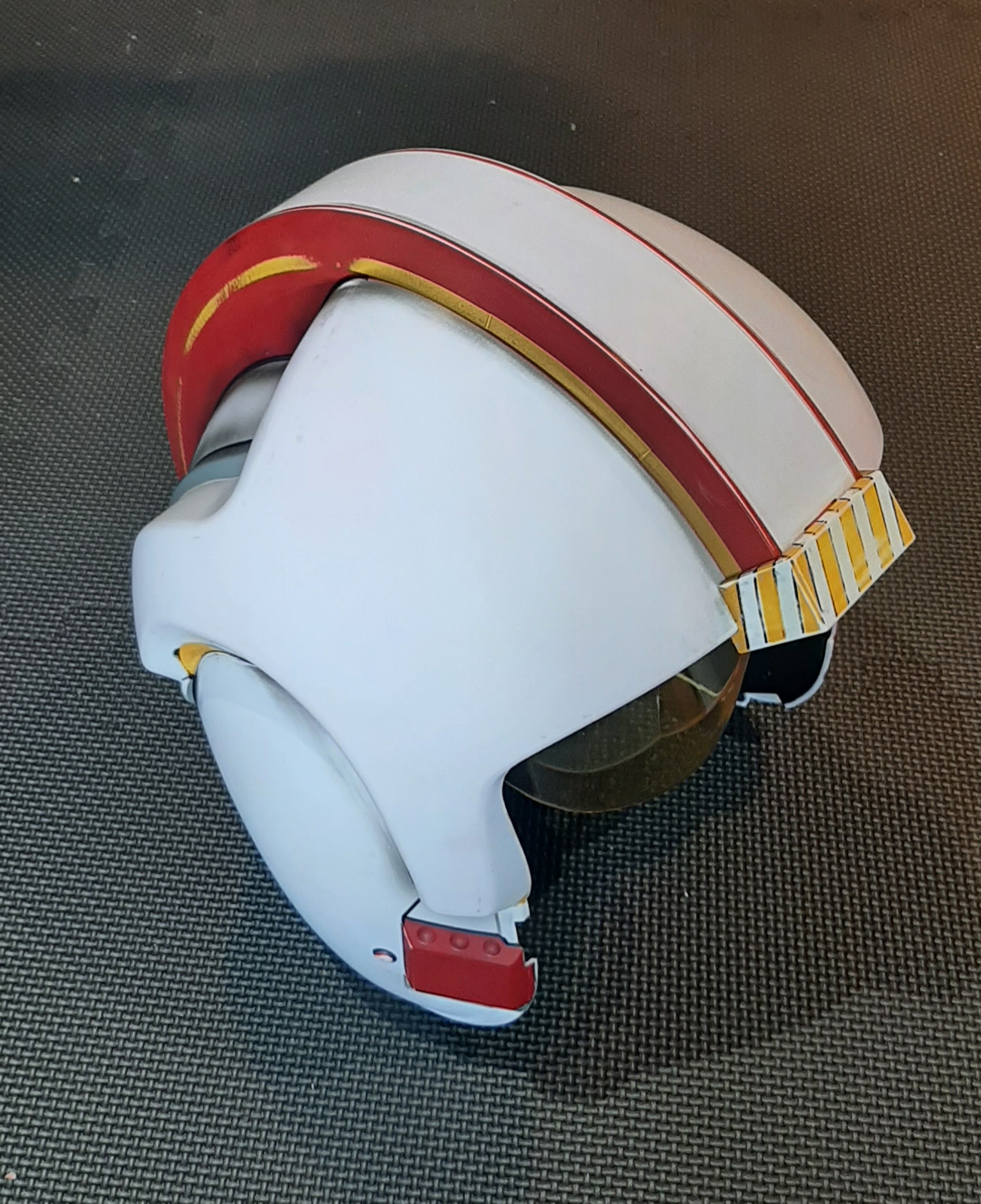

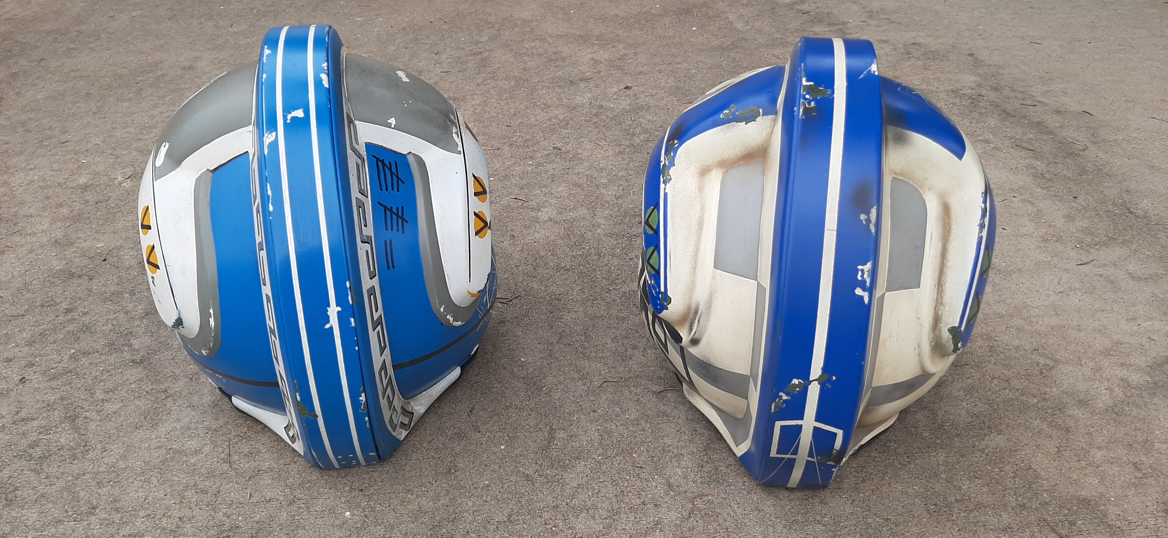

here's the comparison of size and shape from the Black Series repainted Luke Skywalker helmet and an original Rogue One xwing helmet with my own paint. BS on the left and RO on the right.
enjoy!

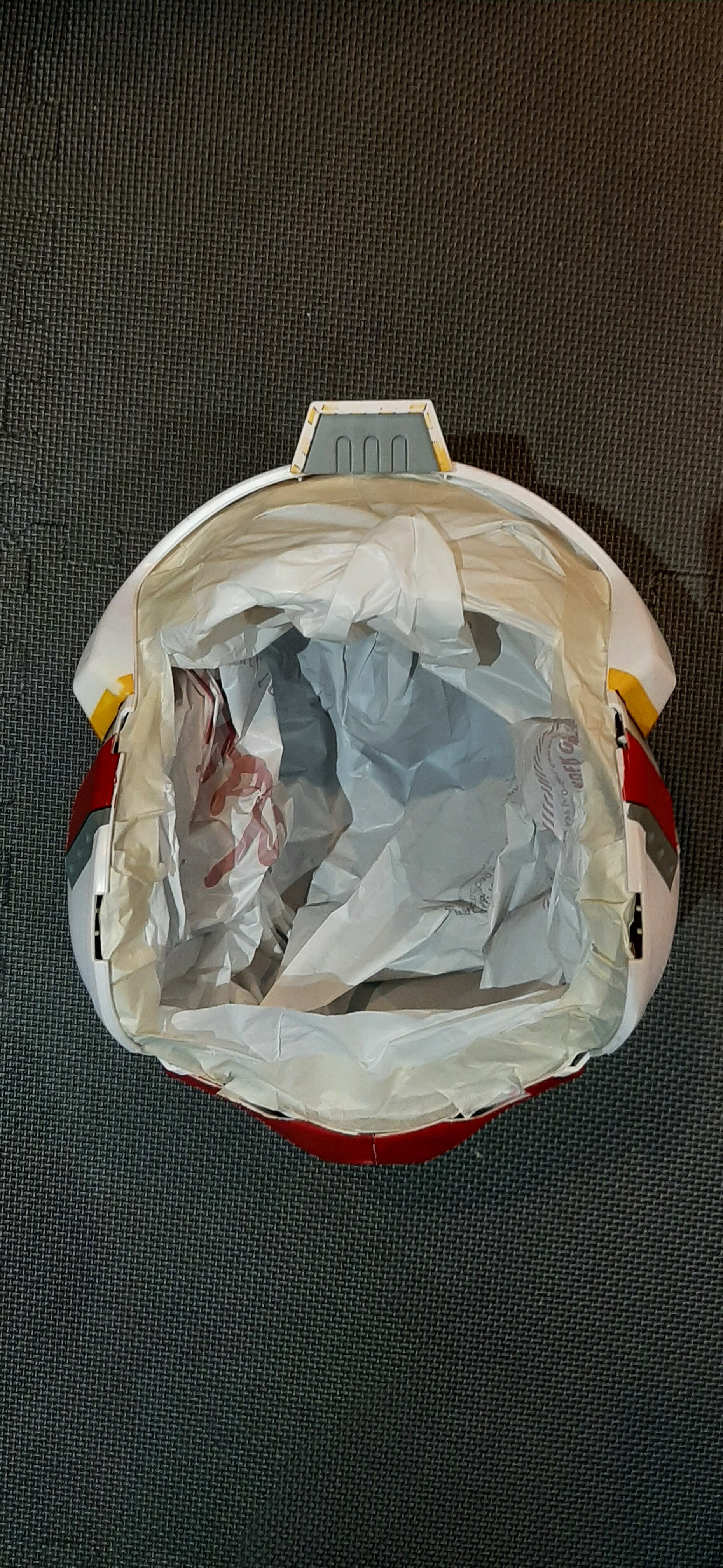

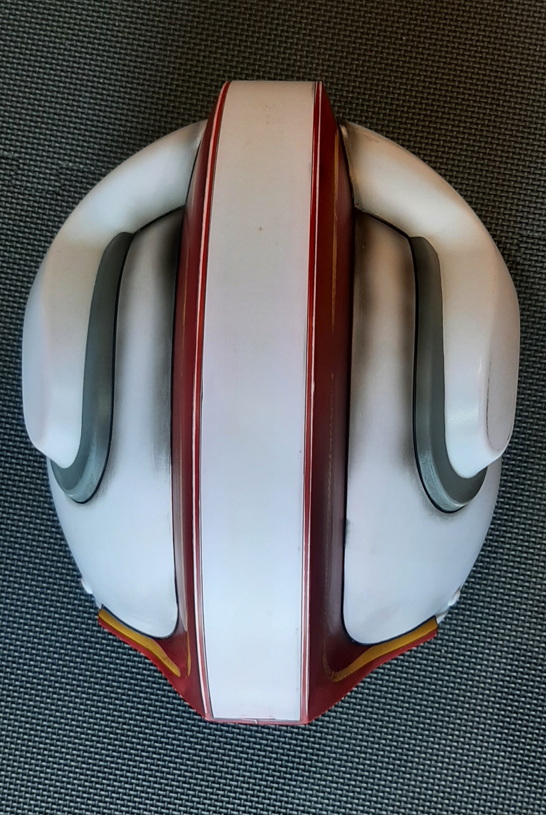

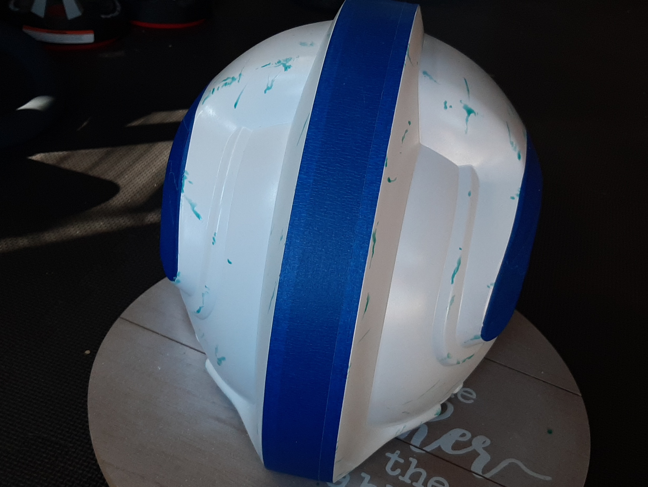

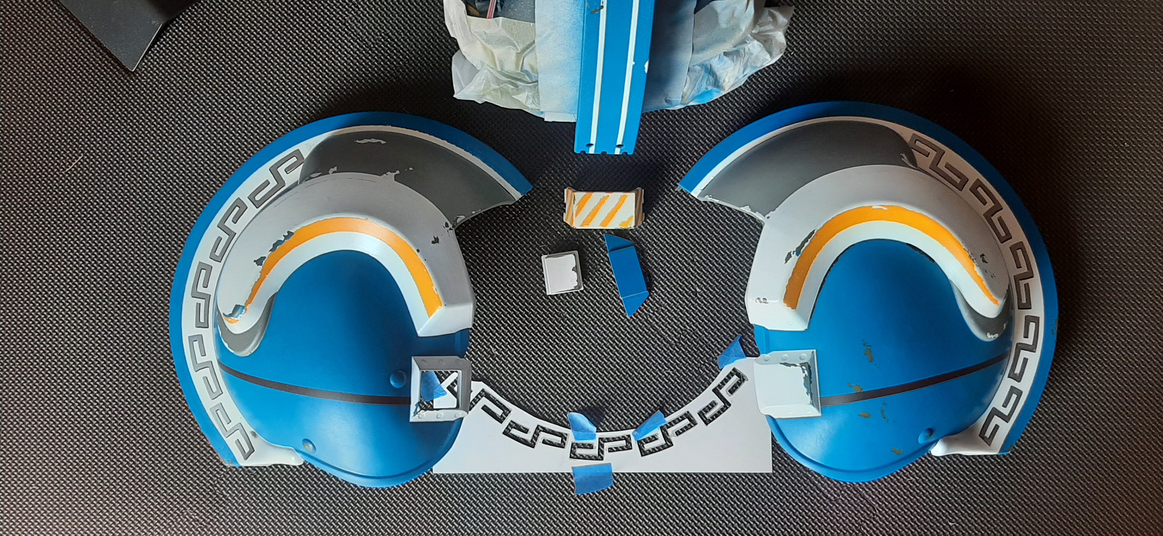

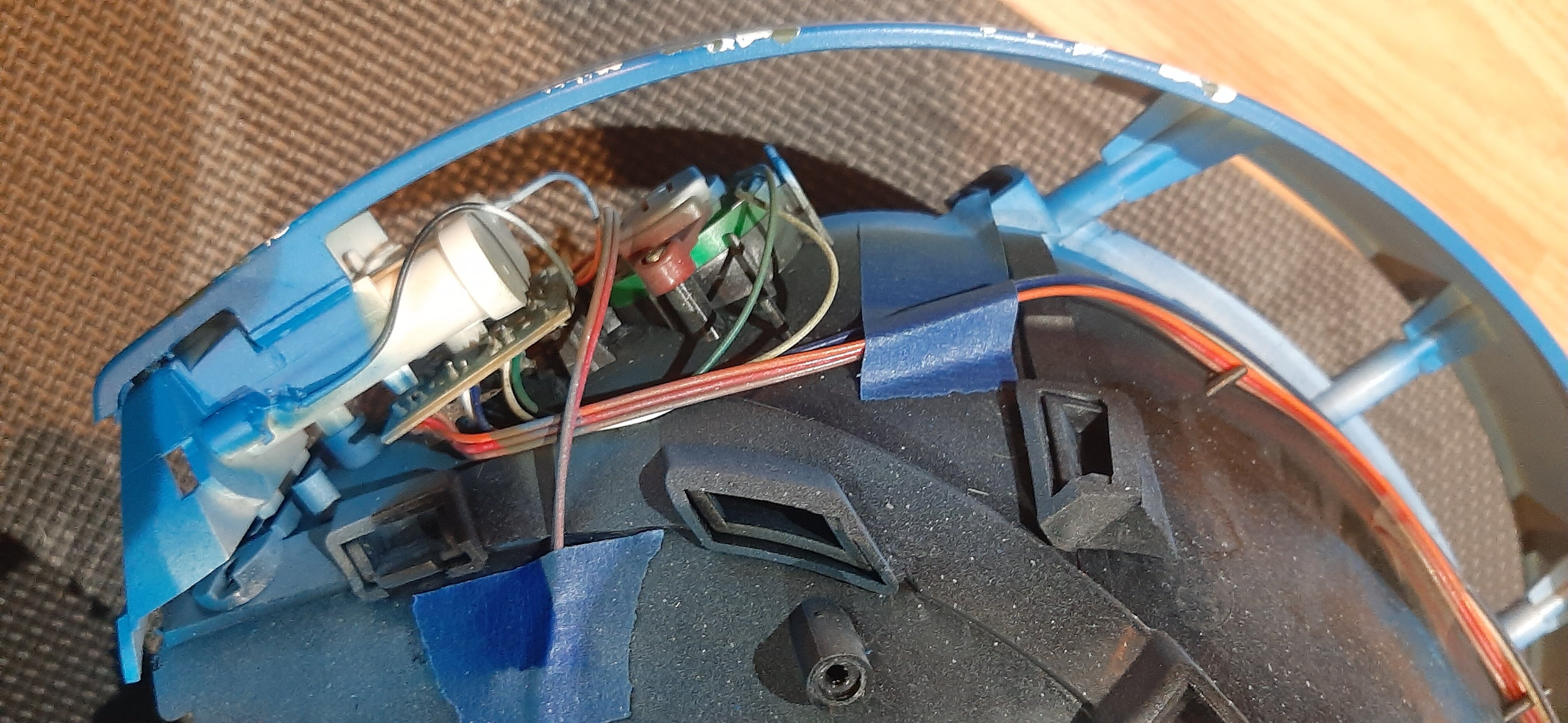

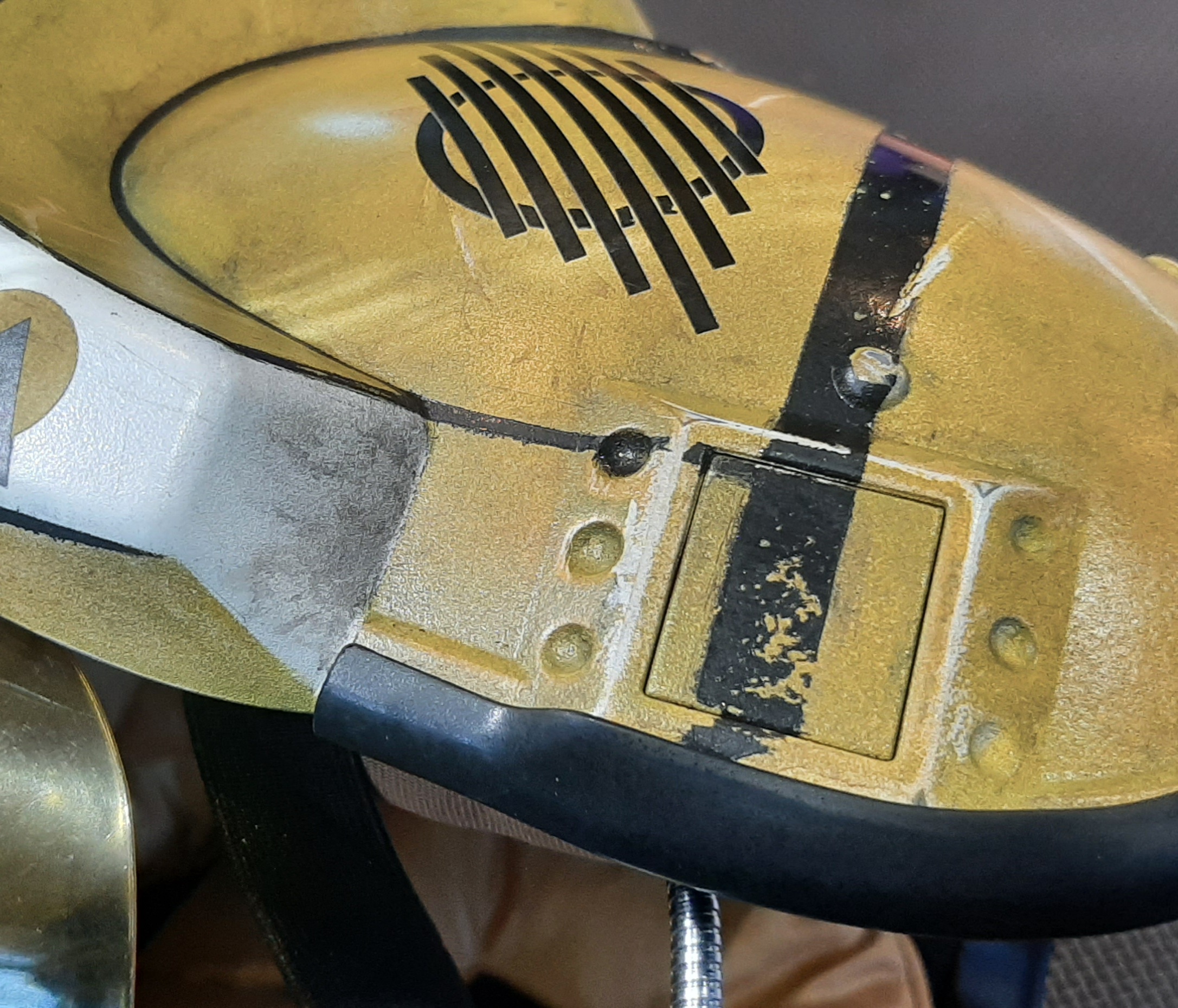

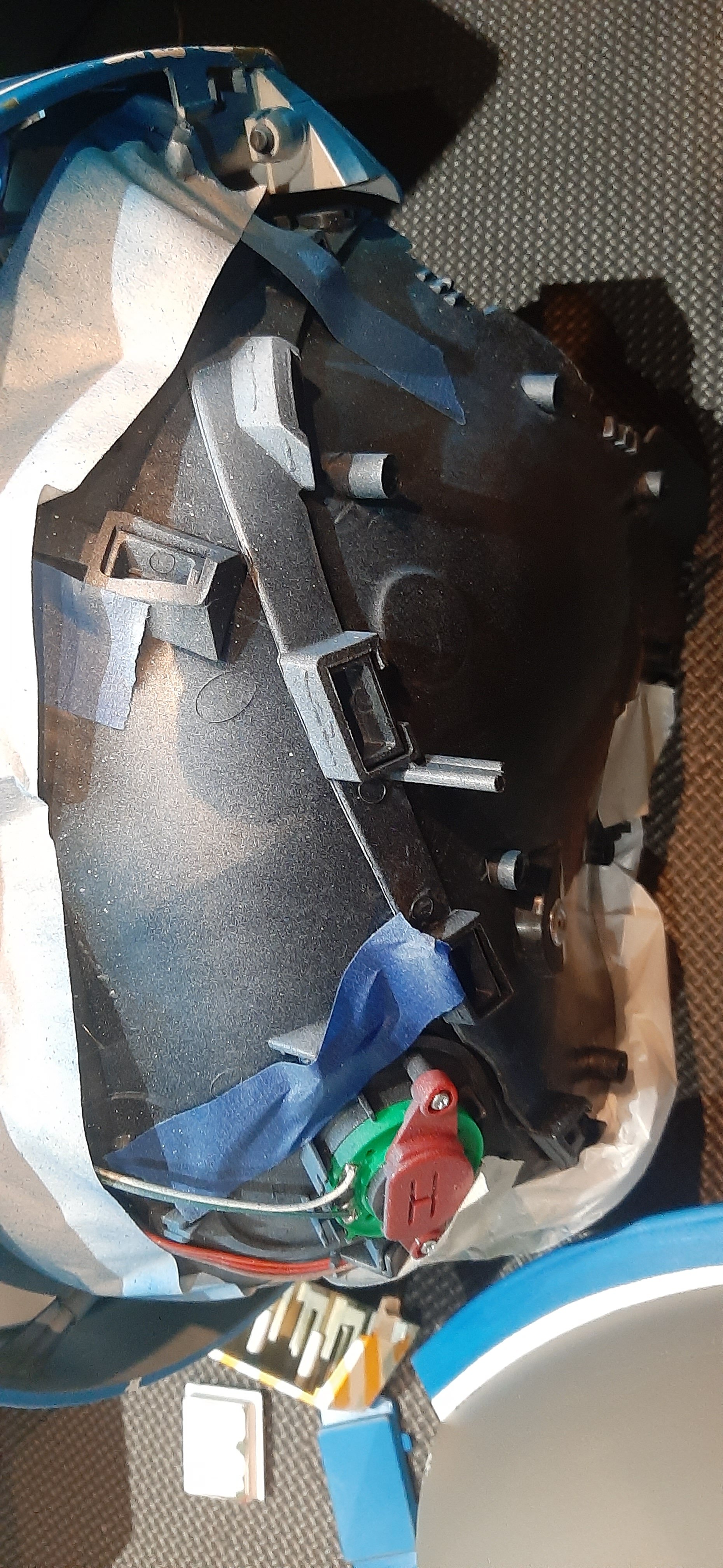

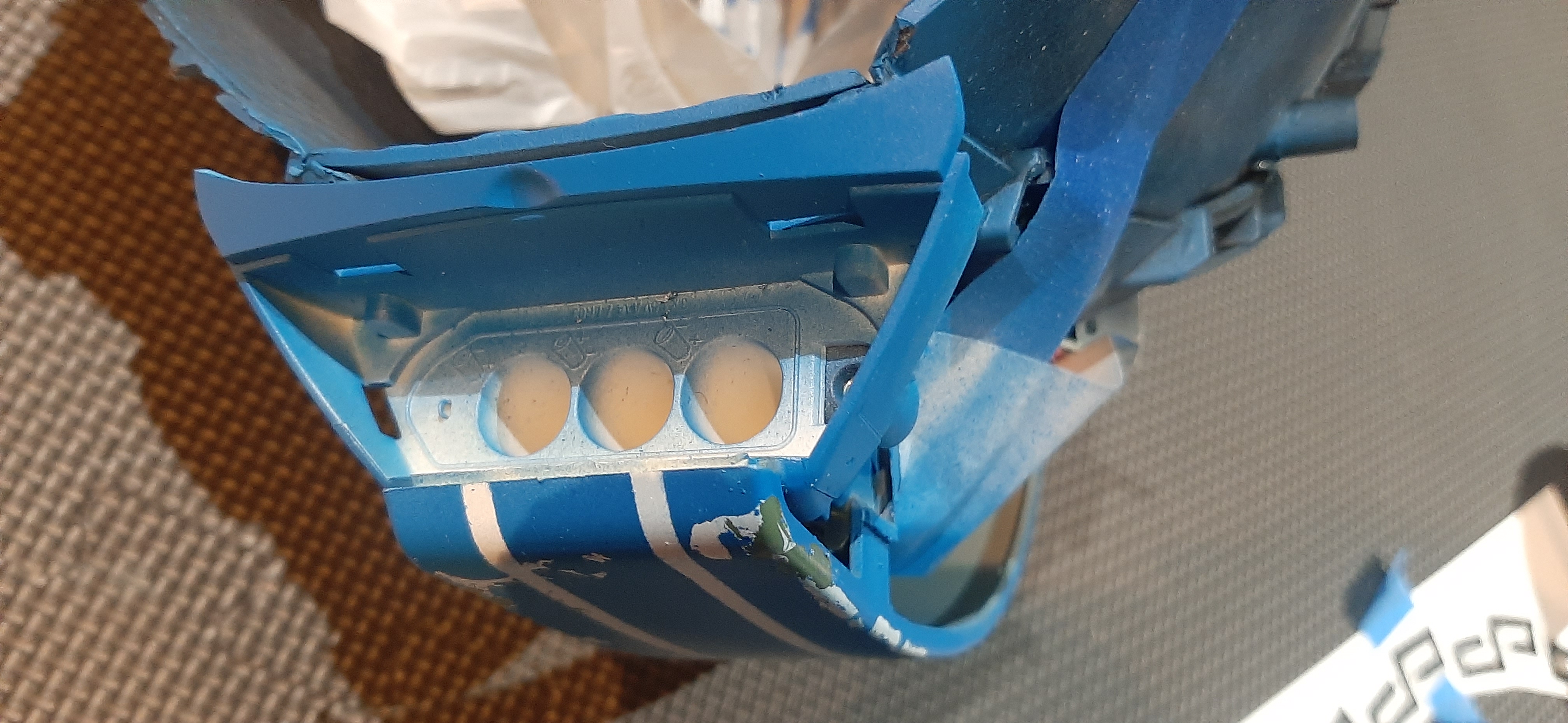

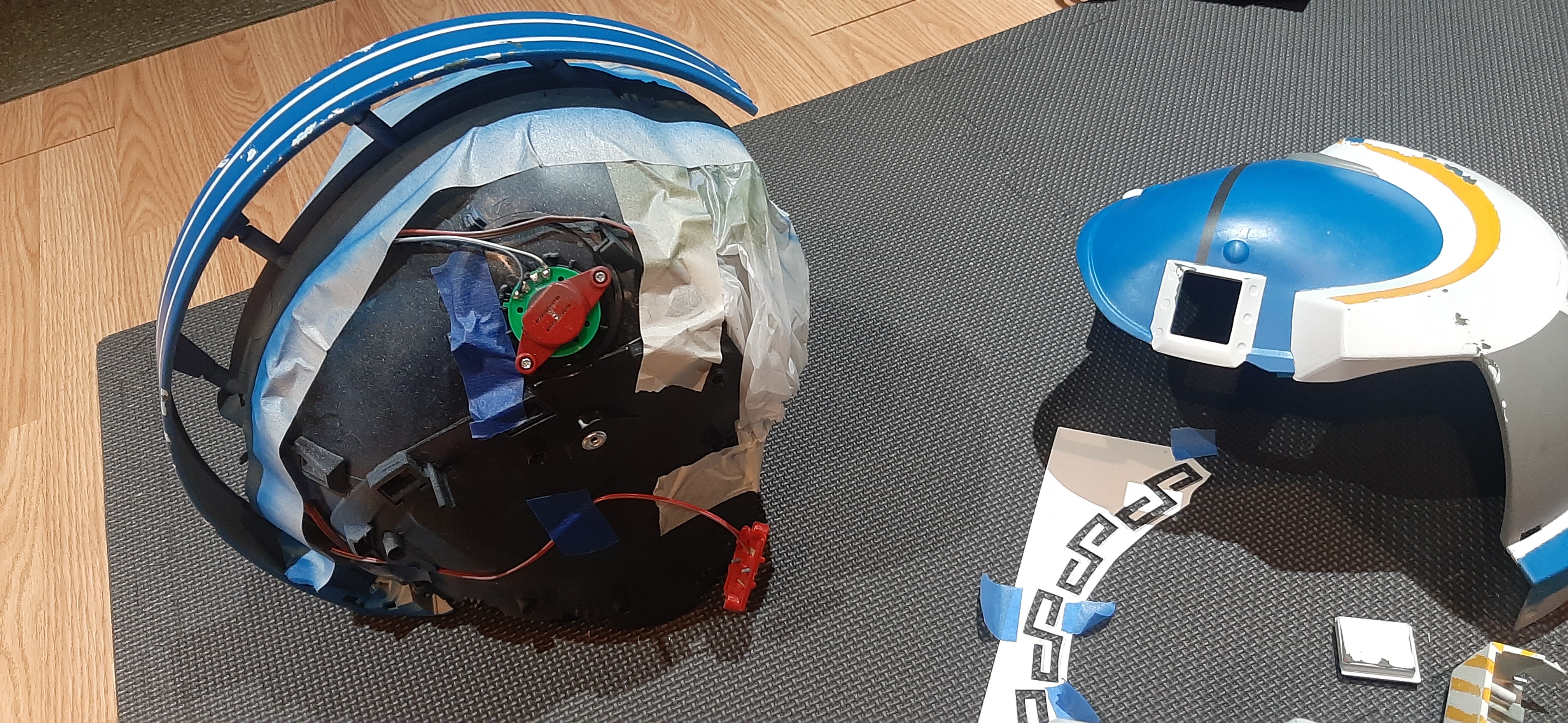

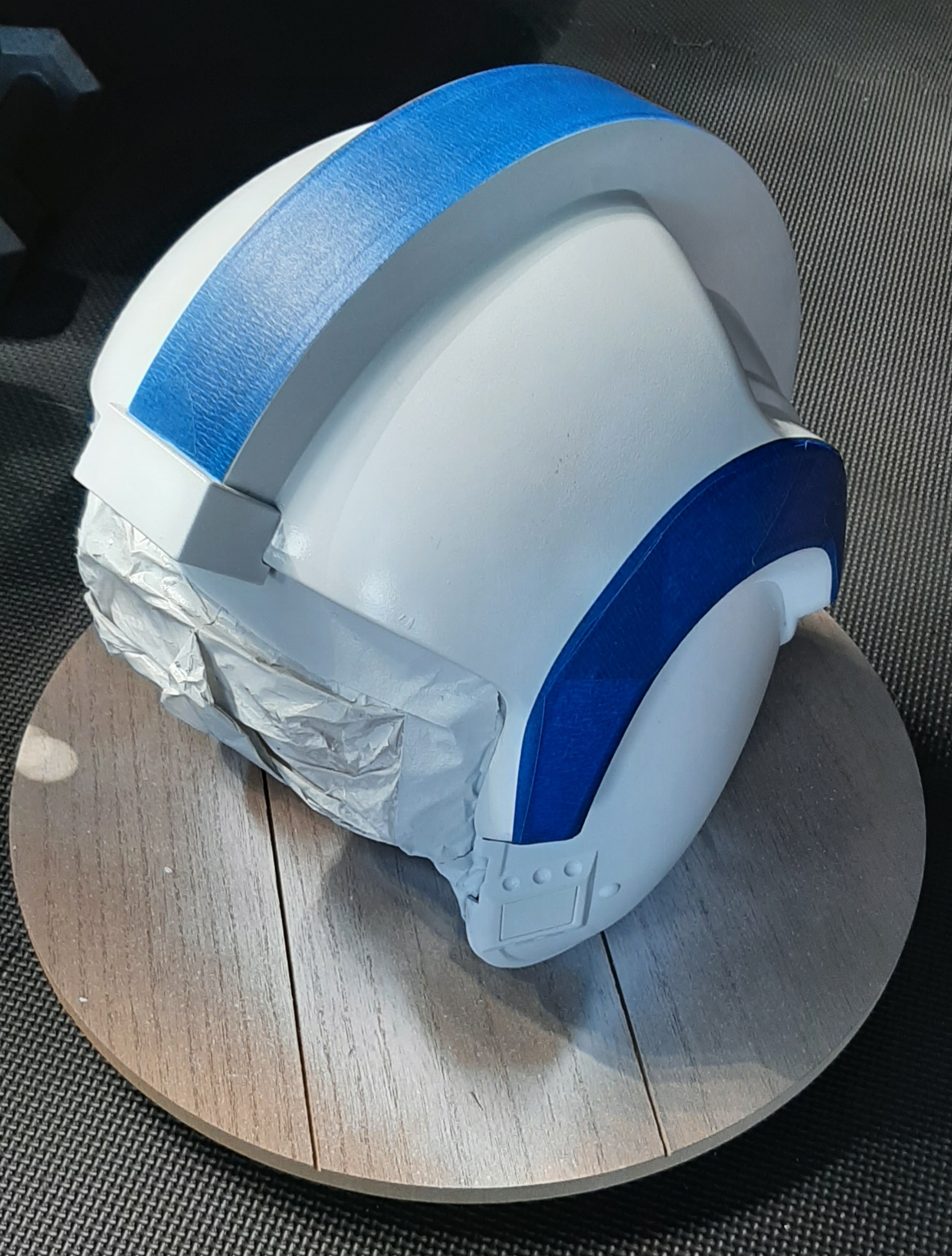

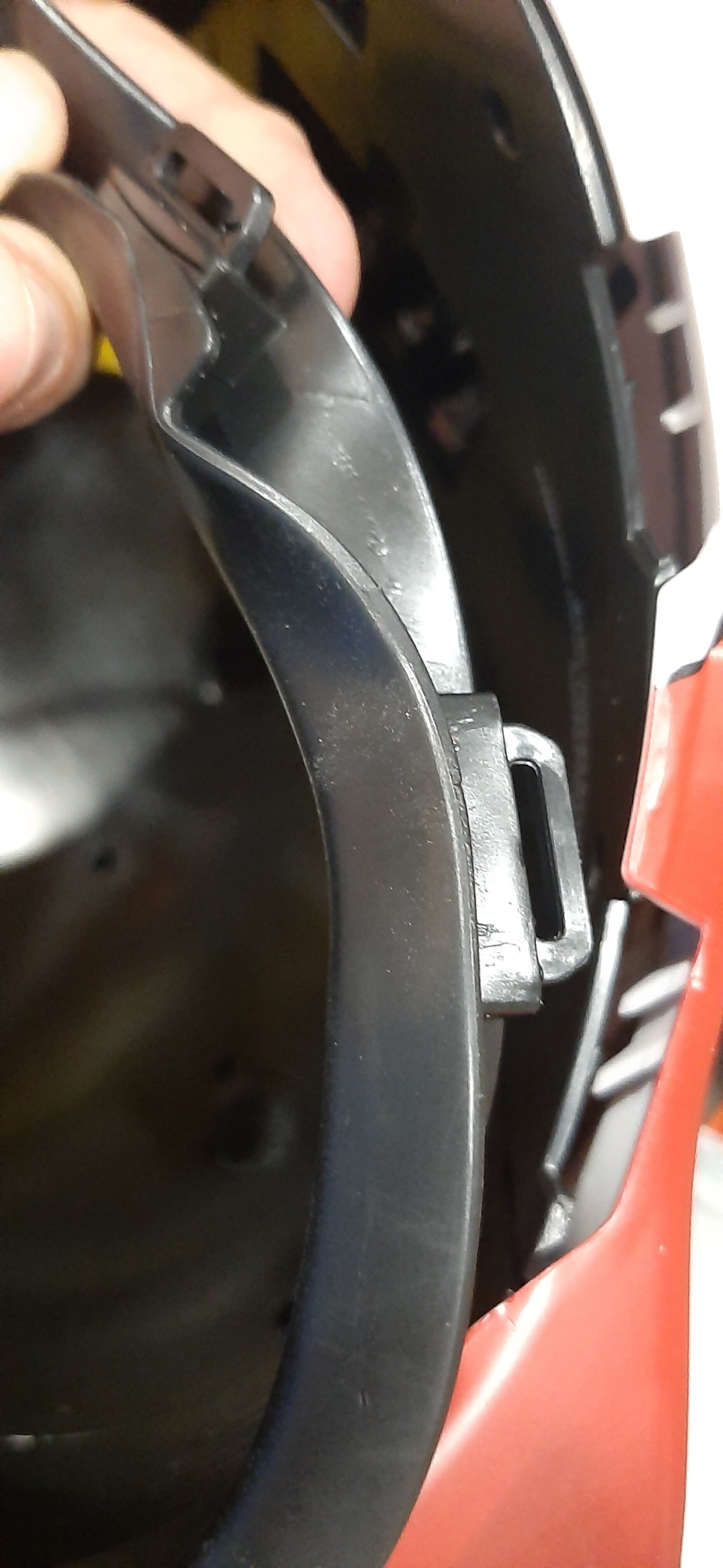

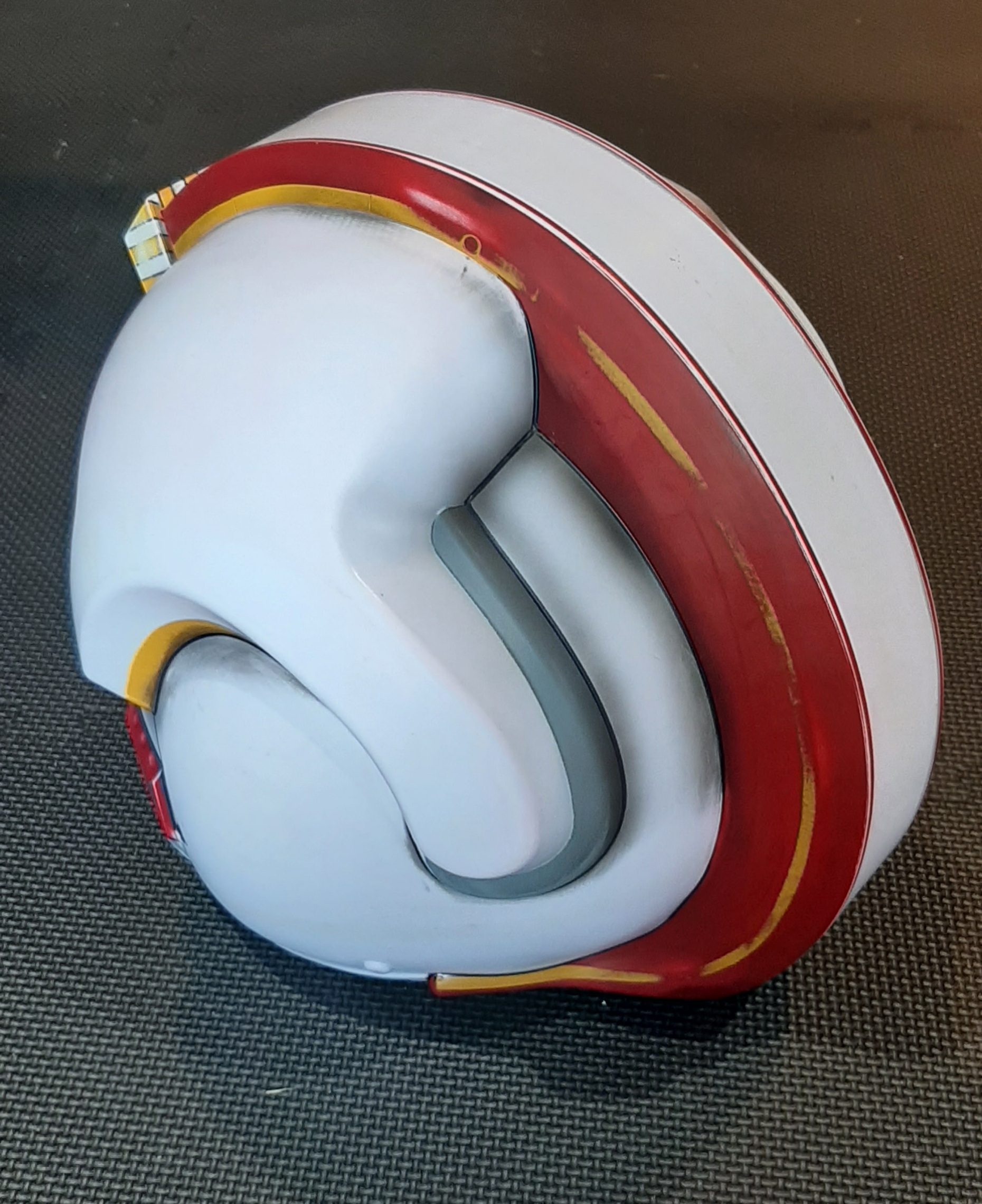

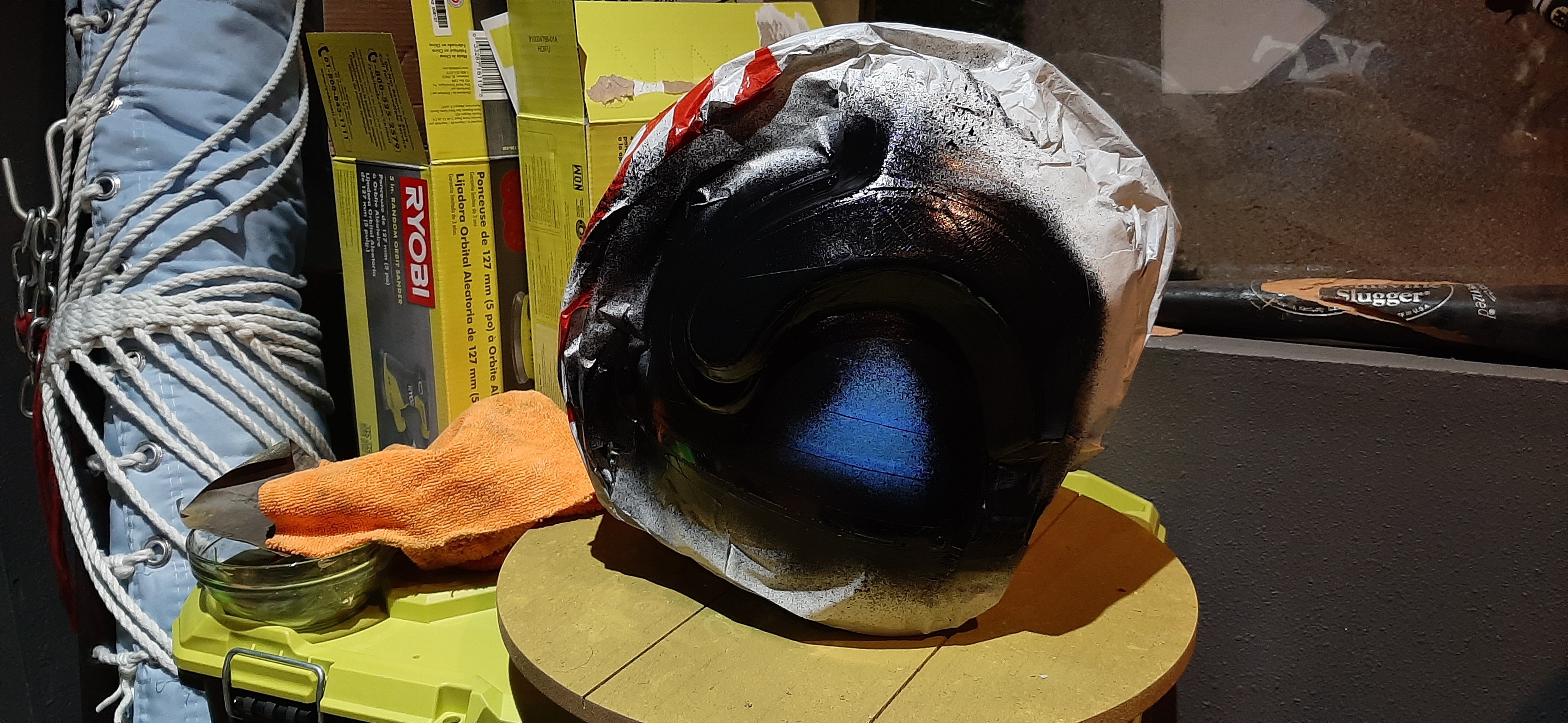

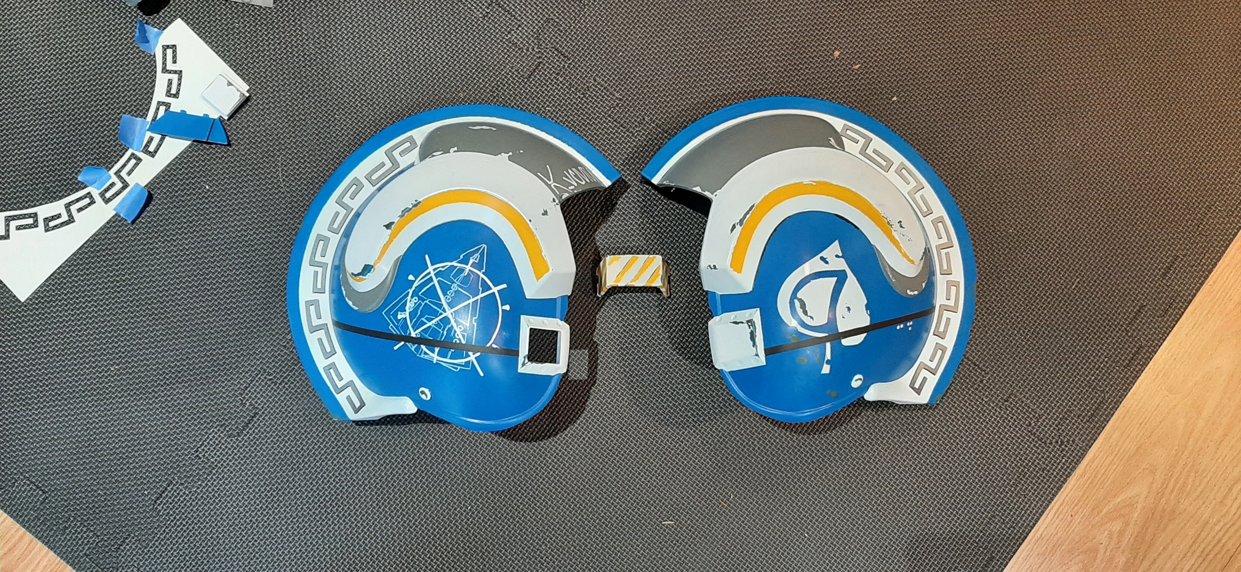

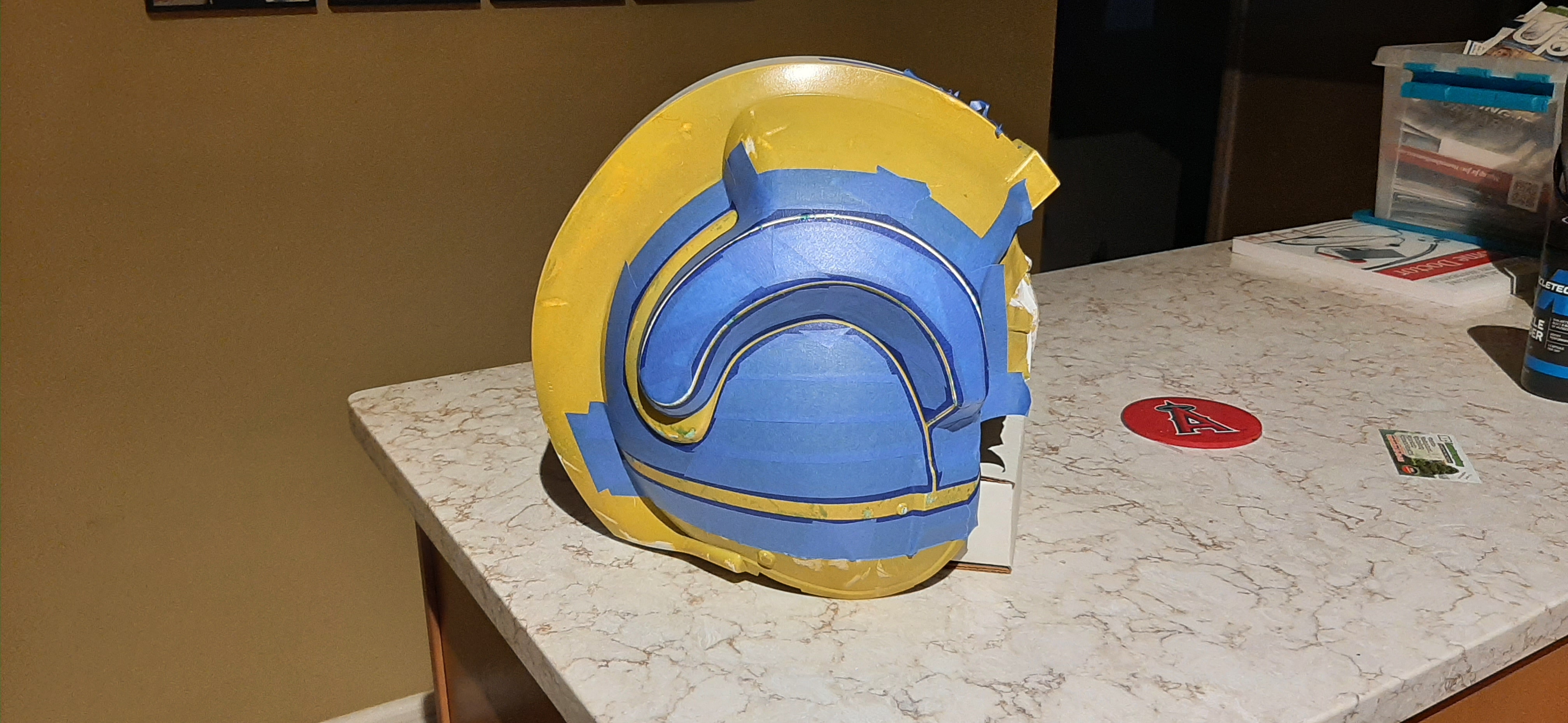

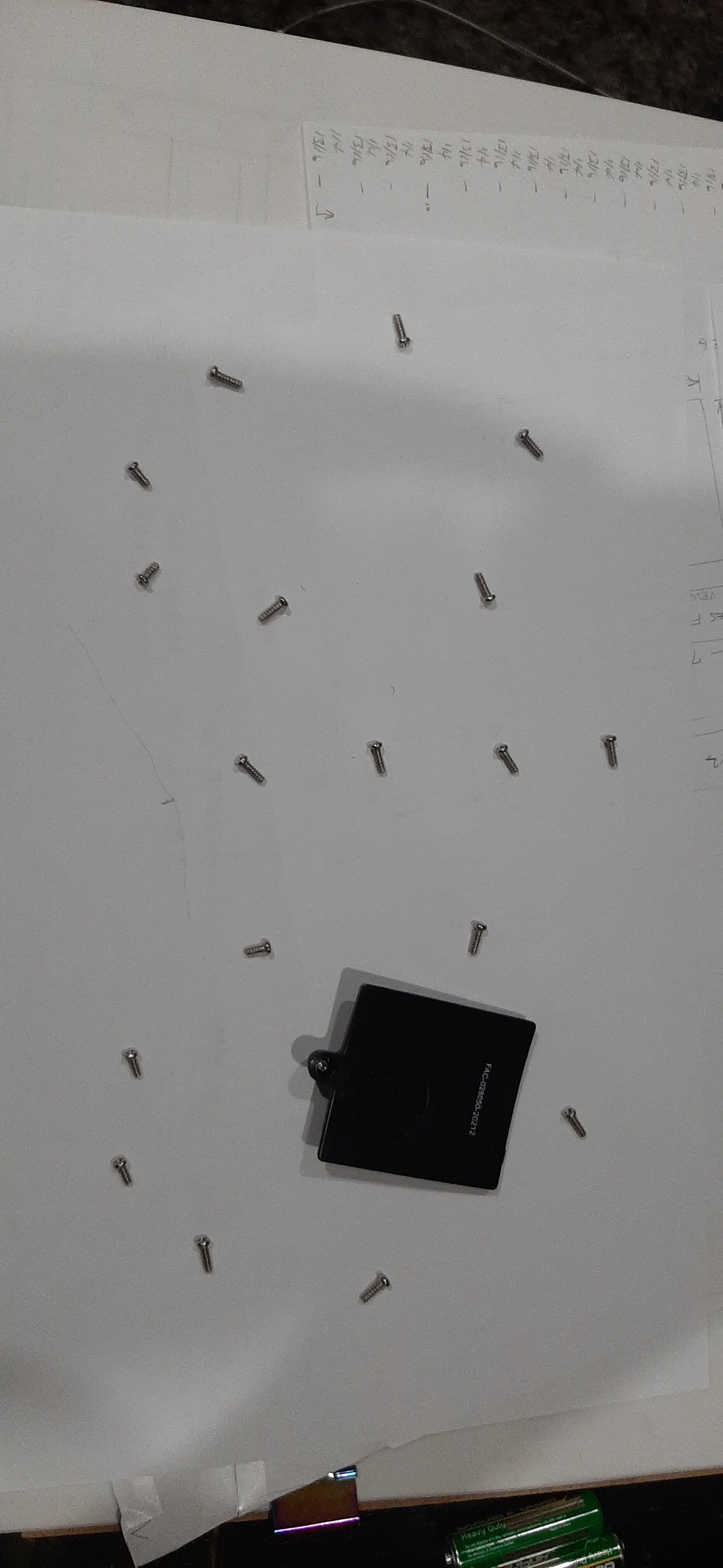

i began to partially diassemble the Galaxys Edge helmet for sanding and taping before paint.
I removed all the padding and the chin strap, then looked for all the screws, removing one at a time and making a screw map on a piece of paper until all the screws were removed. This is for re-assembly so i know where the longer screws go etc.
I removed the rubber edge roll, which has little loops attached so you cannot just pull it out.. I peeled back the side panel enough to pull out the edge roll and realized this interior is attached pretty well even without the screws, so i detached the microphone boom by pinching the clips and pulling the mic out of the side panel. I then left the interior attached for sanding, since i decided removal of the interior is not that important on this one.
I am leaving the interior panels alone at this time. I dont want to ruin whatever they have going on in there holding it in place. I will just tape off the edge of the interior so it doesnt get a bunch of overspray and work it with everything as-is.
I was going to remove the visor and paint the underside of the visor cover, but at this point i will just be bagging and taping the visor off so i dont get spray on it since removing that is not working well with the interior being possibly tack glued or have some clips holding the majority of it in place.
I wetsanded the markings off the helmet, since you can feel a bit of roughness when you touch the logos and emblems and fake chipping. This would probably show up if i were to leave them on an just prime the helmet.
I left the sides of the ridge largely alone, but did wear down the yellow stripe a bit.
I am leaving the heavy shading and grey pieces and the red sides, also i am taking a little off the front cap just to get the lines less noticeable.
I will be using a modeling technique with this one, where i am going to pre-shade the helmet before adding color. In order to do this, i will be adding chipping agent after a solid white coat is applied and wet sanded smooth to a semigloss finish. I will explain more as i go along.
enjoy!

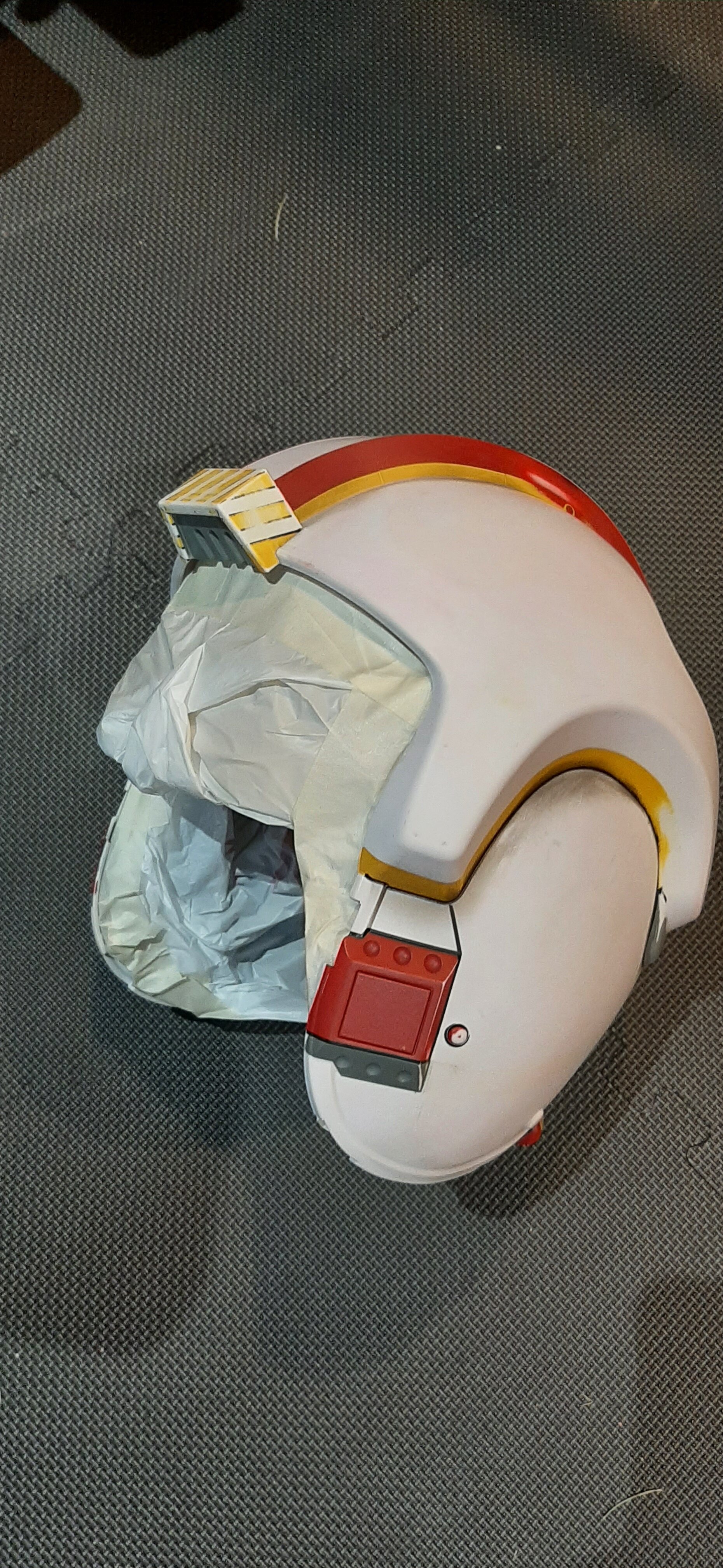

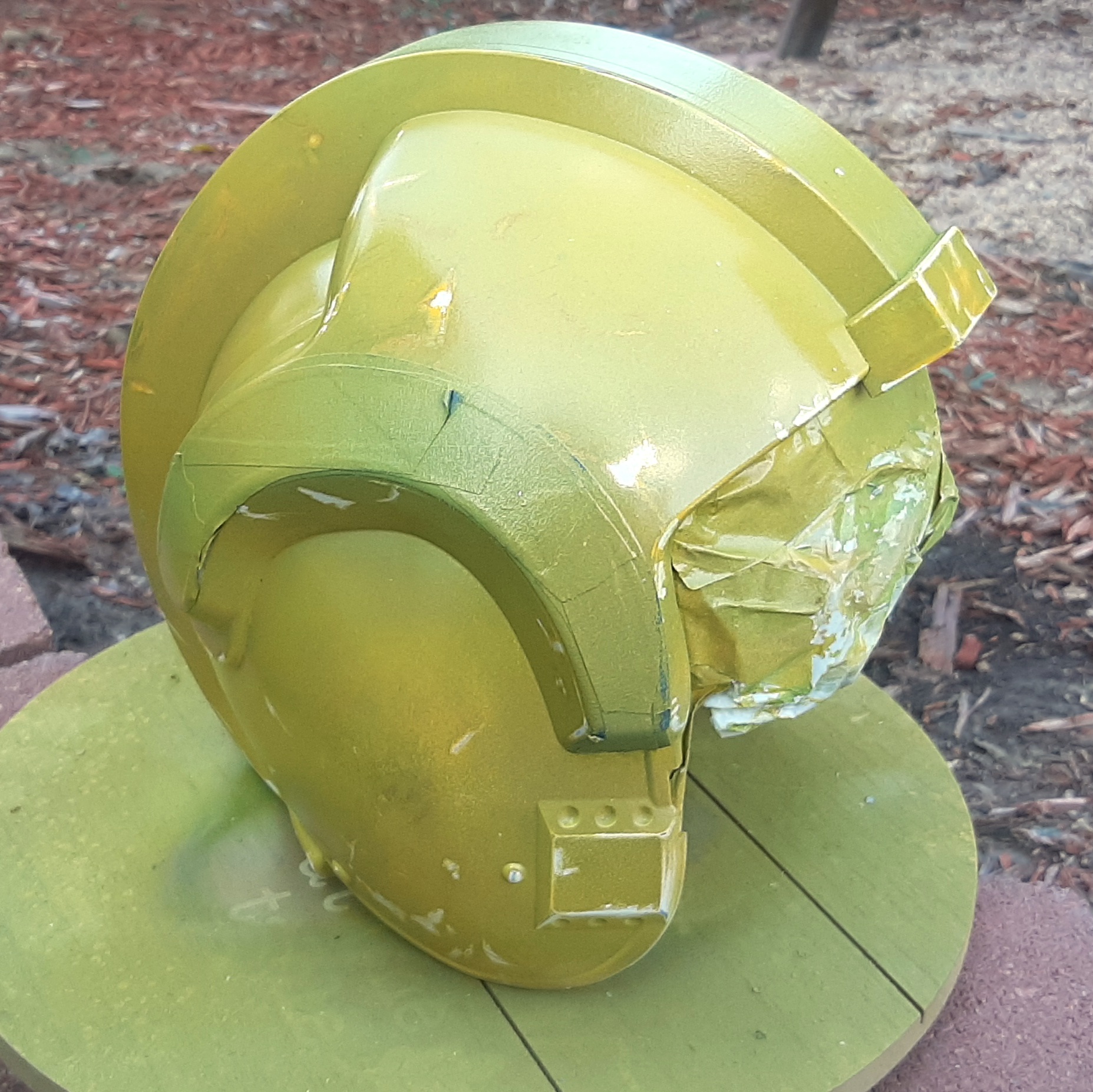

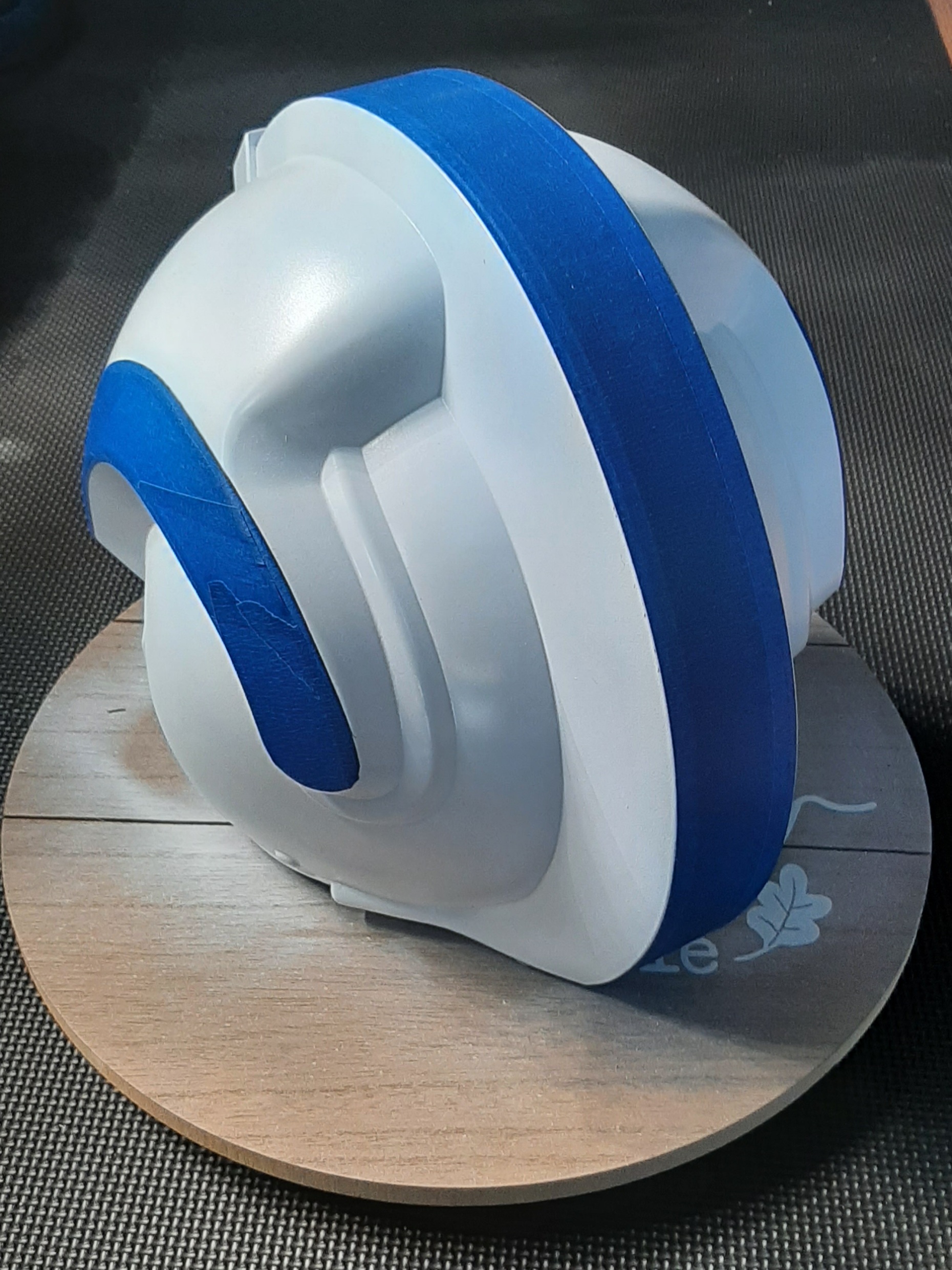

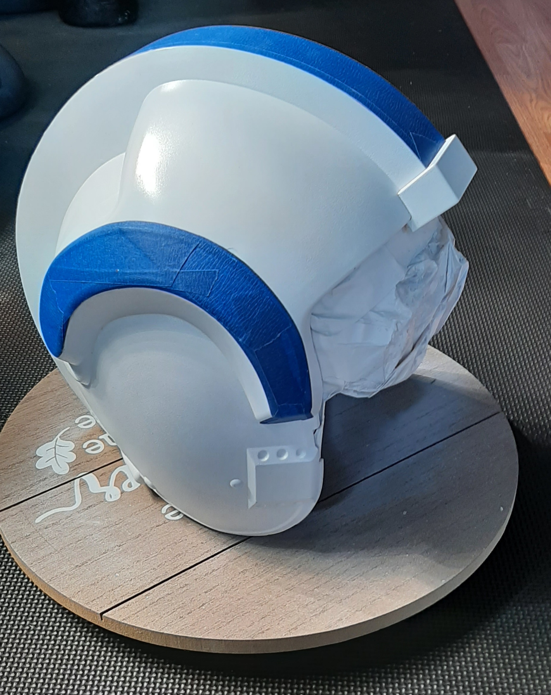

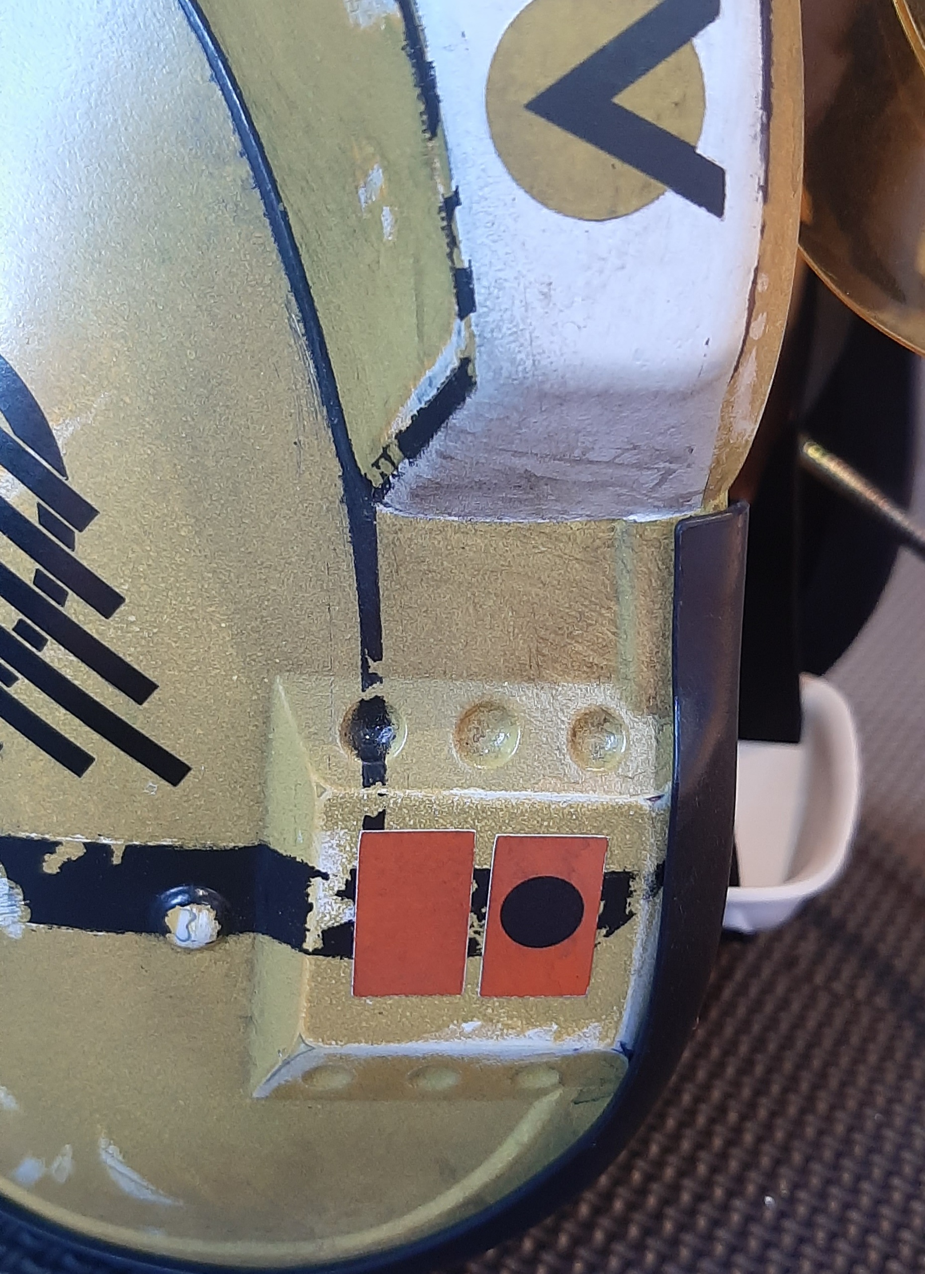

i have done a lot of work on this Galaxys Edge Luke... you cant tell it yet but i did a bit of priming, sanding, paint, more sanding, more paint, some gloss, more sanding, more paint... and now taping off the areas i want to remain white. next is the chipping agent and then color!

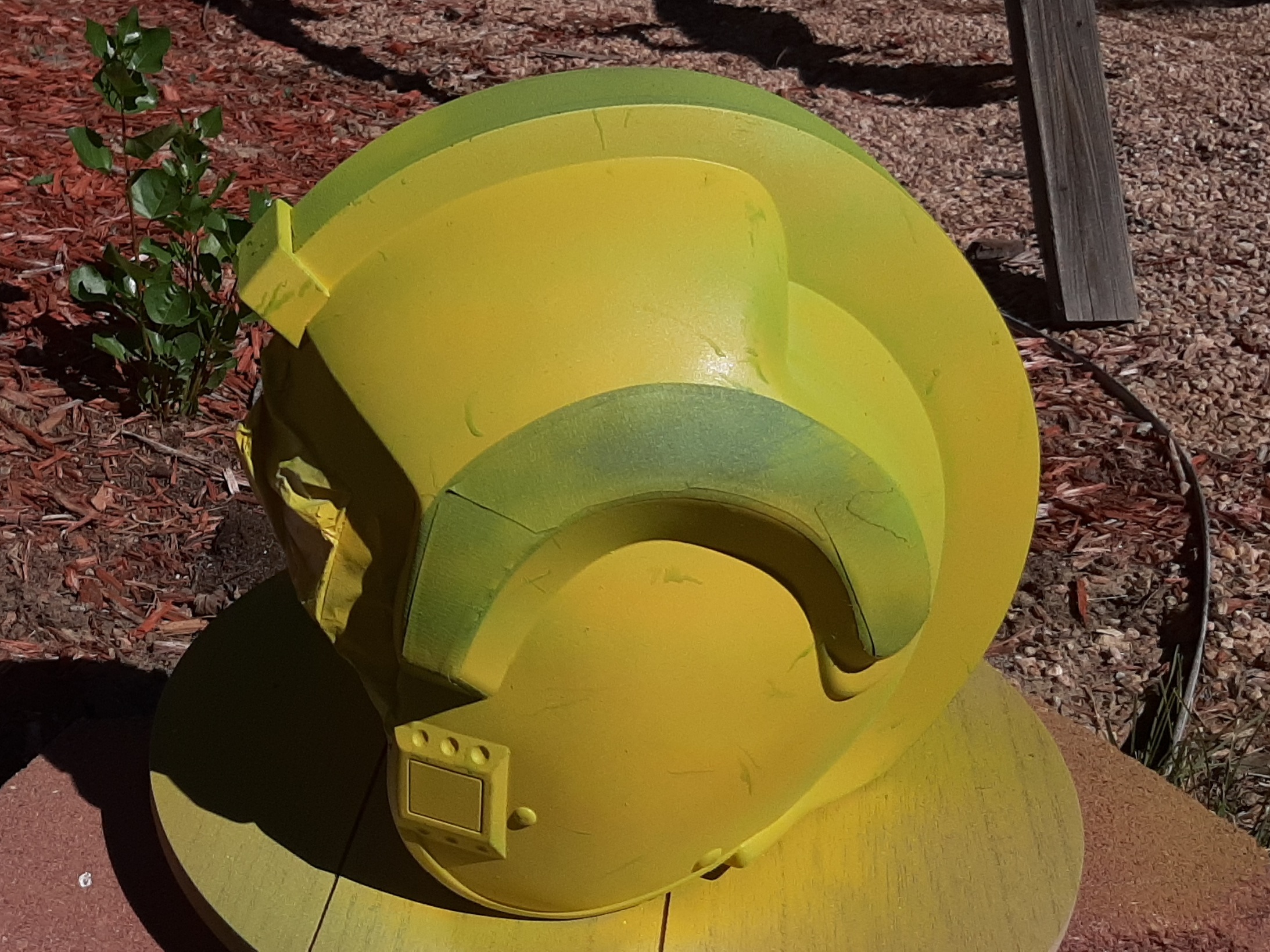

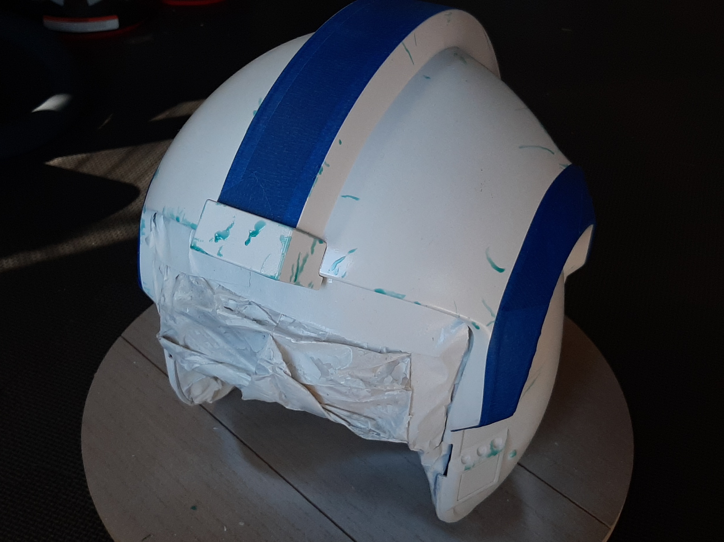

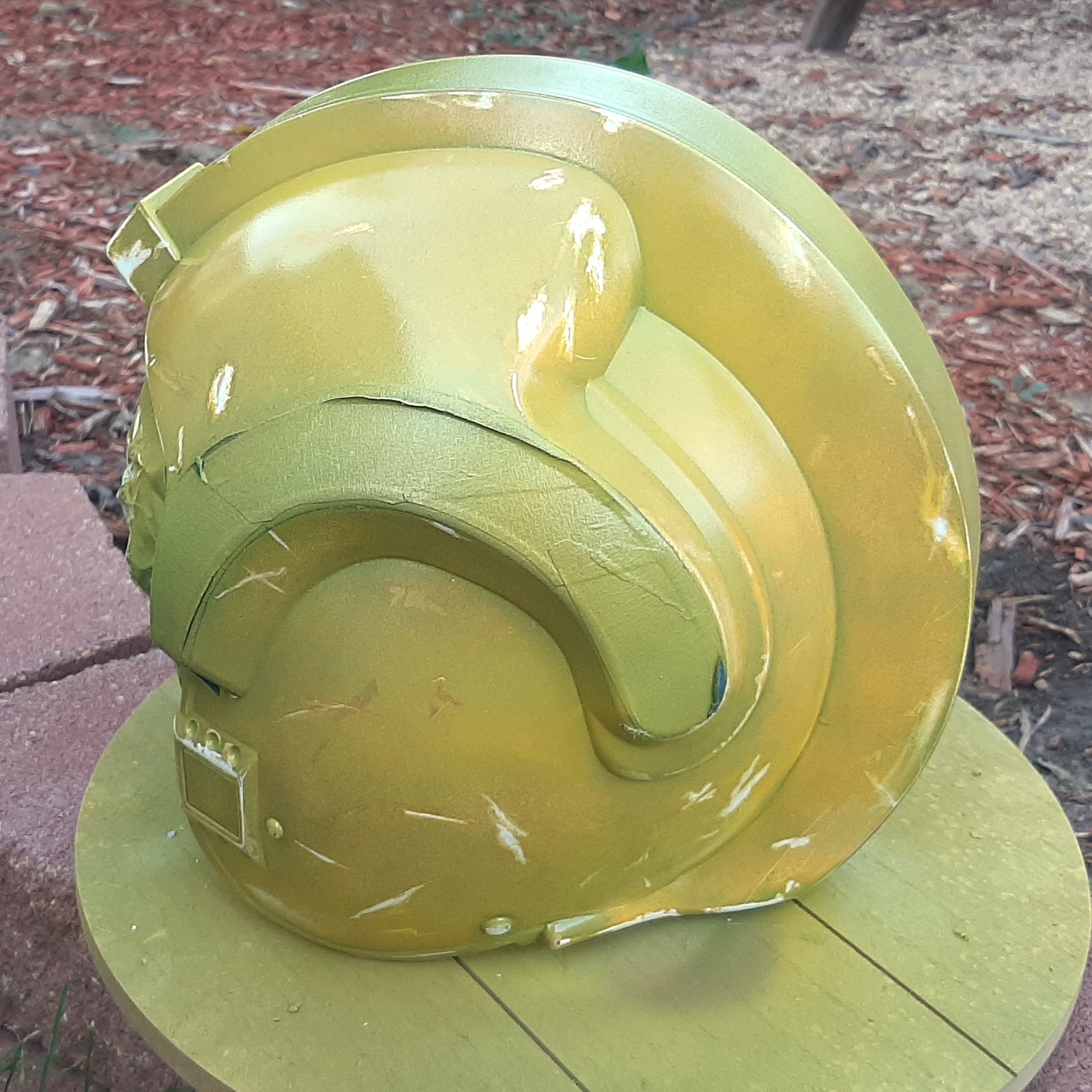

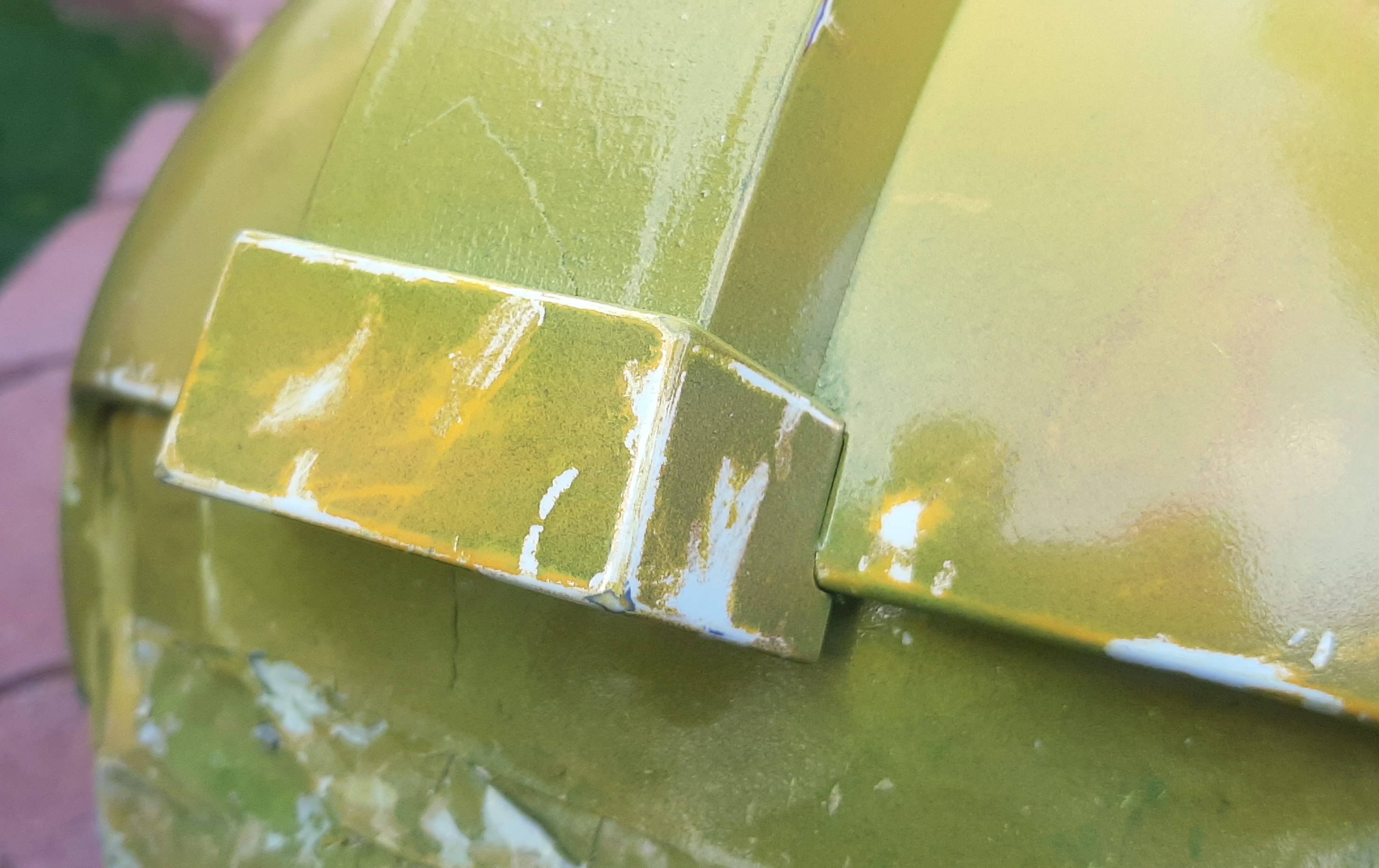

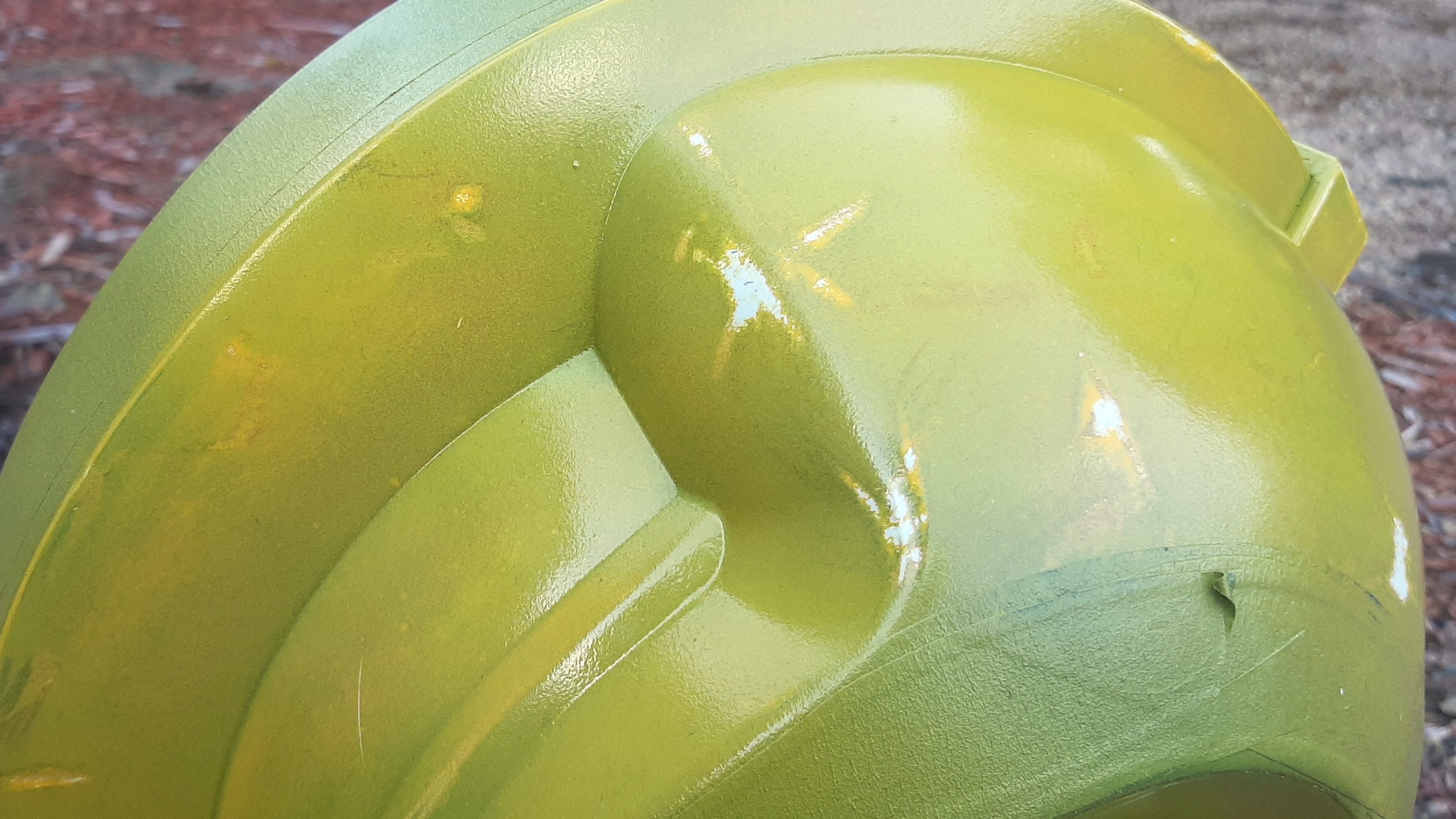

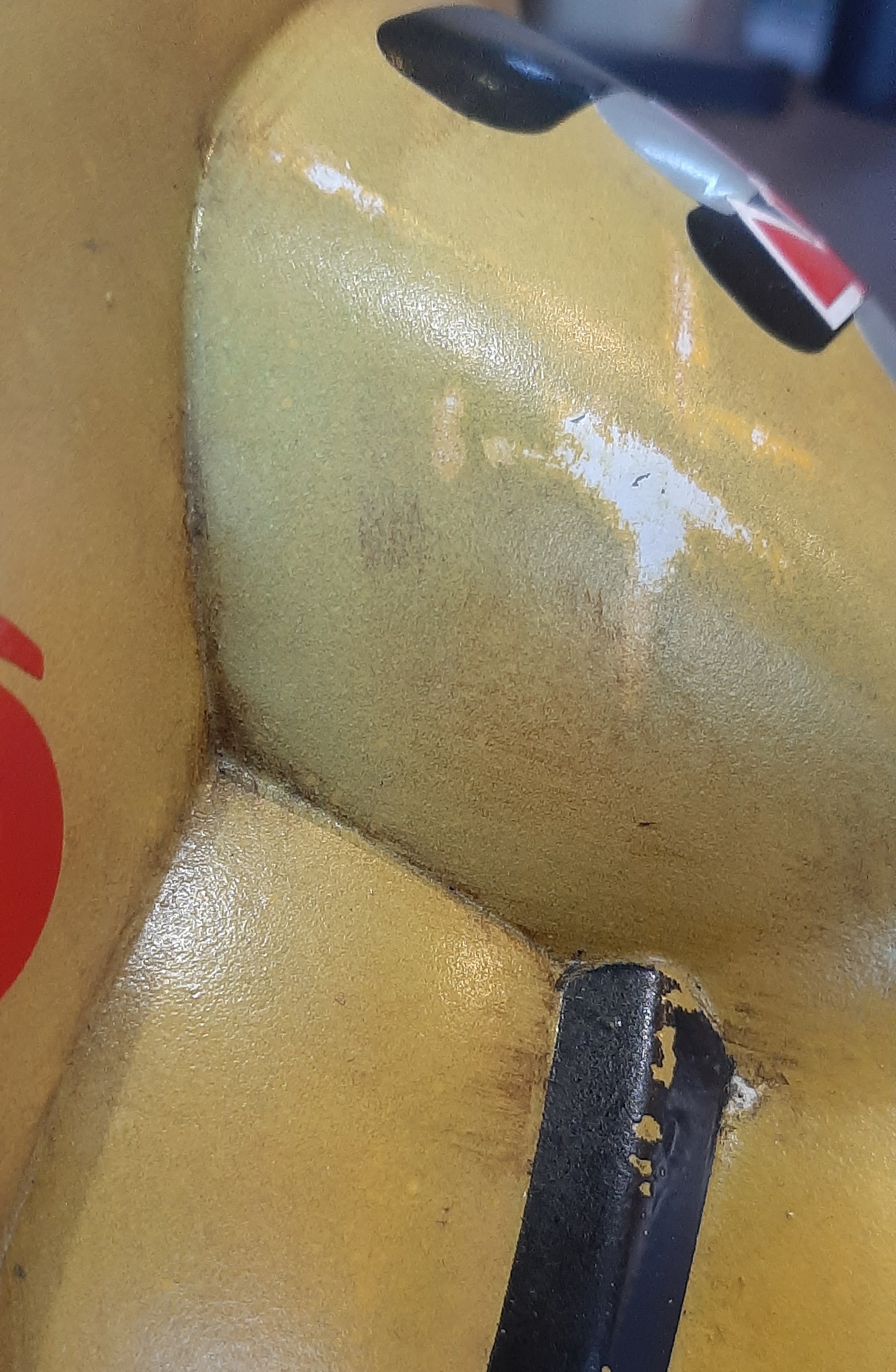

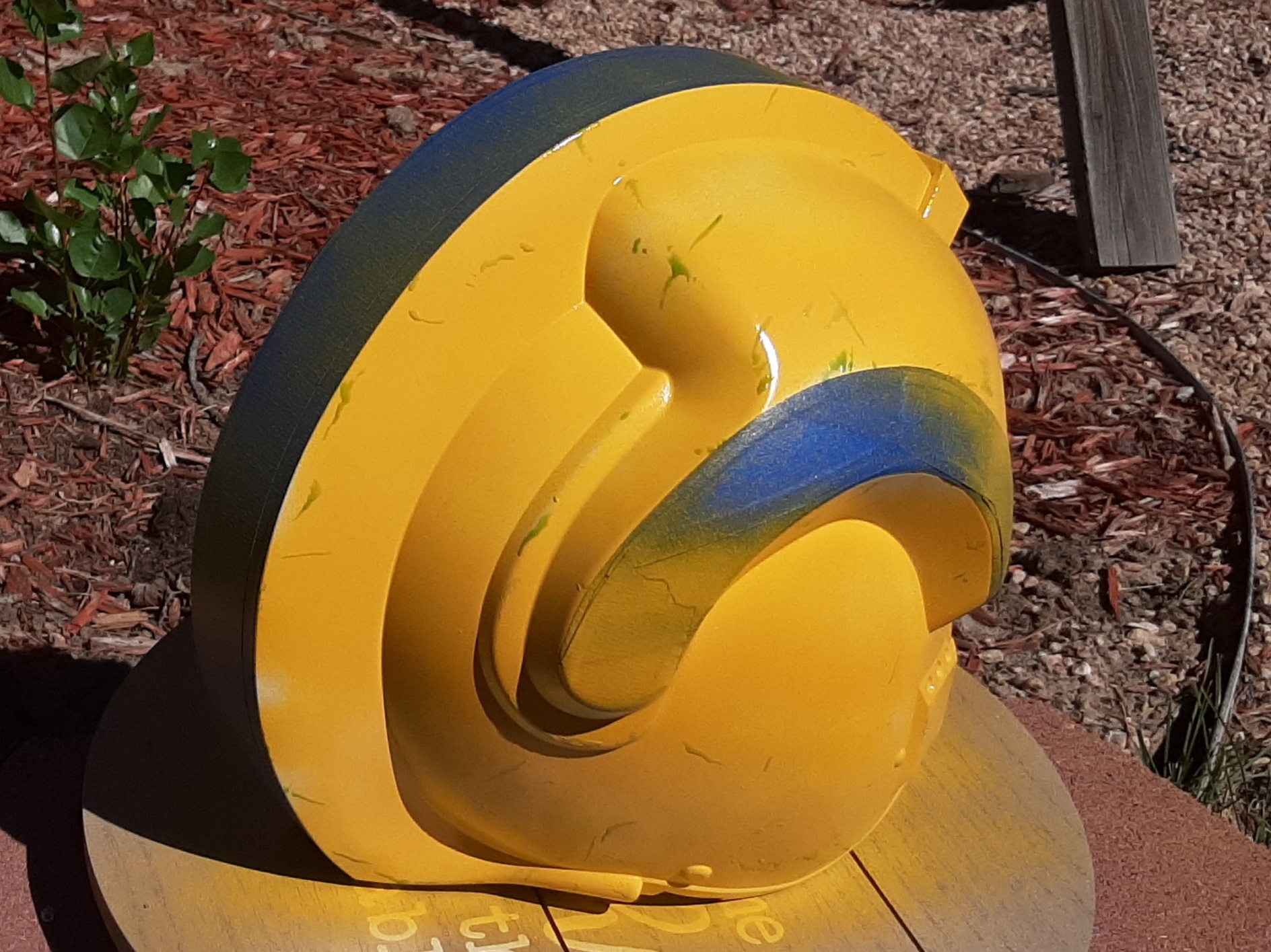

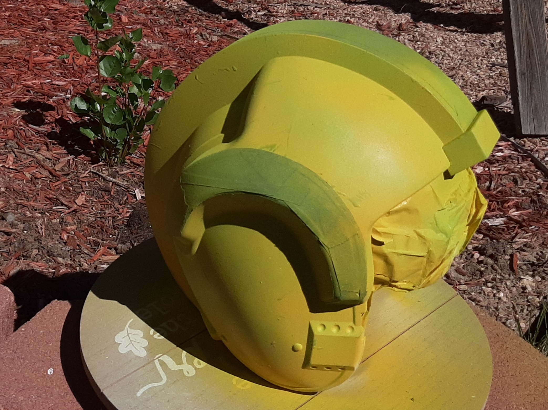

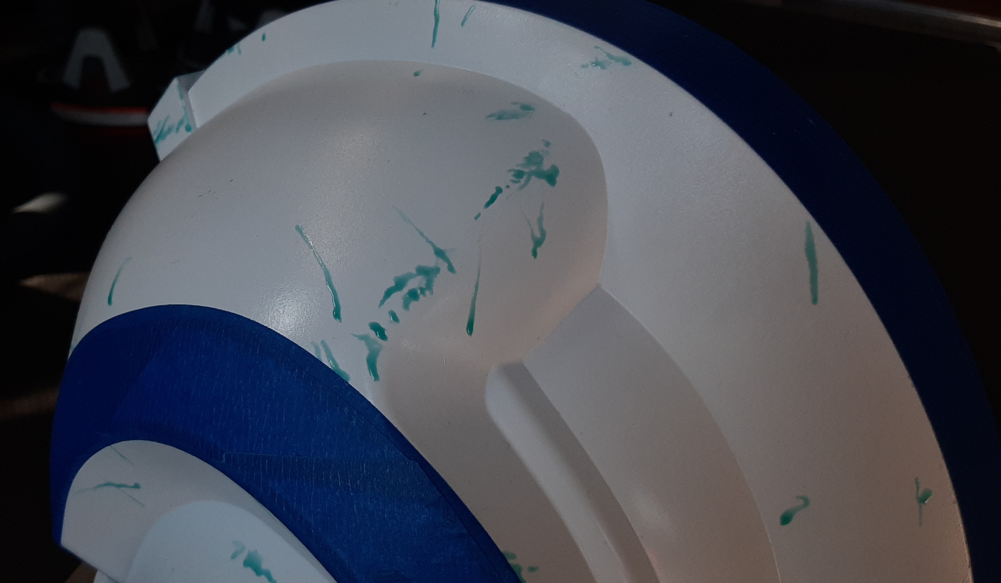

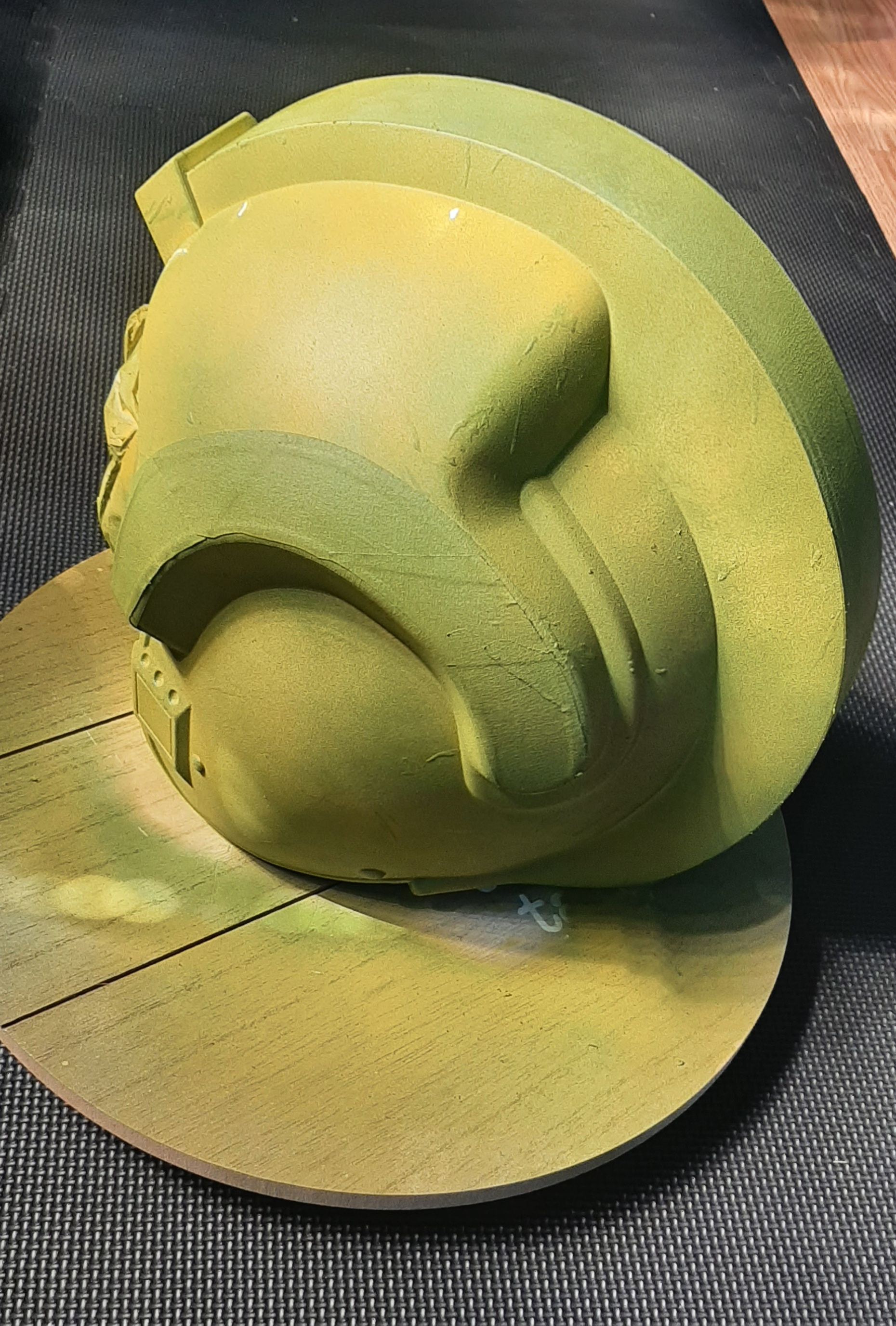

i made some progress on the Red Leader helmet.. i started by laying on some masking liquid to try to come close to the major scratches and paint chips. i left the finer ones to be done later when the helmet is closer to complete.

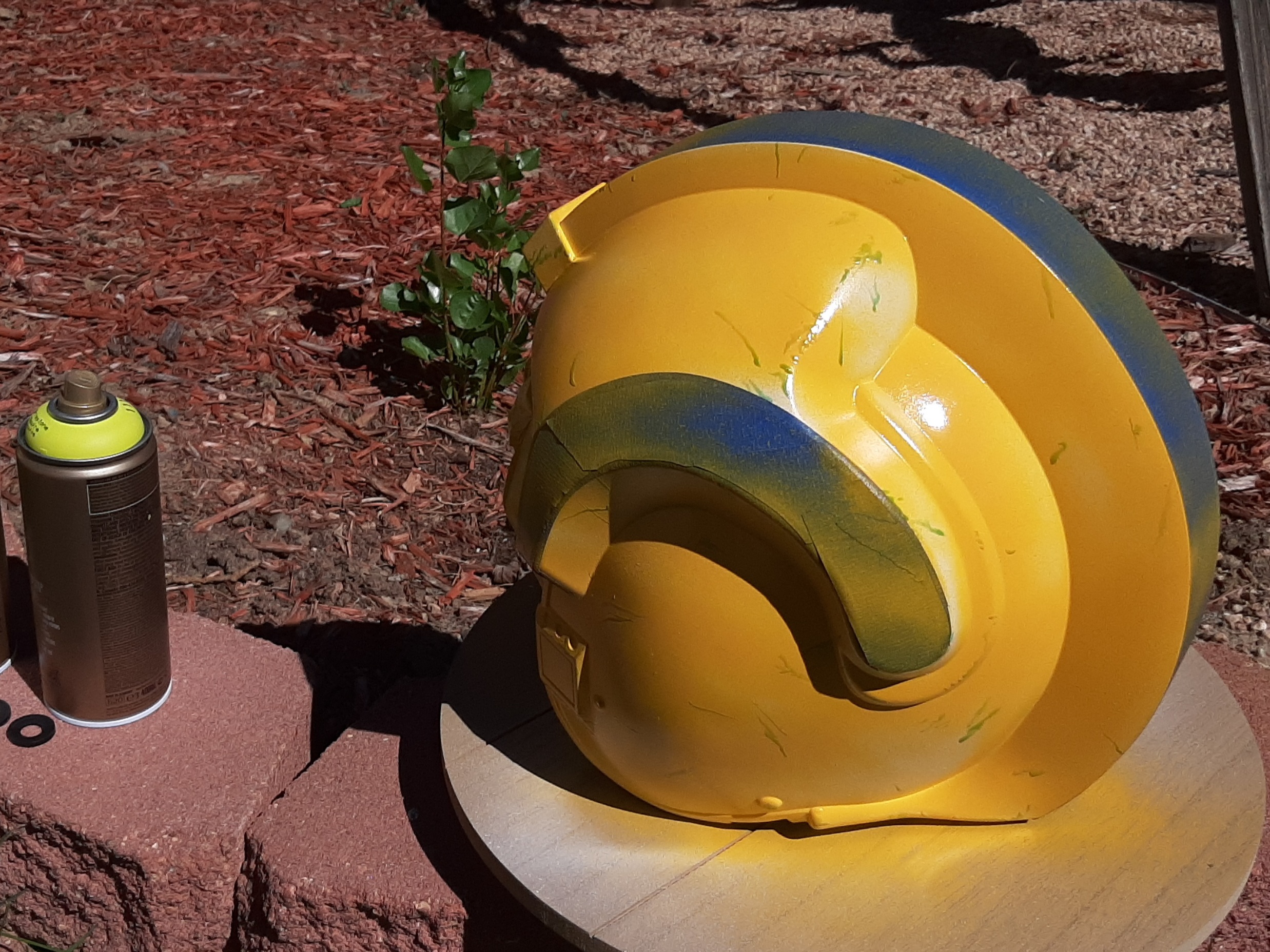

i layed down a light coat of krylon marigold which was covered in light coats of various Montana colors to try to get to a close, but darker yellow-greenish hue. this will lighten up and yellow up as i wet sand the color and remove the chipping mask and some of the montana color mix.
i have started to wet sand now with 800 grit as i dont want to remove too much color at once.. so far its still a bit too green for my taste but its getting closer. it will also ungreen itself as i add some washes and weathering passes later on in the build.

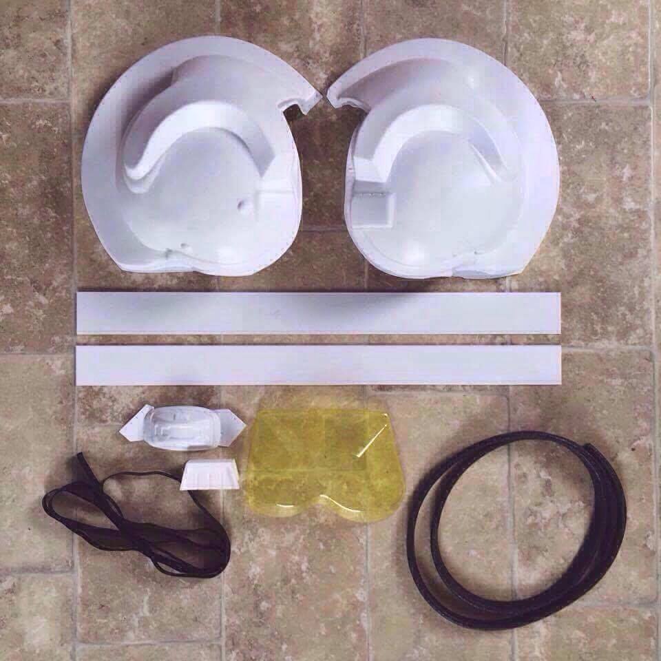

I built a Hephaestus Forge kit a few years ago. He's a local Albertan, but it was a nice kit with a good result. Some pics of my friend's build, plus the instructions and yours truly in the mustache I grew for the occasion. My wife and I did the foam earmuffs ourselves, some mattress foam covered over with pleather.
never heard of that one. looks pretty good. no visor?
It came with a visor...I guess they don't show it in the instructional pdf, but it was there. I replace the chin strap material, made the liner/muffs myself with my wife's help, and made my own mic.

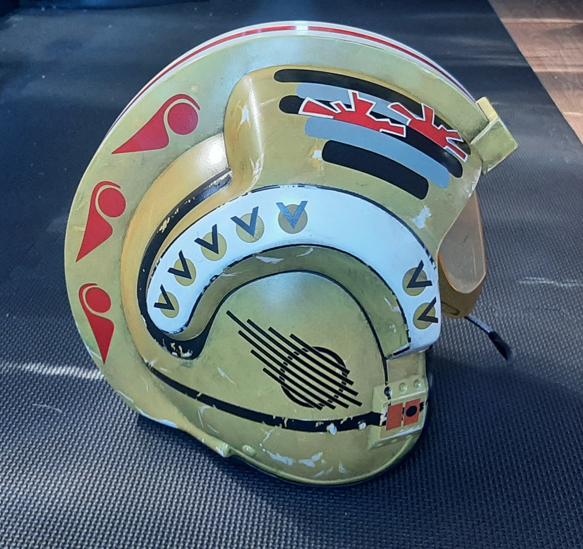

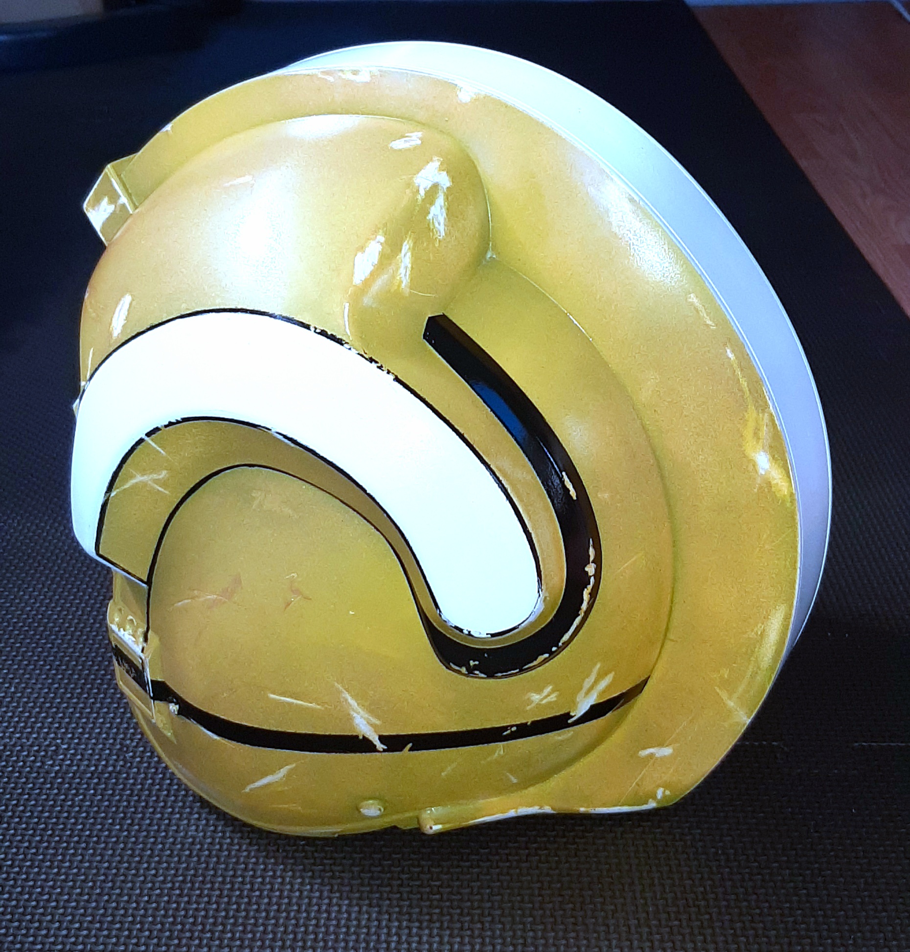

heres my current status on my Red Leader repaint.
i have done several coats of different paint colors and finished up with 2 thin coats of semi-gloss before the removal of tape and the retaping for black lines..
I will say these photos are a touch too green.. the actual color is a little more yellow than this, and slightly darker.
will keep you updated

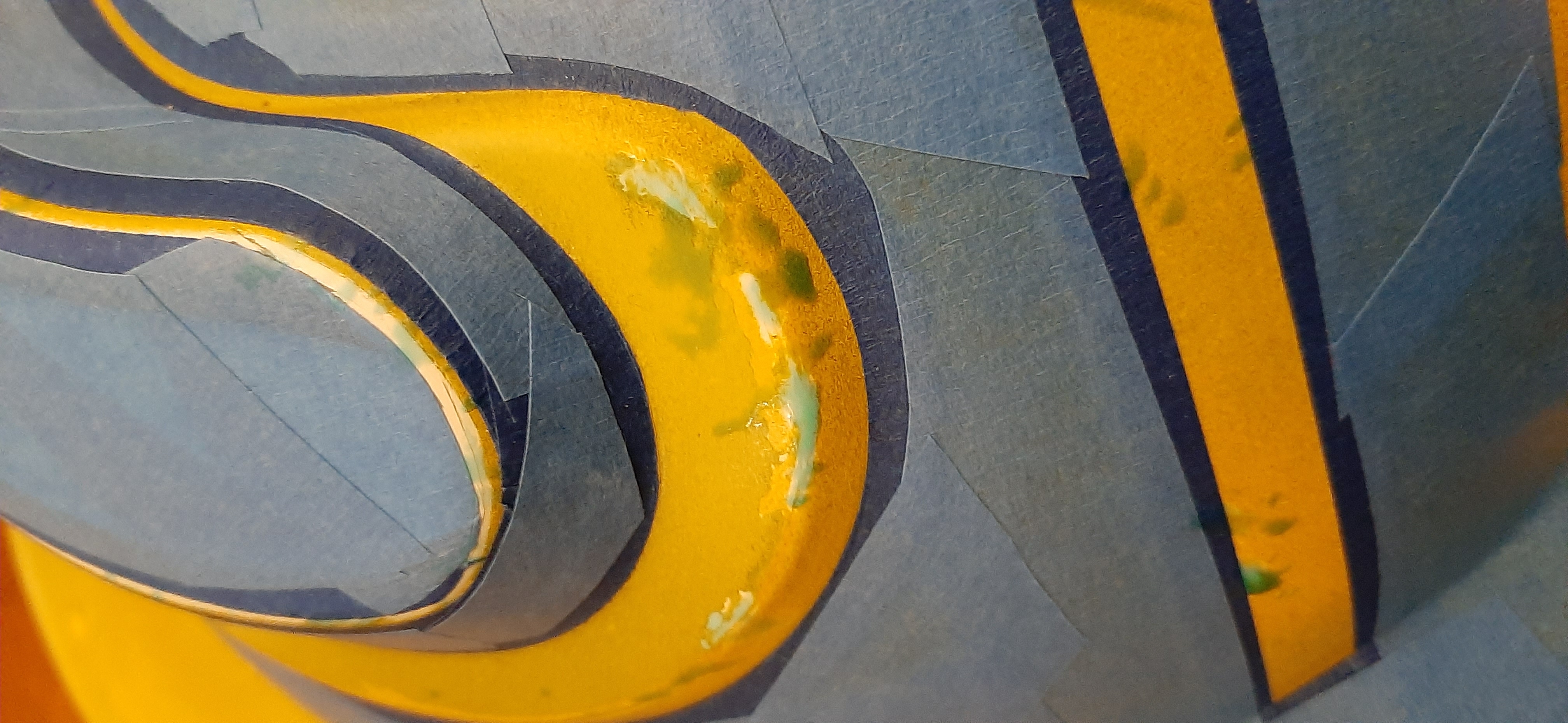

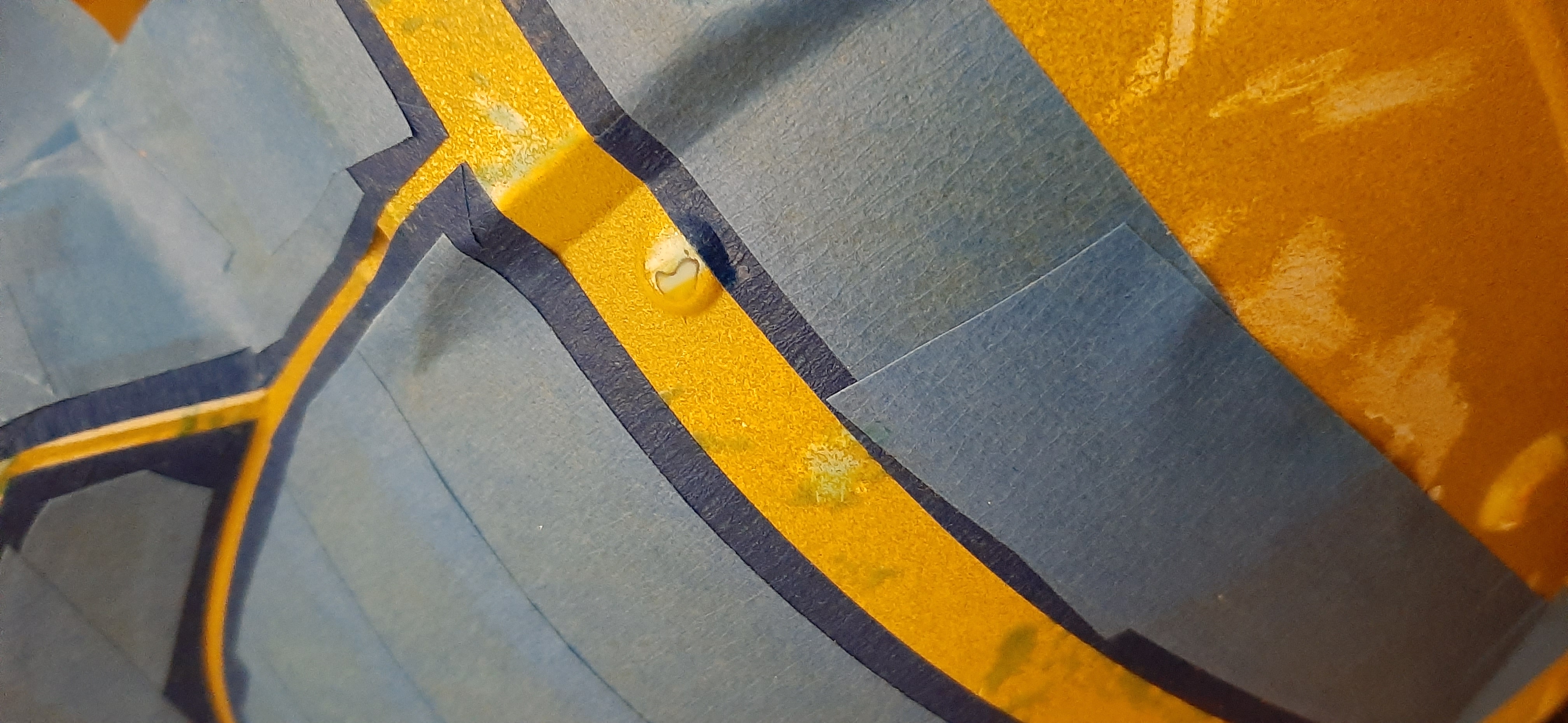

added some gloss coats, removed tape, and light wet sanding... before adding tape again for black accents.. still need to bag it and prep for chipping before the black passes.
Yes i did decide to mask off the black areas and not hand paint all the lines.. i just dont like the look of most of the hand painted Red Leaders that i see.. i think the lines are too thick and not straight at all for my preference.
more to come!

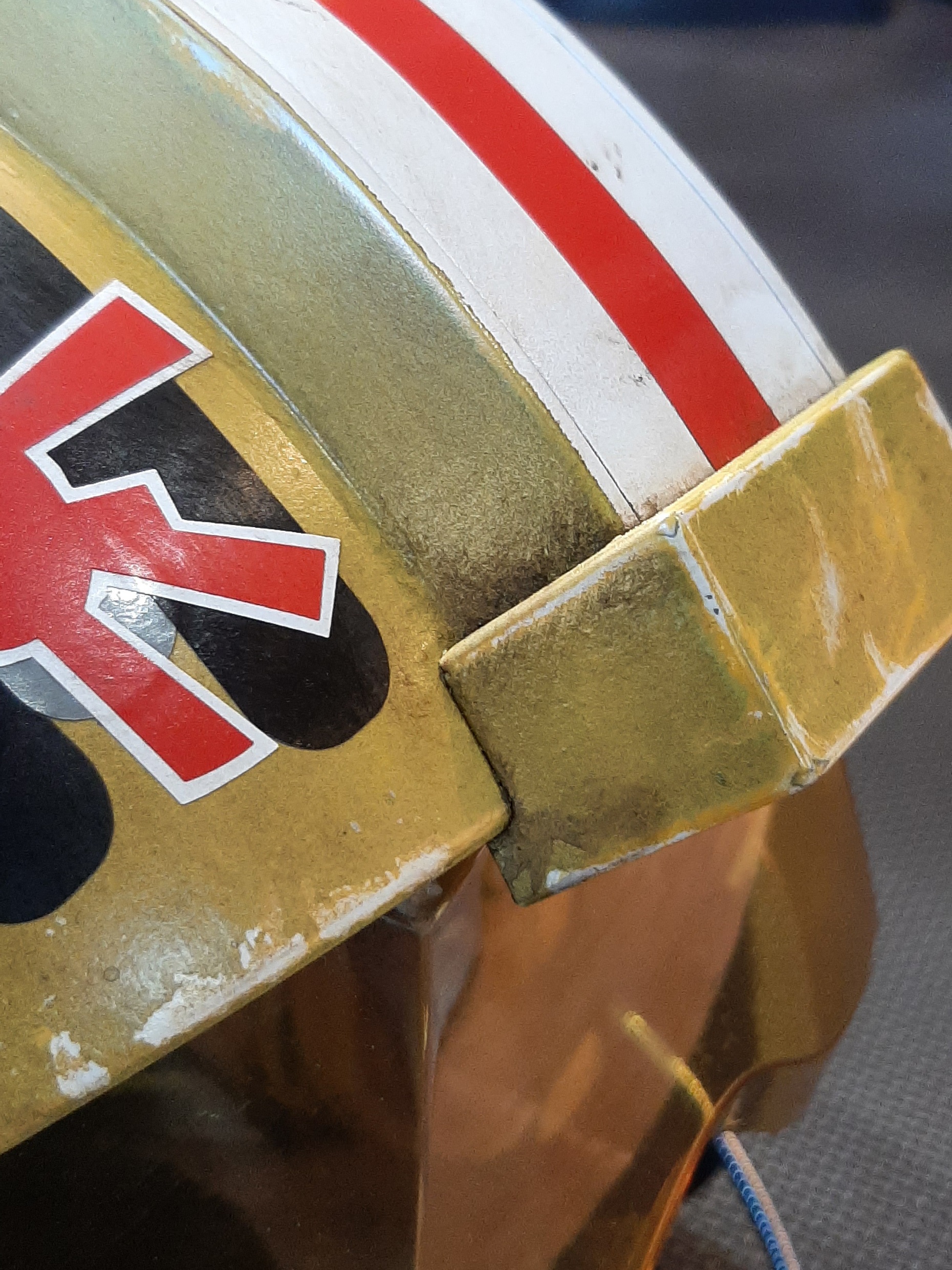

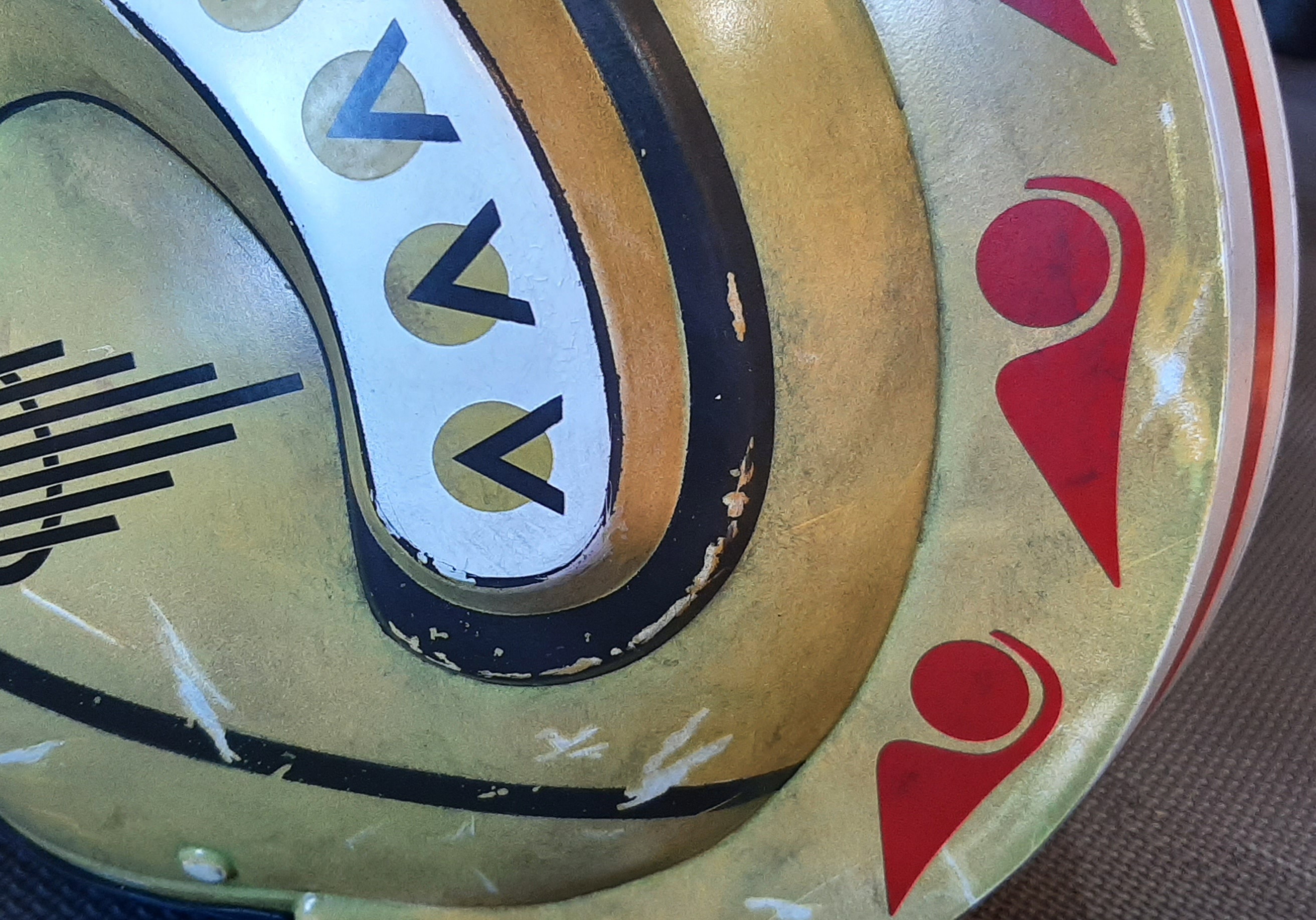

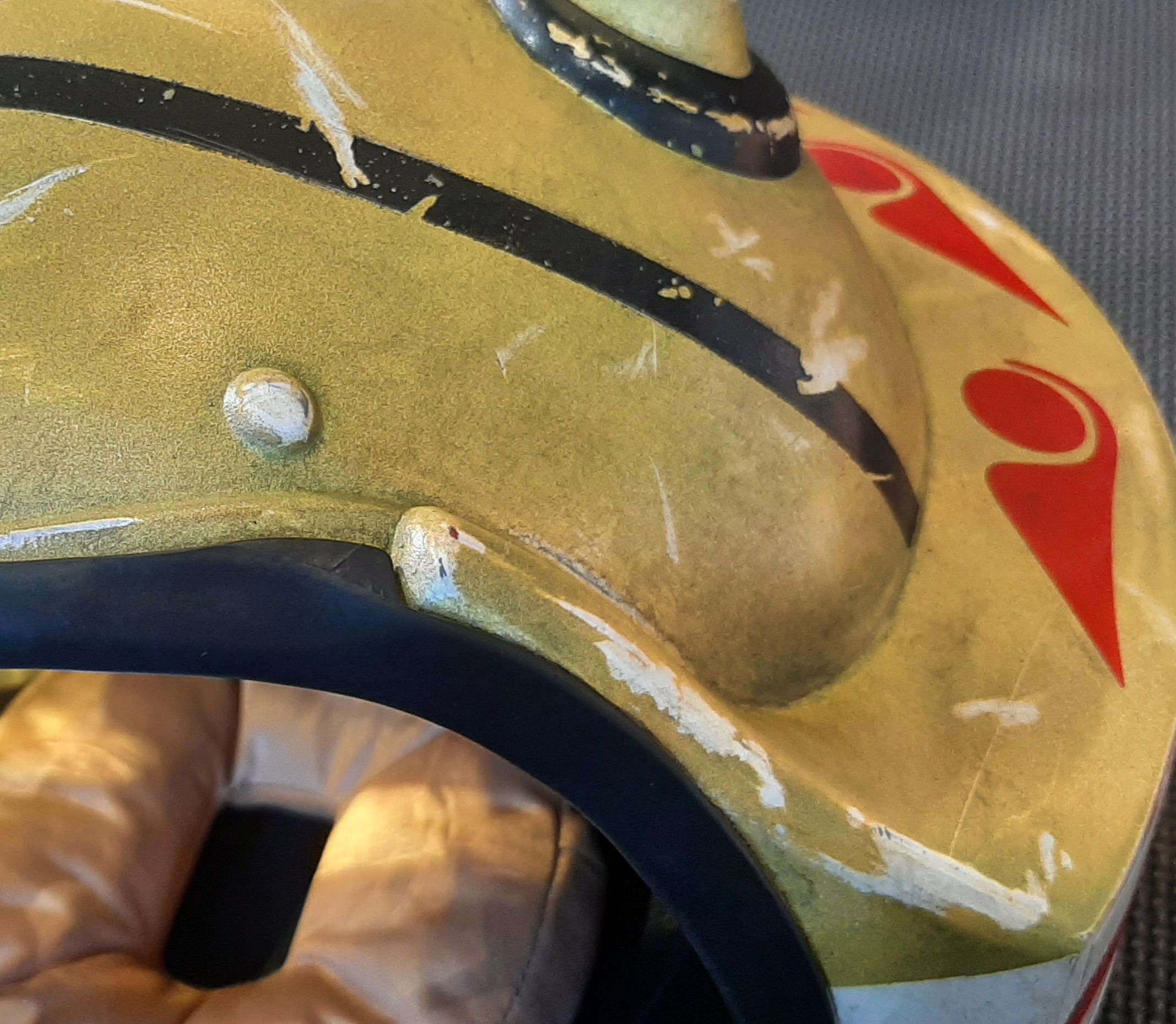

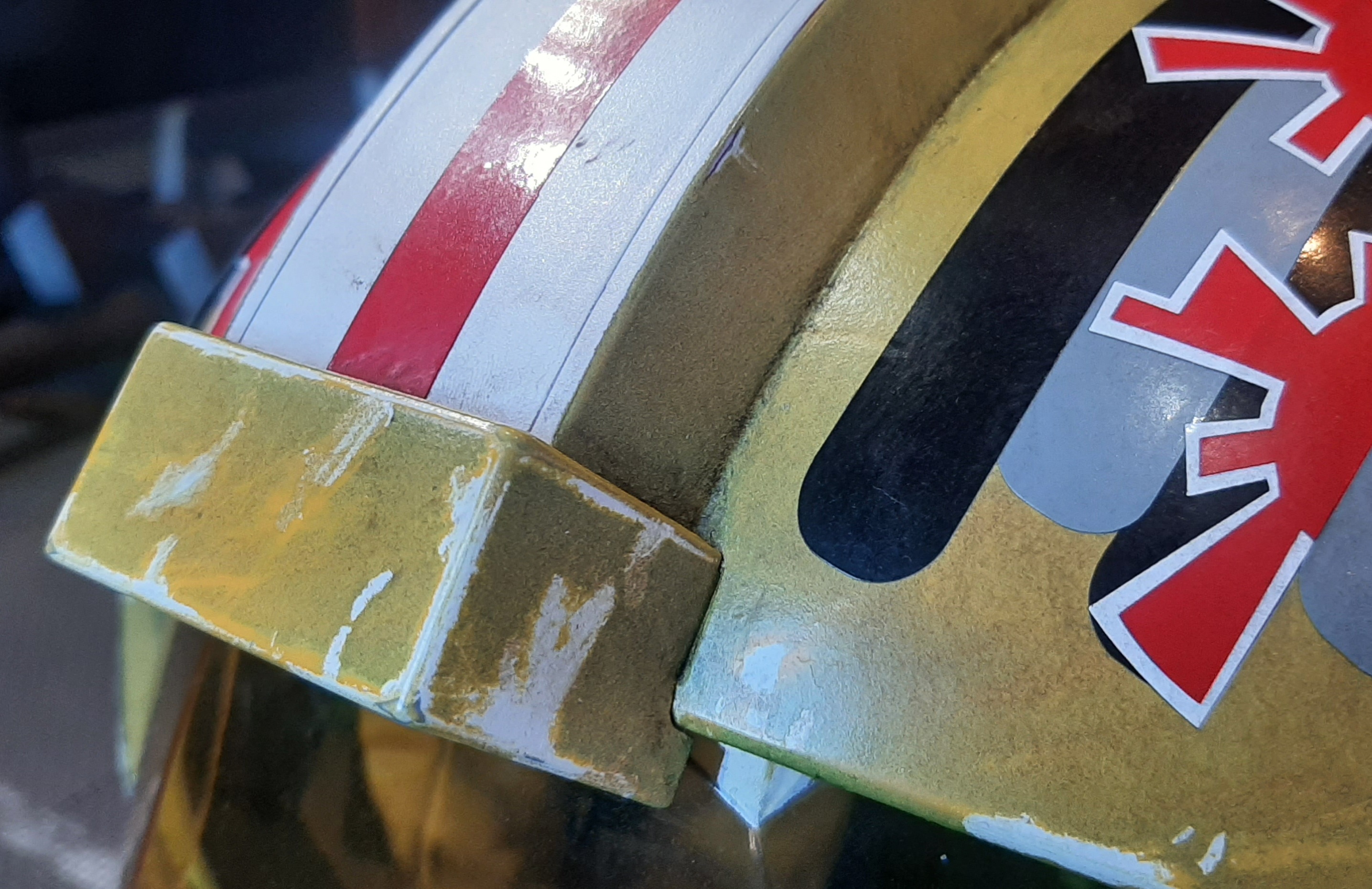

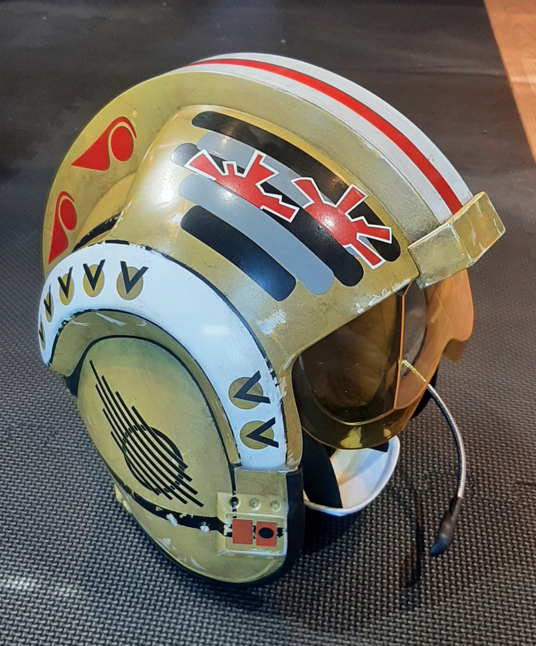

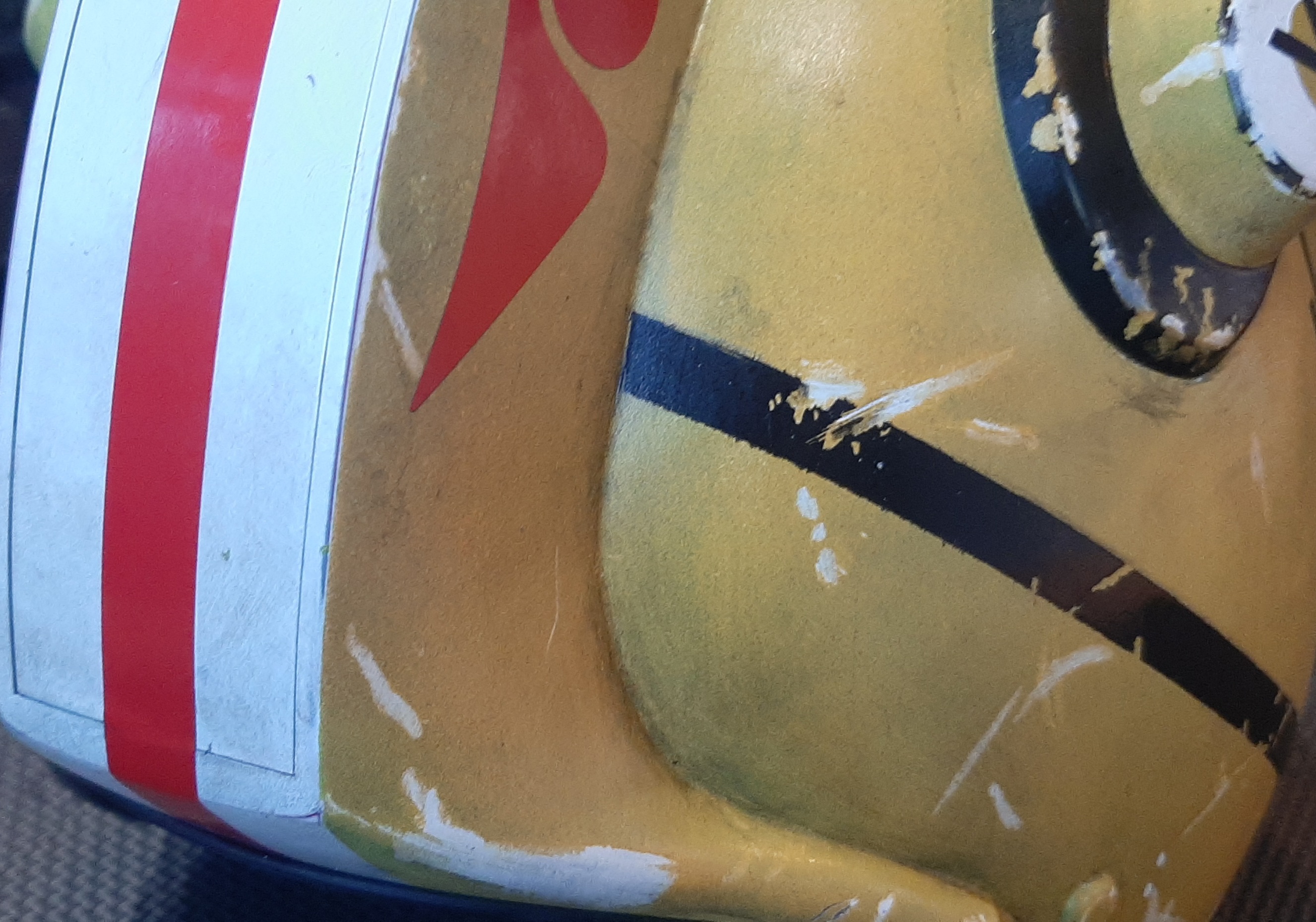

decals added.. again, from two different dealers.. then light gloss coat applied and the helmet was weathered with several passes of water soluble oil paint in a few colors.
i didn't want to get this one terribly dirty so i left it somewhat cleaner than other props. It is a bit dirtier than the photos show..
i haven't had a chance to do a final scratch pass yet but the weathering is completed.
Closeups are included in attachments below.
enjoy my new Disney Galaxys Edge Luke repaint to Red Leader!
