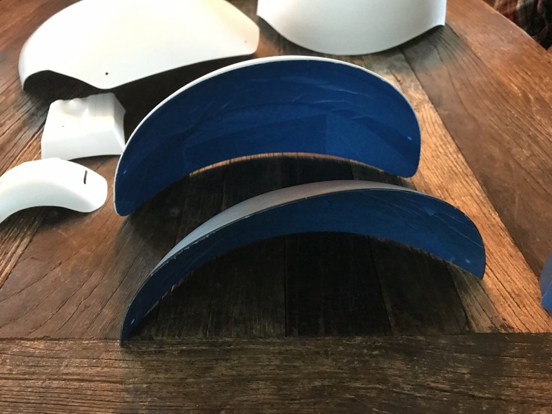

I had a little time to work on this and made some progress with the pre visor and the cut out the tinted visor and got it all attached.
Pre Visor aligned and centered
Rough tinted lean visor piece I received
It's pretty thick
Traced out the cuts
And pre visor and tinted visor attached to the main helmet
