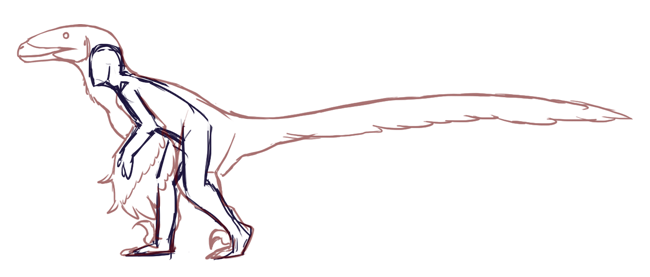

Ah, i knew i should just draw a picture:
As you can see, my hands will be occupied with being hands XD One of my coworkers happens to know of a local maker space I might be able to tap into for resources regarding my mechanical questions, so that part of things may essentially be taken care of! I might also contact one of my local libraries, which not only has a maker space but should be able to direct me to others which might be a bit closer to where I live. So, more things to look into, but I feel like I have a direction to go in.

Build the string system into the hard hat situation, so it can be operated by opening and closing your jaw. Unless you already have something you plan to use your jaw movement for. Just a random thought.
Btw: if you plan to be in that position for long, you need to think about back support. You want to take as much strain off your back and hips as possible.
ArtisticThingem
Yeah, the jaw will be operated by my jaw, so, that's not an option. I emailed the maker lab at the local library about my magnet idea as well, but they didn't actually address it, just gave me other suggestions that... aren't what I'm looking for either. ._.;
And, yeah, I'm concerned about that too of course--I don't want to hurt myself trying to have fun! So some kind of back brace and maybe exercises to help my endurance, and I'll definitely have a handler or two with me in case I get into trouble. It's also why I'm not going for a fully horizontal pose, but more of a birdlike angle that won't be quite so severe.
