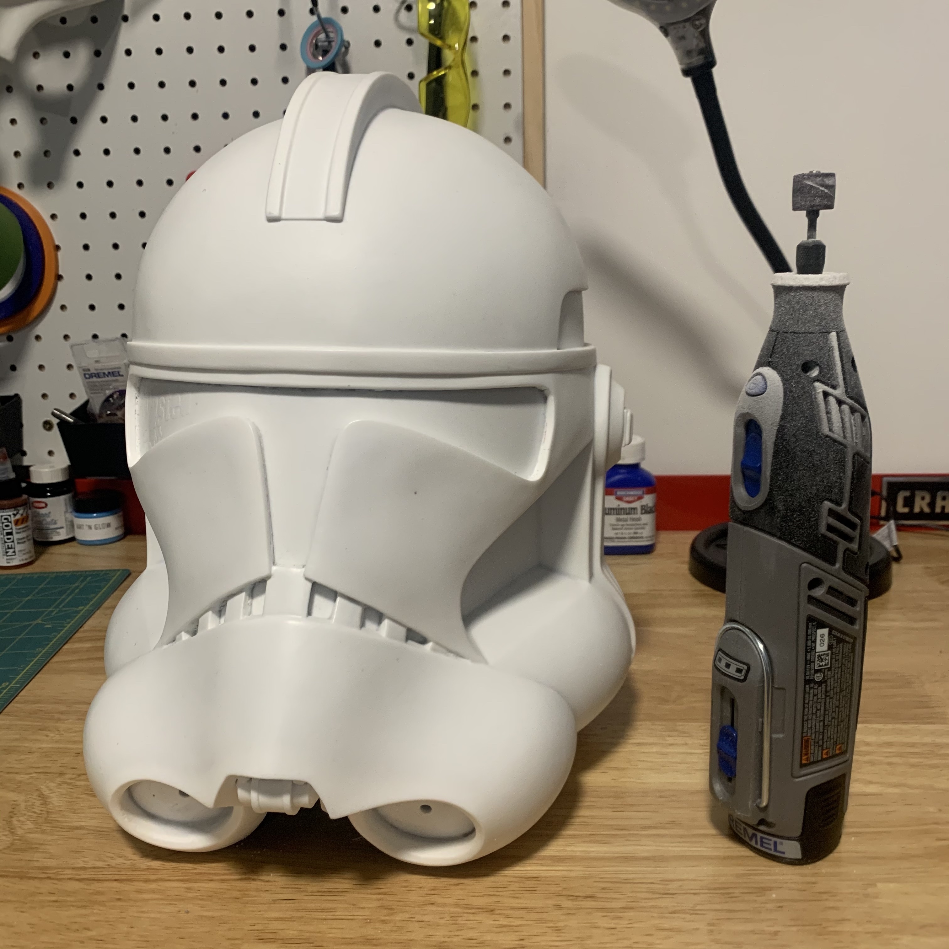

The raw cast looked like this:

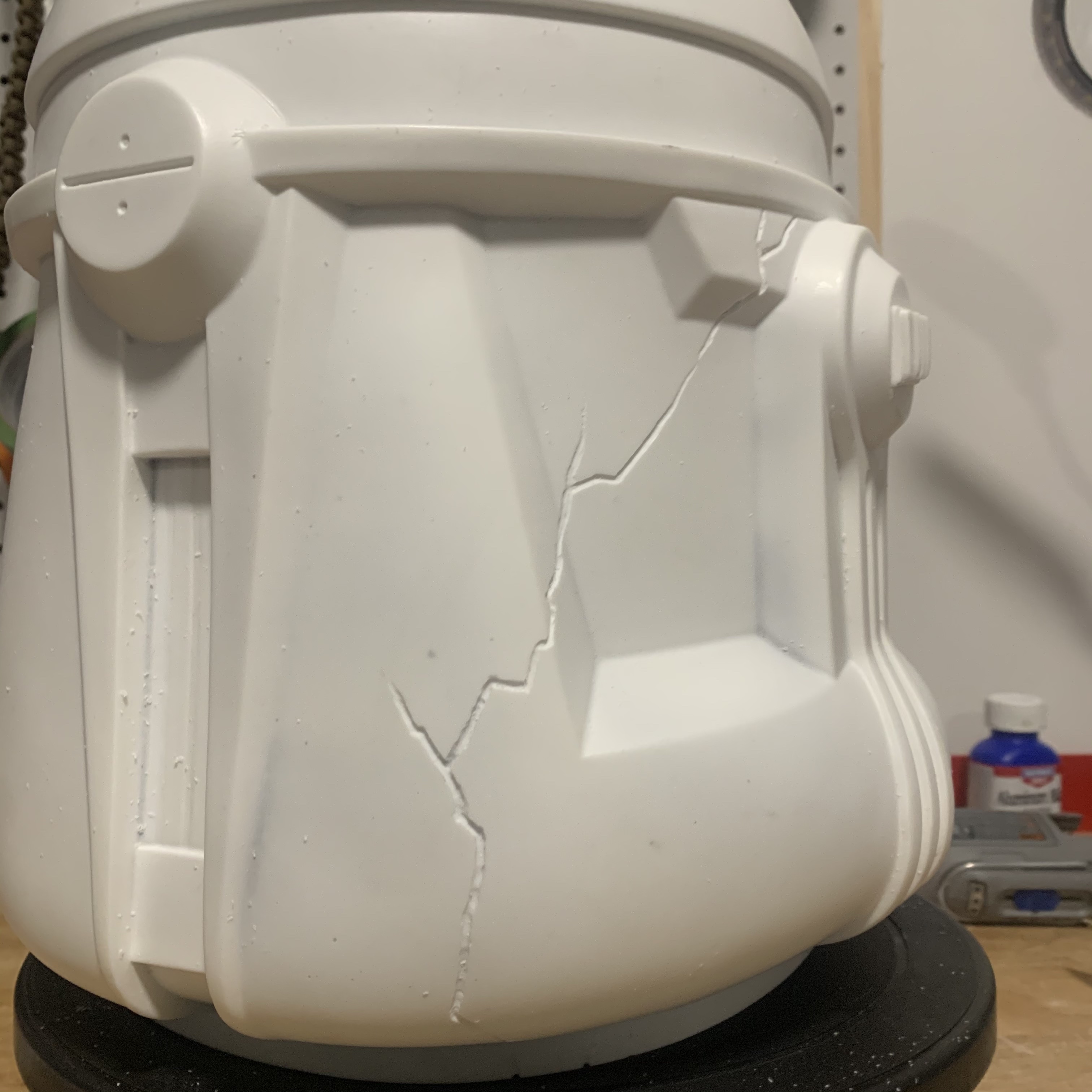

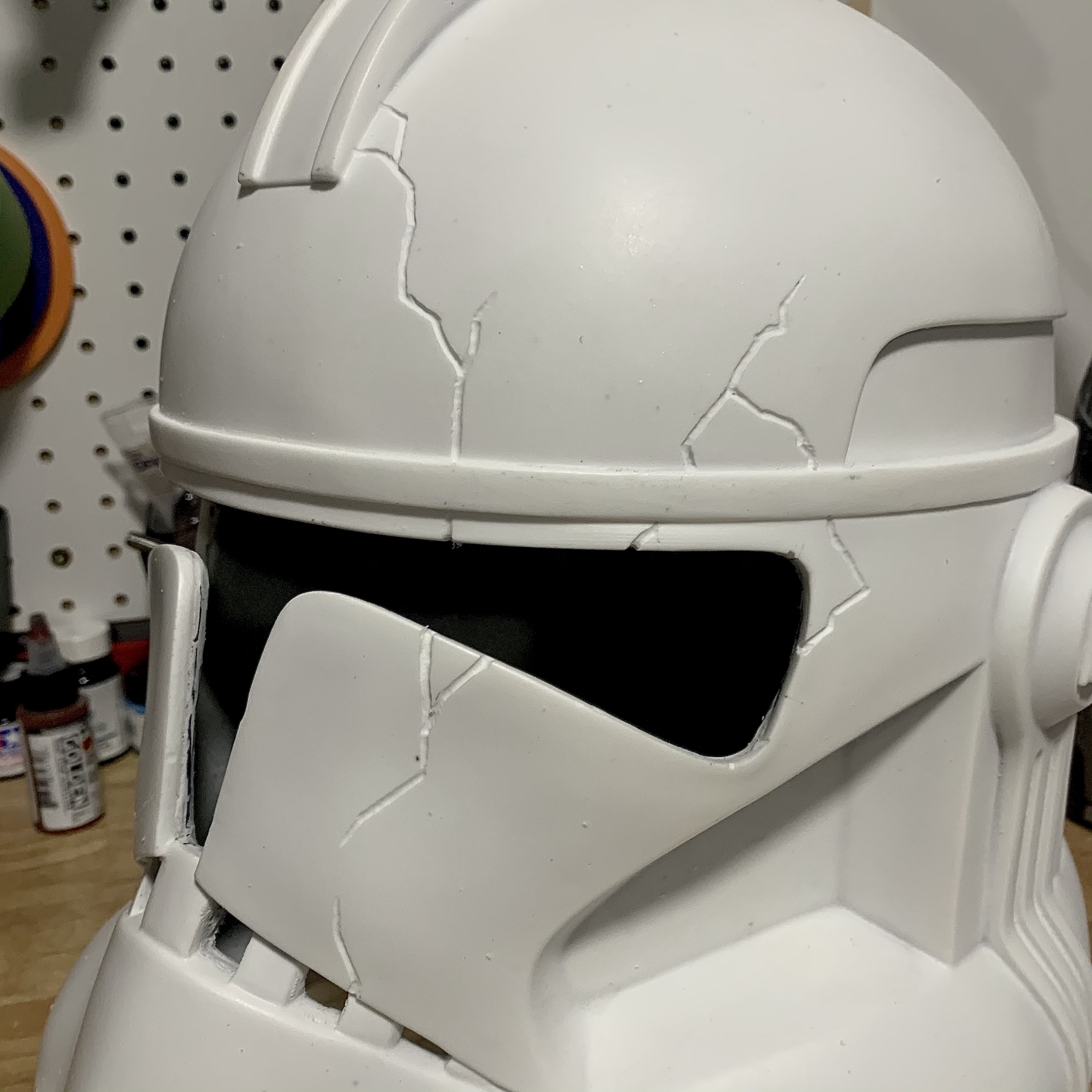

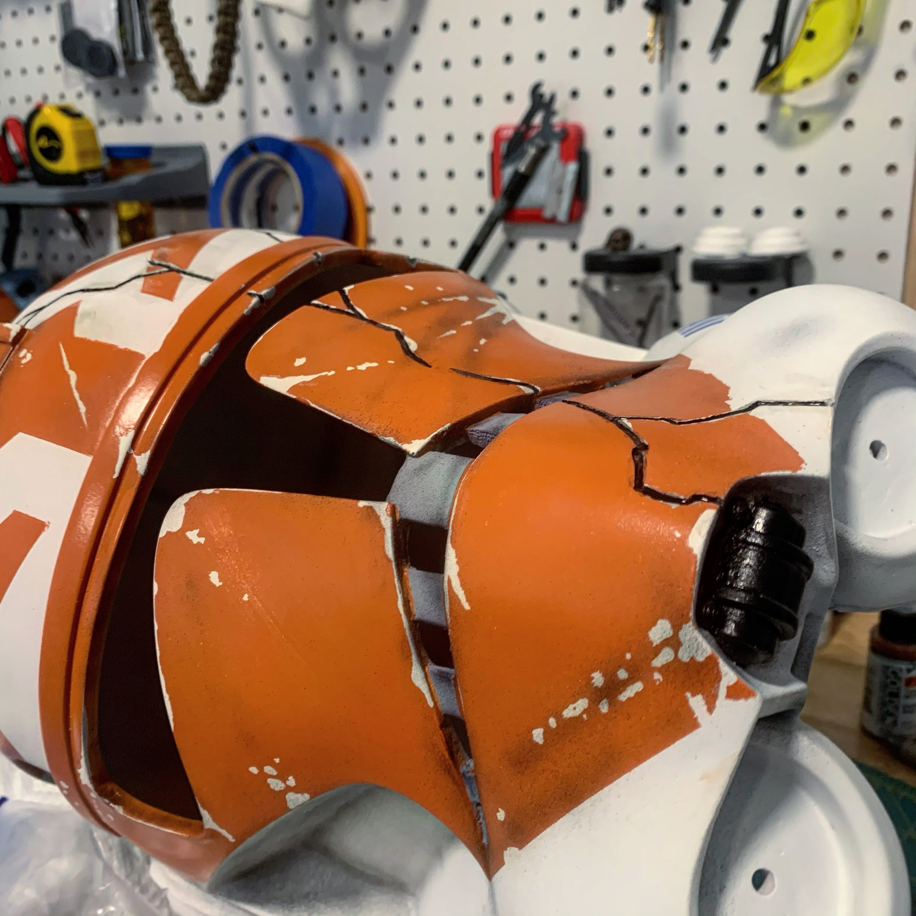

After removing the visor area, teeth holes and cleaning up the neck, it was time to start in on the carving for this build. I used a Dremel with a couple different sized engraving bits. For cracks... PLAN them out. You cannot put it back once you carve it out, without having to fill and sand. So, use a pencil and plan it. Carve about 1/16" to 1/8" based on your material. You want it to look substantial without actually weakening your helmet. The weathering will sell it. In my mind, the brow ring and mohawk are separate pieces so the cracks do not continue onto them (they go under).

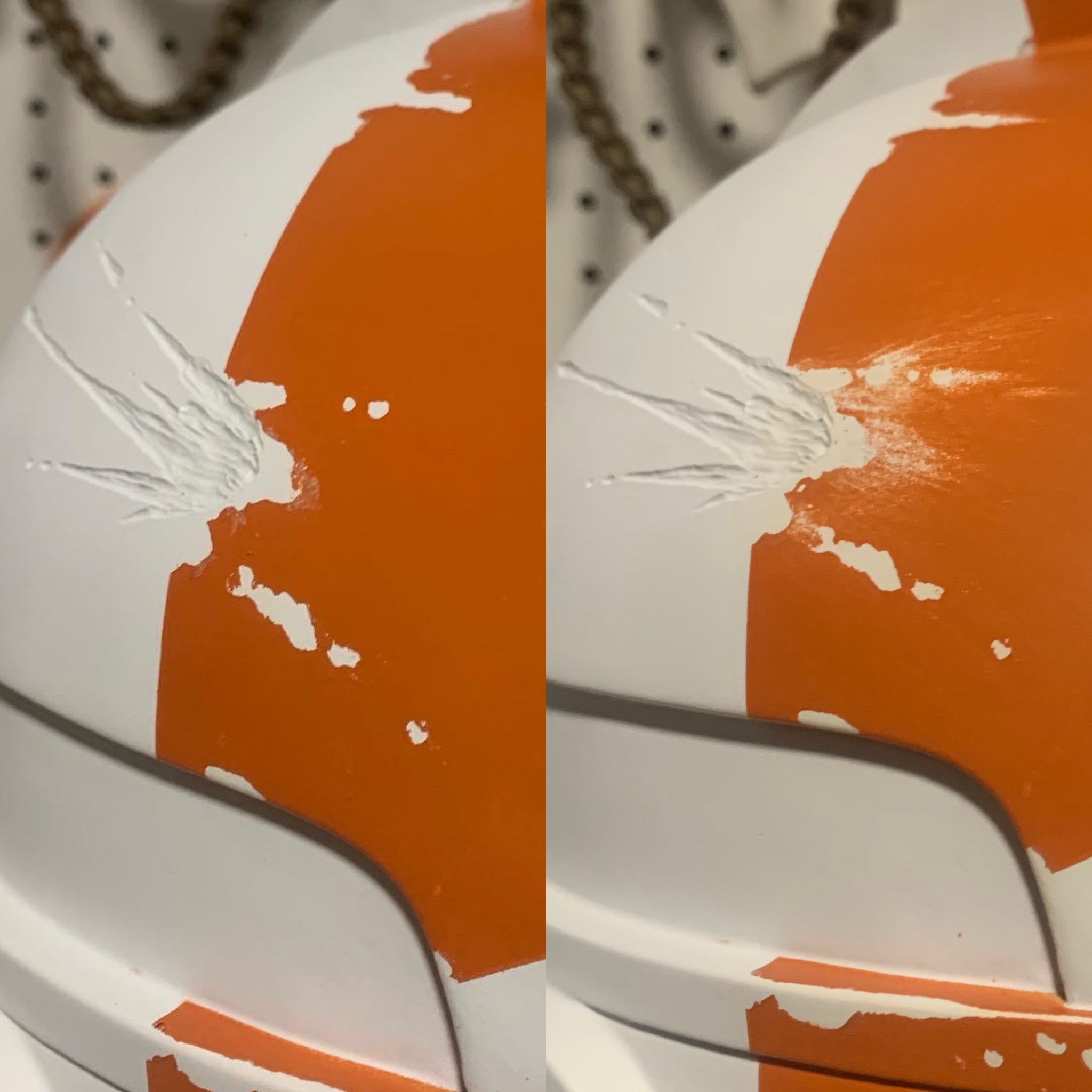

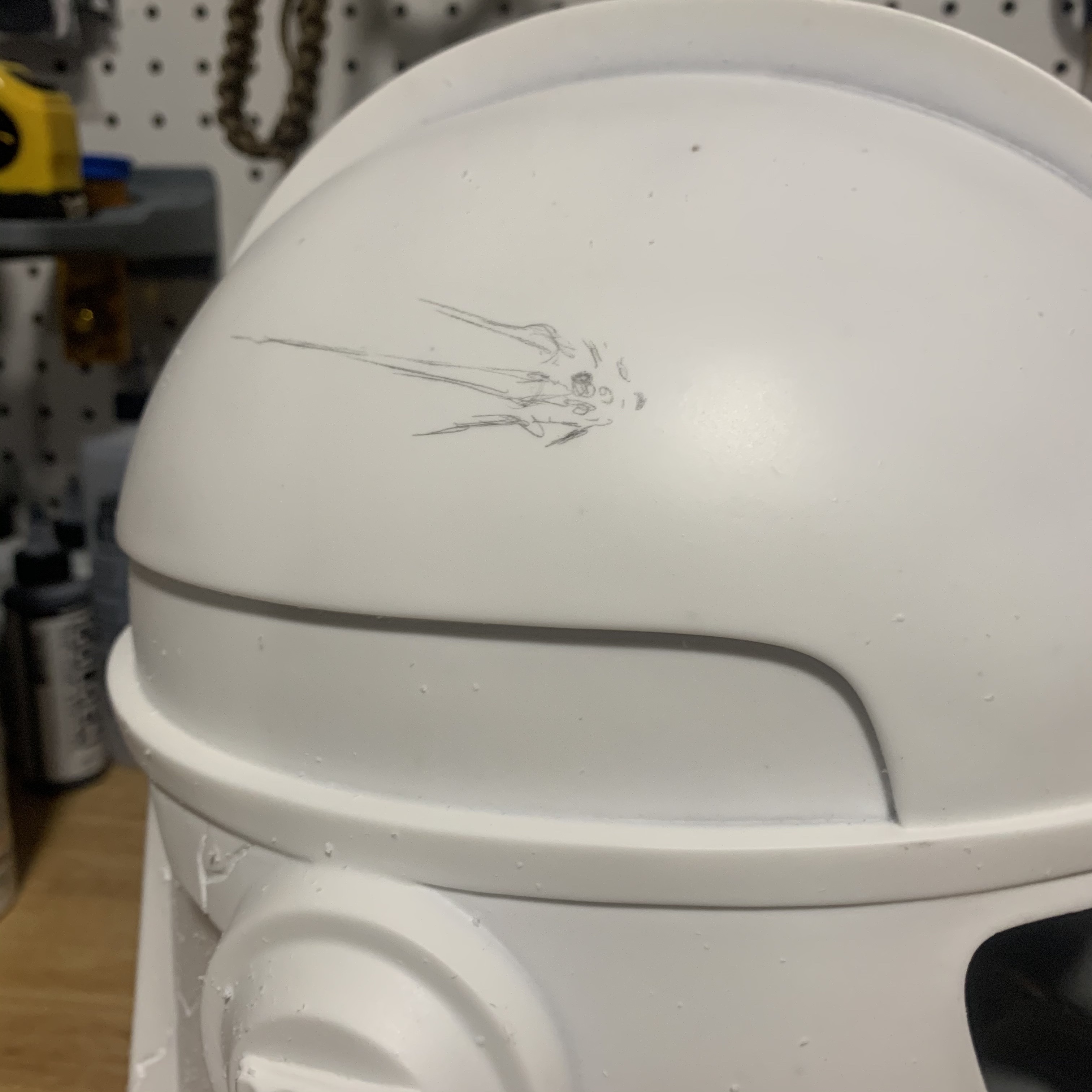

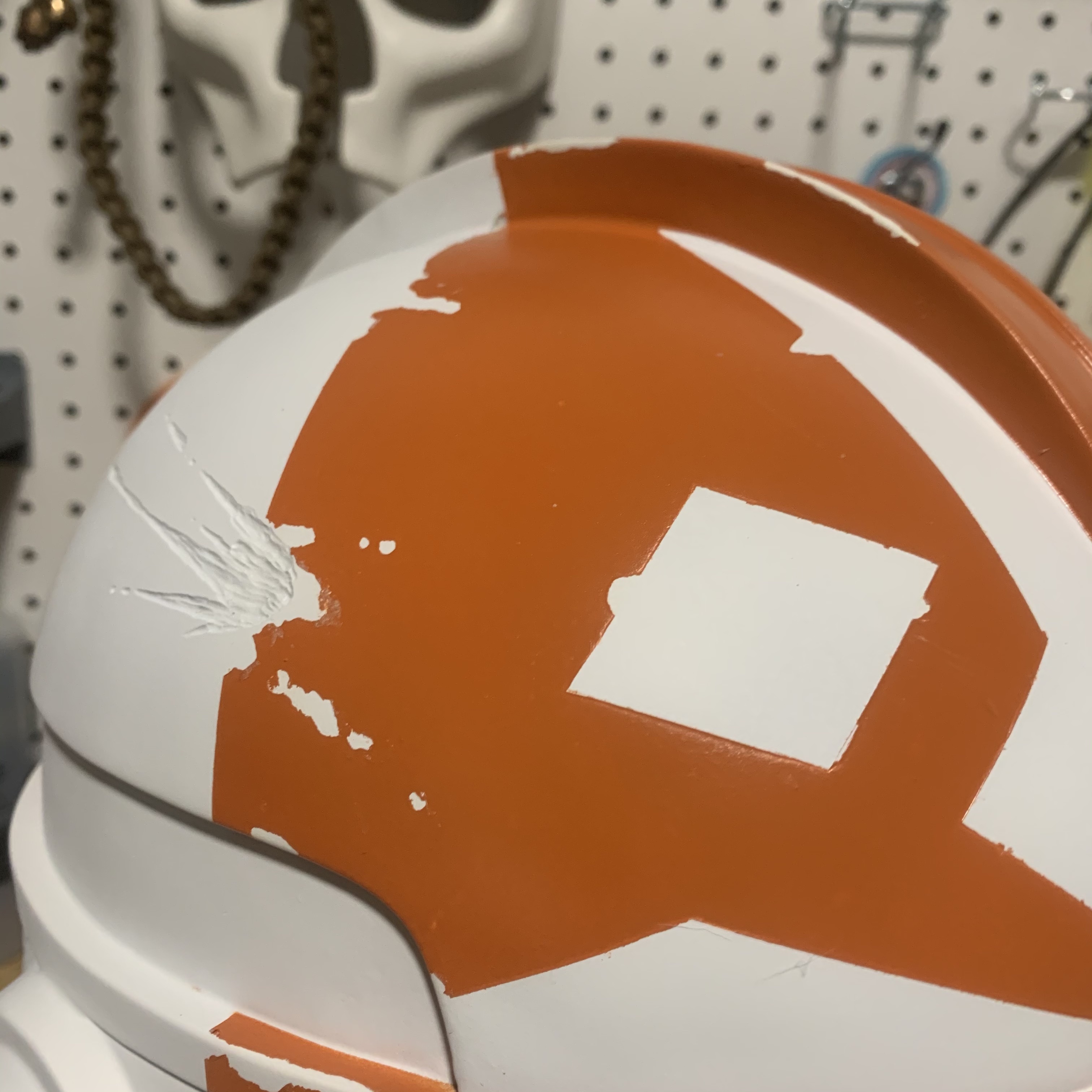

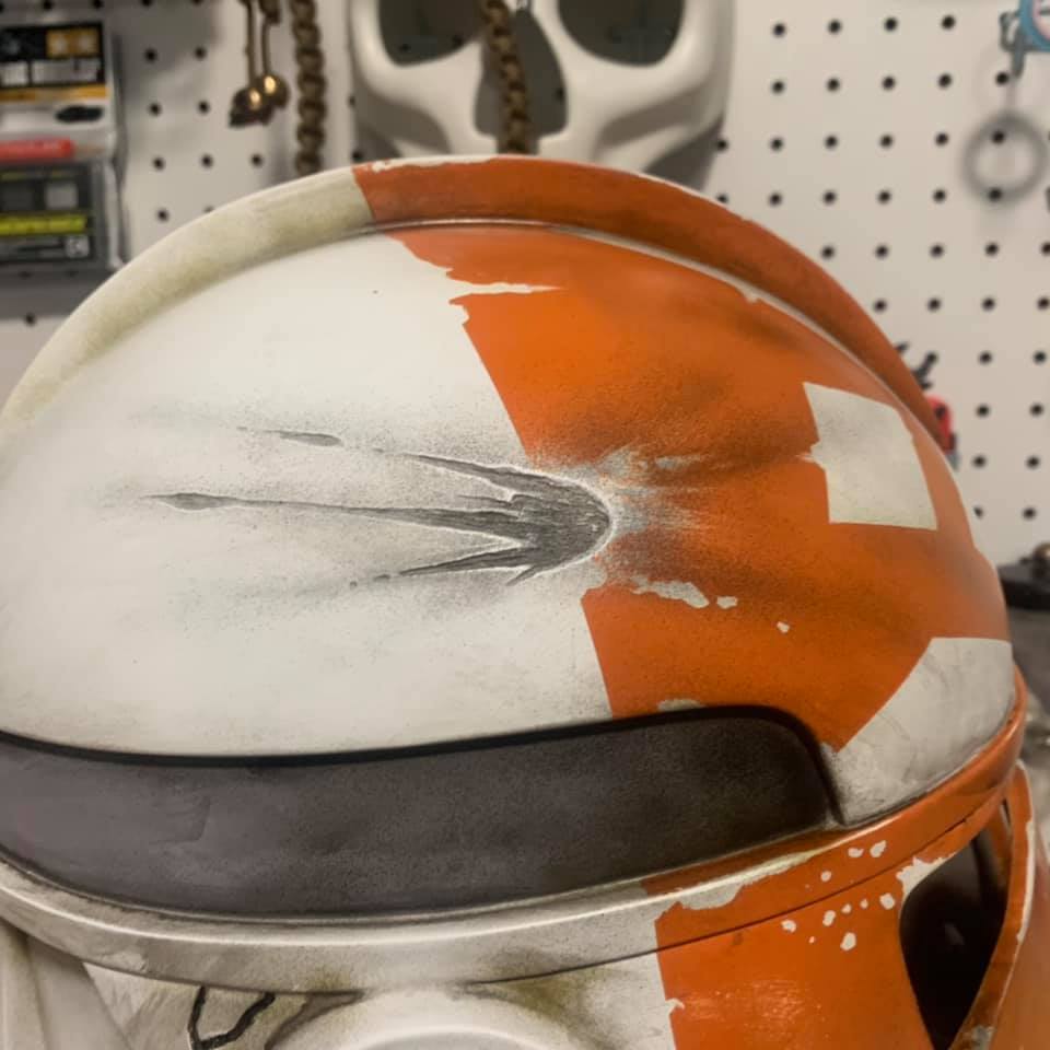

Now on this build the thing I get asked about the most is the blaster mark. I decided to do this off the cuff and made up as I went... Another case of plan your move in pencil. Think about the direction the blaster bolt is coming from, and the direction of any shrapnel. This is a brave member of the 332nd who would be facing the enemy, so the bolt hit a glancing blow and spread back, wider. Don't go too crazy here, Start small and expand as needed. The paint and weathering will really sell this. I carved mostly around 1/16" deep, with a little variation. I used the same Dremel bit as the cracks. Be wary of a heavy hand here as too gouged will look fake (or faker than a sci-fi blaster bolt...).
All of this was done before an ounce of paint. Speaking of paint...

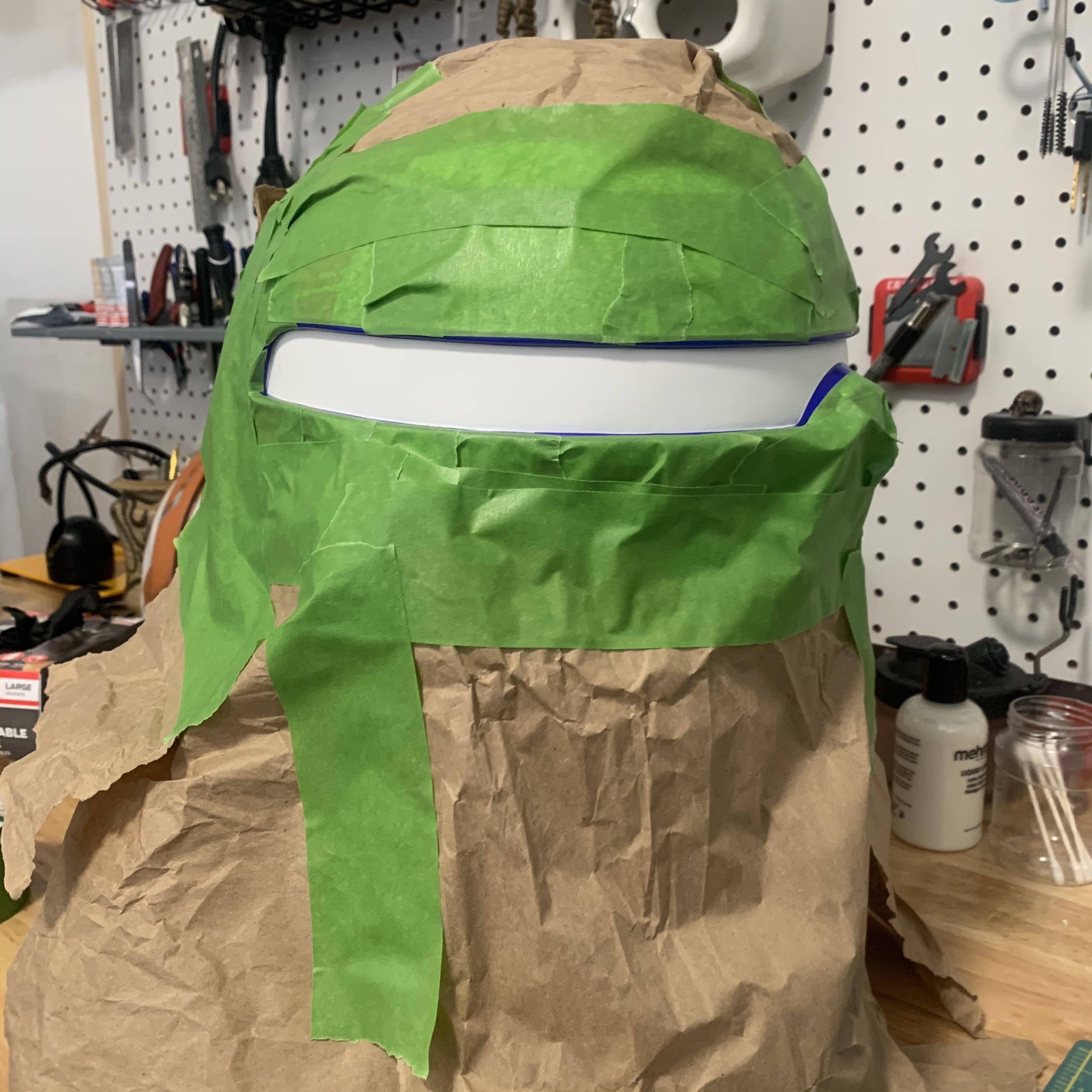

Next was taping off for the orange. 3M curve tape is your friend here. Cuts a smooth line and curves with no bumps.
Also added the liquid latex for paint chips.
Then time to lay down the orange and really make this a 332nd bucket!

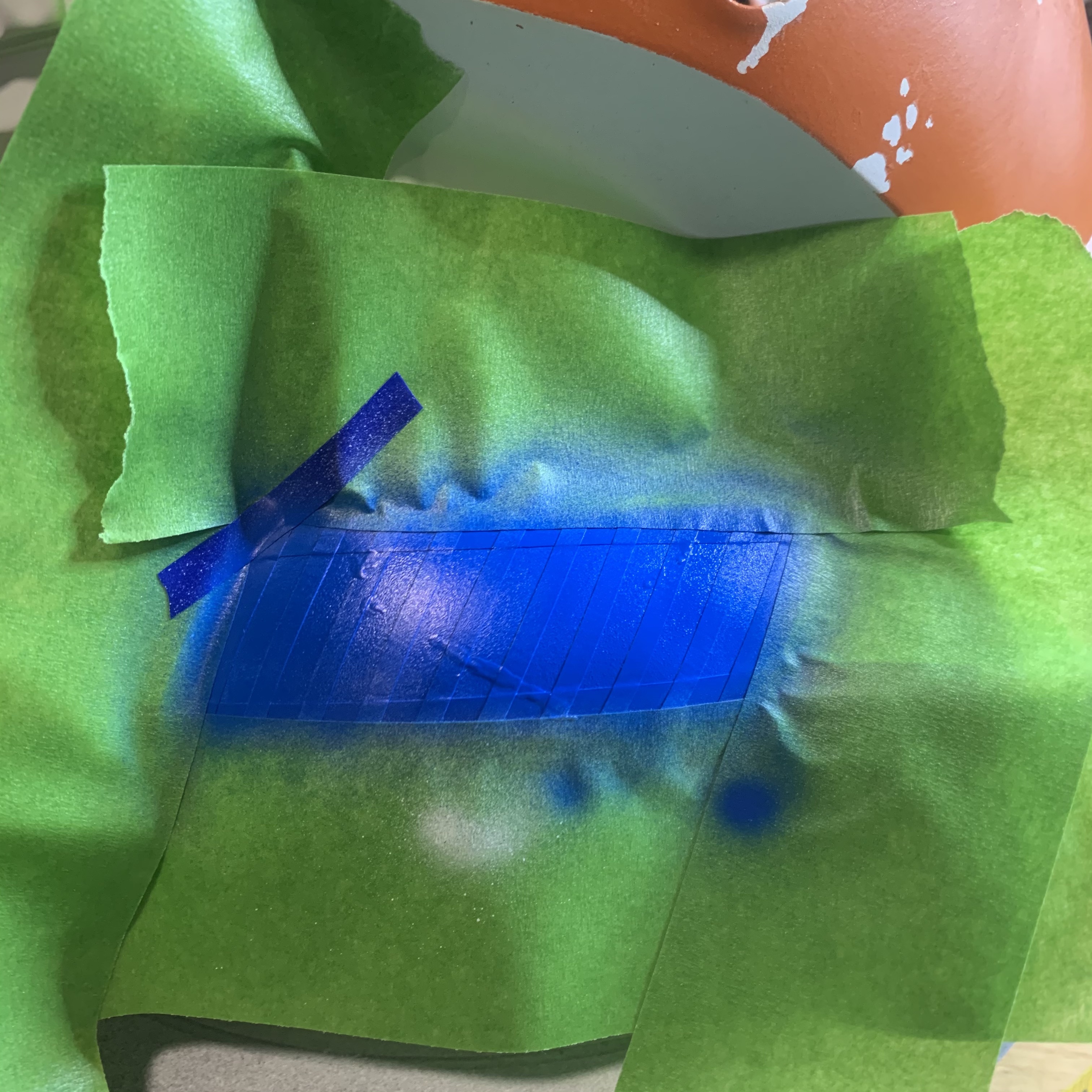

Now, on to the tube stripes. I originally bought a stencil... but that went horribly and bled like crazy, so old school it is.
I used a combo of 1/4" and 1/8" tape. I cut a pice 3/16" wide to use to easily measure the width of the strips as 1/4" was too wide.
Double checked that I had the correct 9 stripes for a RoTS bucket, added a little latex for weathering, then airbrushed the blue.
Both sides done!

Used black acrylic was to darken the cracks. This to me looks more realistic than trying to had paint them.
This after another round or two of shading grey and an overall acrylic wash. Important to layer the weathering and sneak up on the right level. Easy to add, but harder to subtract...

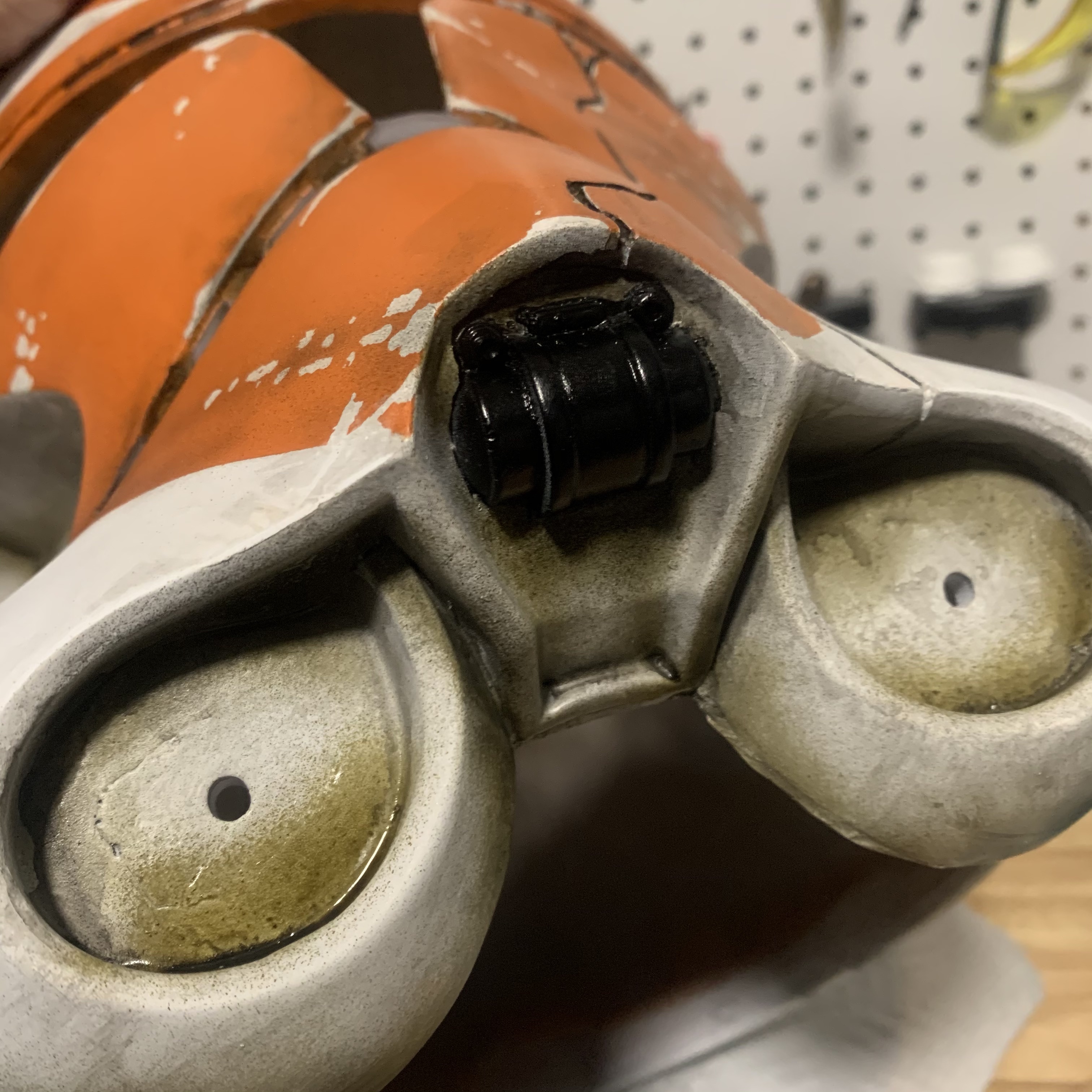

Warm color grime and rust are the next few layers, both done with airbrush.
For the grime, I added a couple drops of sepia to the transparent shading grey. This make sit look more than sooty and much more grimy and oily.
Also, added some rust on the ear caps. Just went for a look like something in there has rusted and the rust has run down over time.
Did more wases and a little sanding on the blaster mark.
Next, added the aerators. There are printed hollow aerators (that are hard to find...) and I just colored the grill with the chrome pen and airbrished the grime, then CA glued in place.

I wanted to reinforce the carbon scoring on the blaster mark and used Tamiya flat black through the airbrush to carefully add more black.
