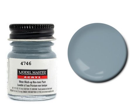

Testors Model Master Acrylic Paint - 4746 Flat Medium Gray FS35237 - 2oz. bottle

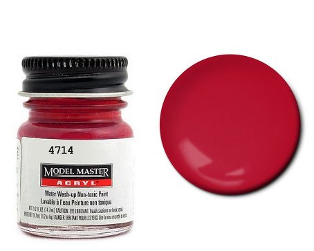

Testors Model Master Acrylic Paint - 4714 Flat Insignia Red FS31136 - 2oz. bottle

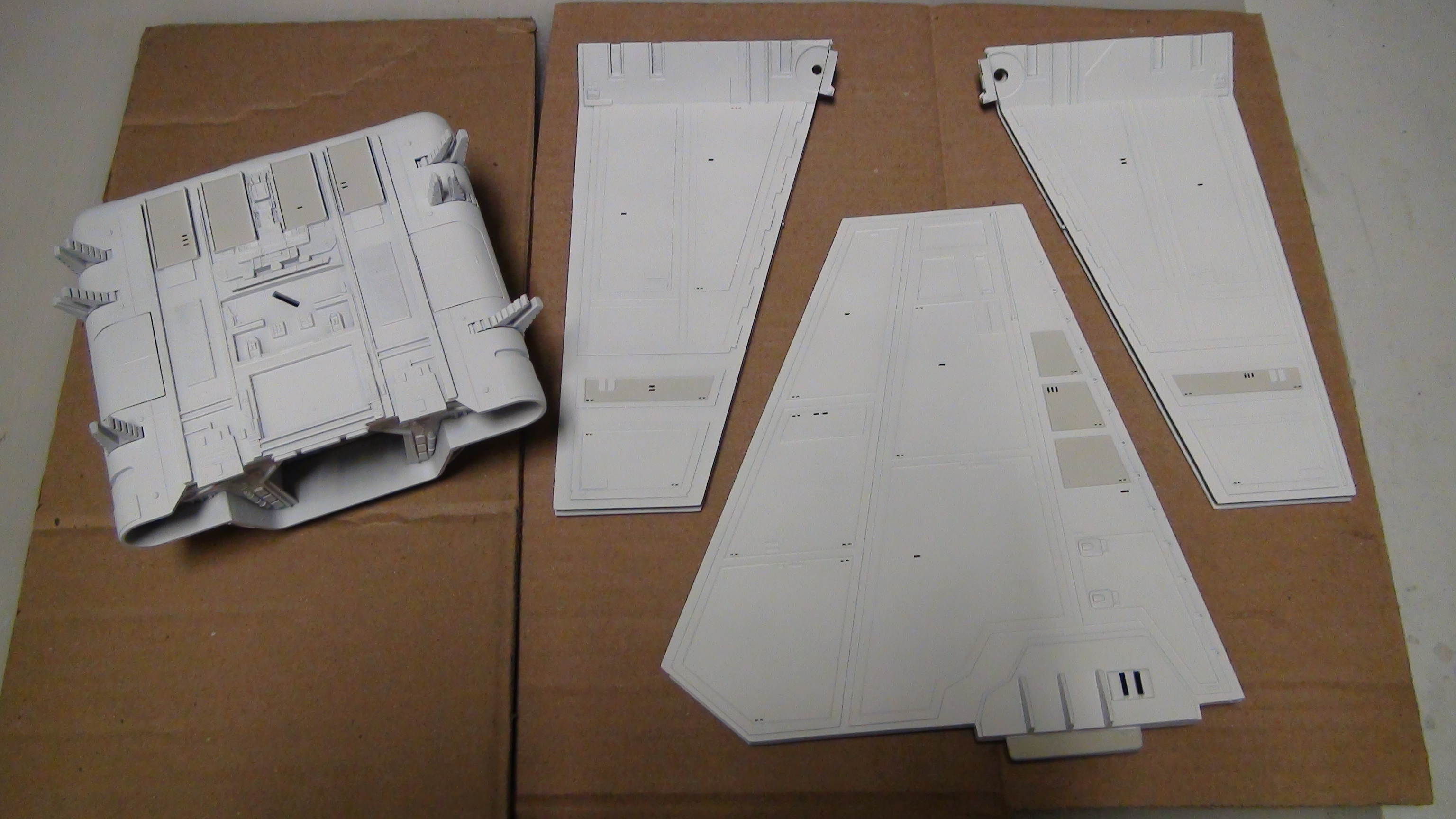

Main hull color is not light grey, its more of a very light beige (cream ) color and Tamiya insignia white is a close match,
here's my shuttle tydirium model, the darker panels is the insignia white from Tamiya as you can see its not white at all, I have the MR falcon to compare and its a close match far from being a light gray tone.
