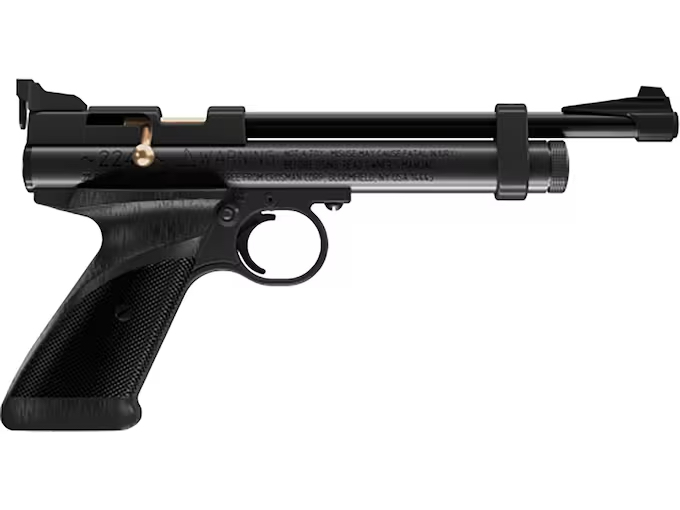

I have an old air pistol that no longer works (I'm sure all the O-rings are gone), and I'm thinking of turning it into my own "blaster." It's a Crosman 130, one of the ones I learned to shoot with "a long time ago in a galaxy far, far away." ;) I think it's "unique" looking enough that it might make a good "sci-fi" pistol.

Still working on ideas for upgrading this pistol... As it happens, I work for a company that supplies welding parts and supplies and there are DOZENS of assorted pieces and parts that would make terrific "greeblies" to add on for effect!
Anyone have ideas on how I could affix some kind of "block" onto the side, which I could add a couple of small tube-like parts onto?
Looking for some brainstorming on ideas on creating a "new" model of blaster out of this. ;)
It's a couple of times per week when I'm doing inventory checks that I see another nozzle, tip or something and think it would make a great part to add on to the pistol. LOL

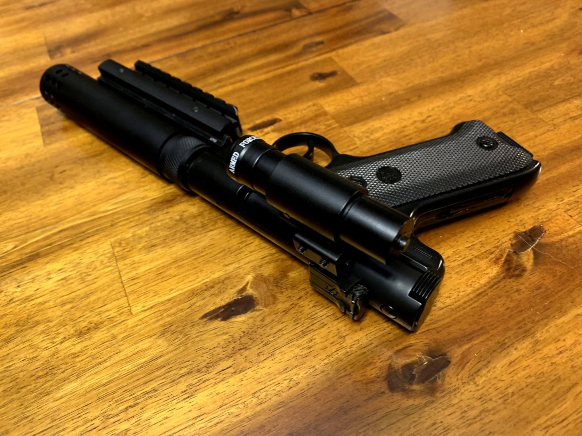

I had done a similar custom blaster over 20 years ago. Similar in design but it was shorter and it was CO2 so there was no pump section.
It here is the original.
I eliminated the top section (the actual barrel, barrel support, cocking mechanism) so the I could use the larger tube as the main barrel. This is actual where you load the CO2 cartage from the front. I also got rid of the screw on loading cap on the front.
At the time, I had a friend with access to a machine shop, So I designed a muzzle that would slip over the main tube. It was slightly rounded on the top and bottom with a wide and thin groove. The thin groove I added black paint accent to along with a fat O-ring behind the muzzle. I had a bit of a hard rubber grooved grip piece that I had in my parts box. I sliced a section out of it and fit it so it clamped at the top. This covered the text engraving on the side and the a little bar that stuck out the top. The grooved piece could slide along the tube and still cock the pistol which h offered a neat effect.
When I had the muzzle made, I had it made very long because I was not sure how long I wanted it. I actually was able to cut to two equal pieces and then a shorter leftover piece. I ended up making two of these for a friend. My friend I made a extension barrel lathed that would screw into the threads where the CO2 cap once went.
Unfortunately all my good images of those two blasters have been lost and I no longer am in contact with my friend or have mine. So this is the best shot I have of one of this blasters.
If you want to know what happened to the the smaller muzzle piece, I used to to make a quick and dirty Mara Jade holdout blaster.
