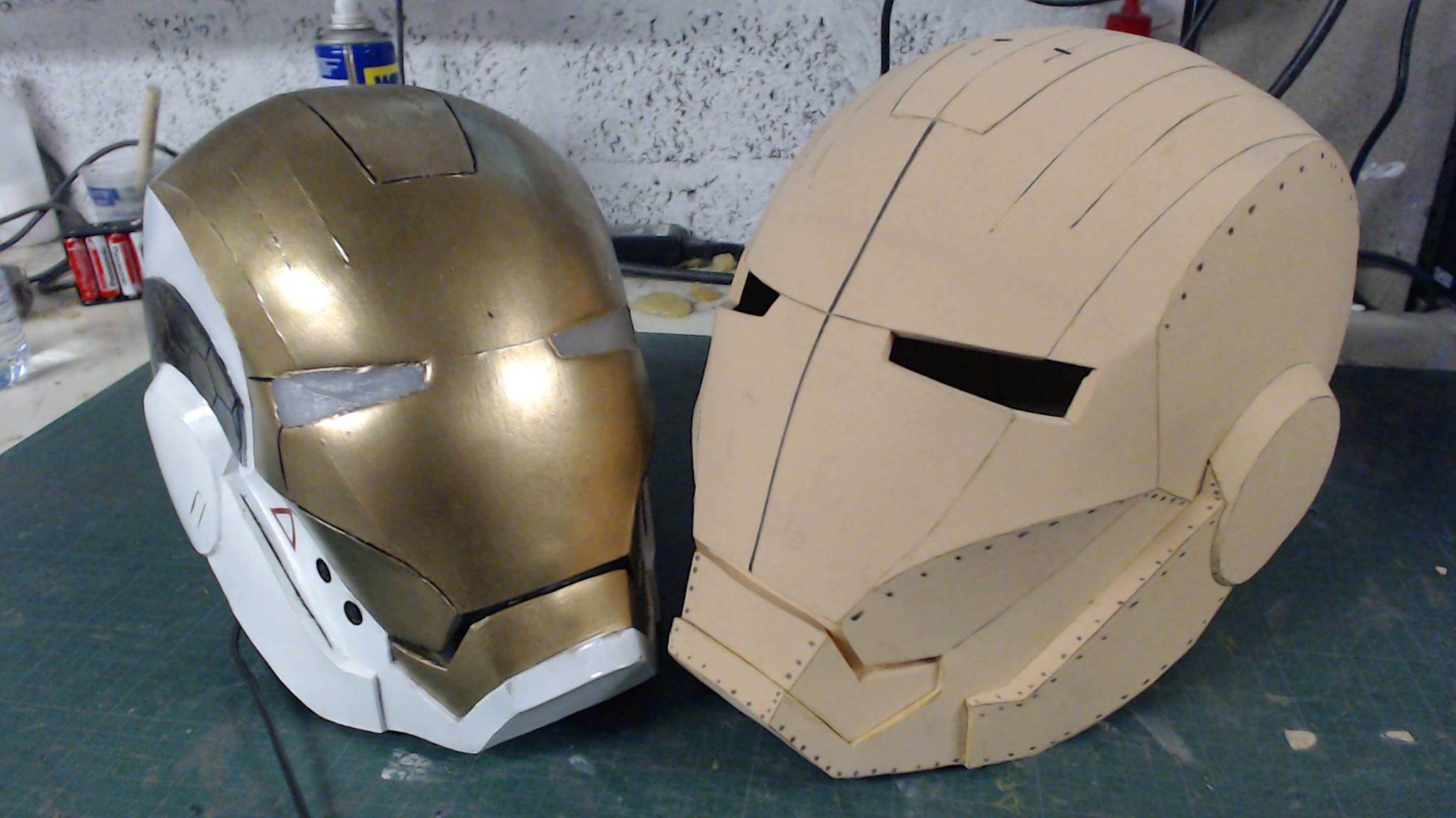

Helmet is gonna get a redo but 10% bigger and a nice coat of smooth on epsilon.

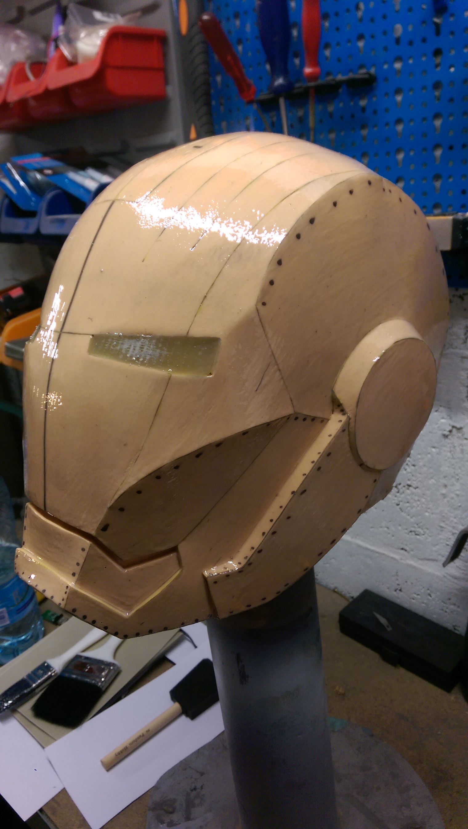

hot glue lenses and the hexagon back piece:
12119184_1708972272672042_2298099040979488605_n.jpg 12118706_1708972236005379_9165131441562125475_n.jpg

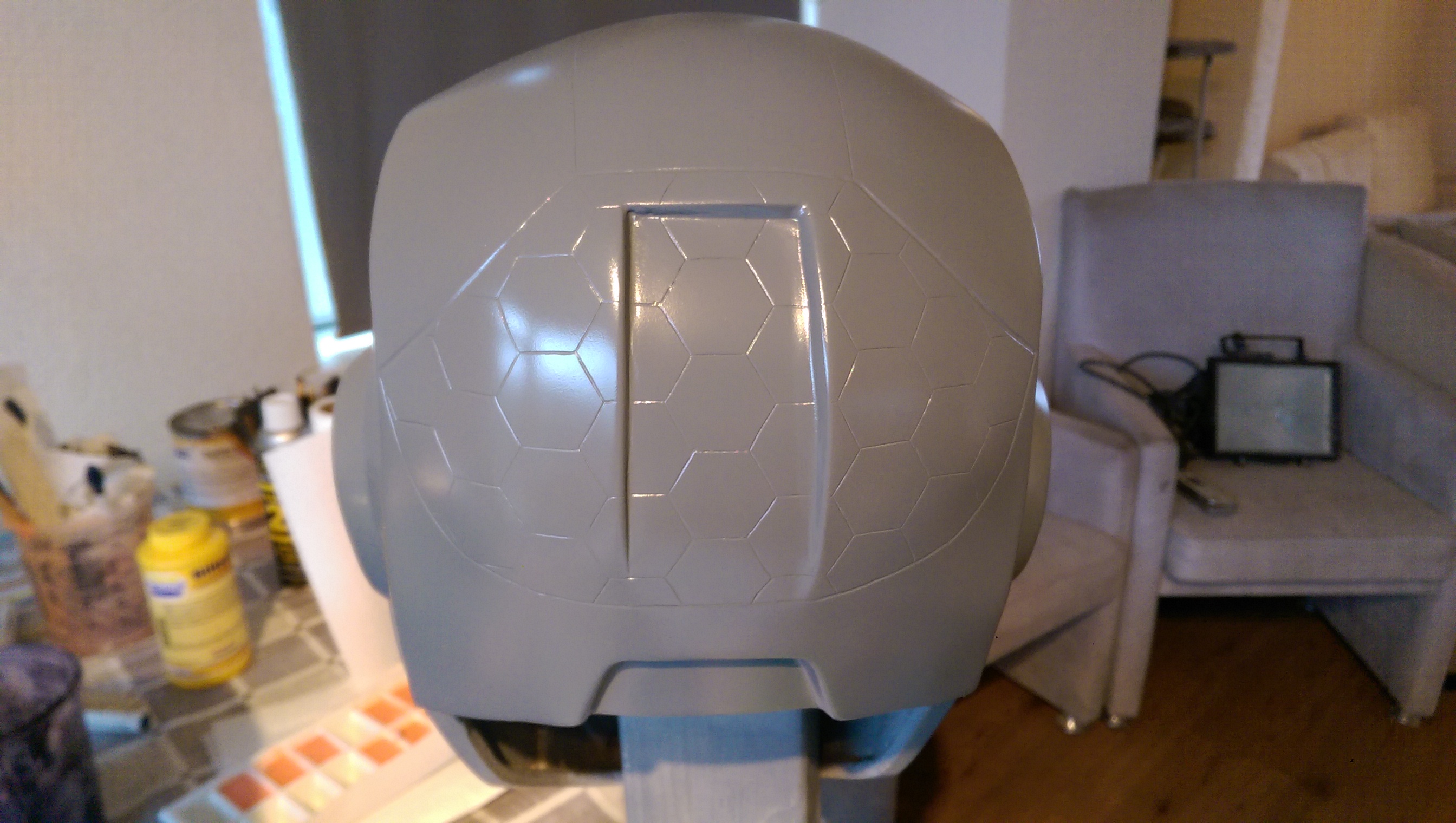

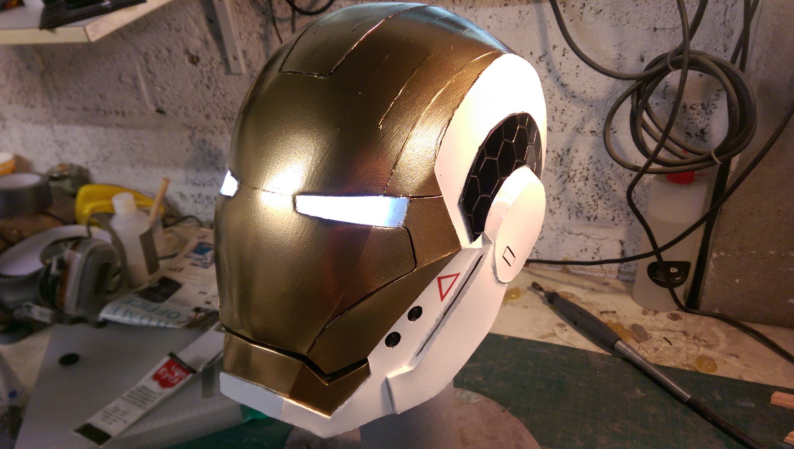

gave it a quick seal and paint job:

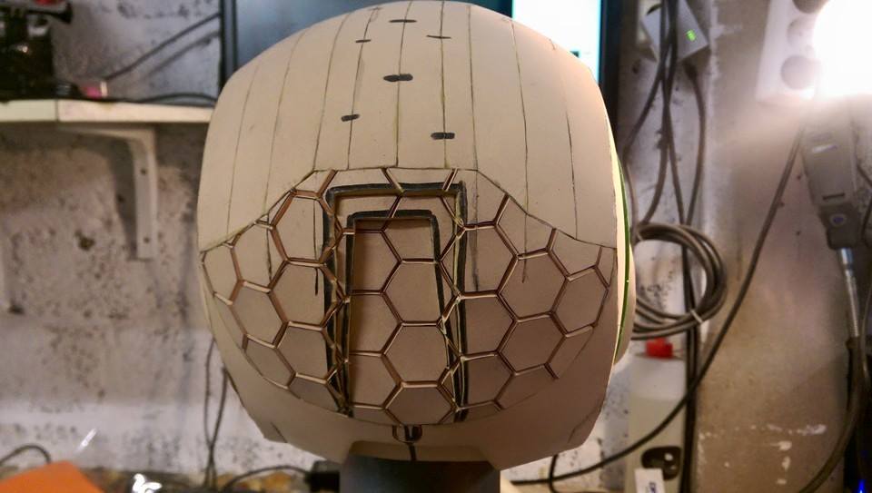

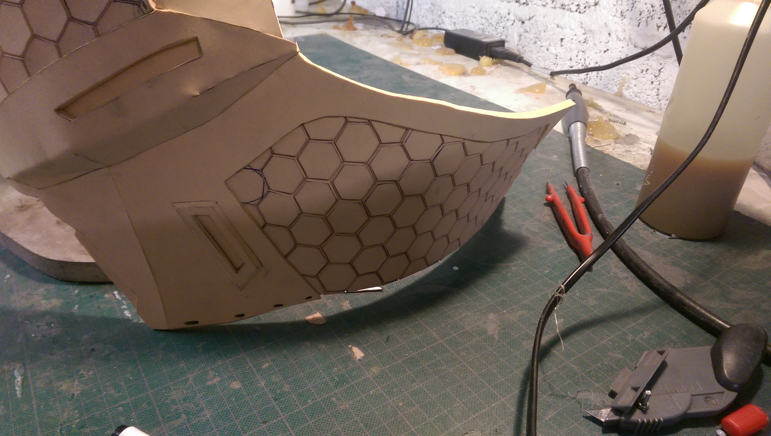

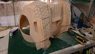

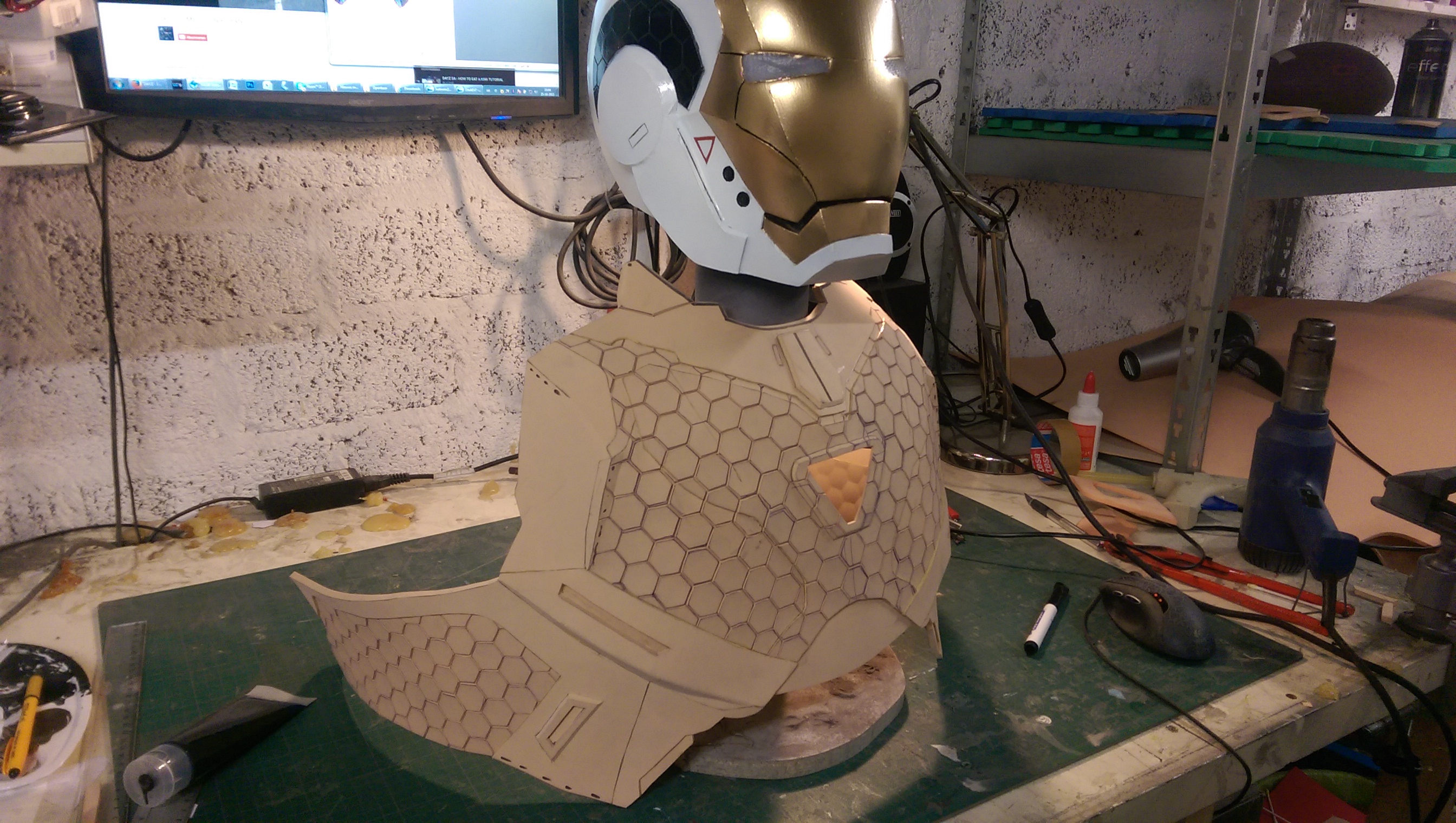

drawing and cutting in all the hexagon patterns,and then pop it with the heatgun:
getting there :) :
Everything seen here is ofcourse good ol' foam!
The back piece and thruster pack i will maybe do in high density foam as its need some support of the co2 jetpack system.
Will update asap :)

thanks man, yeah i just took a hex pattern off of google, size it a bit to what i wanted, cut out 1 hex and start drawing away.
constantly moving and lining the hex further along. cut in each one and pop it with the heatgun, it took forever and my back was in real pain afterwards :p

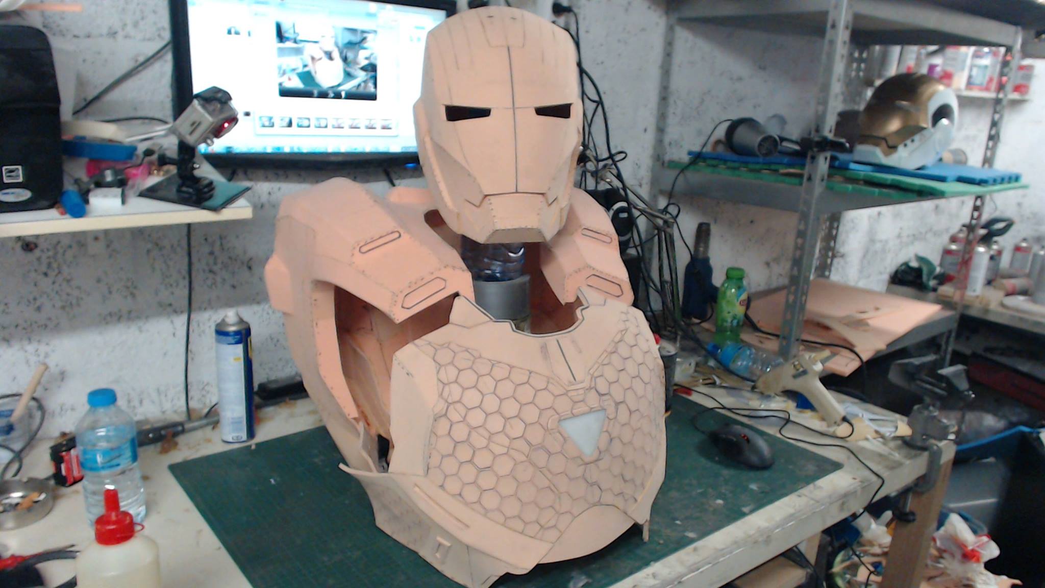

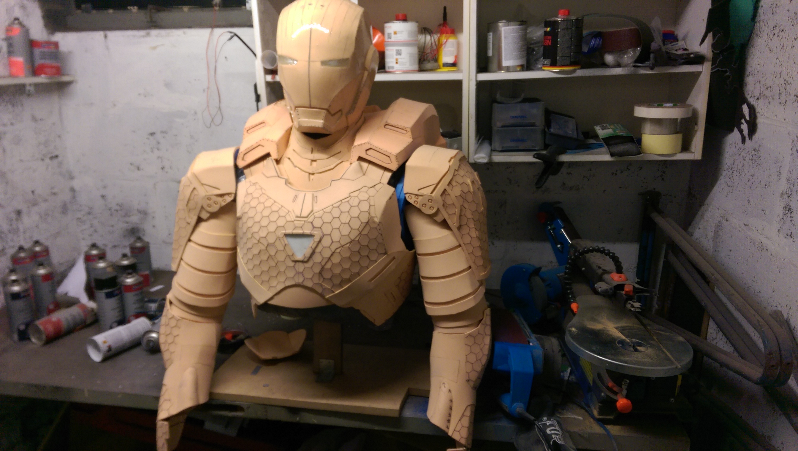

i should update this more often as im way further along now :p so here goes:
since my last post i continued the work and started on the back piece, this piece was the most difficult part so far:
12241618_1731957153706887_3332028088833697462_n.jpg 12274428_1731957140373555_7052357278619300677_n.jpg

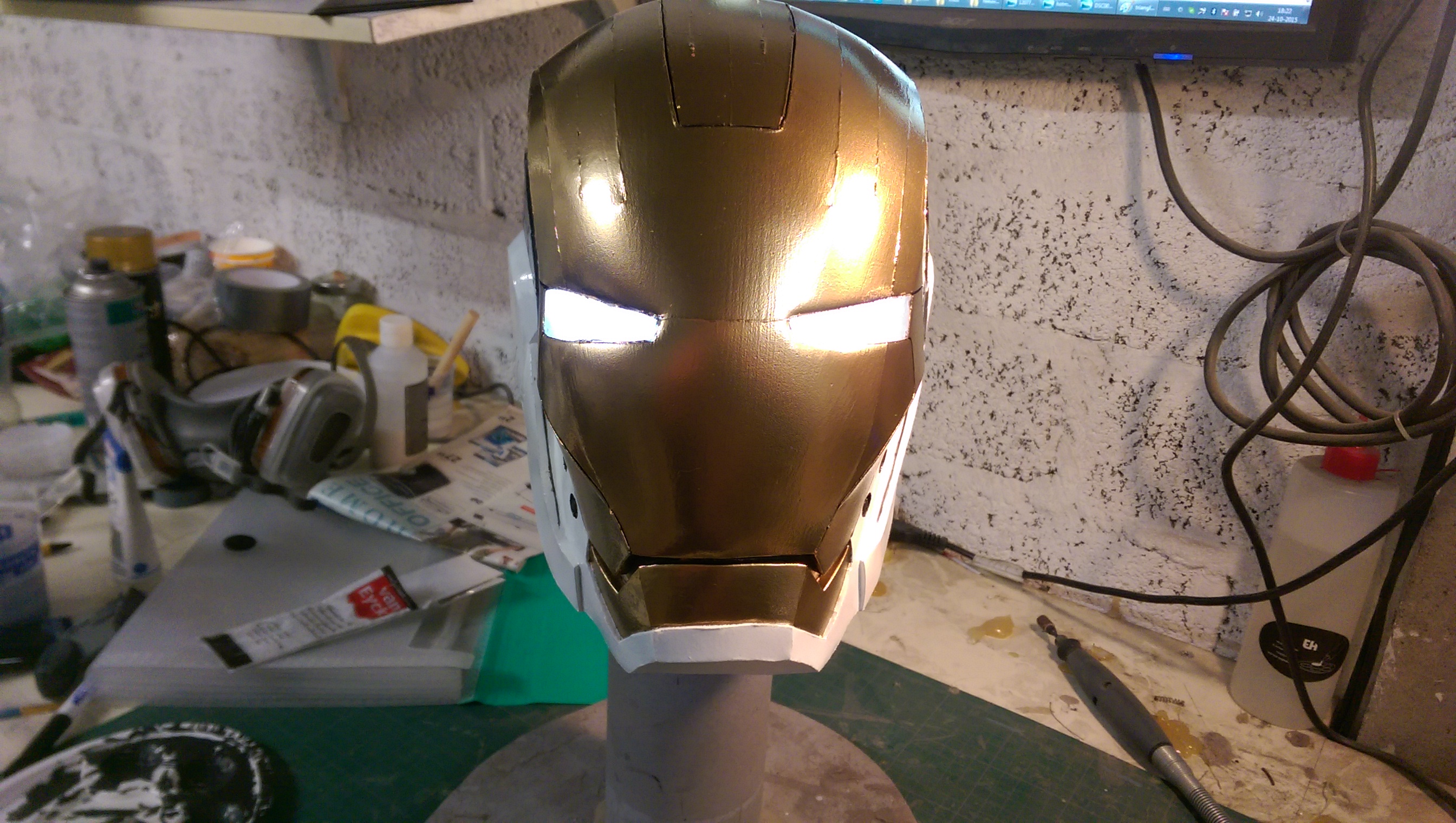

i also made the helm 10 precent bigger as the previous one didnt fit my big ol head, after putting it all together it looked a lil something like this:
905747_1733718216864114_4929671070049218891_o.jpg 12244336_1733718513530751_9205810559765205276_o.jpg
still lookin a bit scrawny right? nothing a couple of shoulders wont fix :p
12249976_1735810569988212_7517504755759453726_n.jpg 12310621_1748003808768888_6528363120875765429_n.jpg

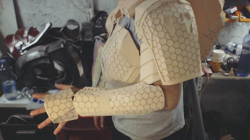

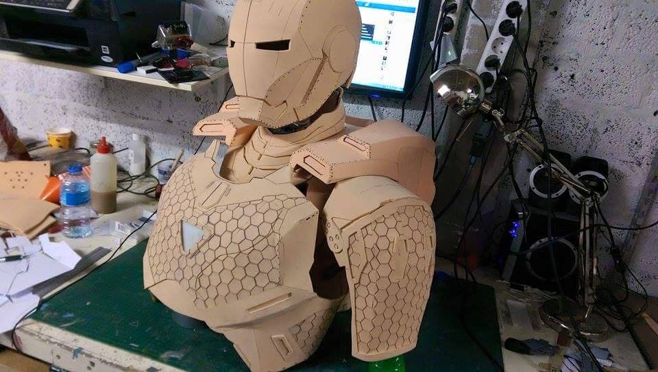

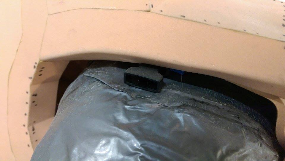

couldnt resist a test fit ofcourse, also proceeded on the arm, i found files lacking in this area so freehanding to the rescue for a bitter fit and look
12369020_1753174521585150_5606416705612597167_n.jpg 12341603_1753174544918481_7792514474969111191_n.jpg
also made a half mannequin on a stand so i could display it easier for now and work/draw on it if needed, finished the arms and filled in alot of gaps in the (under)armor

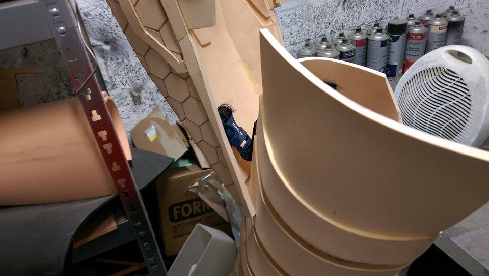

as for the elbows, made some flexible joints inbetween the biceps and forearms, several rings that hold together through elastic straps and can move independantly

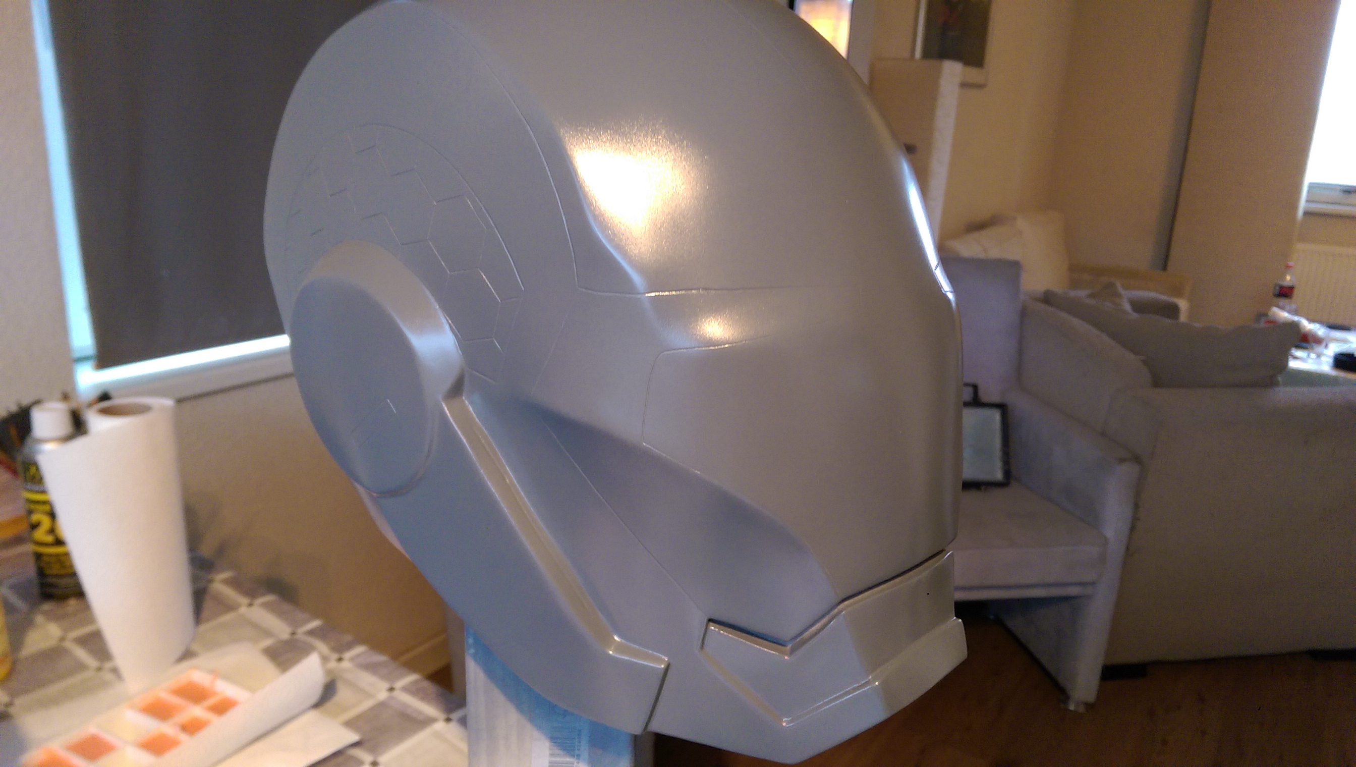

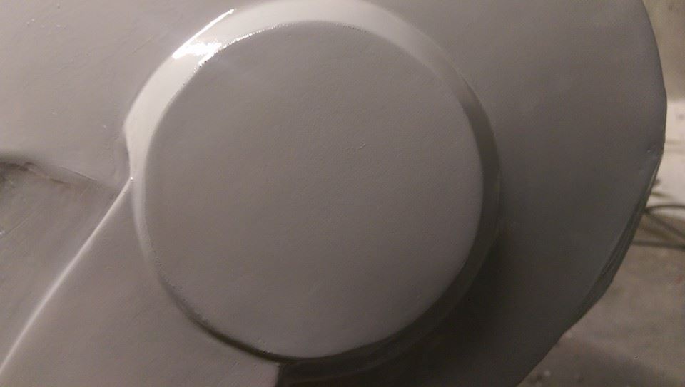

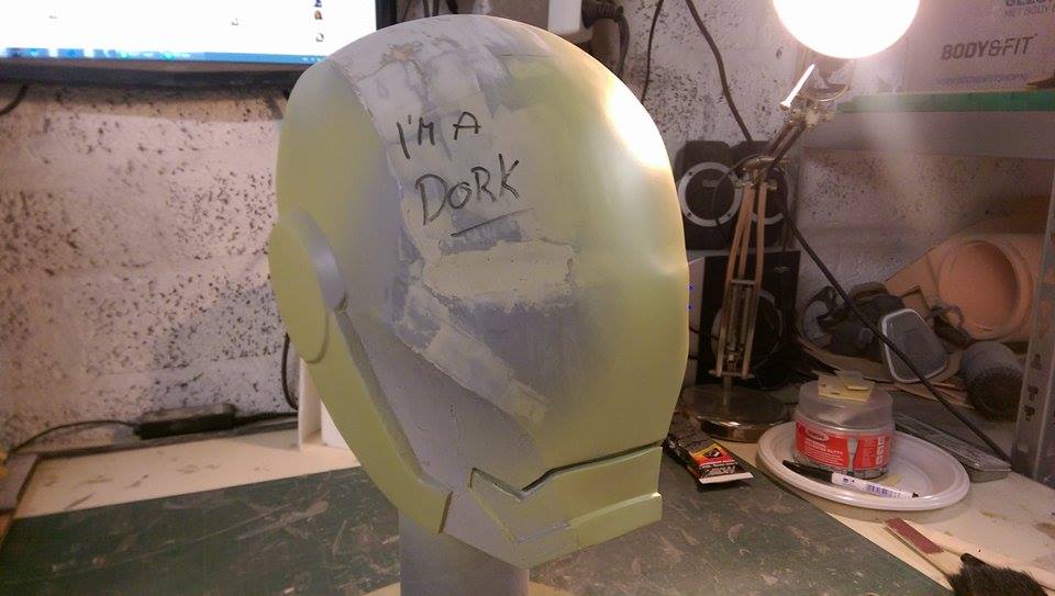

coated the helmet in Smooth-on Epsilon, so onwards with all the sanding! :p
its getting smoother every day
12463793_10153569738914093_990397326_n.jpg 1010609_1762368610665741_3195369014863054291_n.jpg
thats it for now people! around the holidays i didnt get much time to work on it but as all that crap is over now we can get back into the grind and get this suit really moving!
i will try to keep it more updated regularly instead of these enormous pic heavy posts all at once :p

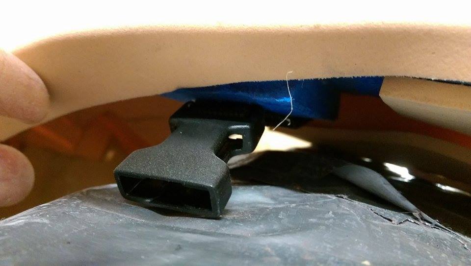

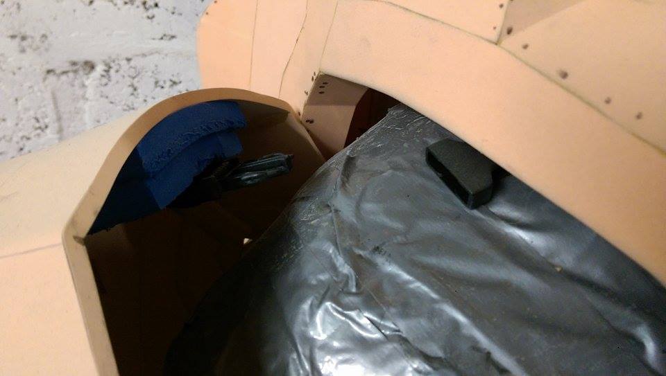

Oh also another thing, can you make a detailed picture of how you attached the Shoulders to the Torso? Thank you in advance! :)
Re: Iron man mk 39 starboost/gemini (BIG update and even more pic heavy)

for now im sanding the helmet to make it worthy for molding and casting

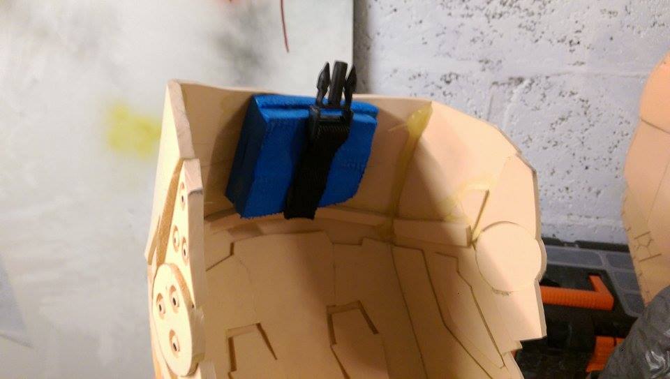

as for the attatchement pictures of the shoulders here you are :p
pic 1 is shoulder with 2x10mm foam pieces slammed together to function as a spacer
pic2 is the torso where you can see the other side of the buckle sticking out
12511863_10153595541559093_195037071_n.jpg12570905_10153595538224093_1367374877_n.jpg
pic 3 you can see that underneath it (torso) i slammed 2 of those 10mm foam cutouts aswell to make it allign so that it actually sticks out
and pic 4 well... clickity click em together and its done
12511989_10153595538269093_65045205_n.jpg 12540283_10153595538374093_1481187686_n.jpg
pic5: and you go on like that also for the rest, like the bicep to the shoulder :)

Thanks for the quick answer! Yeah Im gonna redo my shoulders too, eventually! Mine dondt really turn out the way I wanted them, yours look great!
I had to slim down the Biceps aswell, they were way too big in PepCowboys files, my arm could have fit in there 3 times ! :D
I have one question on the shoulder attachments, does the clip not rub on your shoulder when you wear the armor or do you have another foam layer underneath so that it is comfortable? Thanks for the detailed pictures! Most of the time I have an idea of how I want to connect something but no real plan!
And also I cannot wait for the CO2 system updates!
i wear stretch suits underneath the armor so no, the clips dont bother me at all, i always do it like this actually.

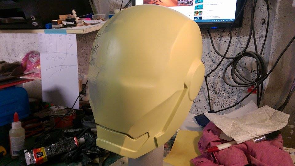

nice plans on the 1 way mirror, mine will just be casted in smoothcast 300 when im done with all the sanding and then ofcourse mold it :)
other than that been just busy with more sanding
traced out all the detail lines with a pencil and gonna carve in the details with needle files
when thats all done im gonna wet sand it all and its rebound 25 time :D

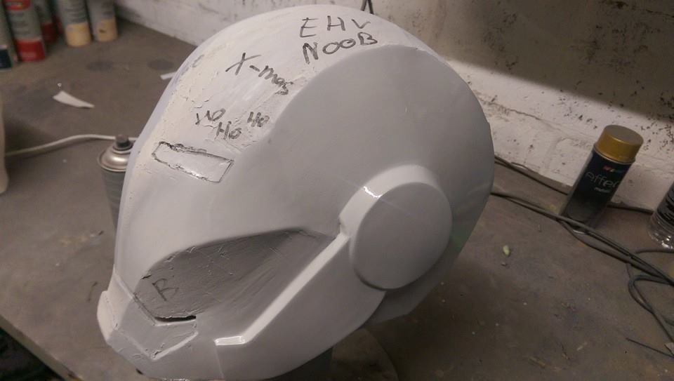

and the helmet is done!
its gonna be molded tonight, jacket mold tomorrow and casted the day after that.

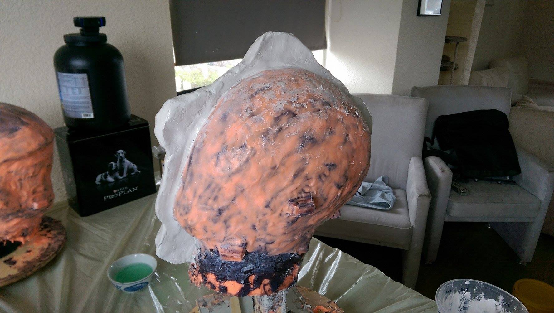

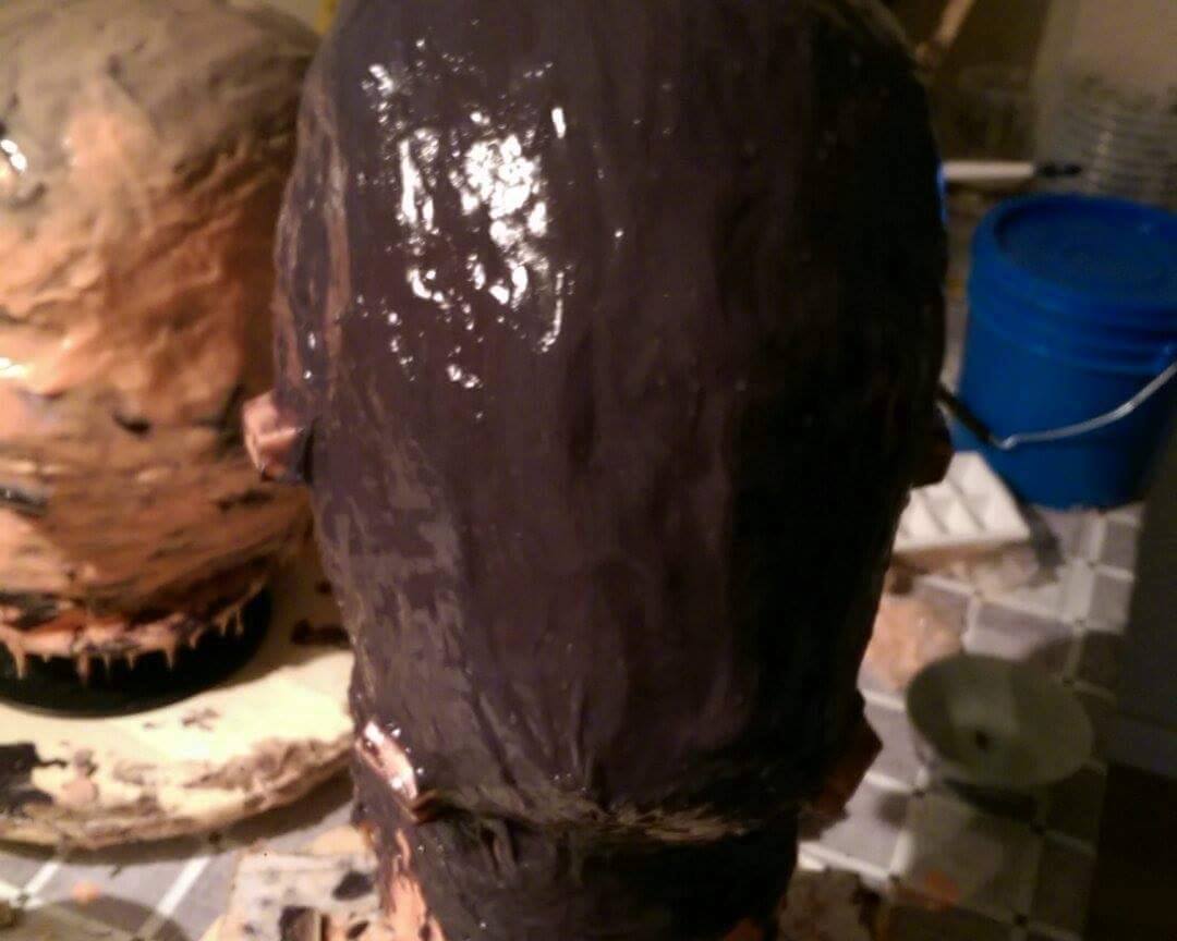

Re: Iron man mk 39 starboost/gemini (HELMET MASTER DONE!)
molding in progress :)
brown stuff is not nutella, lick at own discretion ;)
