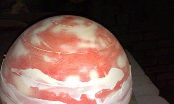

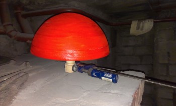

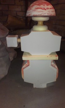

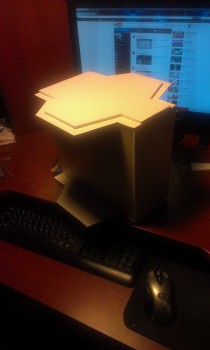

hammers head

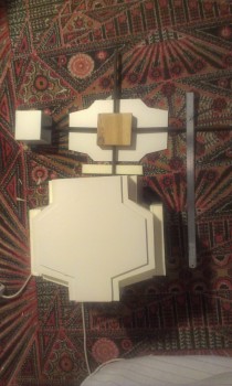

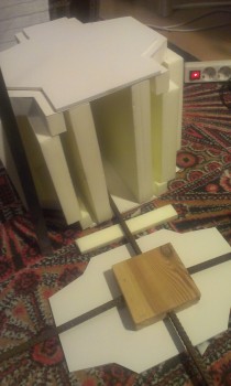

Steel suport frame for hammer
Still needs more sanding and putying to smooth those gaps between foam layers.

hammers head
