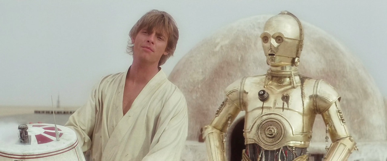

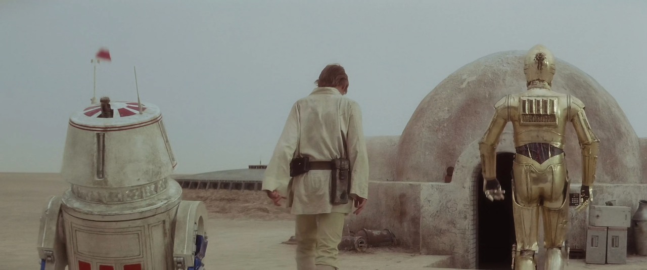

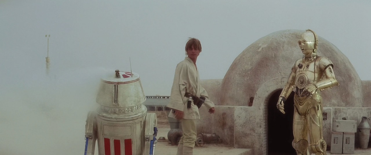

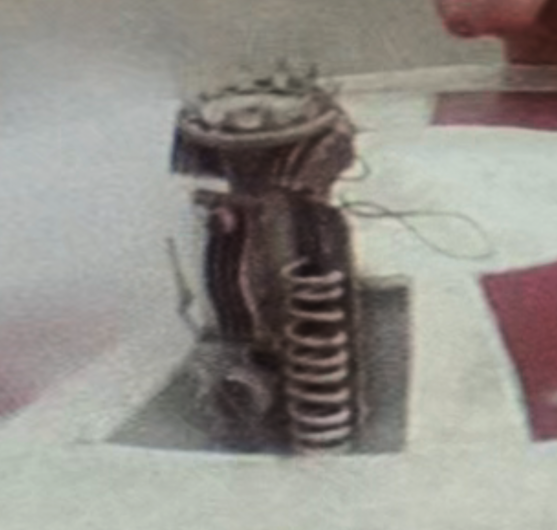

I dont know if you've got the 4k screenshots from those websites but here they are! I cleaned them up a little.
Also kinda fun to see the practical effect in action :D
Hi. Those online images are only 1280 pixels across. The 4K version gives you 3840 pixels across, and you can get details that look like this.

On the Baddeley version of the flowerpot dome, the panel opening is 2 inches wide about 1/3 of the way in from the outermost edge, which is about where the motivator seems to be popping up in the screenshots.
Based on the high-res images that were just posted, I'd hazard the variable air capacitor thing sticks out no more than a couple mm on either side of the light socket or whatever the cone is.
If the socket is from a Vickers lamp, it can't be more than 1.5 inches across on its own, so between that and the panel width I'd guess the whole structure to be under 1.75 inches wide.
Also - don't underestimate how violent that pop up motion is. I wouldn't be surprised if the metre needle was installed vertically and broke loose during the effect.

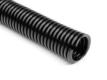

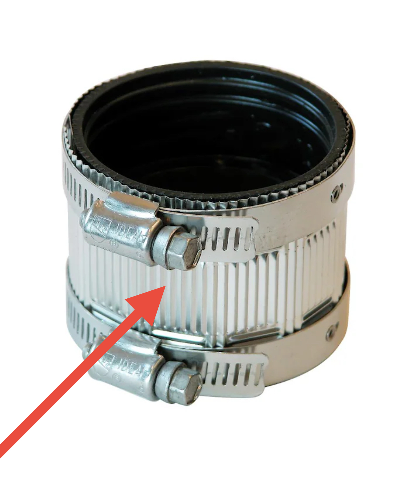

Are you proposing that the part we’re calling a variable air capacitor is actually something corrugated? I think that’s unlikely. First of all the corrugated material in your example won’t curve across the lines—that’s what they’re for! So it would have to be something already corrugated in the other direction, like split loom tubing for example.
That’s possible, but such ridges are usually pretty far apart, and as Vagabond Elf points out, the part can’t be very long. Also it’s closed on the near end, which limits the found objects that would have the right texture—it’s apparently not a tube.
(Compare the real one to my mockup, which does use the equivalent of a corrugated tube. You can clearly see the open end of mine.)
Was only saying what I see, I never claimed it’s the part…
Sure. It’s certainly not impossible. Those could be corrugations on a half cylinder rather than stacked plates.
But most corrugated rounded objects are hollow, so it’s hard to imagine what it would be exactly. I don’t think they fabricated much here; it’s probably almost all found objects.

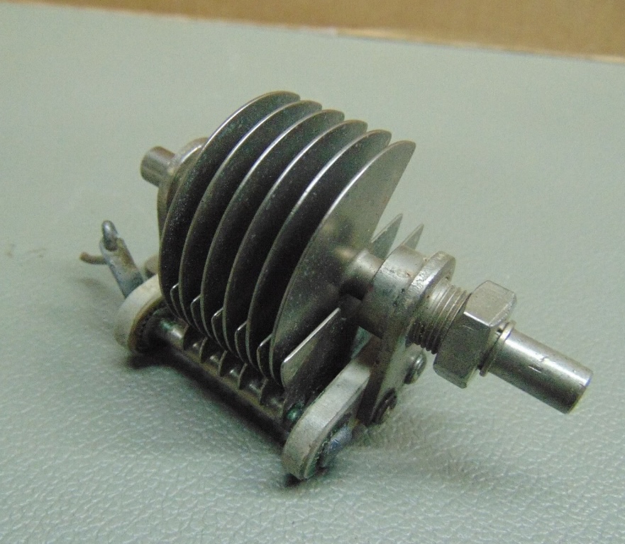

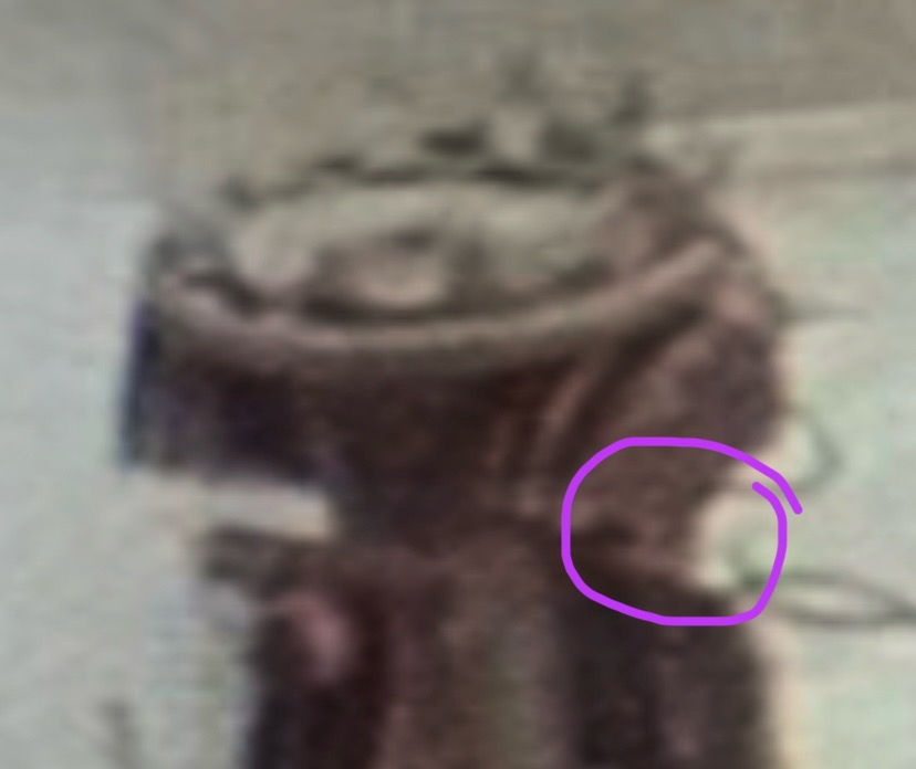

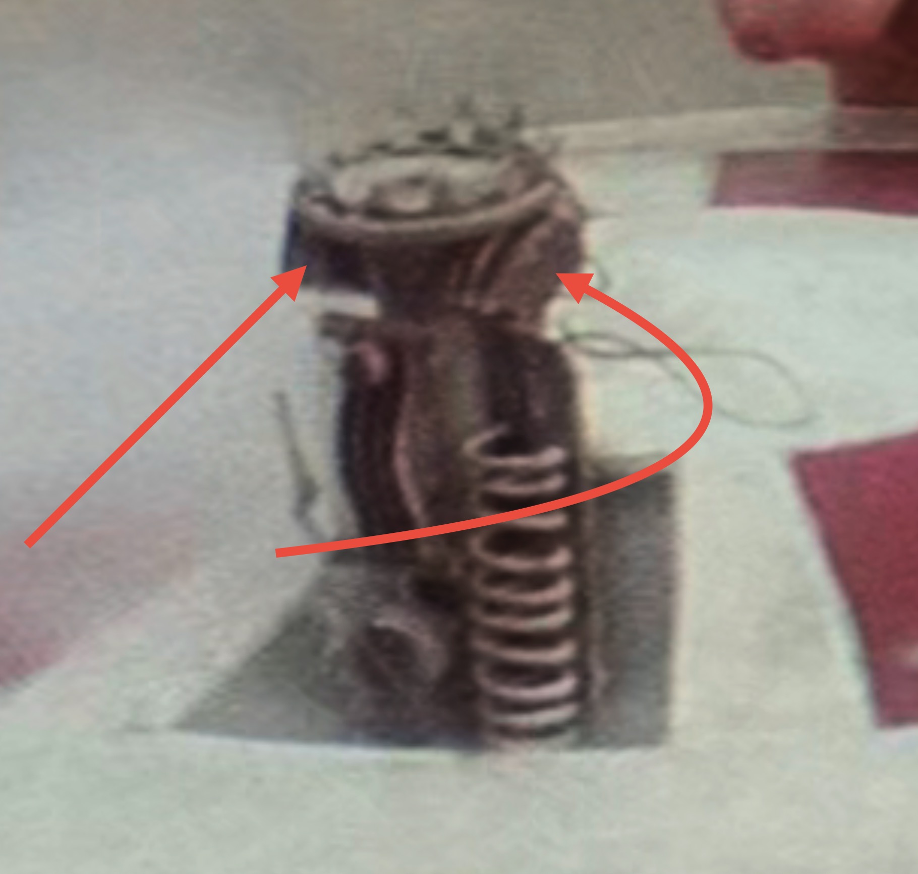

The main reason I personally like the variable air capacitor theory is this detail:
It looks to me like that is the opposing row of plates. Something like this:
I think I see that matching pretty well. If it isn’t that, then we need to account for that detail some other way.
I guess I should also make explicit the biggest reason one might doubt the variable air capacitor theory: most of those have an obvious axle and housing, neither of which seems to be visible here.
But they came in many shapes and sizes, and the housing might be easily removed on some. I haven’t handled one in person—or not recently—so I’m not sure about that.
