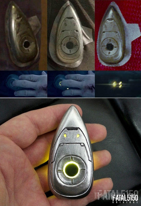

I decided to make my own sculpt of the rocket controls so I could integrate working lights into the design. One thing I haven't seen anyone offer yet is a version that actually lights up. You'll notice not only is there a ring of light around the button, but above it as well.

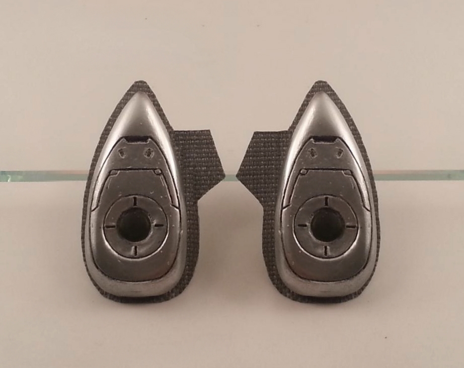

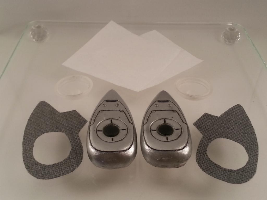

Each set includes 2 textured pre-cut fabric pieces that go behind the controllers and 2 pieces of fusible web that can be cut to shape and heat-set with an iron to your pants. Also included are 2 mounting options, either velcro or magnets to allow easy removal for washing. You can turn the unit on by pressing it against your leg. If you have a con or another event you are wearing these to, you can leave them on all day with their 200+ hrs of battery life! The units are actually activated by a button on the back-side which bubbles out about 1/4". This allows for ease of battery changes while still maintaining a visually thin profile.

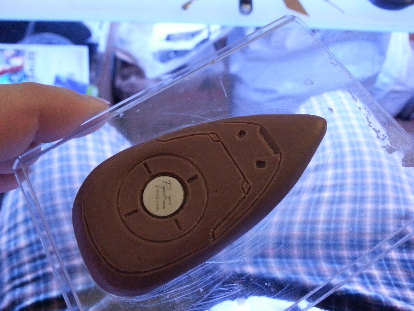

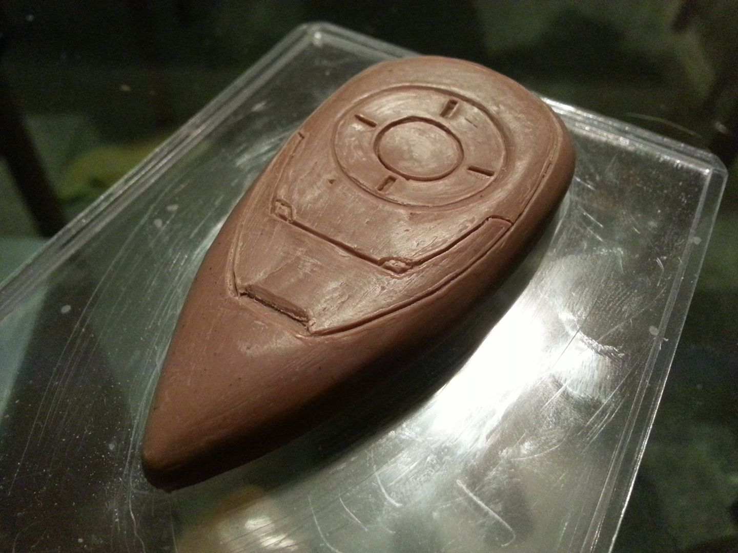

This is my first time using Monster Clay. Amazing stuff! I like it so much more than the standard plasticine clays. I got the firm clay. I like that you can microwave it, or use hot water to soften it up.

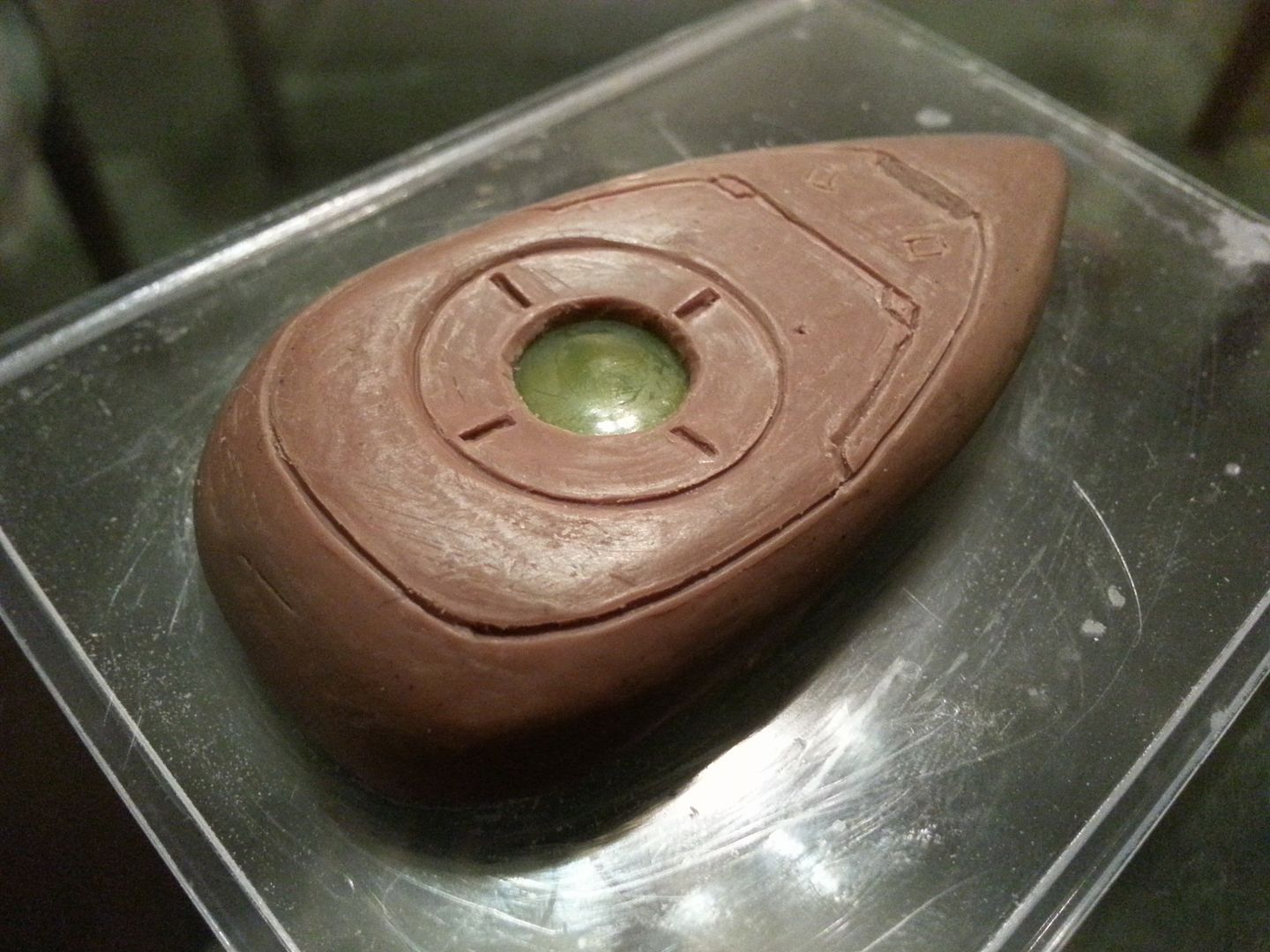

Here is my initial sculpt:
I built it around a yellow housing that holds the PCB unit. I cut out the button itself because I had a piece that fit perfect with the right dimension and shape.
This is the piece I used. It's a charm my wife made for her bracelets and other jewelry she sells on Etsy.
I then built a housing to pour the mold.

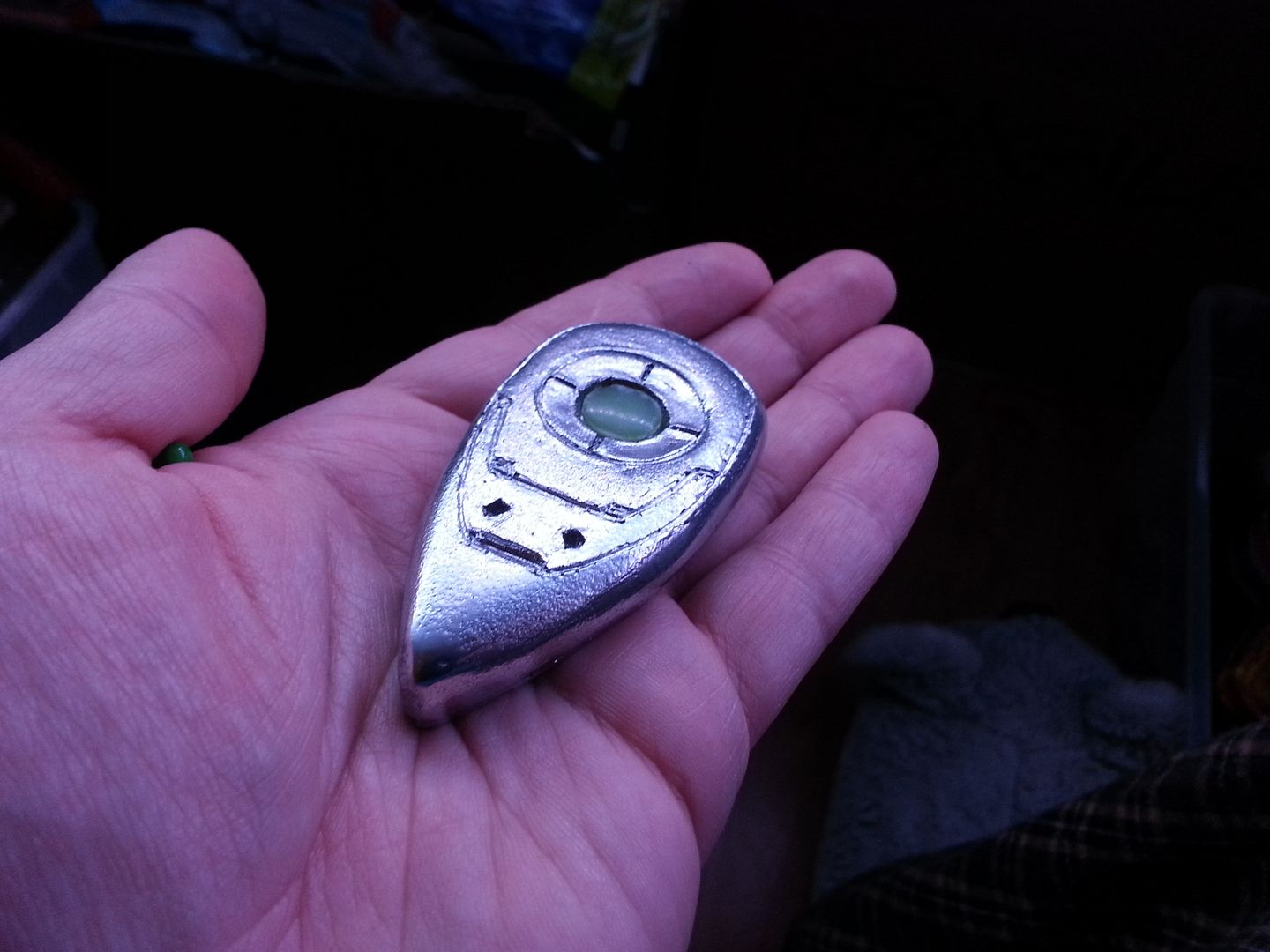

This is the first cast in thermoplastic.

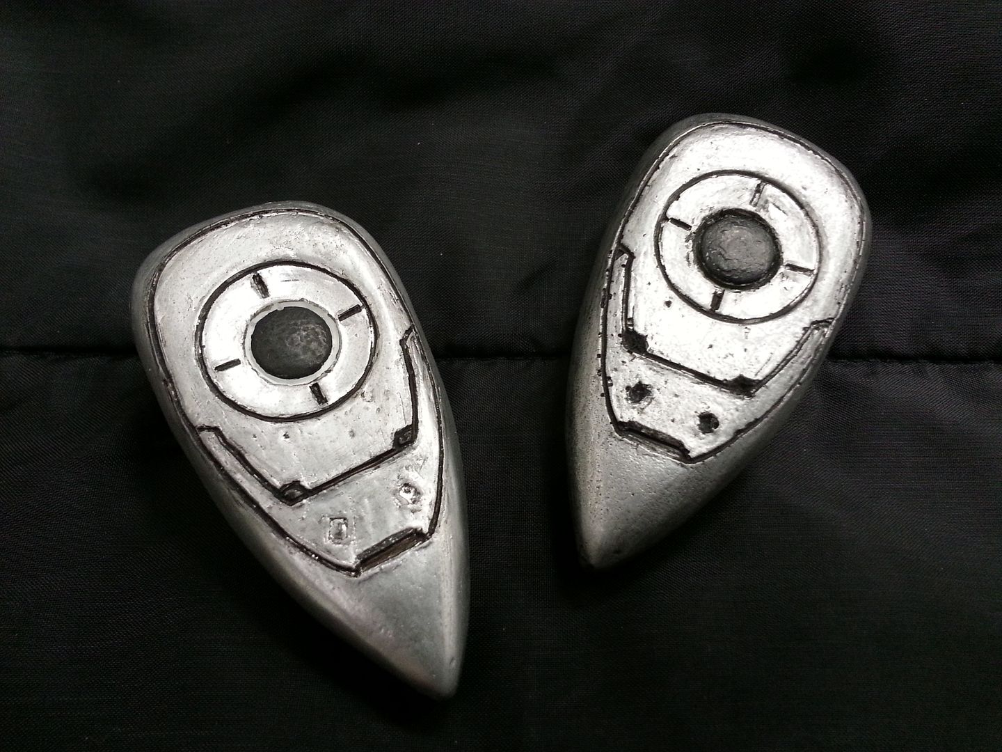

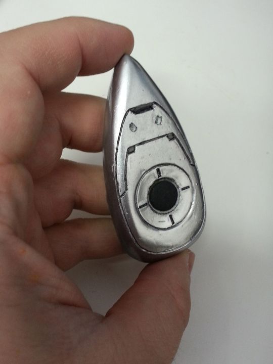

I started with a base matte black to block out the light.
I then sprayed it in a chrome coat.
My first finished attempt after a black wash and some weathering. The thermoplastic is thicker than resin when poured so I lost some detail and it created too many air bubbles. It also took 4 coats of paint to block out the light properly.

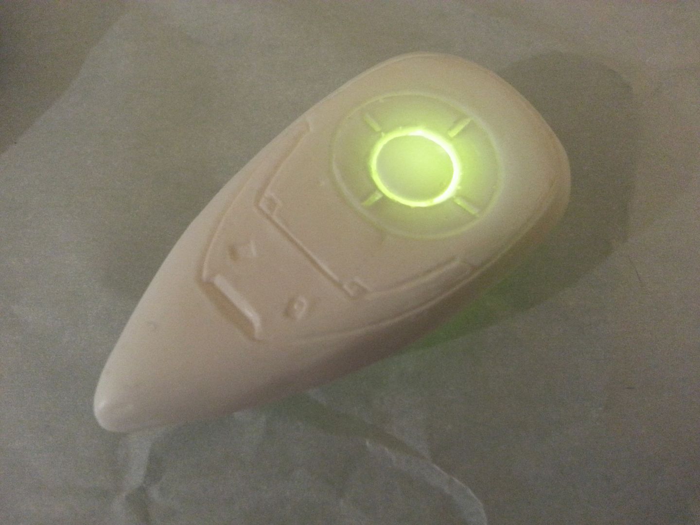

I thought I might try resin to see how the light would shine through.
Here is the same LED under a couple different lighting conditions. Much better!

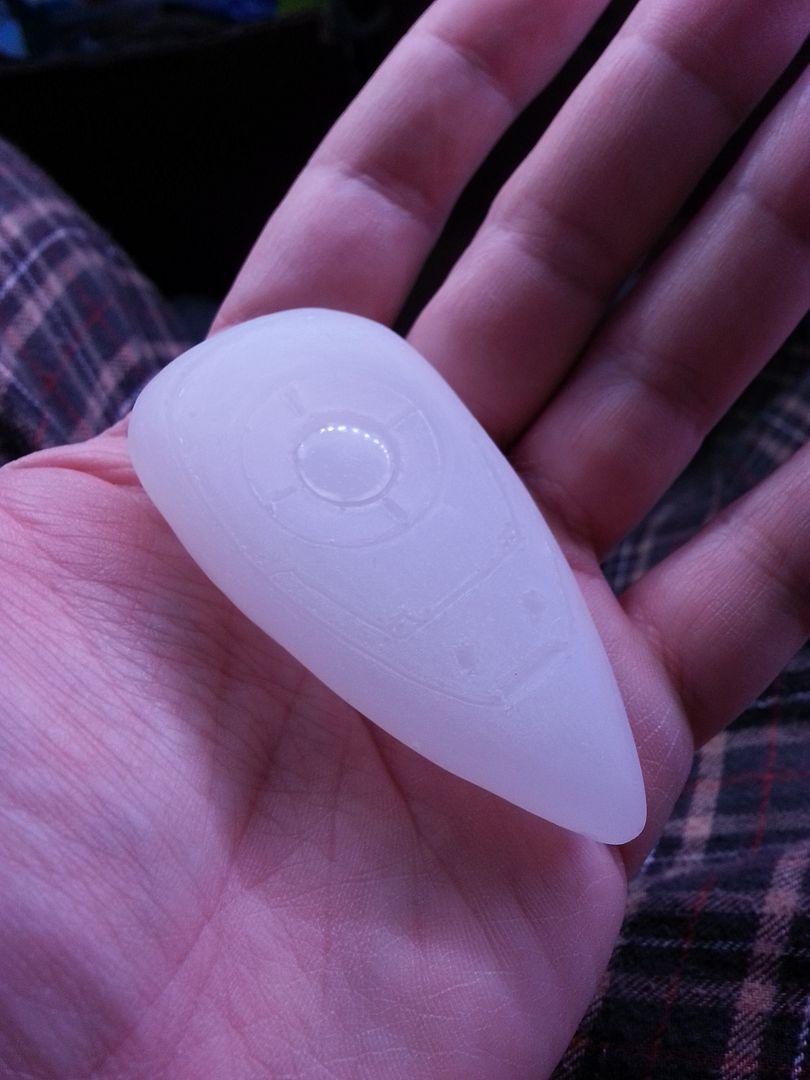

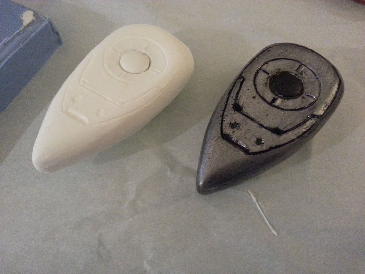

Here is an example of the resin cast straight out of the mold.

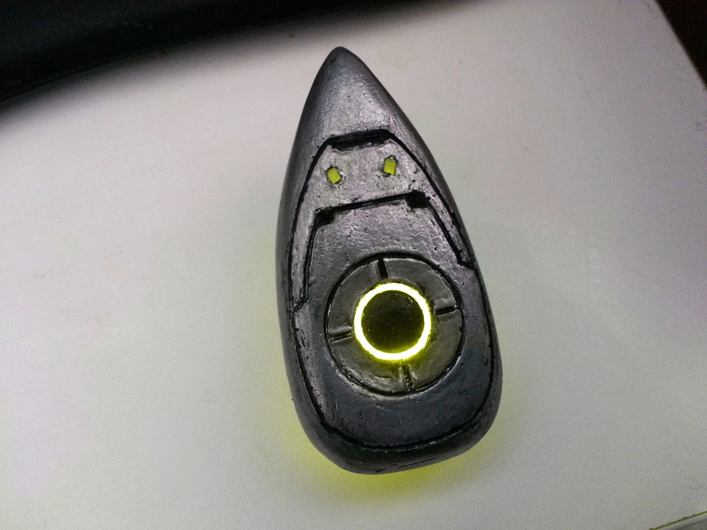

The two versions next to each other for comparison. I wasn't as heavy handed on the weathering for the resin version.

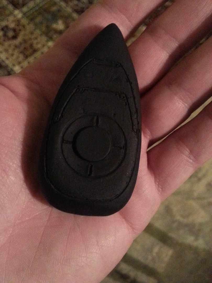

I didn't do any sanding on either of these as they are just my prototypes and I was eager to show proof of concept. The finished versions for the production run will be a little more cleaned up and smoother as you can see here:
The only issue with the resin version is lighting the two sections above the button. I'm still working on a solution to that using a combination of thermoplastic and resin.

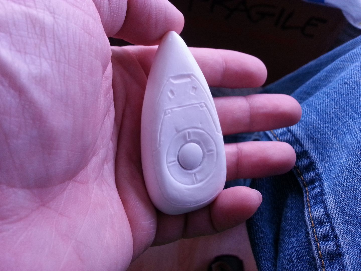

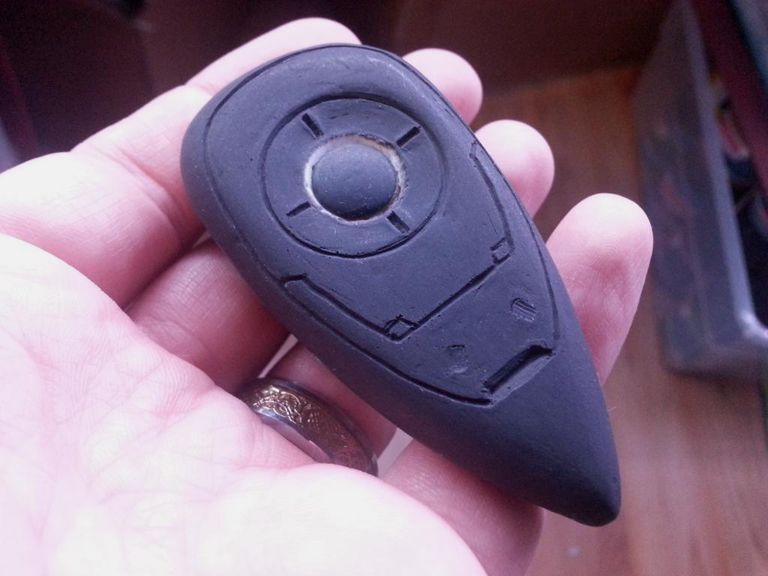

This one was cast with a resin outer layer and filled with thermoplastic. I think it will work! I then sanded with a base coat of matte black. I'll have more to show on Monday.
