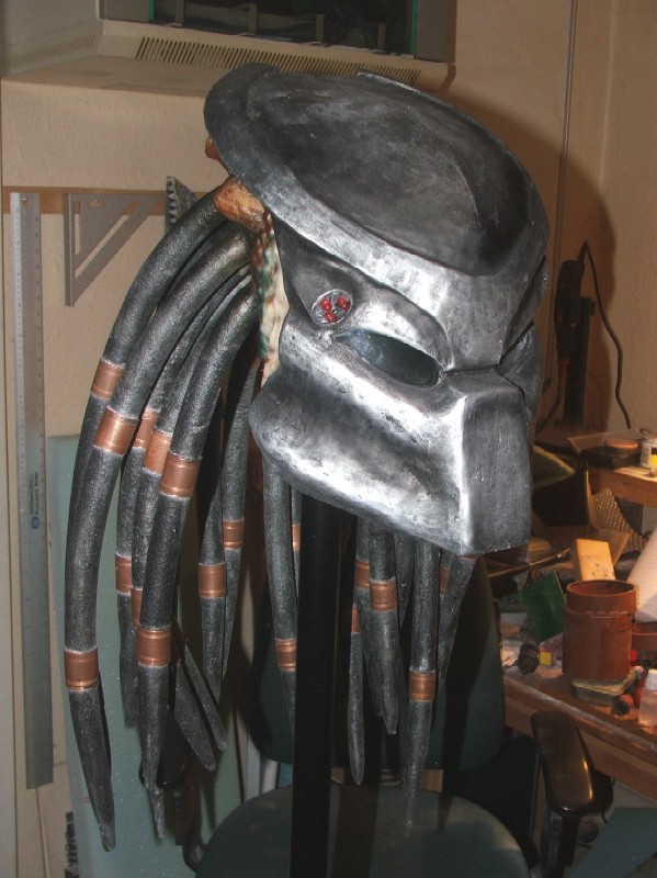

Here's a pic of my Bio and half mask with just the copper fitted. I will post pics of the newer version beads once I have a fully completed one to post.

Here's a couple I've just made, less than 10 mins start to finish. i know it's a quick paint job but you get the idea
