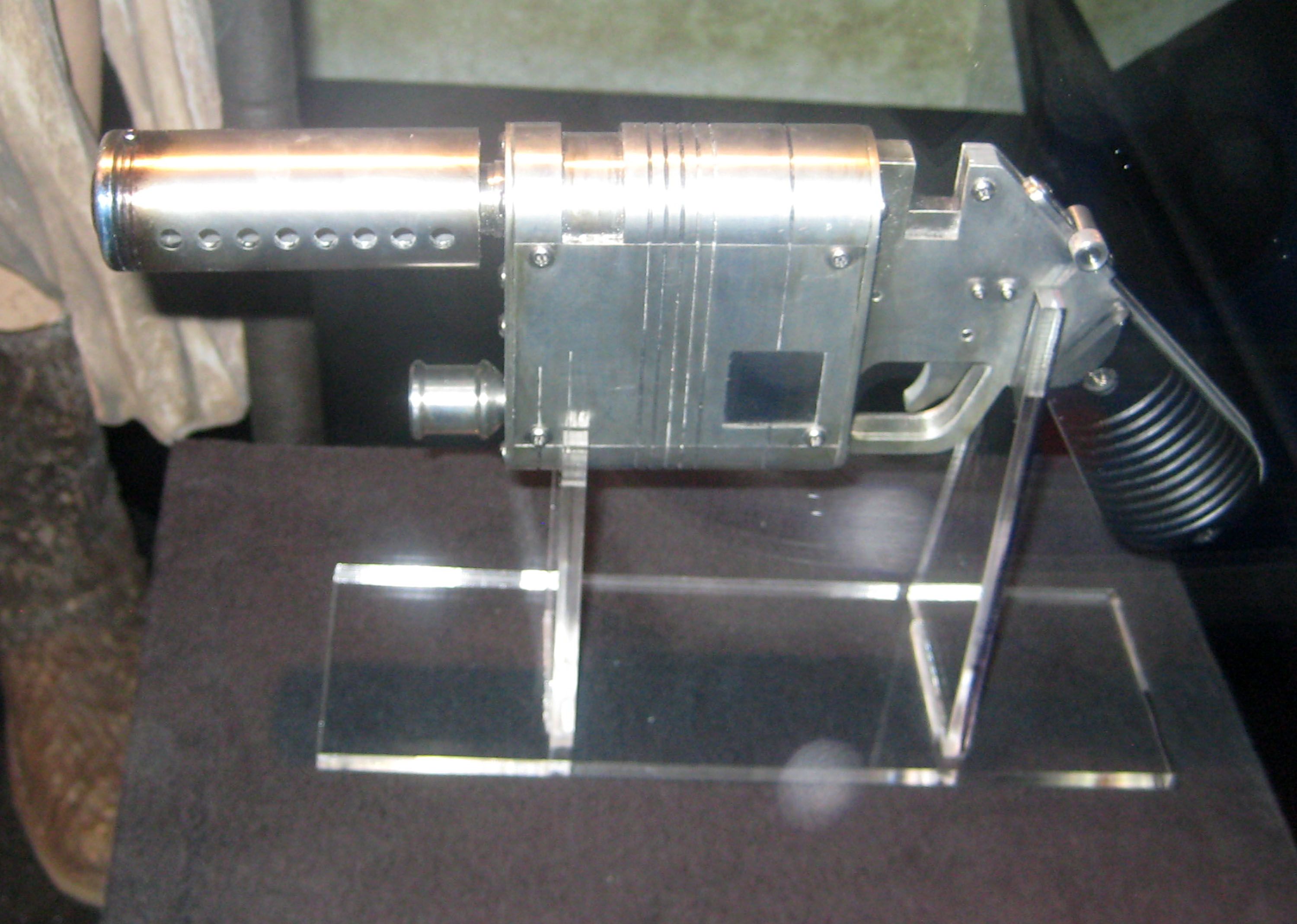

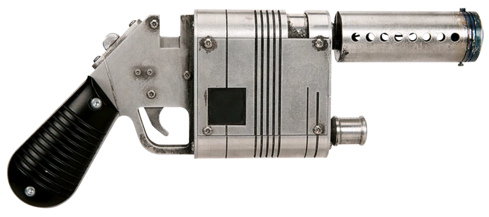

After the epic journey that was the Aliens Pulse Rifle, I decided to tackle something quite a bit easier and attempt to finish it within a week or so. Rey's blaster is a very simple design and interesting one of the few Star Wars props not obviously based on an existing weapon.
The original design I believe was by Matthew Savage so that was the starting point for me.

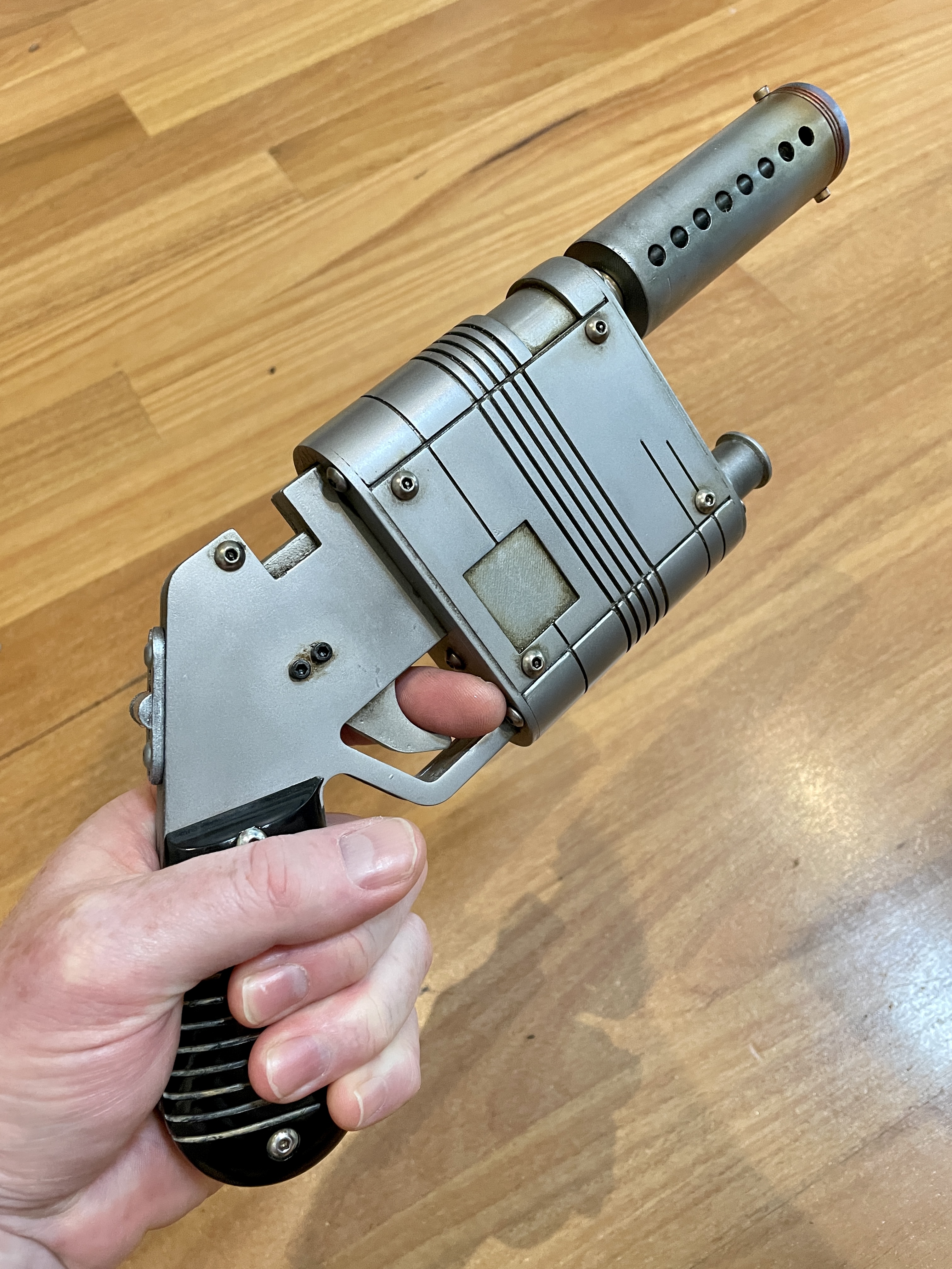

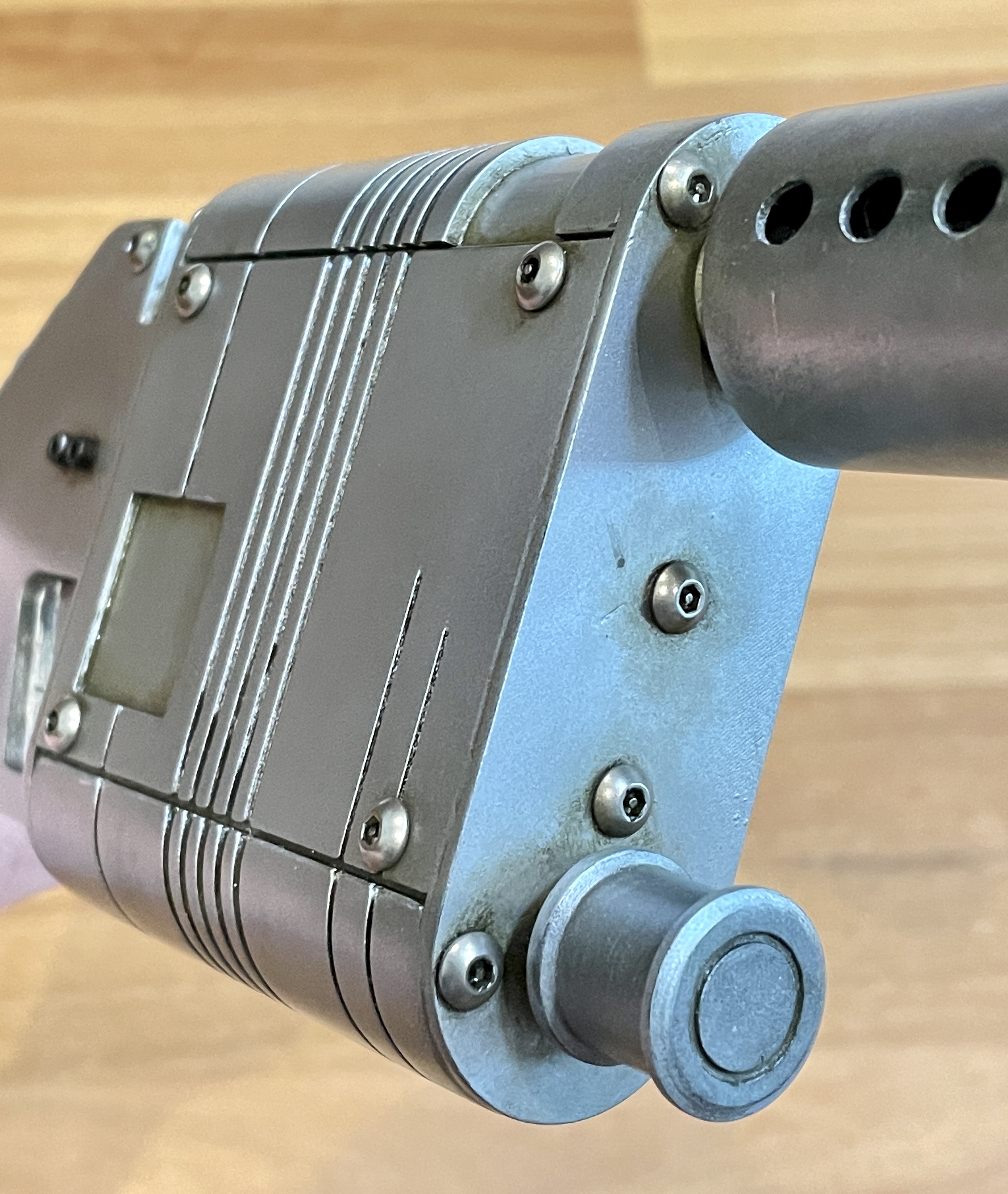

And here's the finished product!
I started off with Alclad Chrome but that rubs off way too easy so I ended up going with a random old pot of Model Master in 'Steel'. Weathering was done with oil paints.
It's definitely not as shiny as the original but I think it has a nice realistic look to it.
