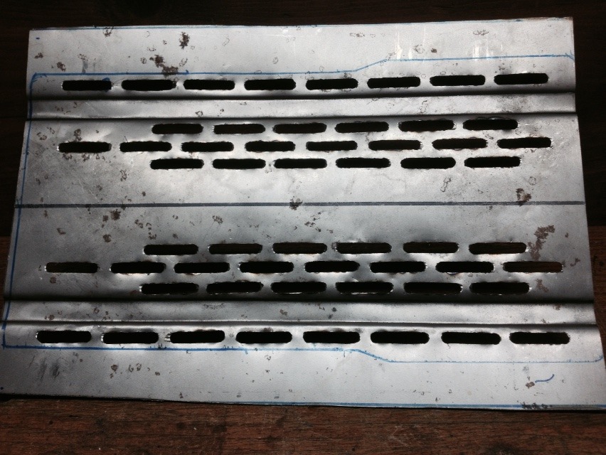

Drilling drilling and more drilling. I tapped in pilot holes to keep the drill bit from slipping. It worked perfectly. Now I have lots of filing and grinding in my future.
Hey look, I fabbed up my first cheese grater!
obiwan kowalski
The hard work is done. I now have a homemade cheese grater (seriously, this thing will take a layer of skin off so gloves are a must). This is definitely a project that requires patience. As I went along I found better ways of cutting the slots. My original plan of using my drill press as a mill failed so I tried many other methods. I am pretty happy with the results seeing as this is my first try at something like this. It is going to be my practice run to refine the process. I have a good idea of how to do the next one much more efficiently with less defects but I am going to complete this one first.
obiwan kowalski
She is rough but you get the idea. With a little paint it should pass the 10 foot test. I am going to weld on the top part of it and cut out the rest of the holes.
funboy1013xx
do you feel afterwards it would have been better/easier to bend the steel first then do the holes? im digging this man! :thumbsup
obiwan kowalski
Absolutely. For the next one I plan on just drilling the pilot holes at the end of each slot first and then bending the steel. After that, drill the full sized holes at the ends of the slots followed by carefully cutting out the slot, connecting the holes. I think I will use this thread as a step by step guide to building another one, that way I will do things in a logical order.
