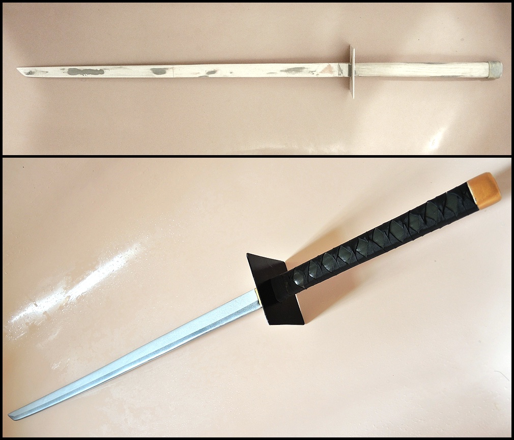

Some progress, I’ve made a faux Ninjato Ninja sword, it seems to vary among comic artists, some have Psylocke with a curved katana, some draw her with a straight Ninjato, but I went with a straight one. From the research I’ve done it seems these swords never really existed historically (unlike katanas) but where made up for Ninja movies, Oh well. Its mostly PVC foamboard, with some balsa to thicken the handle and a little craft foam for the bit on the end, it is a bit wobbly but its is con safe and can’t hurt anyone (unlike my steel one) .
After far to much sanding and filling (why does this form the bulk of most cosplay projects?) I painted it with car touch up paints and some brass Humbrol spray I had lying around from a steam punk project. Wapped the grip with synthetic leather (string ray skin is apparently what you are supposed to use but I didn’t have any handy) and then tried to learn the art of Tsuka-Maki (the very specific way wrapping a Japanese sword the grip with little twists to form diamonds) of a from you tube videos, its harder than it looks. I used black polyester 10mm grosgrain ribbon for the wrap, not purple (sorry Judge Spartan) but they only appear purple in that pic above because the sword was being hit by the purple lights I used to light the background.
The result is well erm, a 10ft stunt prop, not a hero prop, but it will do for cons etc.
