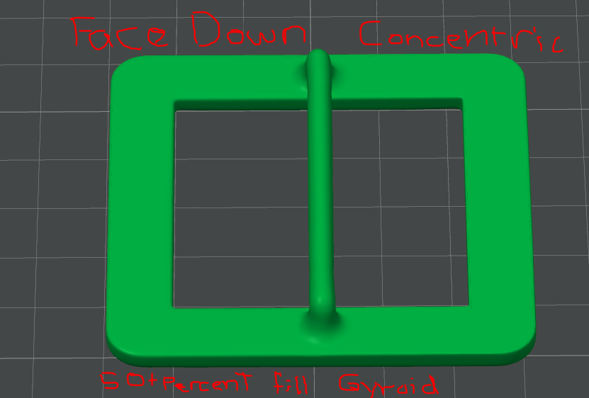

One last caution on this print: let it cool completely before removing it from the print bed. Flat objects warp easily while cooling so it is best to allow it to cool while on the bed. Which of course reminds me that I print this face DOWN with no brim and no first layer expansion and no skirt. I did use tree supports, on print bed only, to support the bar. Printing face down ensures an entirely planar flat face that can be polished beautifully. Do not use raft either. My settings were .12 layer height, .2 line width on first layer, gyroid internal fill at 50% for strength.

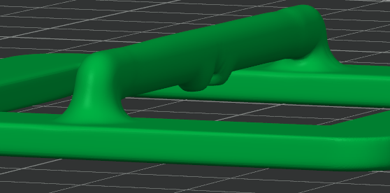

The bottom image is a prime example of something I would usually consider swapping the bar for some 2mm holes in the sides to insert a piece of filament through (for better strength and smoothness)
I hadn't noticed it was all hiding from view until you mentioned it. The bar is decievingly small from that view and the large connections are hidden in the back. I will try to post a better view as it did have serious strength issues and I beefed it up a lot. But it is all hiding in the back. It is now very strong. Sorry that I did not show the upgrades. Will try for today.
Update:
I appreciate you pointing it out. This one was a learning experience for me as I had not known how weak fdm was at layer lines when incorporating a true 90 degree pipe (guaranteeing that at least some section was layered poorly and too small). When I fought with this one, I had a side convo with Jintosh and fixed the issue with the extended back (much taller that it is wide) and the swollen mount points. It went from a snap off piece to very nearly unbreakable without pliers involved. Due to wanting the flat face contacting the build plate (as seen in this picture) and wanting that back bar to print long ways (print follows the bar) instead of causing short sections of print, the alignment on the print bed is very specific as are the specs when printing.
Print specs are concentric on all pattern options except infill which is 50 percent or higher gyroid.

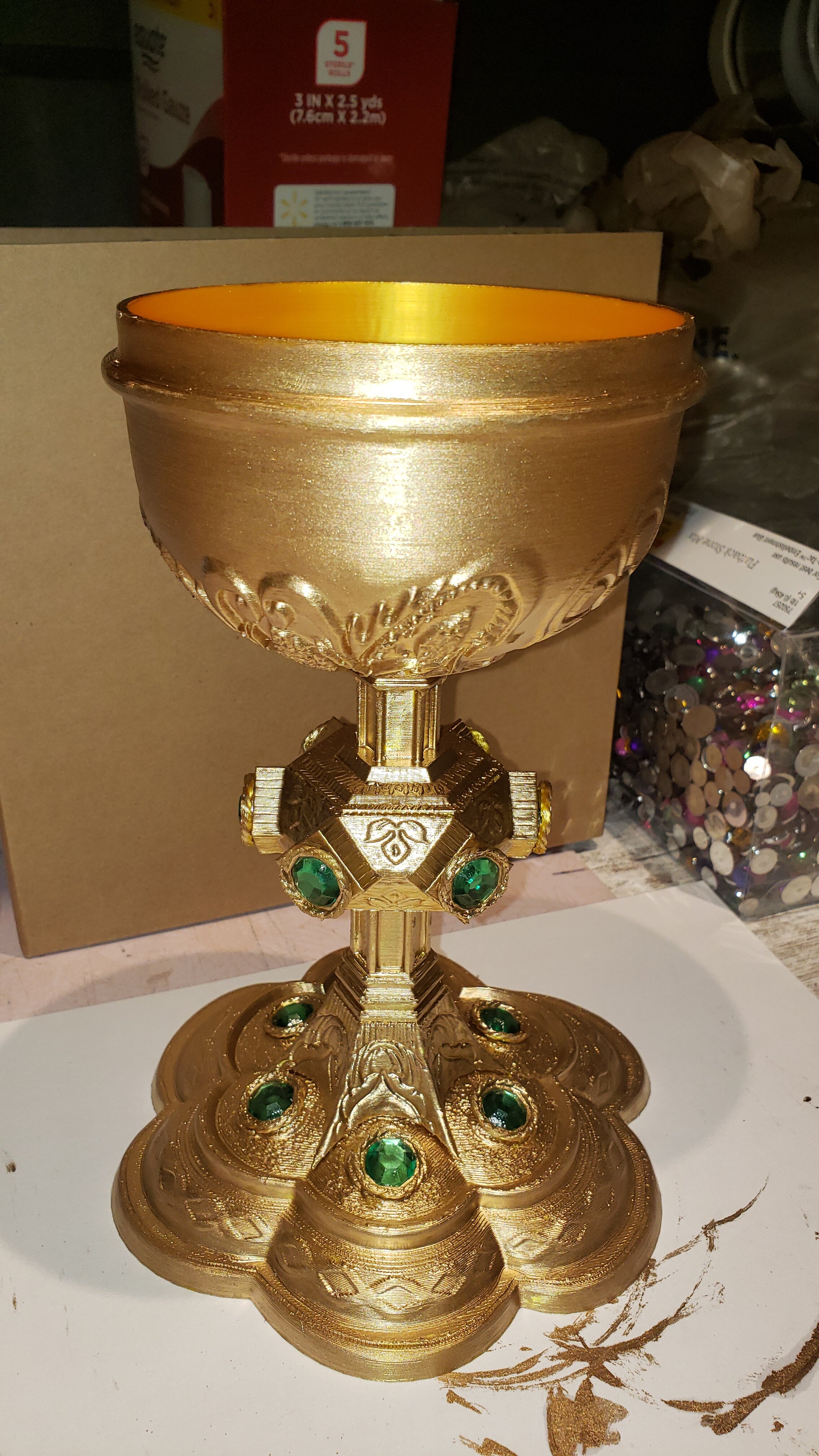

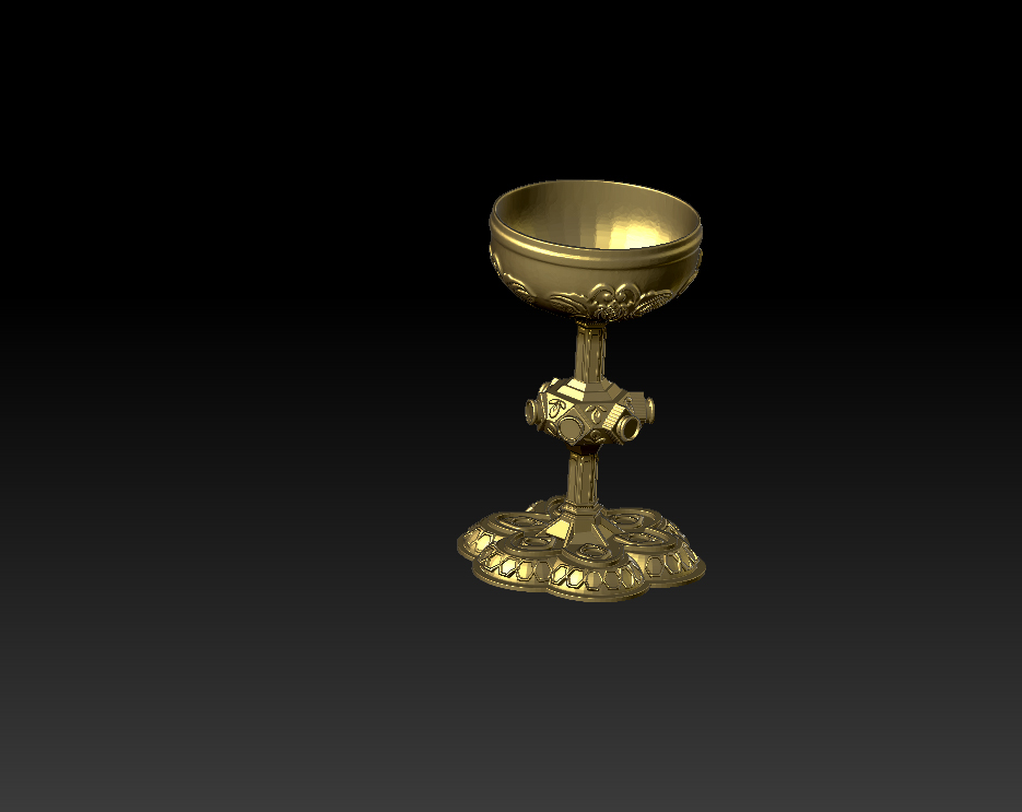

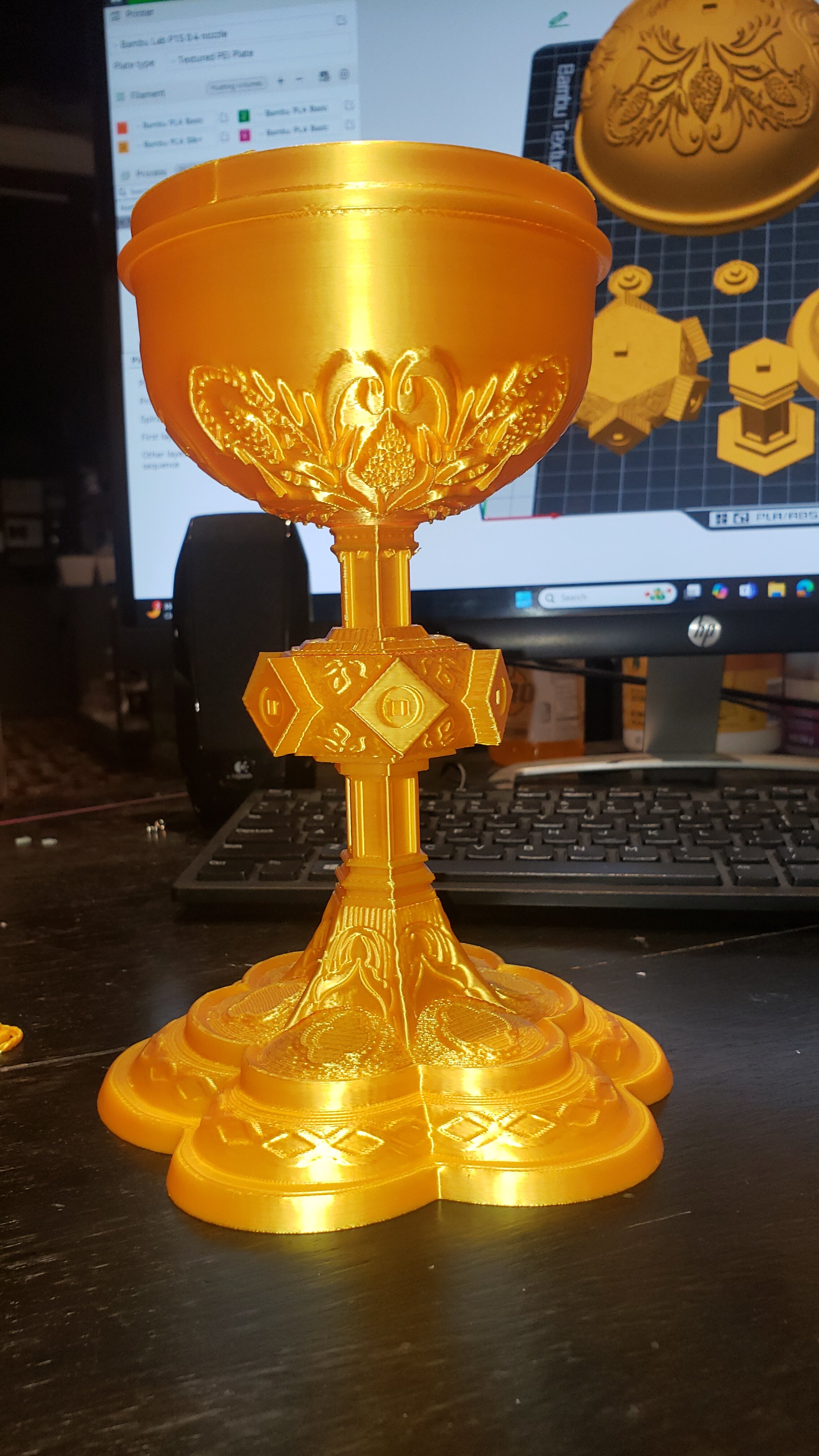

The False Grail v2.0
More accurate than my last false grail. I left room for the green gems.
