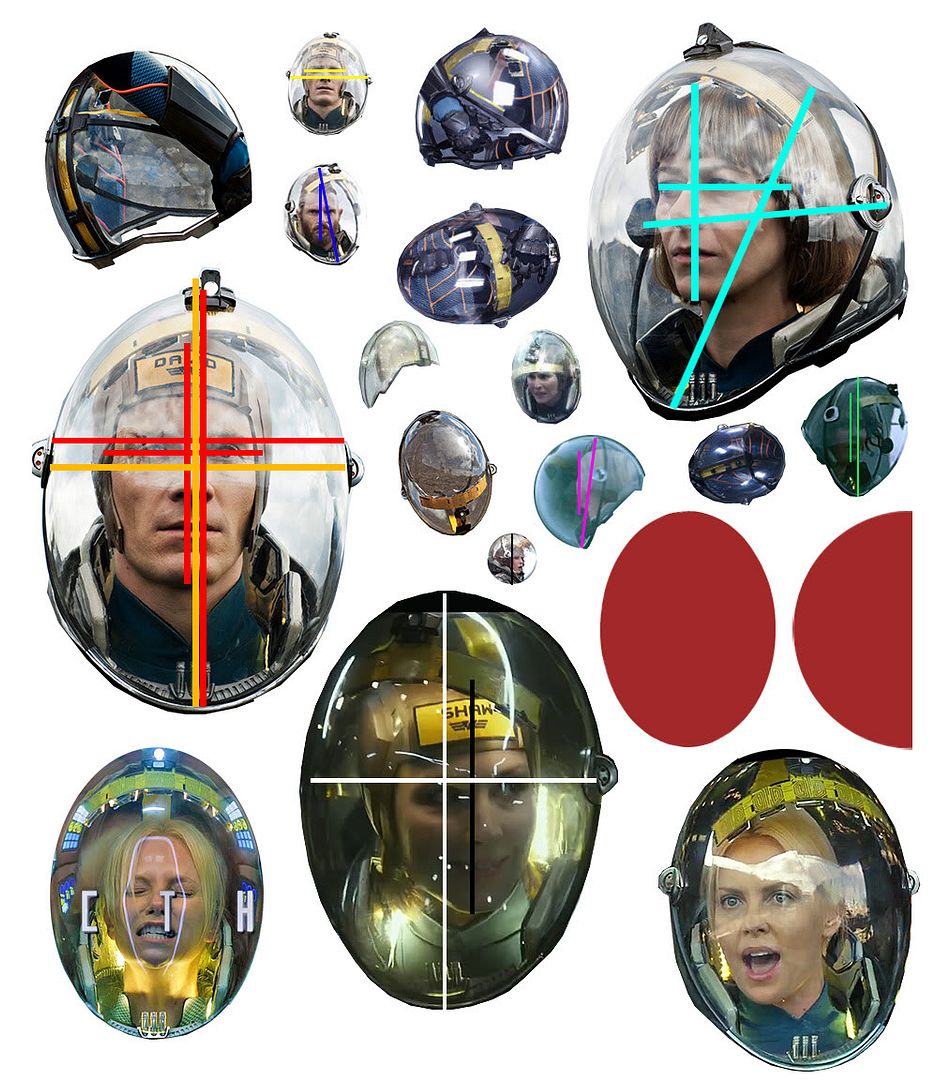

I have seen the film, and I think my model is close to the correct size which is 22" H x 16" W. Those Oval domes look like they could work. Good luck, very cool project.

A bit of an update from the manufacturers of that oval dome I had passed on: the maximum height on the 16" x 20" - which according to Captain April best approximates the Prometheus helmet - is 8"
I can't tell for the life of me if that would be enough, as sadly, there exists no head size chart for individual actors....yet.
Average human head is 6" x 9". The height of the dome must be half the long dimension to get that perfect circle profile. I estimate the measurements for the helmet somewhere between 11-12" w x 16" t, requiring an 8" height.
I've made quite a few measurements from many various pics and screen grabs. Comes out the same every time.
I'm contemplating building one myself.
Hope this helps you on your endeavor:
