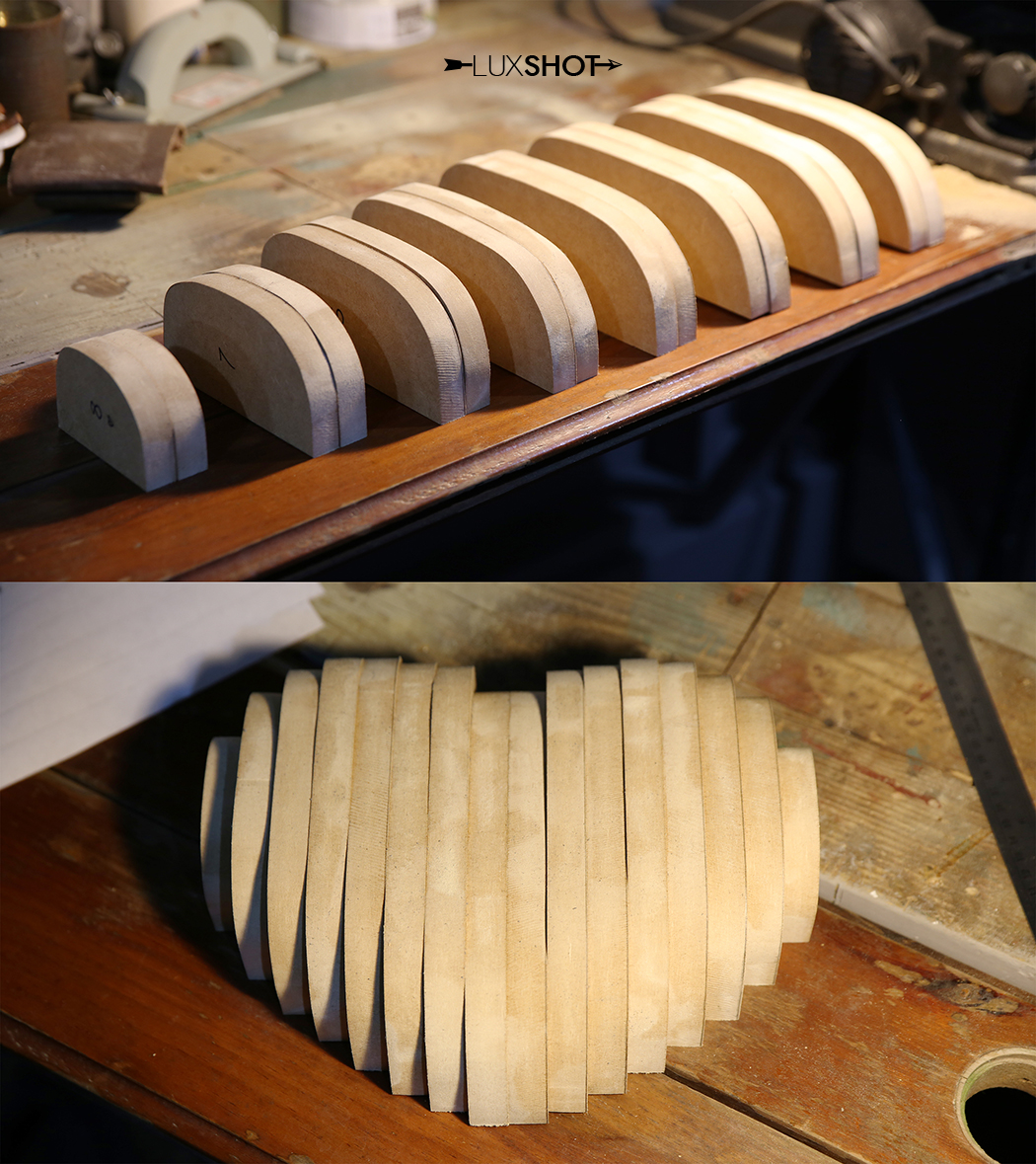

  • I figured a way to make it with wood. Maybe this isn't the best way to do it but for me this worked great. I used the foam I first used to do the mask, cut it in half and sliced one side in to 8 pieces of the same width of the wood panel I had. Once I had the pieces with numbers on it, I traced each piece in to the wood and cut two of each one, that way I had two symmetrical parts of the "heart" shape of the mask.
  • [*=center]And this is how it turned out!
  • This is what happens when you combine a lot of patience, sanding and love... you get a really cool heart.

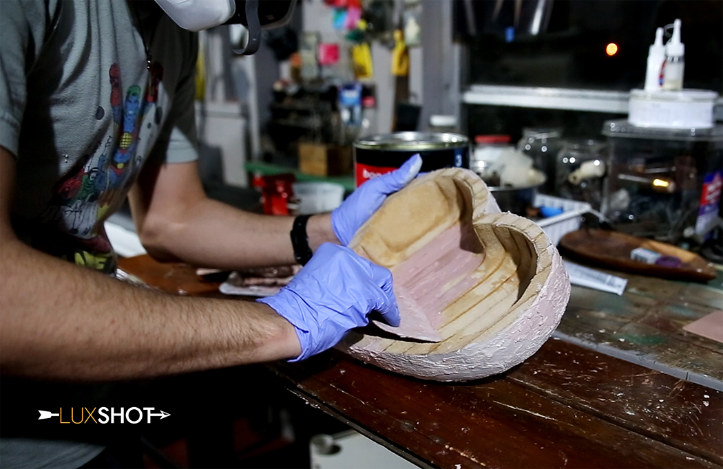

  • Finished making the mask hollow. With the Band Saw I cut the inside of each slice so when all were put together, voilà! got myself a hollow heart!... though that sounds kind of sad...
  • Bondo! this worked great to fill up the imperfections that the mask may have and make it even and smooth.
  • Sanding, sanding, sanding... After applying the Bondo I had to sand everywhere I used Bondo to make it nice and smooth.

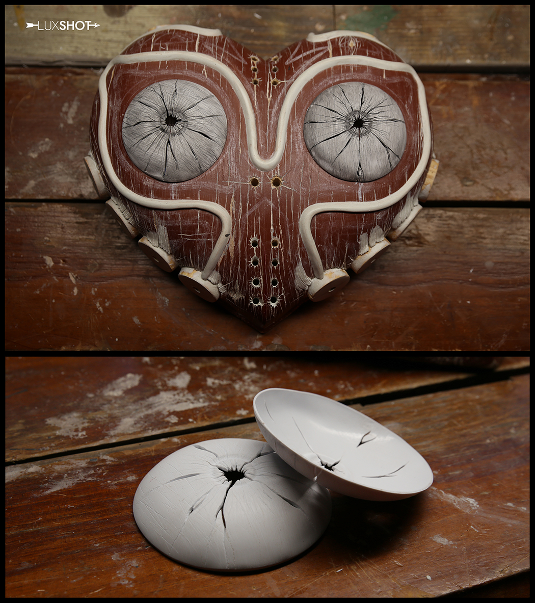

I made an eye out of wood that later will be used to make both eyes in plastic by heating a piece of styrene plastic on top of this piece so it will then be molded by this form. By doing it this way I can have a hollow eye where I can install some leds to make glowy eyes.
Lux Shot
This process might have been way easier if I had a Vacuum forming machine, but since that's not the case I had to find a way to achieve the same results with what I had in hand at the moment. So this is what I did: First I cut a circular piece from a styrene sheet, then placed the plastic on top of the wood and using a heat gun I heated the plastic so it would start getting molded by the wood piece. I had to stretch down the plastic a bit while it was still hot for it to be completely molded. Finally I cleaned the excess from the bottom. Now that I have the two eyes made in plastic it's time for detailing!
