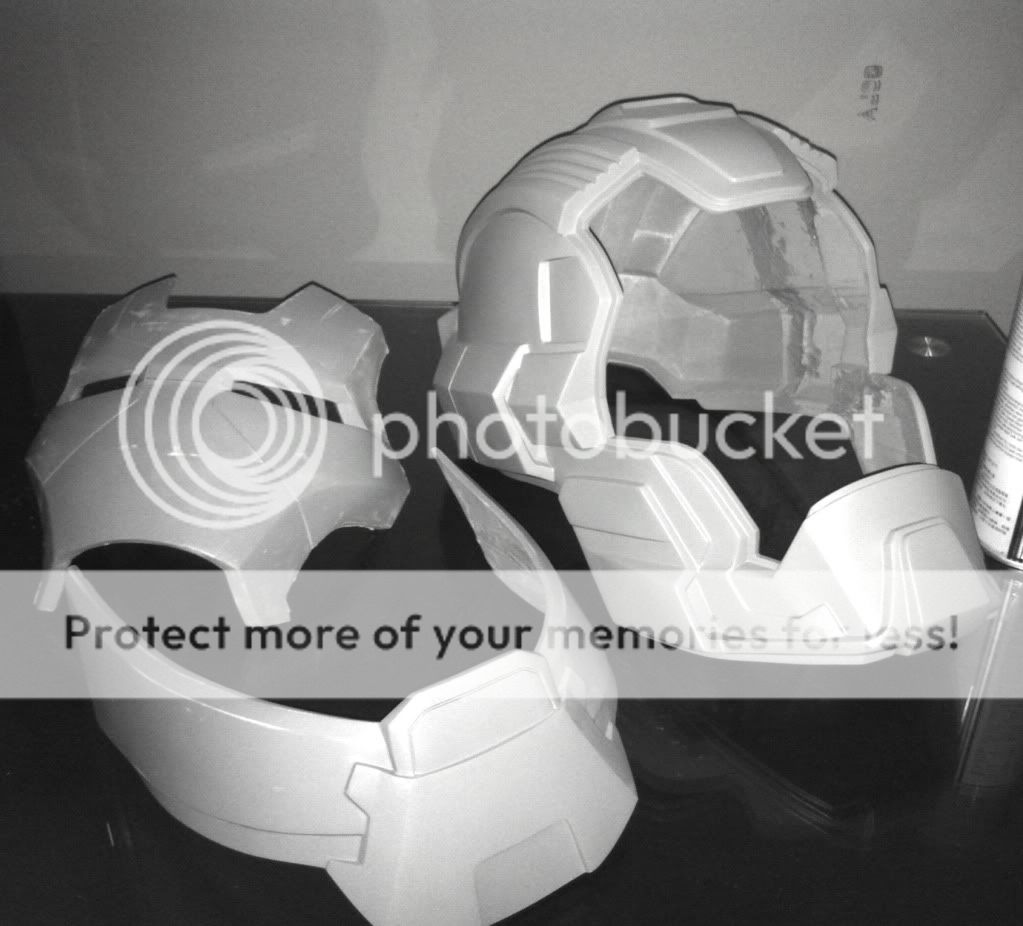

The model was printed by the Replicator 2 desktop printer, and spliced out into pieces (due to the print size restricted). All I have to do is glue all pieces together and mastering it. Here is some of photo in progress (I didn't took all pics, hope your don't mind).
Printed piece freshly out:lol
I have the face plate printed and smooth sanding for two layer prime:)
and combine with some pieces out from printer, glue and put together:D
This helmet design jusr rocks! plenty of detailing needed to model and a lot of hard work and afford to put into the sanding work:sleep...So here is what I reach now...
Current only left to fill up the inner ear like all those inlet hole, then I think that this helmet will consider as done:), but issue that slow me down is just the inlet hole bit too narrow to access and reachable area is small, I will have to use small file to deal with it part by part.

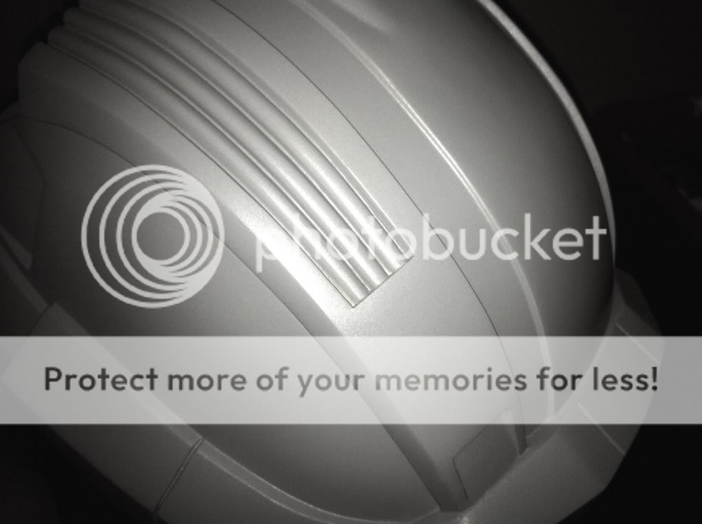

Here is my today progress, sharpen where the three groove join to.
And here is the all 3 pieces.
That's it.
