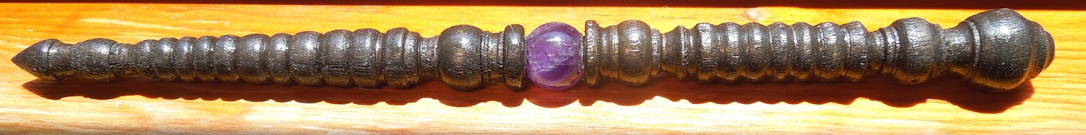

Here's my attempt to make a Prof. Umbridge wand:
attachment.php
It's based on this image from Pottermore and info from the HP wiki site:
attachment.php
It's actually made of birch and is 8 inches (20.3 cm) long, turned in 2 parts on a lathe. The 13mm purple sphere is real amethyst.
I thought it odd that Noble USA and Universal doesn't sell this wand (It is available from Nobel.uk). I recently was told that they figure Umbridge is so disliked (OK - she's evil :) ), that no one would buy her wand - so they don't carry it.

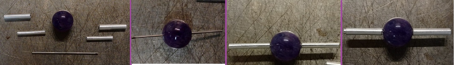

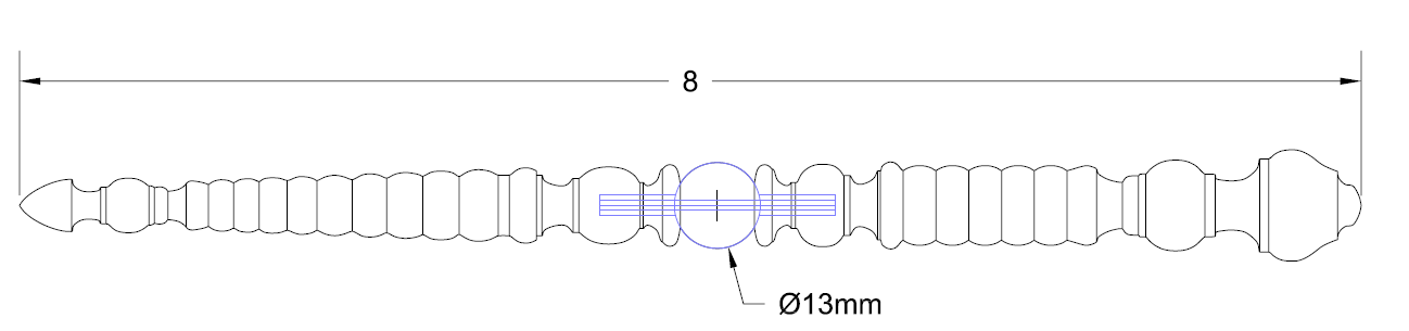

The sphere is actually a bead (ETSY) with a hole through it. I epoxied a short piece of piano wire through the hole then added some aluminum tube to make it an 1/8" diameter.
attachment.php

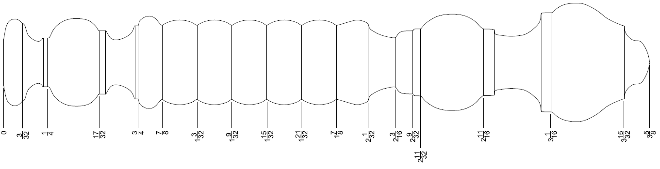

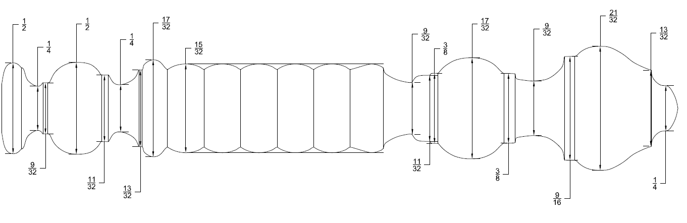

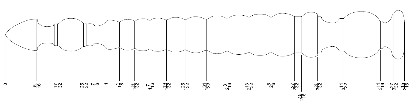

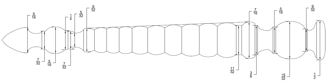

Here are a couple of dimensions I used for turning the 3/4" birch dowel:
attachment.php
attachment.php
attachment.php
attachment.php
attachment.php
If you prefer centimeters, I'll ley you do the conversions:lol.
