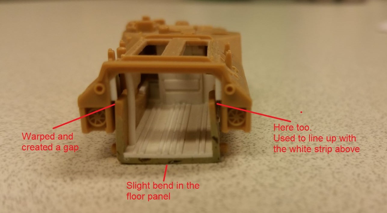

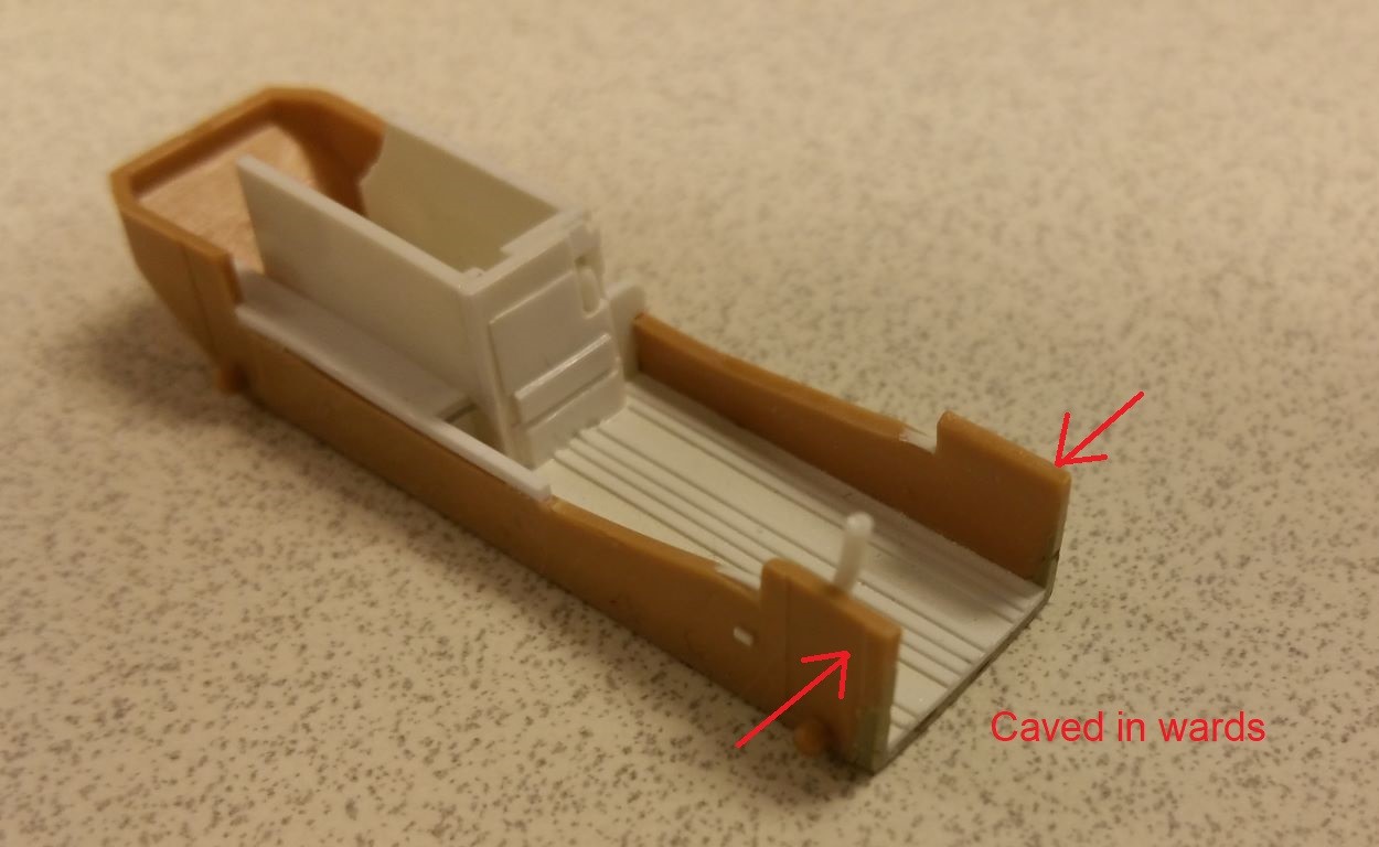

Waketrail
Thanks for all the advice. I thought bonding through melting would be the best thing to do when working with plastics. Maybe I continue doing so but using less or only bonding a bit each day.
The pictures show the actual model kit warping (1/144 AAV-7A1 by Trumpeter). It only seems to happen when I use plastic strips for detailing. I guess I am using too much cement.
