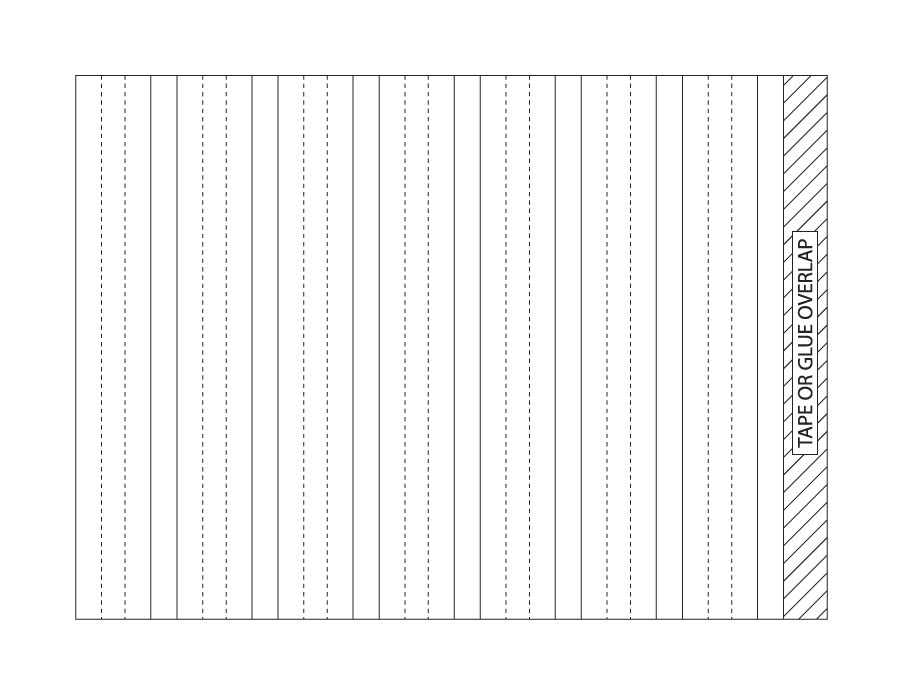

For those of you who have applied tracks to sabers in the past, what kind of process have you used to ensure that they are strait and symmetrical? I'm clumsy as all get-out and assume I will either get them on slightly crooked, or one track will be too close to one and too far away from another. Is there some sort of guide that helps you to do this? Do you just eyeball it? Are you marking up the flash with lines or something to know exactly where to place the tracks? I'm sure these are all stupid questions, but any advice from folks with experience is appreciated.

As for placement, there's various templates out there you can google up that are easy to print out and tape onto the flash to give you guides. Personally, the six-grip option I've found easy to eyeball. You get the first into the place, then play opposites. But for the odd numbered 7 grip situation-- my OCD couldn't handle it so I had to use the template.

I use e6000 glue for the grips. I was nervous about this at but e6000 has been recommended by a number of people and it worked out perfectly. As for placement I would definitely use a template. I believe parts of star was has a template for Luke ANH that you print out and wrap around the tube to mark top and bottom placement. If you need more or less grips I would make a custom template. Good luck.
I used a two part epoxy, works great and drys fast. For keeping it straight, I used the template from partsofstarwars 7griptemplate.jpg
To mark it on the saber I cut knotches about 1cm into each of the spots for the grips, making sure to leave the spaces in between at full length.
