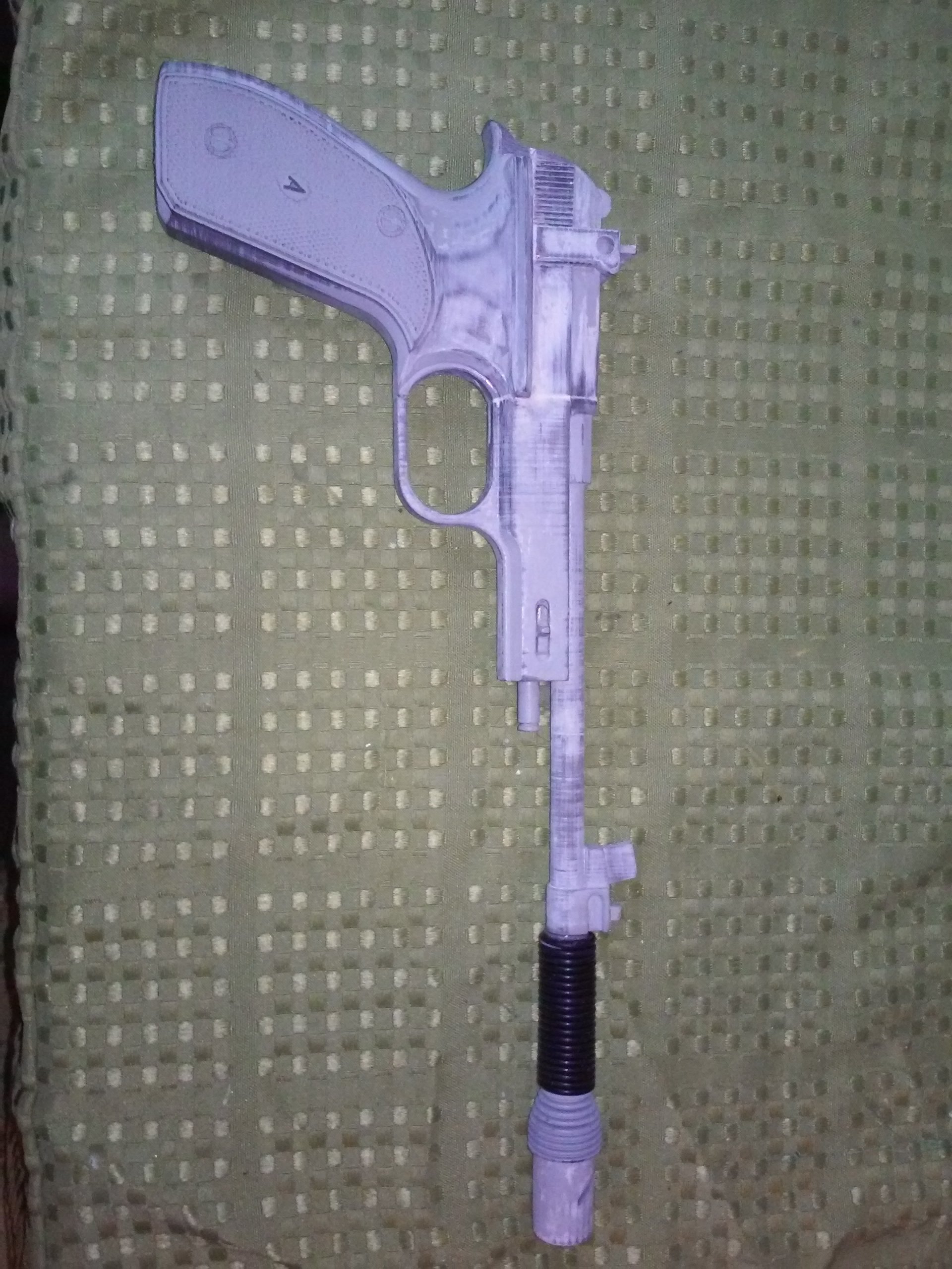

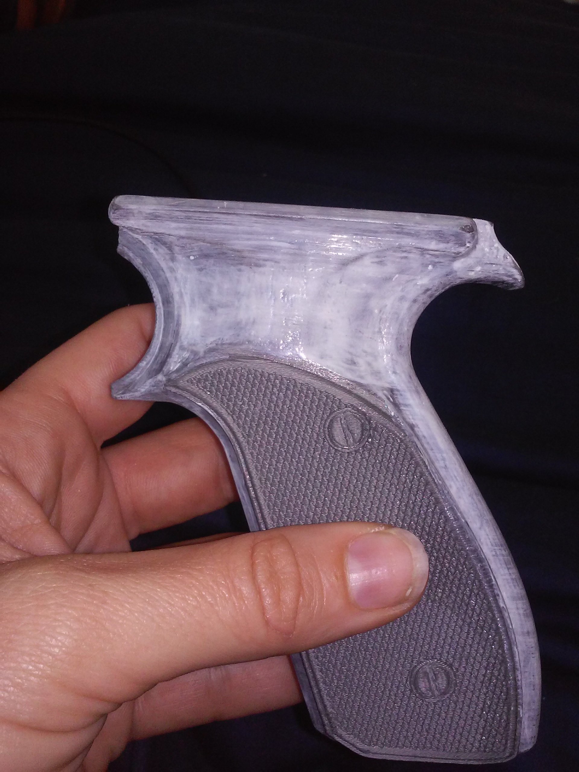

First I sanded down all the pieces, then melted white legos with acetone and painted it on, so that the sides would be smooth and uniformed.

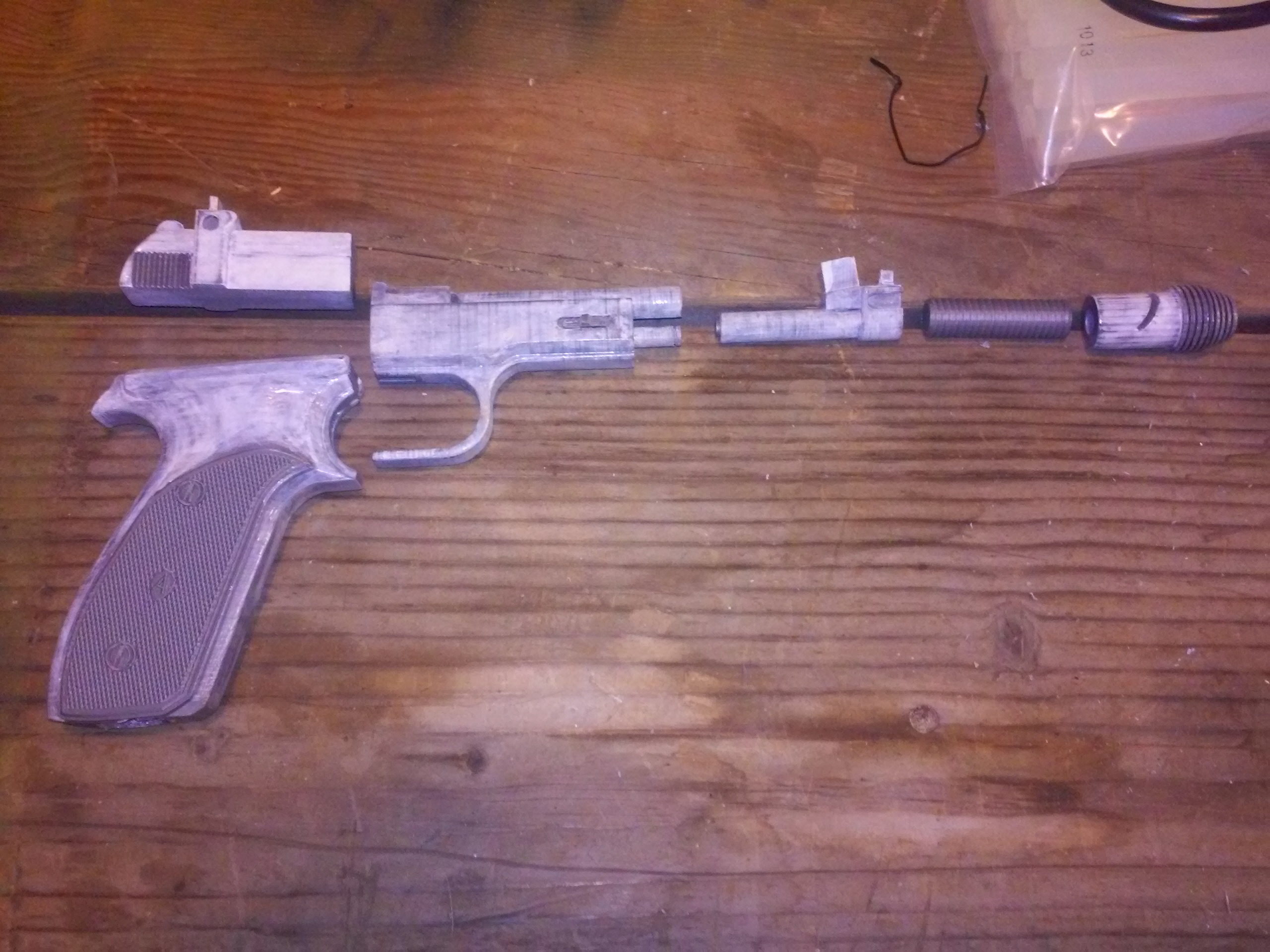

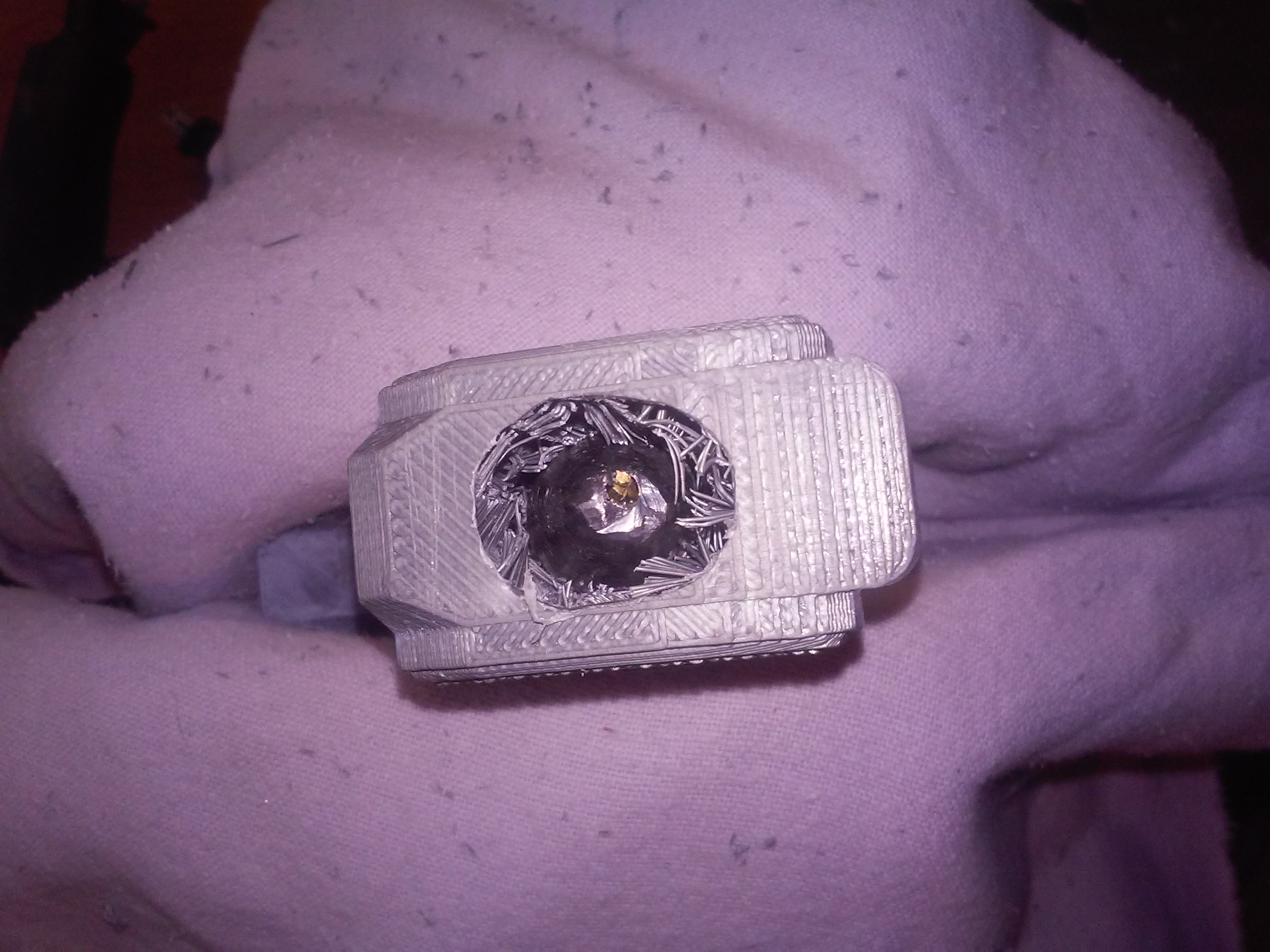

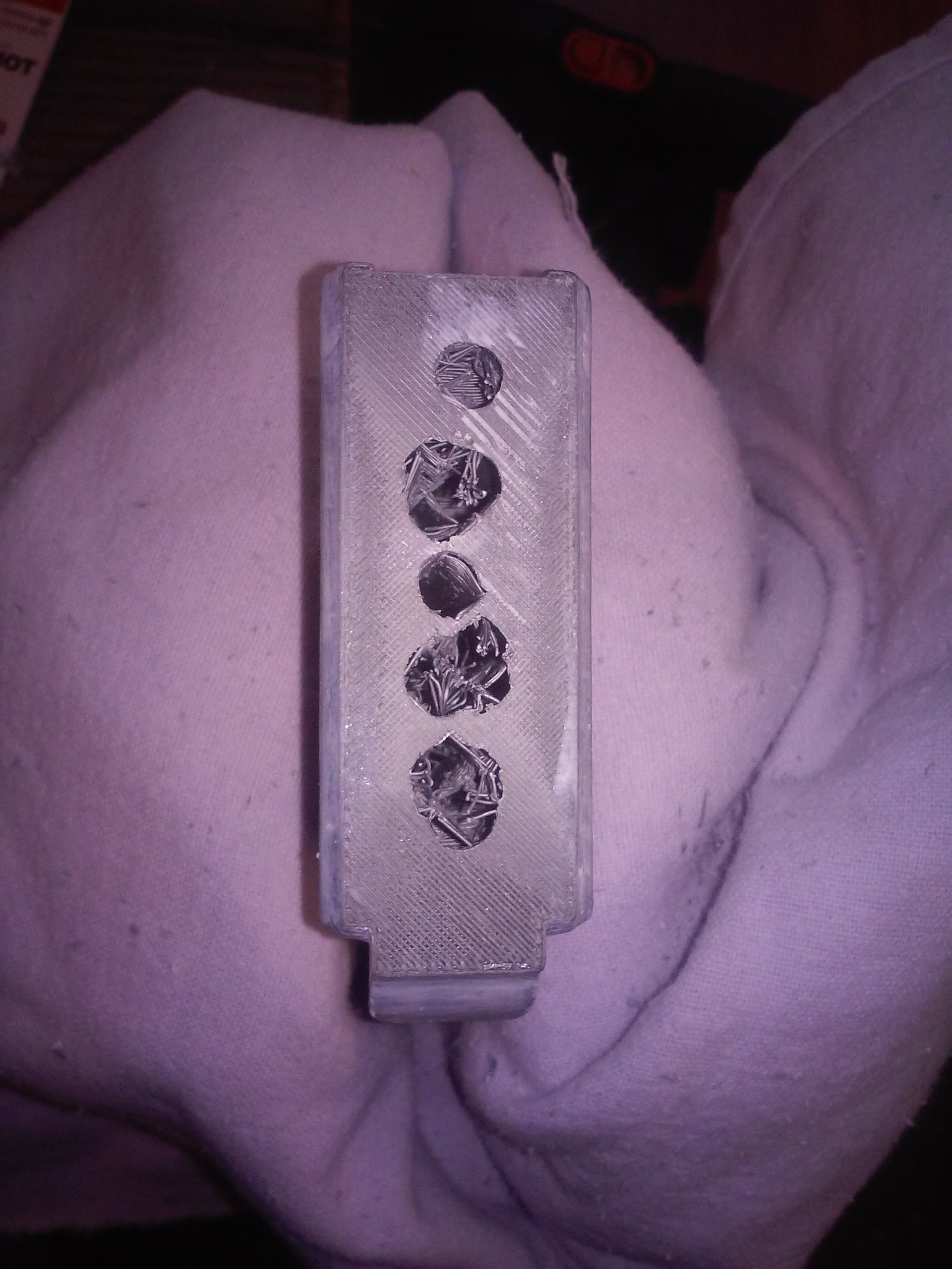

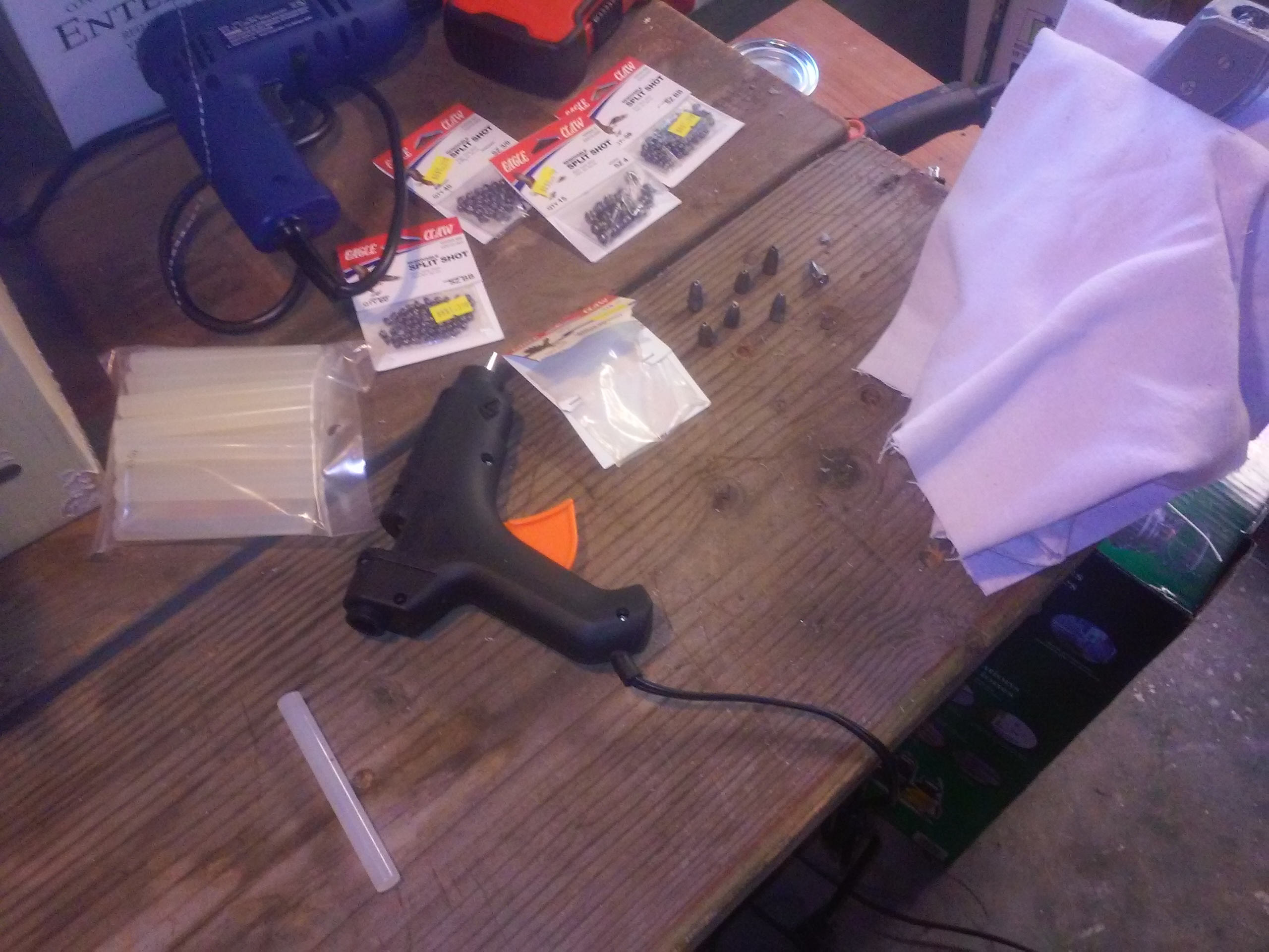

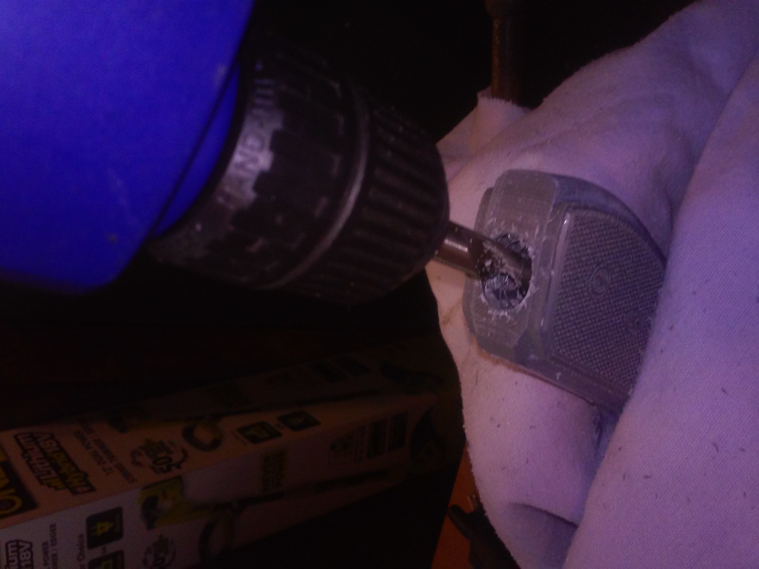

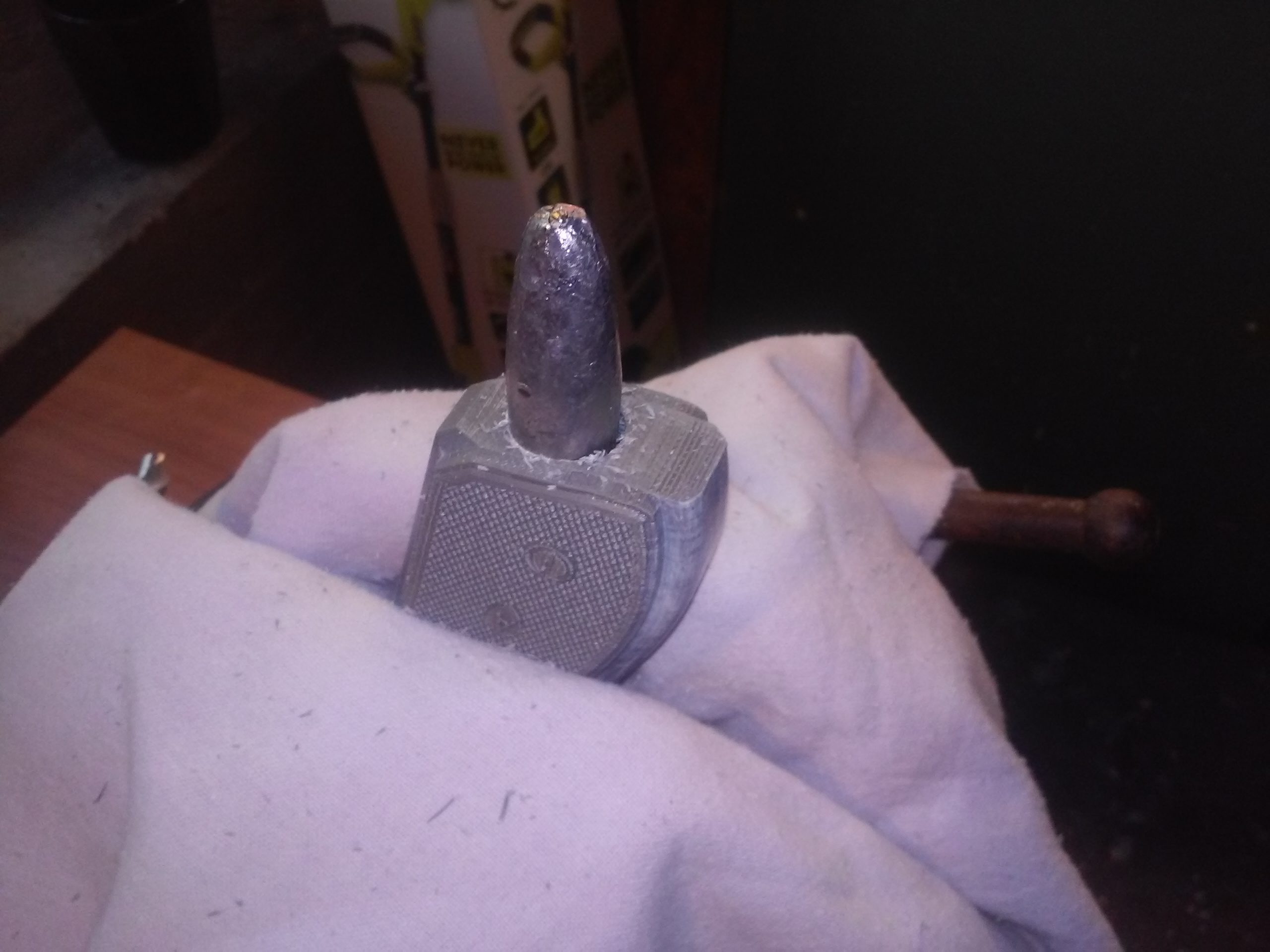

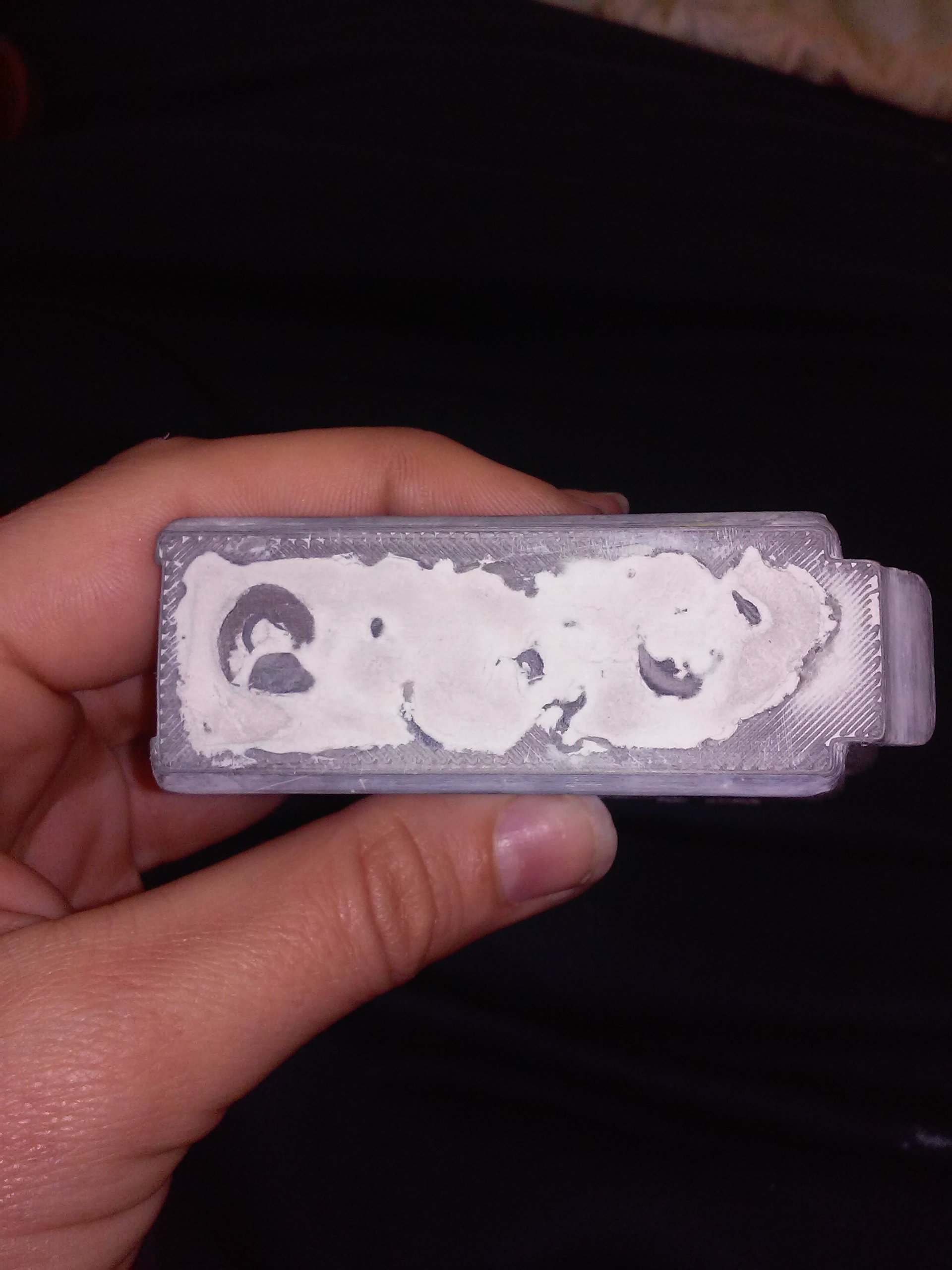

next to give it weight I drilled holes in the three largest pieces, filling it with fishing weights and filling it in with hot glue, topping it off with spackle.

glued together and sanded, with rods between the long thin shafts. i added plumbing o-rings to give a more real look on the ringed section.

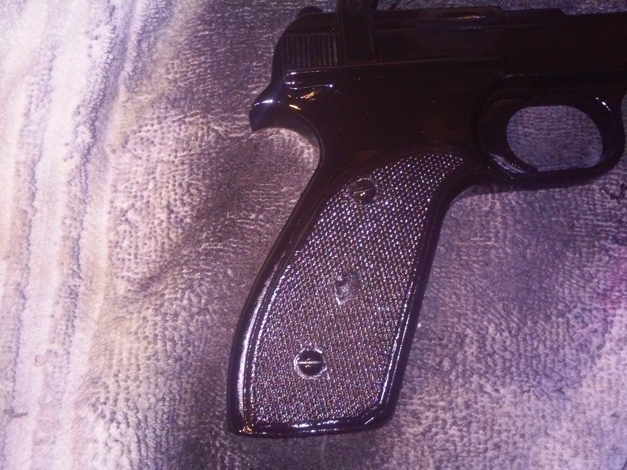

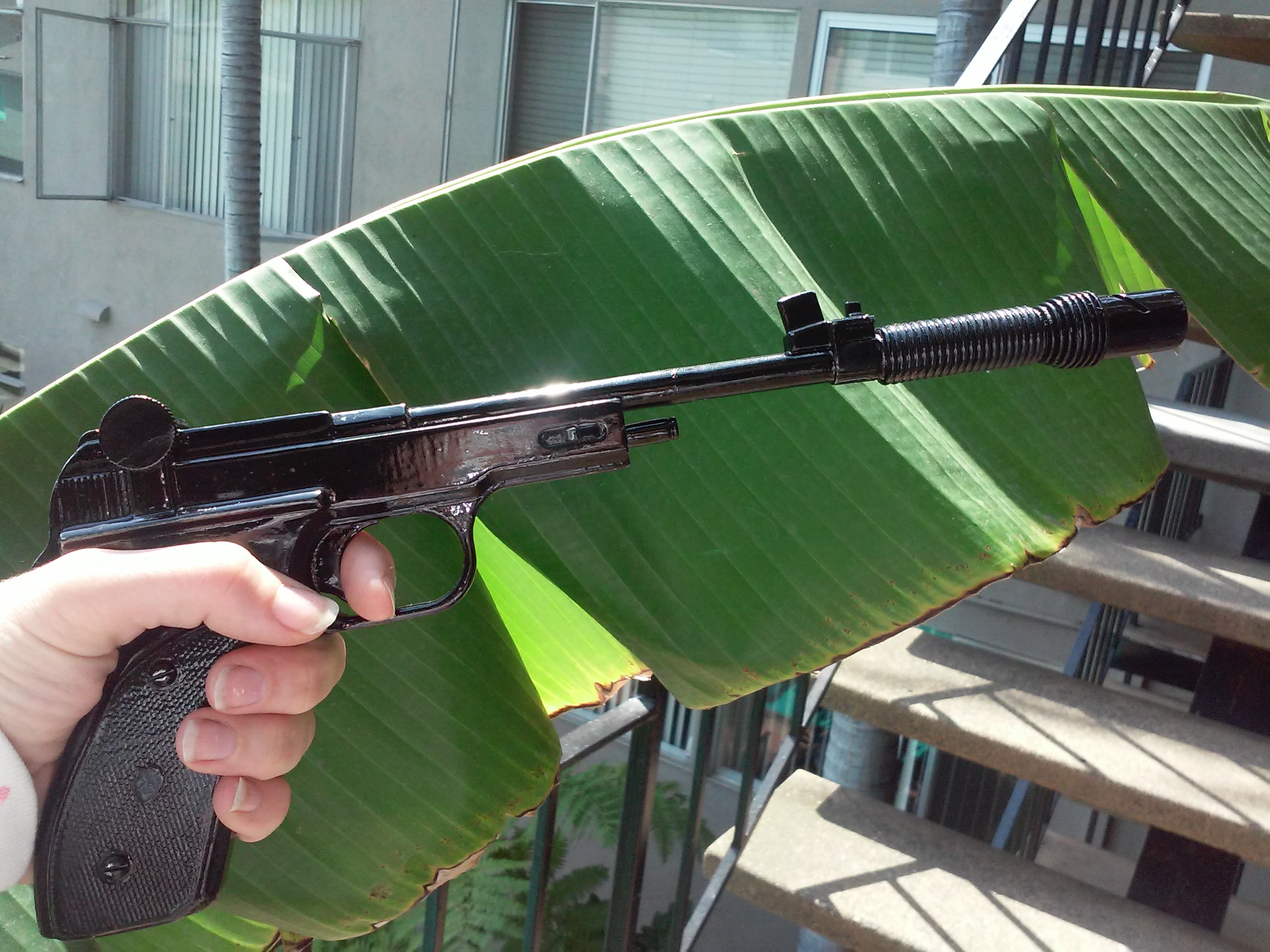

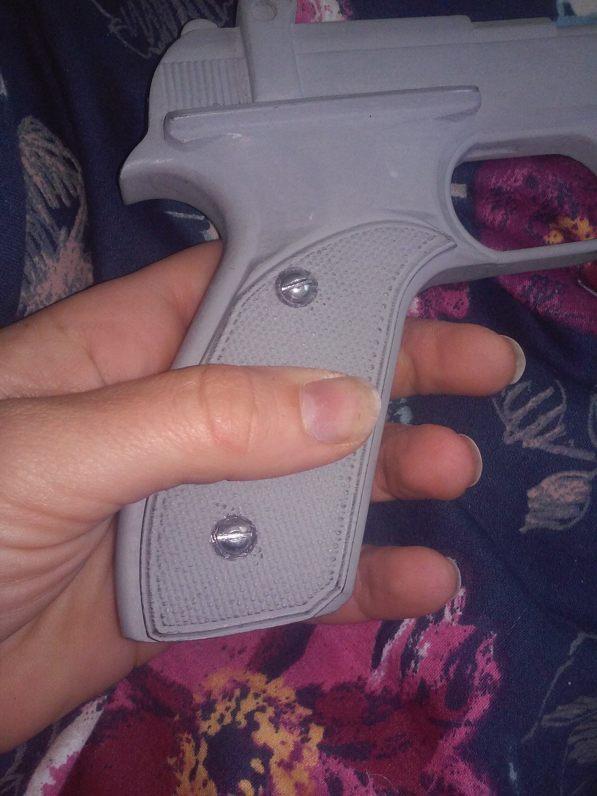

sanded off the fake screws and drilled in real ones, before inserting i filled the holes with hot glue.

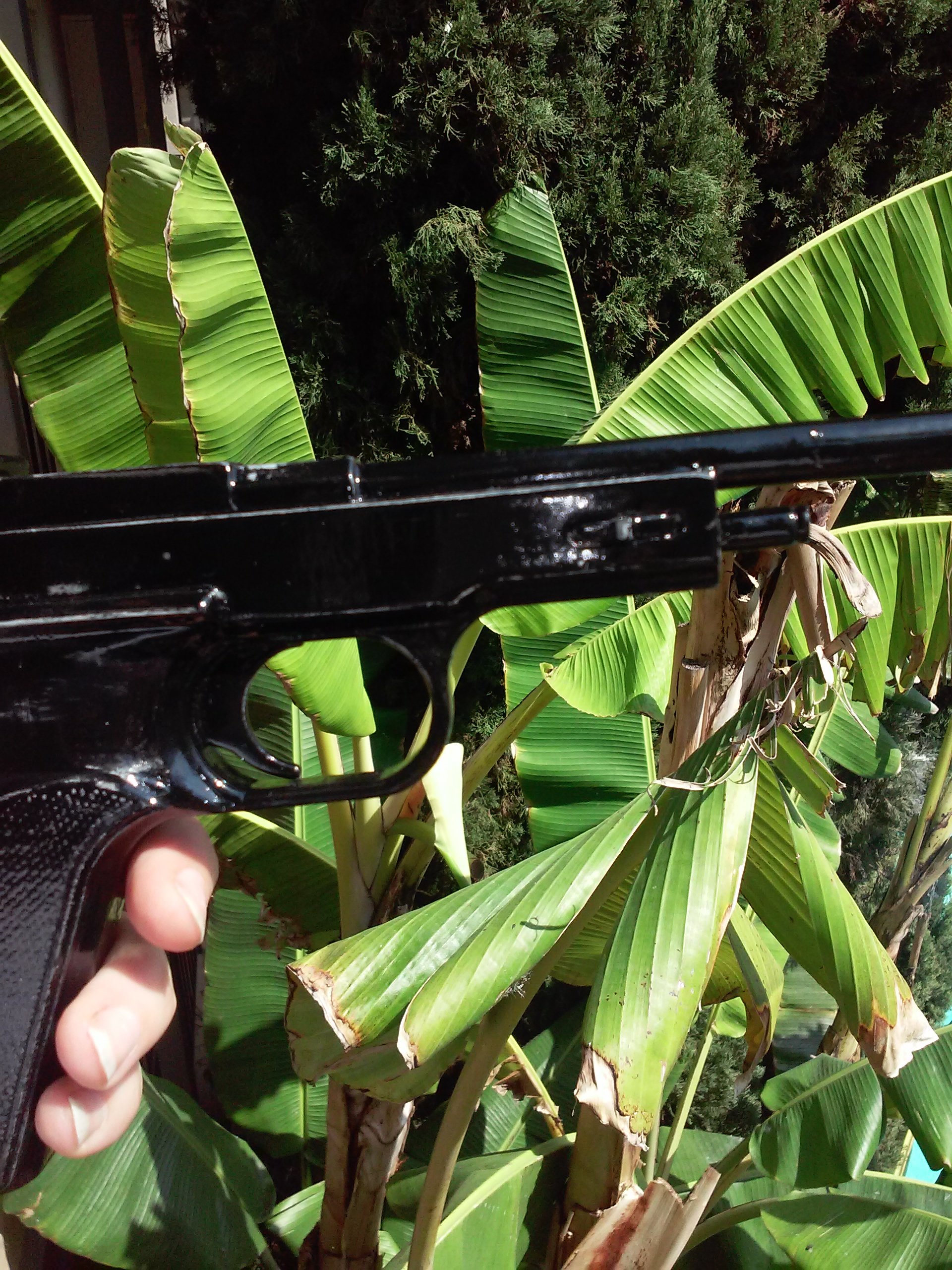

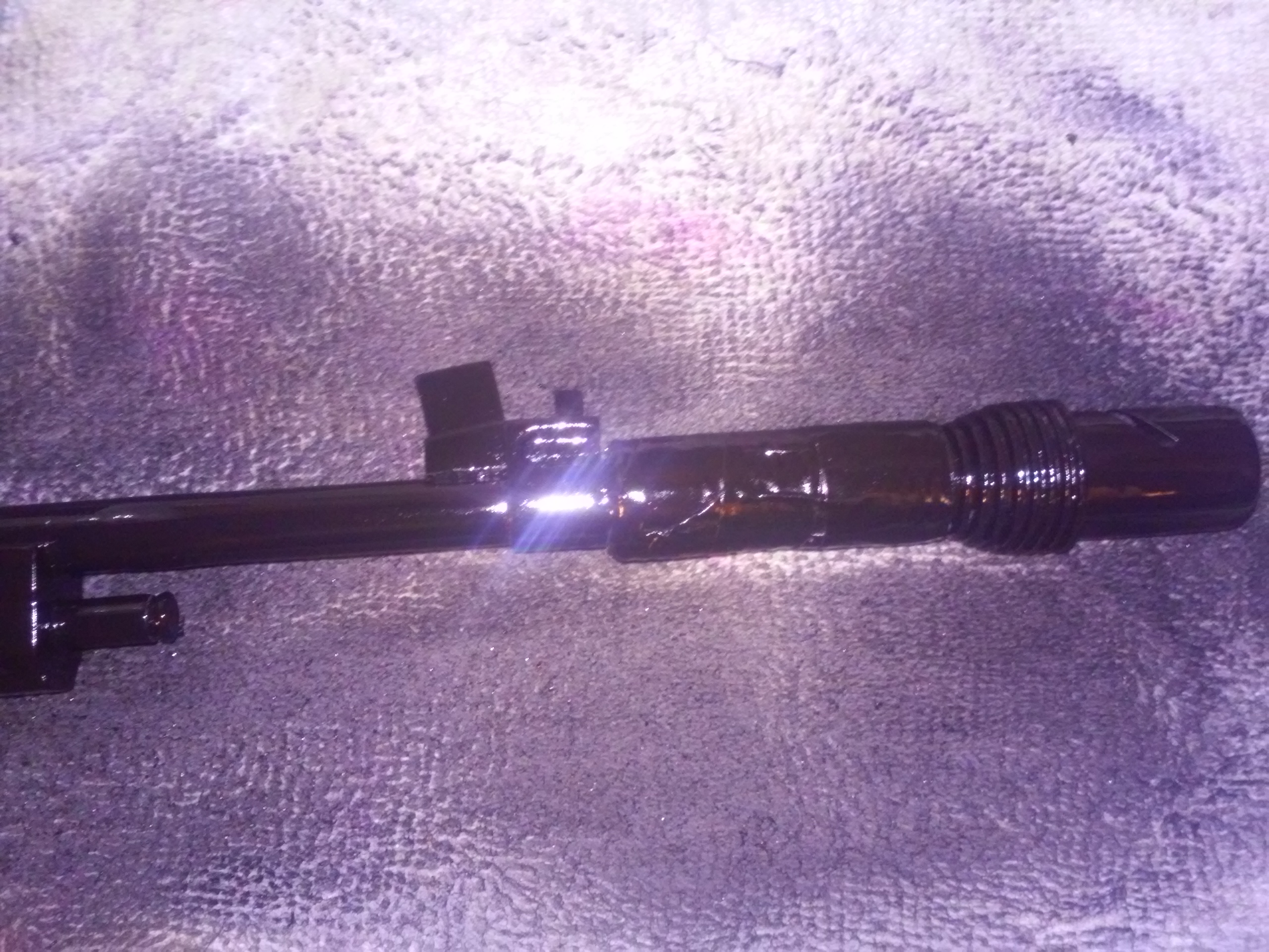

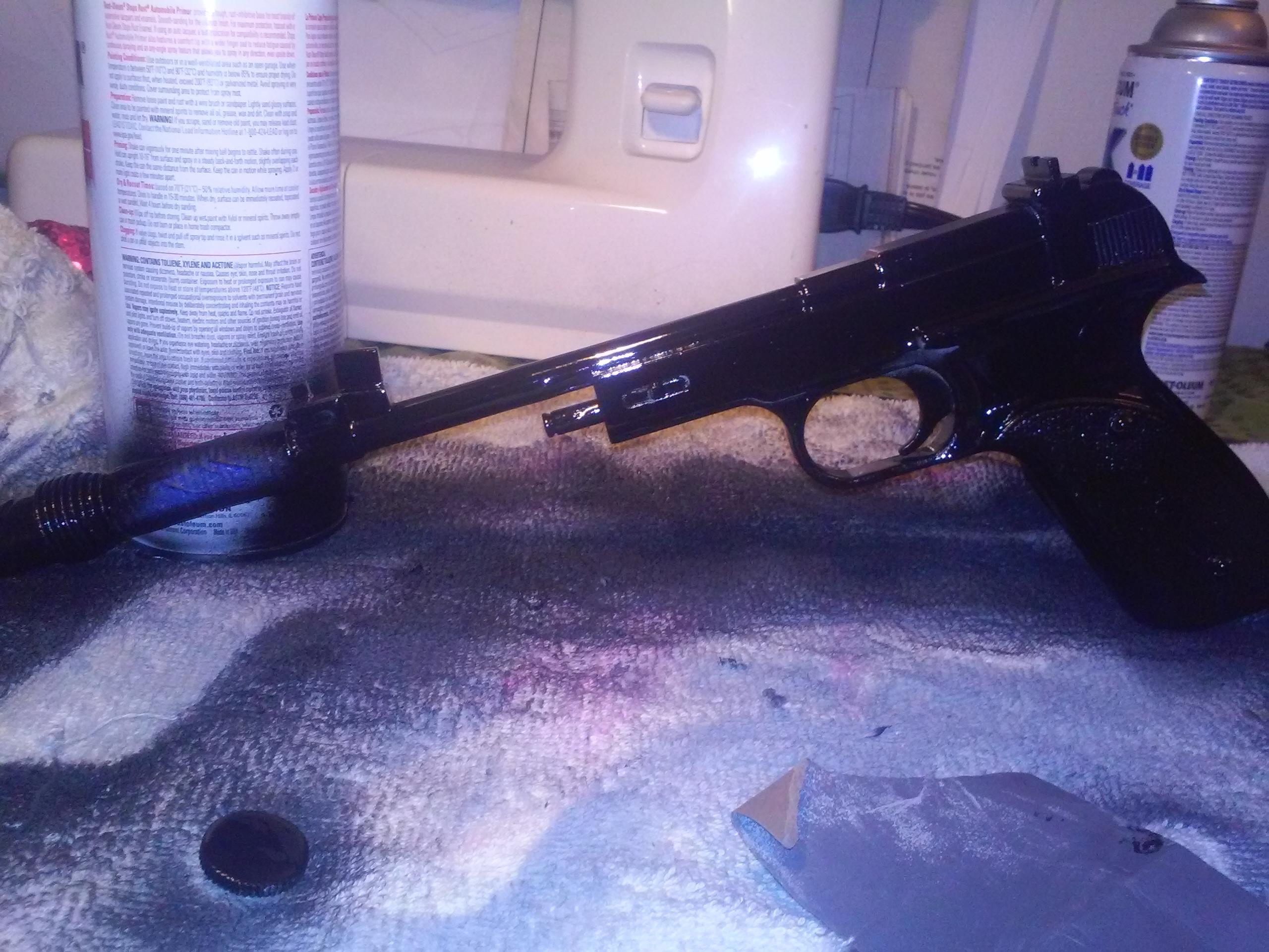

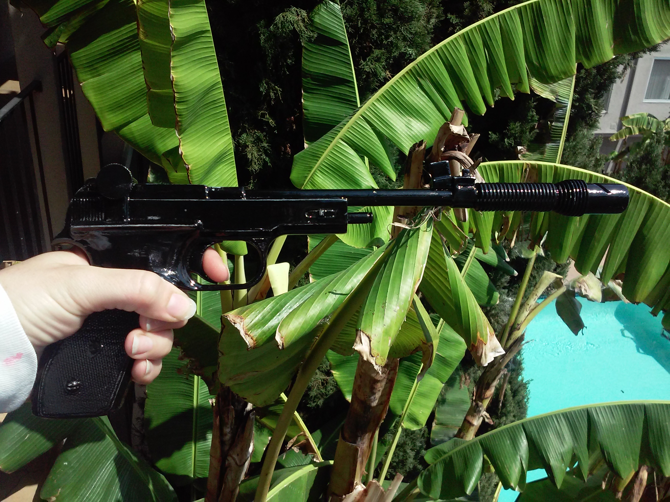

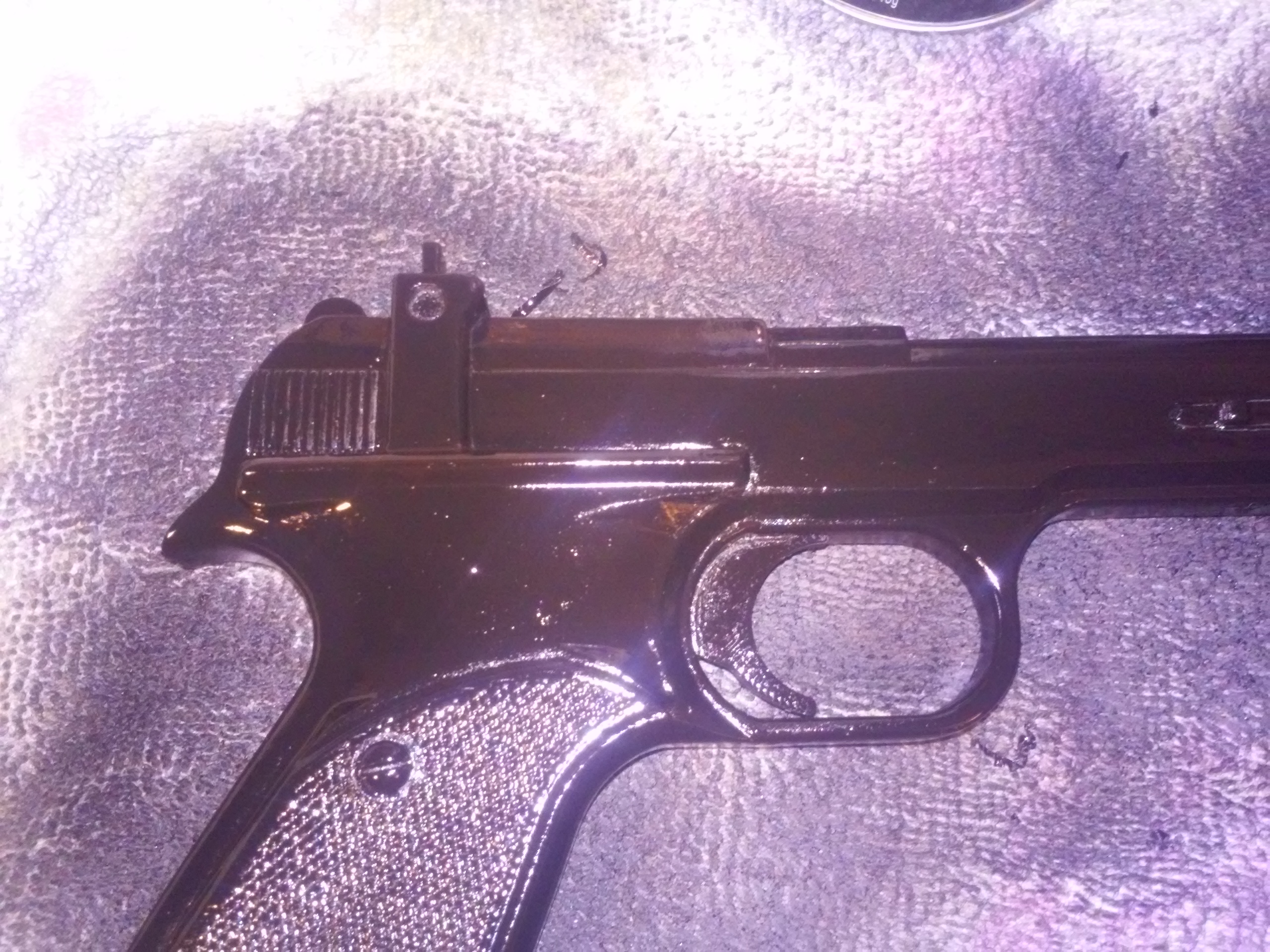

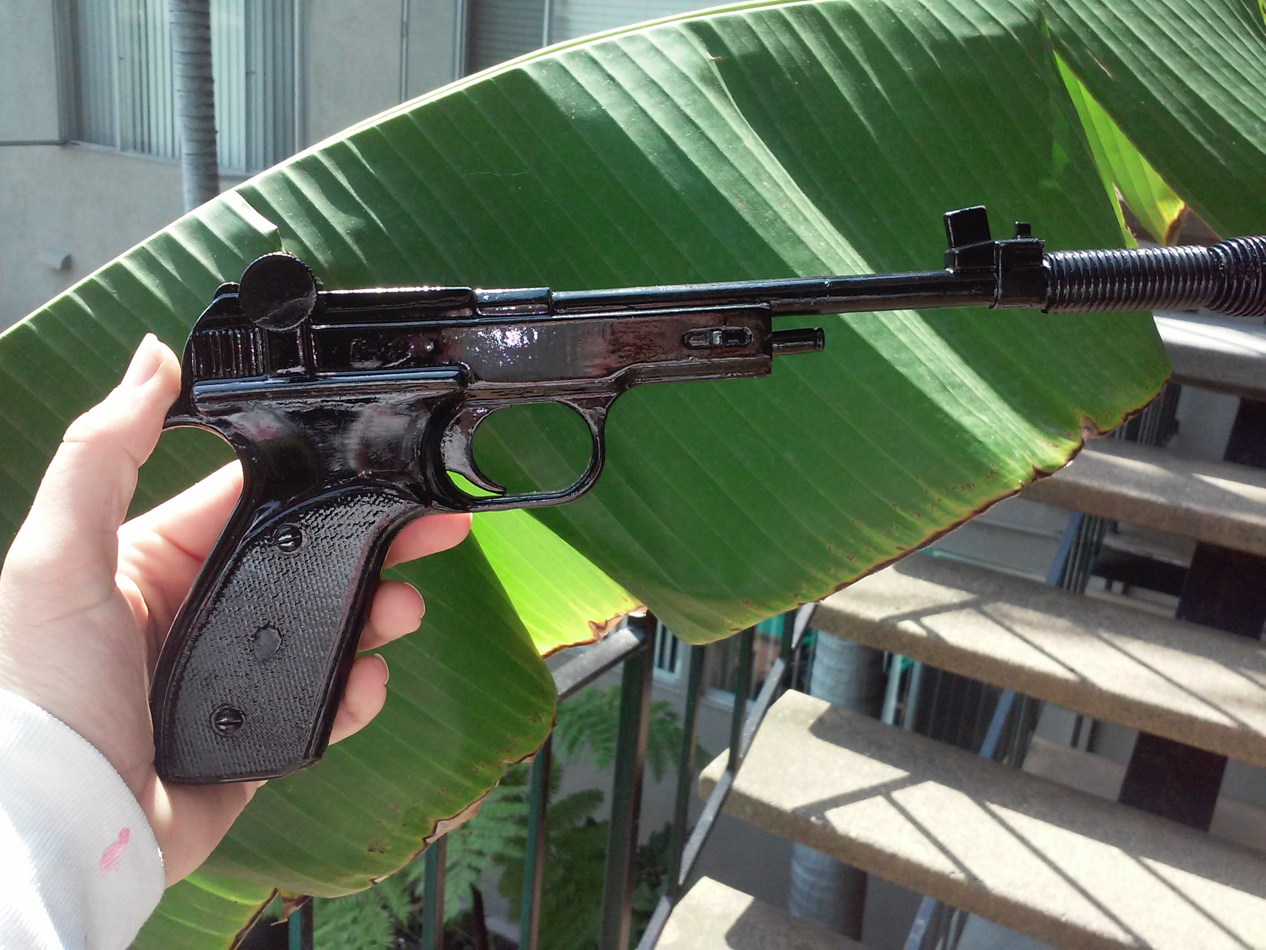

sprayed black.
I like this a lot! Nice call on adding real screws, hot glue and supporting the barrel with a rod
Can you clarify....from what I gathered.... acetone chemically dissolved a lego brick and you lightly painted some on the outside for a smooth finish? or am I completely off base? hahaha
thank you:$
yes that is what i did, to fill the lines of not only the 3D print itself but also the lines from where it was glued together, giving the blaster the impression of being one piece.
That came out really well! The only thing I would suggest is to spray it with some kind of flat or semi clearcoat to knock the gloss down a little.
