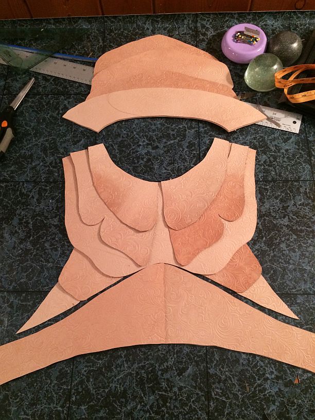

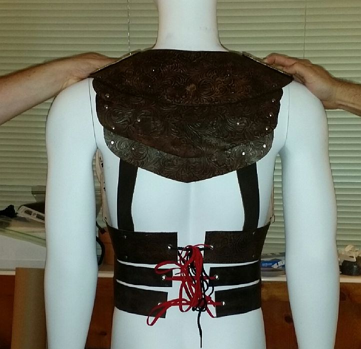

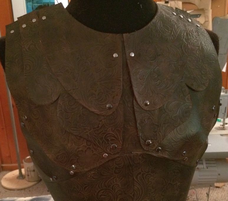

We mapped out all the overlaying and interlocking vest pieces and cut them all out of the leather. For the lower section that goes all the way around the ribs and holds the large medallion, we actually glued the thinner, embossed leather to a thicker, smooth piece and then cut it out to make sure it was heavy enough to hold up. Since the upper part has so many overlapping pieces and we wanted to make sure it was still flexible enough for him to move, we left it the original thickness.
The pieces were all riveted together, the edges burnished and the entire piece hand-dyed.

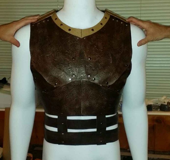

We found some belt blanks that were a good color match for the vest, so we beat those up a bit and used them for the two vest belts, the back straps and the straps that hold it all together. The vest actually goes on over the head, closes using two 'plates' on the shoulder and the lower part laces up the back. We used Worbla to create the shoulder plates, riveted them down on the back and used Chicago screws to secure the front. We also went ahead and put the Worbla collar band down at this point. I'll come to the 'metal' accent bands in a bit.

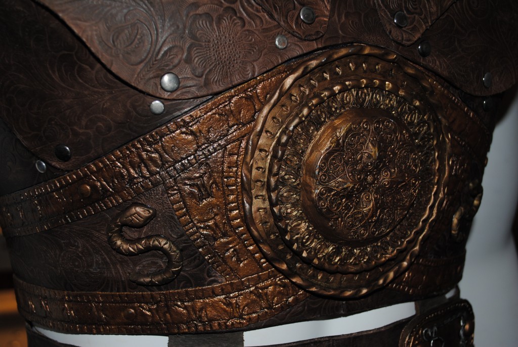

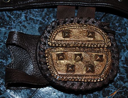

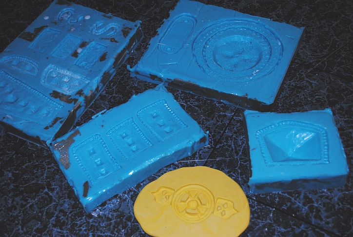

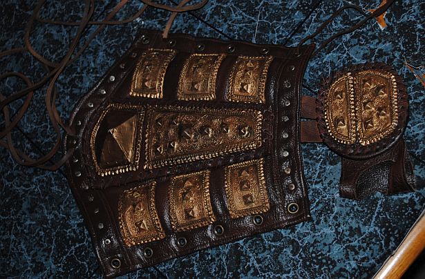

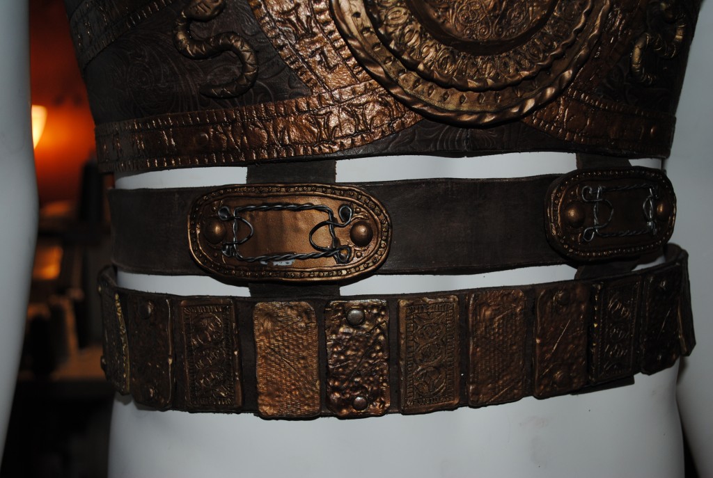

The next thing to attend to was all of the decoration on the vest. We decided that the best route for all of the small pieces was to scuplt them in Sculpey, bake them off, pull molds and cast them in resin. We tackled the large center medallion first.
The actual piece is very intricate. Rather than try to sculpt the whole thing, I found this medallion on Amazon that was a good size and thought it would be a great starting point. We used this as the main detail of the piece and then sculpted the rest around it.

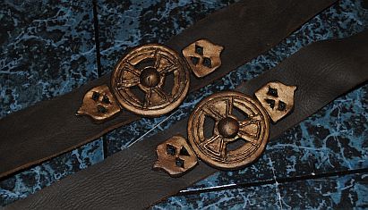

We tried to sculpt everything at once so that we only needed to pull a few molds. For all the little tiles that go around the bottom of the vest, we only sculpted 3 different ones and just kept casting them until we had enough. Same for the 2 pieces on the middle belt on the vest and the little buckles for the belt that goes around the sash.
When they were all done and baked, we pulled the molds. I'll note here that we did all of the left-hand gauntlet pieces as well. To get a curve in the pieces that have to go around the wrist, we cast them almost flat and then were able to pull them before the resin completely set. We formed them around a mannequin arm and masking taped them down to finish curing and they had a perfect curve to fit his arm. I didn't get pictures of that process, but I wanted to mention it anyway.Here are the final baked pieces and the molds. The baked pieces were spray painted to help them release from the rubber molds.
Here's a little more detail of the sculpts and all the little carvings that were included. For the pyramids on some pieces, we used furniture tacks stuck into the Sculpey before baking. To create the filigree patterns on the backgrounds of the gauntlet pieces, we found an embossed coat button and just pressed it into the Sculpey like a stencil. Everything else was sculpted by hand using modelling tools.
Here's how they turned out in resin after being painted.

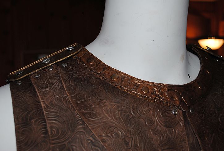

The bands that go around the center medallion and edge that section of the vest and also make up the collar were made from Worbla. The pieces were cut and contact cemented and riveted to the leather. We then went along the pieces and used a heat gun to soften it and carve in the edge detail with a butter knife. For the symbol motif that runs along the center of the bands, we created a stamp out of Sculpey. As the pieces were being heated and the edges carved, the motif was stamped into the soft Worbla.

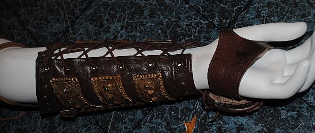

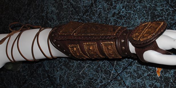

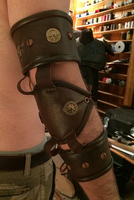

With the main pieces well on the way, it was time to move on to the accessories. We began with the left arm. Having the pieces already cast, the rest of the gauntlet was made using a combination of faux and genuine leather. Once the base pieces were assembled, the cast and painted pieces were epoxied on and the pieces were finished with grommets and laces.
More on this one coming up soon...
SMP Designs
The final installment on this one...

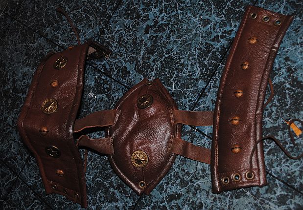

The right arm gauntlet was also made of faux leather and incorporated two different purchased embellishments - small medallions (that actually have a compass motiff) and metal 'acorn' beads.
Here is the right arm gauntlet assembled.
