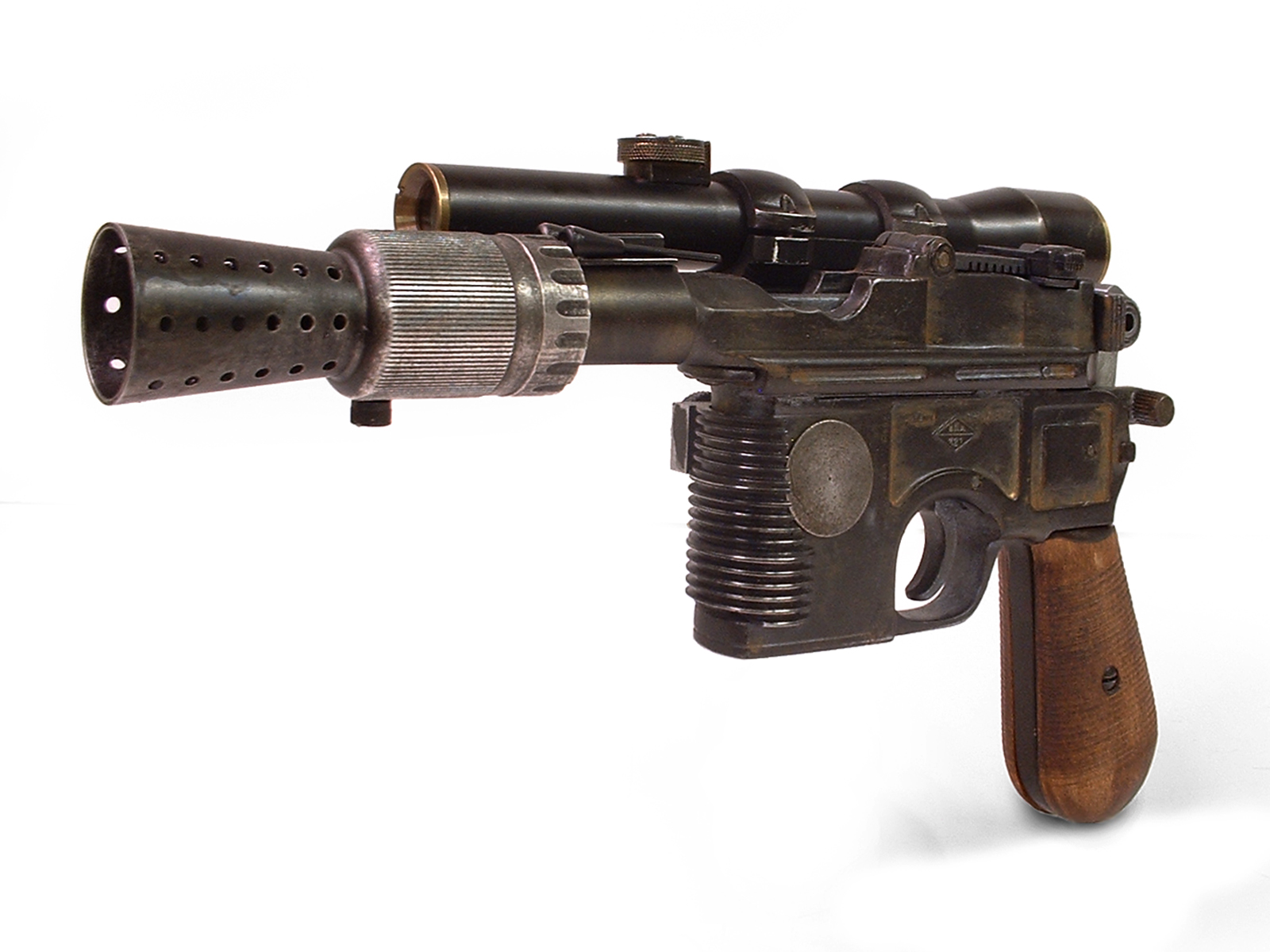

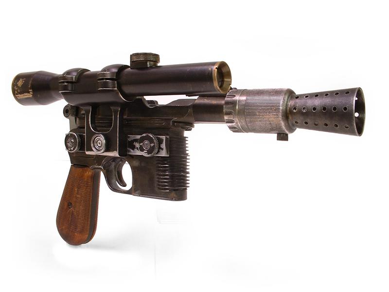

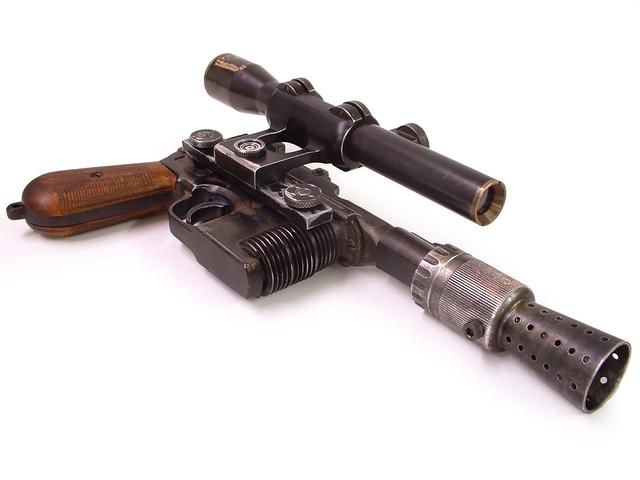

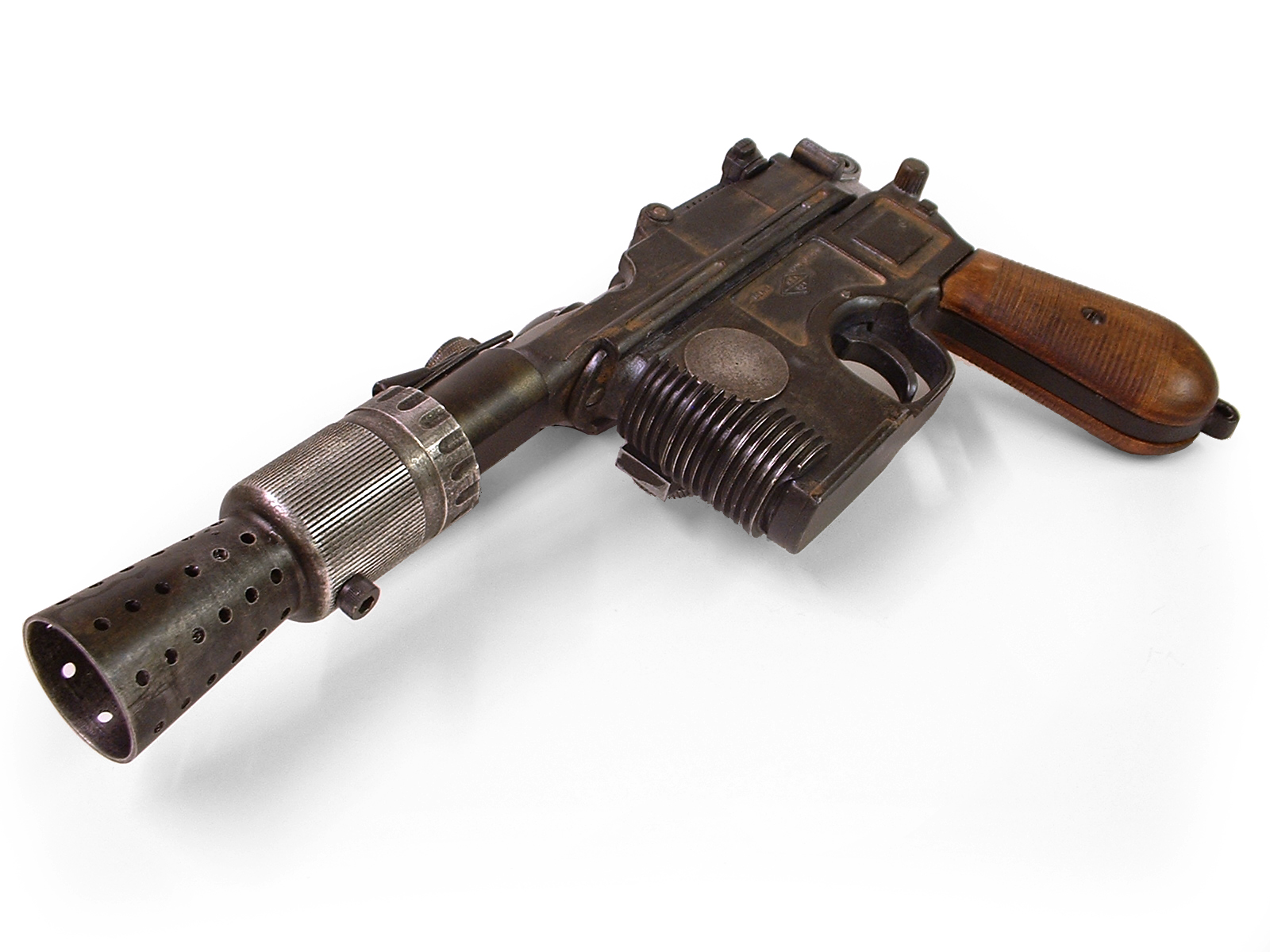

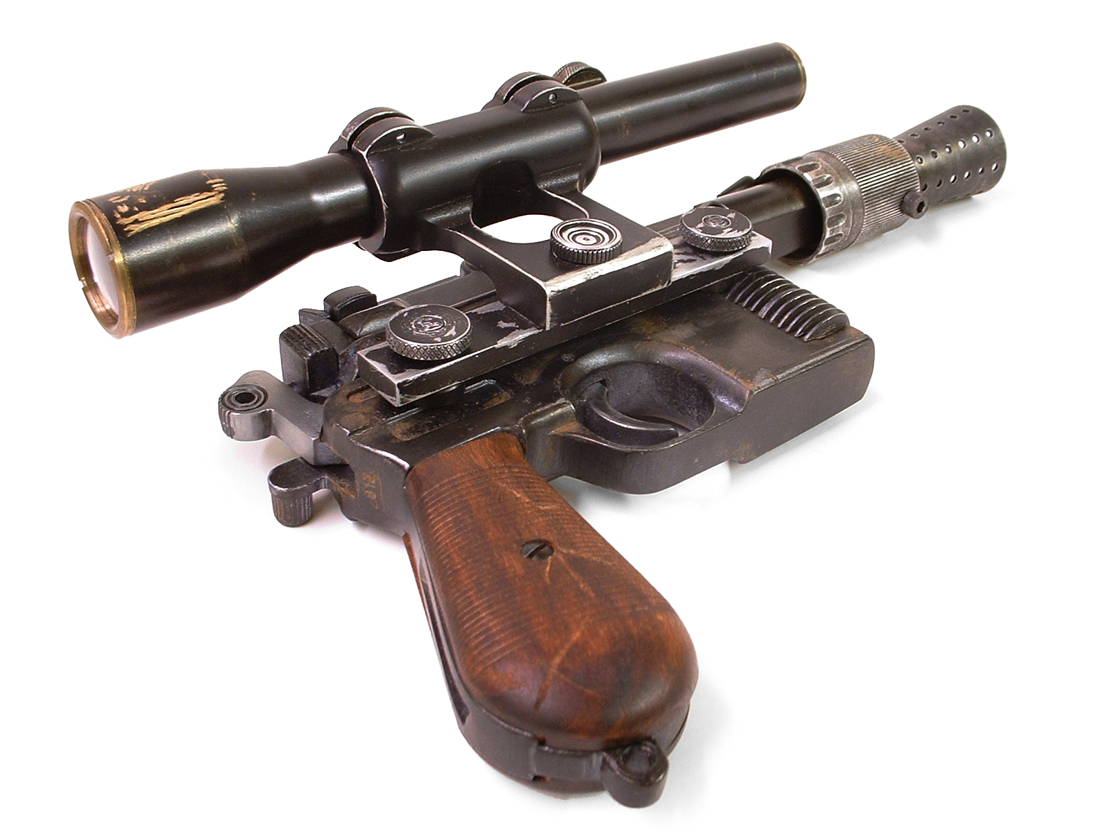

    So my quest for this magnificent prop is finally over. I have loved this one for years now and never got around to finding a kit or spending enough to buy one already done. When DMachinist offered this all metal kit, I knew I had to do it. I studied lots of pics and decided I wanted it to have the nicks and dings of the real one. I am NOT an authority by any means, so I'm sure there are things I missed or that could have been done a little better. BUT I'm extremely happy with it. I hope you enjoy!

    What didn't I use to finish it. Lol. Let's see, I painted all the kit parts with John Norrels Moly Resin black, brass weathering solution for the scope ends, diluted aluminum black on the nozzle, a mix of browns for the rust that I dry brushed on, gold and black painted on the scope scratches, I also dusted the scope with graphite to help with the sheen, then steel wool around most of the gun. I also scratched the paint off with dental tools on the scope mount. The disk on the backside is a machined aluminum disk I made then used aluminum black on.
