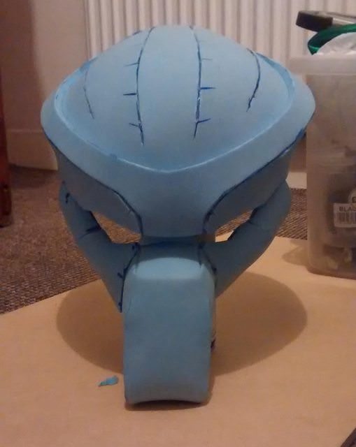

As I say, I'm trying to keep this as cheap as possible, so it's going to be scratch-build, mostly from EVA/camping mat foam. I'm not planning on making the mask (yet!), so instead I decided to start my build with the Bio Helmet
Foam pep, which I then sealed with PVA and a rubberised enamel spray paint from Halfords. I used an acrylic caulk to fill in the seams

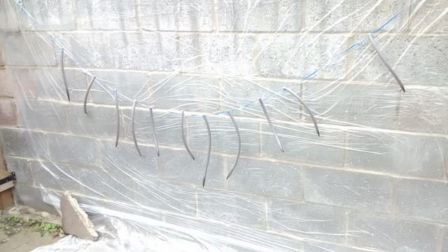

Then I made up some 15mm backer-rod foam dreads, and sprayed them with more of the rubberised enamel paint
I ran out of the rubberised paint, and ended up finishing a few of them off with plain old acrylic, which seemed to work just as well.

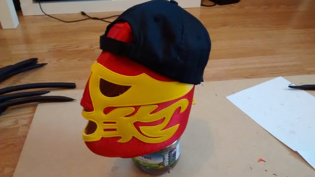

I've used a baseball cap minus the peak as a base for the dreads. I didn't have a styrofoam head to use during the gluing of the dreads, but a Mexican wrestler mask on top of a drinks bottle seemed to do an adequate job. And also looked pretty weird.

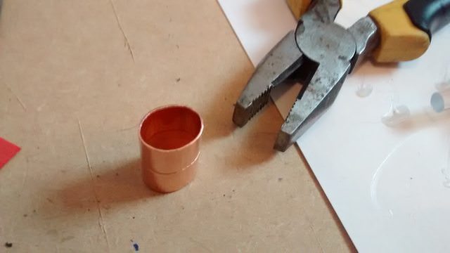

For the dread beads, I've just used some 15mm endfeed couplers which I got from B&Q, about £7 for 40 of them.
To help them stay on the dreads, I've given them a slight crimp. You can't really see it, but it's just enough to hold them firmly in place

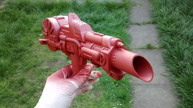

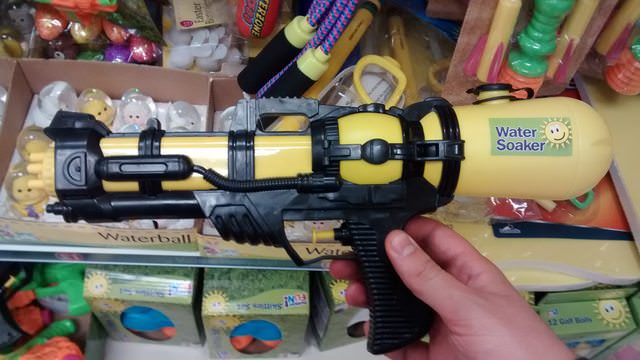

Next up, the shoulder canon which started life as a water gun from the pound shop
Hacked to bits with a dremel and, then some bits and bobs hotglued on, and some greebles added with craft foam

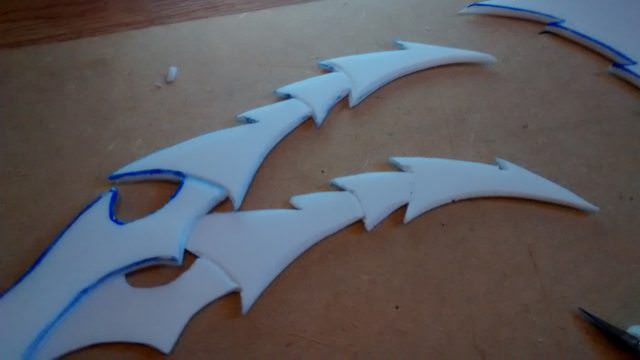

I've cut the blades from some polystyrene sheet (the kind you sometimes get with frozen pizzas). It's super easy to cut and sand to shape, and I'm going to coat it with aqua-resin / Jesmonite and see how strong they are. I might also try cutting them from some thin spruce board, and see which finishes up looking better, once I can get my hands on a jigsaw

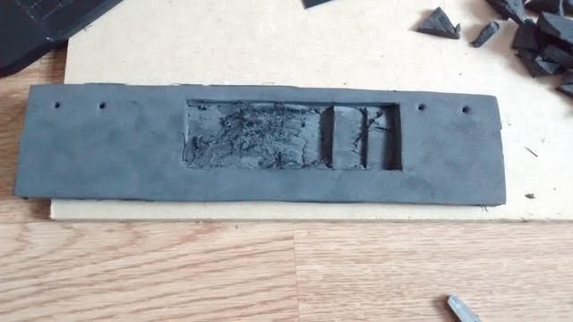

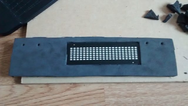

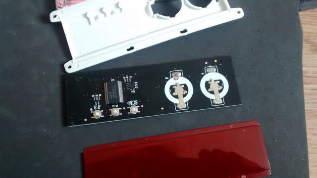

For the bomb gauntlet, I already had one of these cheap scrolling text LED belt buckles lying around from another project, so I decided to use this to make my countdown timer lights
Disassembled, it's quite a simple circuit board powered by button-cell batteries. Because I'm going to be permenantly mounting the PCB inside the gauntlet I need to make a couple of modifications so that the batteries can be changed and the lights switched on and off

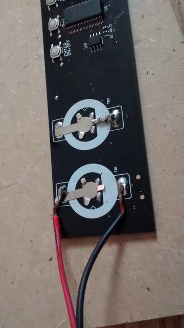

So I start by removing the battery holders, and soldering one of the terminals together (to connect the circuit). Then I solder a couple of wires to the terminals where other battery holder was
These wires will be connected to a CR2032 holder with a switch which will be mounted to the outside of the gauntlet when finished. Next I take a section of floor mat foam and carve out a recess for the board
I've programmed the board to scroll some random gibberish text, and I've placed some black cardboard with Yautja style symbols cut out over the lights, sandwiched under the red plastic that came with the buckle.
I think the effect is pretty neat, and it didn't cost me anything to make as I already had all the bits lying around.

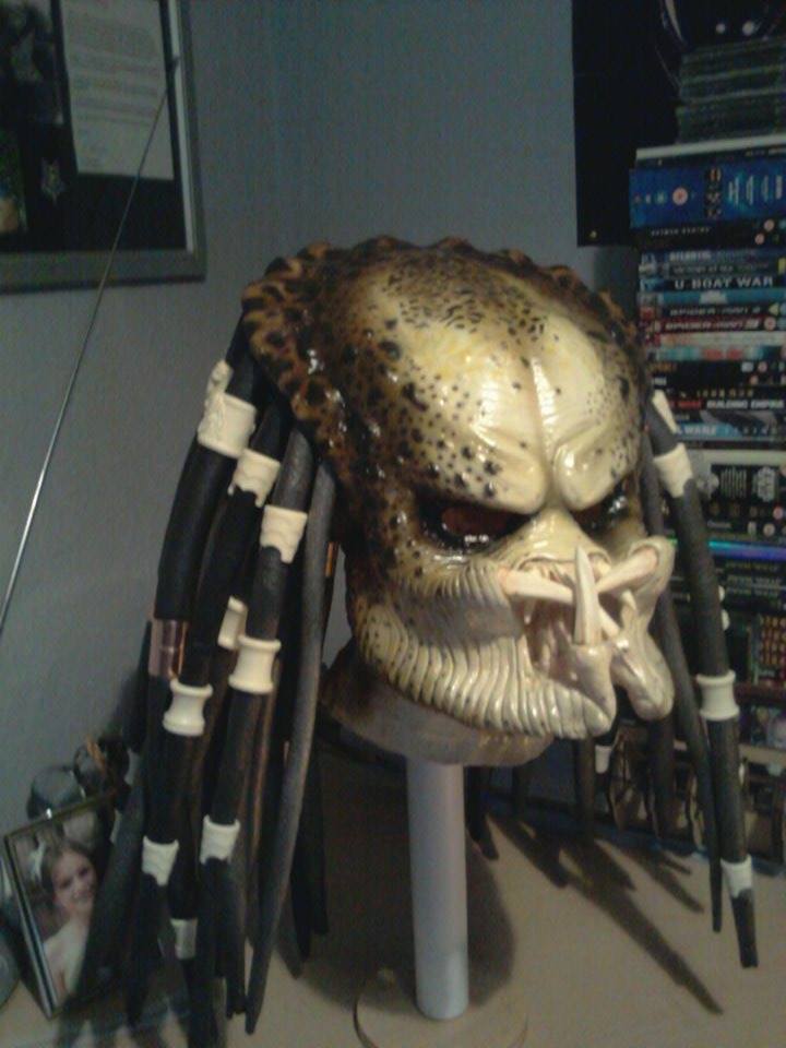

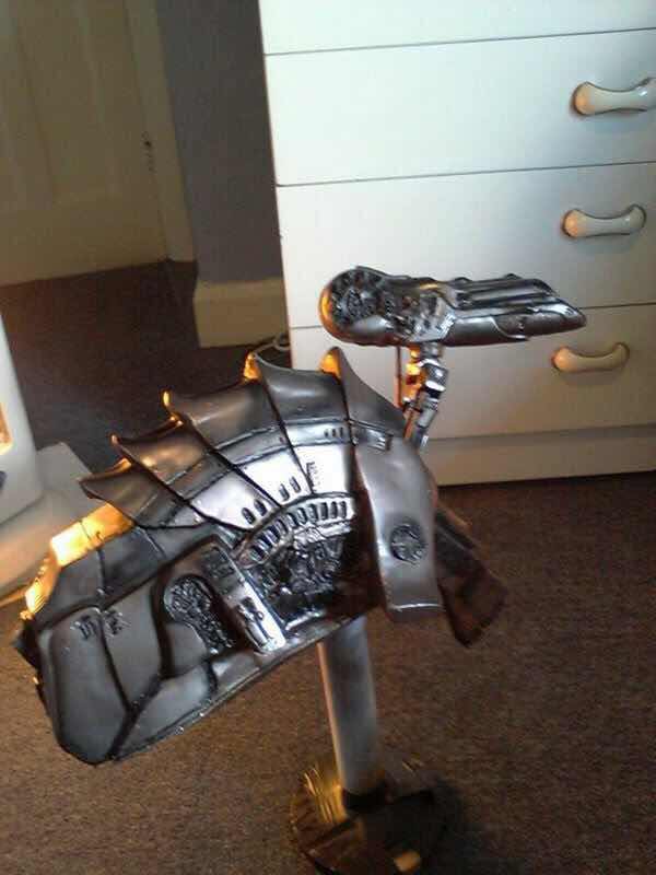

very nice work, my uncle is doing a predator build i went round the other week because he said and i quote " can you come round and put my predator on so i can take some pics as your gran can work the camera'' lol here a few of the pics he took remember this isnt my build but my uncles but i can keep ppl up to date if ppl are interested
11117759_10202687827836540_1663715605_n.jpg 11220132_10153372123538890_7628157572060489670_n.jpg 11156135_10203118550564339_8973355761840836732_n.jpg 10930144_10203118550844346_2018380251355409909_n.jpg
warweaver84
If I'm right he was sculpting small bits then moulding the silicone rubber then joining it's took a while but as you can see it's worth it, my arms are abit longer than my uncles so the forearms don't meet the elbows lol

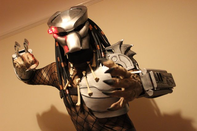

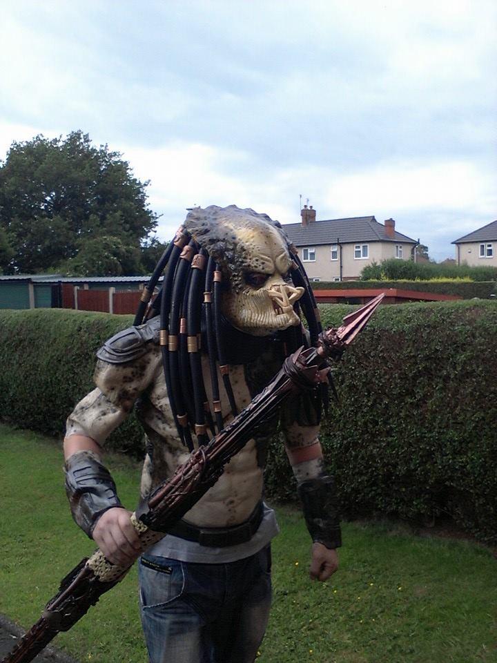

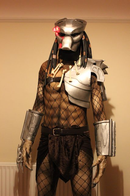

Quick update time - the costume wasn't ready for the party I'd hoped to wear it at, but that's OK as it was too hot to wear it for any length of time, least of all on the lower deck of a boat, which is where the party was...!
But I got a few test shots of the costume progress so far. I'd say I'm about 85% done now, just got the leg armour to tackle and then finishing touches.
