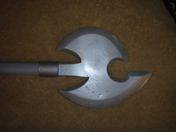

I'm working on a rather unique weapon that my character from the comic "Predator: Cold War" used. One end is sort of a spear/flechette launcher:
The other end has a rather deadly-looking halberd on it.
Here's what I've got so far. The flechette launcher is taken from a Nerf gun, and the spiral shaft inside it is from a mold I took of a concrete drill bit that I got at Home Depot. I made a sculpt for the halberd from MDF, then took a mold from it in pourable silicone, then cast it in Smooth-Cast 300. The shaft is made of PVC pipe, which I put together in three sections. I'm going to put some sort of leather handle on top of those joints.
I'm going to rework those Nerf darts so they actually have spear tips instead of suction cups (which would hardly fit a Predator's arsenal). I'm sort of at a loss for the detailing on the rest of the shaft, though. Other than the handles over the PVC joints, does anyone have any ideas as to what I can do with it?

It took me long enough, but I finally finished this thing. Here are a few pictures of it in action:
And, here are a couple pictures of the business ends of the weapon:
The gold part next to the halberd is made with polymer clay, and I carved Predator runes into it. I'm not sure what they say, but someone on Facebook posted a picture and tagged me in it, so it must be something about me. The flechettes look a little bit bent because the foam bends when I set the weapon down on that side. I sort of forgot to take that into account.
As far as the particular Nerf gun goes, I don't remember which one it was. There are a bunch of them in the stores. This one has a revolving magazine that shoots 8 bullets. I'm sure if you look in the toy department, you can find something that looks like you can use as the basis for a project.
