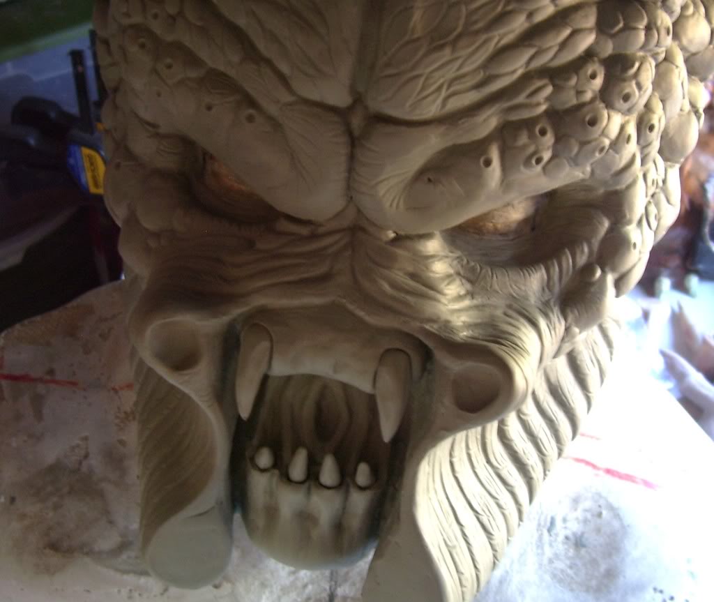

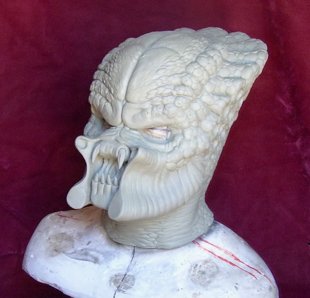

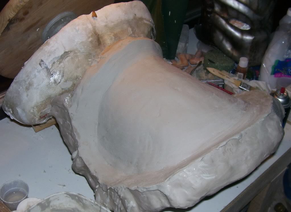

Well its time to make a mold of this head! I am going to post the process pictures here to help out any new hunters out there. The first step is to lay the head back onto a towel with a garbage bag on it to prevent fuzzies from sticking into the clay. Then i used old wooden blocks to rough out the shape of the edge. And those black lines were me trying to find out the highest point to devide the mold from, its just felt marker. had to draw a few to find the mystical spot.

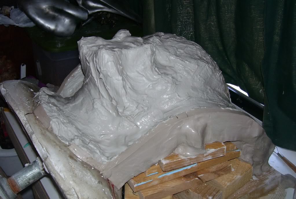

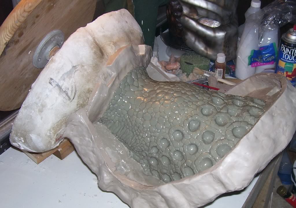

Next i added the laguna wed clay. Its just a water based clay and its used to make the form to divide this into a two pice mold. You can see the keys added around the edge to lock the two pices together when its finished.

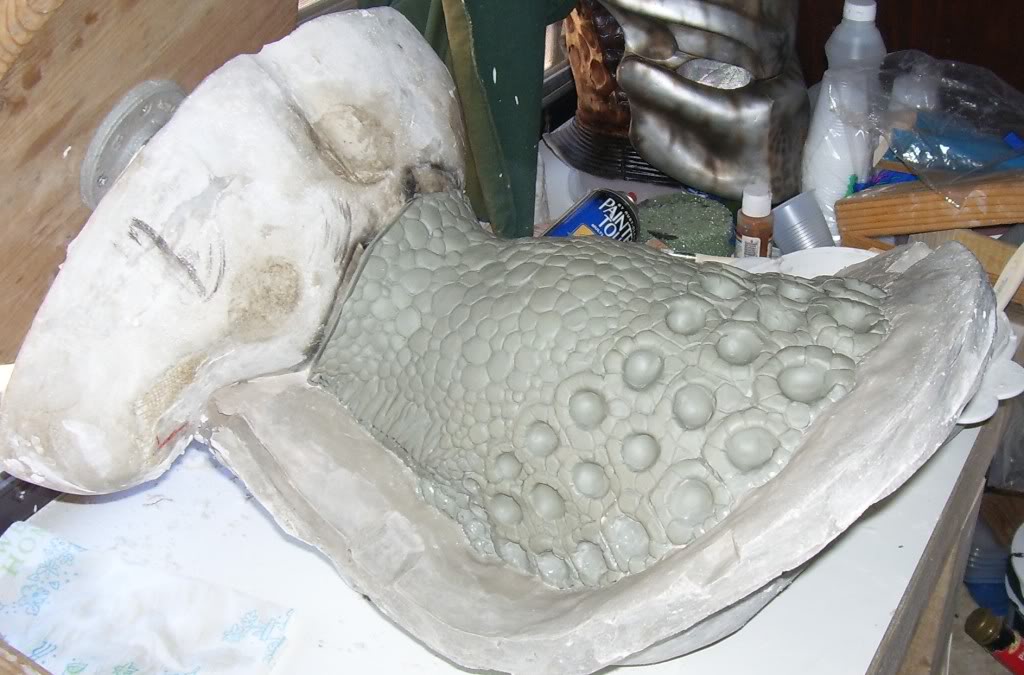

Next the spash coat of ultra cal 30. There is no burlap mixed in yet, this is just to pick up the texture. Had some minor problems at this step, its about 95 degrees outside and the ultracal set up in about 3 min. All seems well tho added another coat over that to thicken it up.

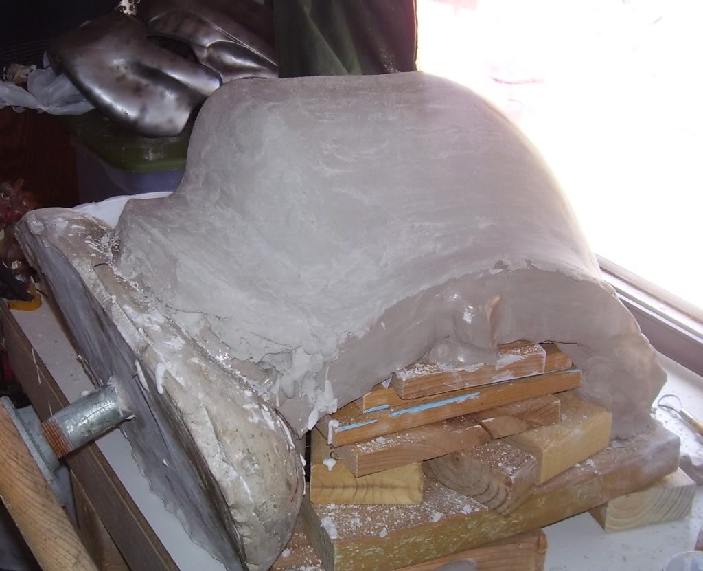

K, using burlap dunked into the ultracal, i thickened it up and got a kinda flat spot on the face to keep it from wobbeling as your working with it. My rubber kidney i normaly use to smooth it seems to have gone missing so it was smoothed with a pice of cardboard. (gotta work with what ya got)
And the last step on this side is to flip it over and clean it up. All extra wed clay thats stuck on there can be removed with a soft chip brush and some water. It needs to be perfectaly clean or there will be a lump on the edge were the clay got stuck in there when you make a final latex pull.

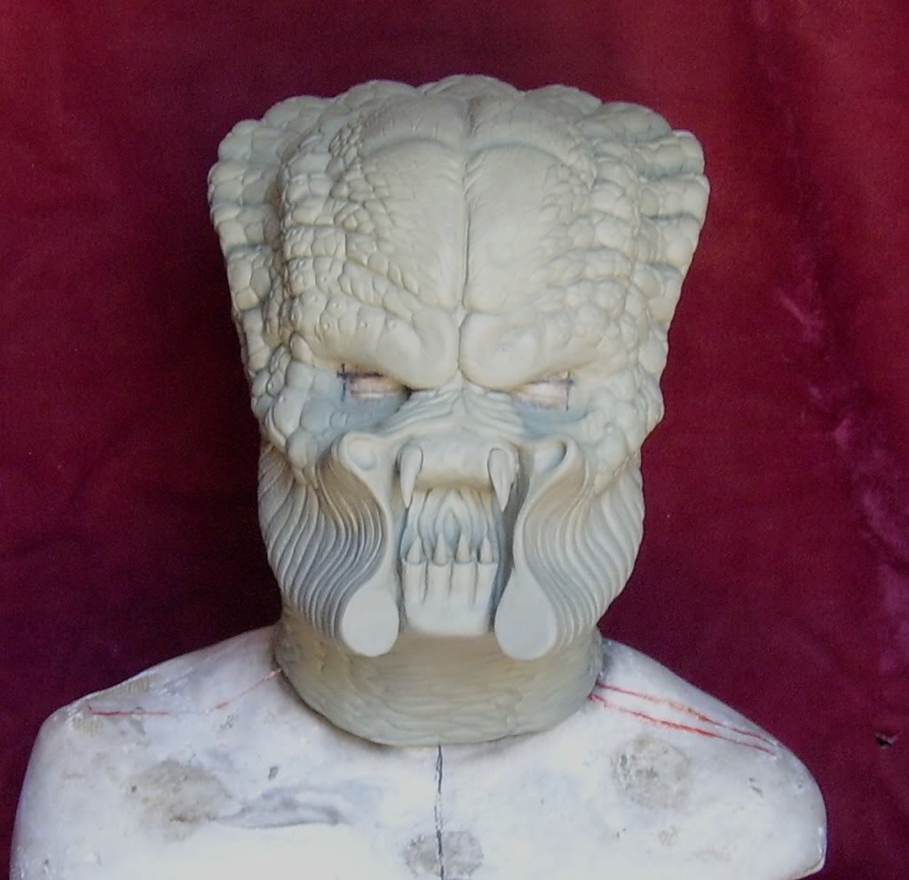

Well, now for a little clean up for any damage on the back of the head from laying it back, and then to making the back side. There will need to be a little rasping of the edges that overflowed the clay form, but that will have to wait untill both sides are done. I will post the rest as it gets completed, thanks for looking! Any questions on the process or comments feel free to speak up.
