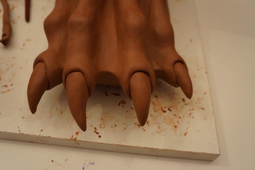

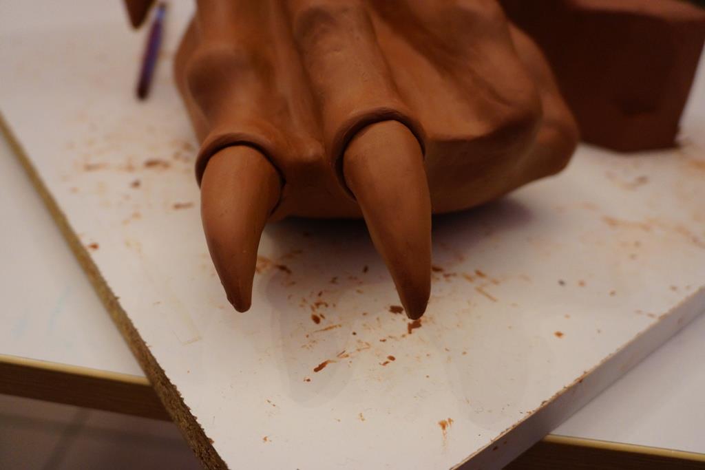

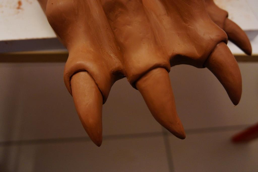

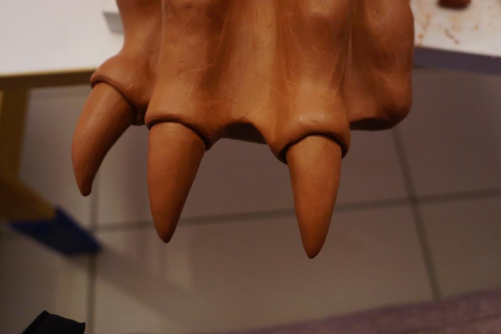

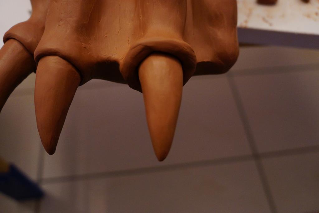

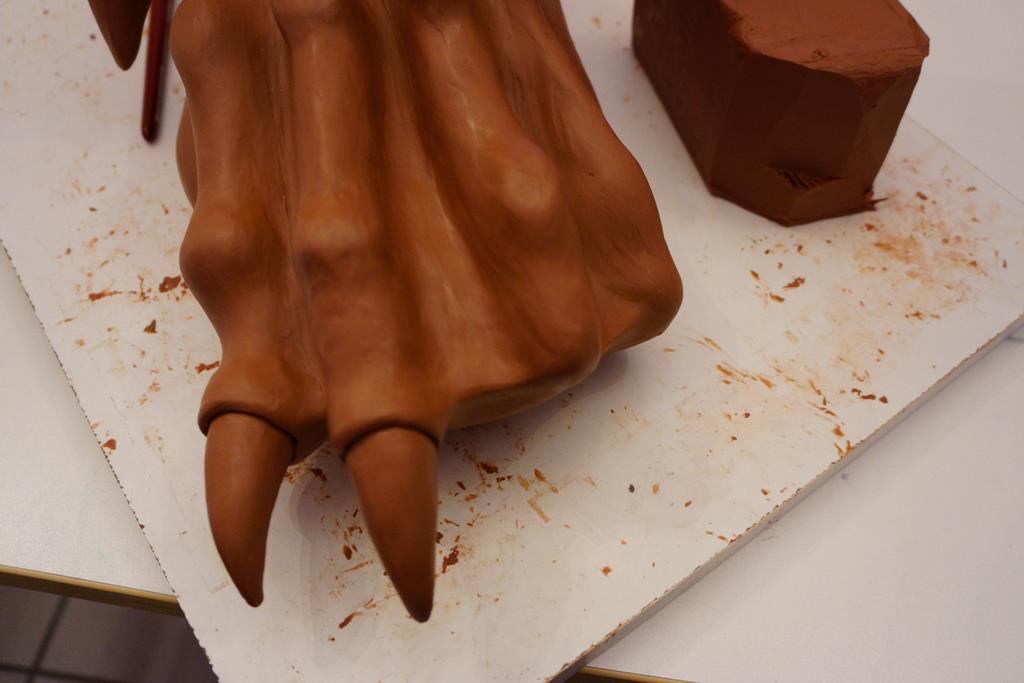

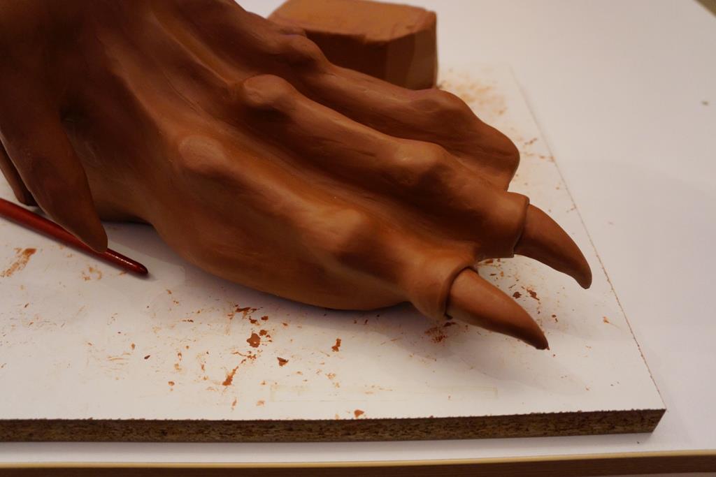

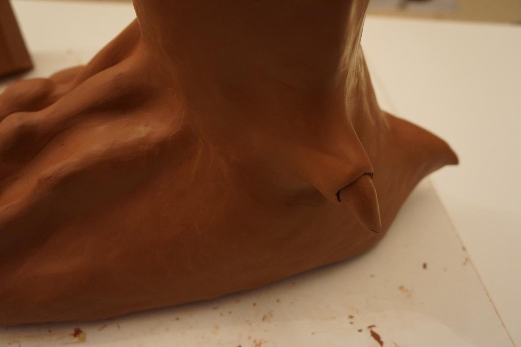

some more update pics....
Pitoon
Read his comment over the pic's. It says
''some more update pics.....getting closer to adding texture
Pitoon''
:) Just to let you know.
And Pitoon, GREAT job! They look VERY great! (Y)

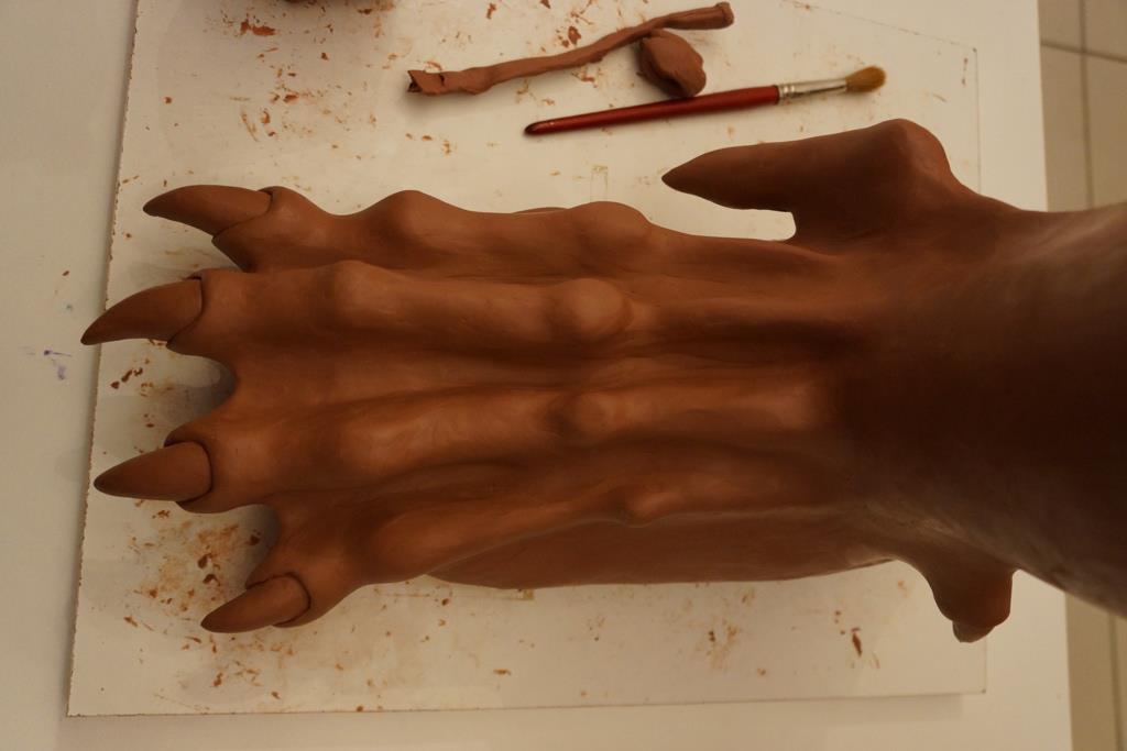

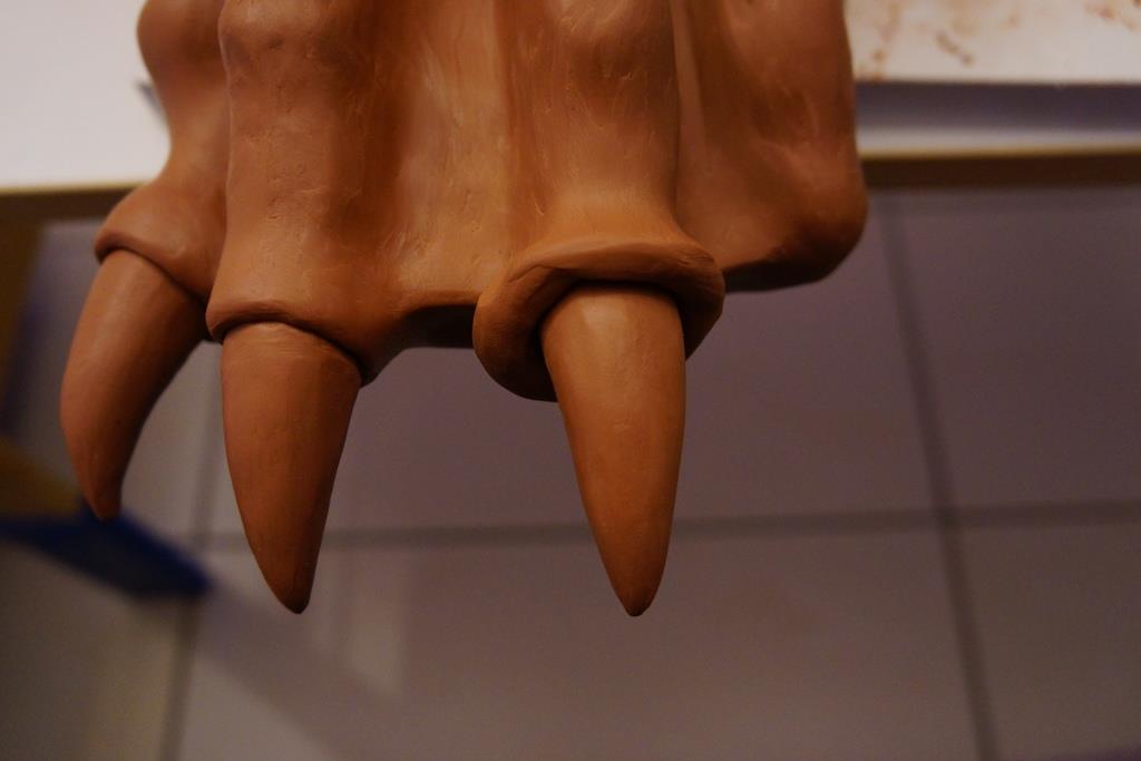

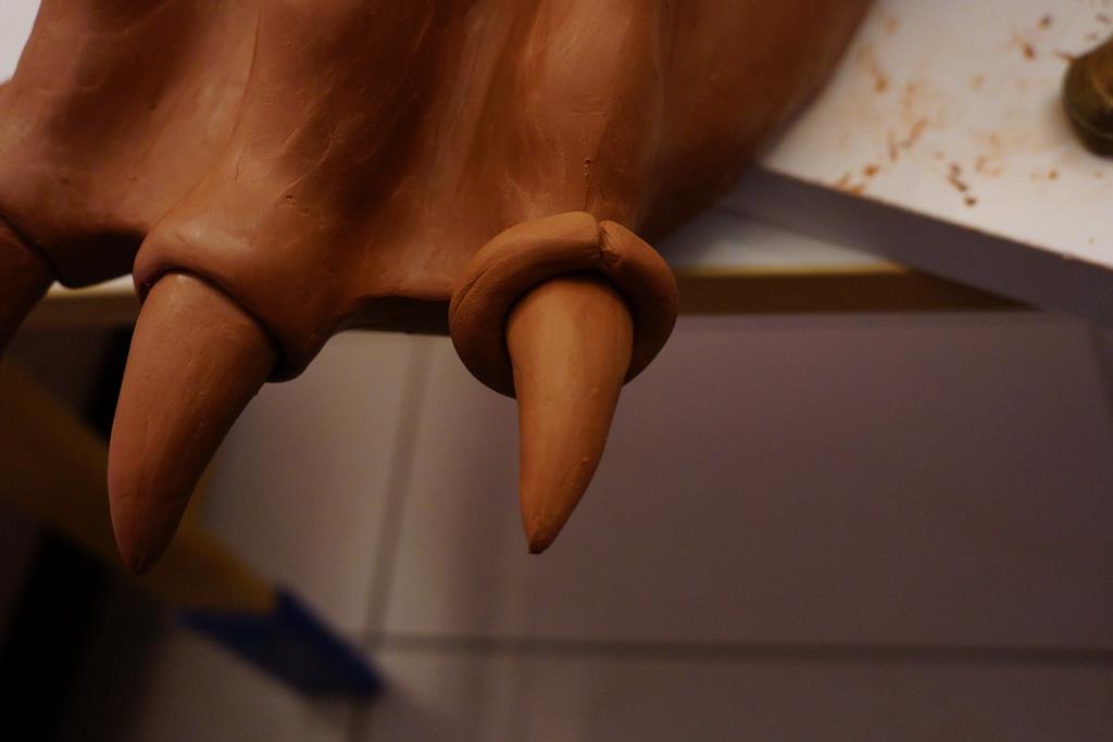

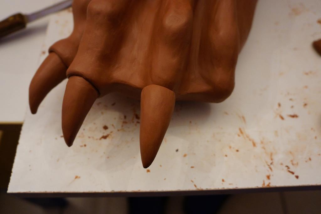

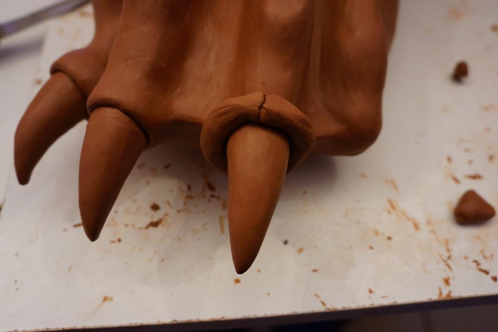

looking good just keep in mind you have to walk in them make sure you don't trip on the claws and watch out for the bone structure being too tall if you pour ultra cal it will be difficult to seperate them so be prepared . just some helpful advise. but it looks sweet keep it up man.
cool thanks for the advice!  i was planning on doing a silicone mould and then securing it with a fiberglass mould over the silicone.  i was planning on attaching 1inch soles so hopfully that would give the clearance for the claws.....hopefully.  but they do not extend that much from the foot.
Pitoon
