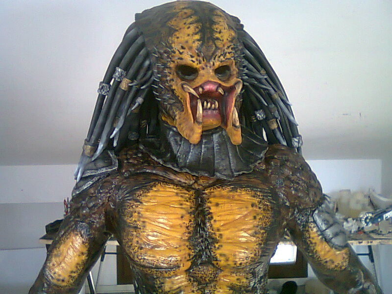

Hi, i started a new version fo my old predator; pratically i'm re-doing all of the costume parts.
https://www.facebook.com/ugo.arizzi/media_set?set=a.10201773874927235.1073741829.1192345504&type=3
i have a lot of photos so forgive me but it's better that you see them on myfacebook page.
I have no photo of the original status of the mask, i have onyl photos after the paint, sorry

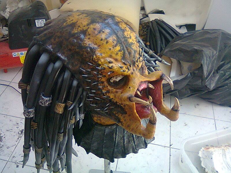

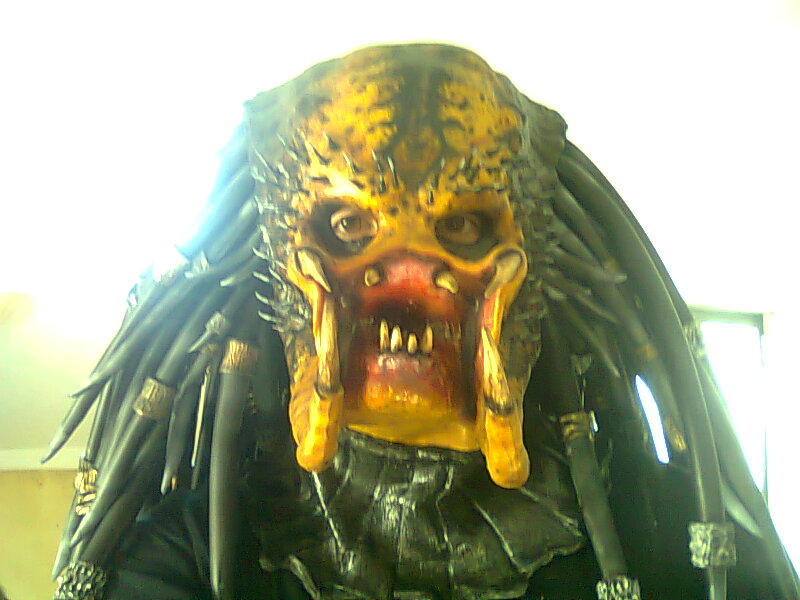

i have made the dreadlokcs in polyetilane rods, the rings are all made in polyester resin.

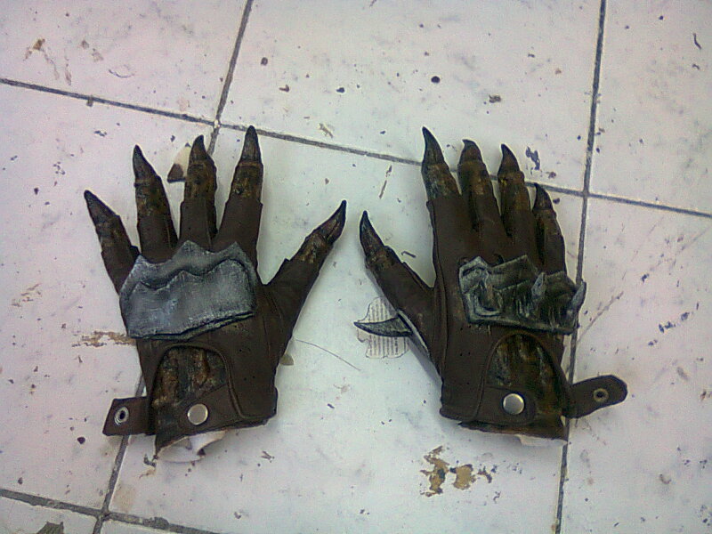

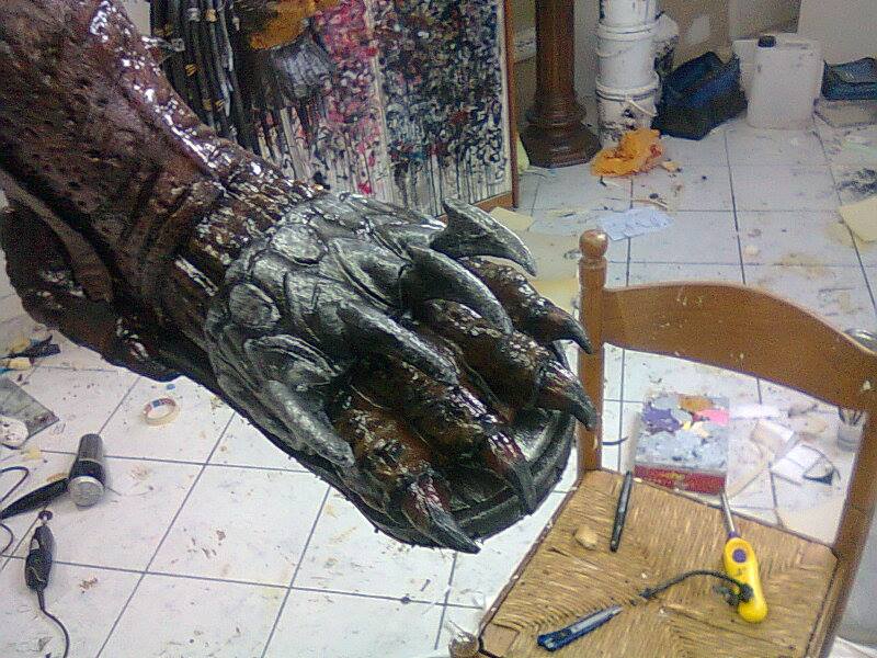

gauntlet are palstazote and latex.

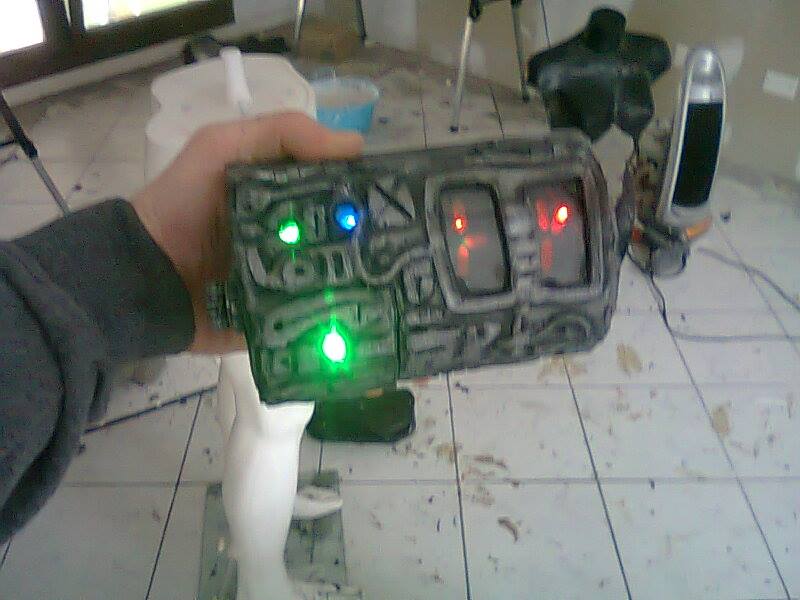

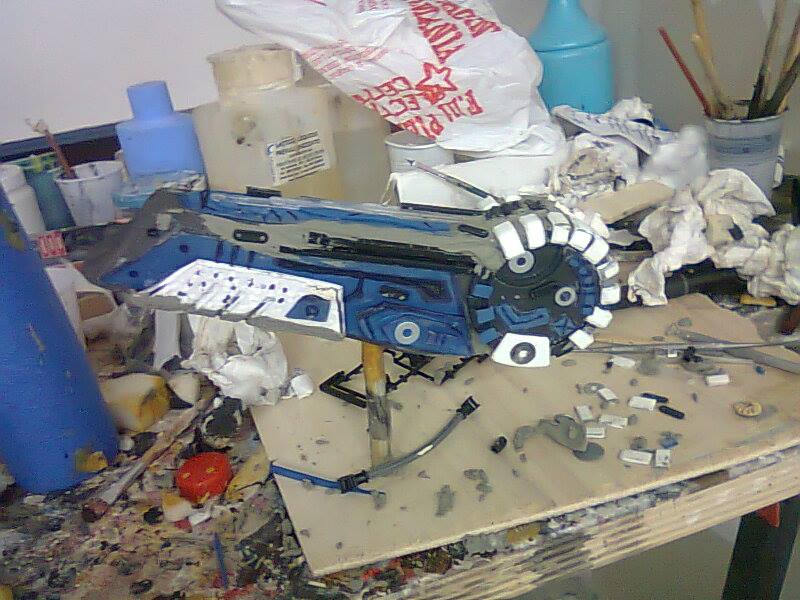

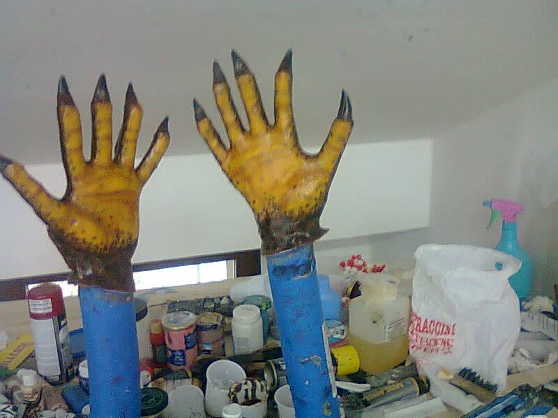

i have finished to scultp the master if the cannon for the molds in these days, i also have made the latex hands, but they need leather gloves.

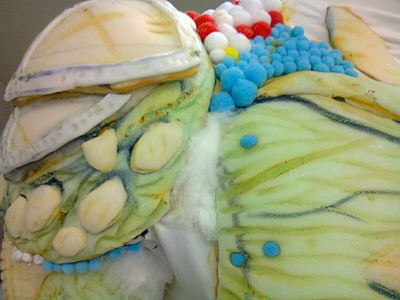

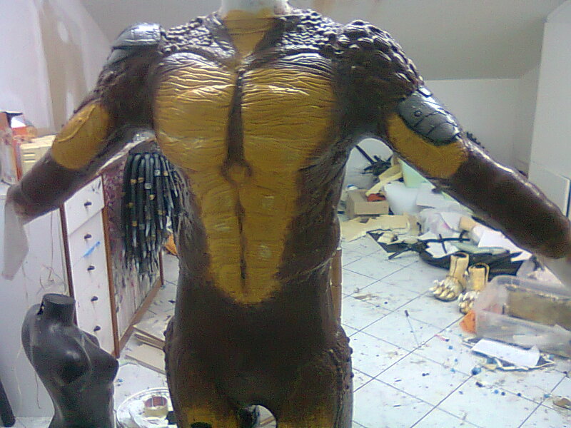

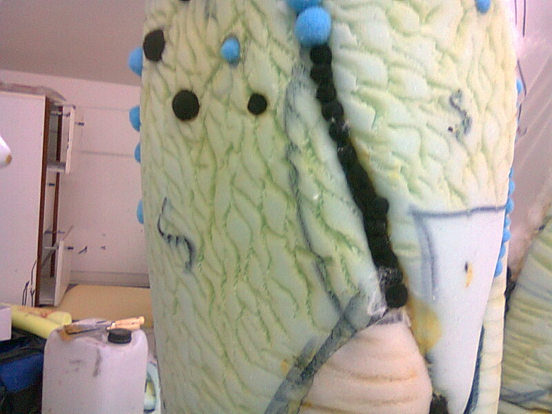

i'm actually working on the body, i have using some new foam techniques to do it, this is an experiment.

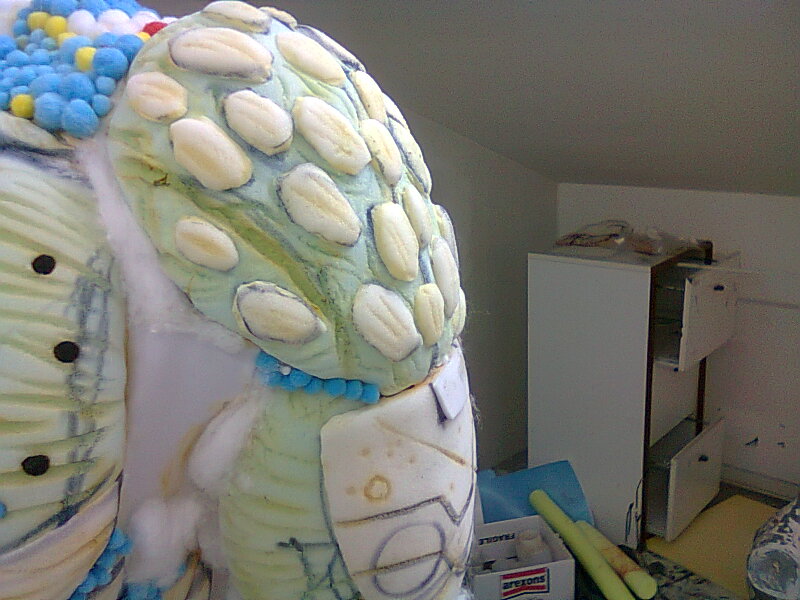

i made the muscle suit in soft foam, using a technique to curve and round the foam, i have to assemble a lot of muscles yet, after i'll sculpt all with pyrographer to do the skin textaure, i'll also add some armor parts, pitting and bristles over the chest.
i almost finished the foam body, i have only to add veins, i sculpted the foam and did the textatures. Now i have to add latex to the suit adding the cotton necessary to uniform certain foam parts to the rest of the body.
looking good so far, i like the muscle suit, was thinking of doing a similar style myself, ie, not using a mr incredible suit.
keep up the good work, i look forward to see how this turns out

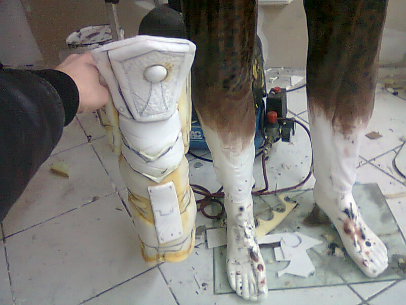

mr incredible suit it's not very good at all because the muscles are not shaped very well, you need to modify it i think. i start to apply the latex this evening with cotton to unify certain points. I have also finish the feet, now i have to apply latex also over it and add the sole. i scultp the soft foam and plastazote over a pair of surf-boots. the textures  are very good and the feet are confortable. sorry for the photos they're not very good...

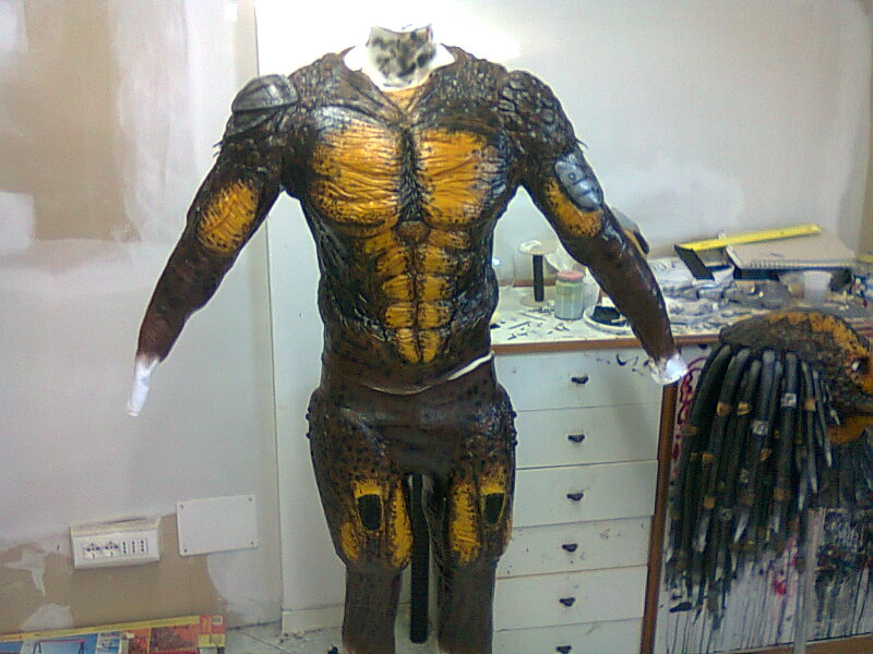

hi, this the body after 10 layers of liquid prevulcanized latex. it's almost ready for the airbrush. i also made the body squills in termofomed plastazote and latex. I'll add them after the first fit test before the final paint.
Body colored... i devided the torso from the legs for more confort to wear it. Now ia ahve to add some straps of velcro to connect the two part, i also add velcro parts on the legs to mantein in position the legs armor.

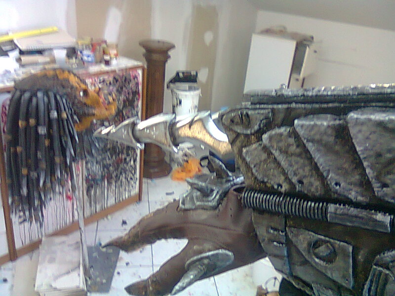

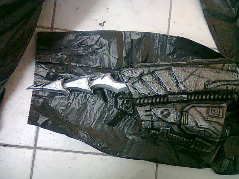

hi guys , i finally Painted the feet, sorry the photos are not very good... I add the fibal protective tomorrow and did the fit test... I also sculpting the armor in plastazote foam, after taht i had the latex. the neck of the cannon is imcopleted because i have to try to add the micro-servo for the animatronic plasmacaster...

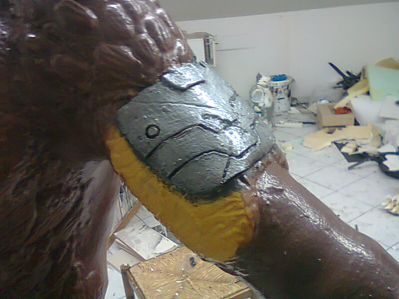

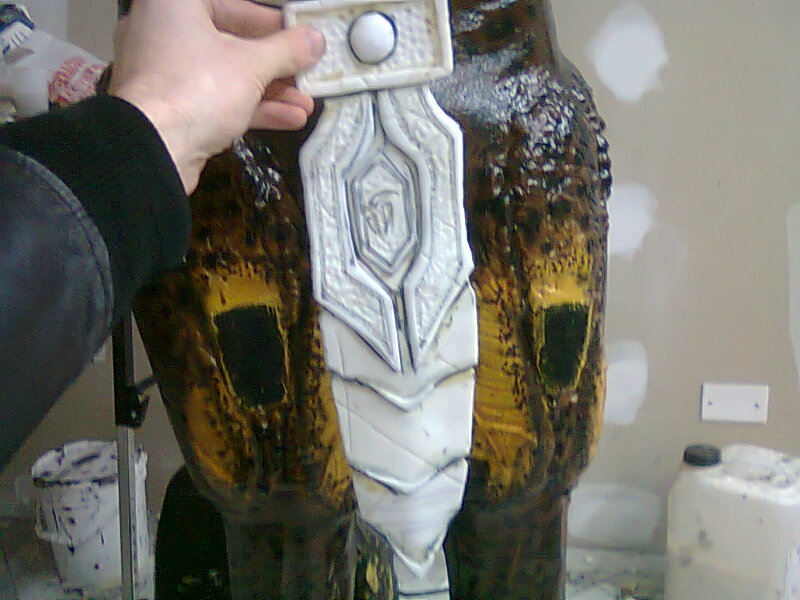

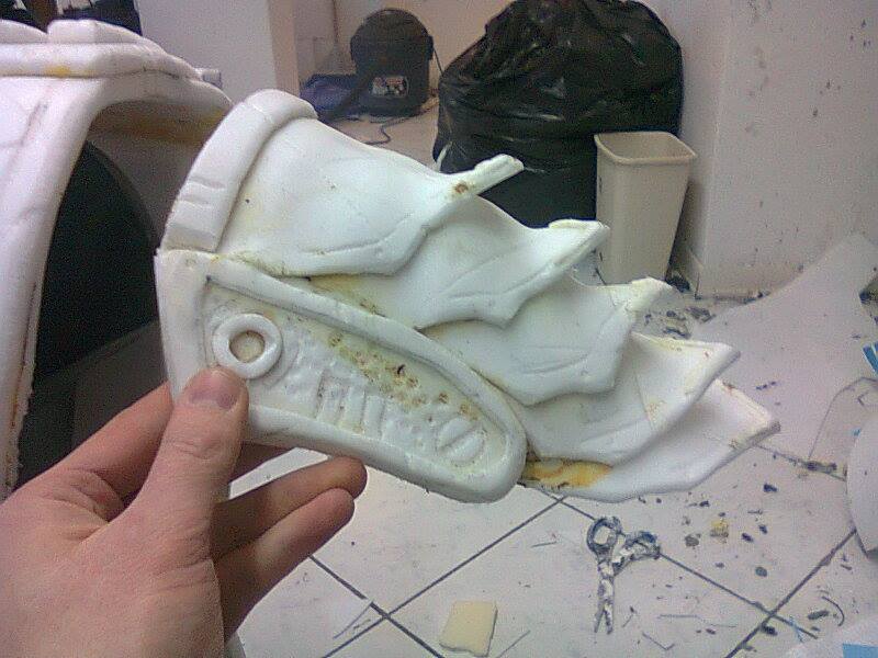

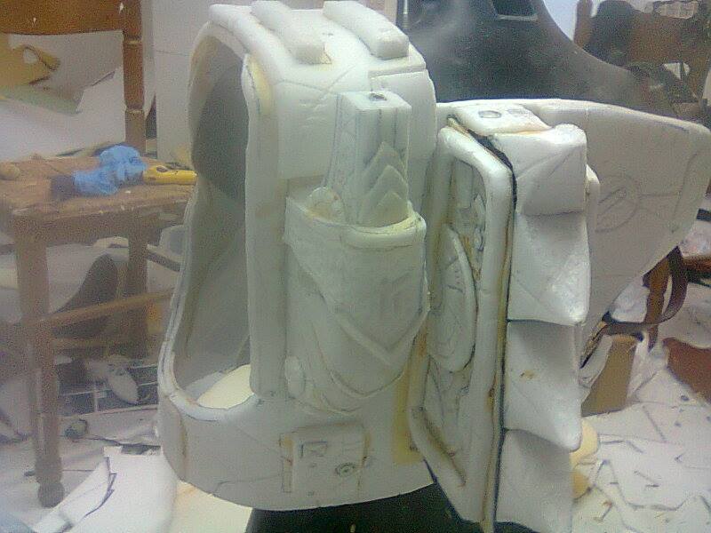

hi, i sculpted the piece of armor over the "balls", and did some fiti test, i'm also sculpting the shinguard
This suit is absolutely amazing! Definitely one of the best foam muscle suits I've ever seen. Keep up that awesome work! I'm looking forward to more updates!!!  :D

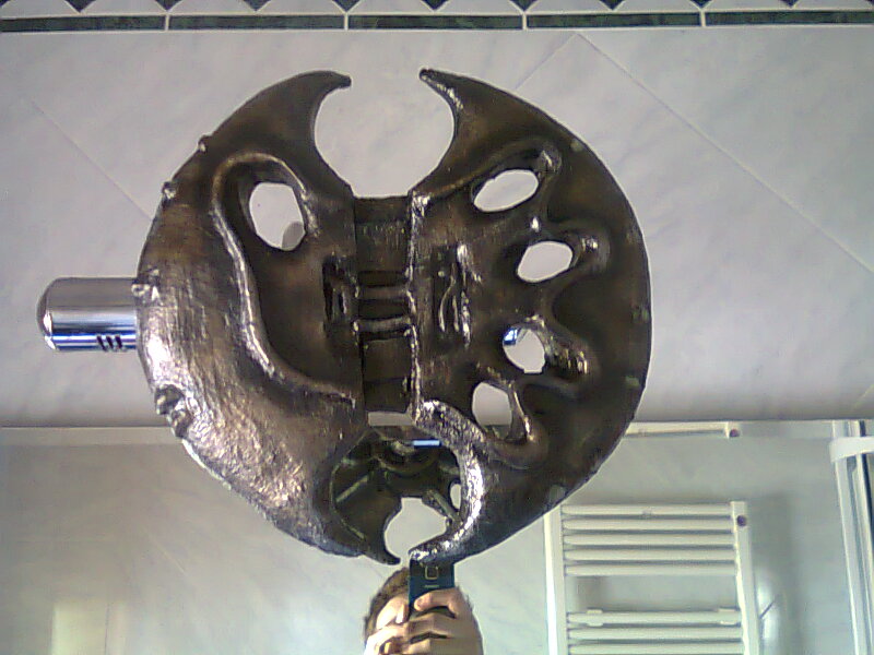

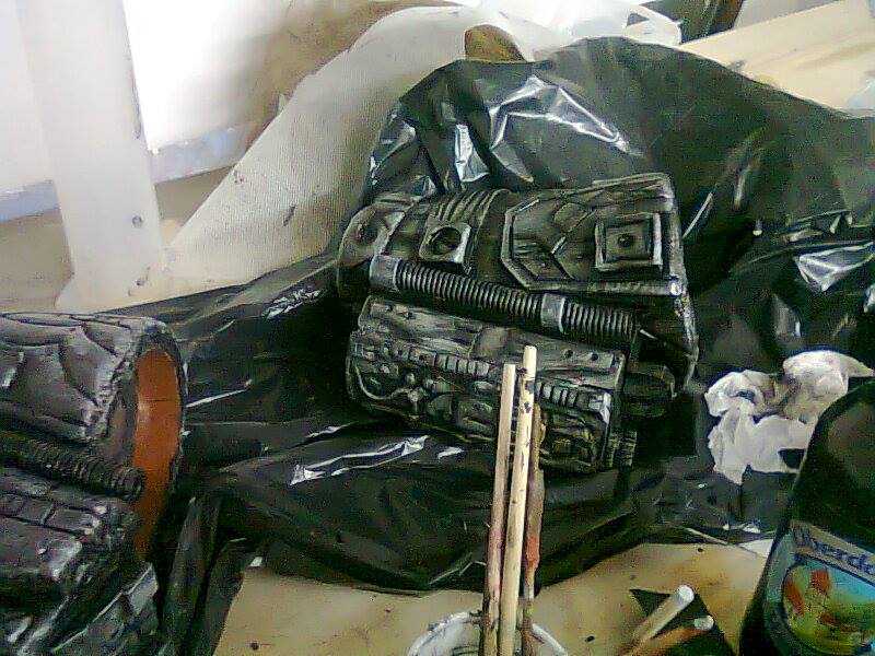

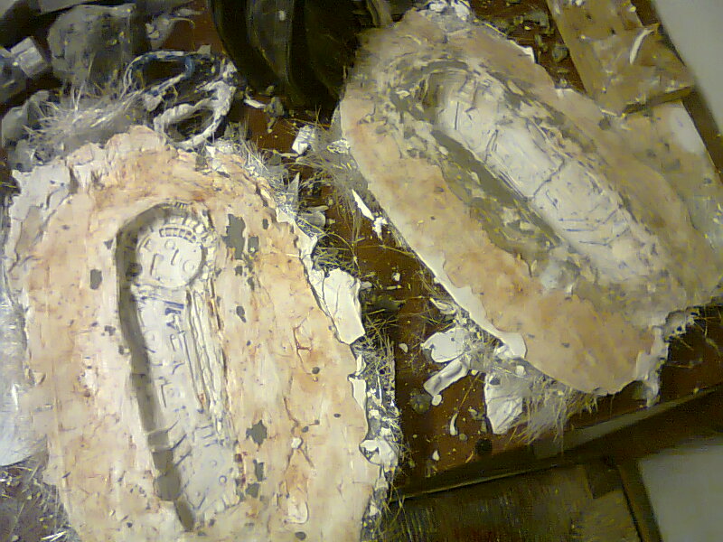

hi, i de-molded the helmet and the cannon, i also didi the left shoulder armor and the magnetic foam smart disk (lighter tha the resin one), now i have to paint the armor and add to it the micro-servos for the aniatronic caster...

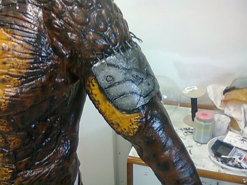

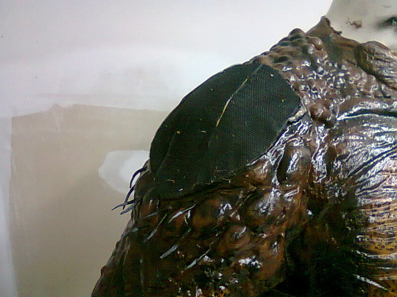

hi guys, i Painted the armor (soory the photos are not very good..) and i gut out the right soulder armor originally attacjed to teh body because i decided to to a removeble one more familiar with the general style of the armor... so i add some velcrum stripes on the shoulder.. Now i ahve to connete every chest-armor pieces and add the micro-servo to the cannon neck.. I saw the mr.increible suit tutorial and it's great!  If someone is interested i could make a similar tutorial to explain how to shape the soft foam and plastazote to do a muscle suit.
your muscle suit is ridiculously amazing!
