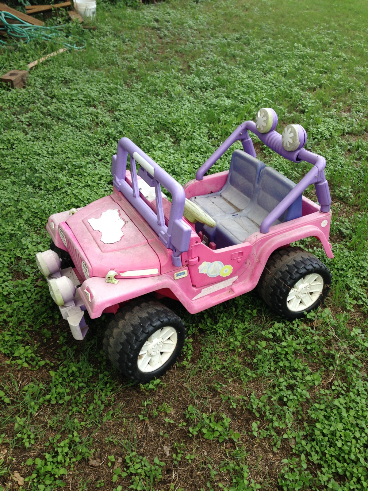

After much contemplation I went back to the idea I had originally wanted to do before I plunged thousands of dollars in on a real Jurassic Park Jeep. That was to make a miniature version that Ive since had just leaning up in the corner gathering dust. As you see this is a far as I got on that. :( (August 2014)

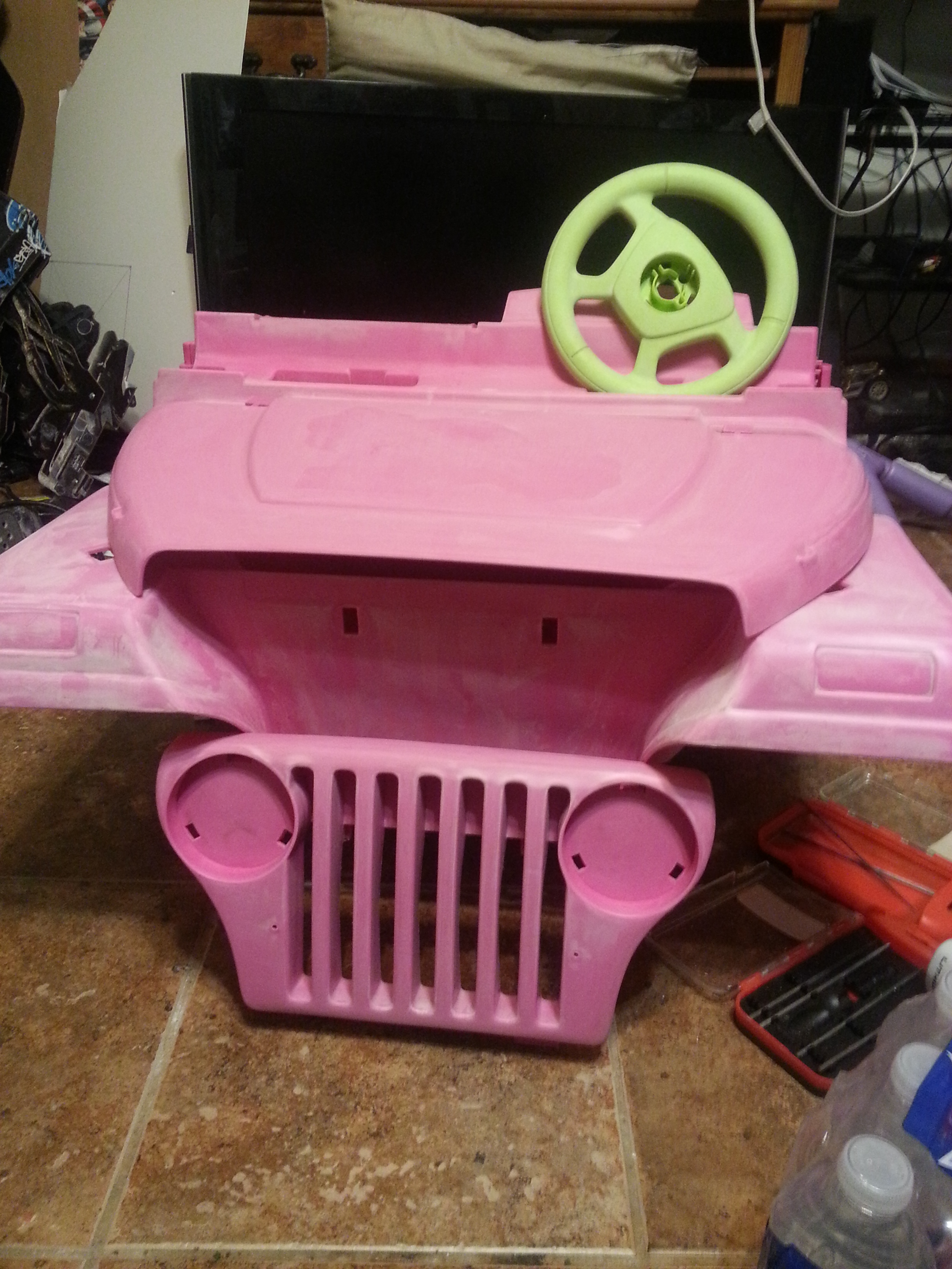

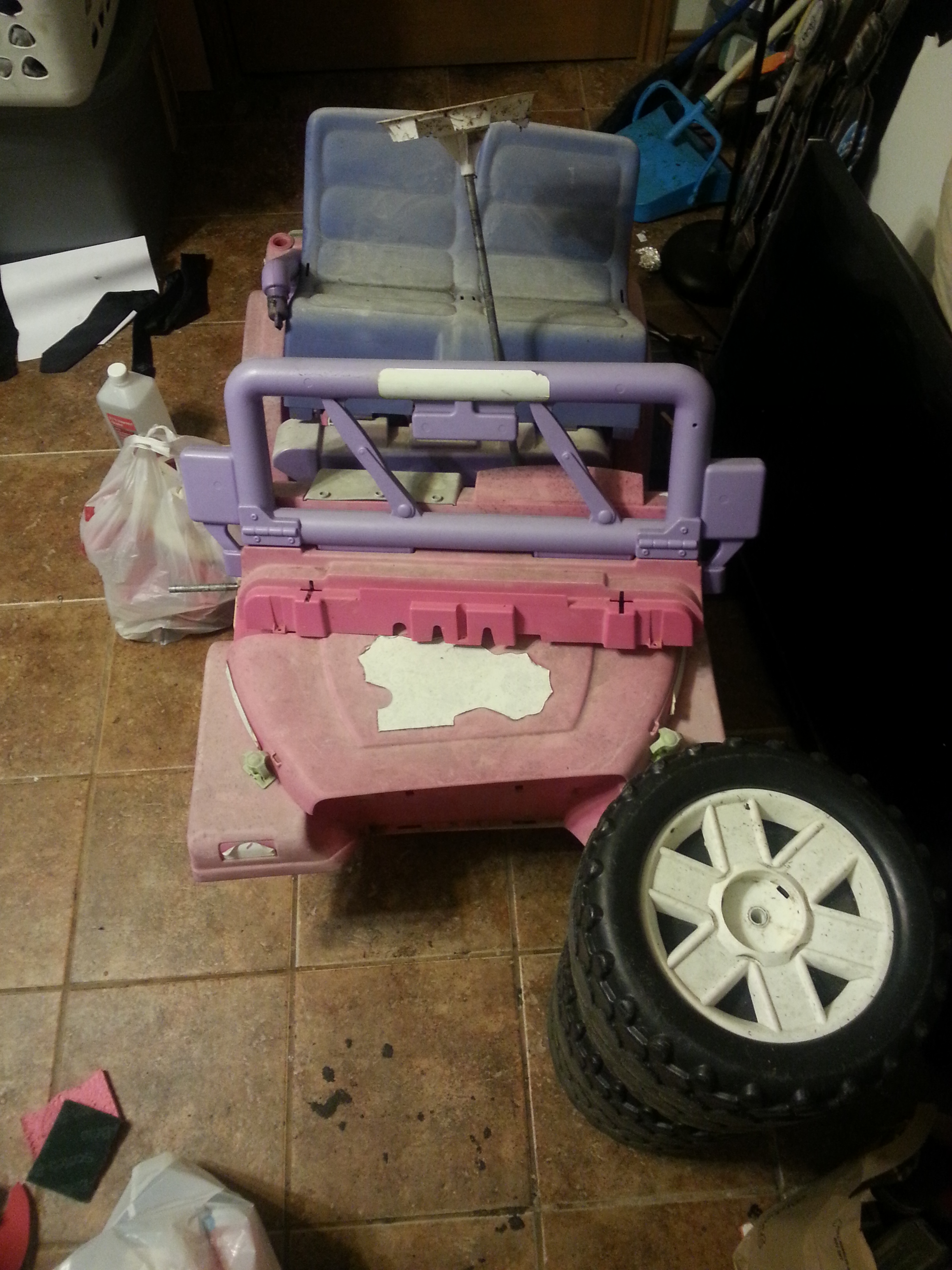

As that jeep has started to warp, has many inaccurate measurements, and was just all sorts of frustrating not having anything other than a hacksaw to cut. I really didn't want to dive into another project that with a release so soon that it would be near impossible working fulltime to finish. So I came up with a great alternative use something already existing. Power Wheels Barbie Jeep to the rescue! I found a few locally. The one I settled on was the lowest priced and when I arrived it was actually offered to me for free!

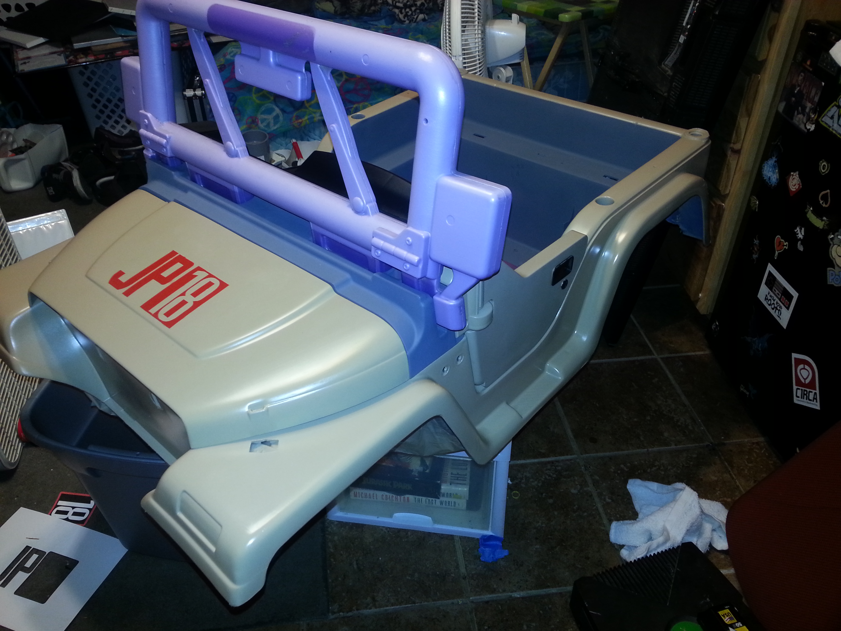

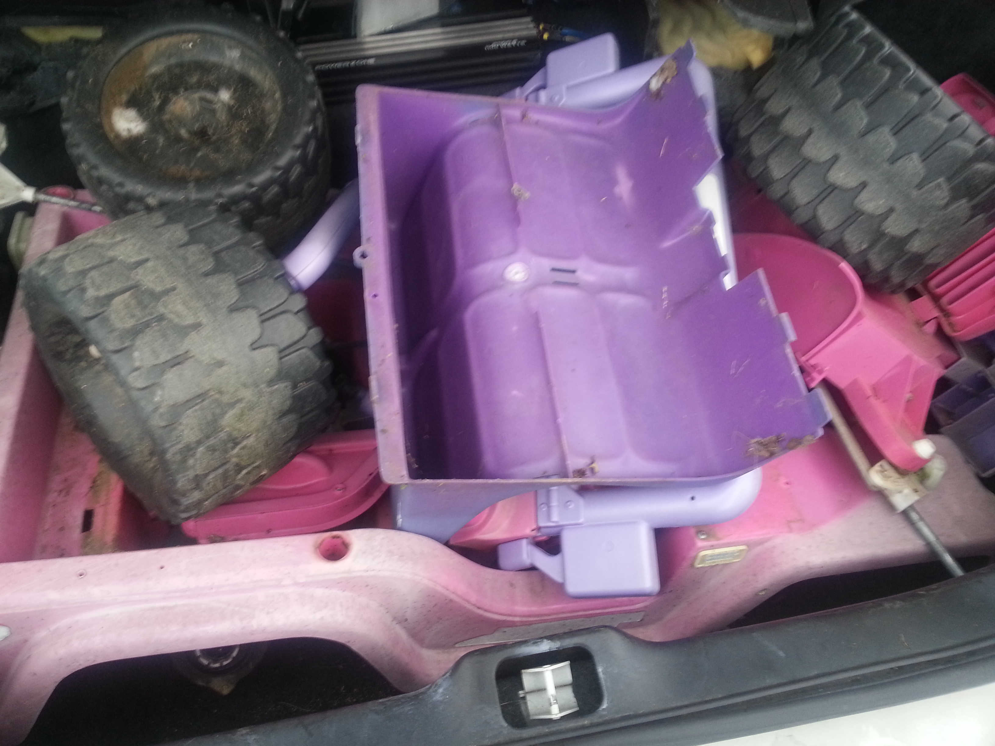

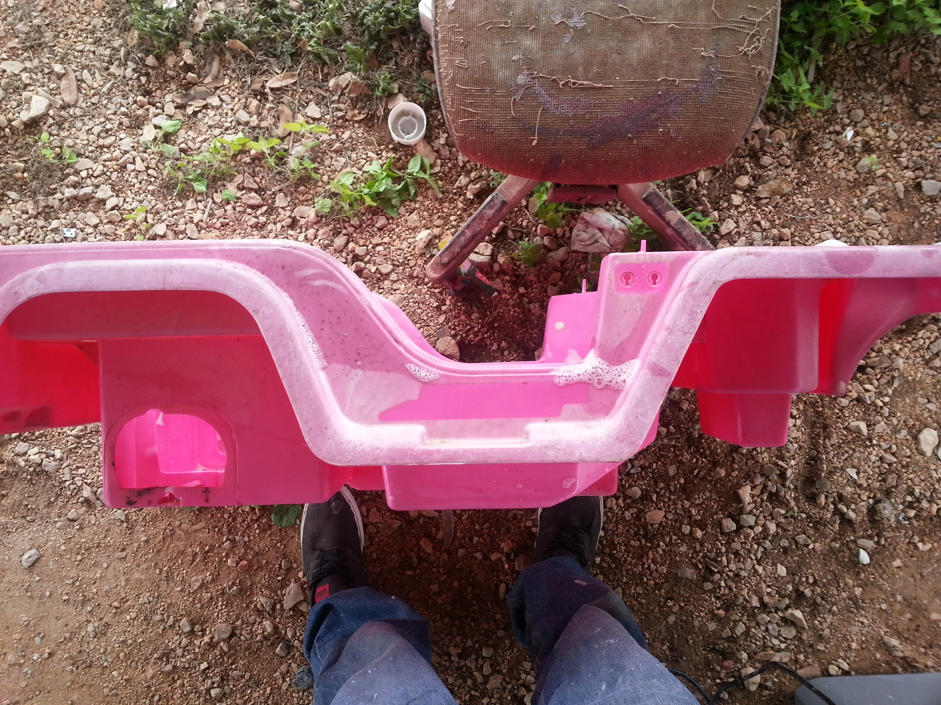

After disassembling the sunburnt, stained, and dirty jeep to force it into my police interceptor trunk it was off to cleaning!!
Oh boy was there alot of cleaning and sanding and more cleaning. This was defiantly the longest part of the process so far and the least fun.... (well almost, we will get there)

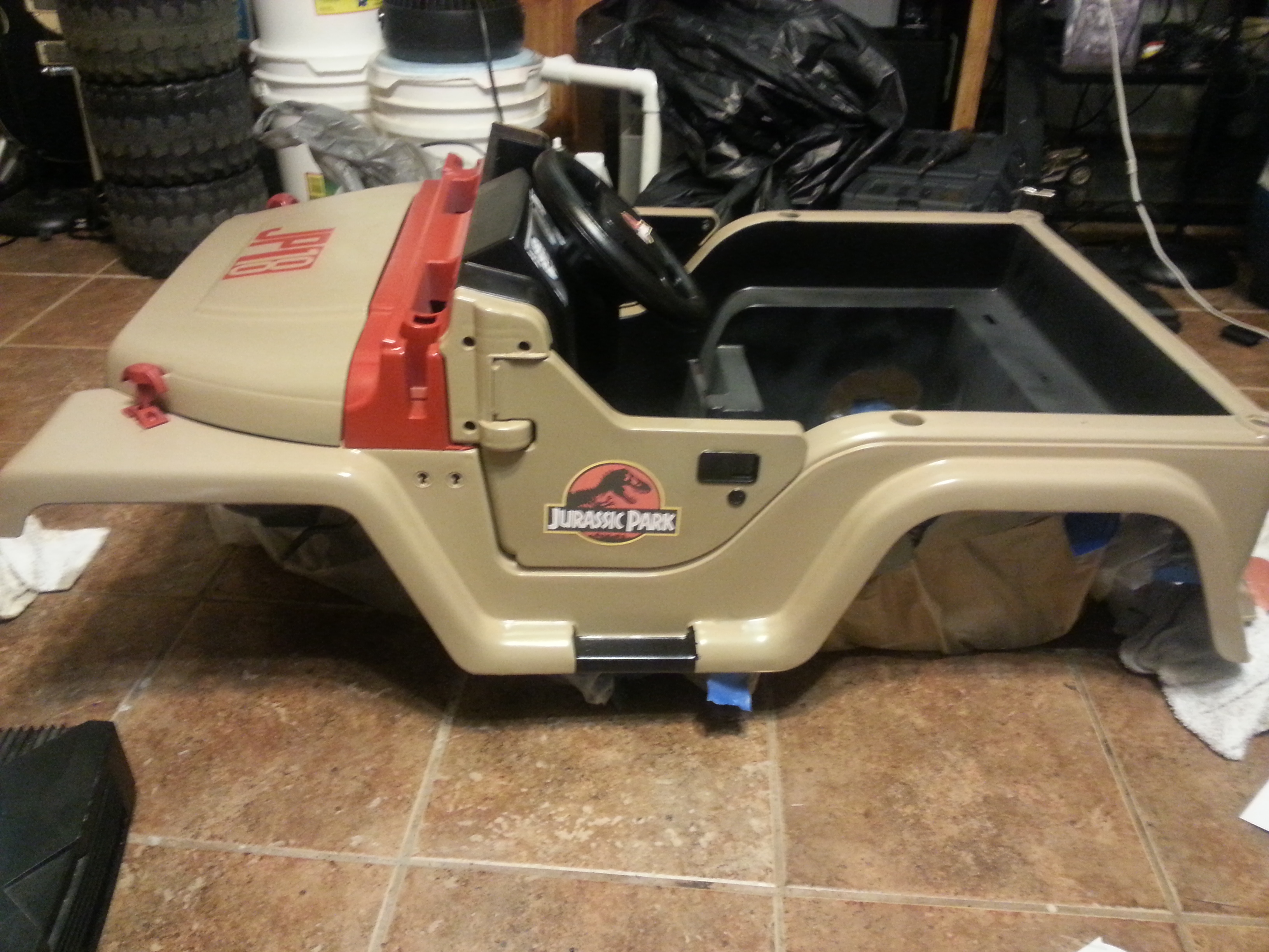

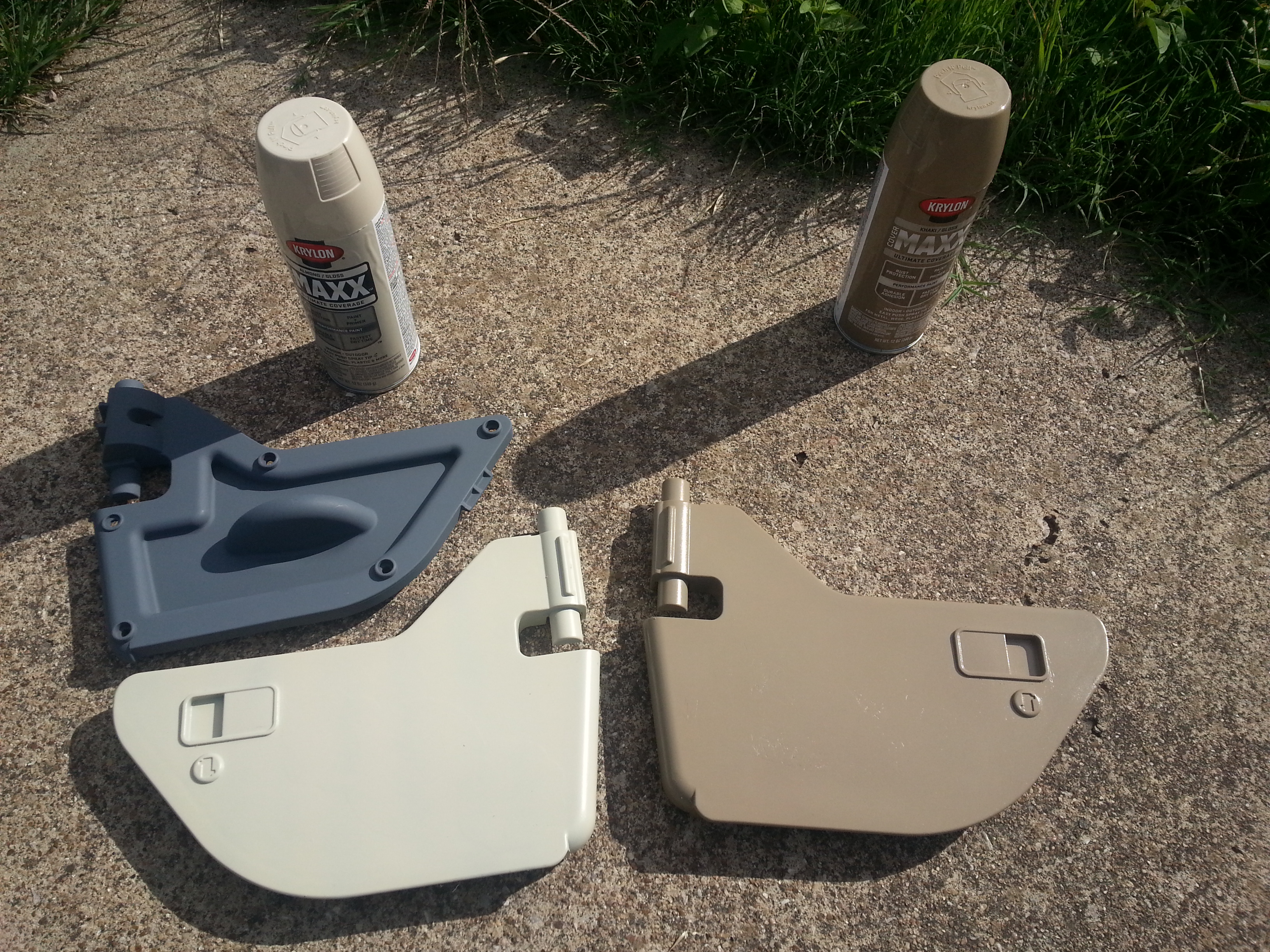

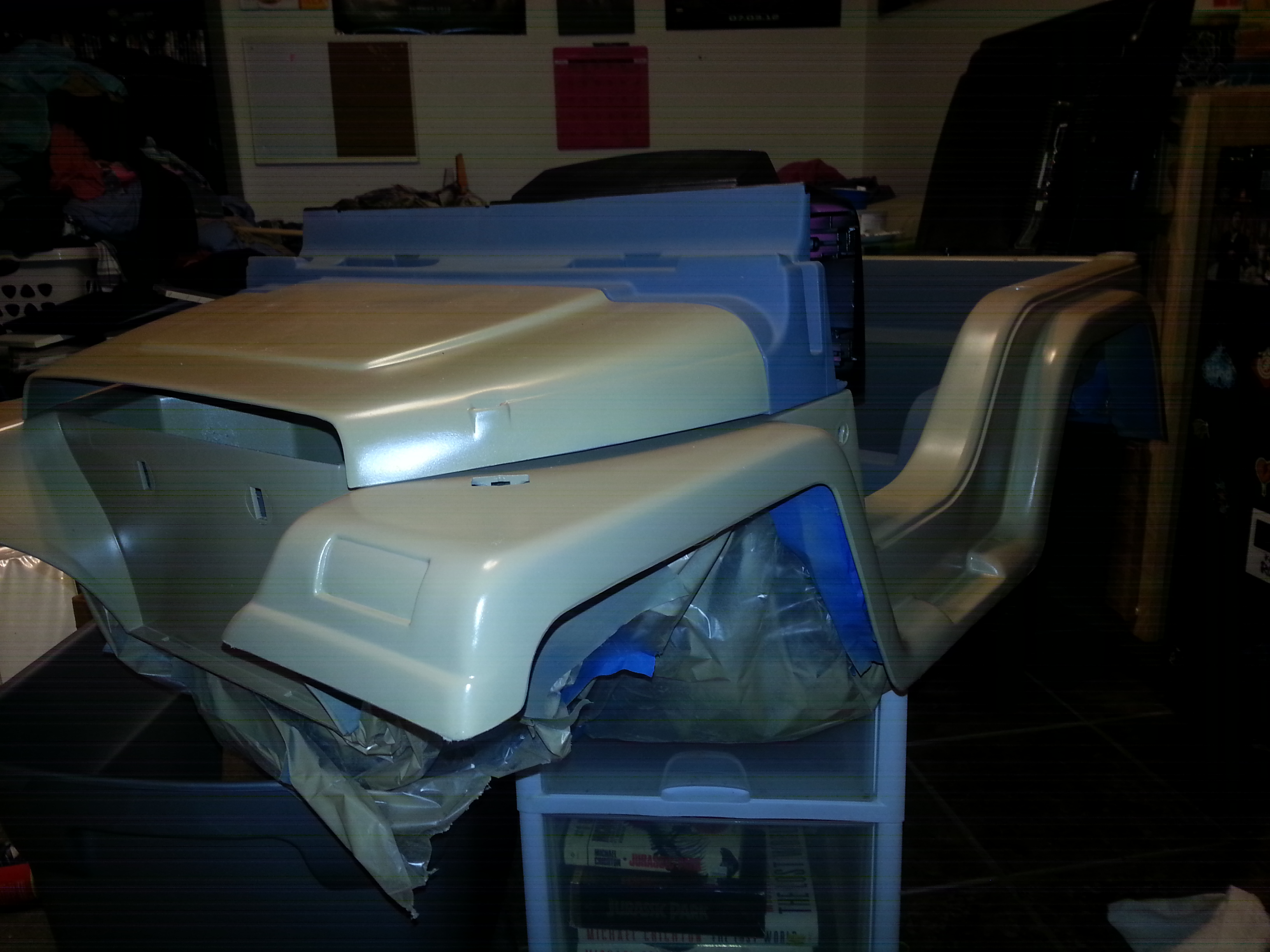

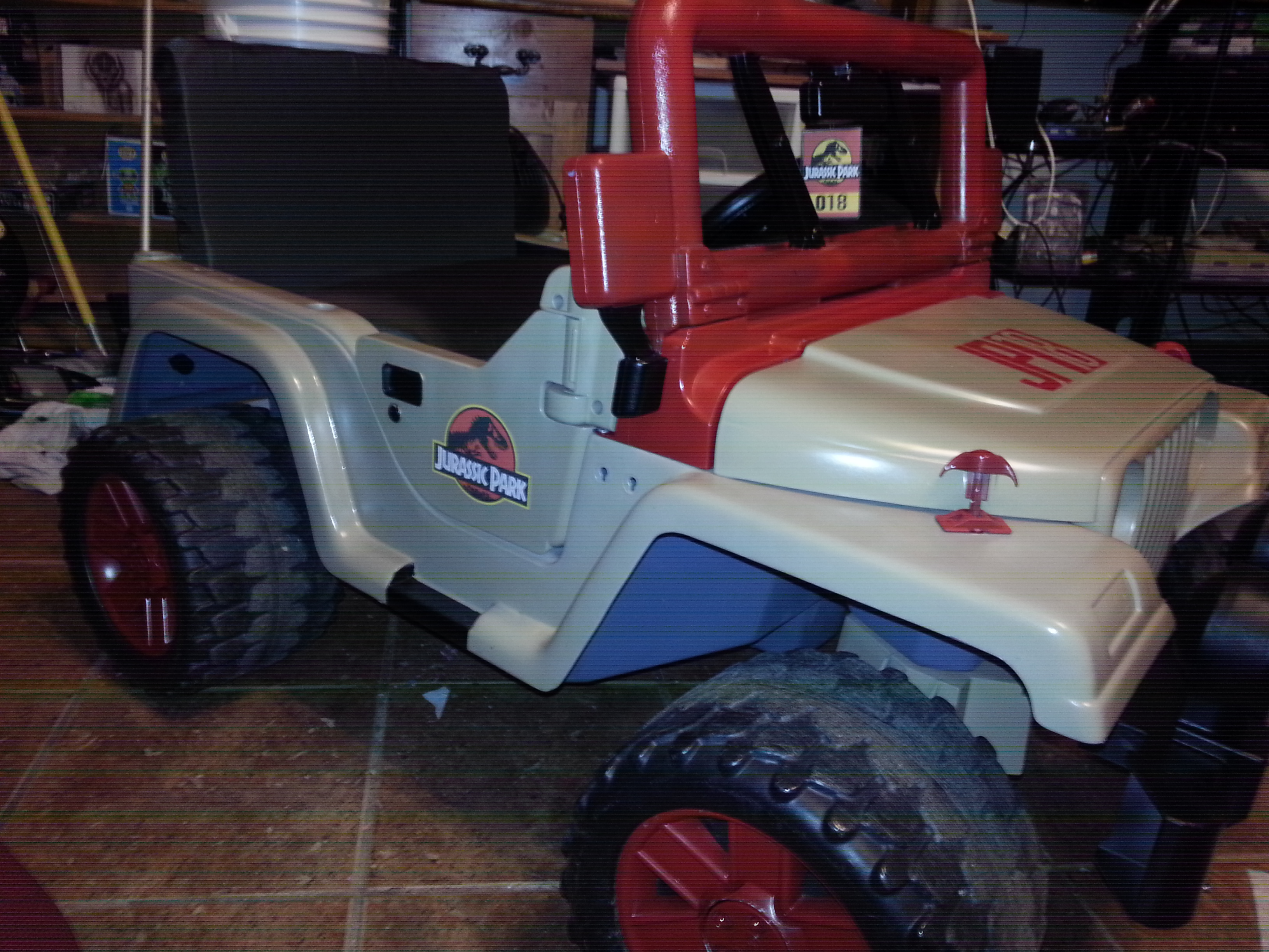

After the rain cleared it was painting for 3 days straight. 3 coats of primer for everything as I was overly cautious that the plastic wouldn't take to the paint very well. (Krylon Max)
The first can of color I went with was too tan for my liking so I switched over to a Khaki color and was pleased with the look.
While working on painting the main body I was scouting theRPF and found Andrewshaddox and his great Barbie Jeep to Jurassic Park Jeep conversion and was super excited to see someone else who had done the same and did a darn good job! You should check it out if you havent seen it yet! Link to his thread - http://www.therpf.com/showthread.php?t=238464
After seeing Andrews and talking to my boss I thought it would be really cool if we could have a place set up as a display for the jeep. Annnddddd then things get complicated. From just a Jeep this project turned into a full on display above our entrance doors complete with a T-Rex, foreground/background elements, lights, and a matte painting for the background. I tend to get overly ambitious on projects. What can I say?? :D

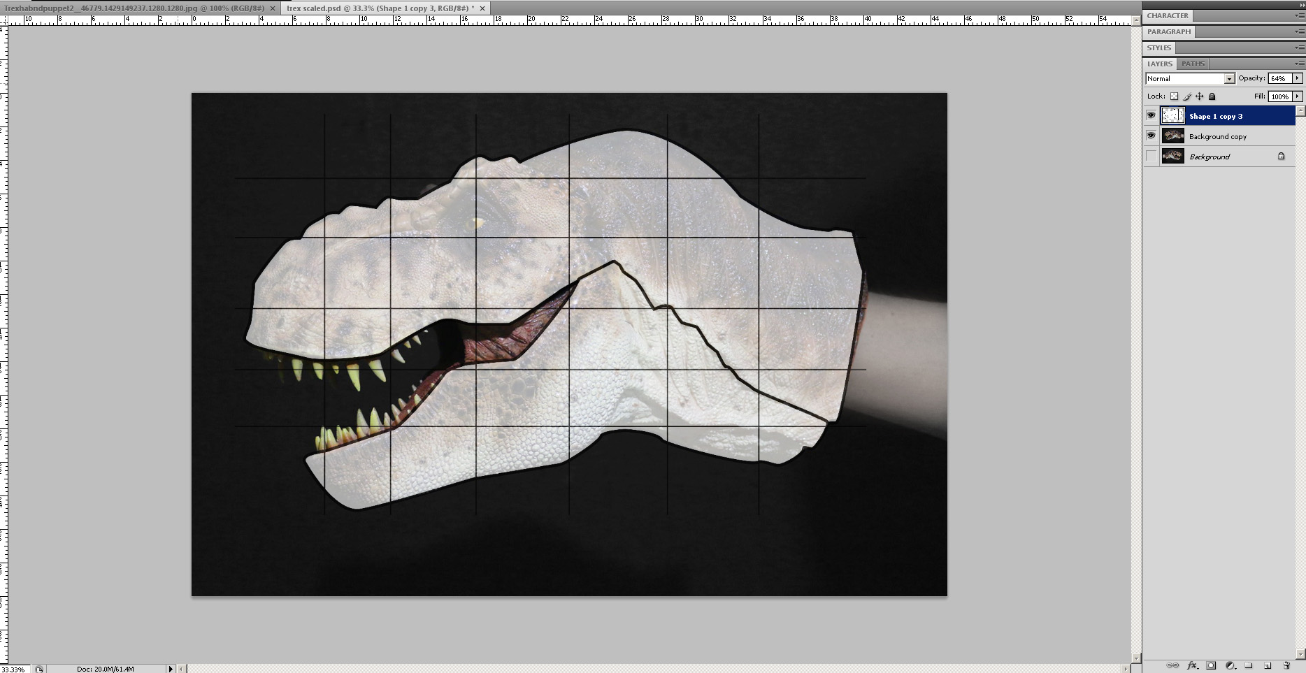

So while continuing progress on the jeep throughout the month of May and into June I also started figuring out the game plan and some things to add. 2 big things I wanted was the T-Rex Head to scale if the jeep was actual size and a scaled version of the East Dock sign from the movie.

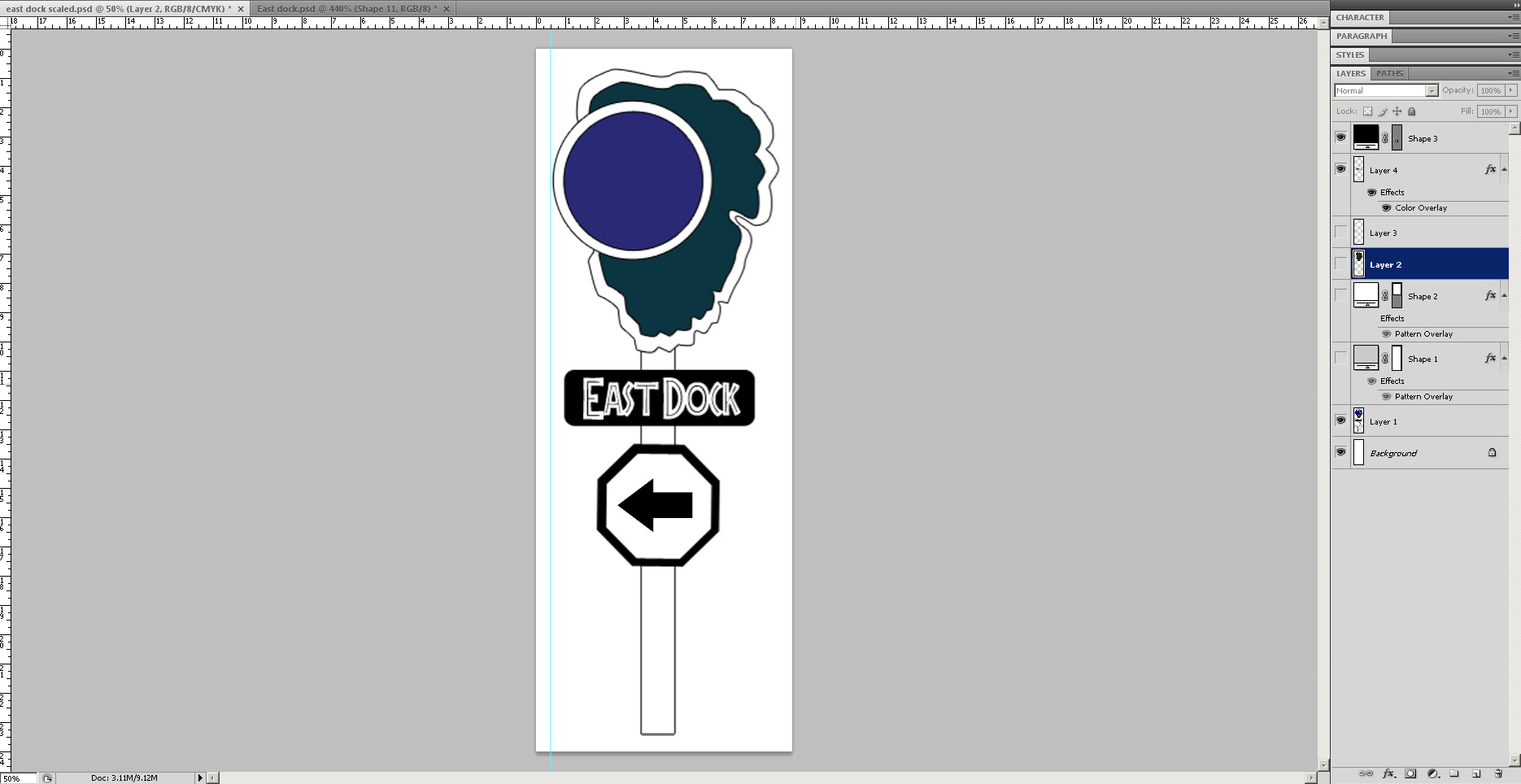

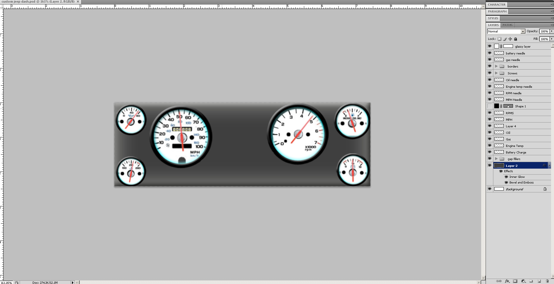

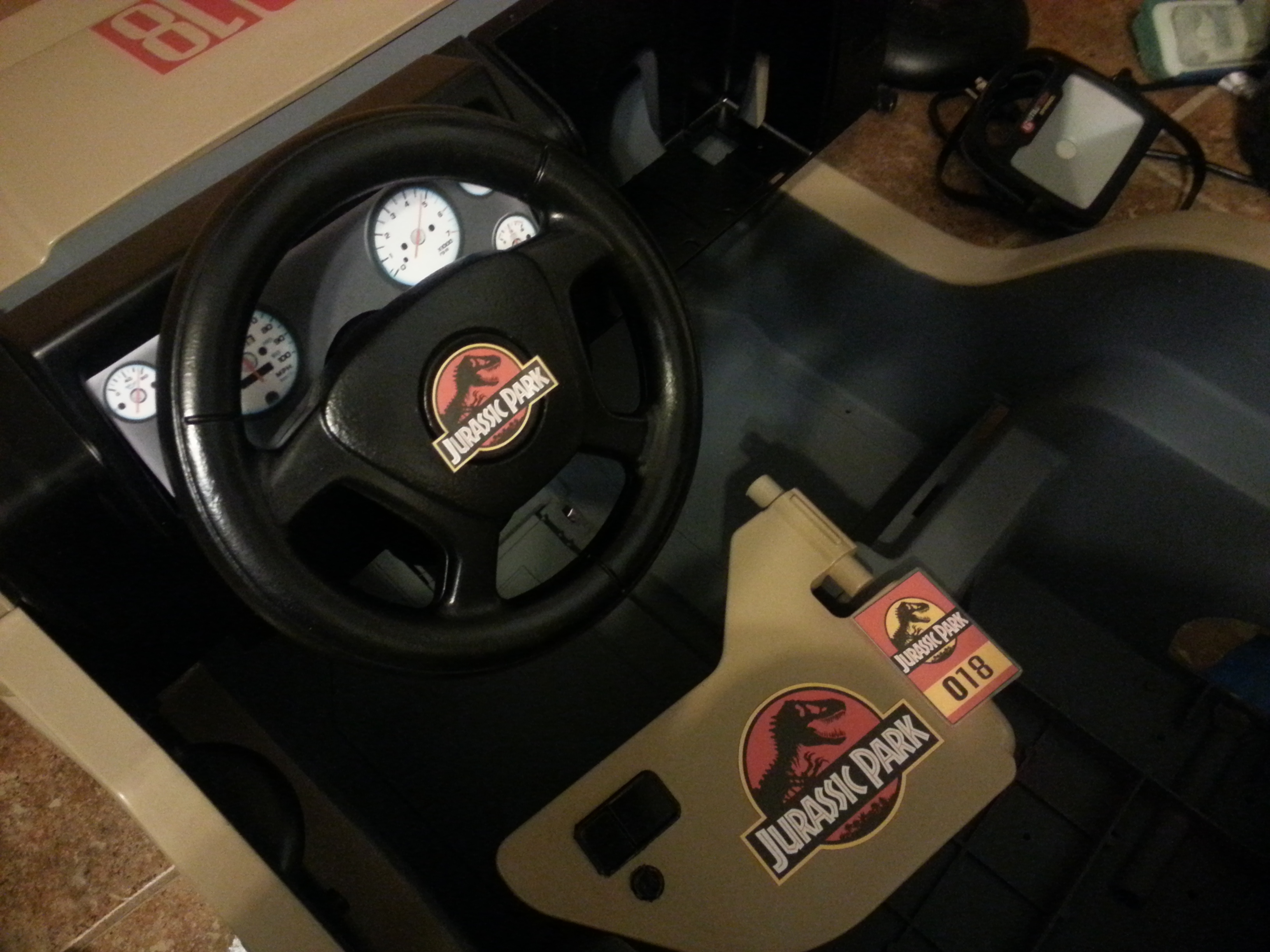

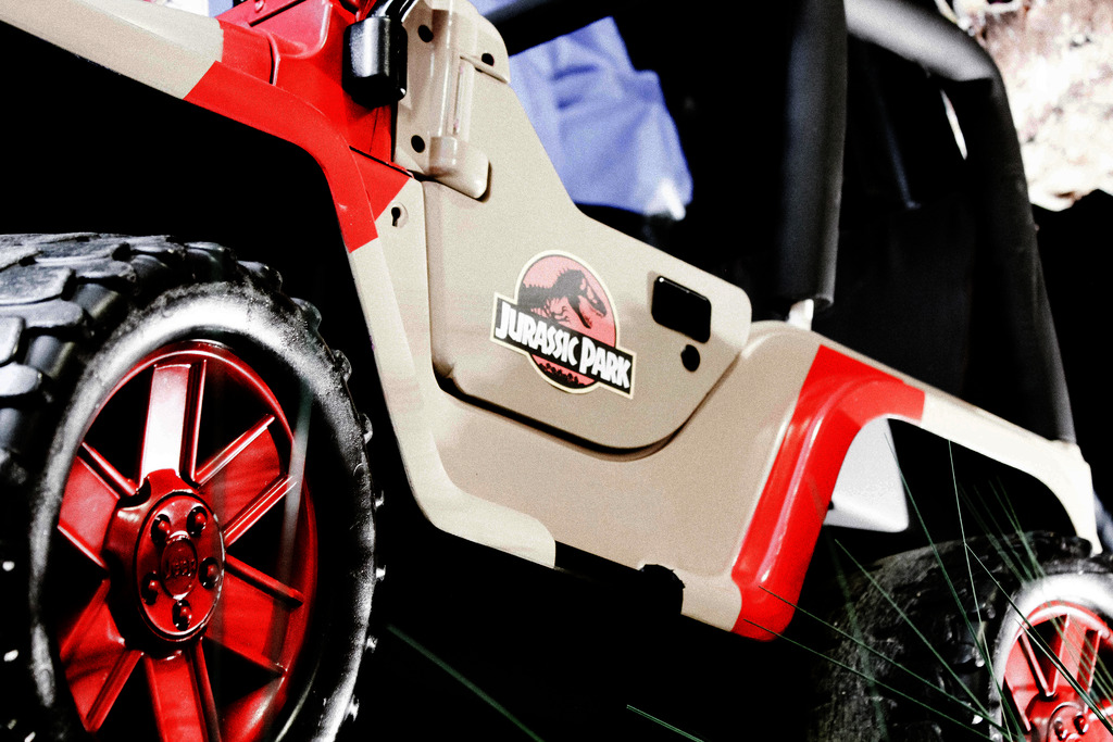

I created several images to use in the jeep and also used existing reference images and files from thejurassicparkjeep forums. I wanted to keep cost low so having decals cut in vinyl was out of the picture so I went a cheap but quick route. I used full sized sheet shipping labels to print my decals and some stencils on. This method while being effective also has the downfall of the adhesive not holding very well under the Texas heat so when I take it to the theater im most defiantly have to cover it from the heat and sun.

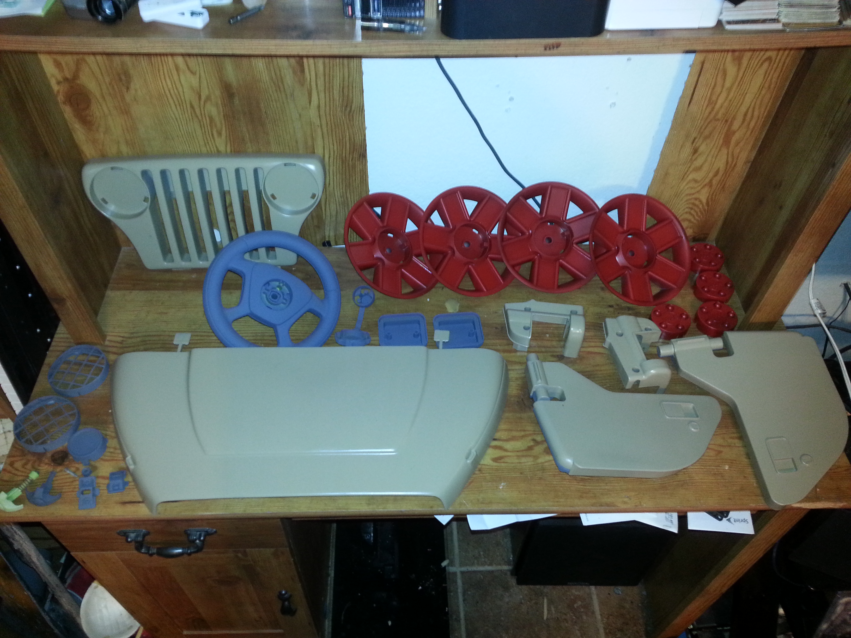

Shortly after finishing the decals and printing them out painting was nearing completion so I slapped on as many decals as I could at once :p
After getting overly excited after I slapped the decals on I went into full on work mode for many hours without to many progression photos. Sorry I got really into it :p

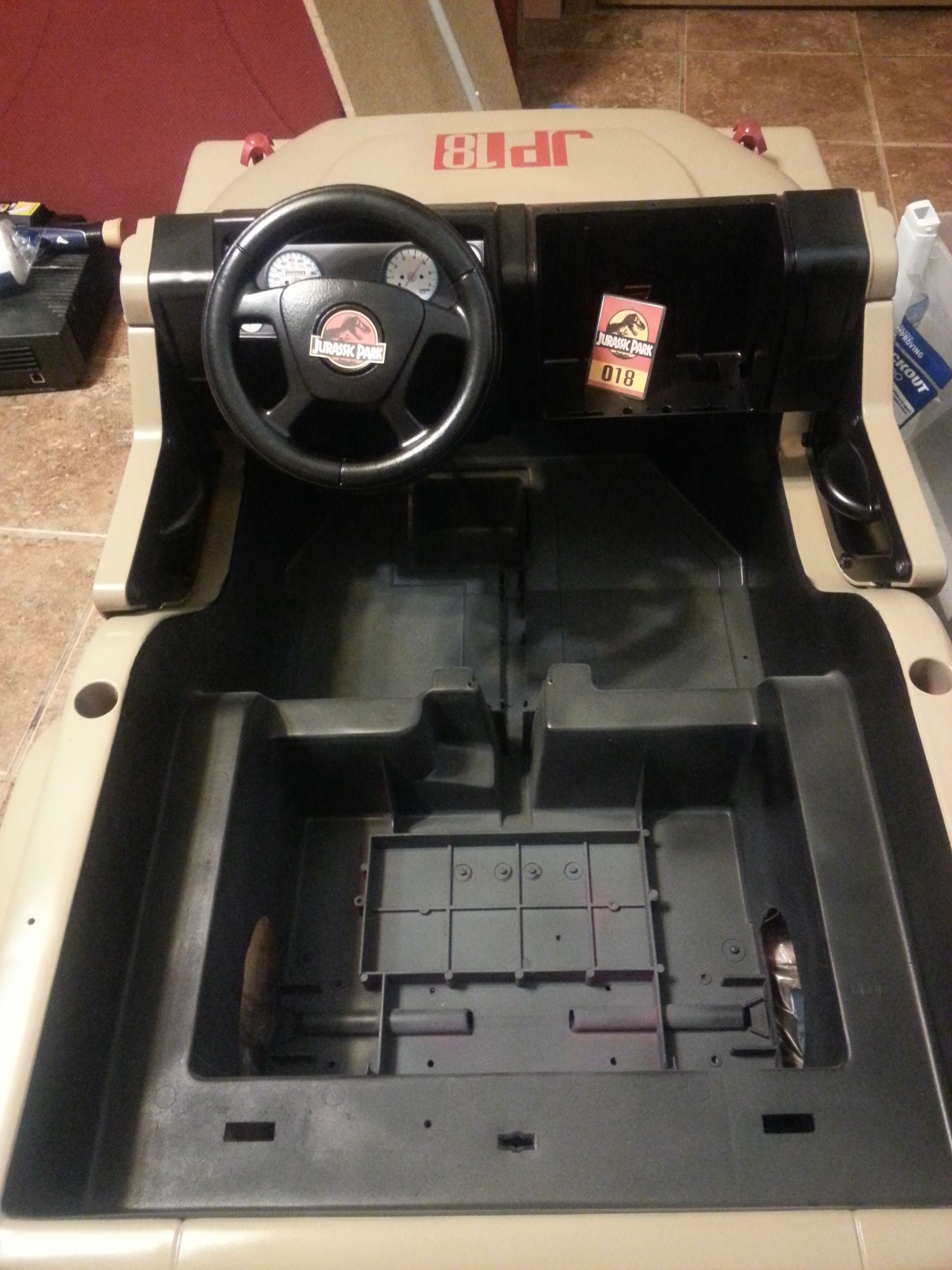

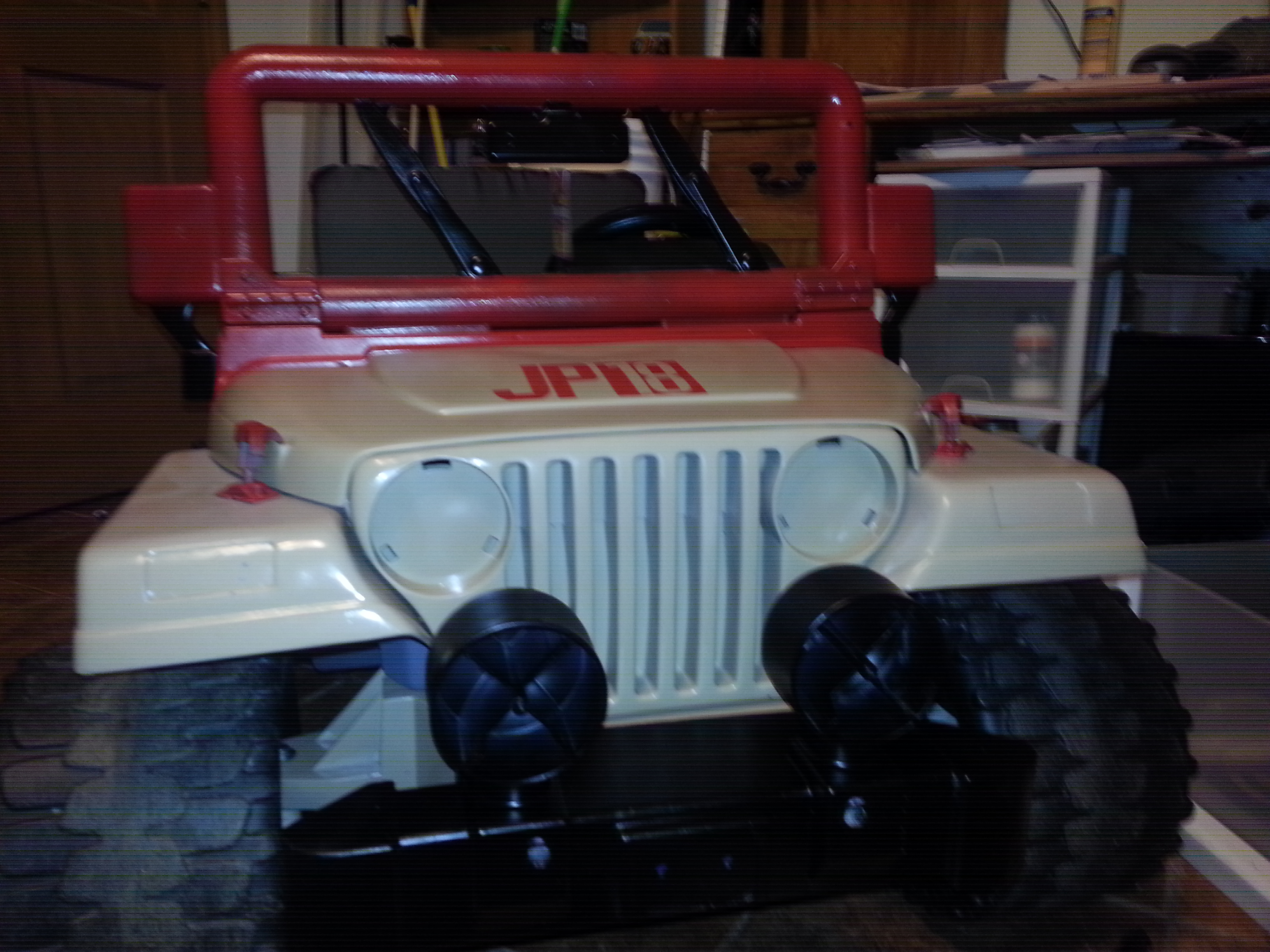

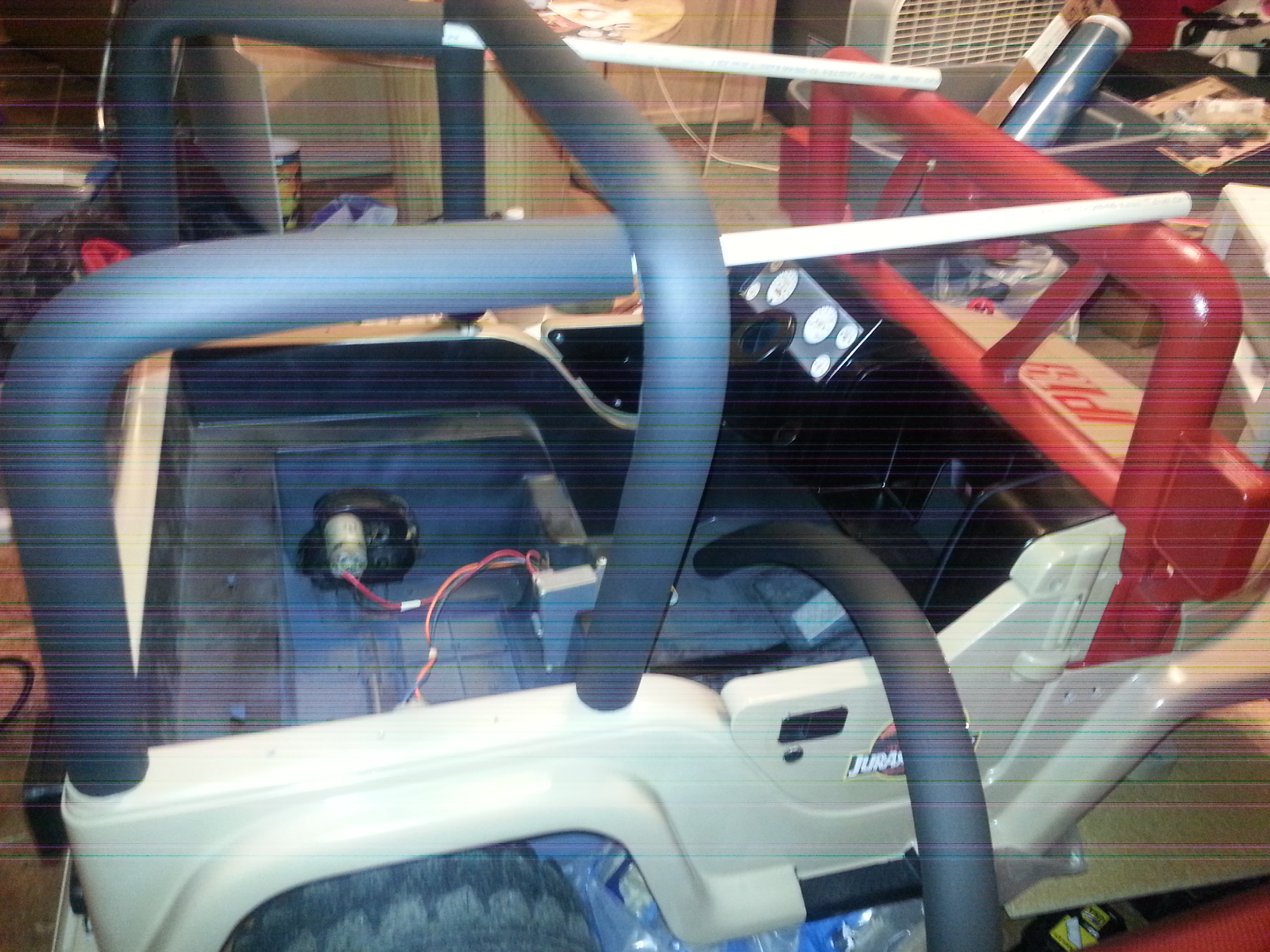

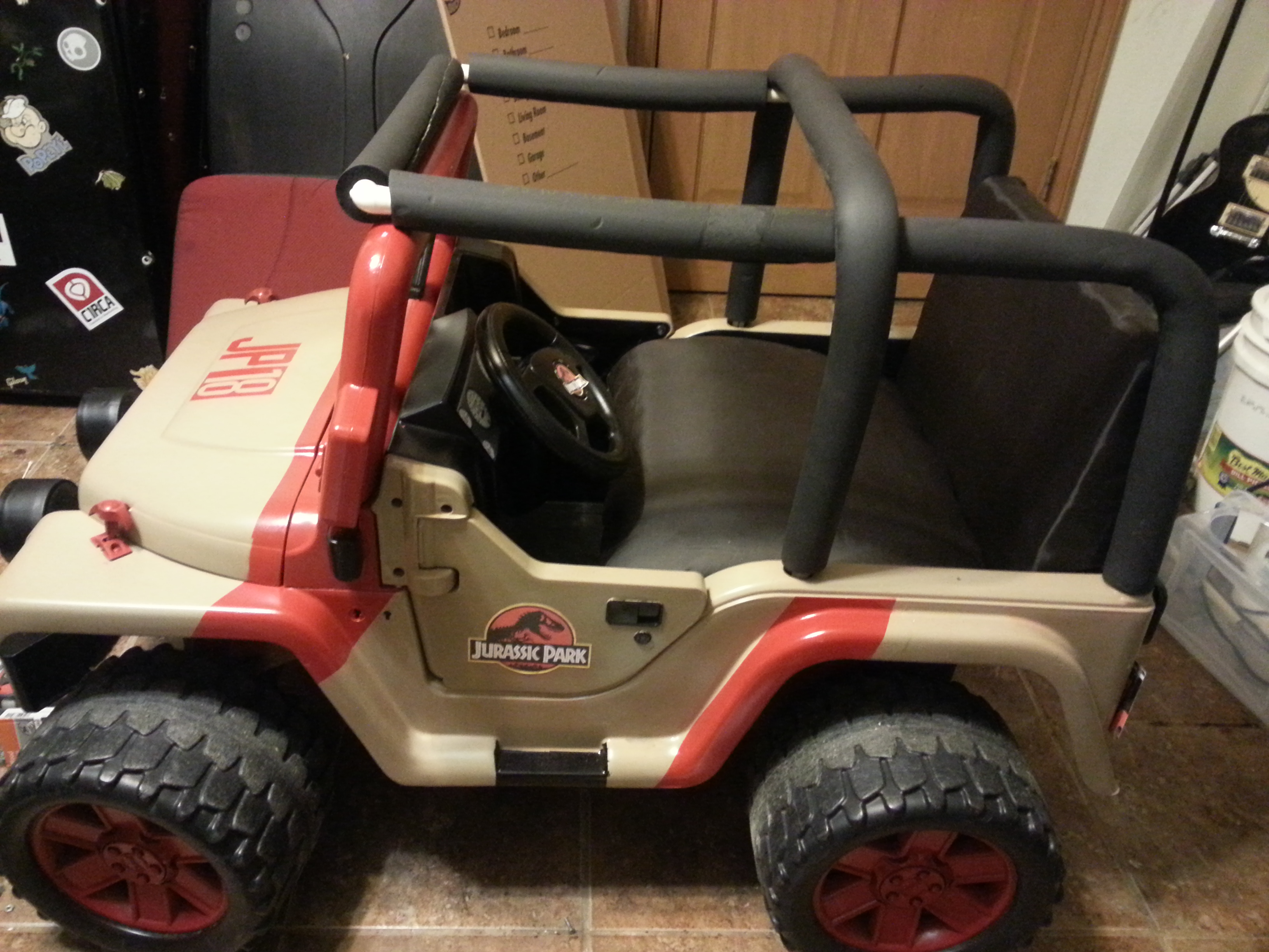

I started figuring out how to mount a roll cage on the jeep because I didnt like the look of the standard barbie jeep ones. So I made one using 3 pieces of CPVC, a heat gun and pipe insulation (the nice rubbery kind) Also added the semi painted windshield to early.
Shortly afterwards took the windshield back out and painted it fully and then made a seat. Ive never done any uplhostry work before so please take it easy on me :p Its just 2 pieces of MDF, a pillow for the bottom seat, 2 thick pieces of interlocking foam used in shipping ice cream cones for the back, and all wrapped in a nice comfy cloth. What you cant see is a bajillion staples that I had to hide! :p

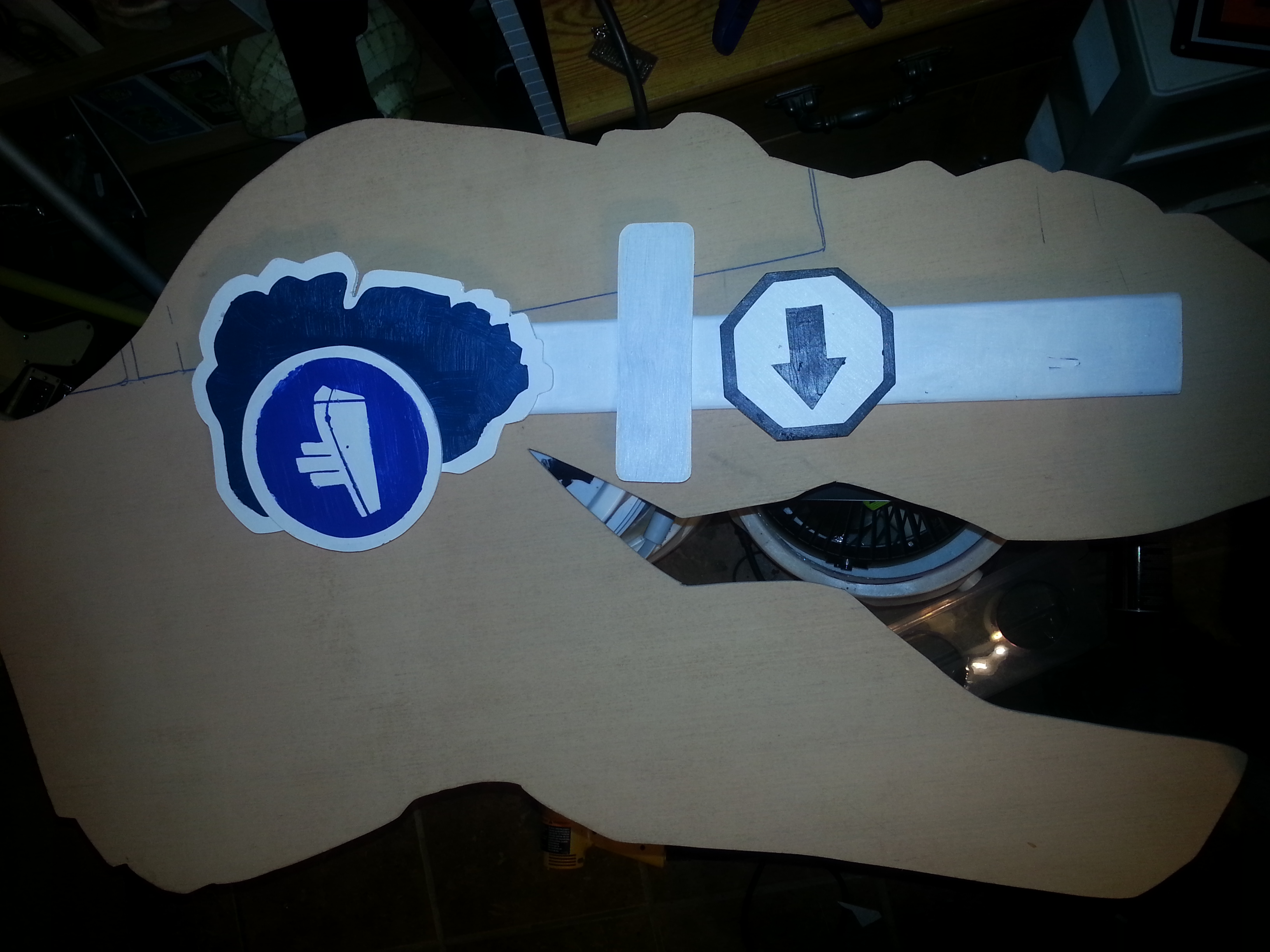

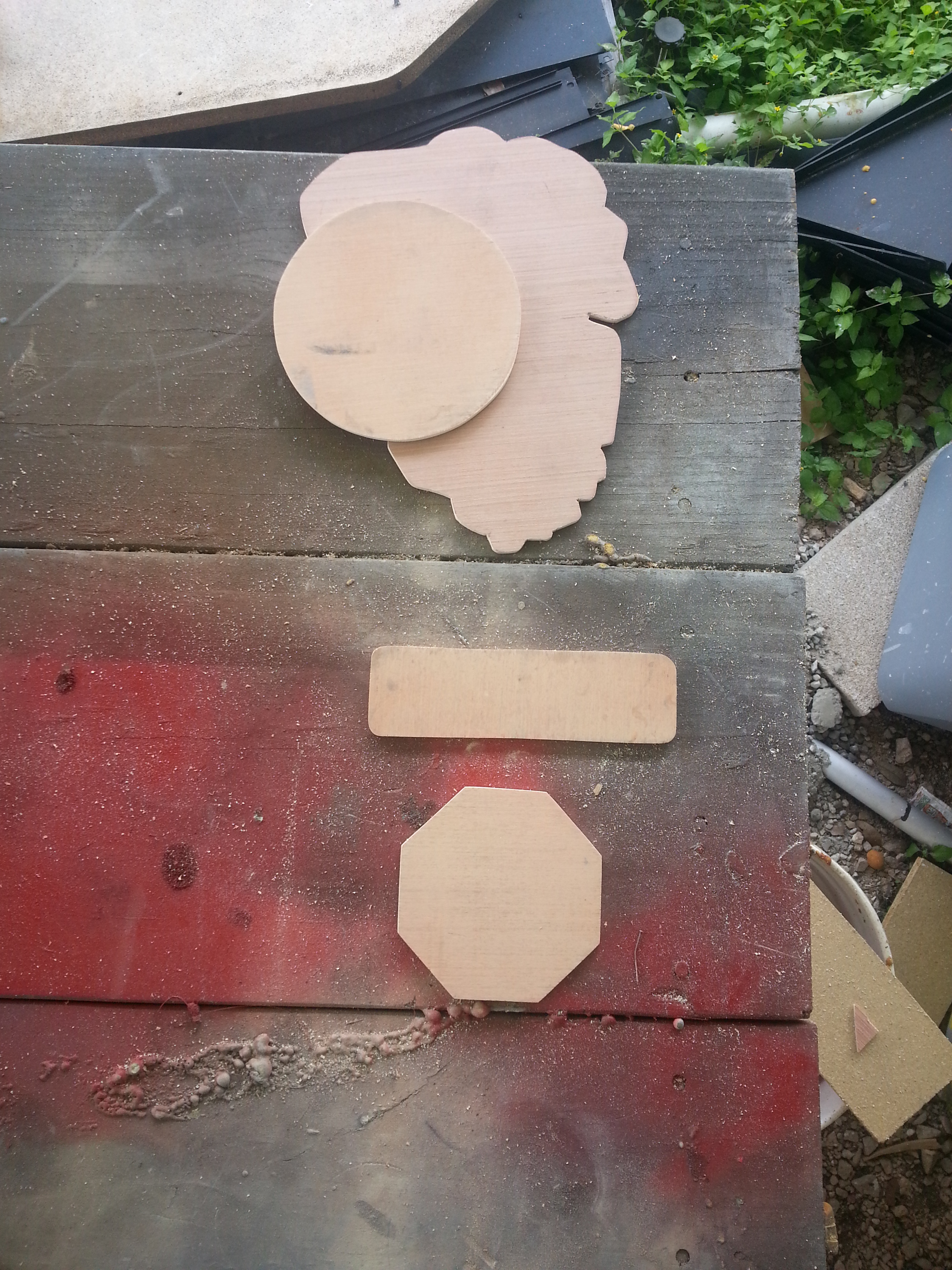

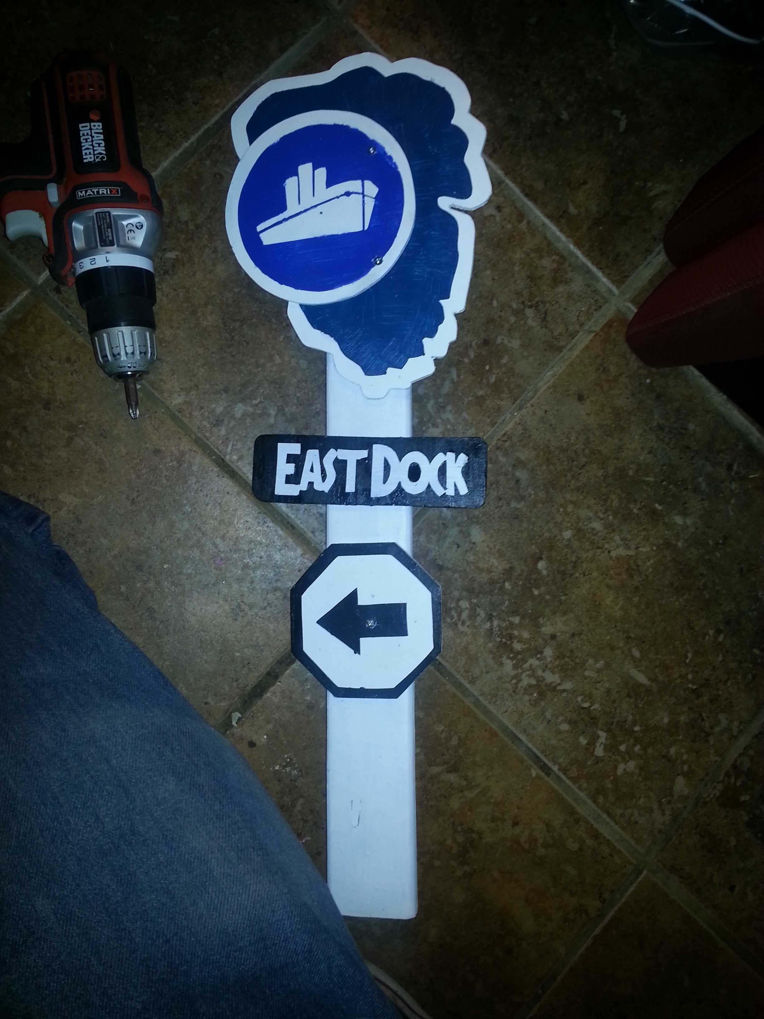

I cut out all the templates in thin wood for my East Dock Sign, the T-Rex Head, added the stripes (but I forgot to put the number stencil before I painted :cry), primed, painted, and bolted the East Dock sign (with spinning arrow :D), started the expanding foam adventure and continued construction on the roll cage.

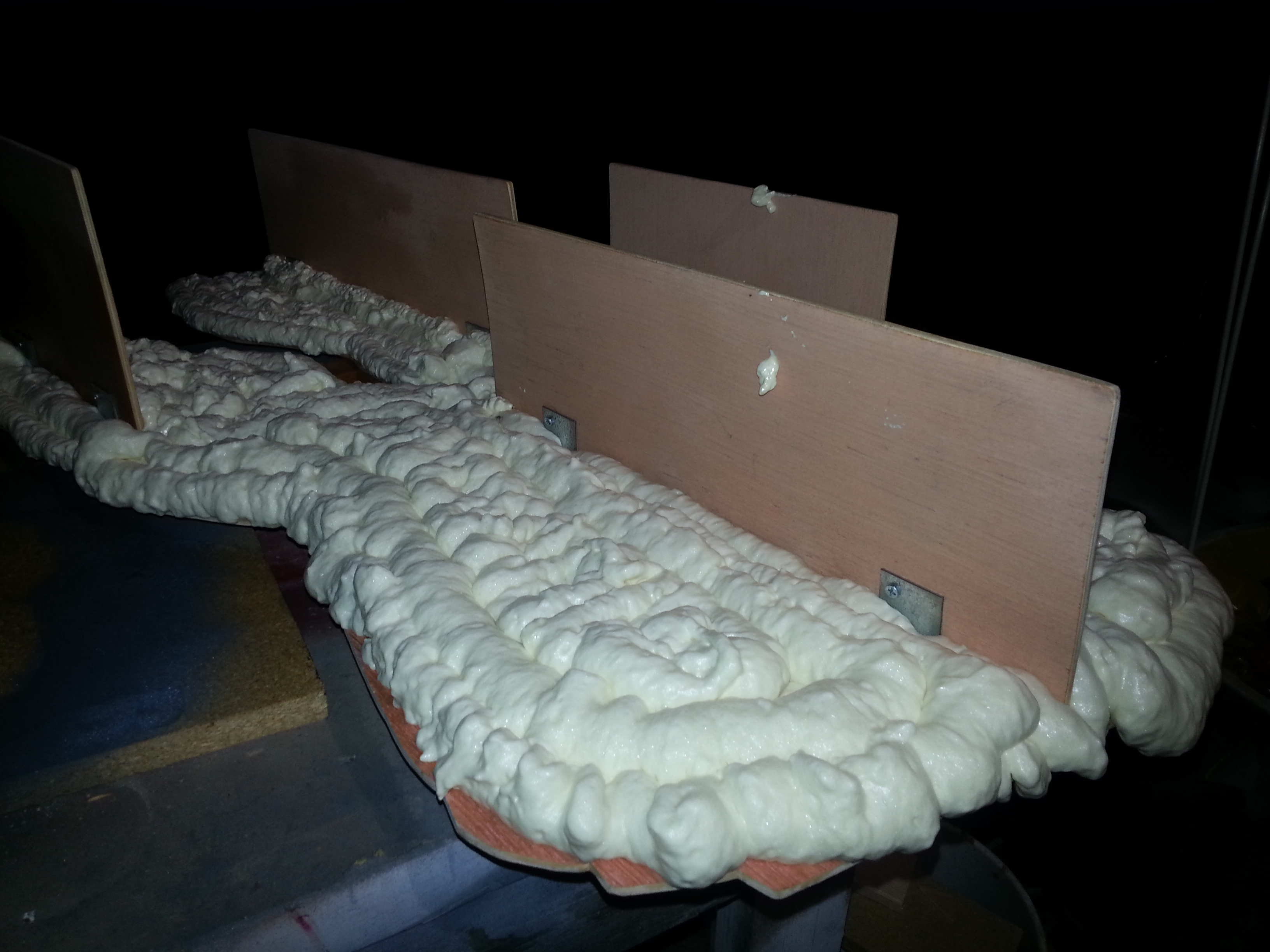

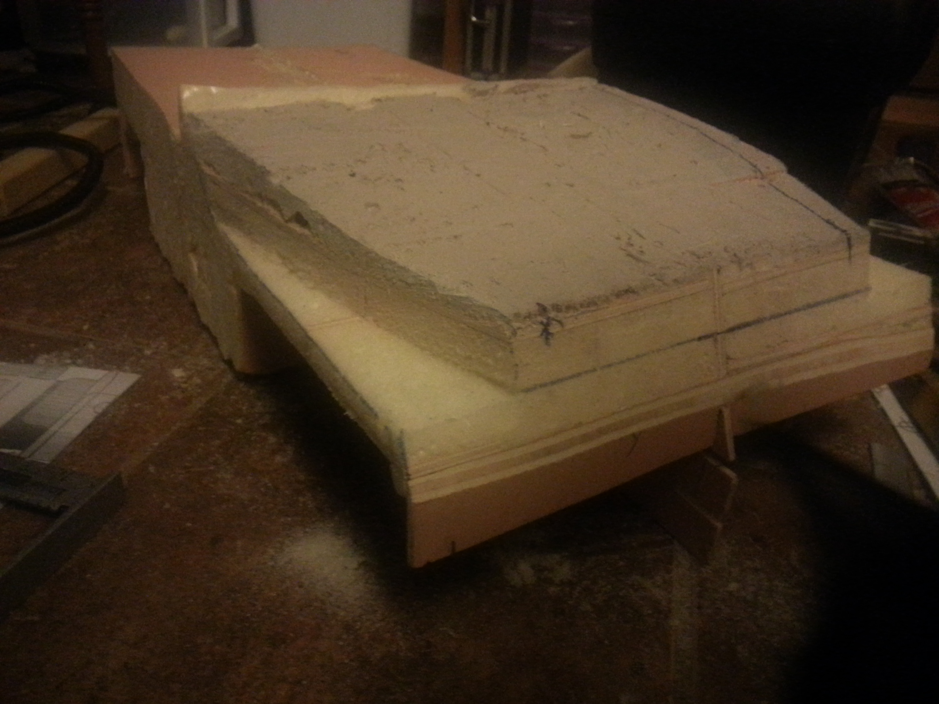

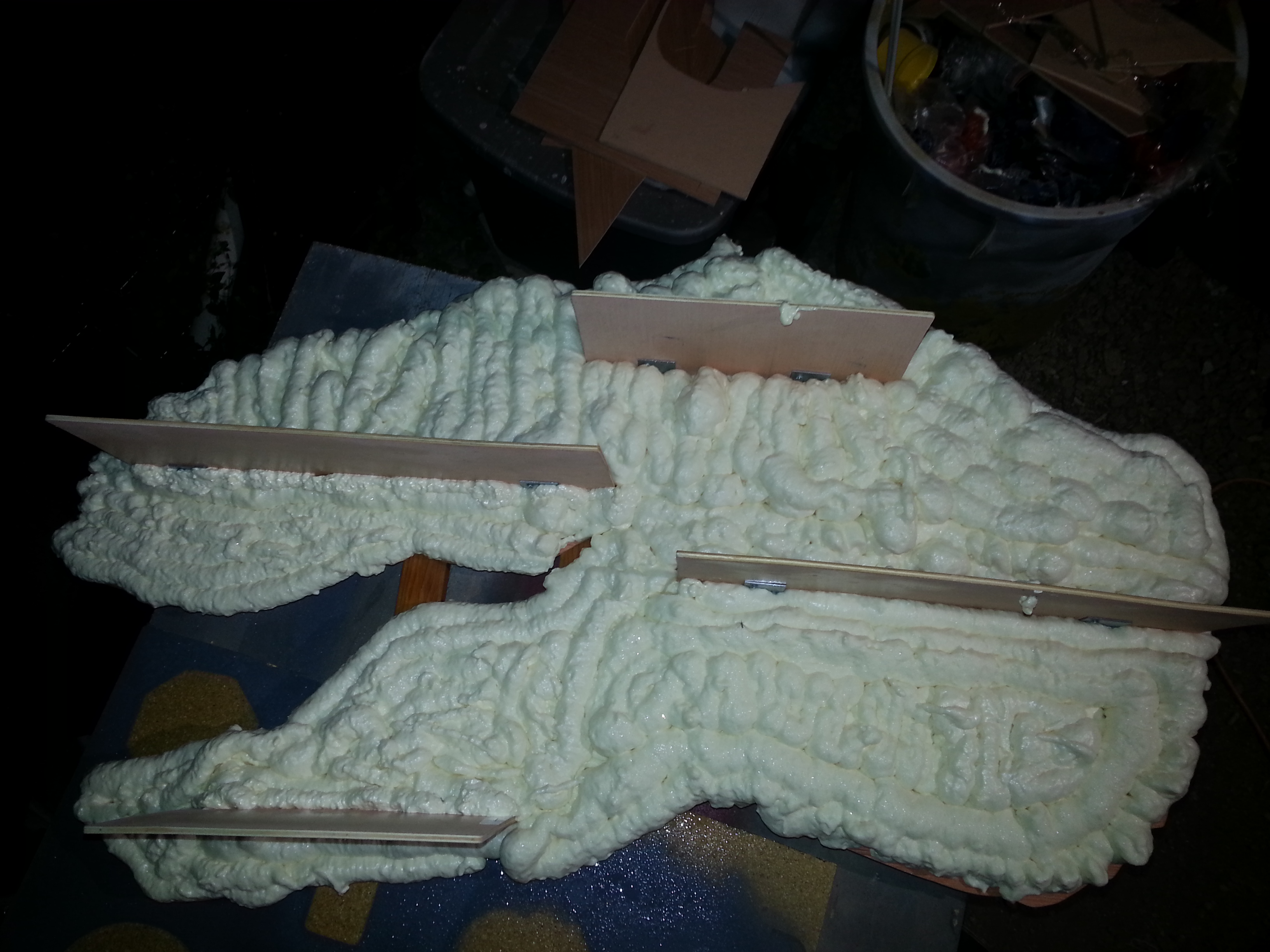

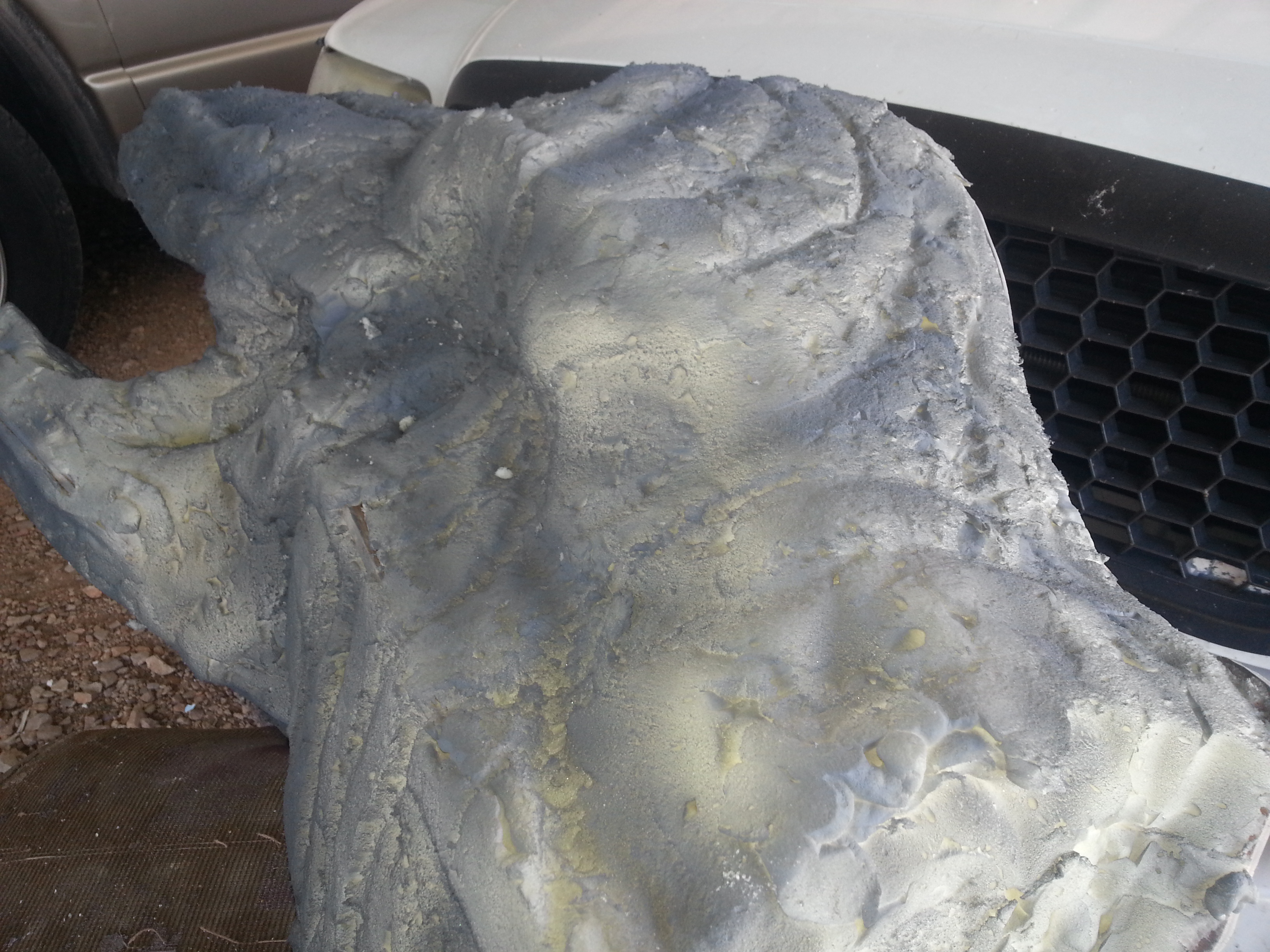

After 4 cans of expanding foam I got the main areas of the T-rex head filled in and ready to sculpt away.
After 1 hour and a giant foam mess later I had most of it blocked out and ready to fill in the rest of the large gaps with more expanding foam.
View attachment 487528View attachment 487530View attachment 487532
Let it set up overnight and then got back to more sculpting and started sanding it smooth.
Today I carved in some details on the neck and left it kind of rough as I wanted to see how the texture would look.
I loved how the rough area looked on the neck so I went back over the entire sculpture roughing it up and adding more gouges.
View attachment 487535View attachment 487537
Started priming it up for paint. Right now I am tracing out teeth on card board that I'll glue to some wooden skewers and push into the foam.
As far as painting goes, going do a base color over the whole thing with rattle cans and then paint in details with acrylic paints. Its going to be about 12- 18 foot from the closest person to it and time is running out way to fast so with all its flaws and errors I still have to keep moving on with it and the rest of the display pieces that I need to complete and put together.

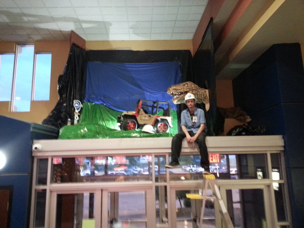

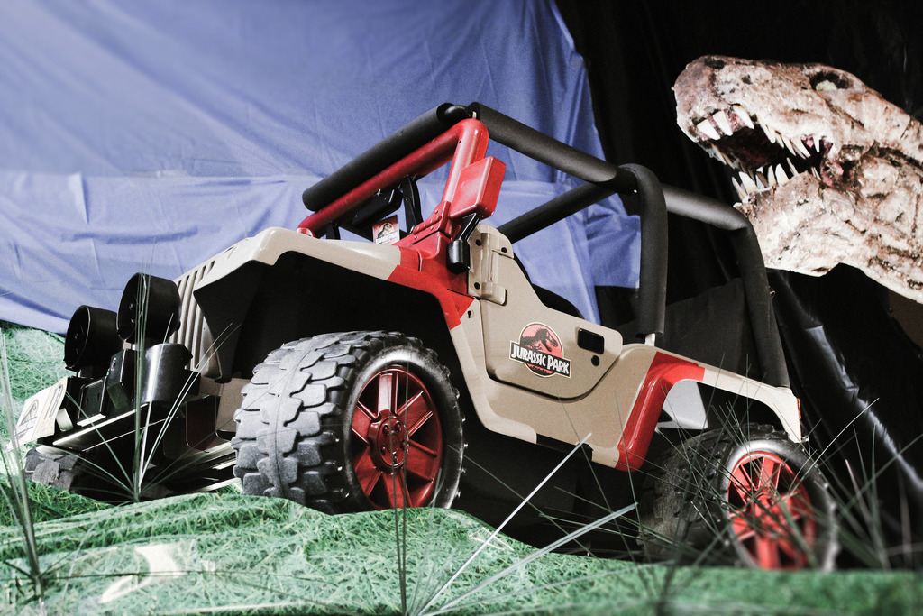

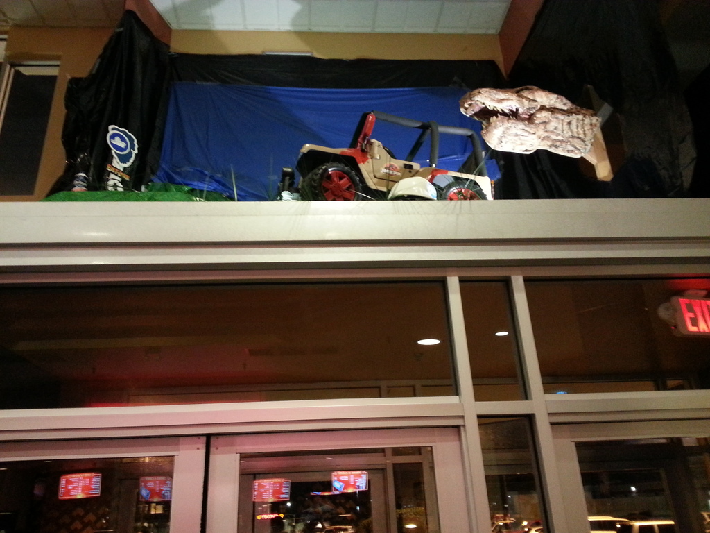

Hey guys! Sorry for the lack up updates as most of you know Jurassic World has been very successful at the box office... which means I'm always getting called in. :p Any who I got the display all done and set up at the theater on Saturday 6/13. Its been a lot of work to get it too were I could live with it but its also been a ton of fun. ON WITH THE BUILD!!!

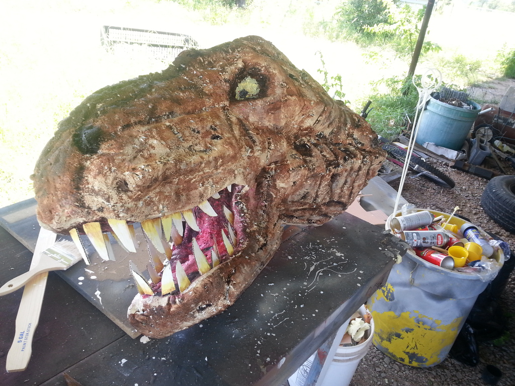

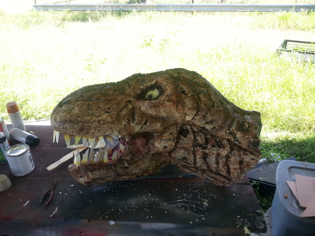

On the 10th I woke up to check and see how well the Trex was taking to spray paint. Needless to say spray paint doesn't hold to well on really porous surfaces so it still looked like the pic above. I needed a solution and really cheap/fast. I figured that since the velociraptors from the original JP were foam covered in latex and painted that maybe a thick layer of latex based paint would act as a good base surface and I could then paint with acrylic paints over it.
SUCCESS! After two thick coats of Latex Acrylic Paint I was able to hand paint the T-Rex head. I wish I could have had more time to sculpt in fine details and get proportions and everything cleaner and more accurate. But from far away it passes quite well for a trex :D.
After completing the T-Rex painting I made a quick support frame for it to hold and be stable with some cheap 2x4's and mounted her up!

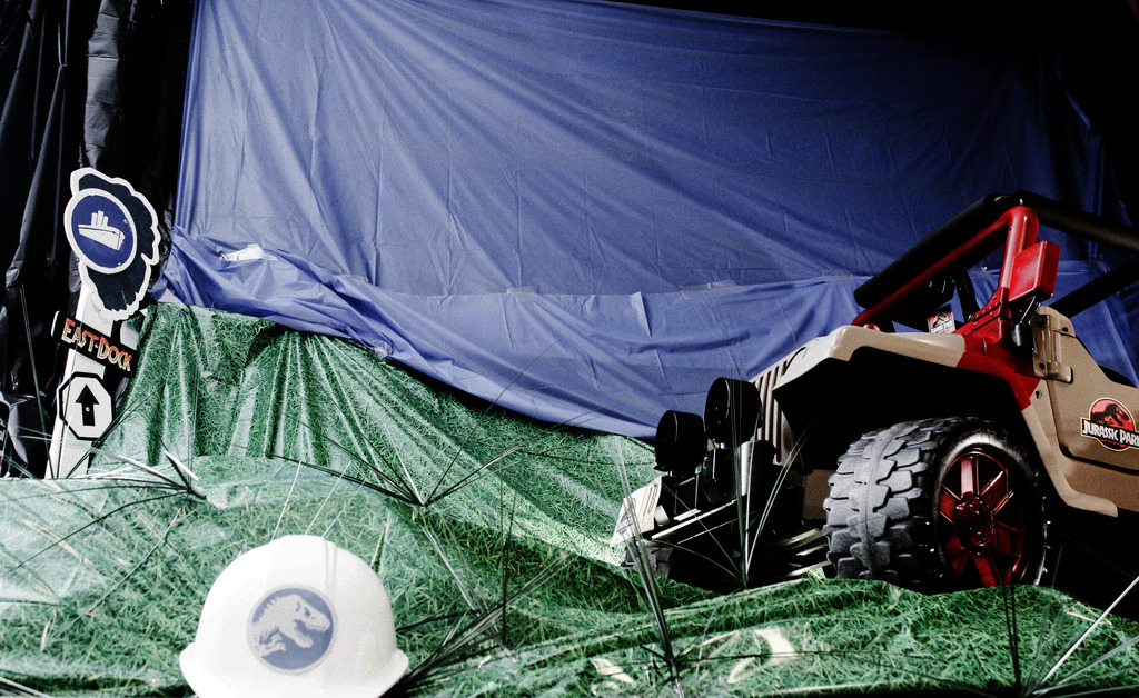

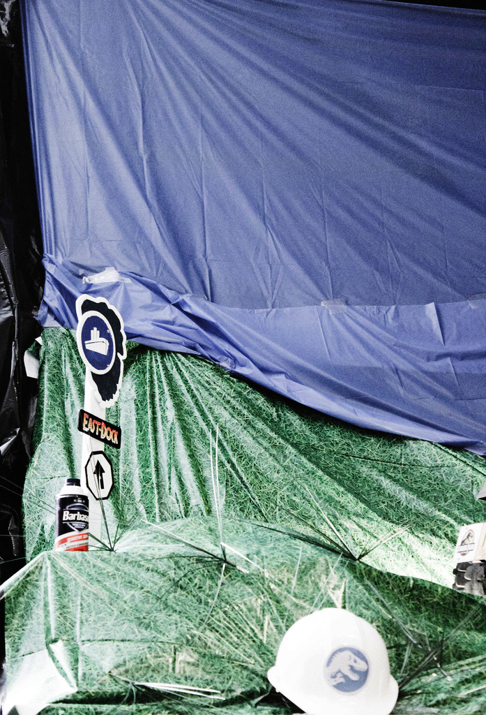

Finally after completing all the large builds. I asked around and got me a couple of hardhats and slapped on a Jurassic World sticker(more shipping label stickers:D). I made me a Jurassic Park Name badge using the template found in the Paper Props section.

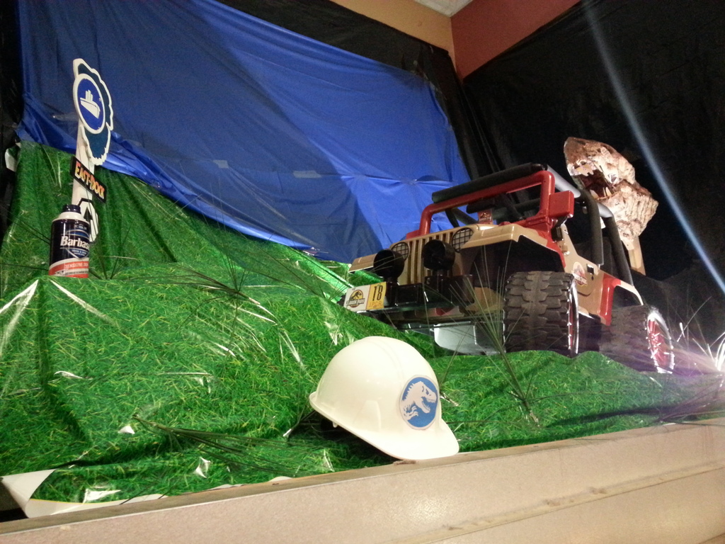

I had to give up on the idea of doing a mattepainting with the time restraints and also I ripped my masking paper template just by stepping on it. So I went to the party supply store and found 2 table drop cloths with a grass texture (was around a bunch of football themed things) a large deep blue table drop cloth, and a few fake grassy stems (on a side note fake plants are insanely expensive) and taped them onto a large black painting drop cloth block out some of the large windows so you could see the display and to tape the other drop cloths onto.
IMG_20150614_204939_zpsa35m9y7x.jpgIMG_20150614_211603_zpslgfp1e9e.jpgIMG_20150614_211917_zpscxiqjjw6.jpgIMG_20150614_211951_zpsubk1xqlp.jpg

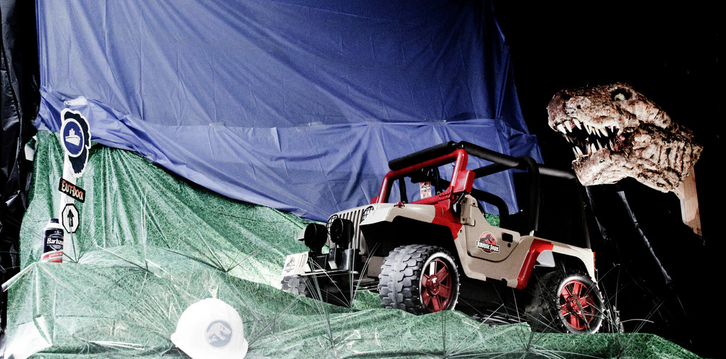

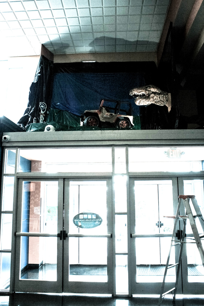

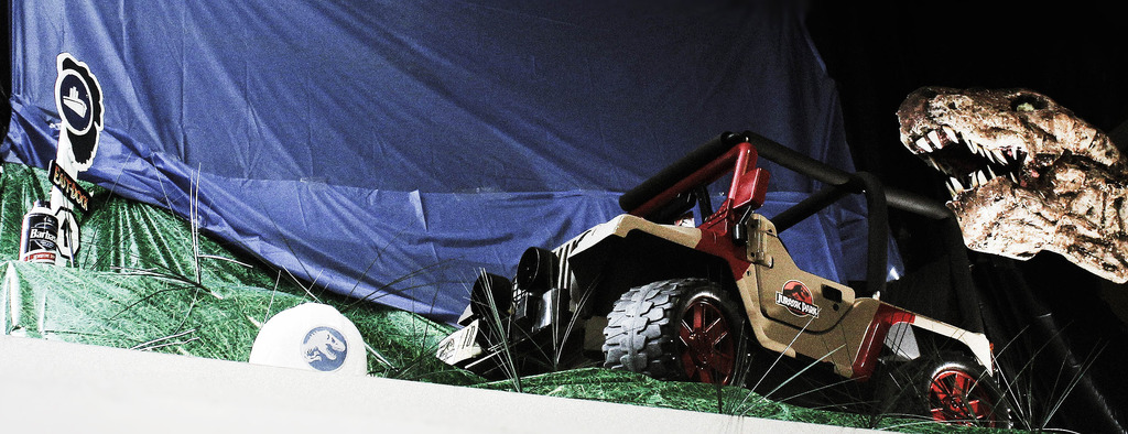

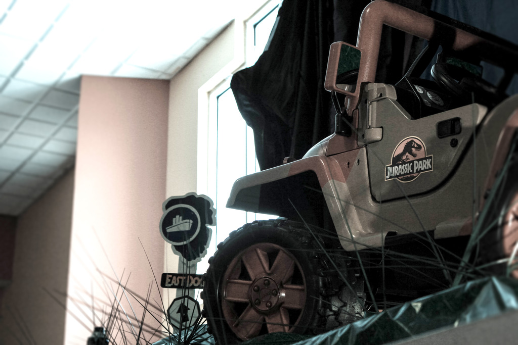

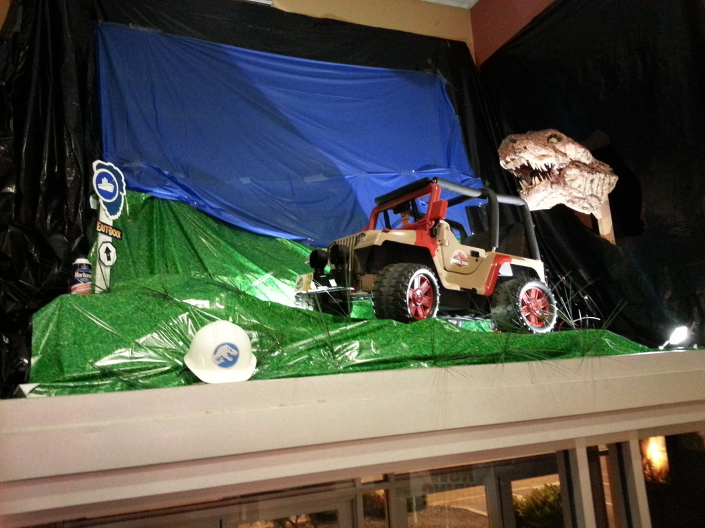

And finally I brought everything up to the theater, and up the ladder and mounted it all up on pallets for a better view from below. I used my large LED work light from Lowes to light most of the area and a small florescent light to fill in some darker ones.
This has been a very fun build and Ive received a lot of local and online support during it. Which really pushed me into completing this and kept me going at times. I am happy with what I made in the amount of time I had and I cant wait to figure out whats next. Maybe this time I'll give myself more time..... but probably not :D

I got a few photos from my buddy today. Hes working on some more he took but hopefully this can give the display some better justice than my camera on my phone.:D
11406153_10206815803424006_8589682383118535387_o_zpsr8j0bhb9.jpg11018625_10206815812144224_6961404915647020210_o_zpsuqz19laf.jpg
More to come soon! :D
I got the images today from my buddy. I really like how they turned out. :D
