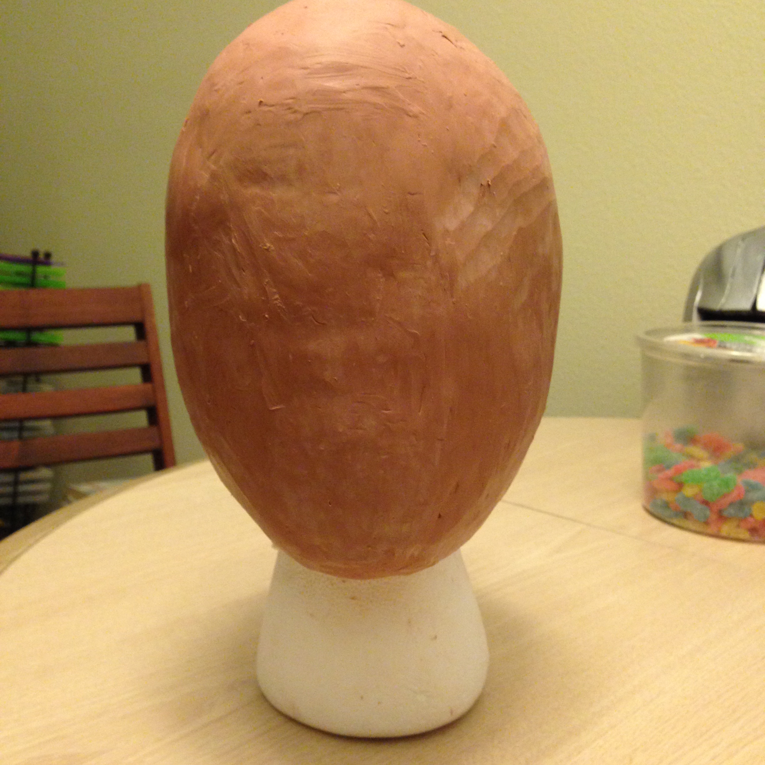

After 8 hours and 4.5lbs of Chavant NSP Medium Clay, I am here.
Basically the plan is to sculpt a base helmet that I will then cast, break down the clay, layer it ontop of the master and build the final helmet from there.
Given that I've never used clay before and the cheap foam head is a tiny, I accidentally built a large portion of it to be uneven. Kinda works out though since I haven't even designed the final helmet design completely.
I'm considering going in with my calipers and cutting circles into the sculpt later tonight to try and get an idea of just how much I messed proportion wise and balance it out before smoothing and gathering my silicone and such.
Any and all tips/critique/advice is welcome. I'm honestly horrified that once I cast it, I'll find it's too small haha

I've hit a cross road. I started on this Styrofoam head from Michaels out here in LA. I measured it and found that it was basically a good 2-4 inches off in all directions.
Rather than building it up with something expendable though, I got impatient and started in on the clay. Now I think I've lengthened the helmet (on one side) long enough to fit my head. However it's only half done, needs to be widened out width wise, and since I'm just using this craft head, the weights too much for it to stand on its own outside of use.
View attachment 467504 View attachment 467506 View attachment 467517
I've used up all 6lbs of the clay I bought and although I could (and probably will) go back and buy another two bricks, it's starting to feel like I'm just burning it ineffectively. It wouldn't be hard to get back to this stage (now that I've learned how to not burn myself and thank god for wire which I didn't have before) but I'm debating if I should just truck through it or restart to be more efficient.
What do you guys think? Right now I'm just trying to build the basic helmet shape and cast that. From there I'd sculpt my helmet onto that. Just can't decide yet if I should keep on this road or rip it off and grab some expanding foam and build a new armature (this time with a base)

I personally haven't done much sculpting aside from a self portrait, but I ran into the same issue with the small Styrofoam head blank.
From my experience, I would highly recommend restarting.
The best way to look at the situation is as a learning experience, allowing for refinement of the skill on the second pass.
Definitely look into bulking the head out and making a base for it to sit on. I ended up making a wood base with some threaded metal pipe from the hardware store. The pipe added some weight to the base, brought the work area more into a comfortable height, and allowed for it to be removed from the base (if needed).
Good luck on your ventures sir, I hope any of this info helps.

You should look into getting a sculpting armature. Look into the Ed Head from Monster Makers, or David Mosher's armature. Both would be a lot more efficient then working off of a Styrofoam head.

Oh wow, Pitch! I loved your Deathstroke build. It's actually one of the one's I've been reading through to prep for this build.
I'd kill to get a proper armature. I've overspent this month so I'm hoping early next month to resolve the armature issue. I'm debating between getting an Ed Head, David Mosher's armature, or just going all in and attempting a life cast. A Life cast would be my preferred option, and Tested's zoidberg project has provided the best life cast results I've seen, but I haven't ran the numbers yet to really assess just how much I'll need to save to do it yet.
In the mean time, the weight of this head has definitely taught me the importance of having a stand. So I think I'm going to grab some expanding foam from my local home depot and start over as Z suggested. That'll save me on clay usage as well.
I've read TMBountyHunter's Skullman
build religiously before starting this and I think I'm going to try his armature method for this initial build. I'm going to take pictures of my head next to a yard stick. Print it out as close to 1:1 as I can. Cut some cardboard and slits to lock the profile and straight on shots together and fill the rest with foam. Currently limited to my motorcycle so lets hope I don't die trying to transport wood and a rod to make the base haha.
Which armature do you use, Pitch? Also, since I'm basically going to make a master shell and then sculpt ontop of that to create my final helmet, what would you suggest I make the master out of since I basically intend to use it like a head armature and will need it to last multiple projects.

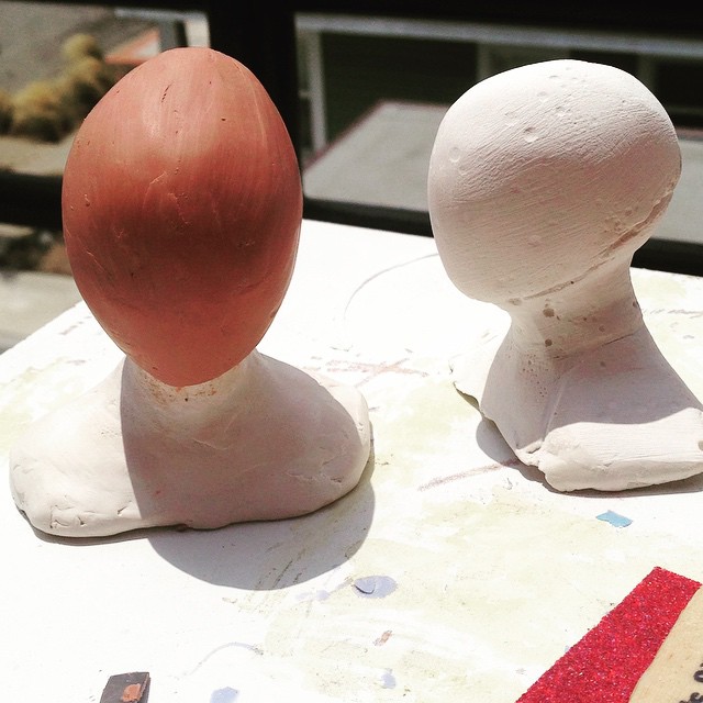

Well my experimental pour of my mini bust is now underway.
Things I've learned from this stage:
-Figure out whats important to you before you buy the materials.
I.e.: I knew Oomoo 30 and 25 were different based on cure times but with my girlfriend constantly alerting me that the store was about to close (her pet peeve) I neglected to check which had the shortest cure time. Now I'll have to kill the next 6 hours as opposed to oomoo 25's
-Hot Glue guns eat up glue like there is no tomorrow (although luckily its very cheap) So learn to be efficient with it.
-REALLY learn to make a good seal with the hot glue. I should've probably lined the cup with some clay at the base. Had a few spots where the silicone began to leak. (hopefully) patched it up with a river of glue.
As far as the housing, I bought a large sheet of foam core, a huge set of party cups as I figured for this it'd be a useful mold housing. (Hopefully the cup doesn't effect the cure)
I didn't need all of the party cups but walmart only sold them in a pack of 50.
I figured out the amount of silicone to pour by filling up an additional party cup with water, pouring it into my mixing cup to get the volume. Figuring the water displacement of the head wasn't much, I used the exact of mount I had originally poured into the cup (400ml) and it worked out perfectly.
Now to wait 6 hours and come back with results.

SUCCESS!!
I learned just how much plaster expands by making 150+ml of it when really I only needed 25-50ml lol.
So glad too because as the silicone was curing, I realized I only had resin which I didn't want to waste on a test mold. I zipped over to my local craft store and got ArtPlaster 10 minutes before closing. So glad I did.
Things I learned:
-Art Plaster expands a lot. About 3x the volume of the water.
-Party cups make amazing and effortless mother molds for tiny sculpting. It slid perfectly into a new cup.

So I've been experimenting over the last few days with my current set of materials and have a few questions.
#1: What's a good way to seal and make a plaster cast durable?
When I went to draw on my bad pull mini bust, the pen just dug into it. (Which made me excited and I started to carve into it) But when I do a life cast, I'd rather not accidentally cut into it while sculpting.
#2: What's a good material for casting a stunt helmet with intended use?
These helmets won't just be for show. I intend to use them and future helmets in film projects and a Smooth Cast 300 helmet seems like it'd crack pretty badly if it ever fell off a table. Would lining it with fiberglass during the casting process provide it enough safety?

When you do eventually get around to making a lifecast you'll want to make it from Ultracal 30 or something comparable. Basic hobby store plaster, is, as you found out, very soft. You can still scrape and scratch Ultracal 30, that's true of any type of "stone" whether it be something you pour for a mold or a rock you find in the backyard, but Ultracal 30 will not gouge. It's tough to describe precisely how much harder it is, but anyone who has used it can attest to the world of difference between it and a plaster of Paris. As to the second question, and I don't know if I mentioned it in my threads I linked to previously, but I DID knock my helmet off a table and it DID crack. That said, I did not cast it thick enough in certain places and I used Smooth Cast 65D. I have since read that Smooth Cast 300 has less issues with warping which was another issue my helmet also suffered from. All told, I believe that a helmet cast thick enough out of Smooth Cast 300 could withstand a fall from a reasonable height like off a table and come off no worse for it (aside from scuffing up your beautiful paint job). I sincerely hope no one wearing it falls on their head, even from a height of the average table!
