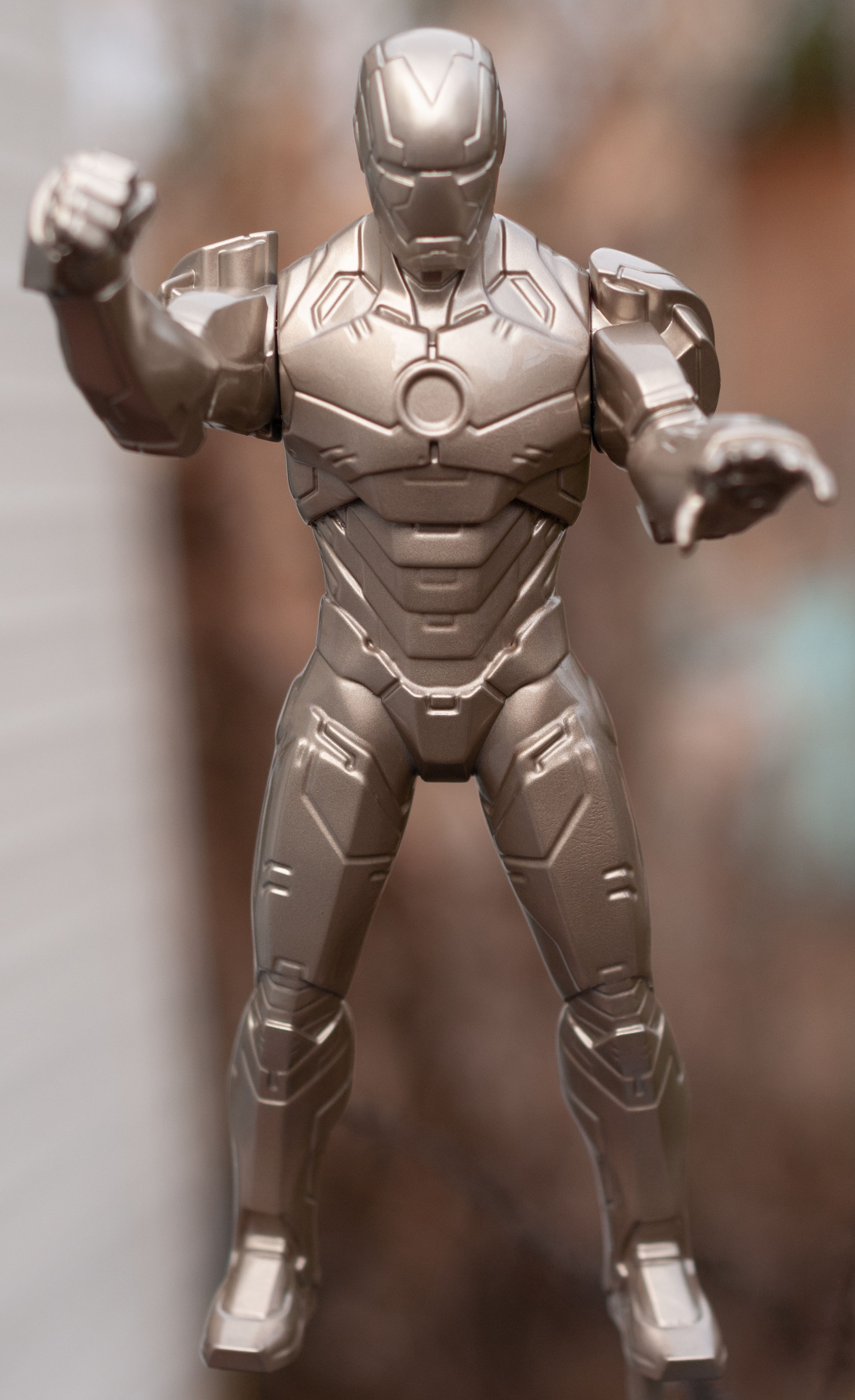

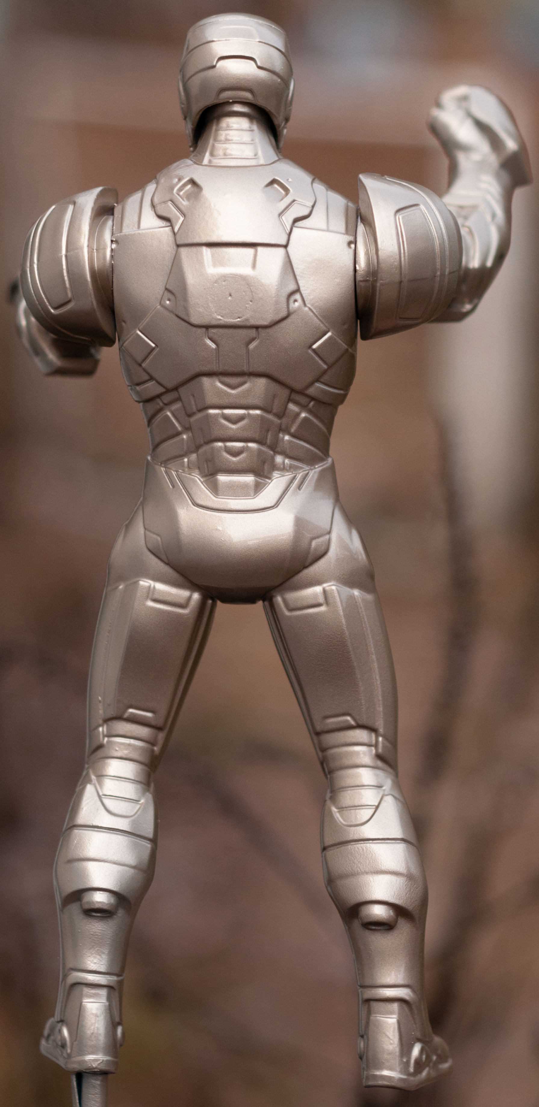

After a new coat of Mr. Surfacer, I applied the "Champagne" gold again. Base Coat Front DSC_3067.jpg Base Coat Back DSC_3072.jpg
I like the pale gold color for this!
Looking at these images, you can see that the Apoxie Sculpt filling job on the back could have been better. I'm out of practice and have never done a figure like this. Also, especially on the right arm, the filling job looks especially not-so-good; I think that is due to the material used for the arms and would probably happen eventually no matter what I do.

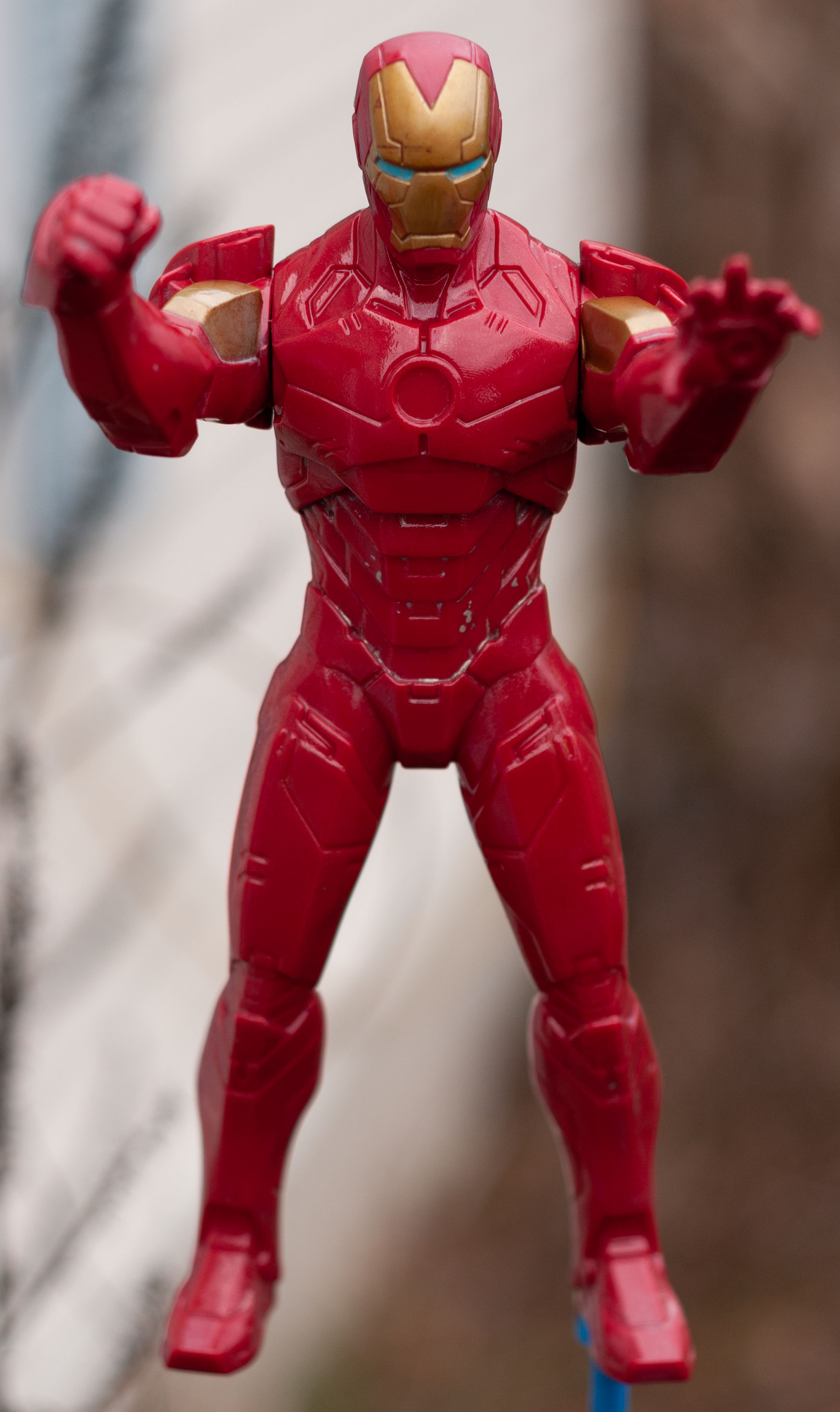

So, upon further reflection, I decided not to start over with this figure. A day or two after my last post above, I took a closer look at the thing. The paint damage I mentioned seemed to have settled down a great deal as the clear coat dried. You can still see it, but it is much less noticeable than it appeared it would be at first. So, I decided to soldier on. It won't be perfect, but it was never going to be perfect. I could never take the figure apart, and so I cannot lock the rubbery arms in place -- which means the paint around the join between the arms and shoulders gets damaged a bit, no matter what. So I'll finish it as best I can and call it a learning experience or proof of concept or whatever or both.
I also did do a test of the new "acrylic" clear coat I bought and determined it would also damage the clear red paint I used, so I used Future applied with a brush instead. That, at least, seemed to work fine.
Over this past weekend, I painted the gold details by hand. The only parts I masked were the gold panels on the front of the legs. There are a few spots that need some additional work, and some small areas where the gold smeared and a few where errant flecks of gold got where they shouldn't. I'm experimenting with red-tinted Future -- using "super-concentrated" food coloring for tinting -- to fix those mistakes, and will add a second coat of gold in some places. Then I'll do another coat of Future, a black wash and a semi-gloss clear coat to finish the thing up (presuming all of these plans actually pan out). I'll post more photos in a few days, for those who are curious.
