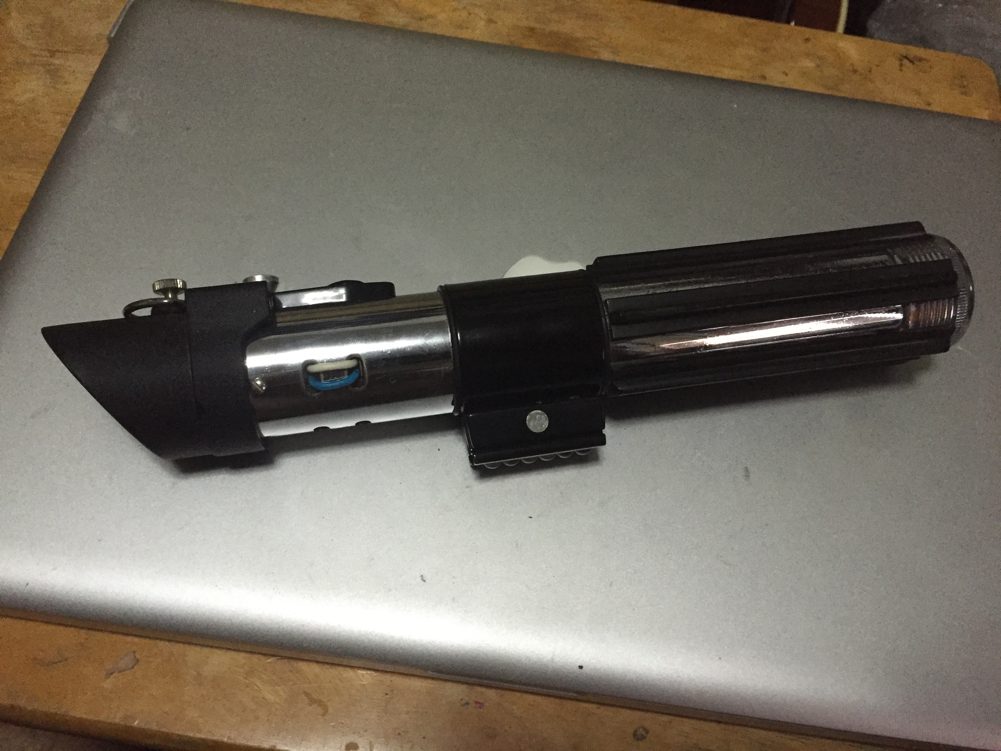

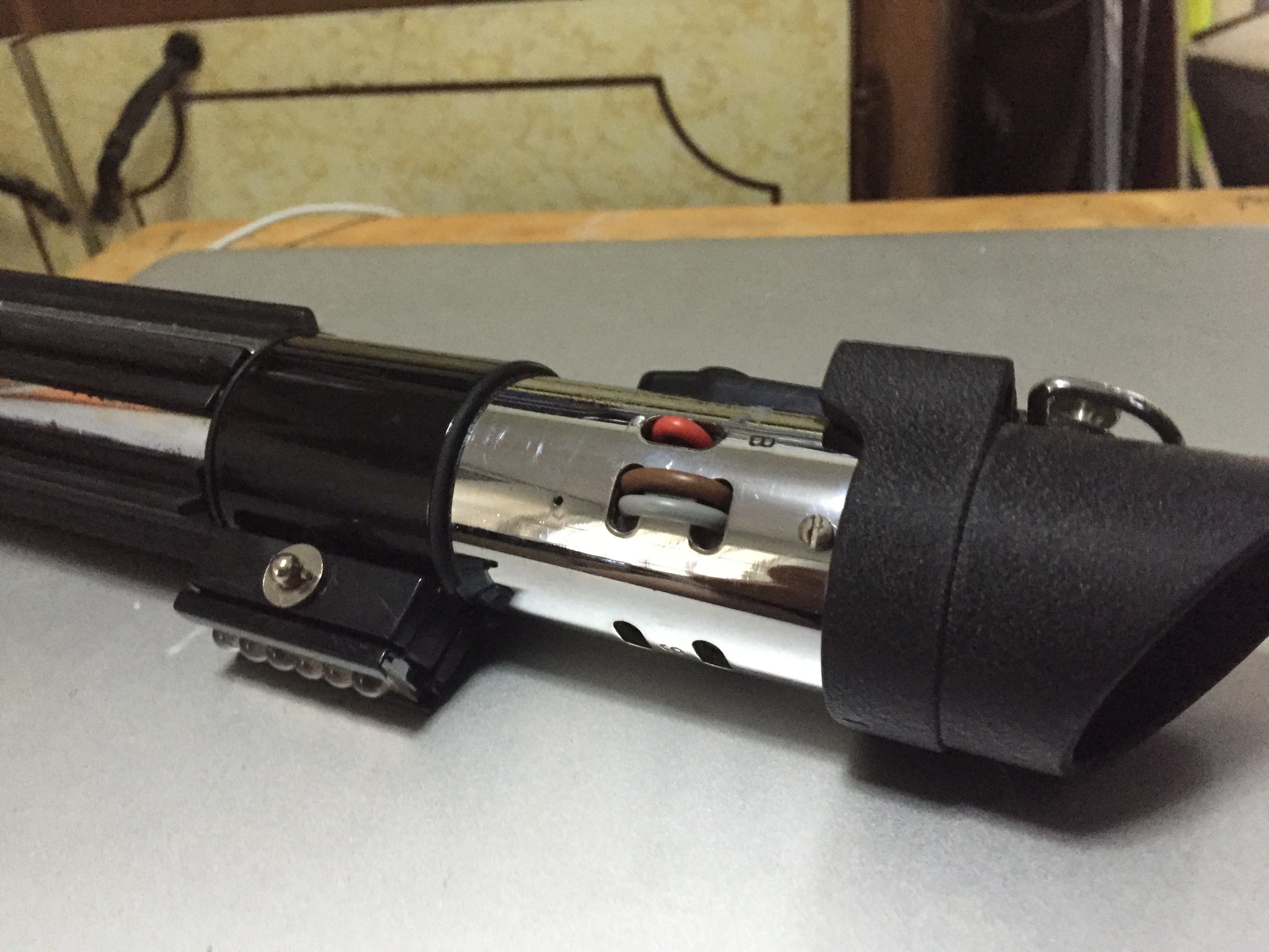

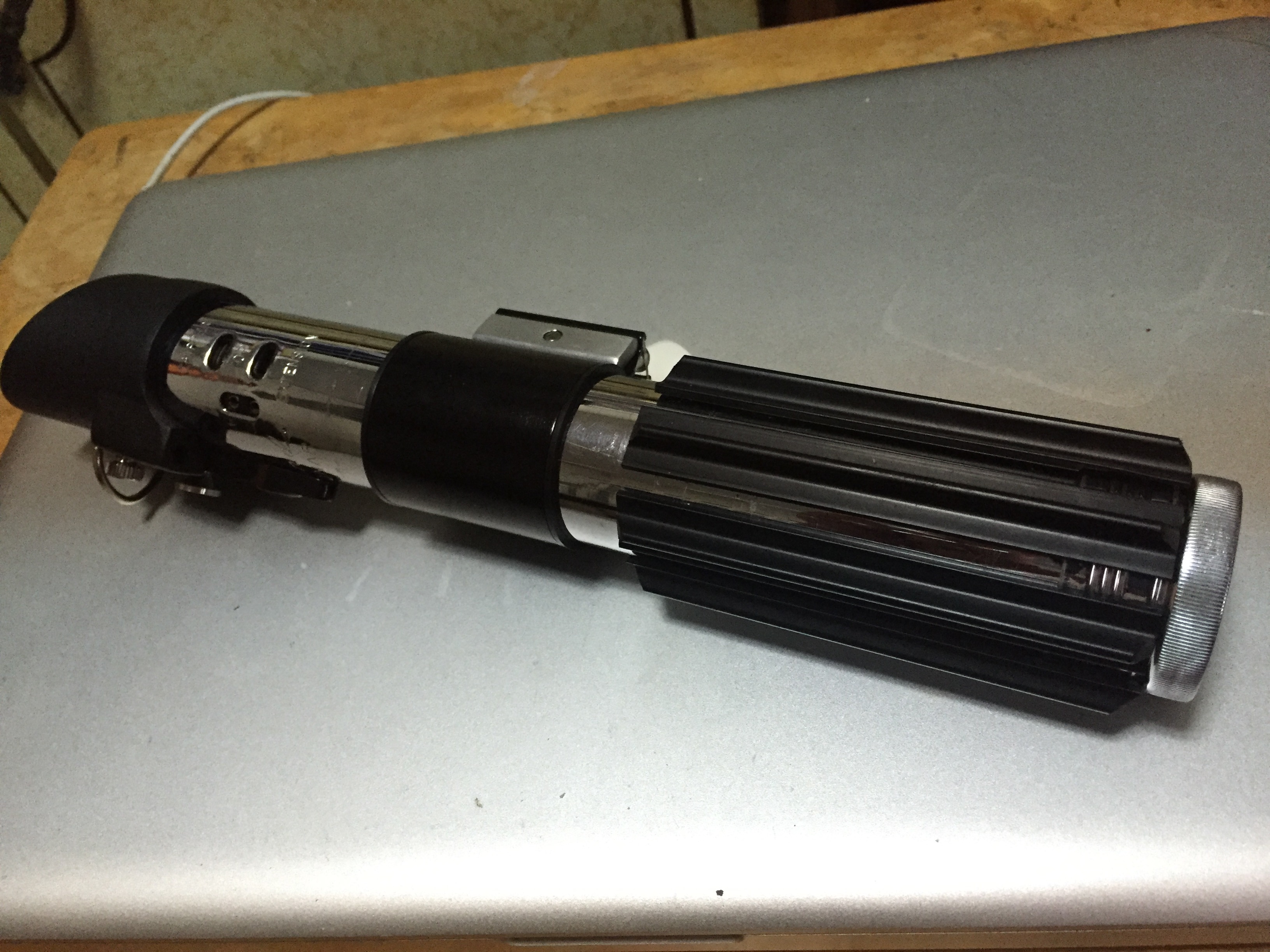

The main thing I was after on buying this was the guts. Upon closer inspection ( after receiving the flash parts) I notice that the guts wont just slide in there as I had hoped, but they were too far off. So I got my dremel and some sanding wheels and went to town on the hilts interior walls. After a while I start to realize I'm never gonna finish shaving the interior of the hilt. However the Heiland guts were made os a softer metal that would shave down a lot faster ( not to mention all the shaving I had already done on the hilts interior)
Sure enough once I got the dimensions for it to slide in, I was pleasantly surprised to find out the connectors on the electronic guts of the Heiland lined up beautifully with the MR FX hilt. I ordered some of Roy's cables and installed them to add the finishing touch.
IMG_2080.jpg IMG_2079.jpg IMG_2081.jpg IMG_2083.jpg IMG_2082.jpg IMG_2084.jpg
Now the reason why I chose to just modify this hilt instead of buying another full Heiland is because it has all the "right" ( replicated) markings of an MPP. It even has the two holes that were meant to hold the MPP plaque. Also the bottom cap looks a lot better and closer to the MPP cap, than the average Heiland squared off cap. ( BTW if you look closely that my ANH Heiland, you will notice I got really lucky and found a flash that had the correct shape of the connectors and the better looking bottom cap.)
Anyways, there you have it. It was a lot of fun to do this and I am very pleased with the results. Hope you guys enjoy it.

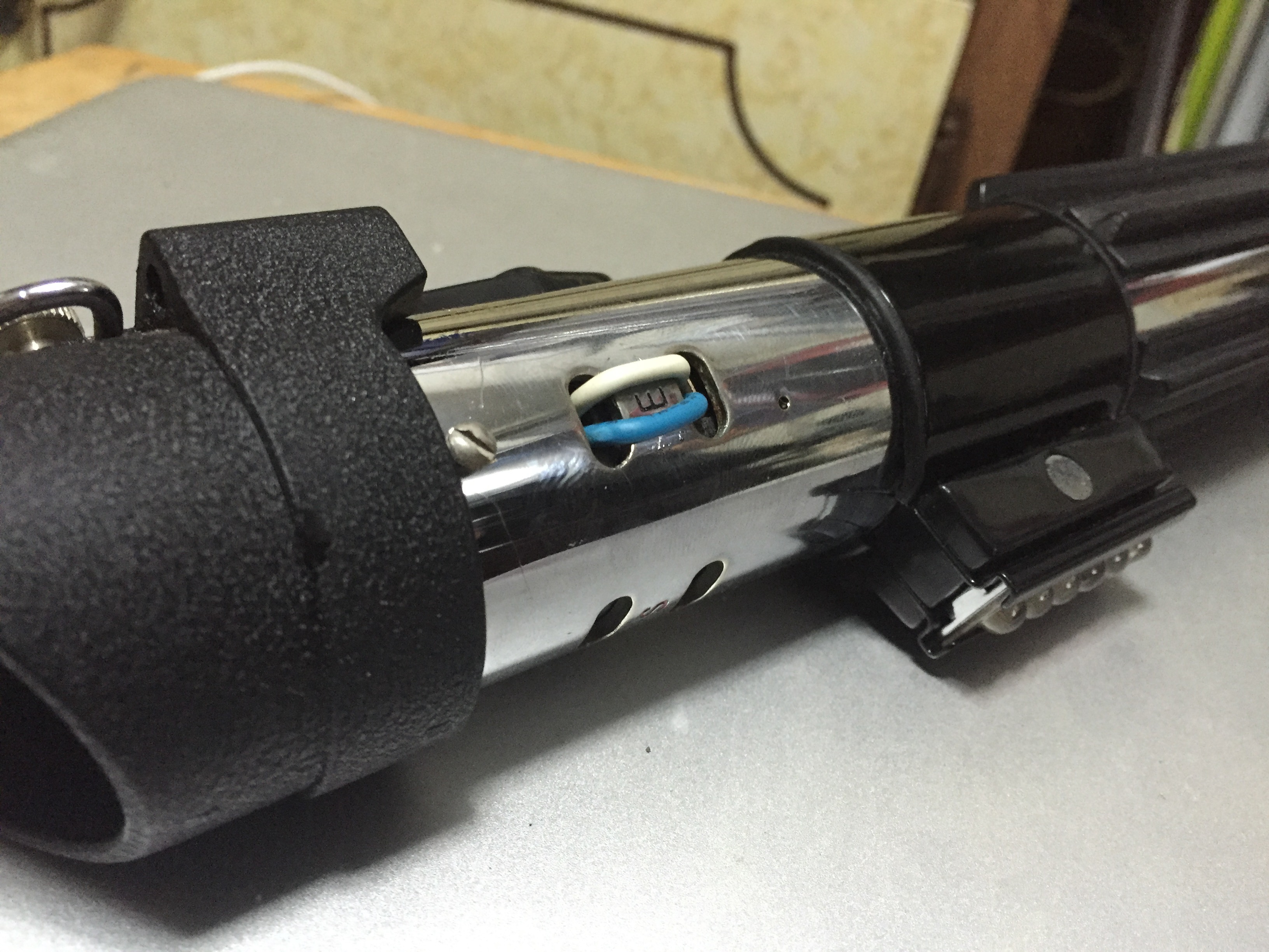

So I love how Roy's cables look but as its already known from pictures of the original ESB/ROTJ prop, the blue and the white cables are actually a bit thinner than the grey and the brown cables. So I went looking inside some old computer parts I had in the closets and found a pretty good match for both the white and the blue. Replaced and voila:
I think they could still be just a bit thiner, but for a random search in the closet, I would say its an awesome catch and a lot better than before.
